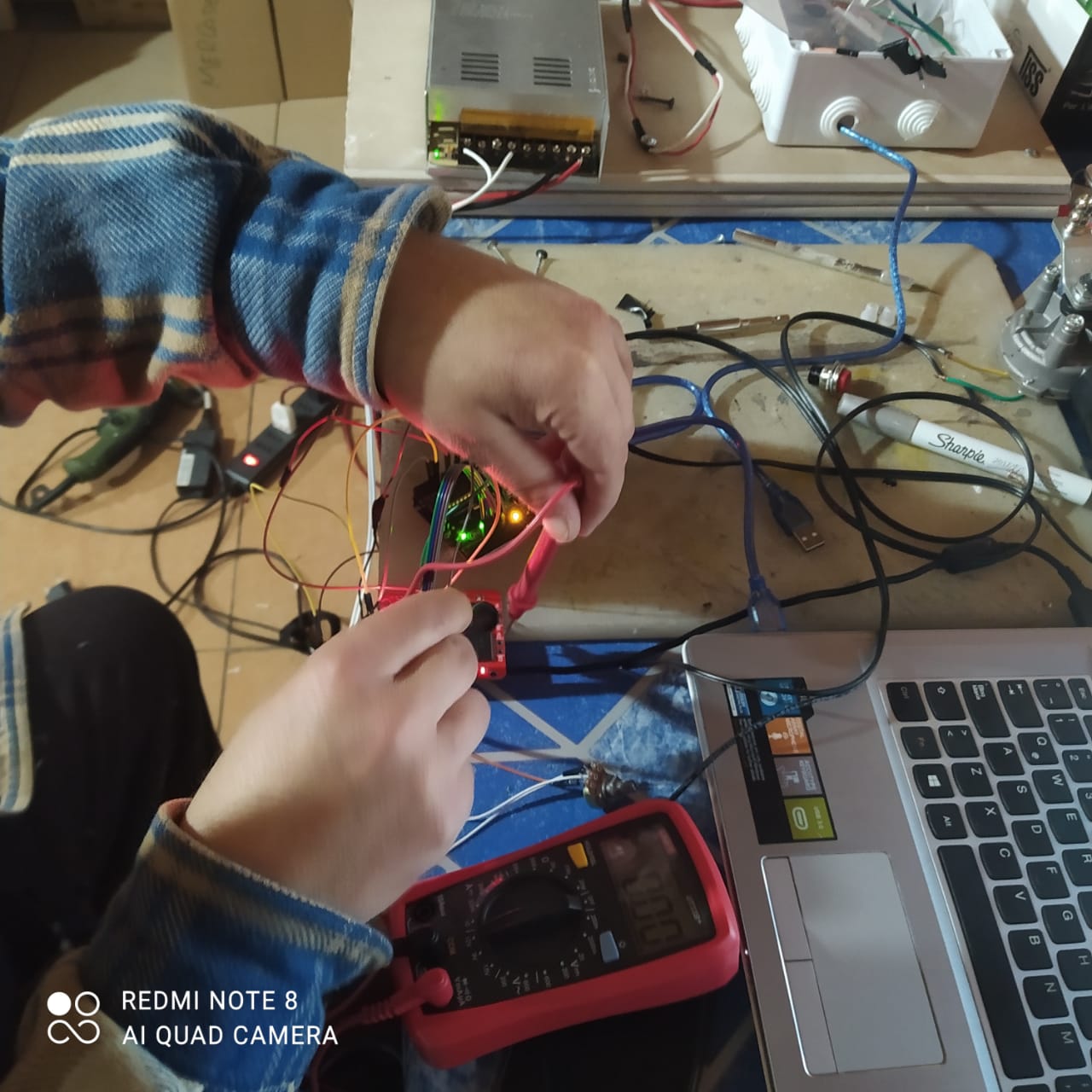

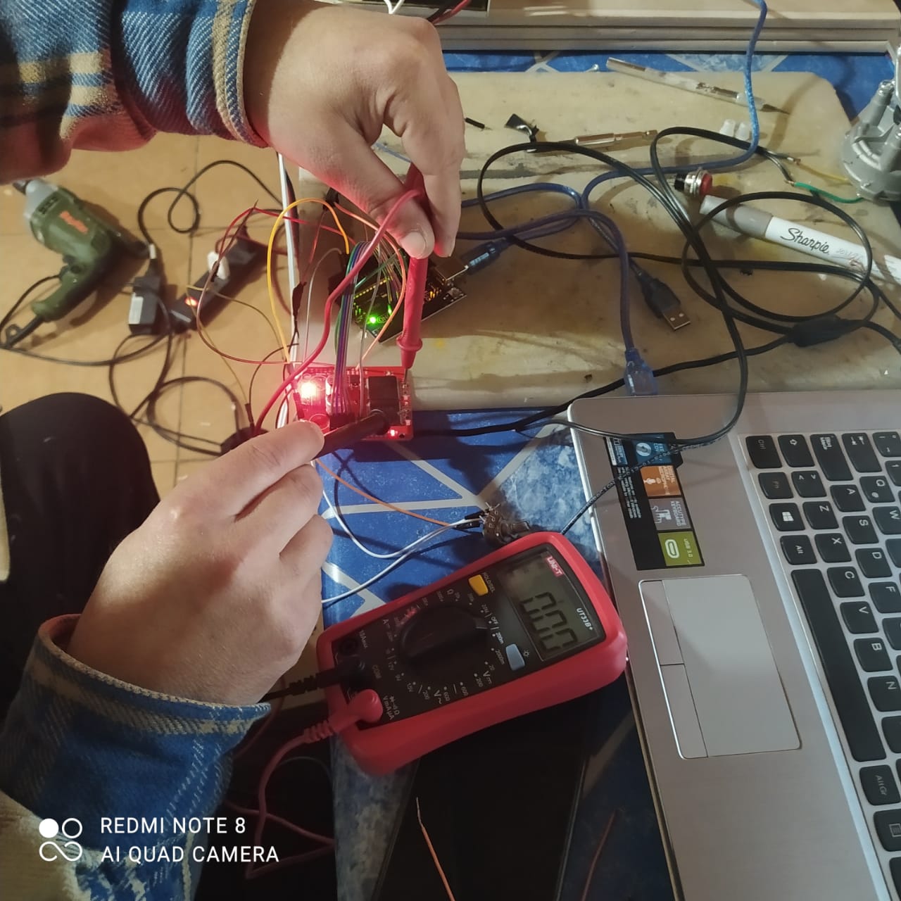

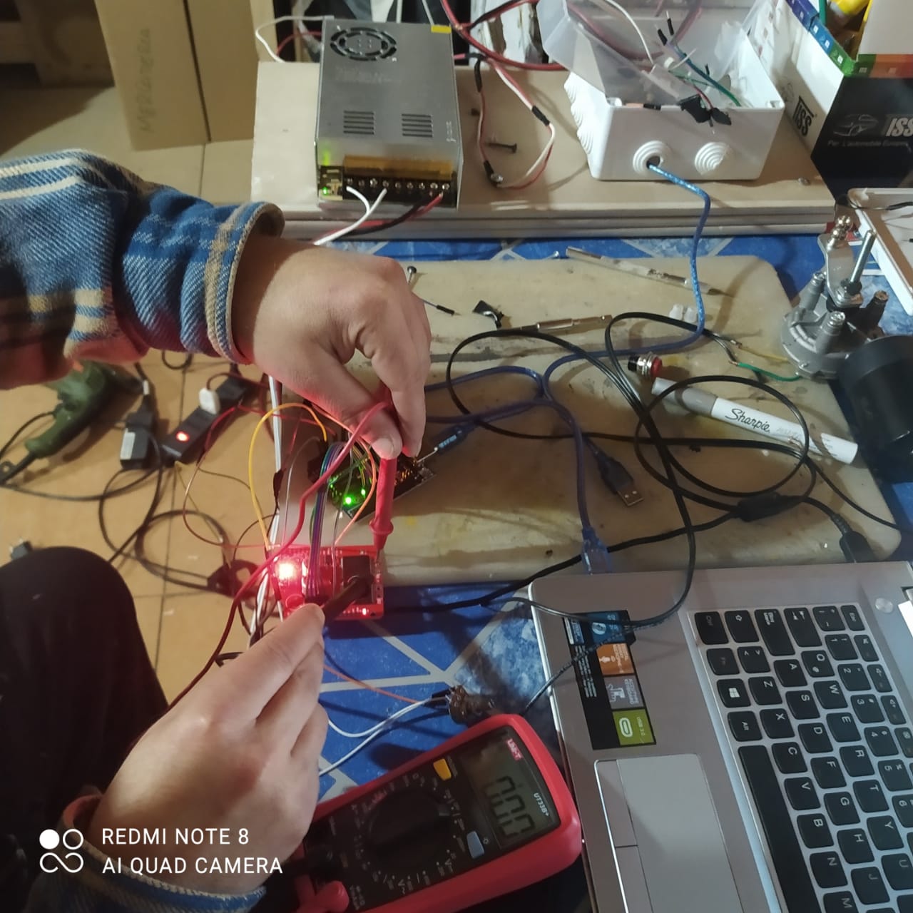

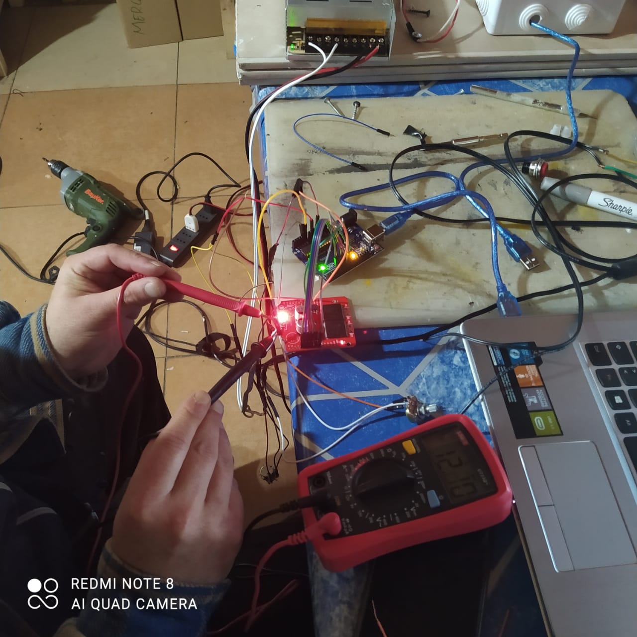

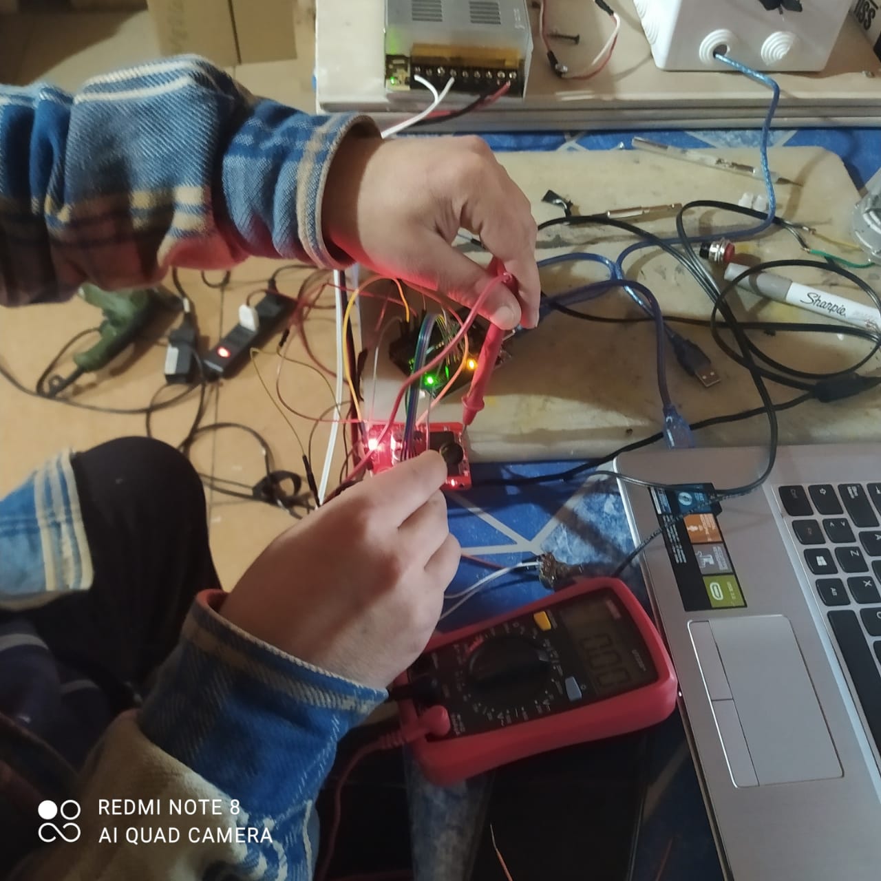

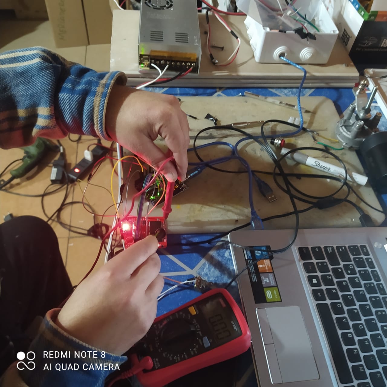

    Hello i build a 2dof with 12v motor i connect all and do the smc3 but when i check the motor dont move,
    checking the energy the slot power motor dont have electric, pls check the pictures and help me
    1 picture: the power supply mark 12v to the moto monster
    2 to up pictures try to put on dif slot, but no one combination work
    what s i do wrong
    the conection is the layout of motor monster.
    the arduino have the last smc
    the smc3 utility detect the arduino

    Ty for reply me, i do the volage test to slot motor A and B and dont mark energy, the mm the bad?
    21,487
    150,542Coins
    +11,017 / 55 / -2
    Test the MMs fully as @SilentChill suggests, including under motor load:
