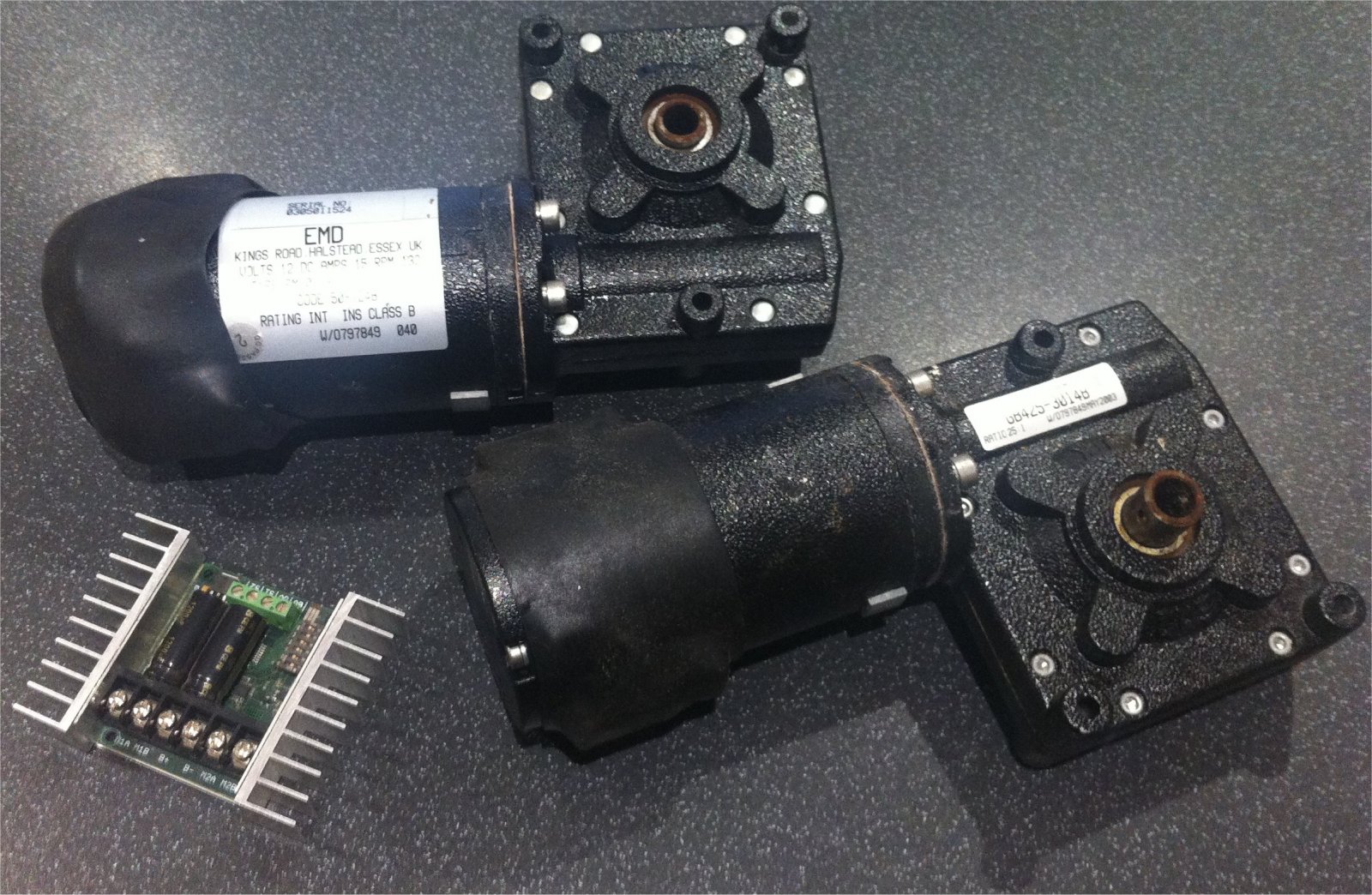

    I plan to use 2 off 12v electric golf trolley drive units (that I knew at some point would come in useful for something – cheap deal from Ebay a few years ago) they are 15 amp units with a 25:1 worm drive giving 132 rpm.
    I also have a DC Sabertooth 2x25 controller as seen in the picture; hopefully this will at least give me a start! From what I have gathered from the vast amount of data on this site the Sabertooth has a simple little unit that attaches to it called a Kangaroo this gives you the ability to add motor feedback by means of potentiometers and end of travel limit switch capability’s. Although from what I can ascertain from various threads this is not the best (function wise) or easiest unit to work with but I think it’s a good cheap option to get me off the ground and get my motors turning!

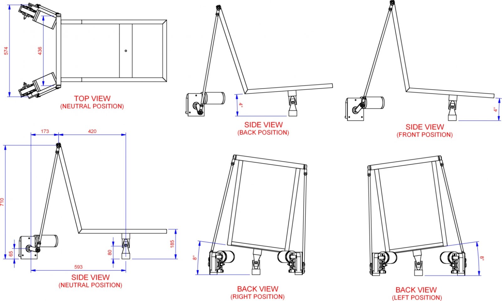

    Ok so I have started to sketch out the mechanical geometry for this but I would like some advice if possible on the amount of ideal movement.
    The below sketch shows what I have so far.
    As you can see I am getting 4deg forward and back each way and 8deg left to right each way, I am rotating the motors +/- 60 deg and I have a crank length of 45mm.
    Will this be sufficient or would you suggest adjusting to create more or less in each axis ?
    Also a small animation of the current geometry...
    Any suggestions would be greatly appreciated ! Cheers.

    I run 65mm CTC levers but only use 80 deg of the turn of the motor, resulting in about 80mm of travel which rolls the chair about 10deg. And when it get a shacken and rollen its quite hard to keep a car straight, like being thrashed around in a real car.
    8 deg is plenty for a seat mover but you can lengthen the levers a bit and use less rotation to gain the same angle or more , resulting in snapper movements too, as in the motor turns less to reach its min and max points.
    With what you have there it looks like the mount (pivot) is under the middle of the seat, it needs to be in the cg point of the chair , a little more forward, balance is the key in a nice responsive seat mover. But overall it will produce a nice effect.
    Looking good cant wait to see it come to life.

    Thanks for your advice eaorobbie, I will do some adjustments after work. I should be picking a seat up over the weekend so I will mock something up to gauge the C of G also. Again many thanks.
