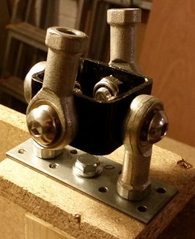

    I do not have any tools for cutting metal or welding, so I'm planning a couple of workarounds that I've seen here. Rather than using steel plates like @pipis2015, I'm planning on using wood. I've seen a few other similar projects that mount the motors and the universal joint to wood, so I'm thinking this will work ok. As for the universal joint, I'm going to try to make my own like @Wanegain suggests in the need-u-joint-recommendations thread:

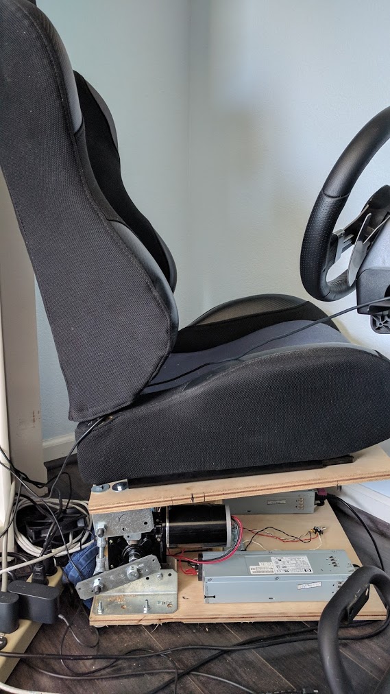

    Life got in the way and this project took a bit longer than planned. I was able to work on it slowly here and there and finally got it all together though. Here's the rig with the seat attached:
    I did end up building my own u-joint, and it seems to be working well:

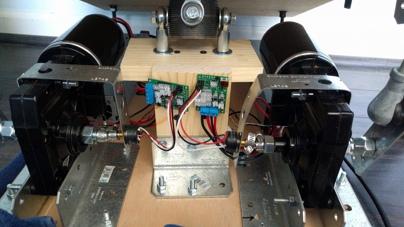

    Here's how I've got the two motors mounted:

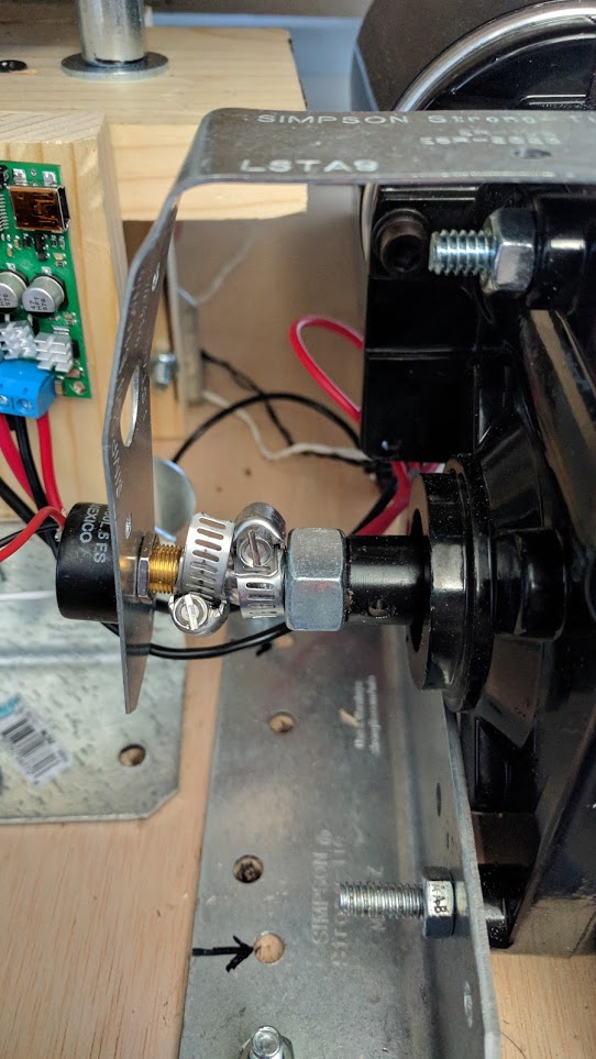

    I ended up connecting the potentiometers to the motor shaft with tubing as I saw elsewhere in the forums. Seems to be working well:

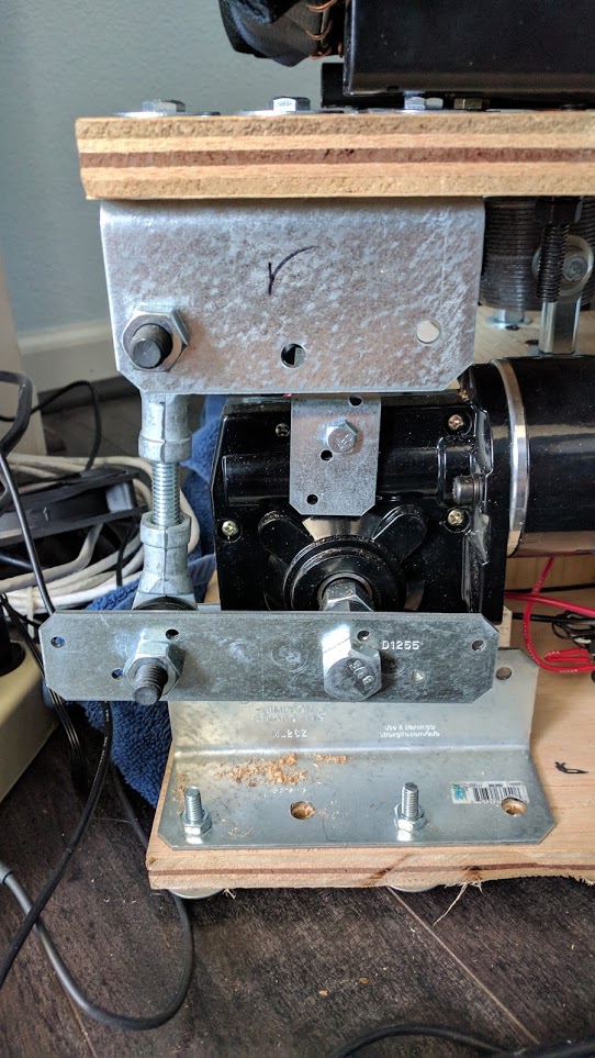

    Here is a closeup of the motor levers and rods connecting to the top platform:
    I got it all wired up and had both the JRK configuration software and the xsimulator software moving the seat around and was overjoyed :D ...until I sat in it and broke both of the motors :eek::oops::( It was all going well for a short time until I shifted my weight in the seat and found myself flailing.
    My theory is that I stripped the gears on both motors, as I am able to move the levers freely with no real resistance. My plan is to remove the motors, disconnect the gear boxes, and examine the gears inside to confirm. I'm hoping I can easily find replacement gears if that is indeed what happened.
    I _may_ have shifted my seat backward on the rails while I was putting everything together, so the center of gravity might be off. That's my first thing to check as far as addressing any design flaws that may have contributed to the break.
    Besides that, is there anything that sticks out as something to adjust? I'm hesitant about the length of the motor levers and the rods connecting the motor to the top platform. I wasn't completely sure that I was using the calculator correctly, so there could definitely be some adjustments that need to be made there. I'm also wondering if I should use some springs as I've seen on some people's rigs.

    I did suggest that with a compact sim you needed to maximize the inherent design leverage with 50:1s. But it does seem very short.
    Same with lever CTC, it looks pretty larger when what you need for a compact design is the torque.
    When you say you can move the levers freely do you mean for a full 360 degrees? I ask because if you decide damage gears it would likely be those that are engaged in the normal lever ranger, it would be unusual if it was all other gears.
    So first check obvious things like the pots and there couplings are in the correct position and that the PSUs are not telling out. If you rule out the obvious then pull the gearboxes apart and check them.
