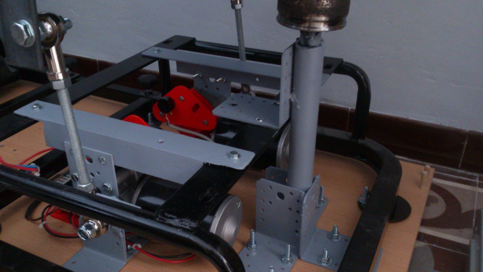

    Iwant to make works RRRE ; dirt rallye and probably nolimits 2 for unracers.
    Type of simulator :Moving seat
    Total moving load with driver is 110kg

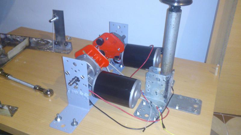

    actuators
    Motor + reducers 120w 24V
    Manufacted parts

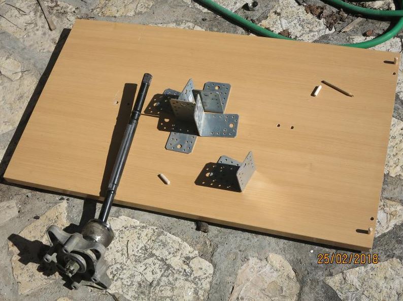

    Wood for the base I reuse a solid coffee table + RZR joint
    + a steel frame for the moving part and one as the commands supports
    My materials

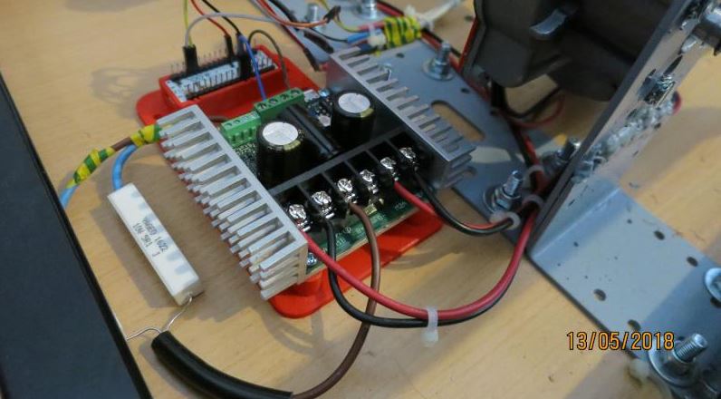

    Control : Arduino UNO and Sabertooth 32
    I wanted 7 - 7.5 degrees (means the total will be 14 - 15 degrees).
    So with the distance I have between the joint and the motors axes (25cm) it mean 3.7 cm as lever.
    My system will work at 120° to make it more punchy and to preserve the material.

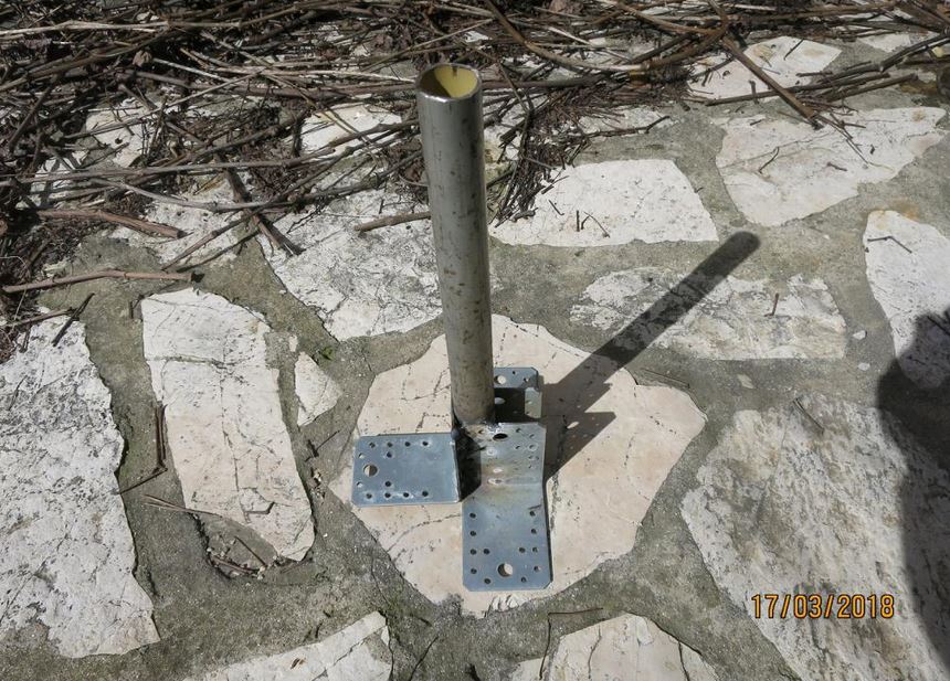

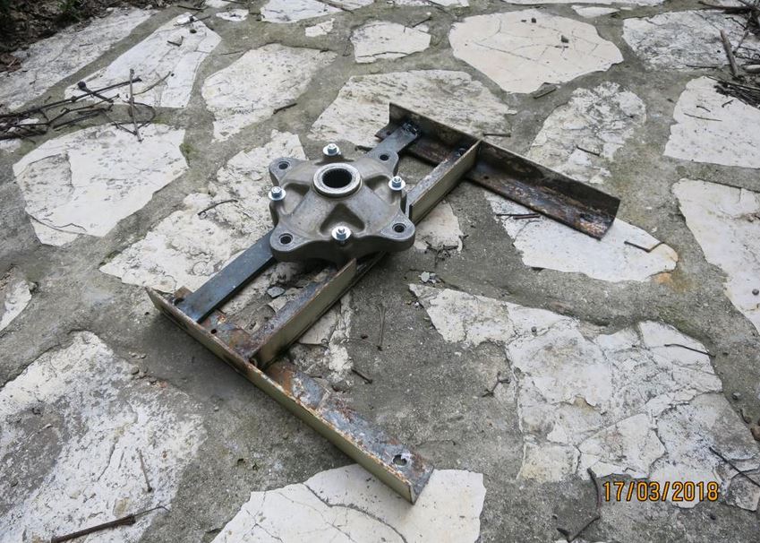

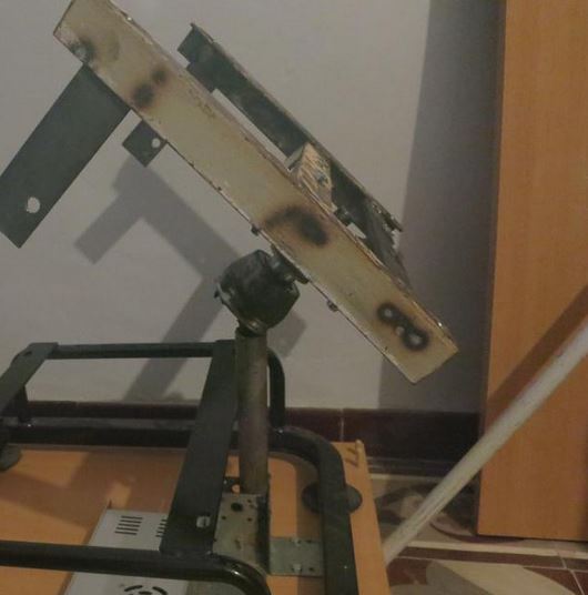

    This is the support of the joint.
    It will be sold in it to avoid rotation.
    another fixation will take place on the right at the upper side.

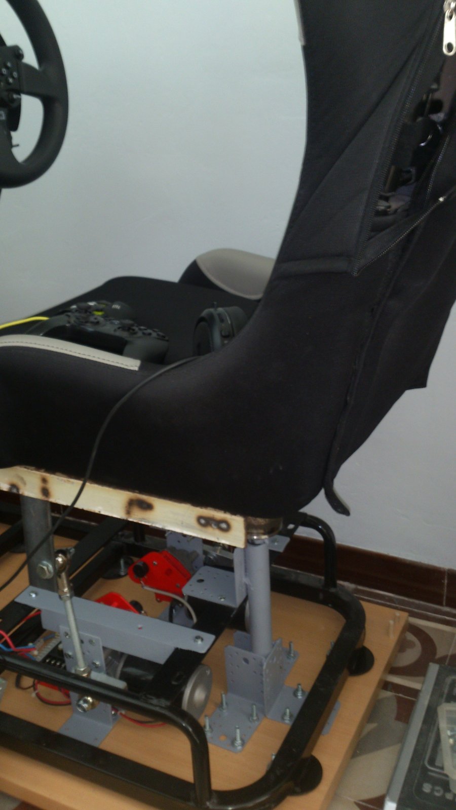

    The support of the seat.
    The beginning of the installation.
    Then the electronics parts.
    The motors and supports (soldered face to face to increase strongness):
    At this time I ve done some tests on LFS and it appears the the support of the motors were not enouth strong.
    So I've add 2 more supports to avoid the motors supports to twist.
    Now it works perfectly. Only missings a few of painting.
    Waiting to test soon on the games I use to play.

  5. Hervé
    Hervé New Member Gold Contributor
    Feb 5, 2018
    64Coins
    As written on the upper side, the card I used are arduino uno (very cheap) and Sabertooth 2x32.
    The result is very impressive and dynamic.
