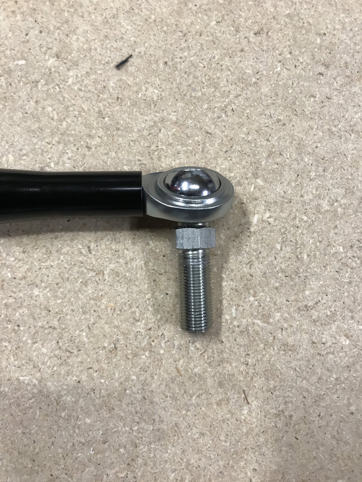

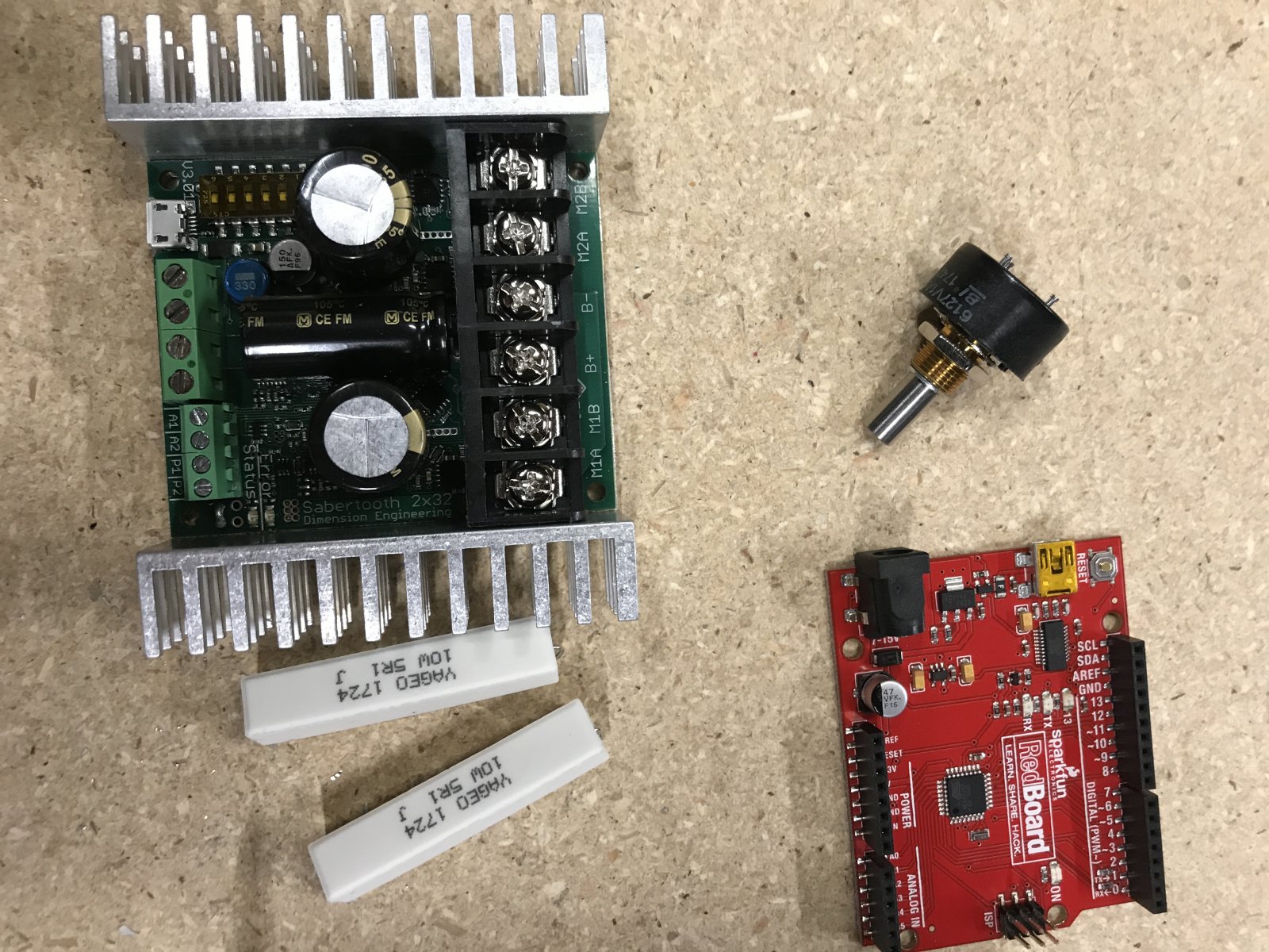

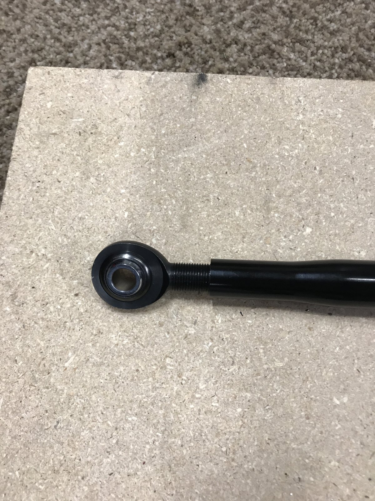

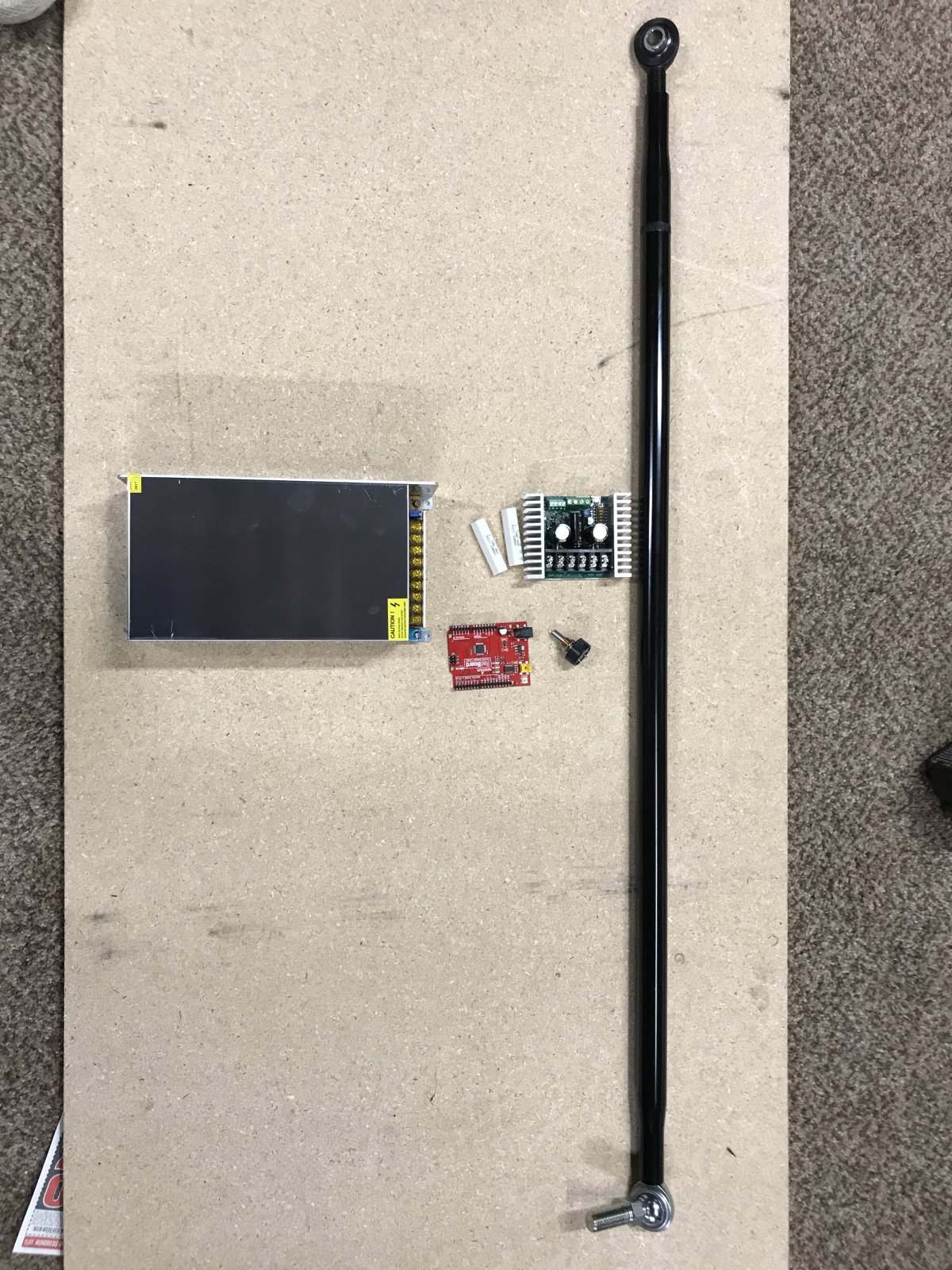

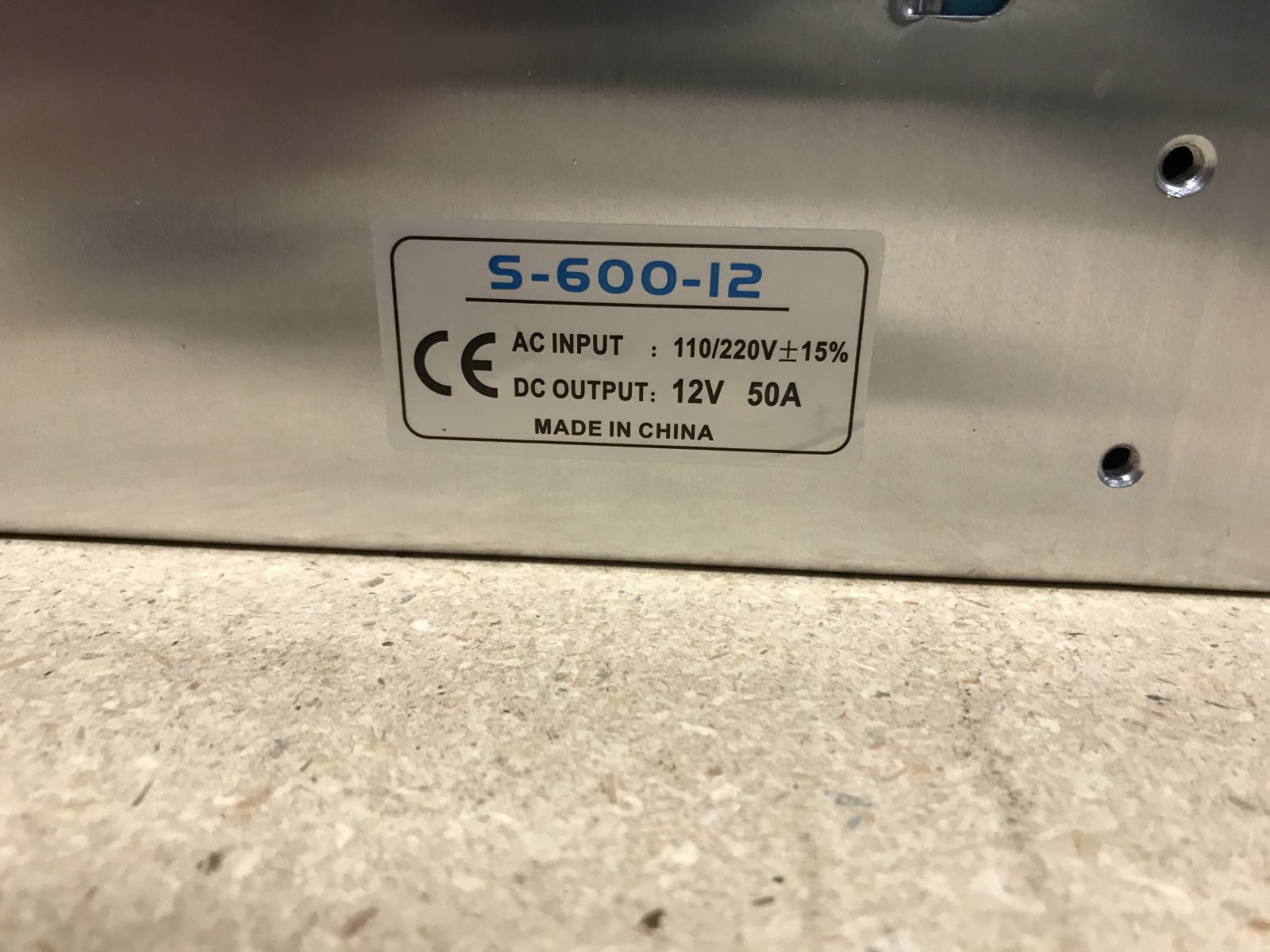

    Hello @noorbeast! thank you for your recommendations. its been a while and I finally received all the parts that I needed to start my project.
    I read a lot and I followed your recommendations, and I went ahead and ordered the hall sensors, the LED strip PSU, the saberthooth 2x32. I already had an sparkfun arduino uno, I ordered some rods and rod ends, "L" brackets, etc (pictures below)
    The PSU is a 12v 600watts 50A

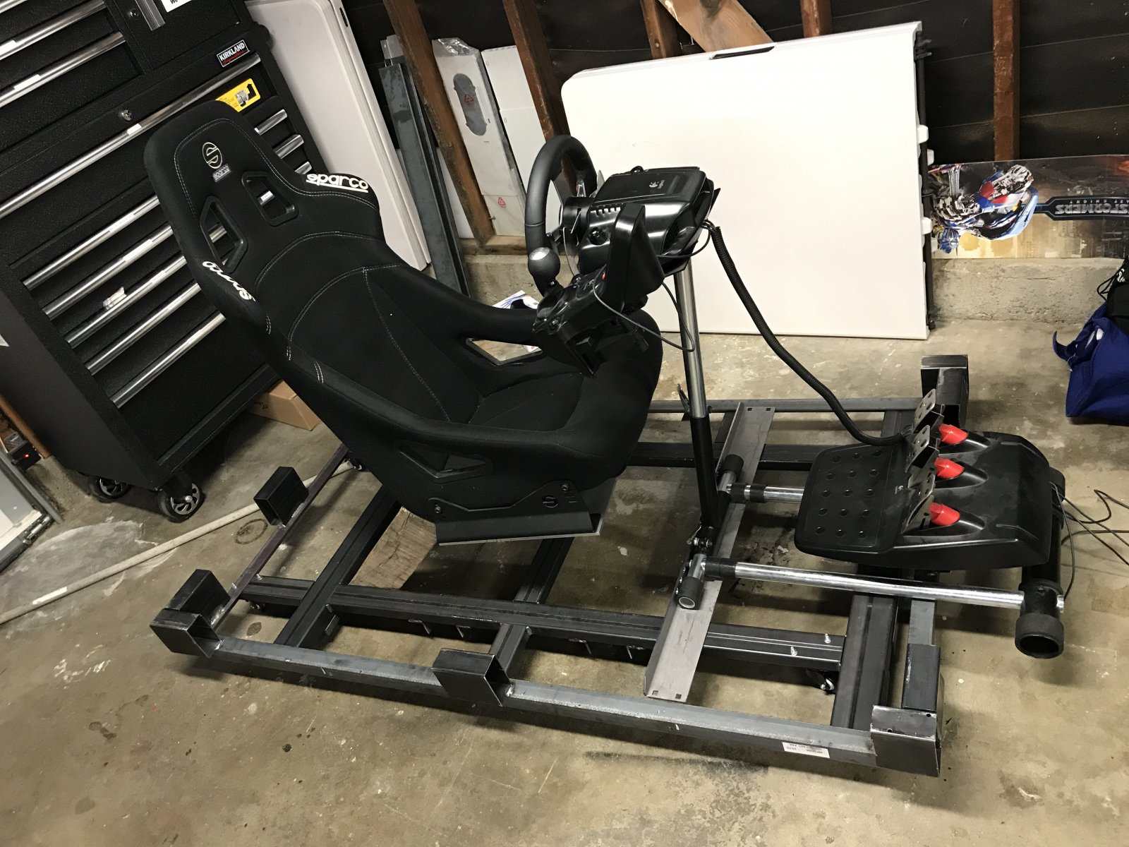

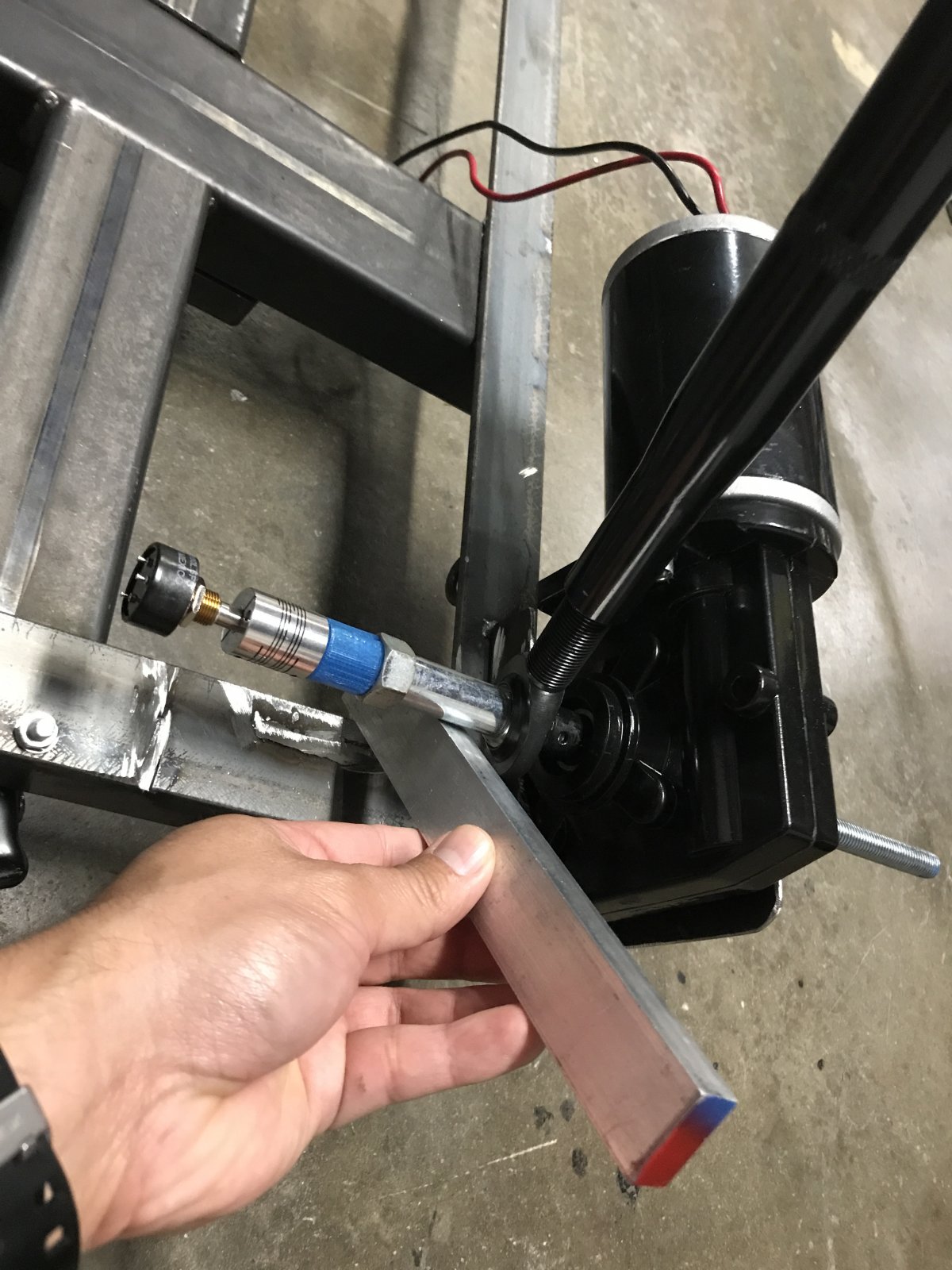

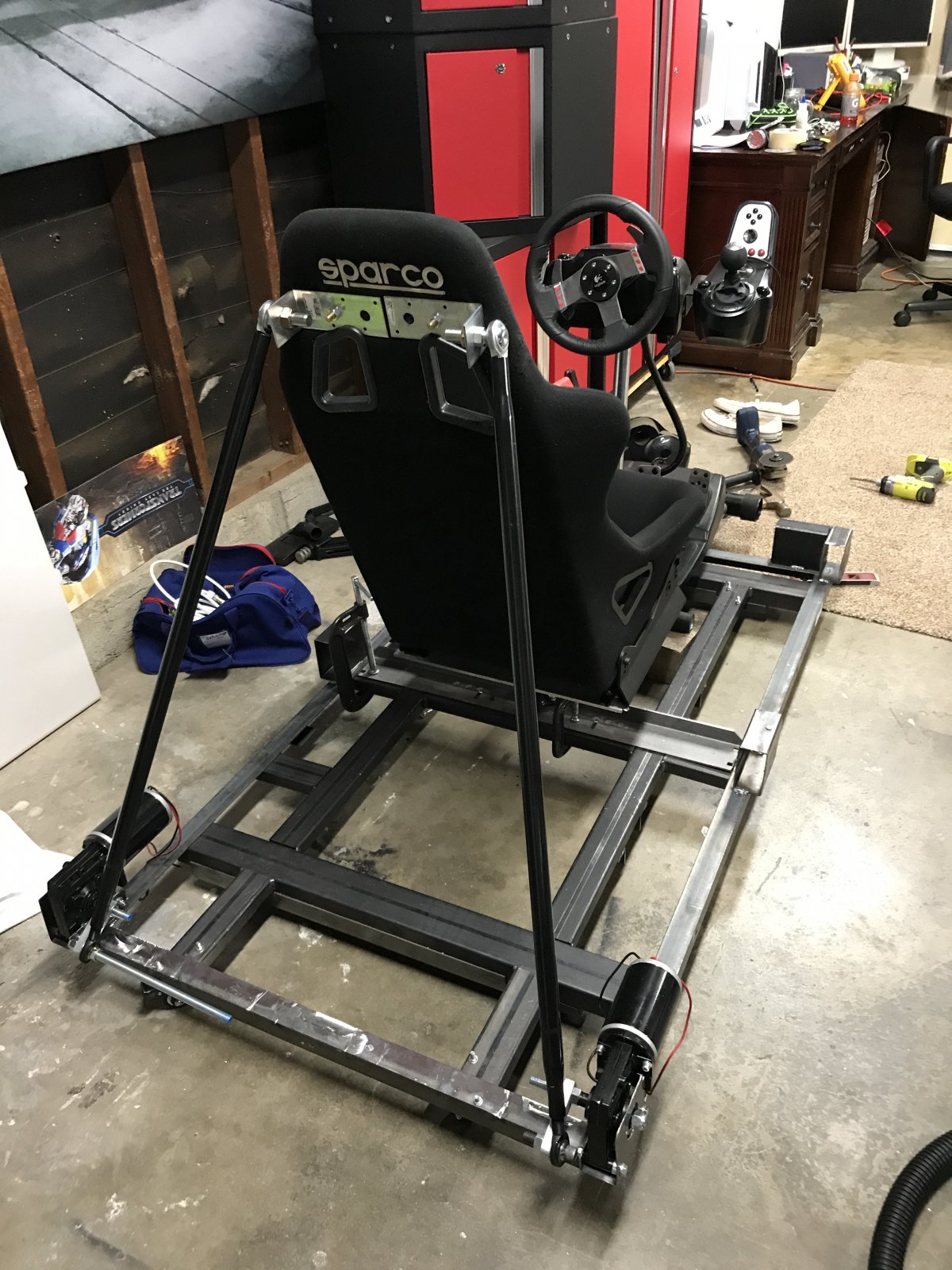

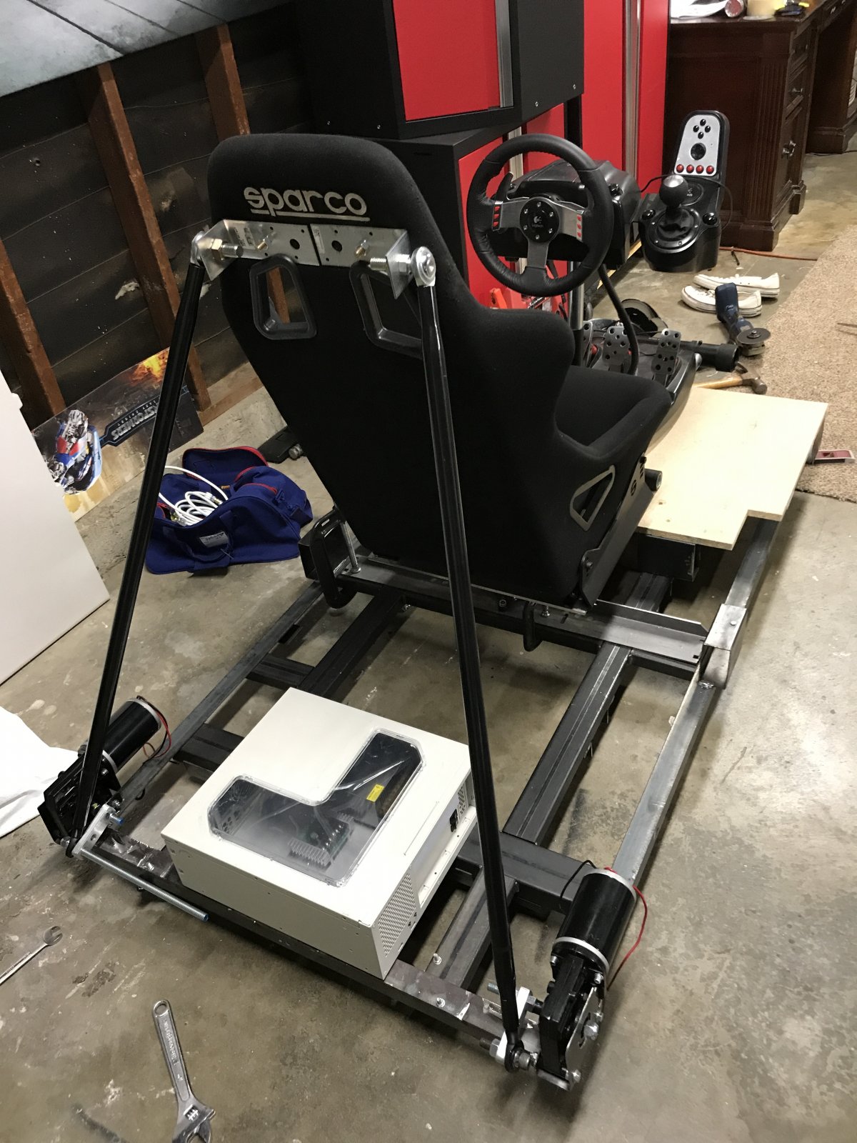

    I also got the Motors from PGsaw, 25:1, 12v, 180 watts, 30-40N.M, and I did a quick setup of things just to have an idea, here are some pictures. I still have to figure out the angles.

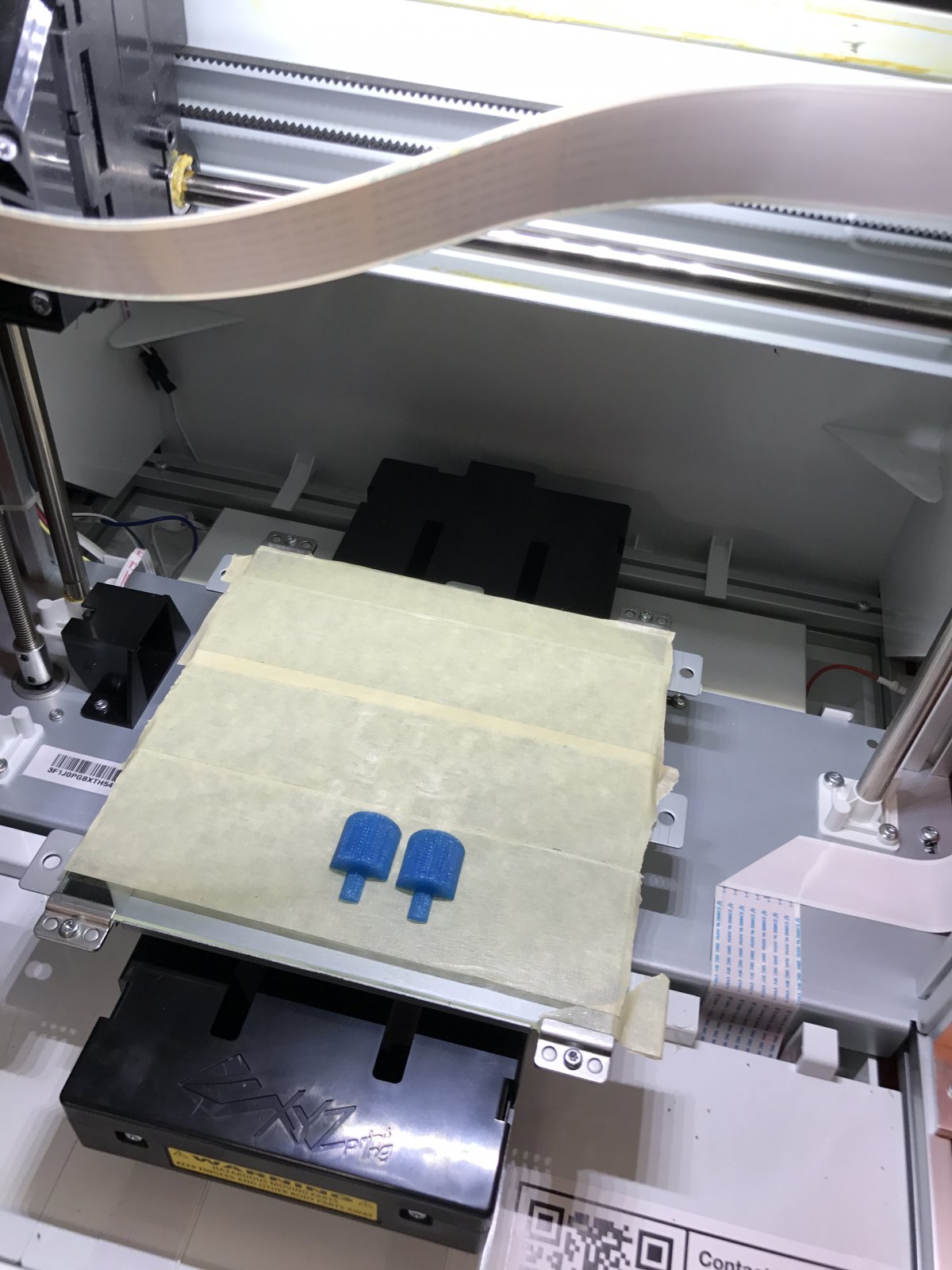

    I 3D printed the connection that goes from the 1/2"-13 motor rod to the hall sensor pot, got the file from one of the threads thanks to @Squonk
    I would like to start buying the electrical stuff, what would you recommend on wire size, I was gonna buy zip wire 10AWG, but the guy at my local electronic store told me that I need bigger wire to support the amps, but the motor only draws 15 amps if I'm correct, and the Saberthooth handles 32amps.
    I started reading about it and some guys are using batteries, relays, fuses, etc....
    Do I need any of that on my little 2DOF or that's more for guys that are using 2x60's with bigger motors? I'm planing on using one PSU 12v/50A/600watts for both motors, with one saberthooth 2x32 also for both motors, do I need any of that stuff??
    Thank you in advance.

    @Squonk Thank you for your message. No issues the only thing I noticed is, there is a little gap between top and bottom wen you put them together... But not an issue, I bet zip ties and theadlocker will keep them together.
    Thanks dude!

    Hmm. Do you mean there's a gap between the halves? I don't have that with mine. I wonder if its due to slight differences in e-steps between your machine and mine. If you find they don't hold up, let me know and I'll modify the .stl a bit.
  12. JohnCor
    JohnCor New Member
    Mar 7, 2017
    21
    Bio-med Technician
    California
    246Coins
    +11 / 0 / -0
    2DOF, DC motor, Arduino, JRK
    Yes there is a gap between the halves. It could be because of the differences in our 3D printers. But hey.... I'm happy to use them since you provided the solution to my problem lol

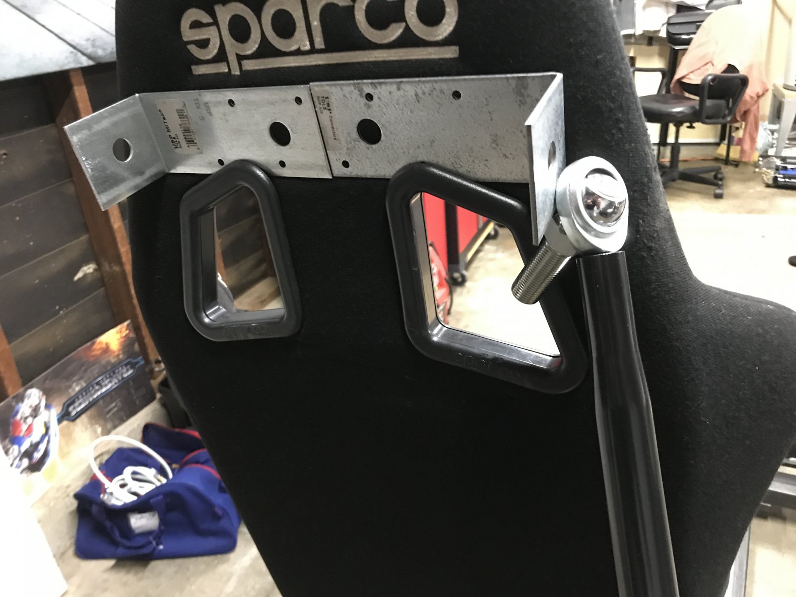

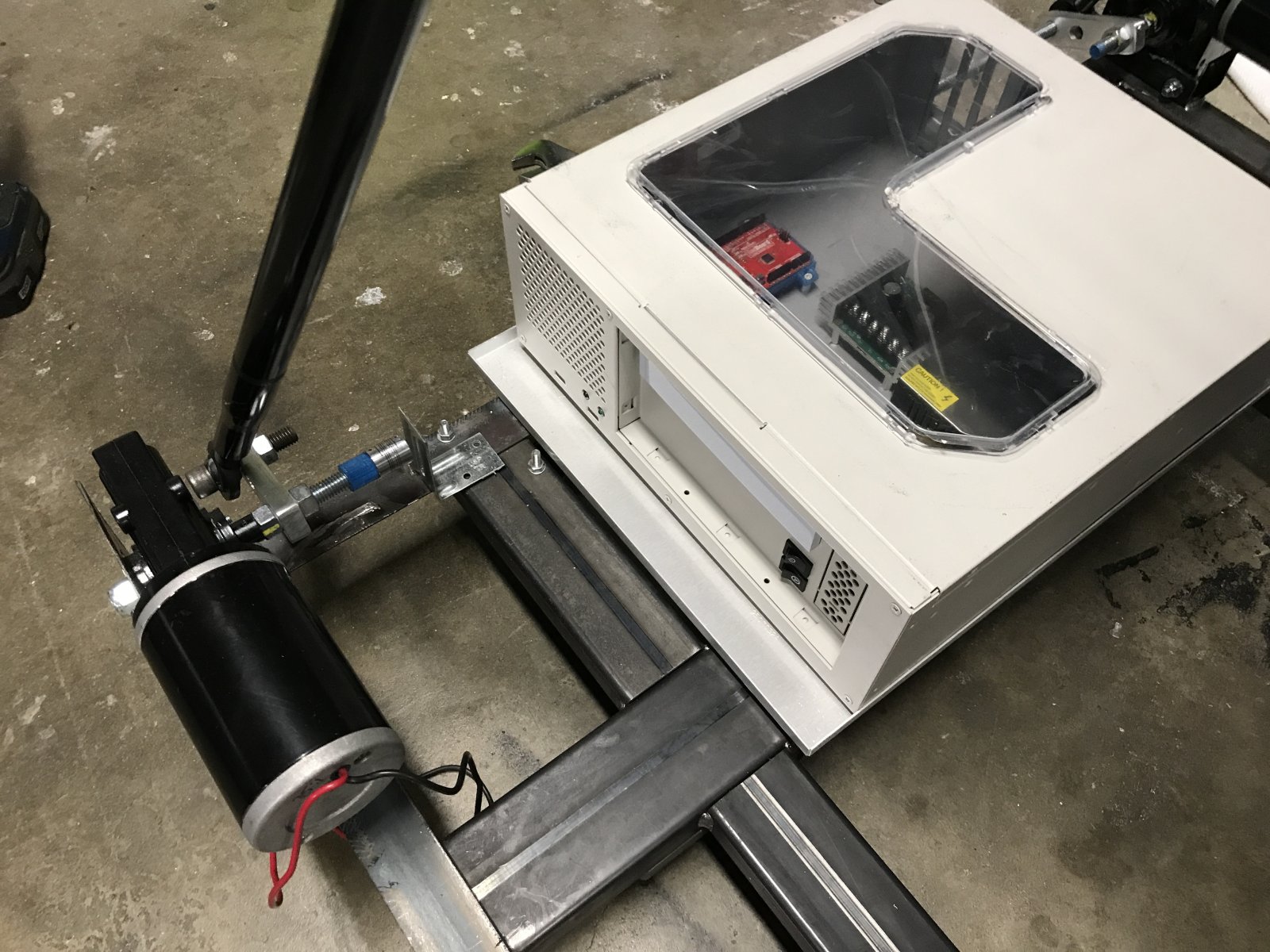

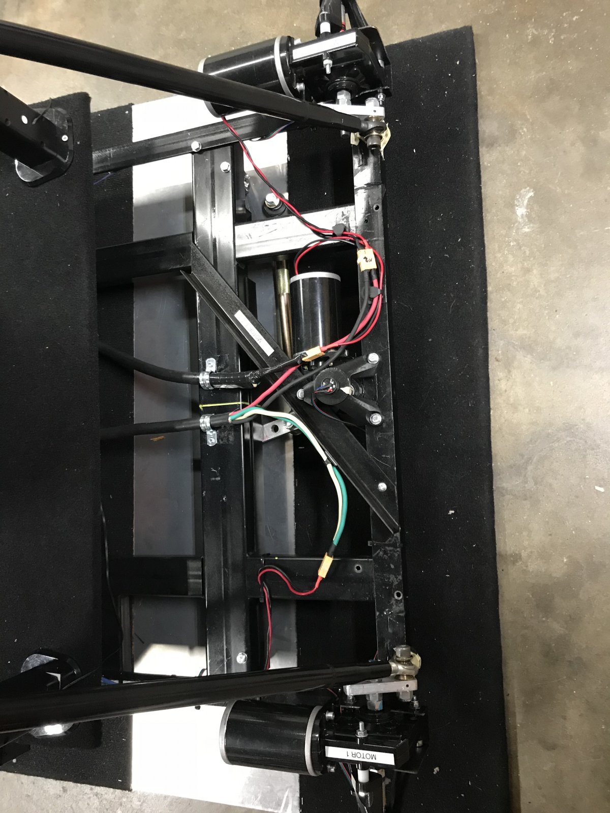

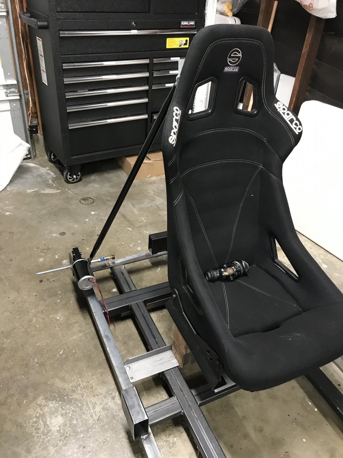

    Hello everyone, here is an update of my project. I still need to add more bolts to the seat brackets.
    Soon I'll be working on the electronics.

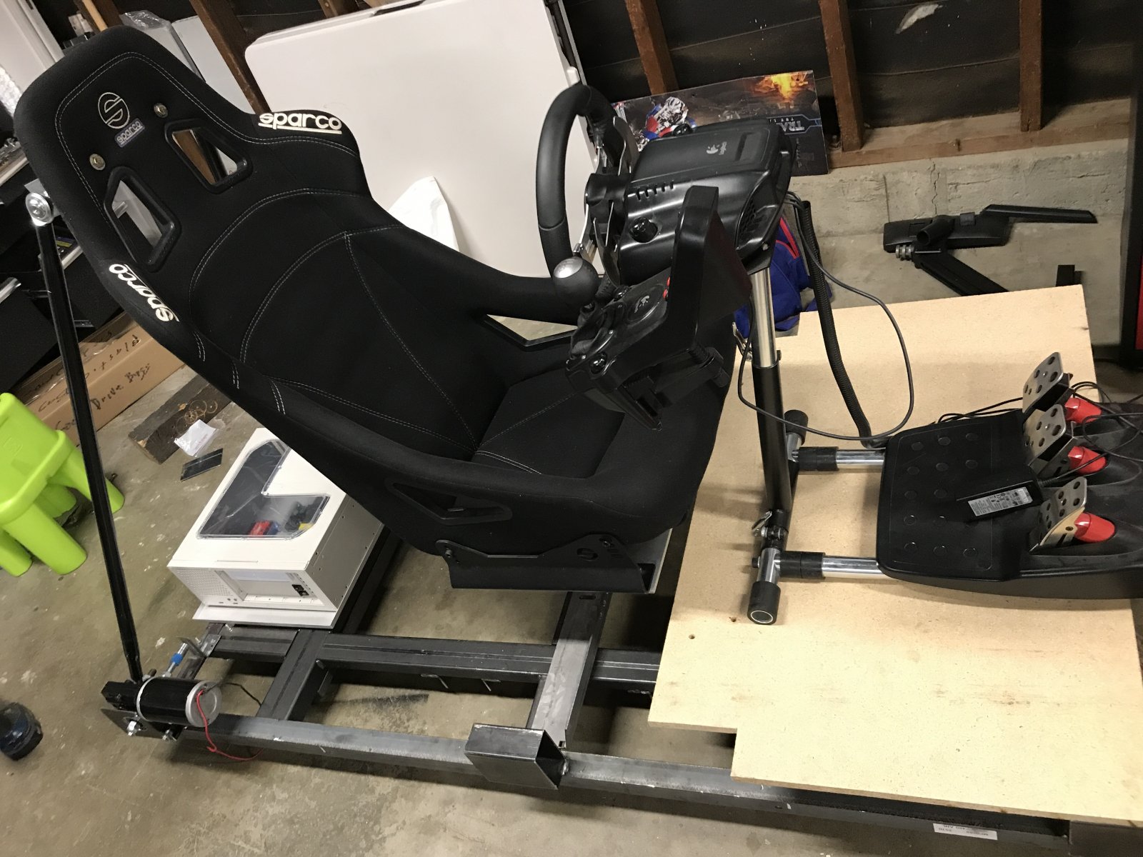

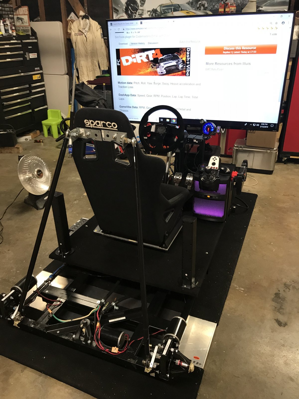

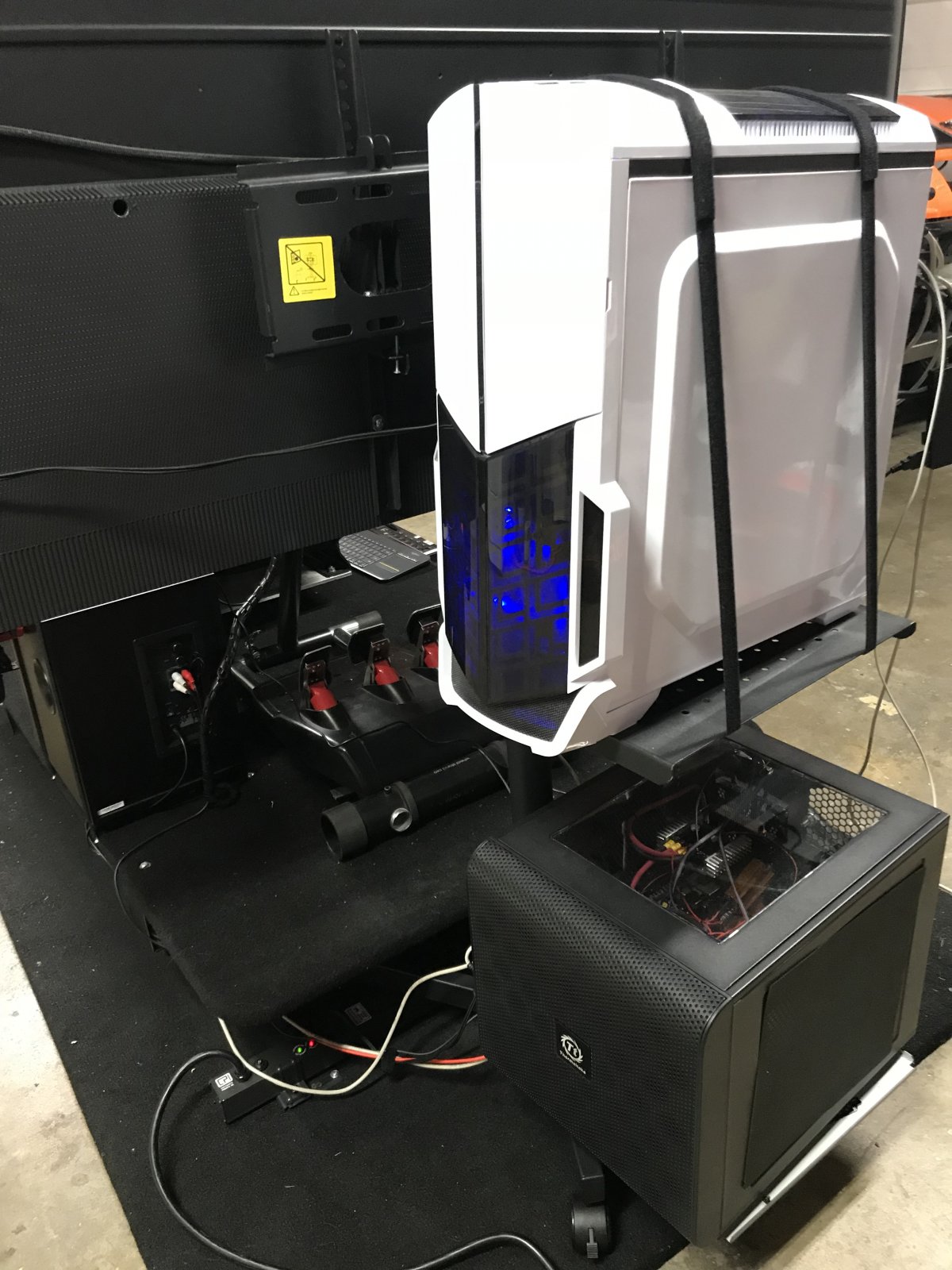

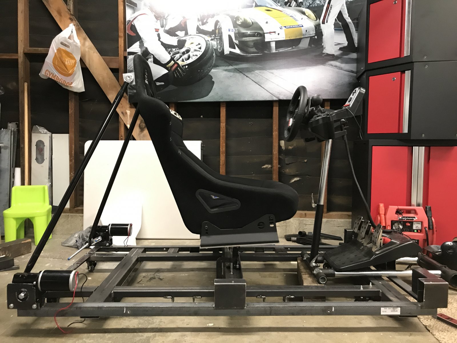

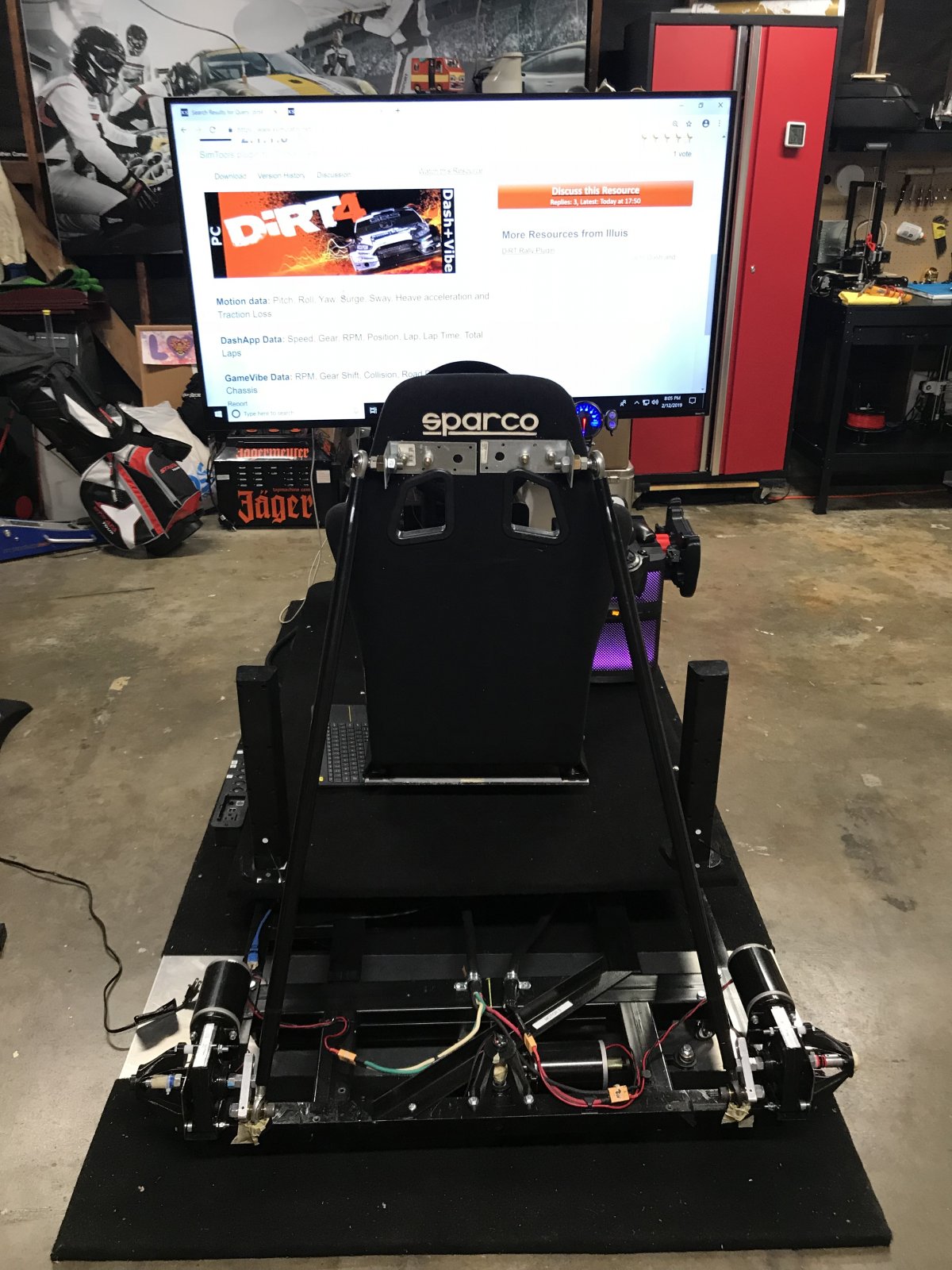

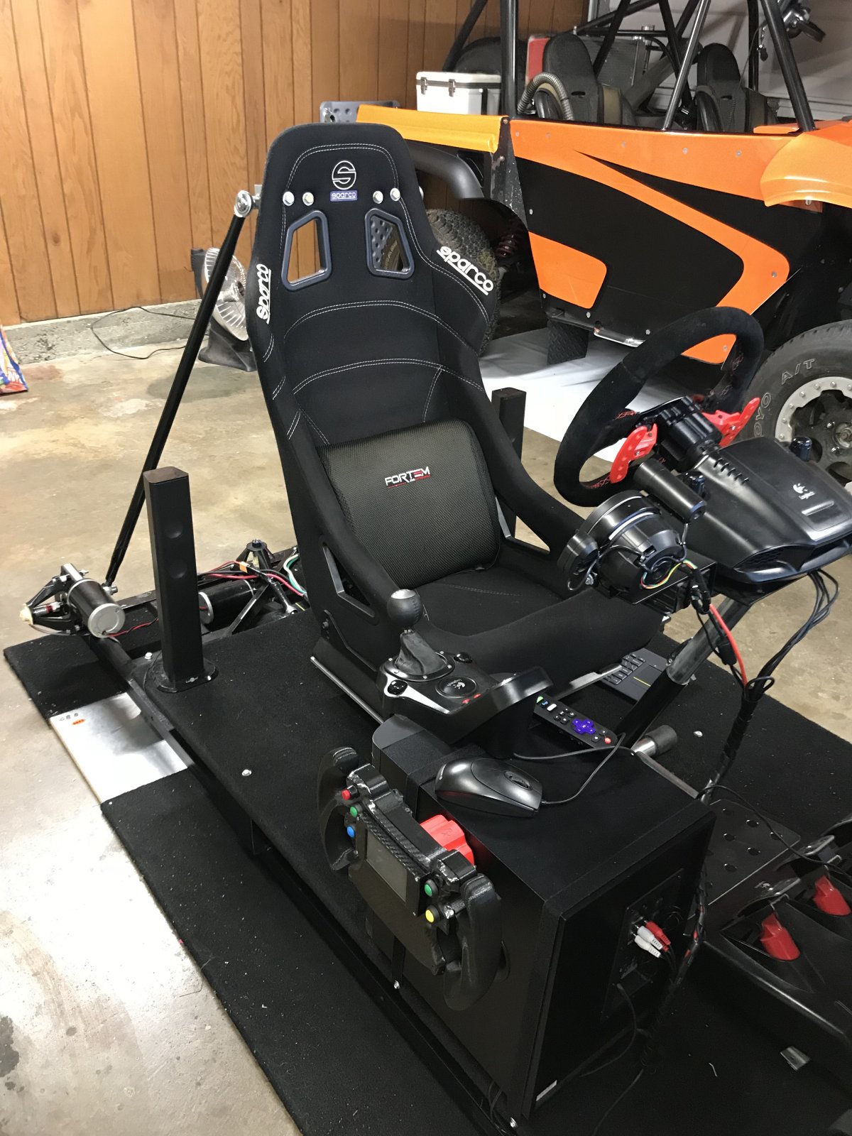

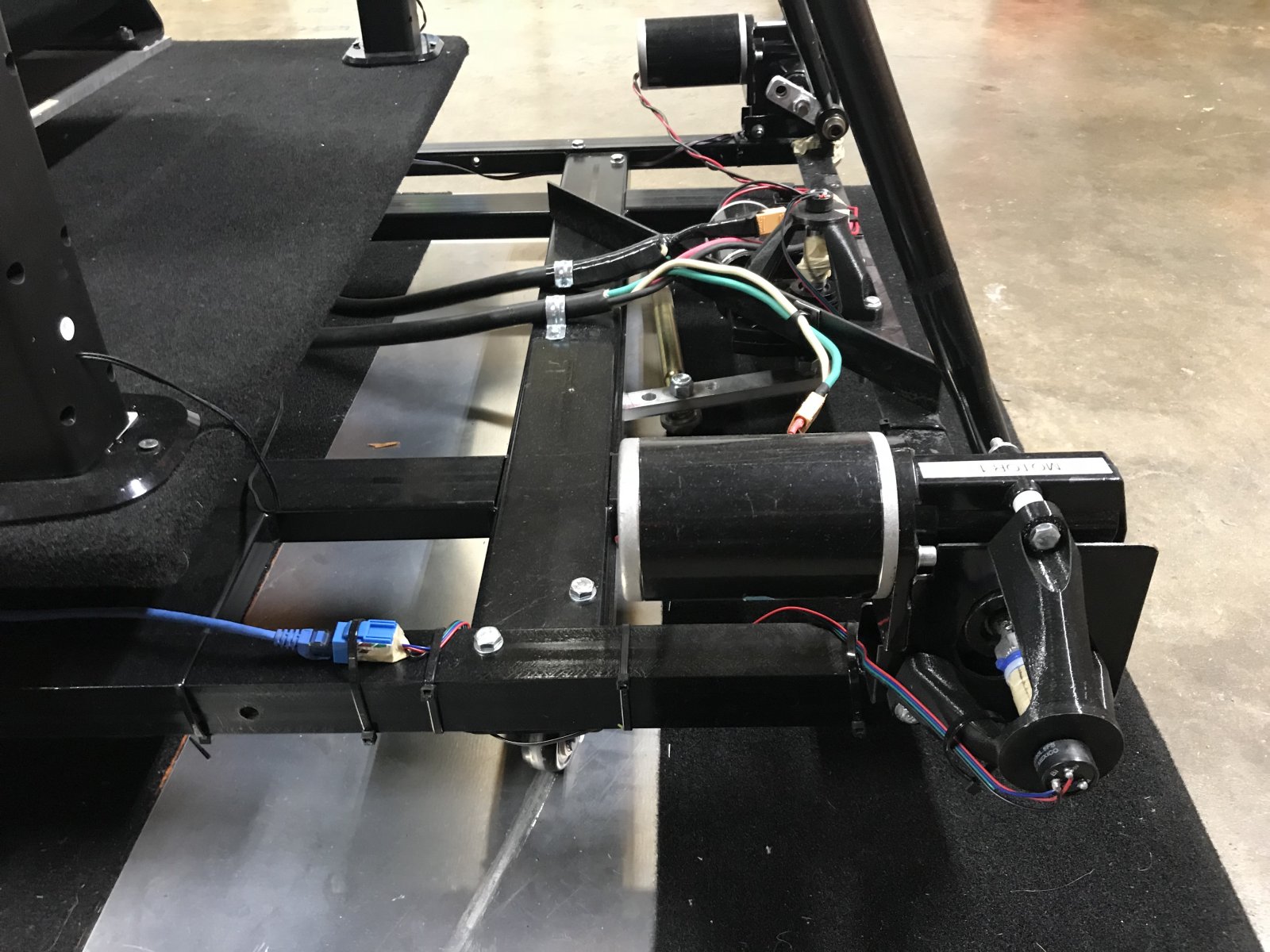

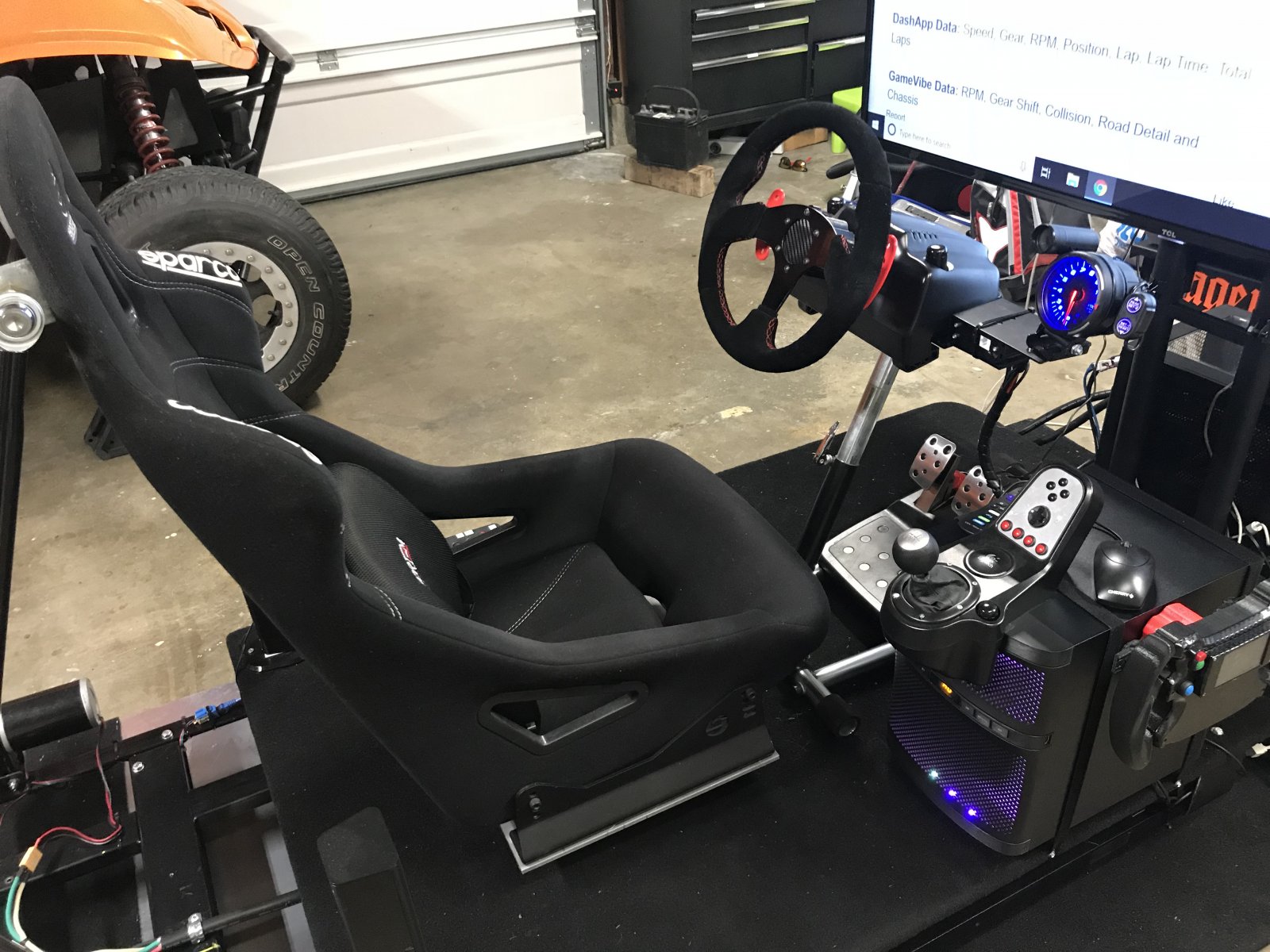

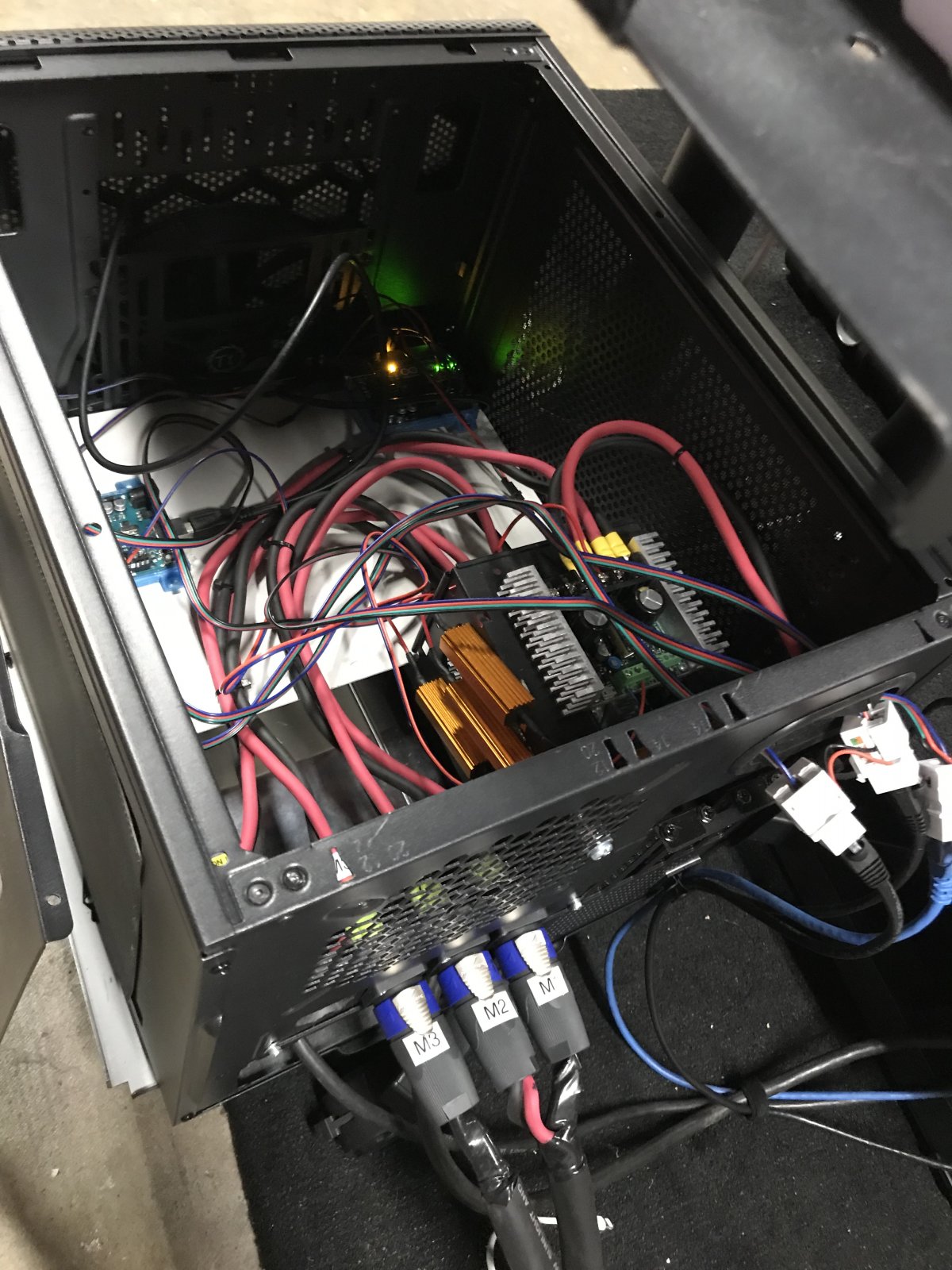

    Hello Guys,
    I know it has been a while since I stop here, work and family is always a priority :).
    Here is a little info about my build.

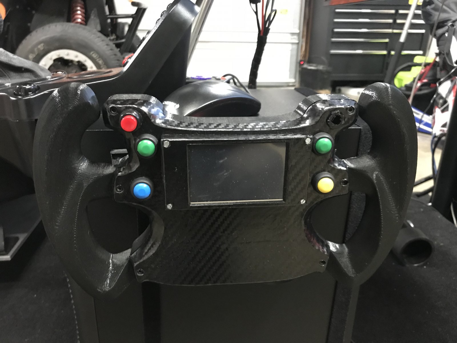

    I was able to finally finish my project a few months ago. I went from a 2DOF to a 3DOF with traction loss.
    I really like my Simulator and I'm enjoying it every time I have a chance to get on it.
    I bought a 3D printer at the end of the build to be able to print an F1 wheel, wheel release hardware, pot holders, paddle shifters etc
    I just want to thank you all, I red a lot on the forums to be able to get it done, specially the fox that share the 3D printing files also @noorbeast, and really every person here, this is a great community!
    I will post a video in a near future.
    Thank you again guys! IMG_7121.JPG IMG_7119.JPG IMG_7124.JPG IMG_7123.JPG IMG_7125.JPG IMG_7126.JPG IMG_7122.JPG IMG_7121.JPG IMG_7119.JPG IMG_7124.JPG IMG_7123.JPG IMG_7125.JPG IMG_7126.JPG IMG_7122.JPG
