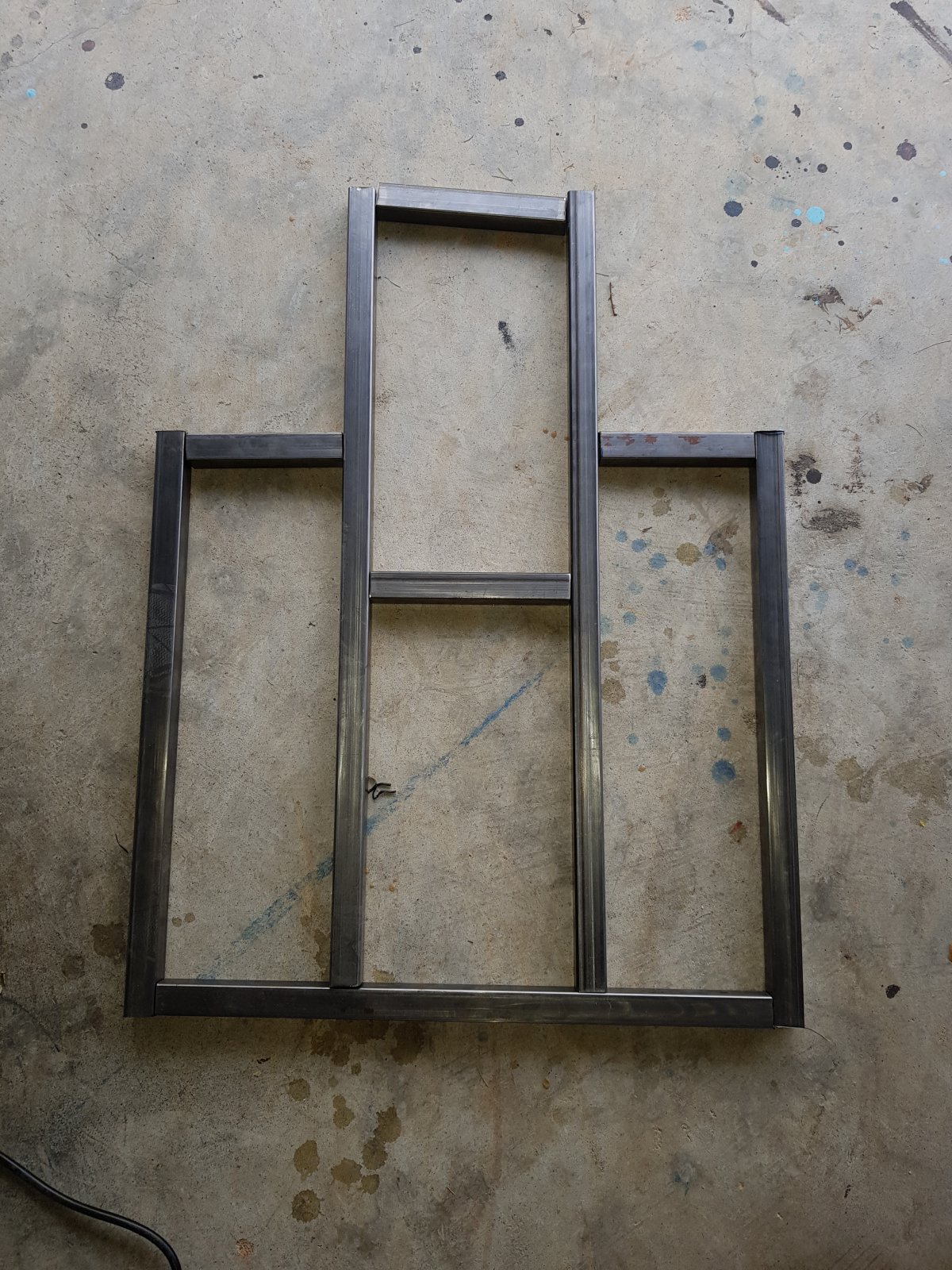

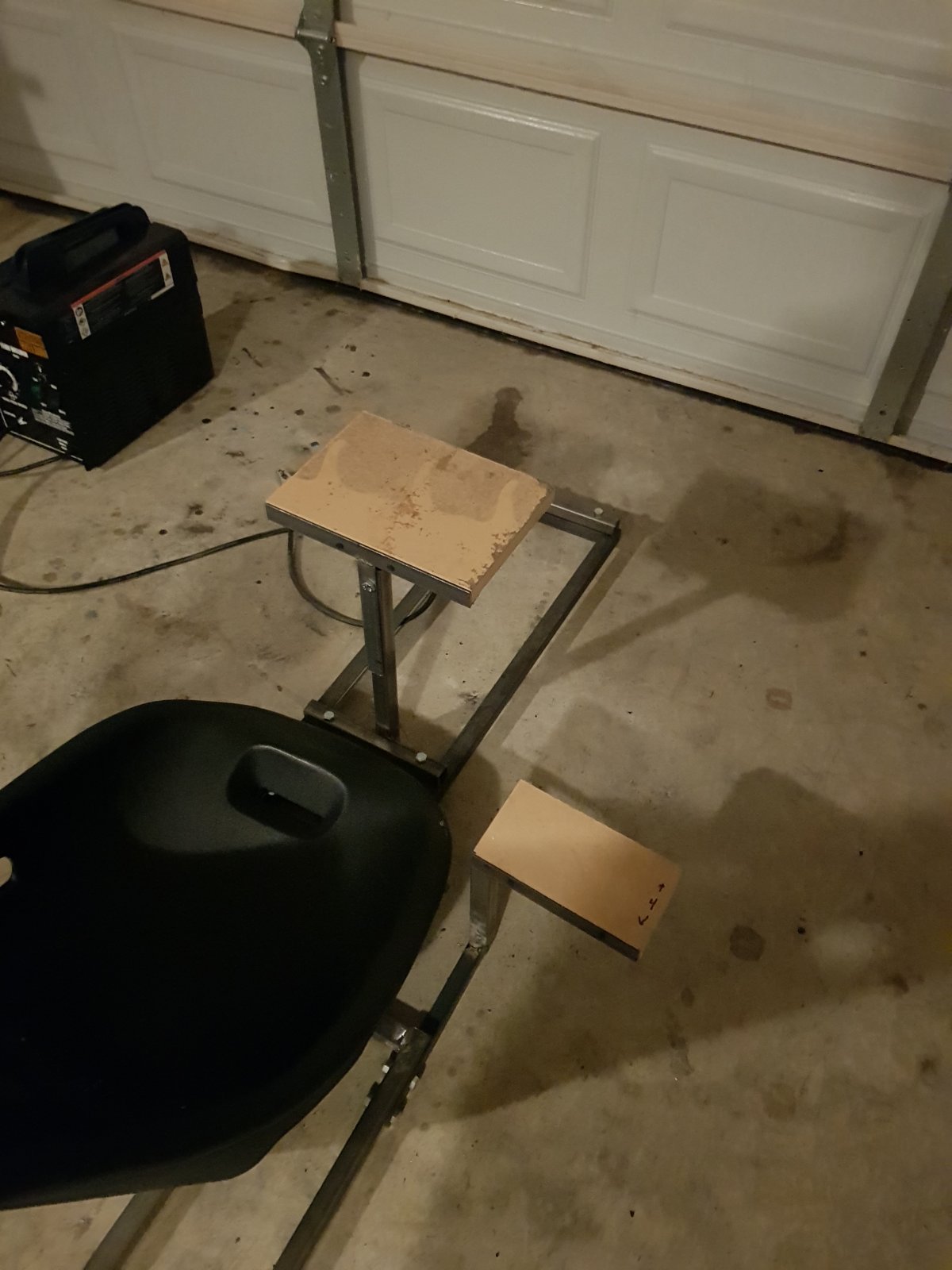

    So here's the first post of the build. I bought some 1" square metal tubing for the frame. I've cut the pieces for the part of the frame where the bucket seat will mount and will be welding them shortly. The seat and pedal setup will all be attached to a single plane of the frame(go kart style) unless I decide to raise the seat up a few inches. I extended the sides of it out far enough to more conveniently mount the harness.
    Metal was from home depot ~&17 per 6 ft section
    Additional metal was from Amazon ~$14 per 4 ft section after buying all of home depot's supply
    I cut the metal with an angle grinder then used a grinding wheel to take off sharp corners and clean up the areas that will be welded together.
    Hopefully I'll get this welded and drill the seat mounting holes out within the next few days for my next post.

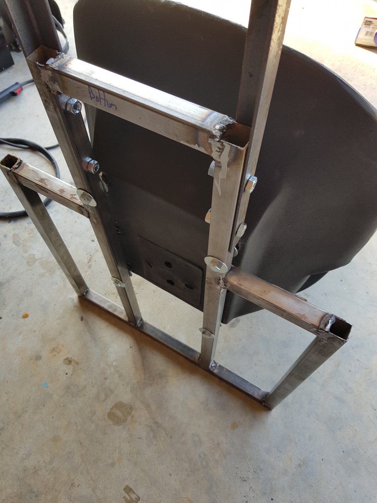

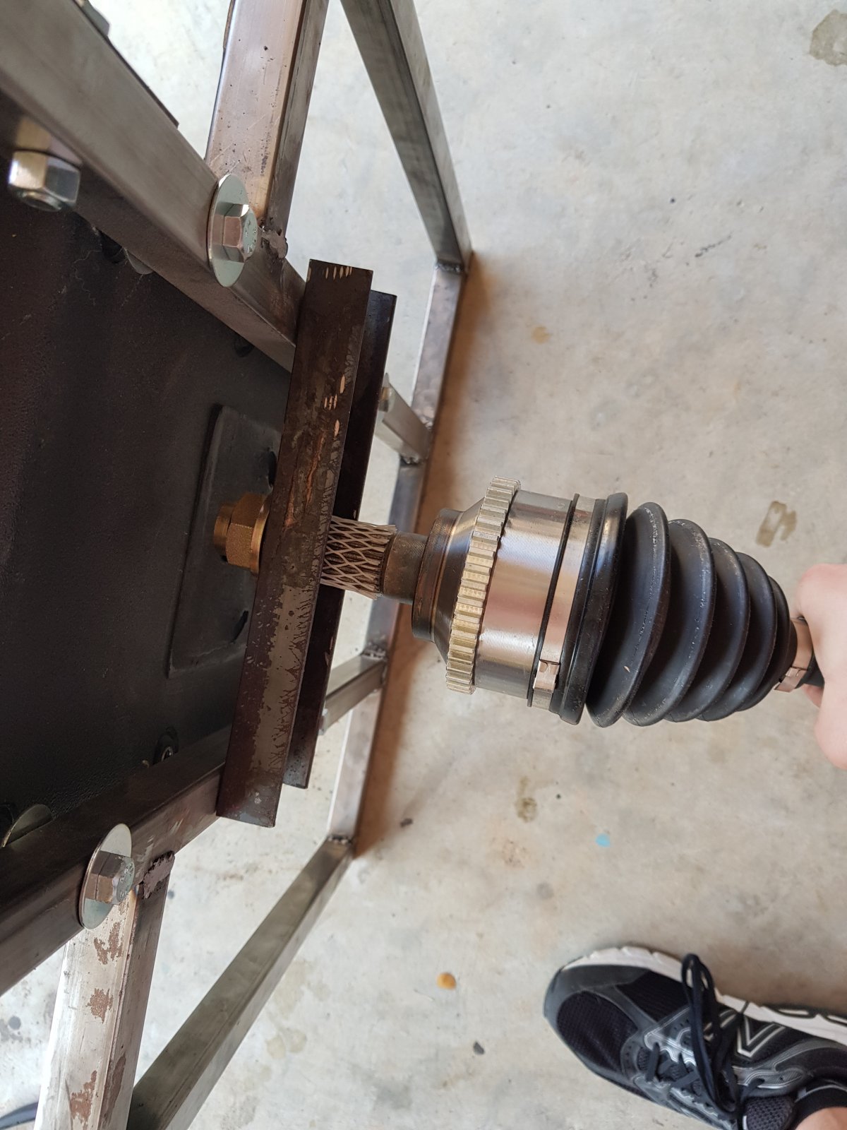

  2. Dane Anthony
    Dane Anthony New Member
    Jan 11, 2019
    22
    Botanist
    Little Rock, Arkansas
    198Coins
    +19 / 0 / -0

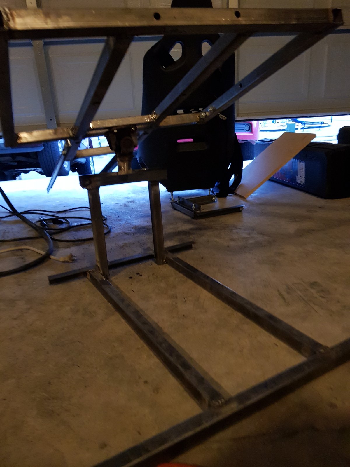

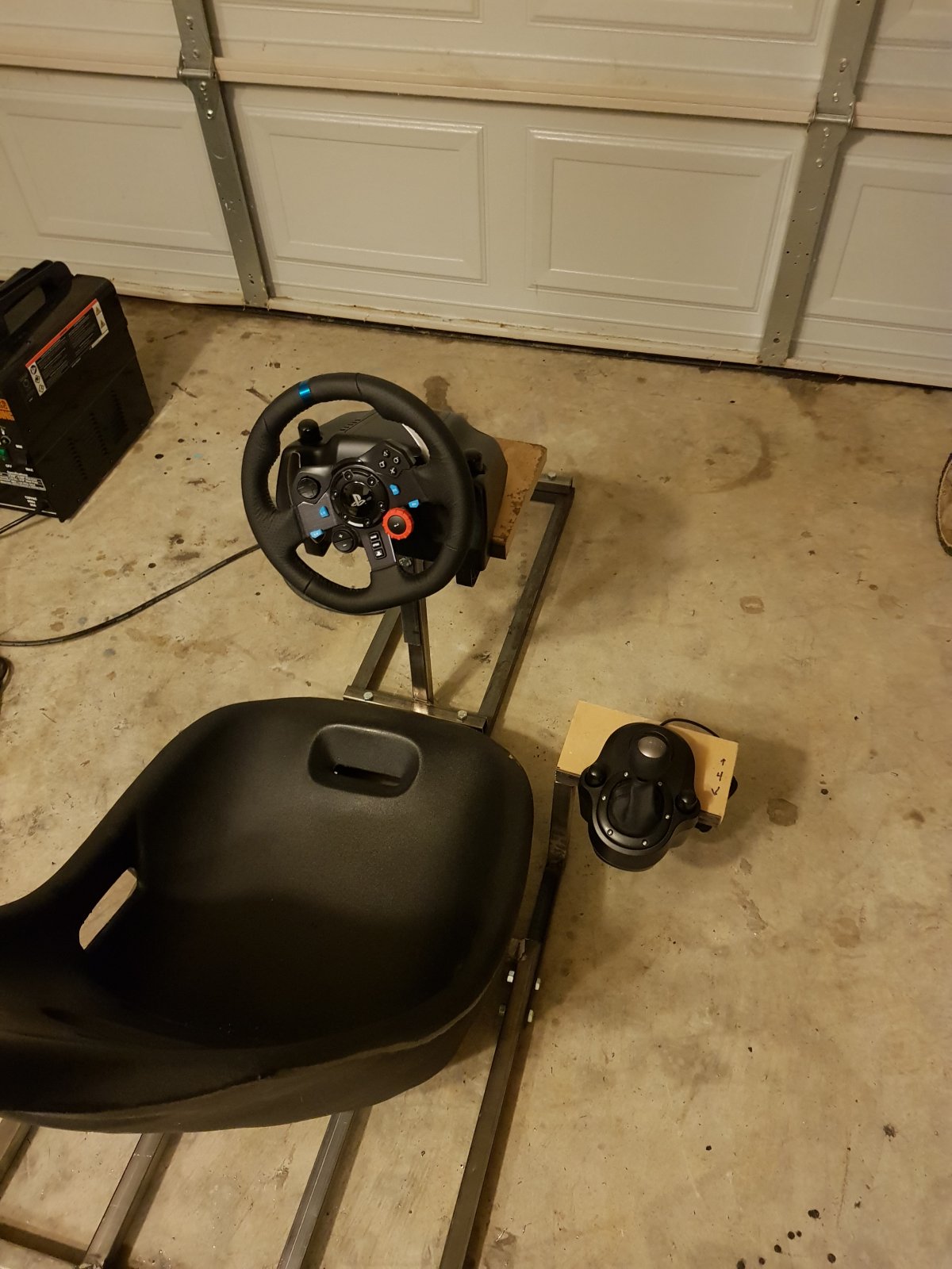

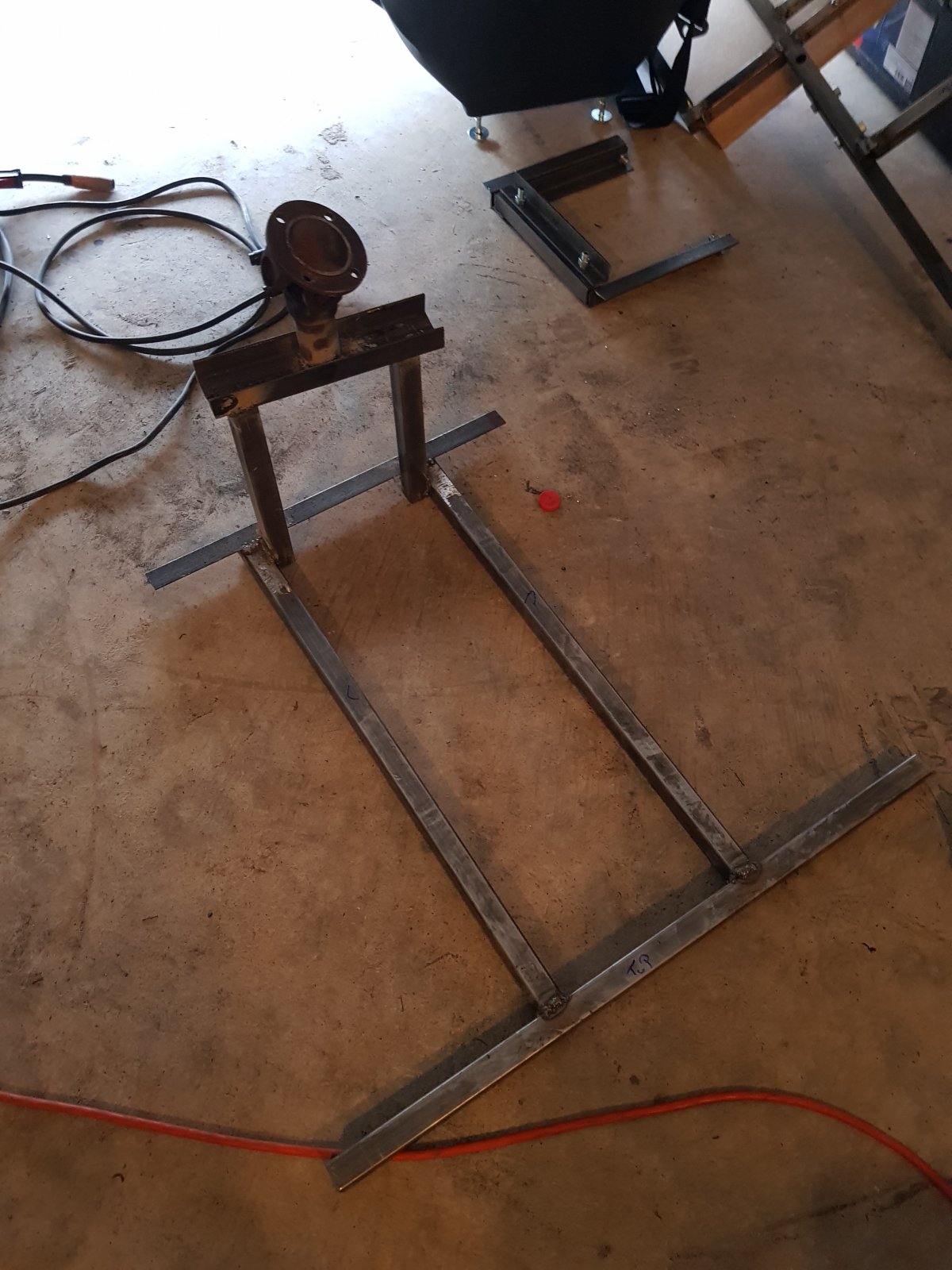

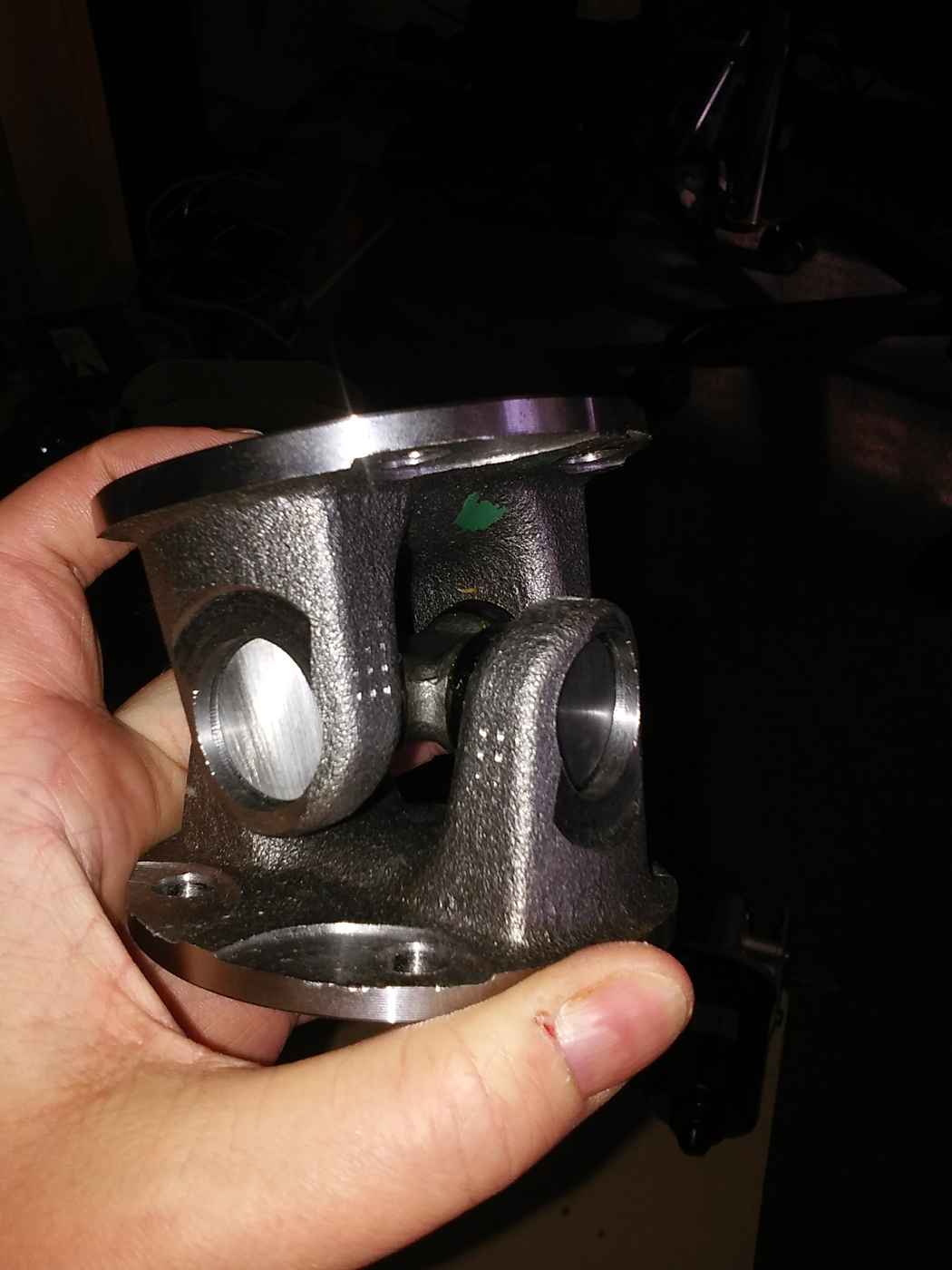

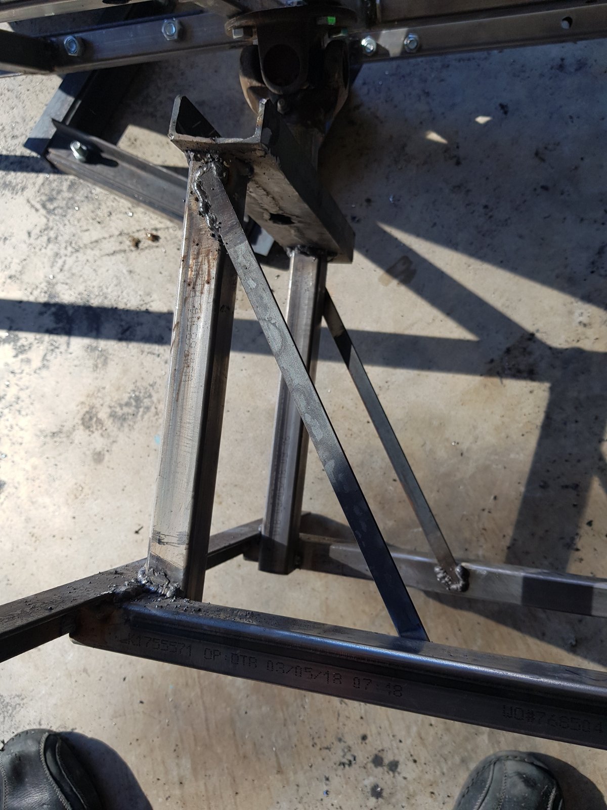

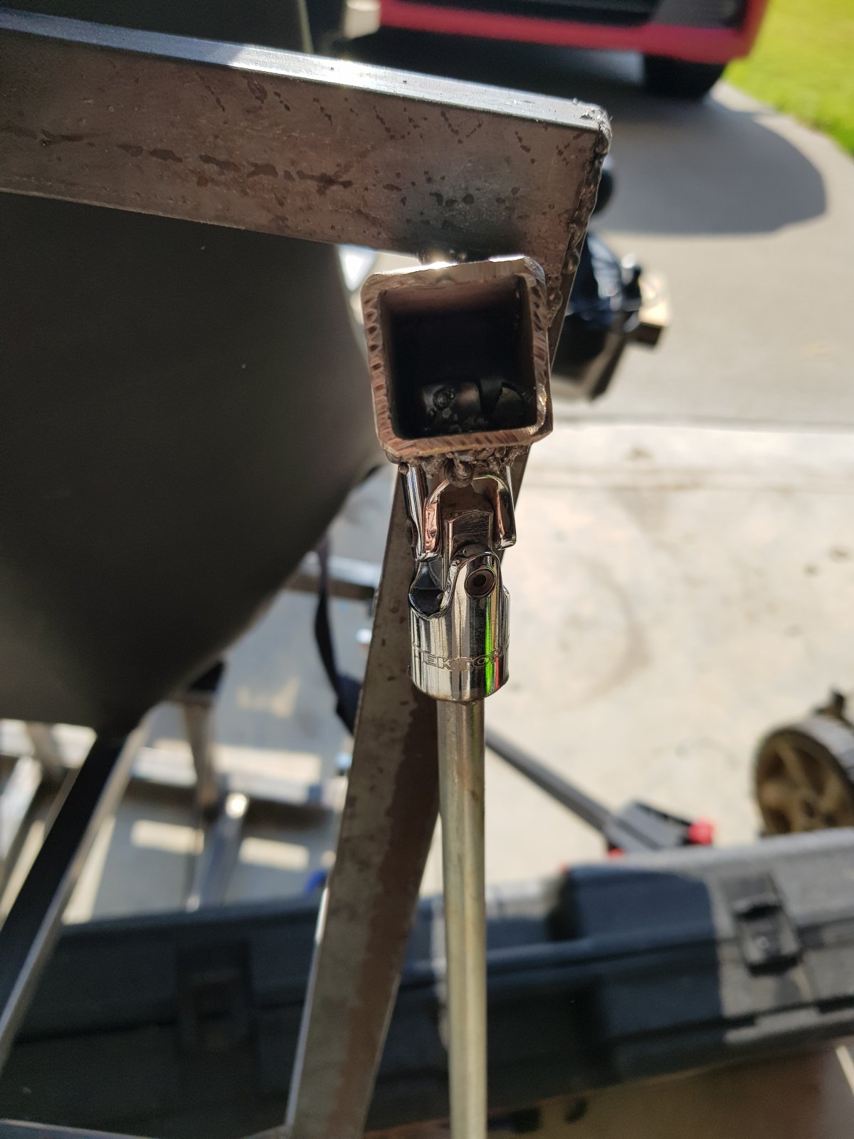

    The seat bracket is welded and drilled out. I've also bolted angle iron to the front for mounting the steering wheel and pedals. For the main joint I'm using part of a CV assembly from what I believe is for an ATV side-by-side. I made a small metal bracket and drilled out a hole for the CV. This bracket will be bolted on after I find the center of mass. The idea is to be able to disassemble the rig enough to easily fit it in a vehicle for transport.
    Note: This is the first thing I've ever welded, so I'm aware of how ugly these some of these welds look. My brother had to fix some of them... 20190203_123134.jpg 20190203_124837.jpg

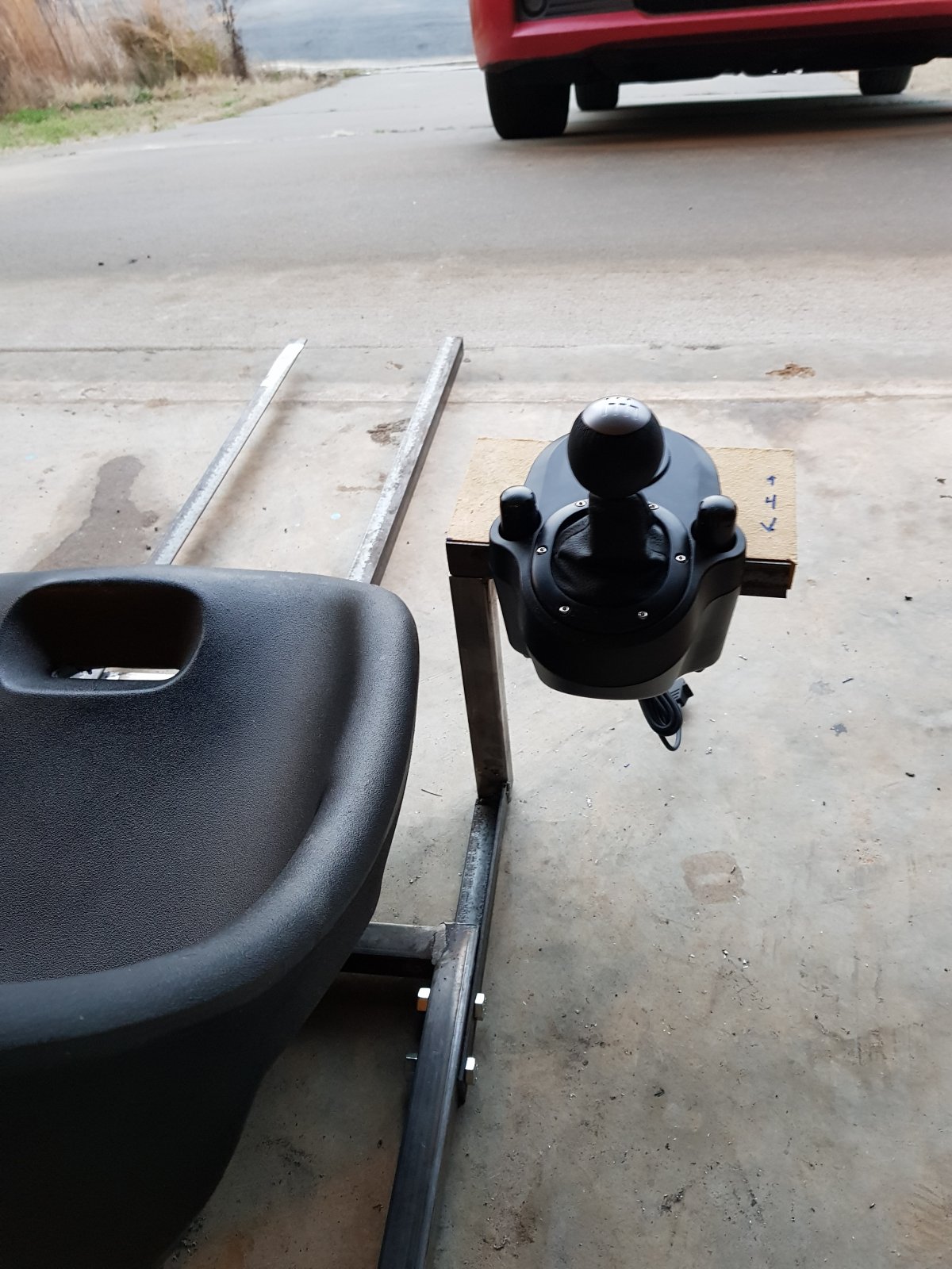

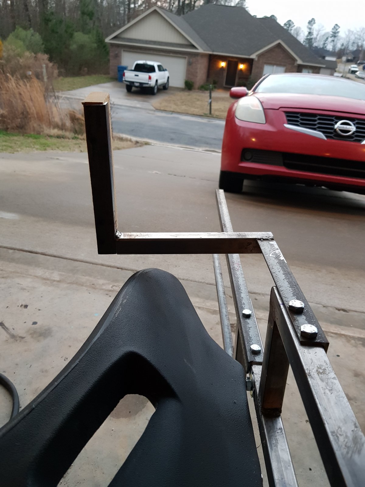

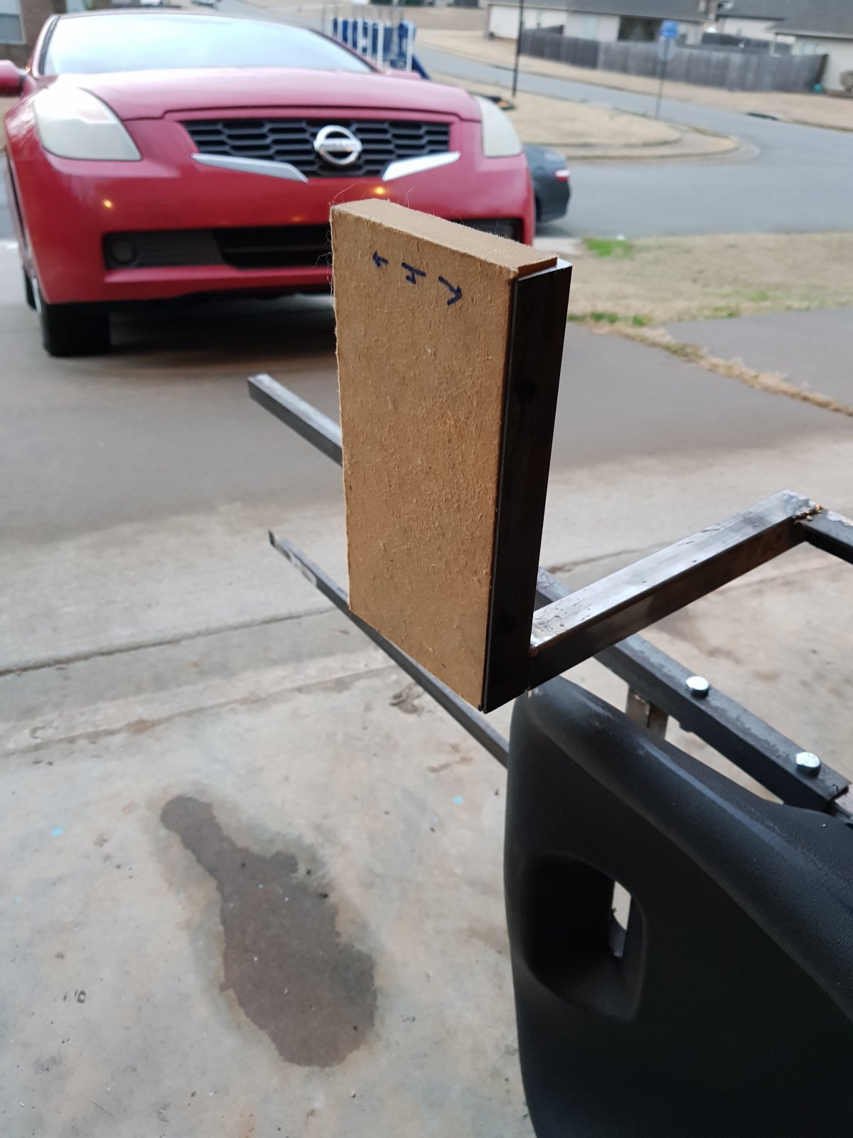

  3. Dane Anthony
    Jan 11, 2019
    22
    Botanist
    198Coins
    +19 / 0 / -0

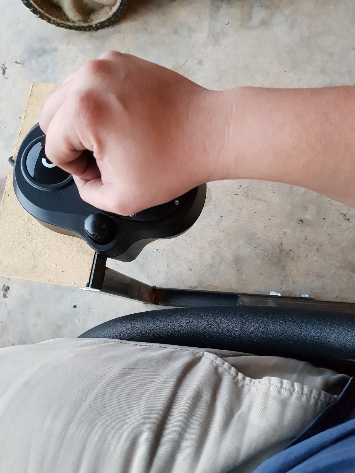

    Also I've created a small bracket for the shifter on the side. It is also bolted on. I used angle iron and square metal tubing for the main frame and particle board as a platform for the shifter to sit. 20190206_174733.jpg 20190206_174743.jpg 20190206_174824.jpg 20190206_174907.jpg
  4. Ijanen
    Ijanen Living Room Mechanic
    Feb 9, 2018
    41
    precision mechanic, media designer
    Germany, NRW, Halver
    408Coins
    +28 / 0 / -0

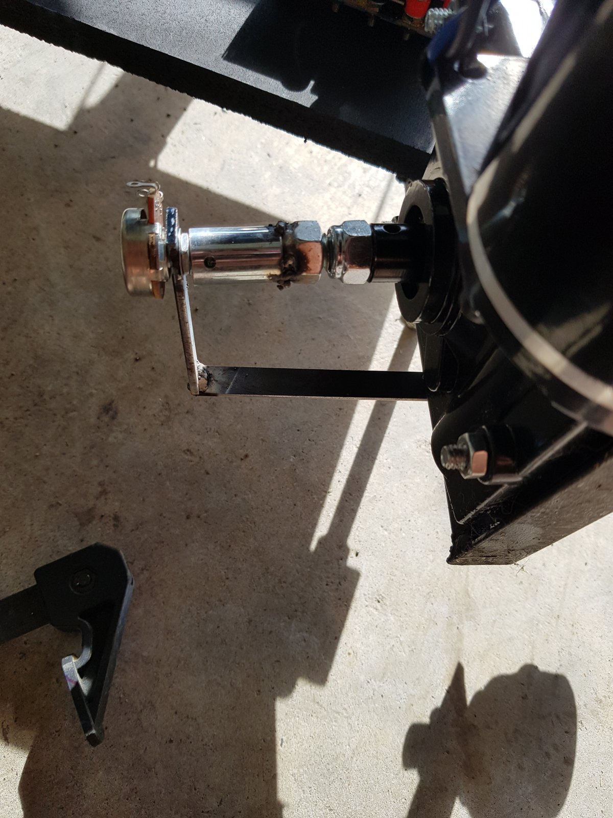

    What kind of universal joint do you have? In the picture, it looks like
    it's a drive shaft from a front-wheel drive car. These are not suitable
    because they can twist. If so, it's better to get something like that.
  5. Dane Anthony
    Jan 11, 2019
    22
    Botanist
    198Coins
    +19 / 0 / -0
    Hi Ijanen,
    I was unaware of this, so thank you for the heads up! It is an outer CV joint from an ATV side-by-side. However, I do have a u-joint like the one in your picture as a backup, so looks like I will be using it instead. Thanks again for the insight!

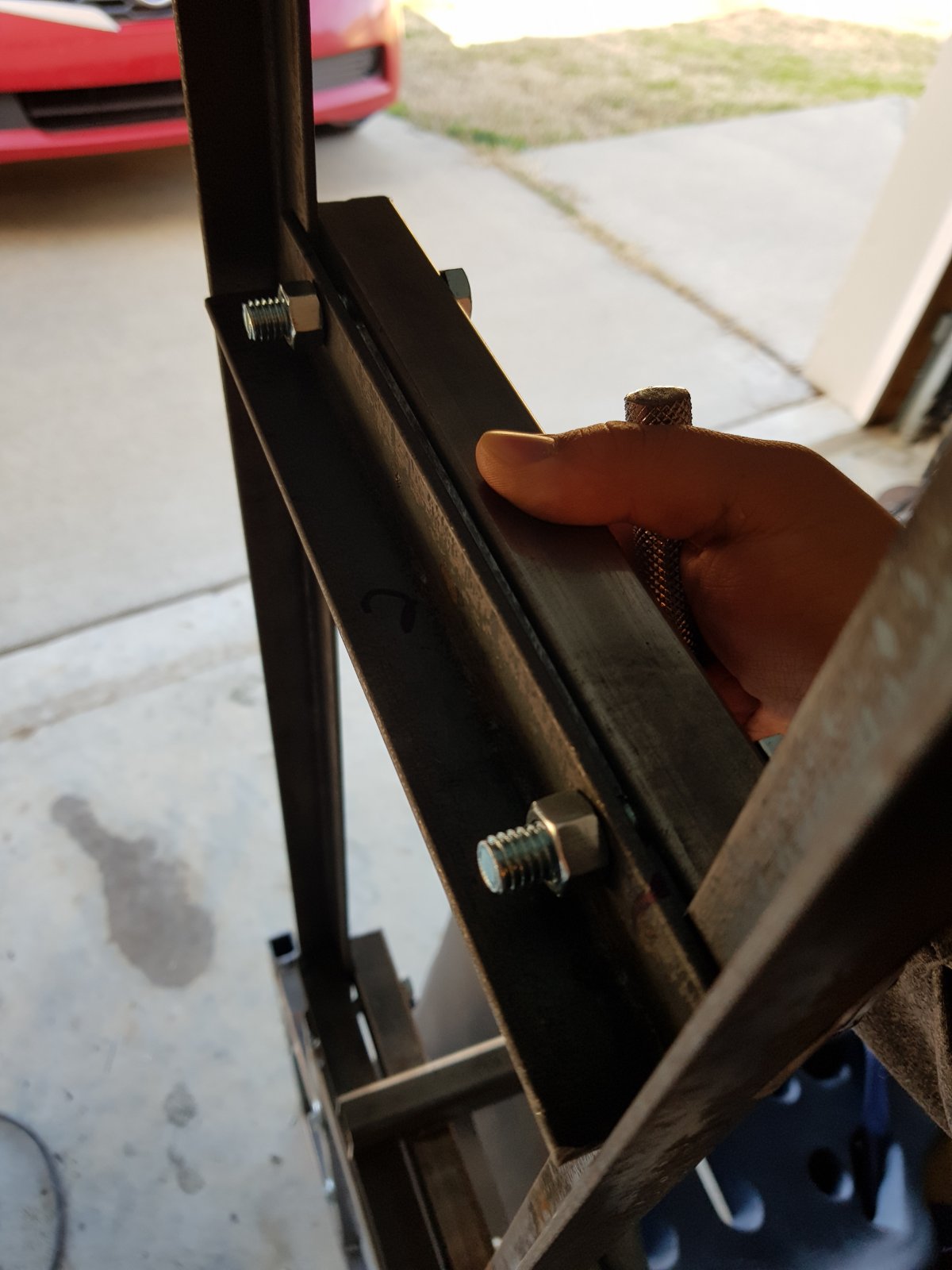

  6. Dane Anthony
    Jan 11, 2019
    22
    Botanist
    198Coins
    +19 / 0 / -0

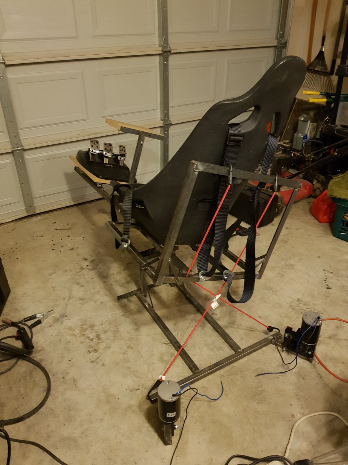

    I just finished making the steering wheel mount. I used a piece of angle iron and some square tubing to make a clamp that will tighten on the frame (in picture). I welded another piece of tubing on this that supports the platform of the steering wheel. This setup lets me adjust the position of the steering wheel up, down, forward, and backwards to dial in a little bit of comfort. I believe this design will be sturdy enough as is, but I can't predict what will happen once the rig is moving.
    I guess I should also mention that I'm using a Logitech G29 steering wheel and shifter. It was the setup with the best reviews in my price range.
    I am currently building a platform for the pedals. I'm going to take them out of the stock enclosure and flip them upside down. I've also began putting together the base of the rig where the motors and electronics will be housed. I'll post pictures once it is finished.

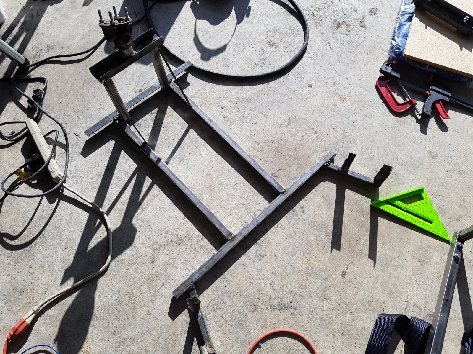

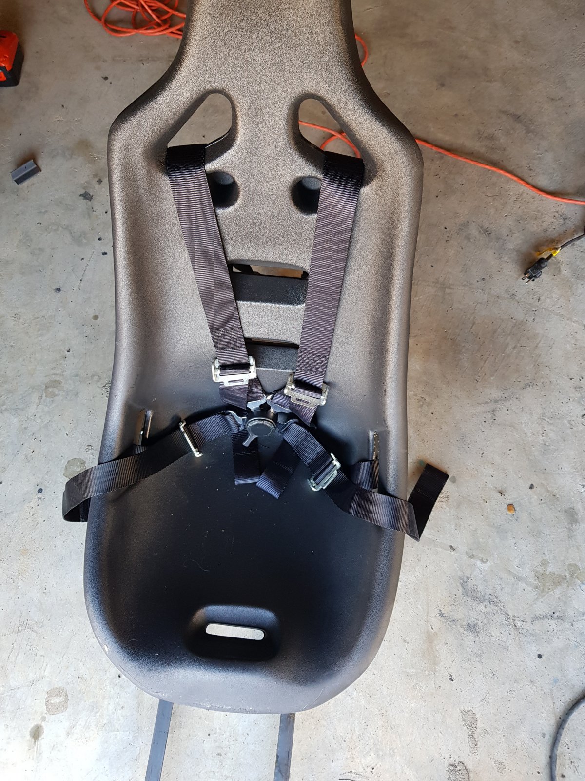

    Alright, it's been a bit since I've posted, but here is the update. I've attached a harness for the seat and began working on the base of the sim. 20190209_104419.jpg

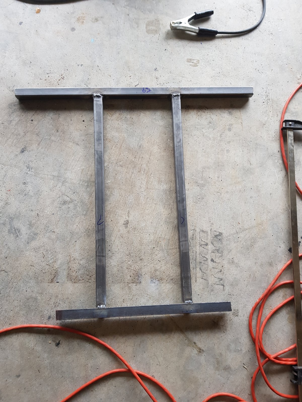

    Here is the evolution of the base. I'll have to add on some extra length to the front and sides to ensure it's stable enough under operations. I've also switched the CV style joint out for a standard U-joint as the CV joint gave unwanted rotational movement. Everything was pretty much made of 1" square tubing with some additional thick metal strips to reinforce the column that will be holding the seat. 20190216_141955.jpg 20190226_171207.jpg 20190309_153232.jpg

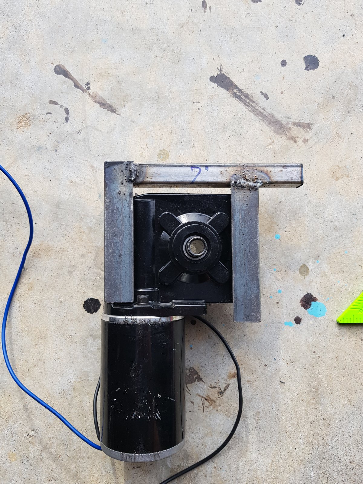

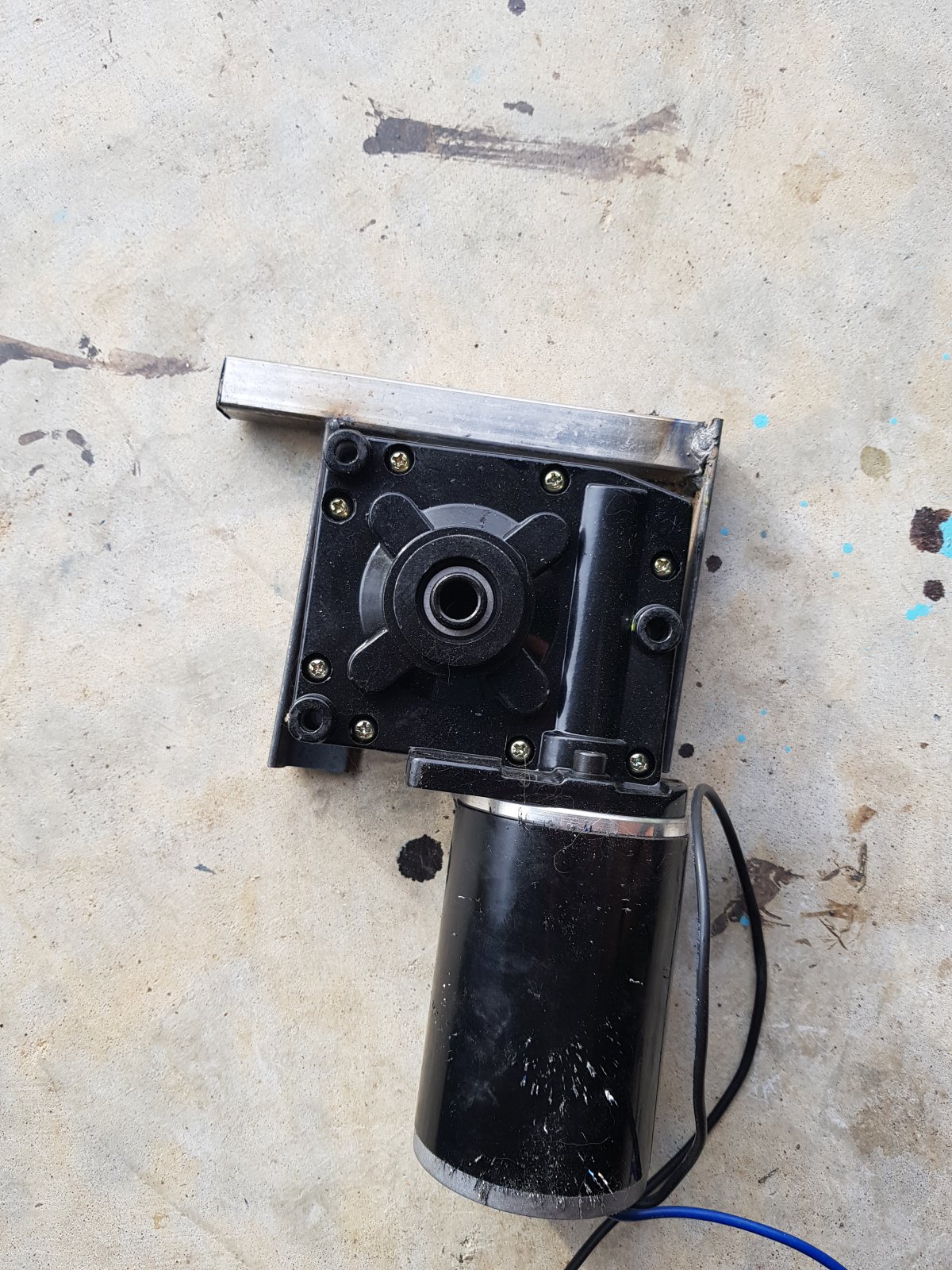

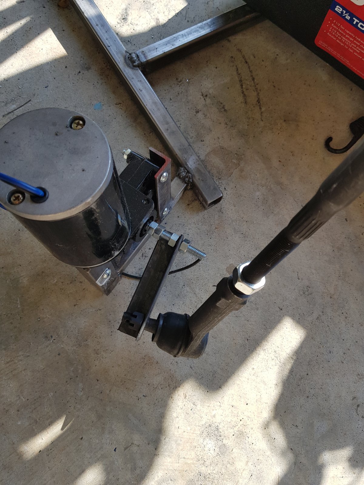

    I decided to try and make mounts for the motors out of square tubing and angle iron. I think it will work fine so long as I can attach them to the base well enough. 20190311_173005.jpg 20190311_172954.jpg

    I've attached the motor mounting brackets to the base of the frame at the angle calculated from SimCalc. Next step will be attaching the motors and connecting them to the back of the seat. I'll have to go pick up some materials to get to that part, but once that is done, it'll be ready for electronics! Hopefully I can start testing out simtools early this summer.

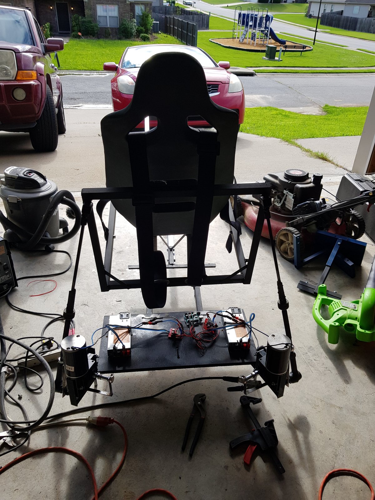

    Getting nearer to the end. I've finished pretty much all of the frame/mechanical portions with the exception of fine tuning connections from the motors to the back of the seat.
    Here is what it looks like without the motor rods attached. I still need to add a couple more tubes on the base for support when the rig is motion (want to tip forward at the moment), but that should be fairly simple. I also plan on using threaded rod and hex nuts to lift this up off the ground by 6-10 inches with adjustable "feet". I cut the threaded rods last week and just have to drill out holes, so I'll update that once it's done.

    Here is the design for attaching the motors to the back of the seat. I cut some square tubing and attached them at an angle to the back of the seat frame. Then I drilled 1/2" holes and welded in a ratchet knuckle. This gave more than enough range of motion and appears very sturdy. The rods I used are tie rods from a front wheel drive van that I've welded to steel rods to lengthen them out. These will be attached to some cut pieces of angle iron that move with the motors and also welded to the knuckles at the opposite end. This design has worked when moving them by hand, but we will see how it fairs in testing under real conditions ie. using motors which are much faster and stronger than my hands... fingers crossed!

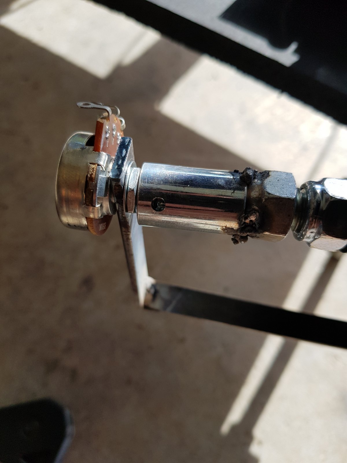

    2. fabricate a potentiometer mount that connects to back of motor (already have design and materials, just have to sit down and build it)

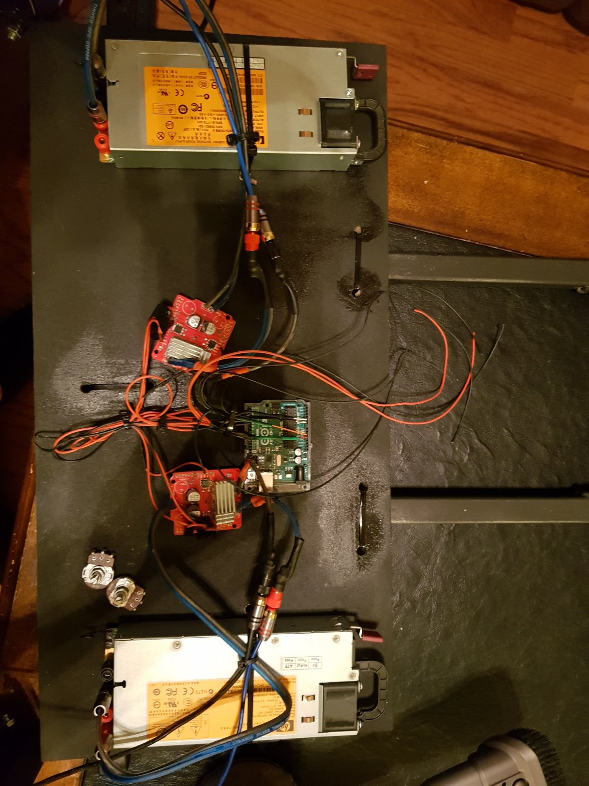

    Yes, I've actually made a bit of progress. The wiring is done, and everything was getting power. I'm using two 750W HP server power supplies, two monster moto controllers, and an arduino uno. I've uploaded the SMC3Util code to the arduino and established connection on my computer. I'm experimenting with a potentiometer mount using metal spacers welded onto a hex nut. The nut is threaded on the rod being driven by the motors. The spacer has a hole drilled through it with a metal wire pushed through the split shaft potentiometer as well as the holes. This wire has enough stiffness to drive the pot, but will bend and pull through the drilled holes if the motor continues turning past the pot threshold. I will probably change this design in the future to something a little more robust and precise, but this works fine as of now.
    However... I haven't posted any updates because I shorted out one of the motor controllers when I was setting up the SMC3 parameters. The other controller is working just fine (tested it on both motors). I've since ordered and received a new controller but have yet to wire it up and test it out again.

    Just an update, so it doesn't appear that I have abandoned all hope... I've been super busy with school, work, and other projects I've been working on.
    I did successfully test the motors using the SMCUtil. Response looked fine, just have to adjust the parameters to smooth out the motion. However, the motor controllers are getting too hot. I have aluminum heat sinks on them, but that is apparently not enough. I'll probably have to build a small enclosure and put a computer fan or two on it.
    Hopefully I'll have some time to put into this in the next month. I'll post updates once I make some more progress including results from the motor tests.

    Sounds like you are nearly there, you are correct MMs do need fans as well as heat sinks.
