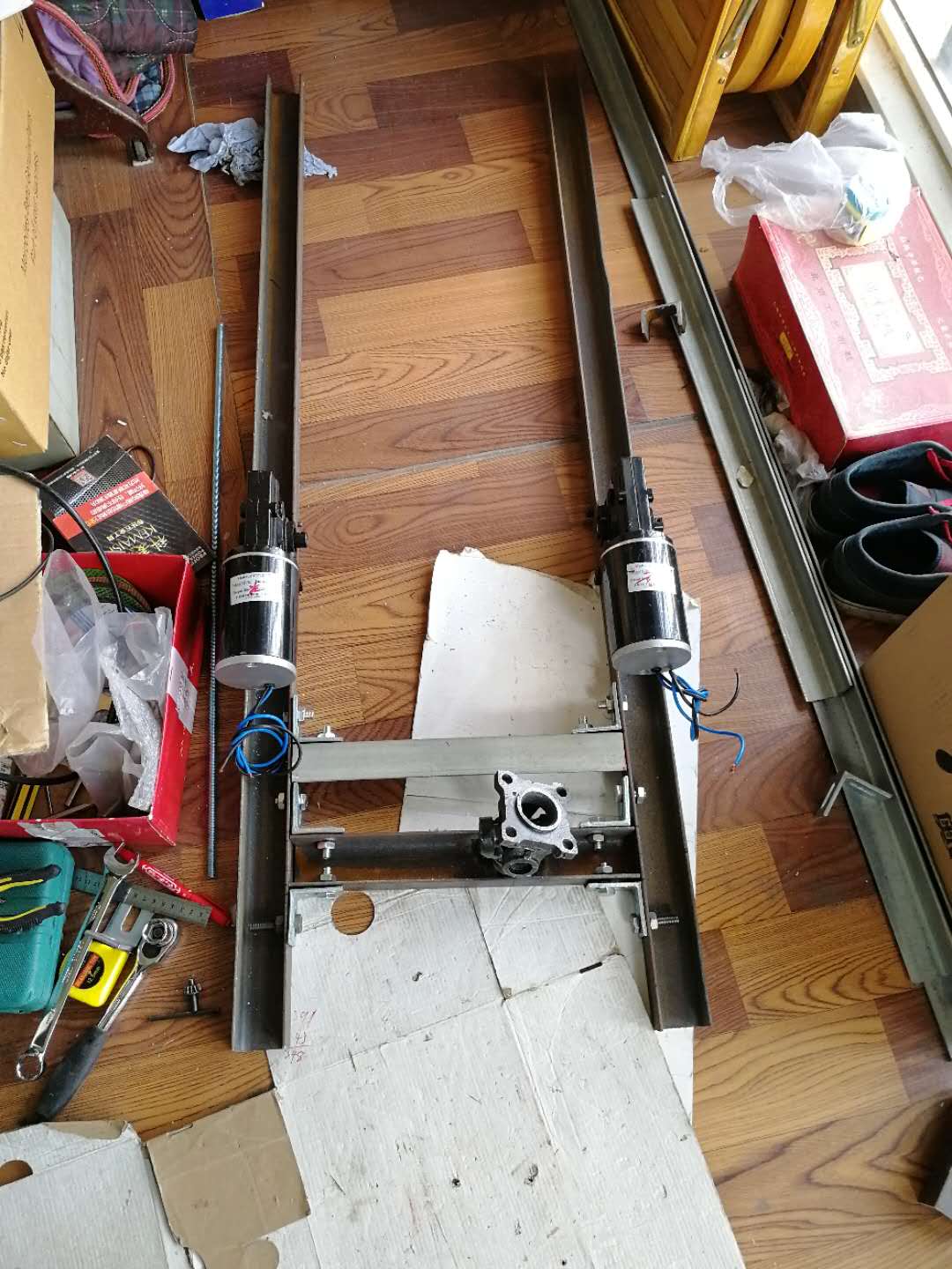

    Materials of my simple project:
    1.channel steel 50x50 which is suitable for fixing motor ,some 50x50 angle steel and steel corners

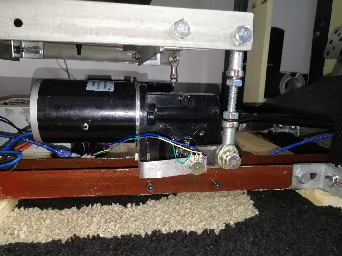

    2.150w dc motor---25:1
    CTC 40mm

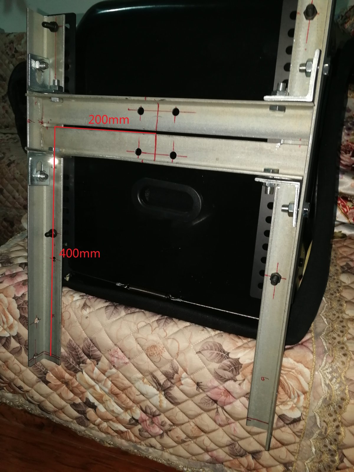

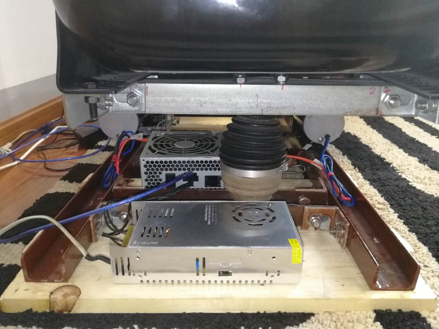

    3.universal joint from tesla half shaft:rolleyes:
    4.ONE 500W LED power supply

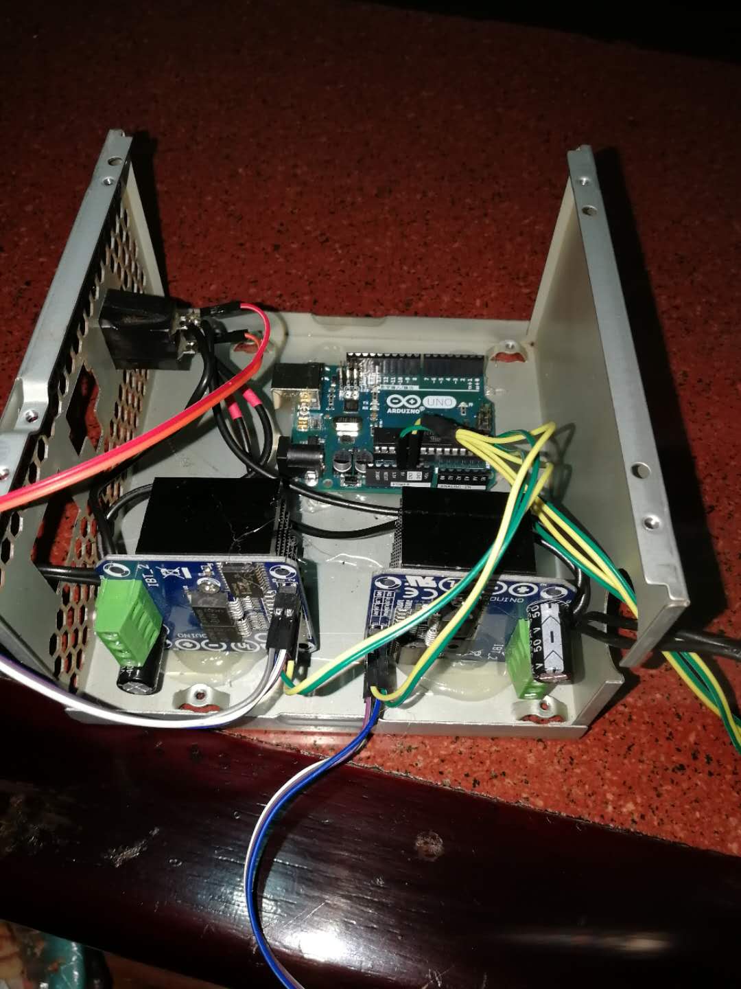

    5.10k potentiometer x2,
    IBT2 x2
    ardunio r3

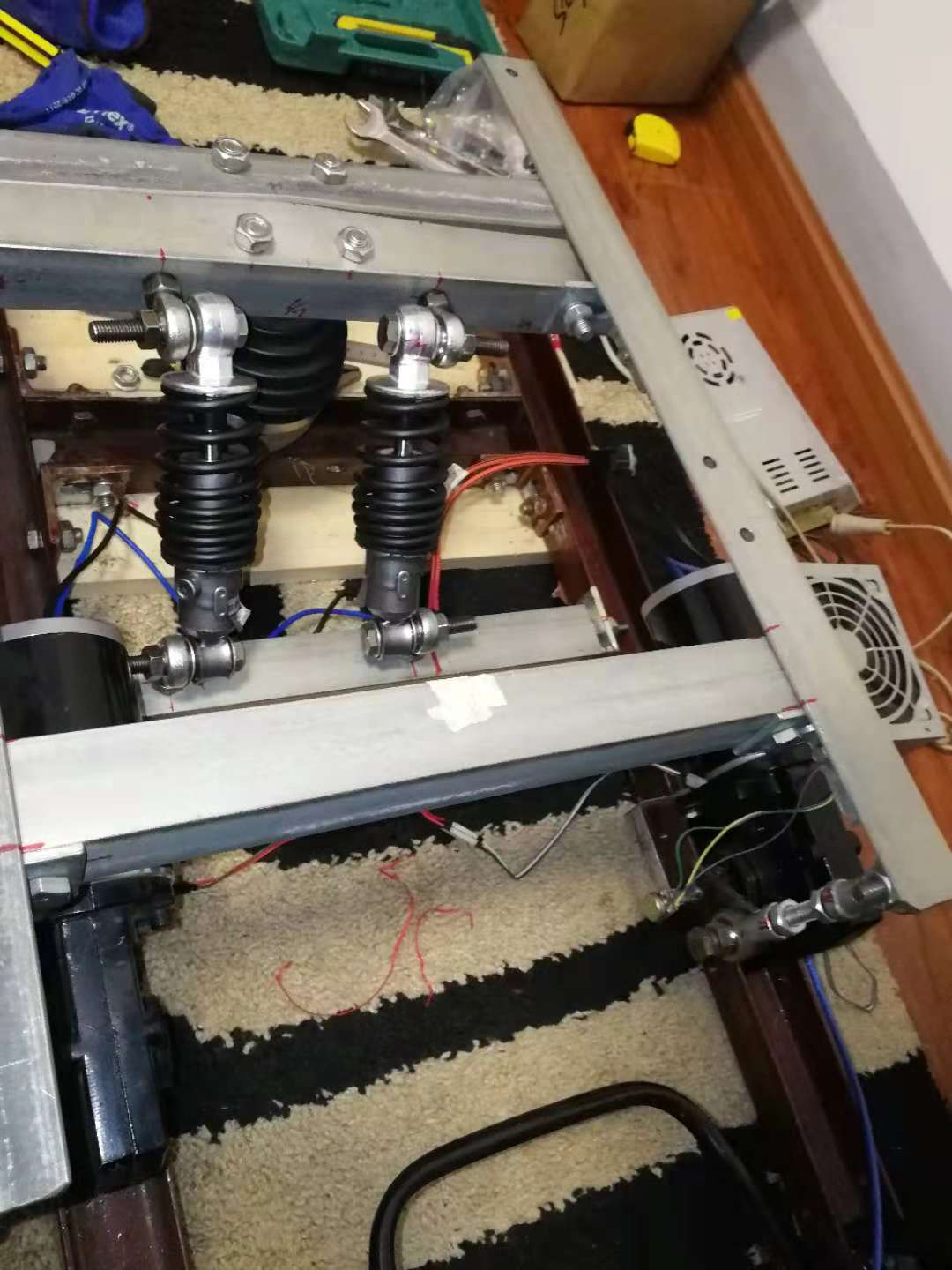

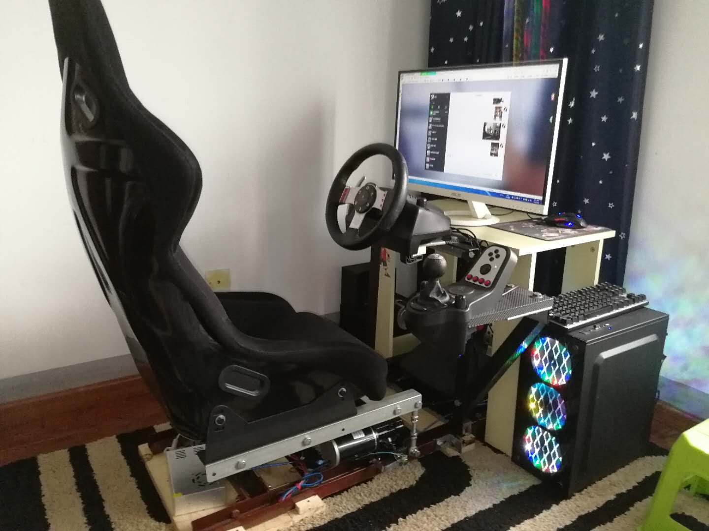

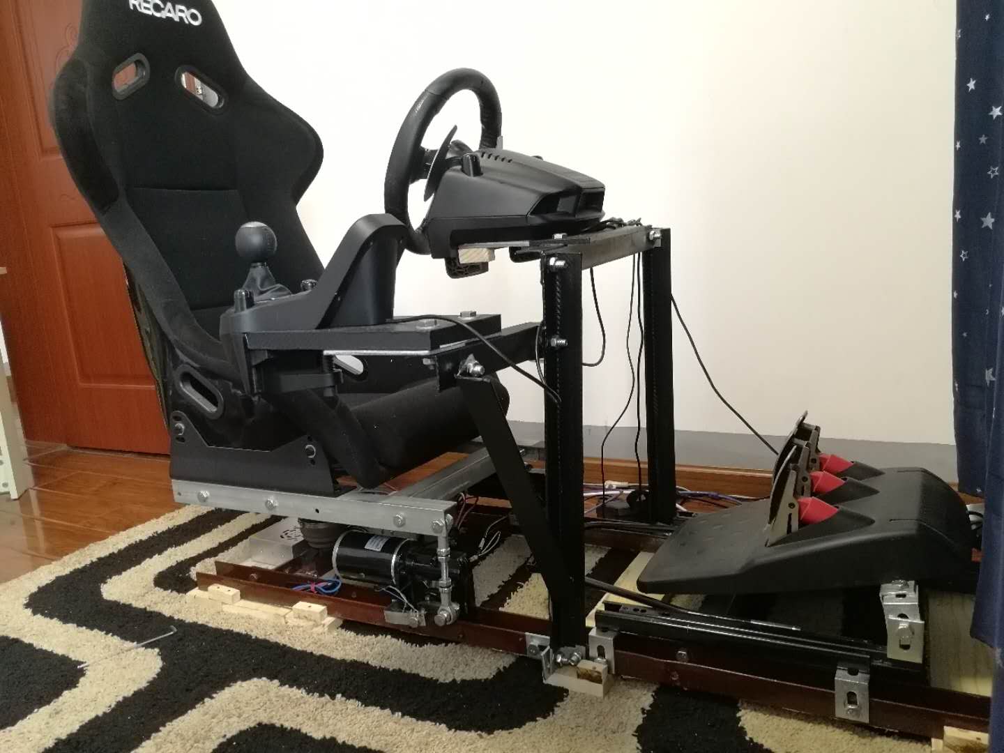

    finished product:cheers

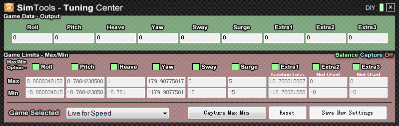

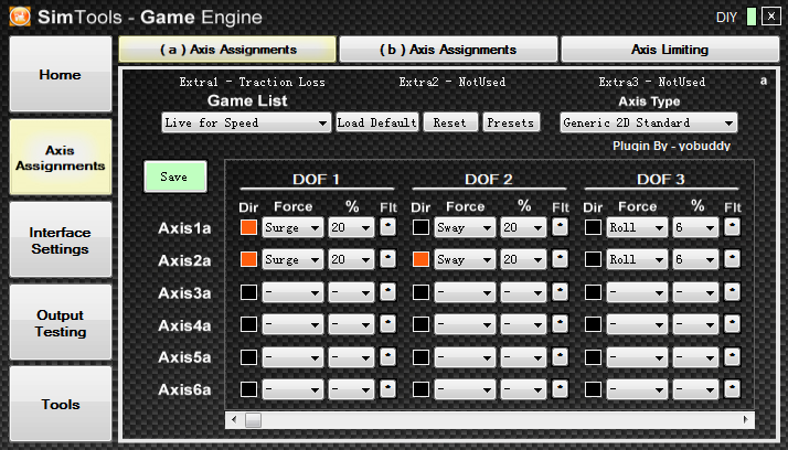

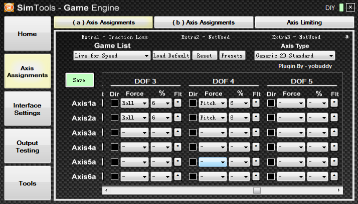

    Hi can you post pictures of your setting in simtools, axis assignments and tuning centre please ?
  12. yeclimb2
    yeclimb2 New Member
    Apr 1, 2018
    15
    china chengdu
    68Coins
    is that ok?
    I just want to decrese the amount of movement while don't decrease the power of motor
  13. Daguru
    Sep 4, 2013
    719
    Kitchen installer
    Wales uk
    453Coins
    +632 / 1 / -0
    Motion platform
    Hi if you want to keep the speed then dont touch the tuning centre if you want to reduce the amount of movement the lower the % of which ever dof is moving to much but to be fair yours look low anyway.

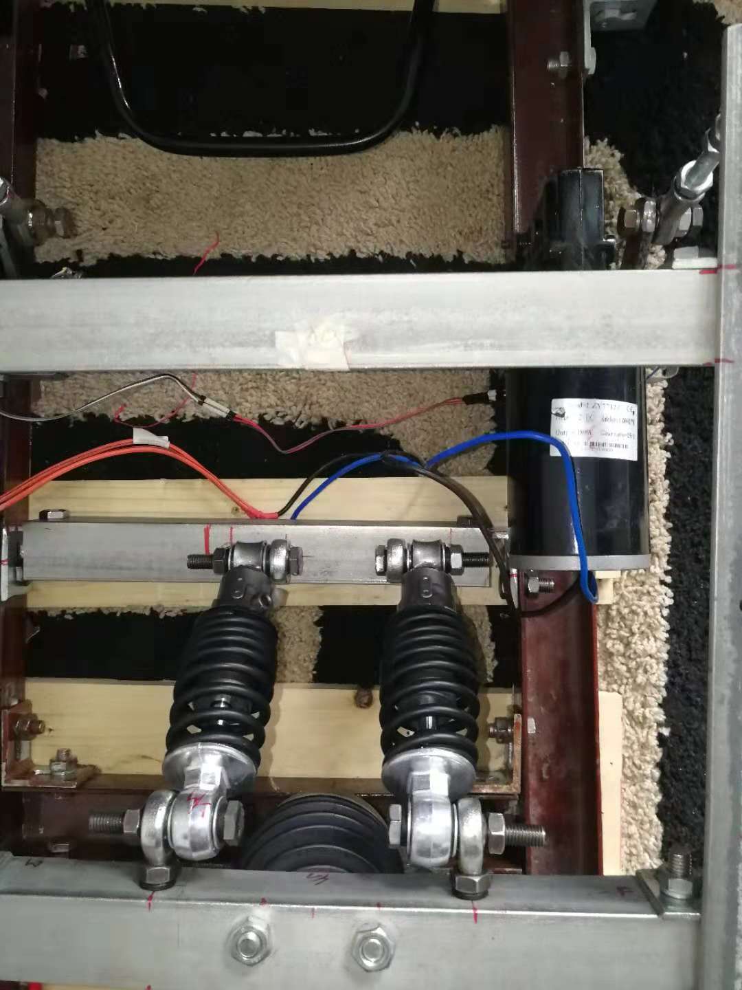

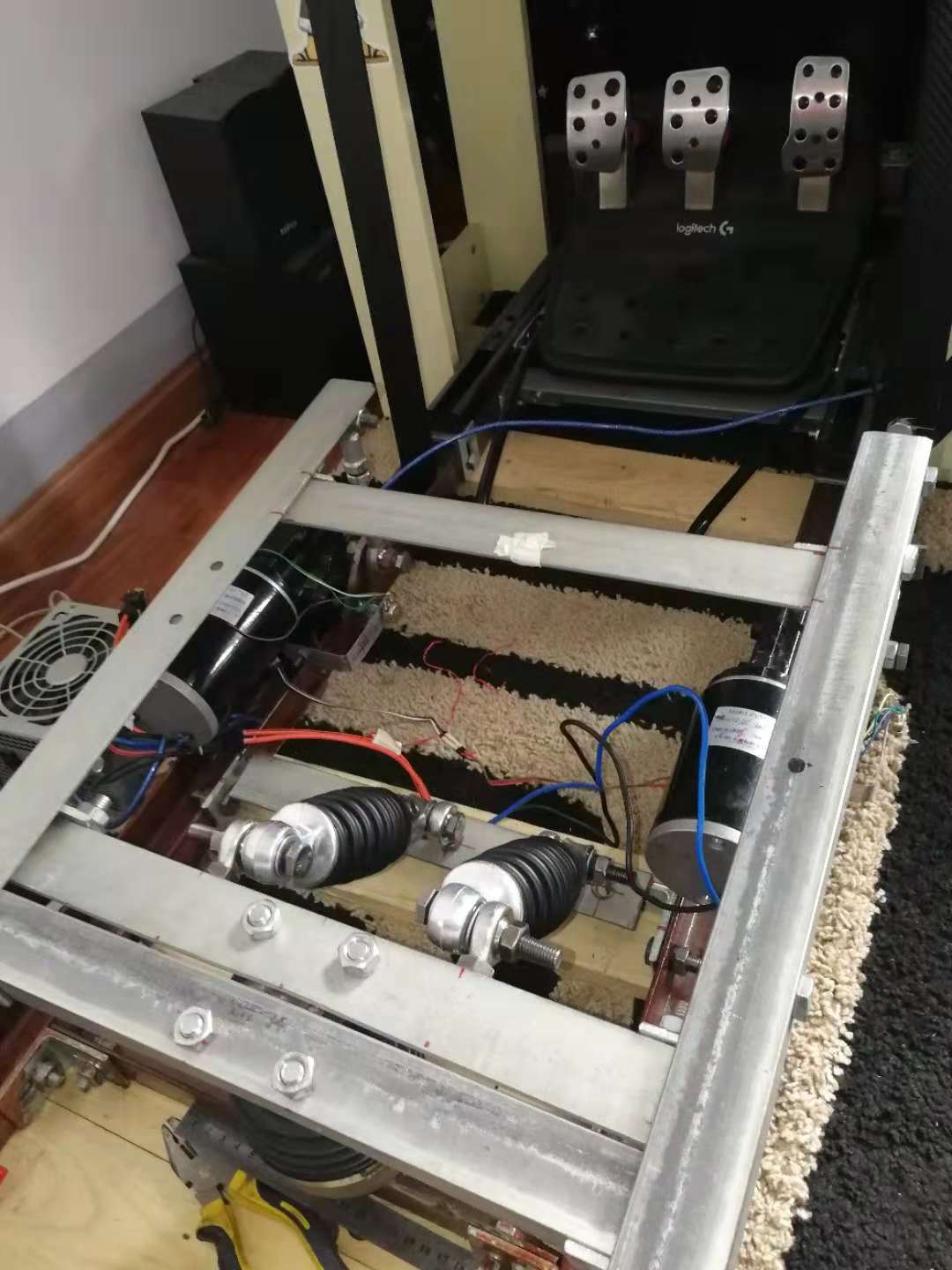

    Upgrade:
    The backlash is annoying,so i add two damping(use in motocycle) .Now the response is much more tight and comfortable.
    And now it also can support me with power off:grin
  16. noorbeast
    20,551
    145,124Coins
    +10,779 / 52 / -2
    What are the specs or link to the dampeners you are using?
