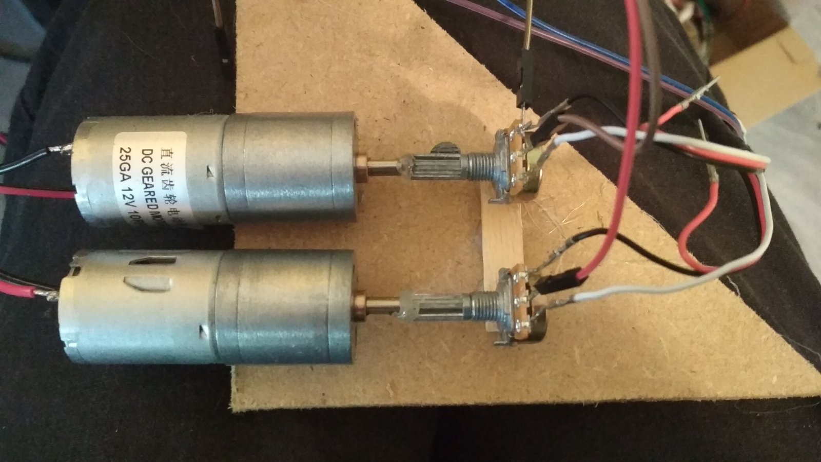

    As i like to understand what i'm doing, i started to build a micro prototype while i was waiting for the motors.
    I tryed differents arduino code for sabertooth from these threads :

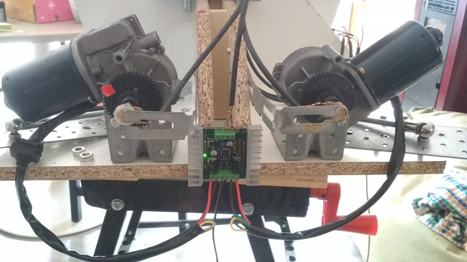

    my micro prototype that worked fine with racingmat arduino code

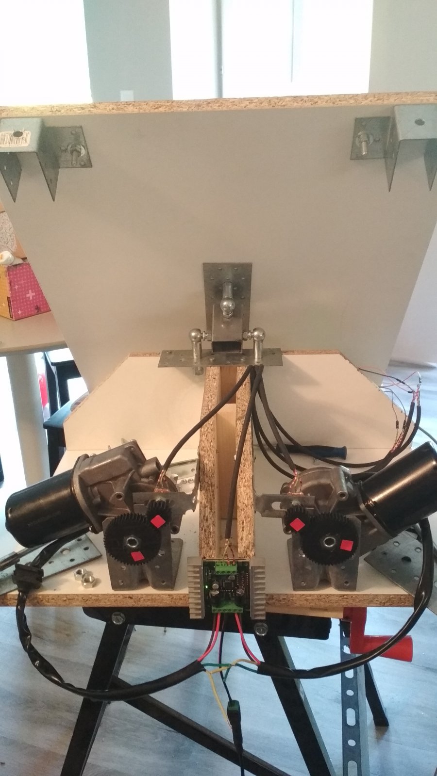

    And now, my real scale prototype whose doing me some issues.
    As you see, i 3d printed gears like it usually used by some builders,
    the presets are those posted with the racingmat's sabertooth arduino thread and seemed to work with the micro prototype, then i didn't change anything.
    I mounted everything, and tryed to make it work.
    But... when i launch game engine i have some issues, motors turns around and finish to the pot's dead zone
    Maybe too much gears amplitude
  6. qbahuon
    qbahuon New Member
    Dec 6, 2018
    16
    network technician
    france
    45Coins
    2DOF, 3DOF, DC motor, Arduino
    I quickly crafted new position for pots, and simplicity won the game !
    It partially works, so this code was designed to work with pots directly attached :thumbs good new
    Now i encounter issue when i launch a game, it trembles and behave badly when motor needs to reverse movement (sabertooth lights red)
    I searched in some threads and founds some things about the regenerating system of the 2x12 sabertooth :(
    I think the PSU doesn't like to take back some power...
    Hope it will not ruin my project :roll

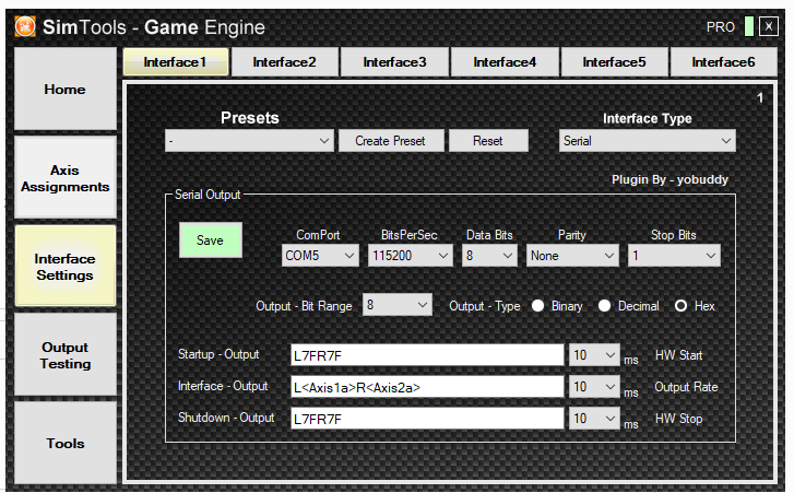

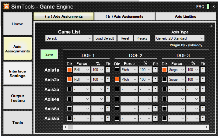

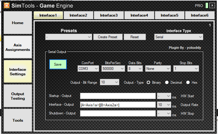

    here are my settings and the arduino code used

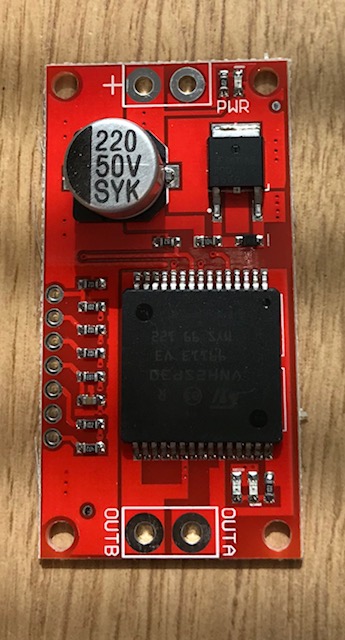

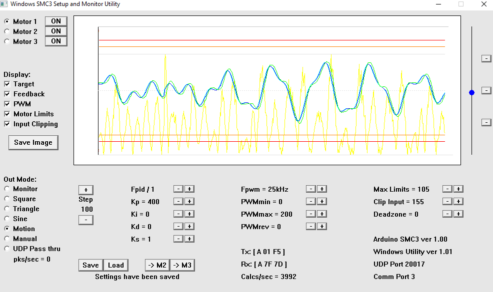

    I received today a moto monster that i ordered to make some tests by curiosity,
    As i'm stuck with my sabertooth for the moment, i gave a try with smc3 and moto monster,
    so i installed smc3 on a 2nd arduino and wired all like explained here :
    Then everything is fine in smc3 utils, i can move like expected but when i want to try in simtools i have no motion at all.
    I tried all kind of solutions, but no result. i didn't find axes settings abouts smc3 and simtools v2
    I saw some of guys with that type of issue but it was in simtools v1.x, what's new for simtools v2 ? is smc3 supported ?
    or maybe i didn't searched enough, i'll try to find something in threads

    ok i see :thinki have to reboot my comp everytime i use smc3 utils, it's like the soft doesn't release the comport when i close it... strange
    but now that works with a 15$ controller, and i stil don't find the problem with my expensive sabertooth :roll
    20,548
    145,106Coins
    +10,777 / 52 / -2
    Your total axis assignments, at 300%, are way too high: https://www.xsimulator.net/community/faq/axis-assignment-percentage-totals.120/
    You should be aiming for around 100% axis assignment total, though you can go a little over but not by a lot, then refine the motion profile: https://www.xsimulator.net/community/faq/steps-to-create-a-motion-profile.228/
    You say you are using @RacingMat's code but show the SMC3 utility. If you find the SMC3 utility handy for settings then use the SMC3 code and its interface settings: https://www.xsimulator.net/communit...3dof-motor-driver-and-windows-utilities.4957/
  15. qbahuon
    qbahuon New Member
    Dec 6, 2018
    16
    network technician
    france
    45Coins
    Thanks noorbeast, i missed that thing, i just changed that to 30/30/30 for the moment and that works less violently, will adjust when i will make a try for real.
    I posted a smc3 utility capture because i tried the moto monster controller by curiosity, and that confirm my hardware works fine, so i have a problem only with sabertooth
    I agree it's confusing to talk about a different controller in the same thread but i was surprised by the result.(in the video the sabertooth is present but not wired)
    I also tried the smc3 SPS code with all advisable settings but it didn't worked, not compatible with the sabertooth 2x12, maybe because of DIP switches config and not way to disable regenerative system)

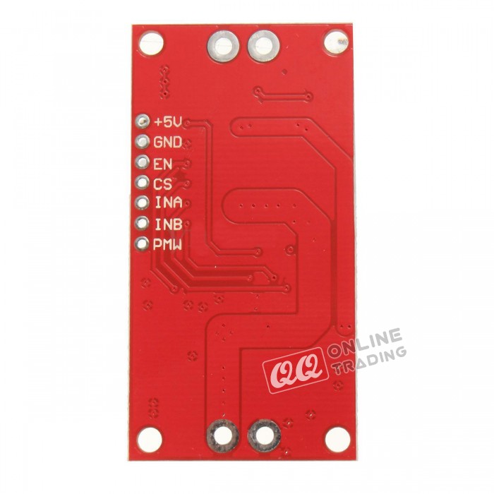

    Hi, I finally decided to switch my sim to the moto monster shield, because didn't find solution with the sabertooth 2x12.
    that works fine with moto monster and my daughter enjoys it.
    i want to turn the sim to 3DOF, i just bought third motor and a single moto monster shield, but don't know how to wire it.
    does someone ever worked with it ? they don't share the same pins as single and double...
    I'm ok for pwr in, pwr out, pot value and pwm, but the rest give me some trouble
  17. qbahuon
    qbahuon New Member
    Dec 6, 2018
    16
    network technician
    france
    45Coins
    that's Ok i found it

    Hi, i also use oculus for more fun :D
    I bought my motomonsters on amazon
    the dealer is ARCELI, they sell many electronic products like shields, arduino, etc, and the quality seems to be good compared to some others
    the motomonster heat very hard (after a session the triac unwelded by hitself), so i installed dissipators up and down
