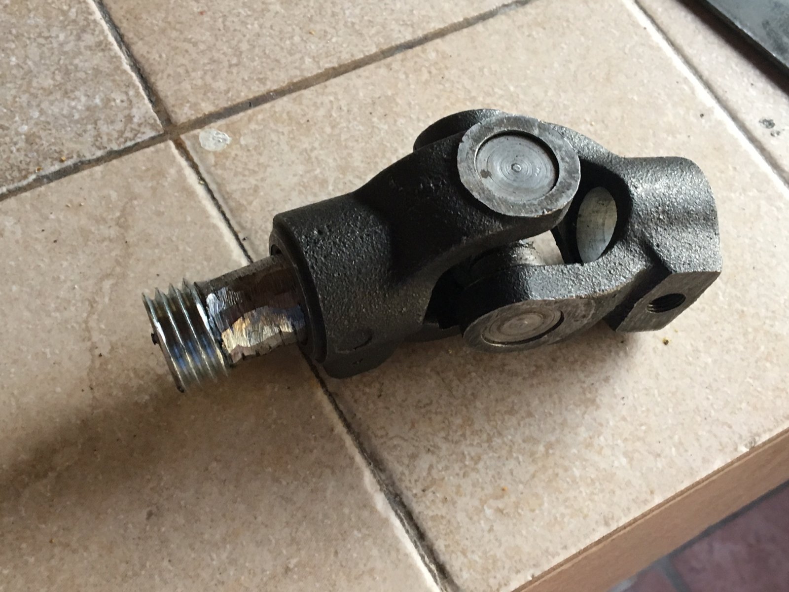

    1 x truck Kardan

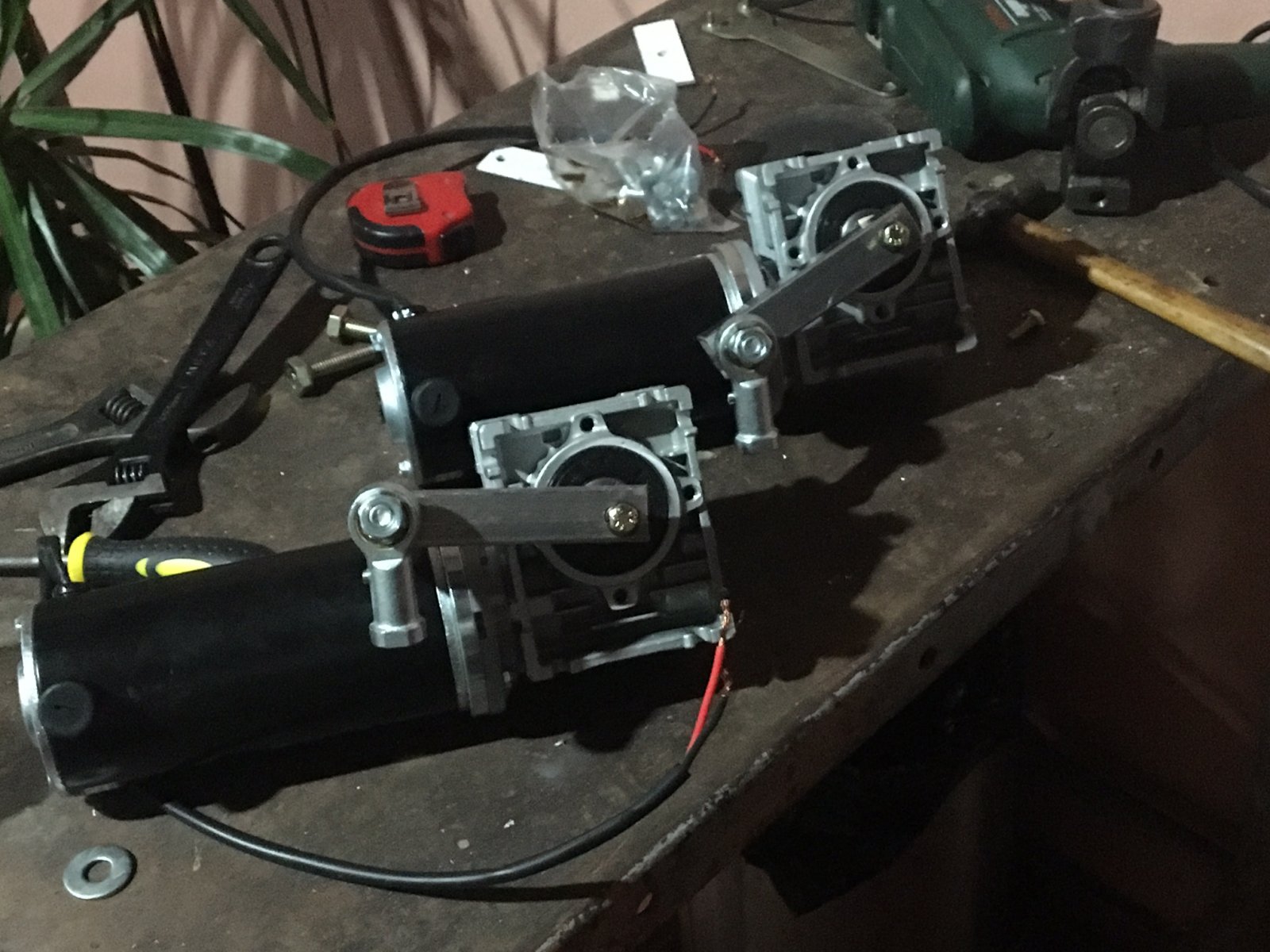

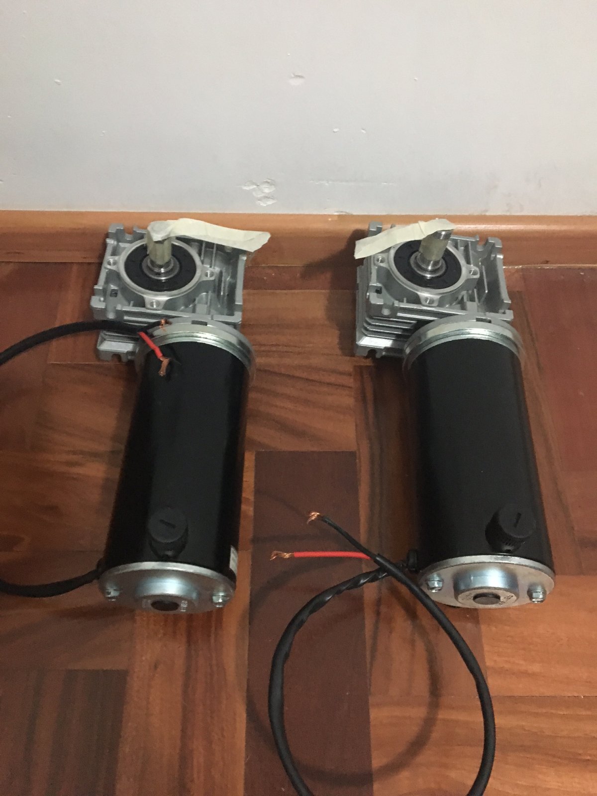

    Motors:

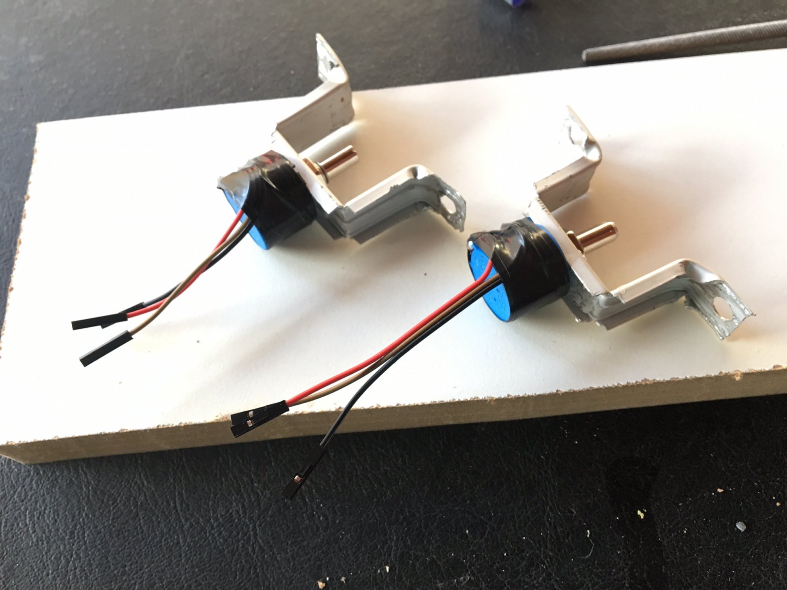

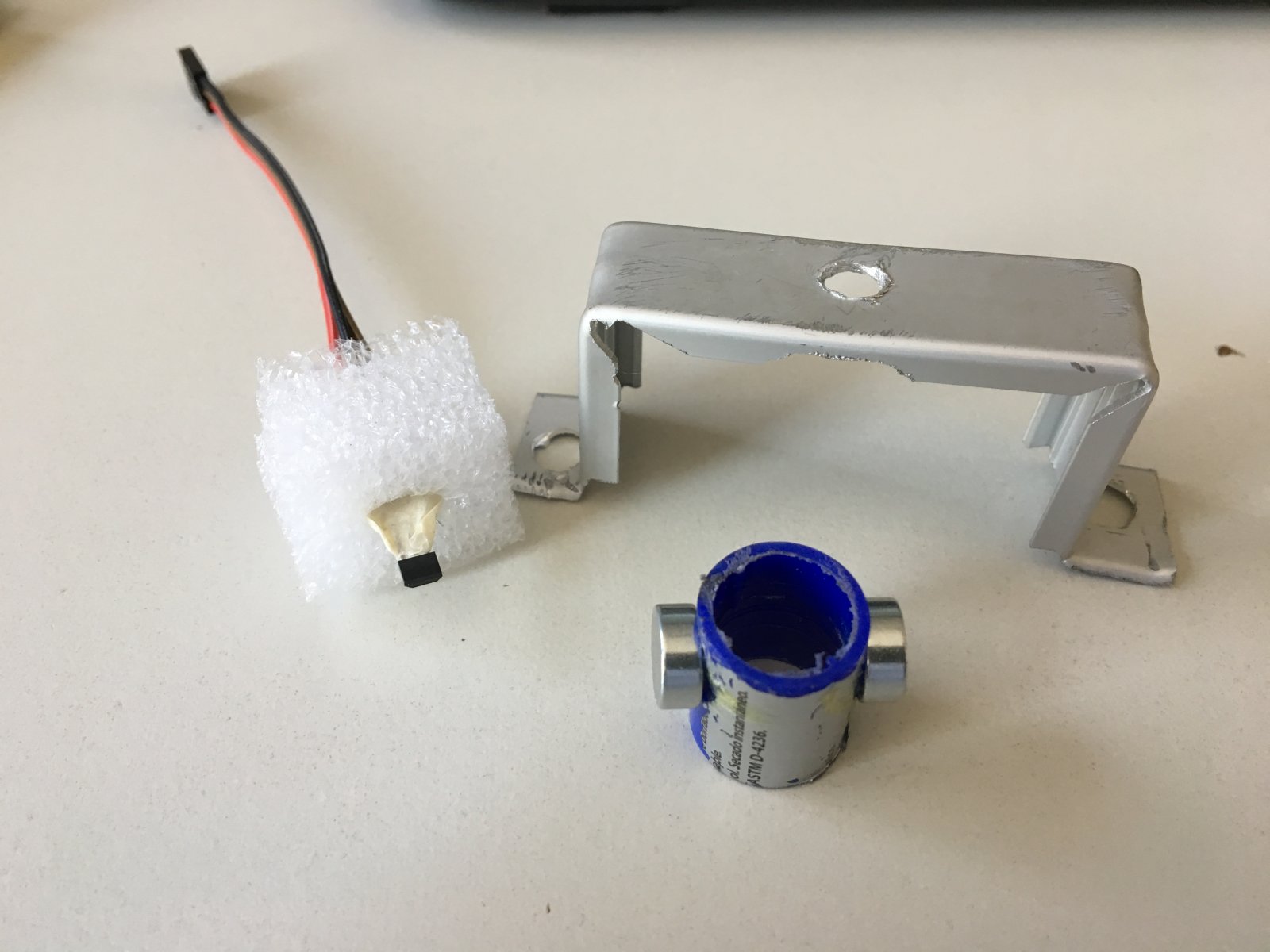

    More progress...
    DIY hall pots. They work fine, but I can not get the range 0-1024. The best is range: 10 - 960.
    next step: assemble and test with simtools

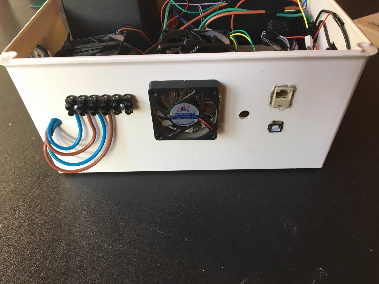

    Hi all.

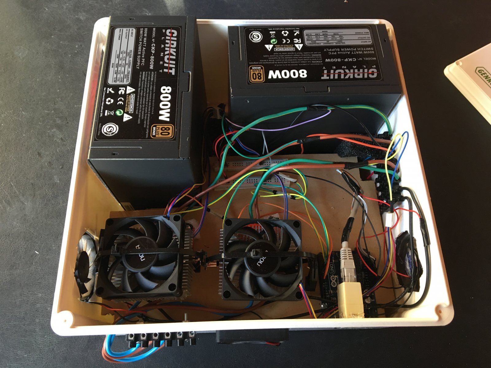

    I show the current status
    Box with moto monster, arduino and psu's;
    In action:
    Let's go for more!

    Hi!
    Pot scale is not problem, i also tested diy-hall. Your fast motors with such a sort lever from pivot point, gives you very fast moves.... maybe even too fast, you decide :) I think the structure may need little more strengthening, it may wobble under pressure. Nice job anyways!

    Hello people.
    The moment has come !. I have assembled all the structure and started the engines!
    But when I sat down, many things happened:
    1. The motors do not have the strength to move me (I will try to reduce the pivot)
    2. The potentiometers (DIY hall pots) do not give correct values (we will have to redo them)
    3. When PWMmax is set to 210 or more, the PSU turn off (I want to cry).
    4. One motor loose precision on your axis (see video)
    In other words: I am a little disappointed. This is going to take more time than I thought.
    I will continue when I have time
    21,487
    150,542Coins
    +11,017 / 55 / -2
    Try reducing the CTC of the levers to about 40mm, as you don't have a lot of inherent design leverage.

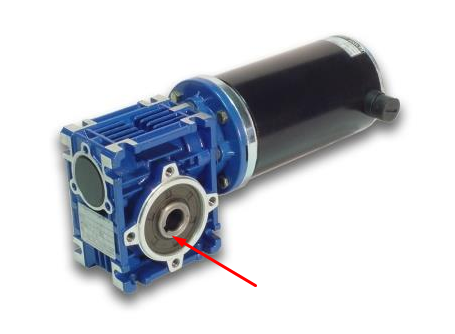

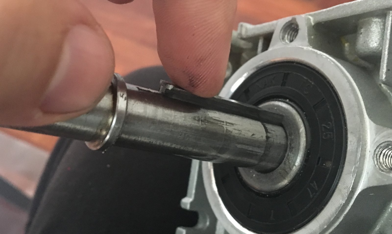

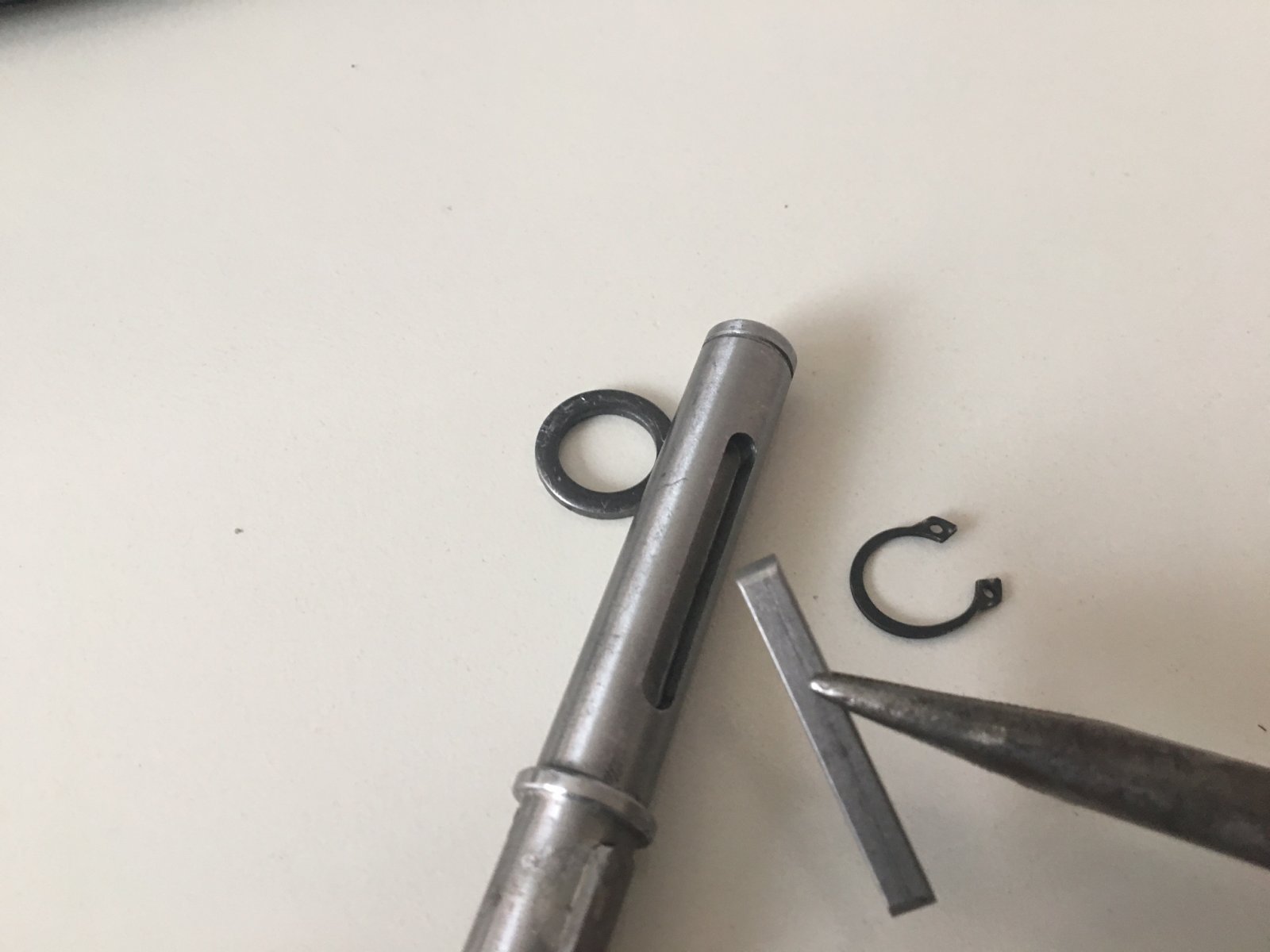

    Hi guys!
    I have been able to solve the problem of the paly on the gears.
    The problem was in the key, (here it is called "chaveta"). I add photos in case someone has the same problem. I replace it.

  17. Nick Moxley
    17,056Coins
    +2,506 / 30 / -2
    curious how does a "key" prevent any play in the gear box itself ? hrmm i see 2 keys on that Axle,....interesting, so there's a keyway inside the gear box on the main gear i will assume.
  18. perdixero
    perdixero Member
    May 30, 2017
    49
    Argentina
    784Coins
    +55 / 0 / -0
    Exact @Nick,
    Inside of the gear box there is a slot where the key engages.
    (Sorry if the translation is not the better)
    Even changing the keys, the play continues.
    Therefore I am determined to apply a soldering point on the axle. Sound very bad?

    I wouldn't suggest welding anything, Not a wise idea.
    The Play is needed for proper gear operation on the worm gear in general. If you apply a proper 1-2% weight bias towards the rear on On your motor's (pending the configuration) You shouldn't notice this play in the box very much, if at all.

    It is very difficult to see, but I think the play is between the ax and the crown (I do not know how it translates).
    Listen it in this video.
