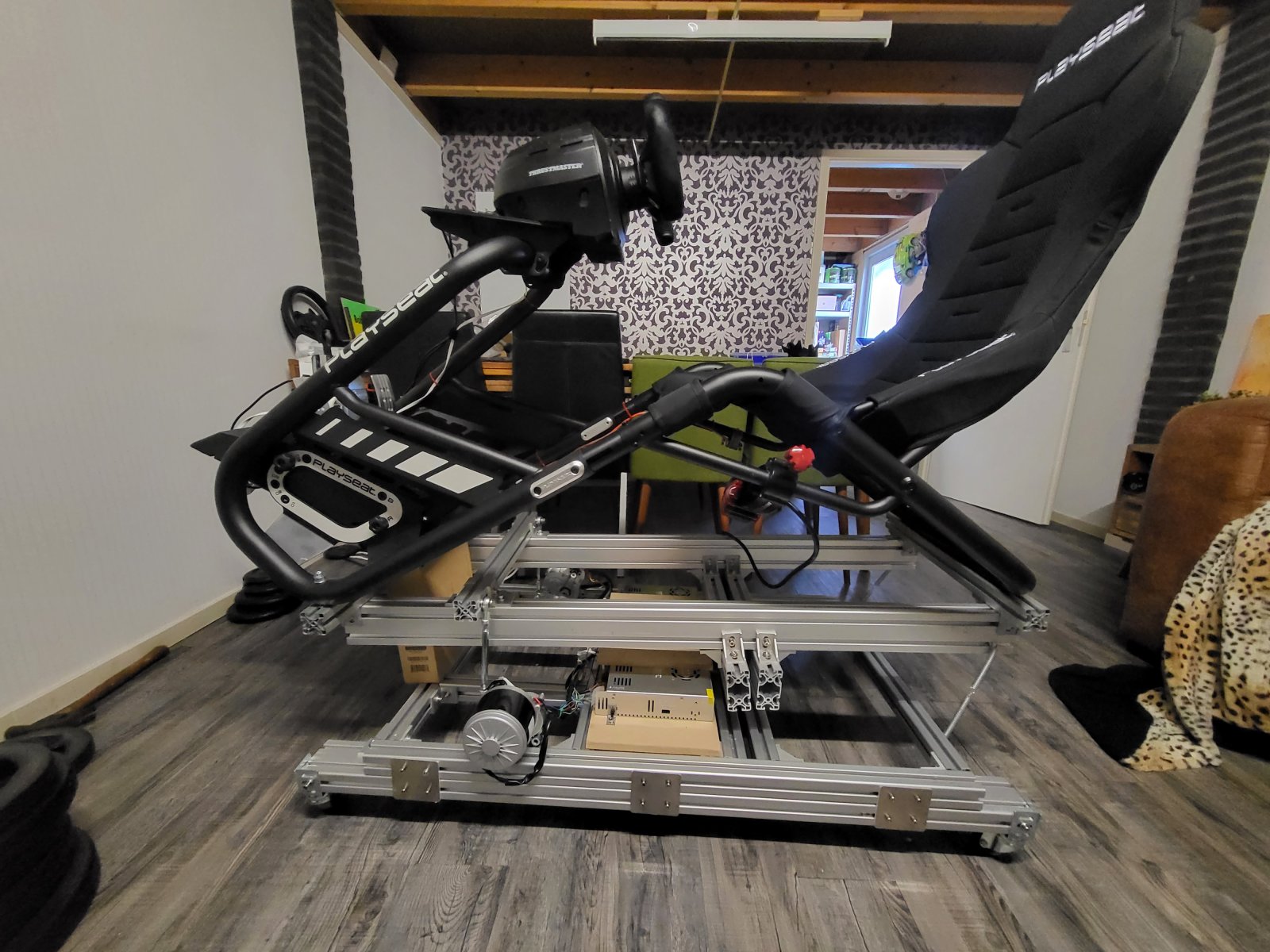

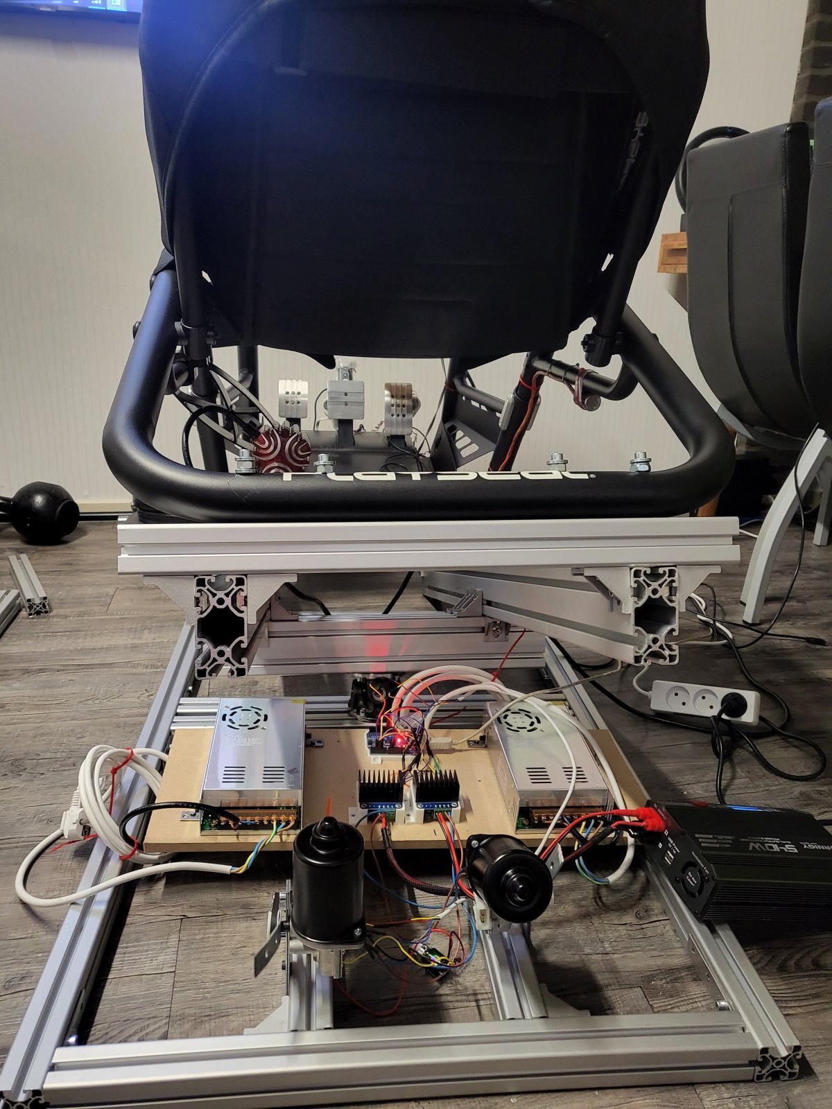

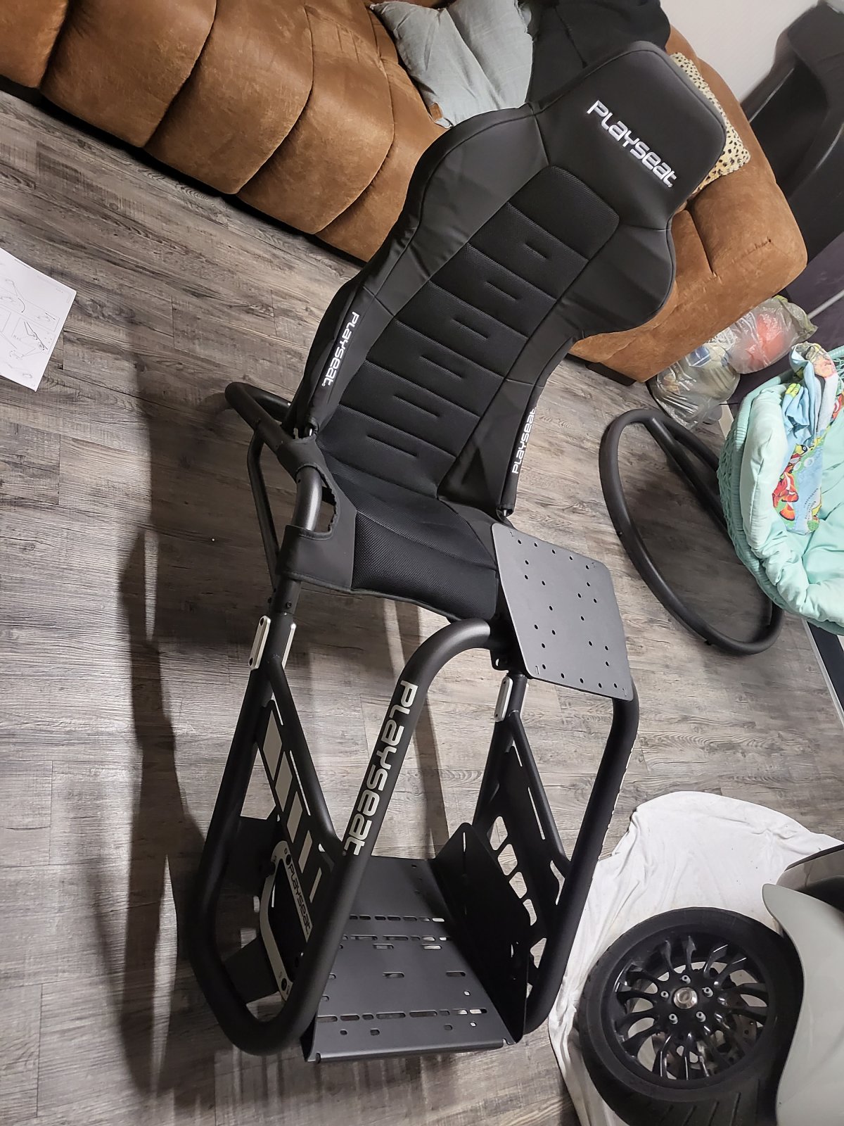

    After lots of reading and watching I have started to build my own 2dof chair.
    I already had a playseat trophy, so this is the basis of the chair.
    I started with simple windscreen wiper motors, as my 24v wheelchair motors are not in yet.

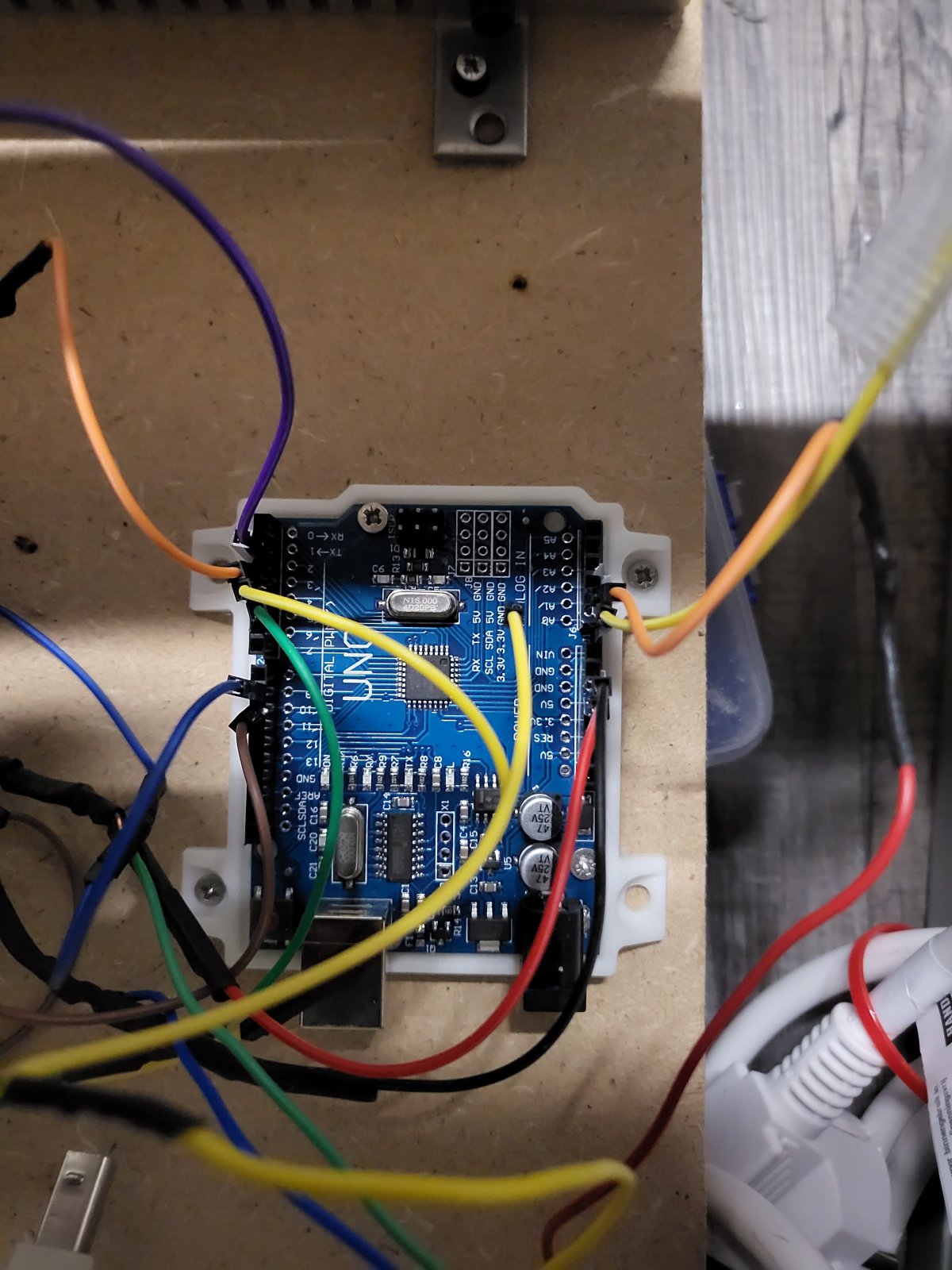

    I have 1 issue still, that is with 1 motor. It keeps going into off modus, where I see the yellow line dropping to zero and it only moves in 1 direction..... I think that my clone Arduino uno (340 model) is the issue as when I build my shaking motor system, also based on arduino, had also issues with this one. A new R3 arduino is on its way.
    When everything works, embedding simhub in it is the next step.

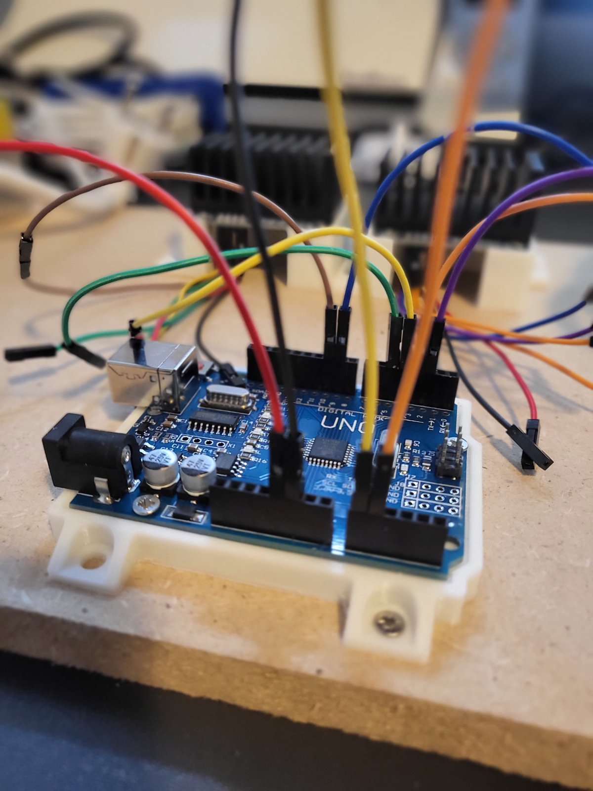

    Small update:
    I was uding this Arduin0(clone Uno)...but never got it to work...always 1 motor which had issues with starting... Now swapped it to an official R3... perfectly working.
    So maybe more will run into this issue....or it was just bad luck on my side...but my advise....avoid these clone Uno's....
    I wasted lots of time in resoldering the wires, swapping IDT's, swapping power units etc.... :)
    Now on the agenda.... Balance everything...so that when I sit... everything is perfectly in balance....

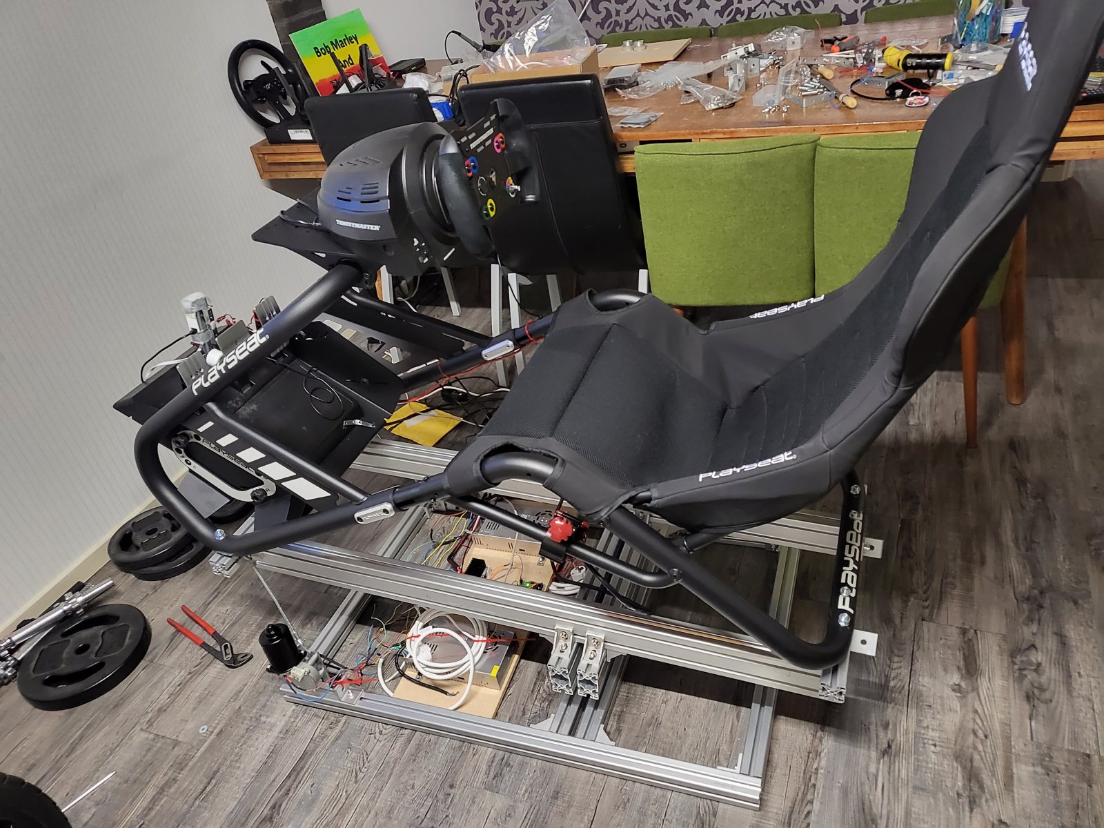

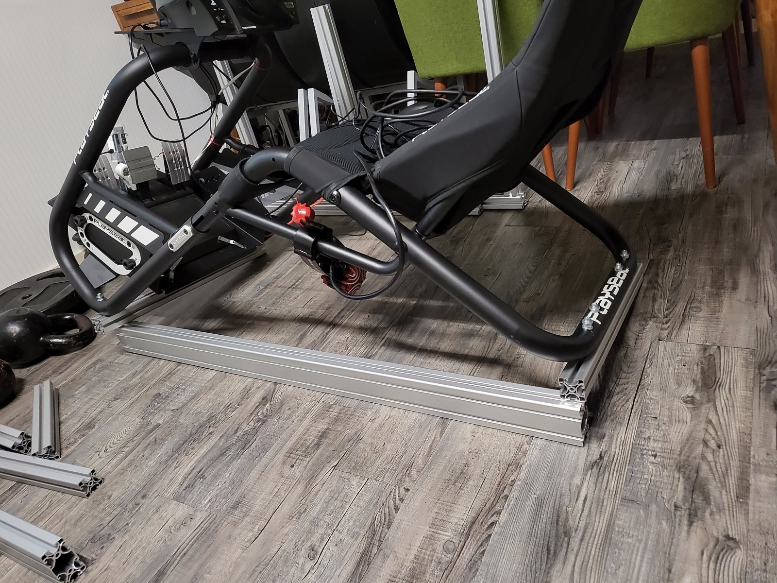

    Status 90% :)
    Things done last night:
    - Swapped motors to front
    - Balanced chair
    - started configuring Software(try to use simtools 3, really like the new look and feel)
    To do:
    - Strengthen/tighten some parts, as there is some movement in the chassis
    - cablemanagement
    - Simhub connection
    Things learned:
    - Do not use Arduino clone
    - Start balancing earlier... As when I thought I was finished almost a few days ago, it was moving horrible. Too much weight at the back of the seat... So had to rebuild part of the frame....but it is hobby..so always fun :)
    Now, I will start racing, somewhere next weeks my wheelchair(24v) motors will arrive and those will be placed on the chassis, but already surprised by the cheap 12v windscreen motors...
    What a nice project :)

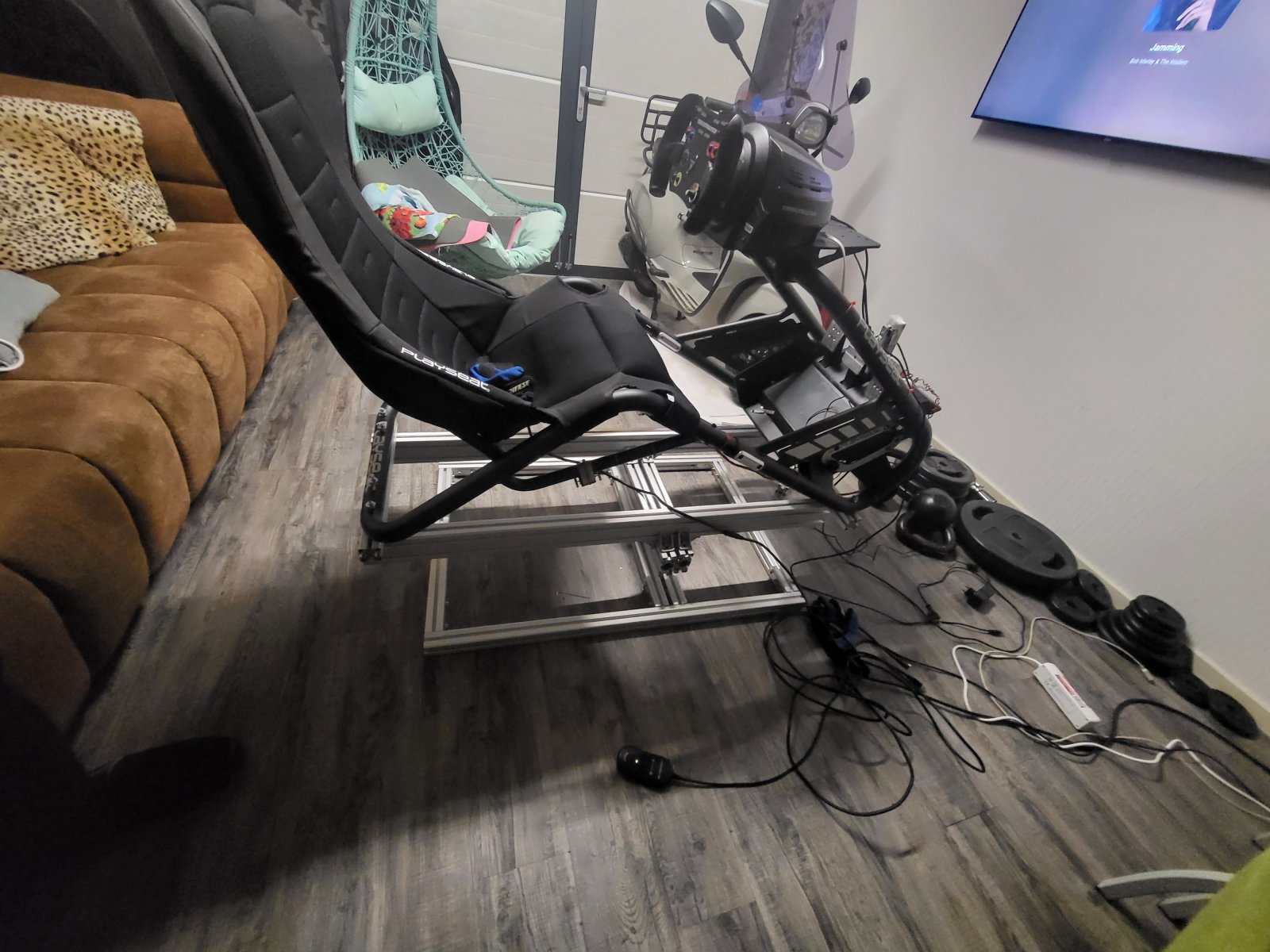

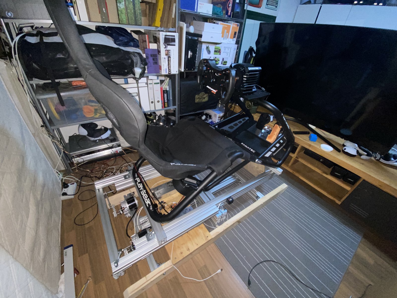

    It's Alive :)
    Still with the cheap windscreen motors, later this week my final motors should arrive.
    But to be honest, these cheap 29euro motors are already very strong, very impressed. Maybe it is because I invested a lot of time in finding the perfect chair balance when sitting in it. As at this moment, when sitting in the chair, it can be moved towards all directions with 1 finger. So the motors do not have to be that strong.

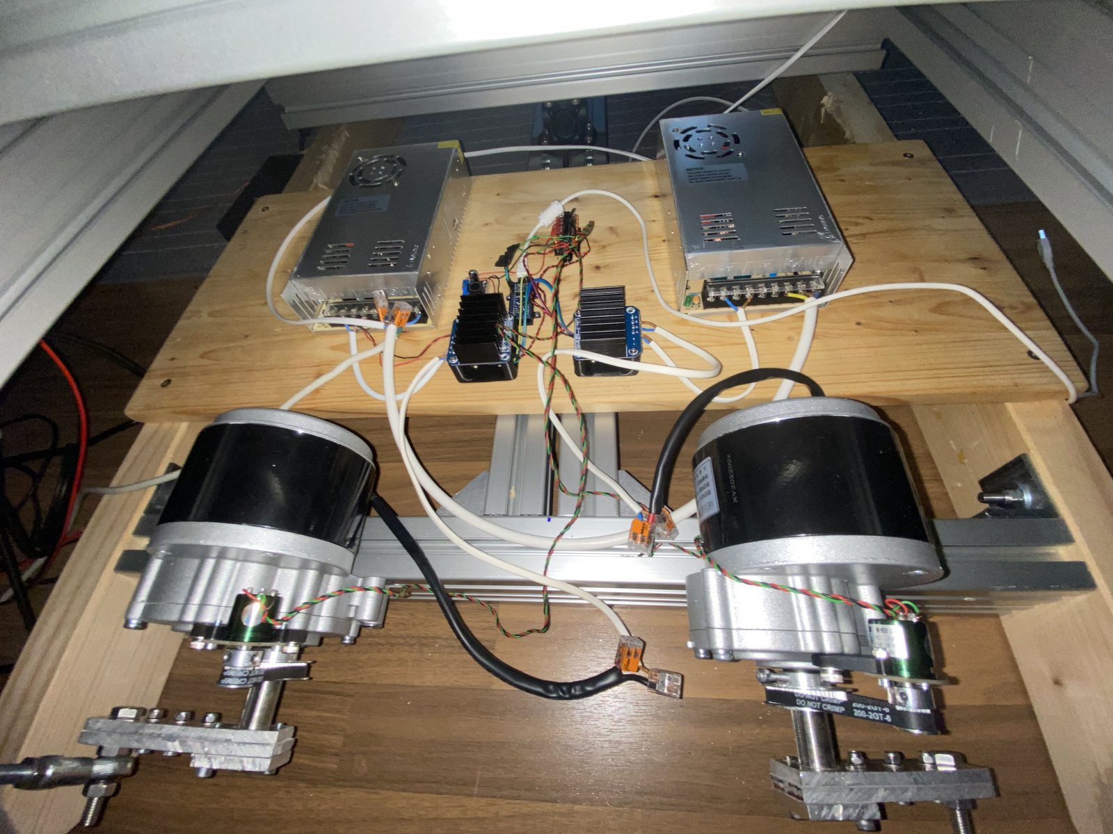

    And it Finished :)
    Very much impressed the way it works... I had to swap the rodconnectors a few times as they have too much play in it (note to myself: Aliexpress quality not use for this :) )...

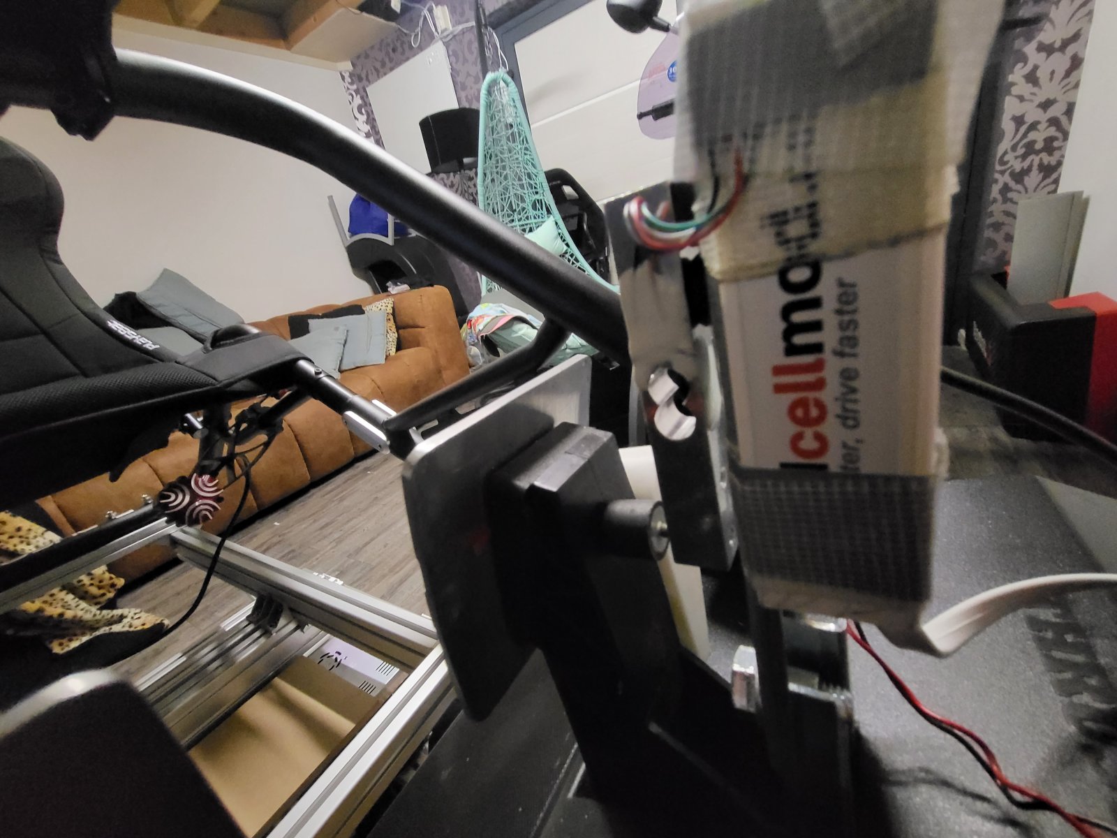

    So now It is working with my Loadcell, Simhub is working for my Shaker motors and Buttkicker..
    Had to play a lot to find the perfect settings as the games act differently. So ACC was working very well, where the same settings did not work perfectly for Rfactor2... Now after some adjustments it is perfect!!!
    These motors are very powerfull, so adjusted the power in SMC3 and set it in the game also not 100%.
    For me, I do not want to have a rollercoaster experience when driving :)
    Very impressed by this community and the way I was able fo find information... I am not a very technical person, but managed to get my chair working brilliantly :)
    So thanks Xsimulator forum :)

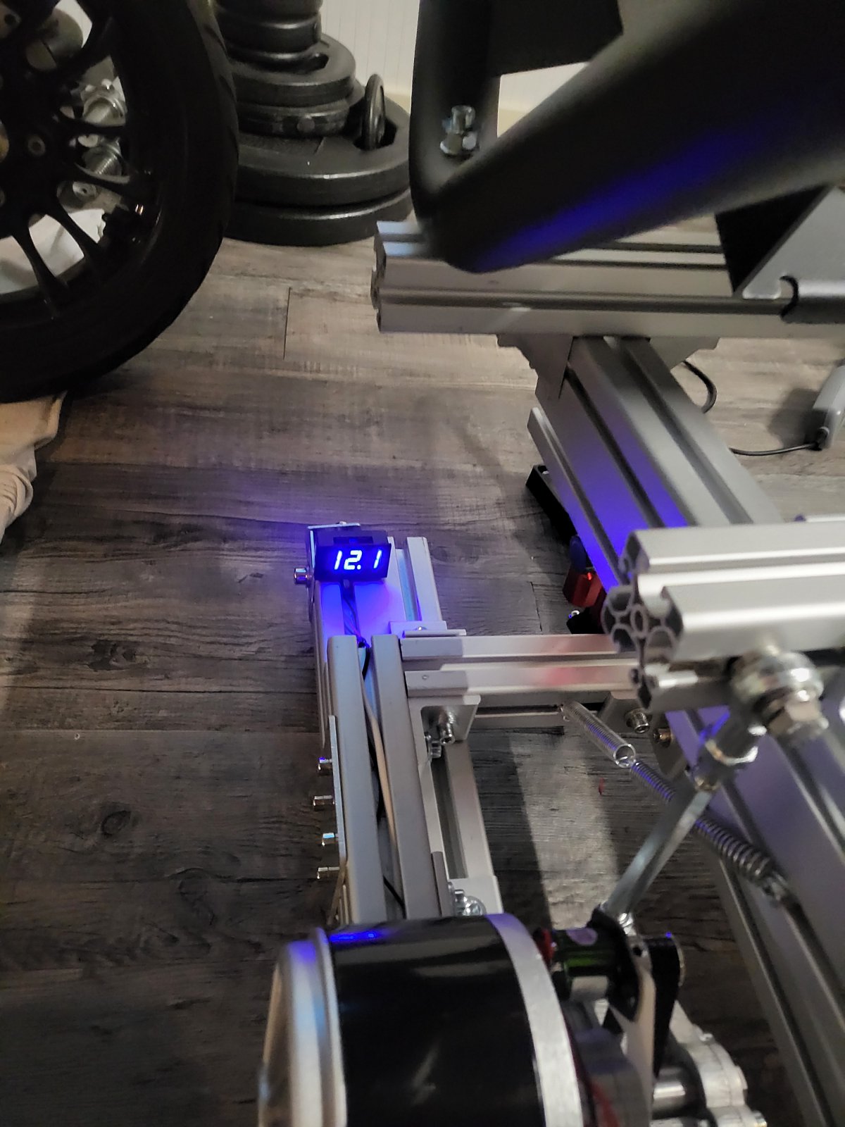

    As this project is fun to keep extending, I have added 2 (aliexpress) temp sensors(each on a side), which are reading my IDT2's, just to make sure that they do not overheat. But at this moment these IDT's are not getting warmer than 30c... But in the summer, maybe good to keep an eye on.

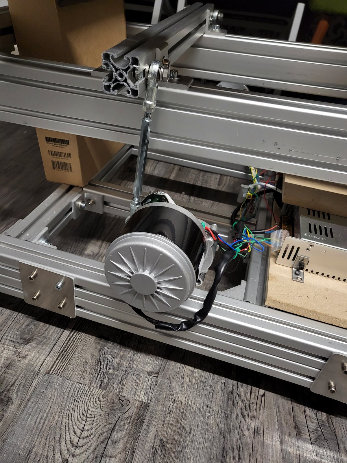

    I have mounted them with 4 screws...2 in front direct to the alu profile...and 2 with large screws on the oposite site of the alu profile. With this, they are very rigid on the profile.
    I do not think that the motor in front, or back is a difference. The most important is that the chair can move very easily when you sit on it. I had to adjust this many times, now when not attached to the motors, I can move the chair when I sit in it with 2 fingers.
    Important with these engines is that u use them on approx 19v... more will burn the IDT's and will give way too much power.

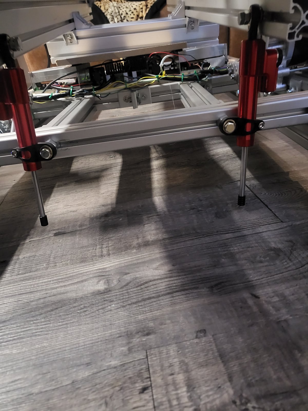

    I have bought very cheap motorcycle steering dampers(via Aliexpress, approx 35 dollars)...

    these are the dampers I use, how much N they are, I do not know. the thing I use them for, is to damp the first mm of movement between up and down, as these motors are gearsdriven, so always some play in it. With these dampers this play is almost gone. Also important to position them at the place where you have enough movement, so the damper do not block the up/down movement of the motor.
