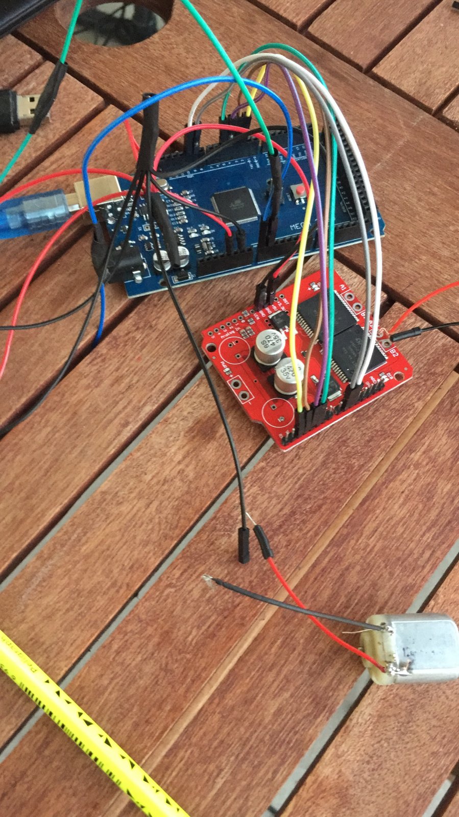

    To start and in order to understand how wiring should be done without burning anything i have started working with 7.2v batteries and 2 tiny DC motors.
    After several trials VOILA the motors are moving and controlled manually with the potentiometers.

    Guys,
    i have tried the moto monster shield and everything works fine knowing that i am still simulating using tiny motors.
    i bought 2 single H-bridges IMS-2A that are supposed to handle 30A each with the purpose of using more powerful motors.
    http://www.ekt2.com/products/productdetails/412_ARDUINO_DC_MOTOR_DRIVER_30A
    i have noticed that i had to disconnect the R1 because The V + pin is by default a direct connection with the B + pin (refer to attachment).
    wires connection as follow:
    Arduino H bridge 1
    pin 2 IN1 (supposedly ENA) motor1
    pin 9 IN2 (supposedly PWM) motor1
    pin 3 EN (supposedly ENB) motor1
    Grnd Grnd
    5v V+
    H bridge 2
    pin 4 IN1 (supposedly ENA) motor2
    pin 10 IN2 (supposedly PWM) motor2
    pin 5 EN (supposedly ENB) motor2
    Grnd Grnd
    5v V+
    A1 Pot 1
    A2 Pot2
    I used SMC3 v1.0 with mode 2
    Nothing moved, on the other hand i have noticed that even without external power supply connected i am getting 5.08V coming from the Arduino on the B+ and Grnd of the H bridge.
    I would appreciate if anyone can help.

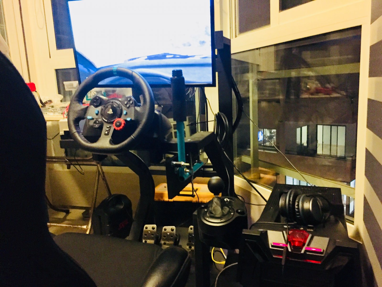

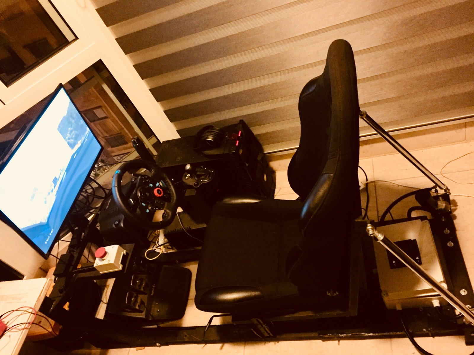

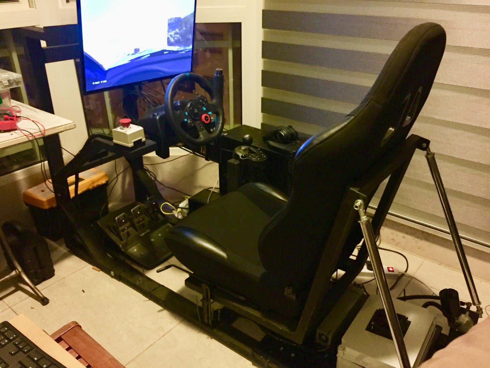

    i know i m late but this is what i have reached

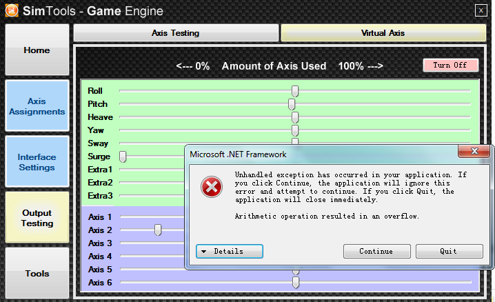

    I have downloaded SimTools and followed the directions but nothing is moving i m stuck can anyone help

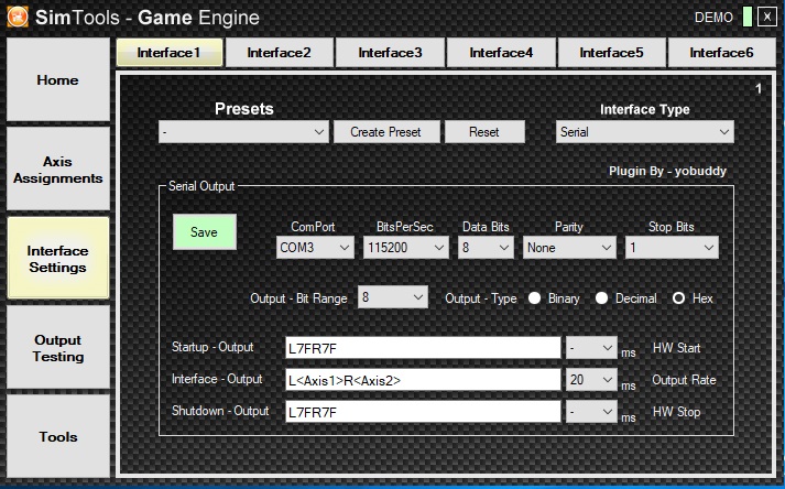

    The difference from SimTools 1.3 to SimTools 2 in setup is that in the Interface Settings instead of axis defined like this <Axis1> it now has designate grouping for a or b in SimTools 2 for each axis assignment, like this L<Axis1a>R<Axis2a>

    it's working now, i tried the output test and it moved but wehn i ran LFS the simulator didn't behave as expected. when i tried again i got tis message
    what could be wrong?
  16. noorbeast
    20,539
    145,052Coins
    +10,777 / 52 / -2
    Did you run a couple of laps in LFS before patching it, as that generates some necessary files. If not then un-patch LFS, run a couple of laps, then re-patch LFS.
    If you still get the error message after that the hot the Details button on the error message and post a picture of it.
  17. Elias
    Elias New Member
    Oct 18, 2017
    20
    Architect
    Lebanon
    163Coins
    +9 / 0 / -0
    Thanks i ll do that
