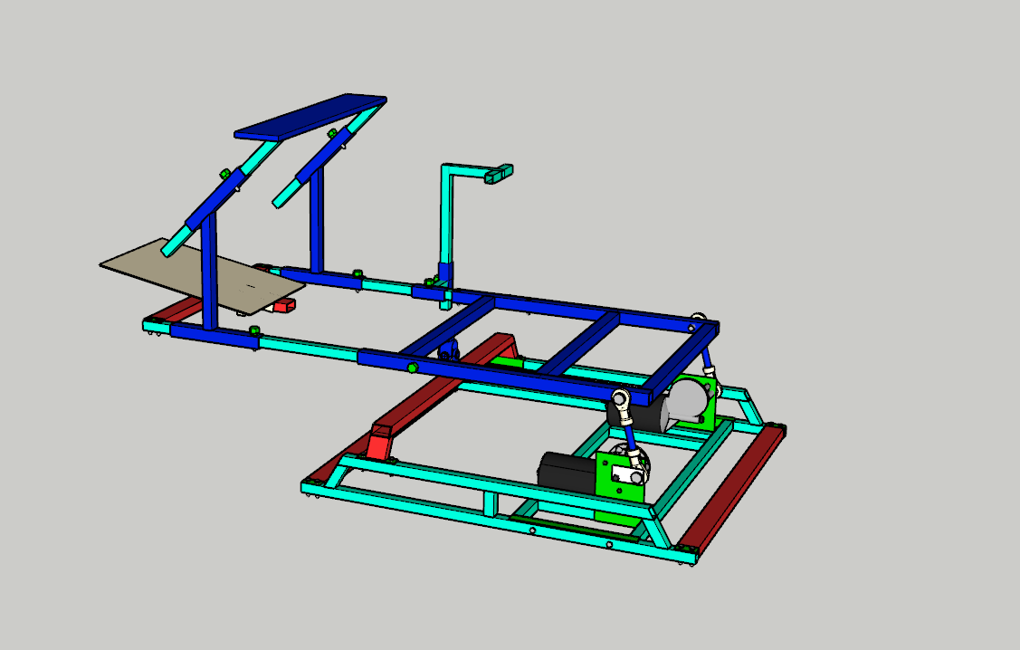

    Good morning, first apologize for my English, I will use google translator, so I will use a simple language or at least I will try.
    After seeing a multitude of projects, I decided to make a version of one that seemed the most appropriate, for now it is only a sketch.
    My first step will be the installation of the electronics and its configuration, if I pass that step I will start the construction of the simulator.
    In the next few days some of the material arrives at home and I will try to upload the advances that I am getting.

    hey! which program are you using for the project picture?
    good luck for your project :)

    SketchUp 2018

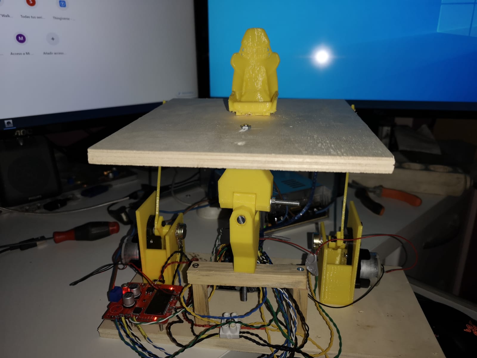

    Between today and tomorrow I will try to start the tests with the software, I don't know if I will be able to perform it successfully, the test will be done with a window regulator motor, if I pass the test I will buy the engines to start the project.
    The initially thought model will suffer variations, I thought it would be interesting that the pedals and the steering wheel were in a module that was removable, so that the chair could be used on the PC without having to have the simulator constantly armed.
    In the next few days I will upload the image of the new model.

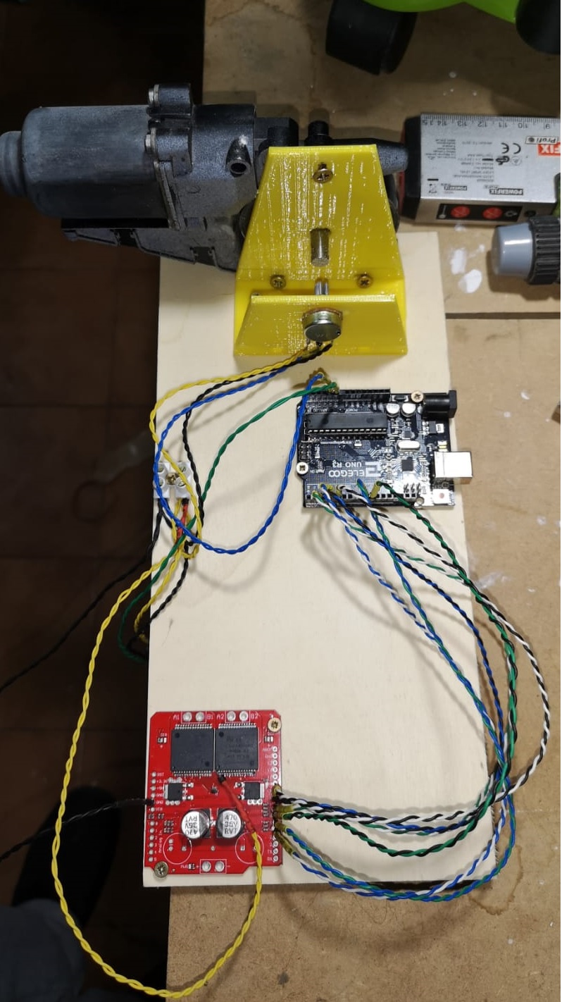

    This is the test bench, the axis that links the motor with the potentiometer is missing, the printer is working on it.

    Hey Israel, looks good! A mention about the potentiometer, though. Those work great initially but tend to wear out and get intermittent. When that happens, if your code can’t recognize it and just deenergize the motors (the Arduino motor control guys would know), they can run away. Worst case is you just rock back and forth as the output arm just spins, but if the output arms can hit anything, there can be problems.
    Hall sensors last much longer and are available in packages that are physically just like potentiometers. Those still are critical on alignment and shafts can bind and seize. Alignment either way is important and some kind of flex coupling can really help. There are also two-piece hall sensors with separate magnets and sensors. Nothing to wear out and they can theoretically last forever.

    Quite a few builders here have used them and details are in the various build threads. The ones I used are these: https://www.mouser.com/ProductDetail/785-RTP180LVEAA but they are more industrial and take their mating connectors too. What sold me on these were totally non-contact and magnets that attach with setscrews but that’s no hill if you have a 3D printer.
    Hall sensors can connect up just like pots too. +5V, Gnd, and the equivalent of a wiper.
    https://www.mouser.com/Sensors/Moti...rue&P=1z0xqraZ1z0x81tZ1z0x2ccZ1yrgqujZ1yvntta
    That link is to Hall sensors that might be suitable on Mouser. Another distributor is DigiKey and they might have other selections. I went with a 180 degree angle measurement range for mine. About $40 each though you can just buy the sensors and supply your own magnet and such for prices down to $10. That’s why I say to check other builds here. People here tend to favor the form factor like a potentiometer over the separate magnet style. One good reason for that is everything is prealigned. With a separate magnet, that’s on you including proper magnet orientation (it matters). The Honeywell magnets have arrows on them to help but it is more involved of a setup.
    You do need to get hall sensors with the right voltage range for your motor controllers. The Arduino uses 5V max on the analog input range so I specified 5V for these.
    You can also just start with pots but beware if they ever go intermittent. You need to know in advance your controller can detect an open circuit and respond appropriately. I think that code is in there but don’t know for certain.

    Thank you very much for the information, it is an option that must be taken into account, especially if there is a very intensive use, although for now I will use these sensors until everything is working correctly, I already tell you that I first have to operate the set and then the updates will come.

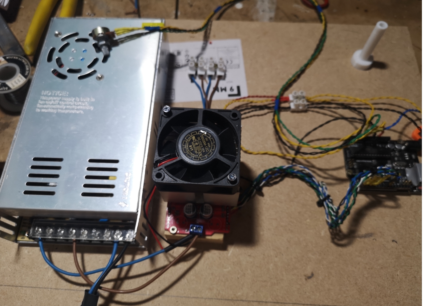

    Good morning.
    After a few days of learning I managed to make the model work, saying that I had many problems, which has made me have had to read a lot through the forum, my first problem was the communication between Arduino and computer, do not ask, try the antivirus and firewall issue, change ports and I do not know how many more things, the case is that finally I connect, the second of my problems was that the engines did not move, to be more precise, it moved only one and erratically, after To read and see that many of the tips was to check the wiring, check them and ... indeed one of the cables was incorrectly placed.
    After that, everything has been seeing how the model behaved in the game.
    sorry for my english, google translator.

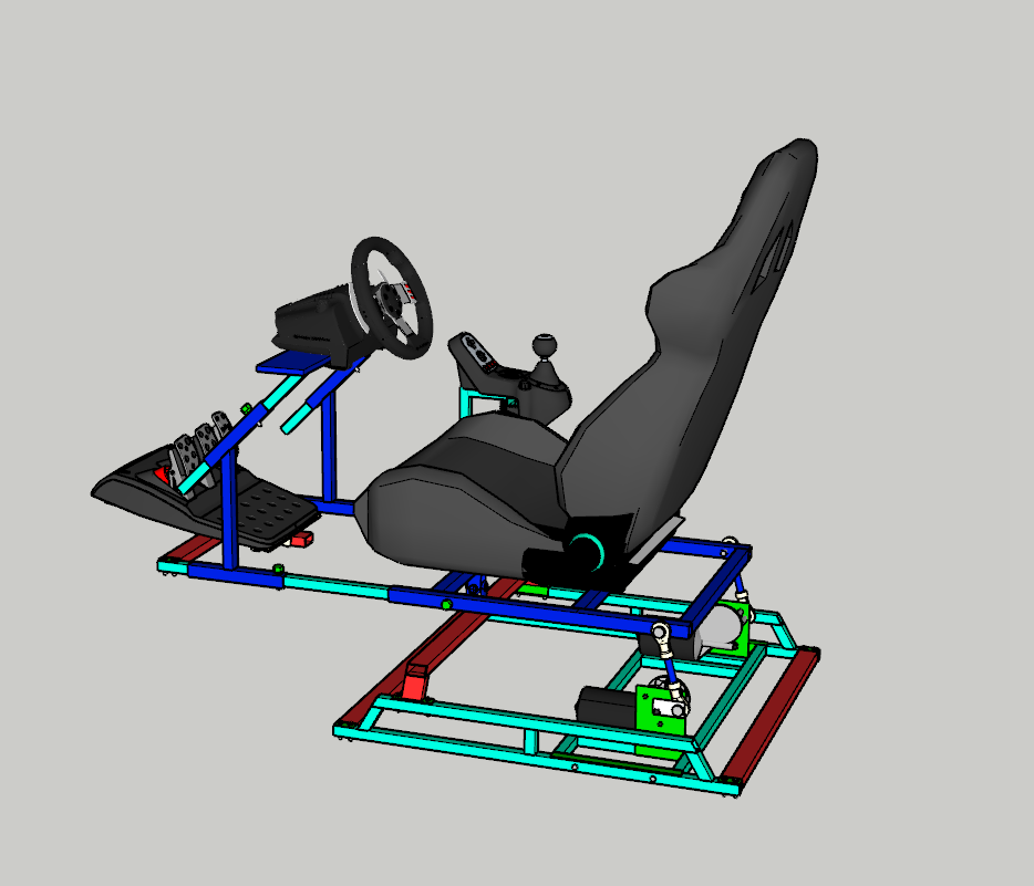

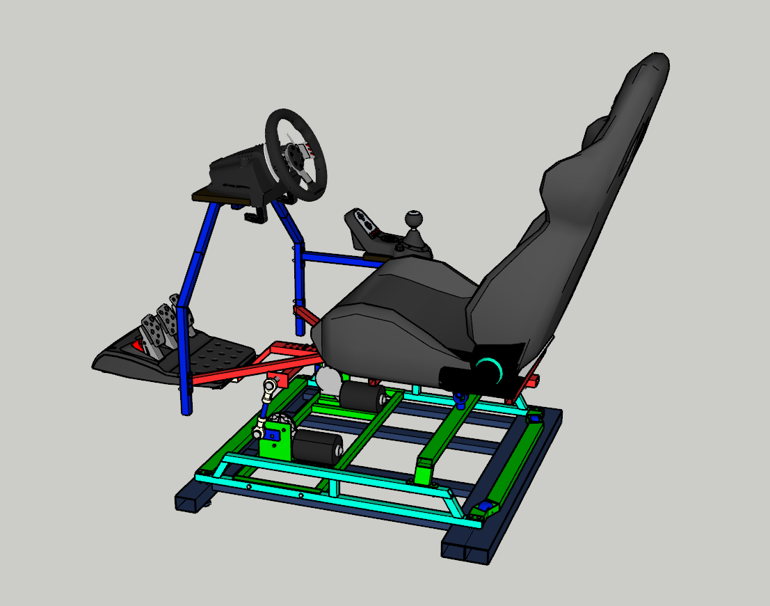

    I bring what I think will be the definitive model, I suppose that throughout the construction process there will be minor modifications.
  16. Israel Ventura
    Israel Ventura New Member
    Jan 25, 2020
    18
    España
    175Coins
    +16 / 0 / -0
    2DOF, DC motor
    I have opted for this composition with the idea that the front part, the one that supports pedals and steering wheel is removable and in pieces to store them easily and that way to use the asinto normally after playing.

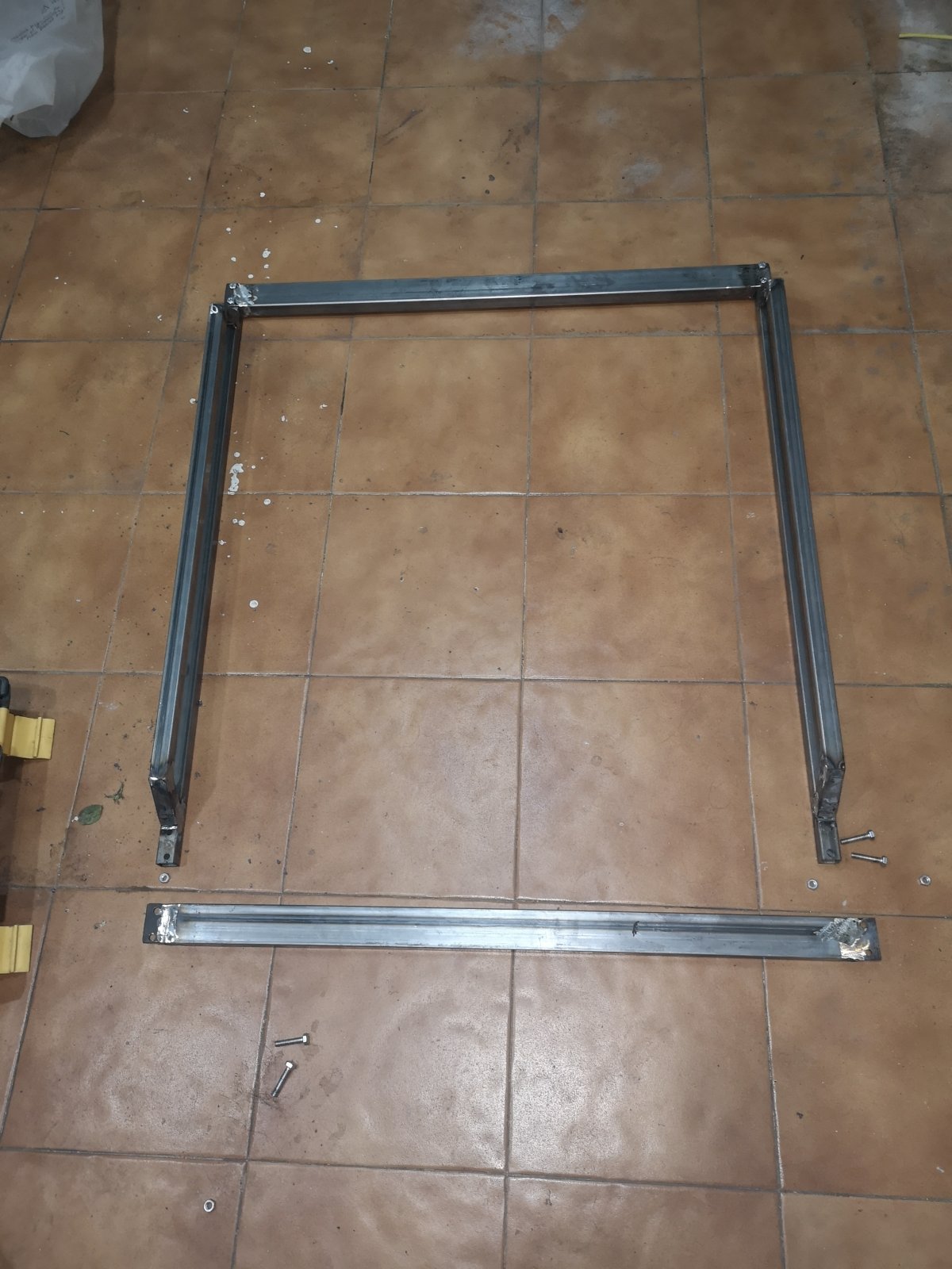

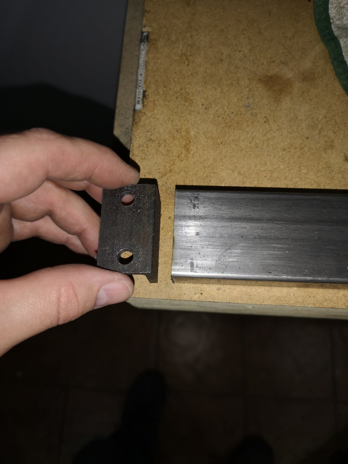

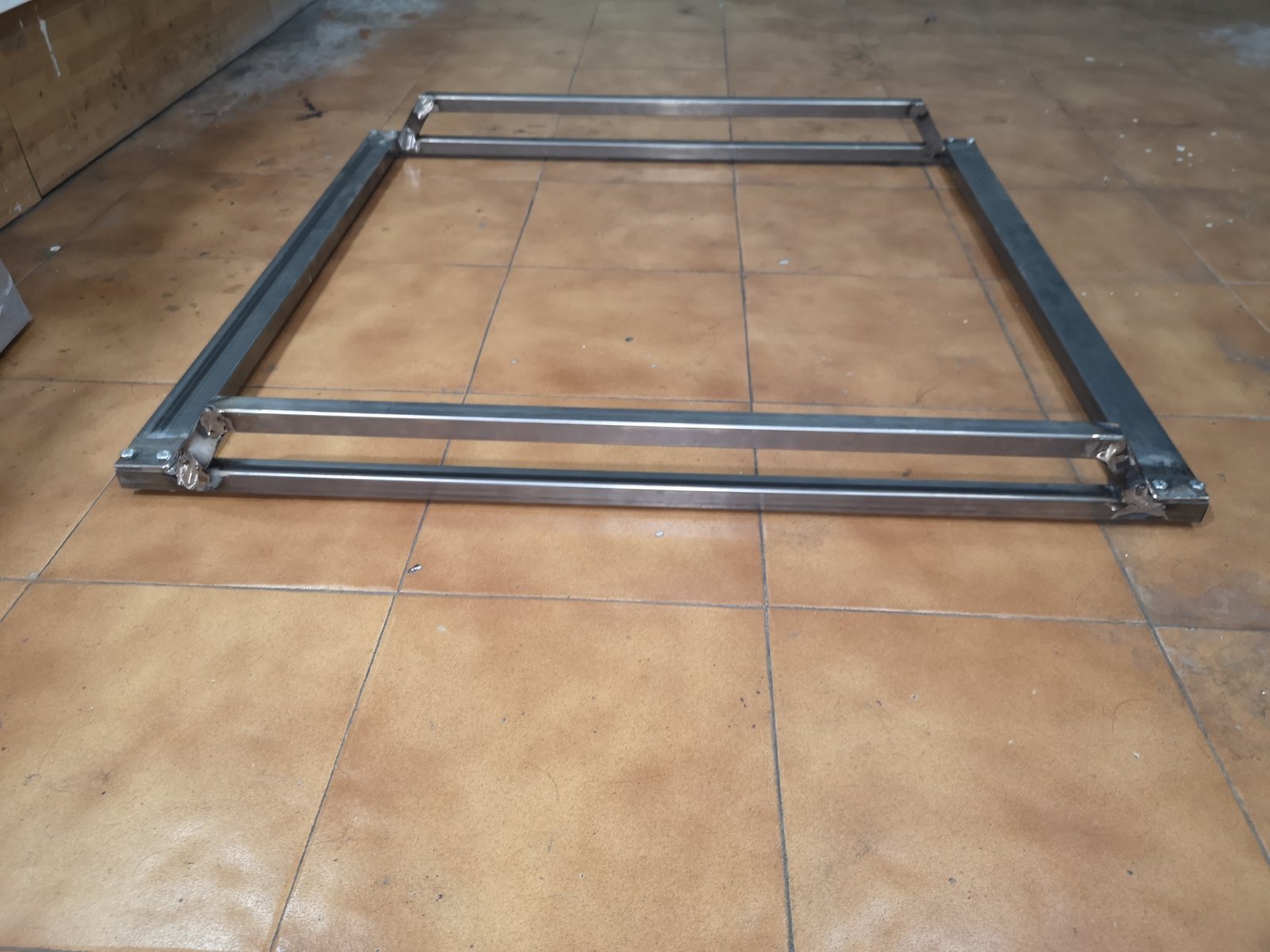

    I have been standing for a while, but I have resumed the project.

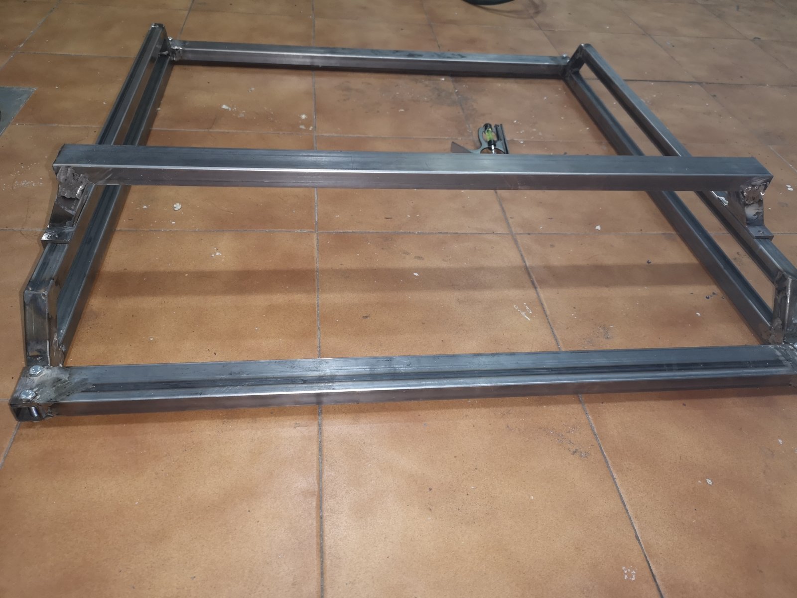

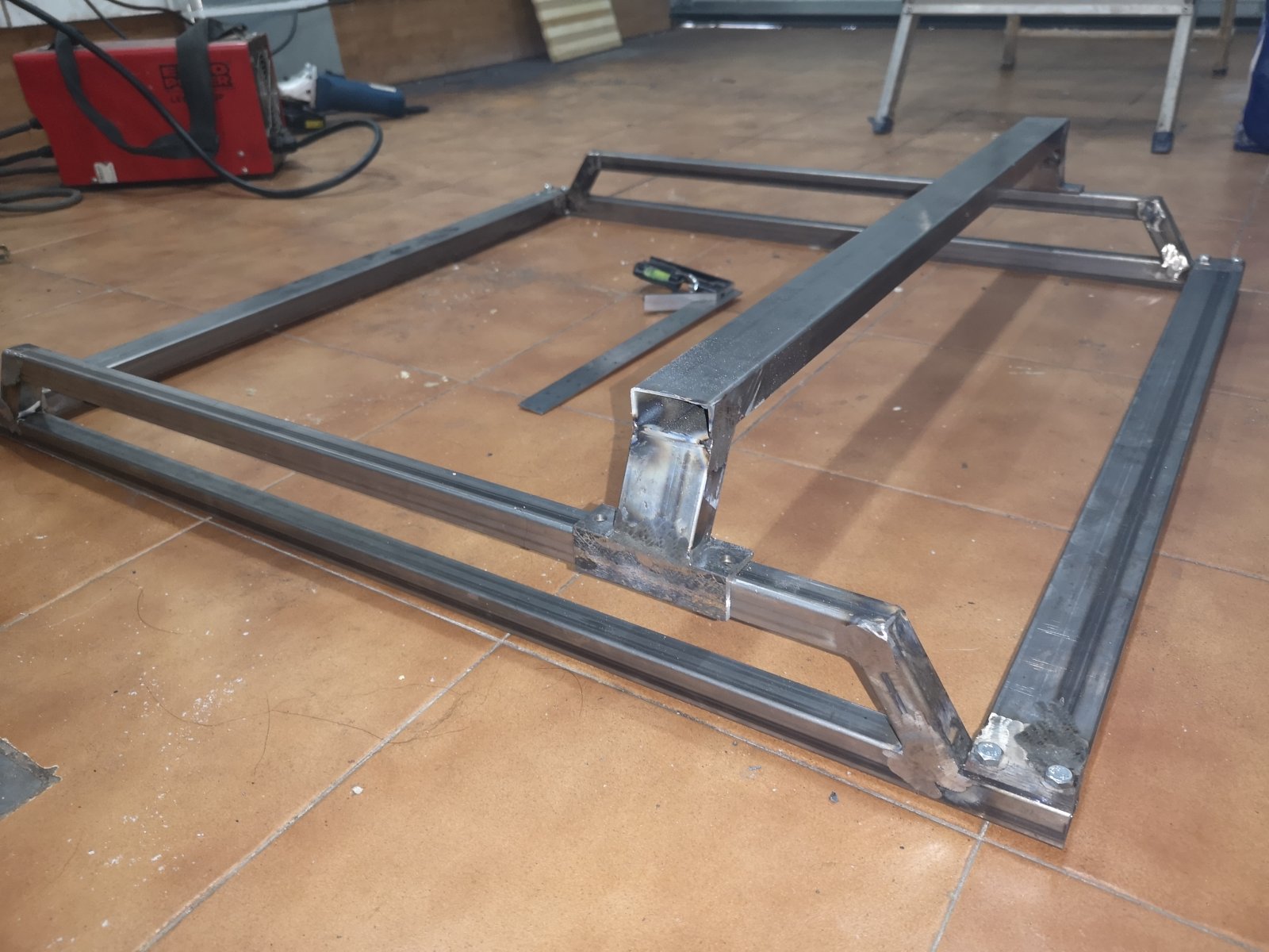

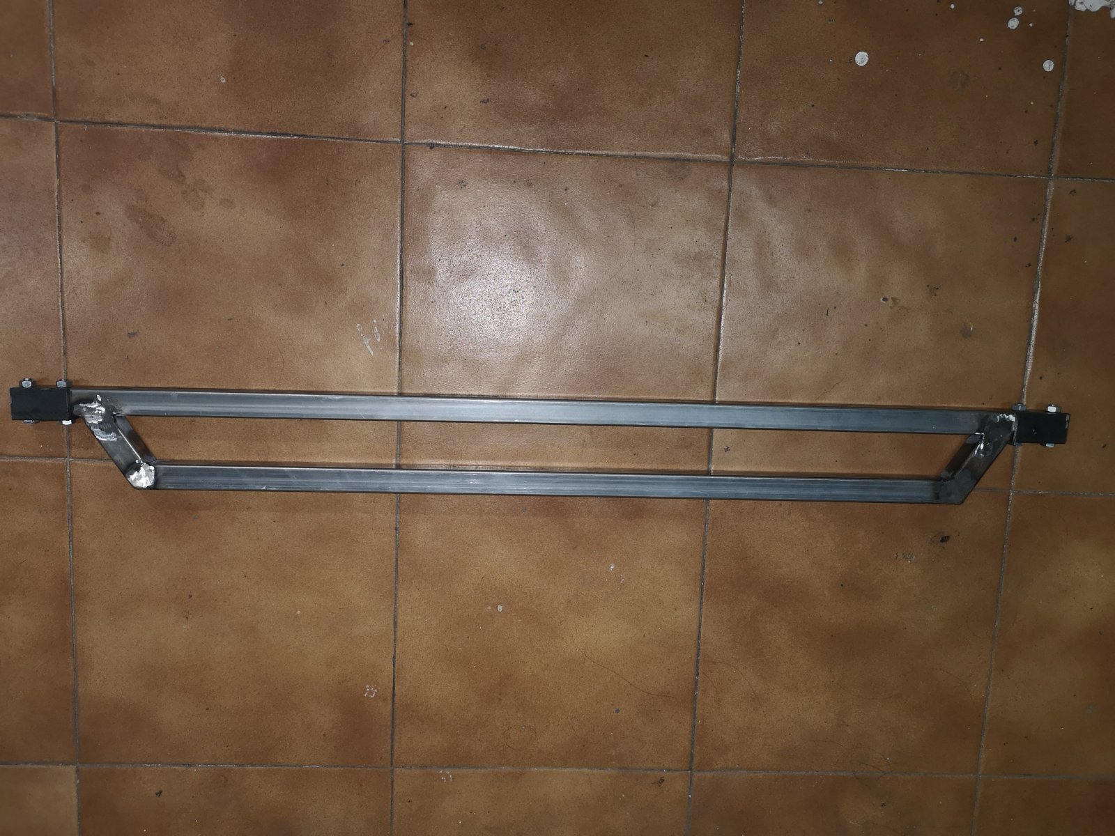

    The first photos of the base.
  18. Israel Ventura
    Jan 25, 2020
    18
    España
    175Coins
    +16 / 0 / -0
    2DOF, DC motor
    The first section finished. I keep moving forward.

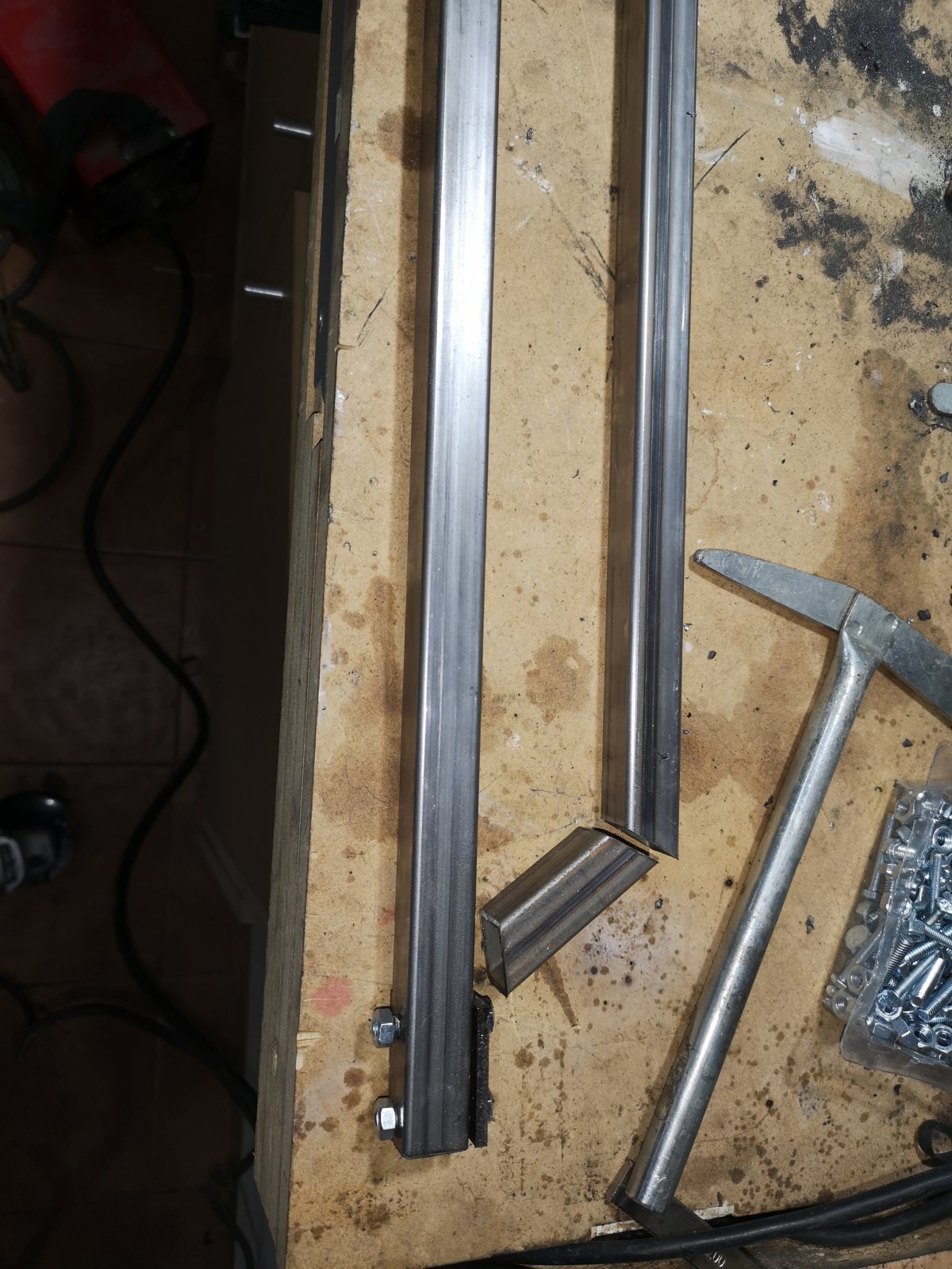

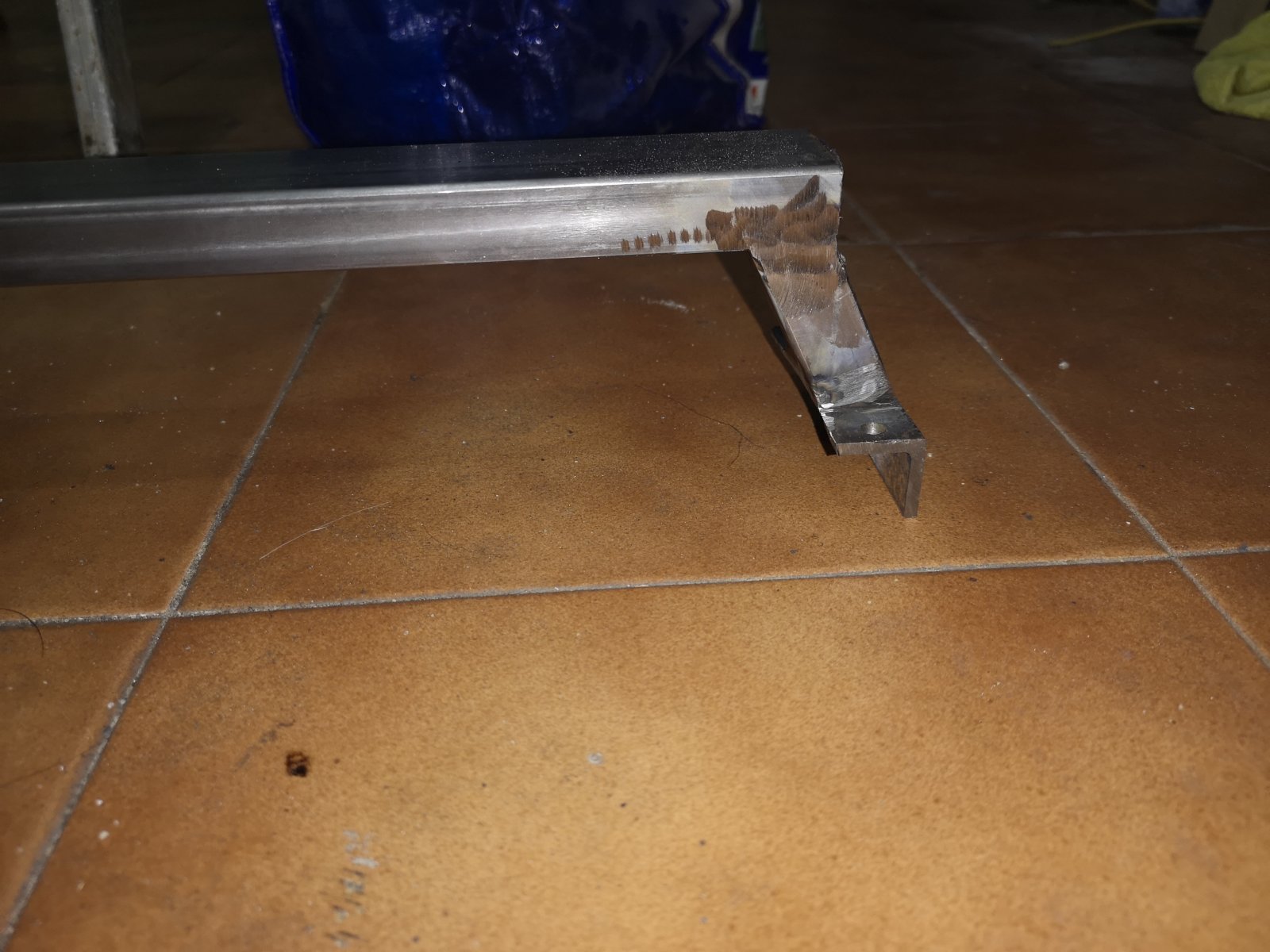

  19. Israel Ventura
    Jan 25, 2020
    18
    España
    175Coins
    +16 / 0 / -0
    2DOF, DC motor

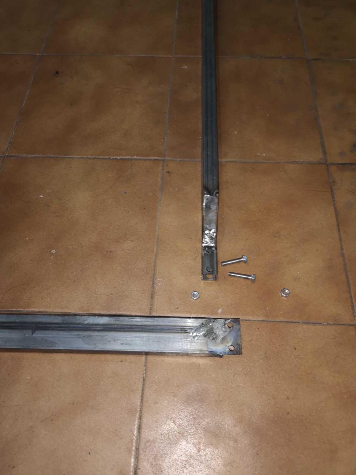

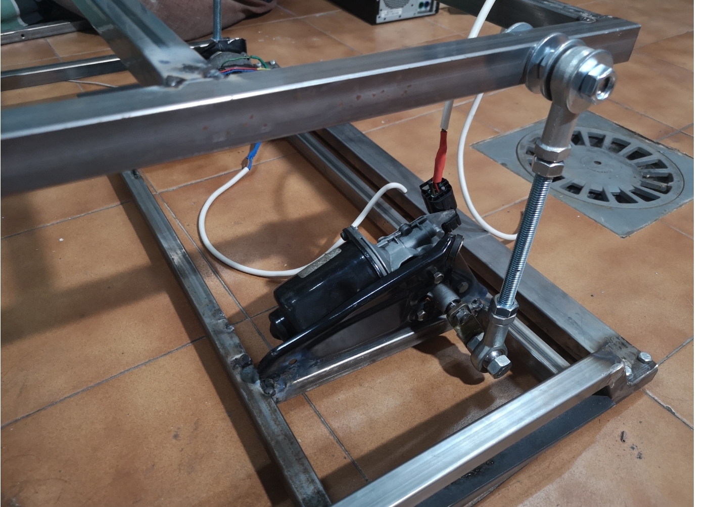

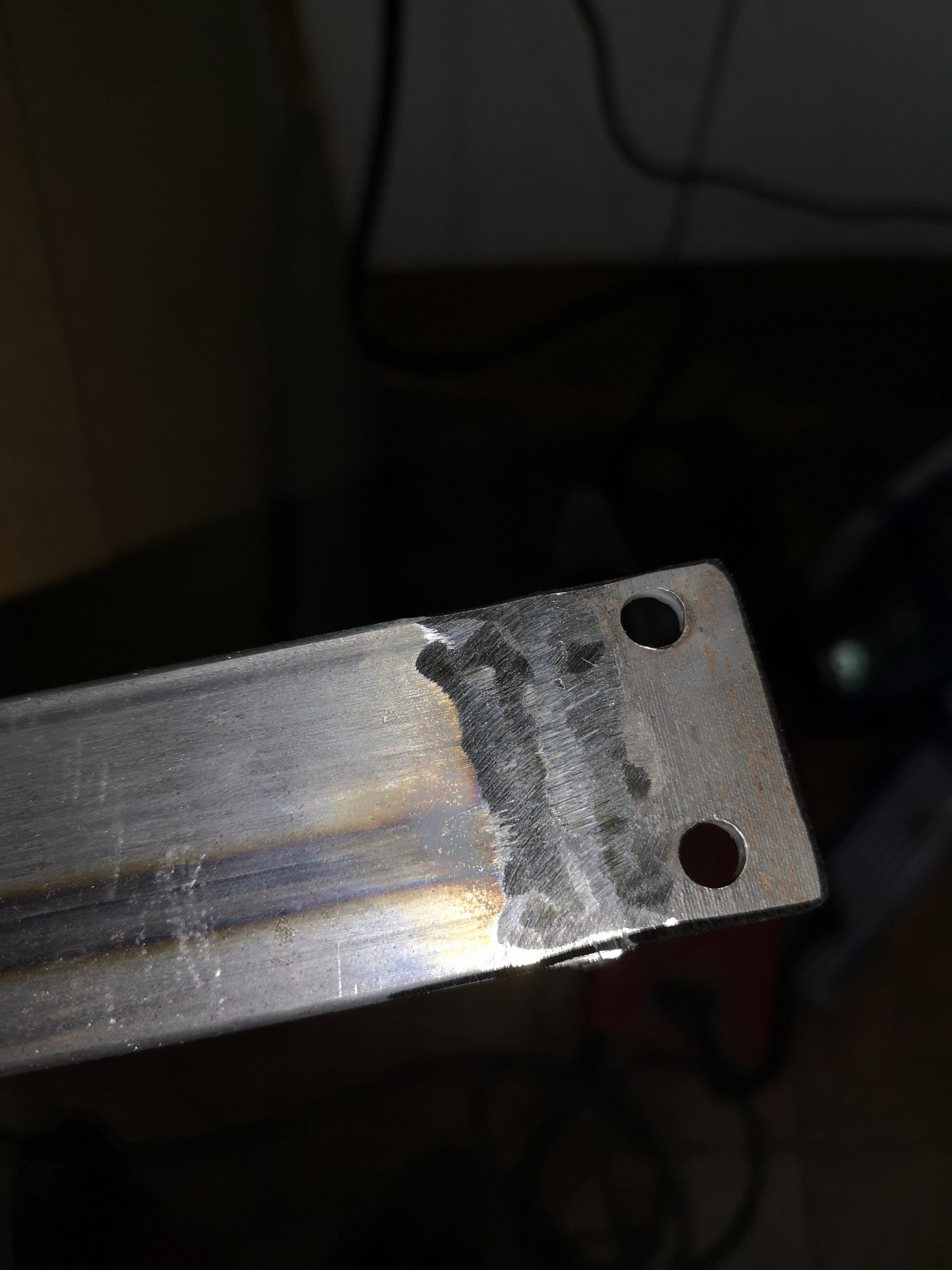

    Some more photos

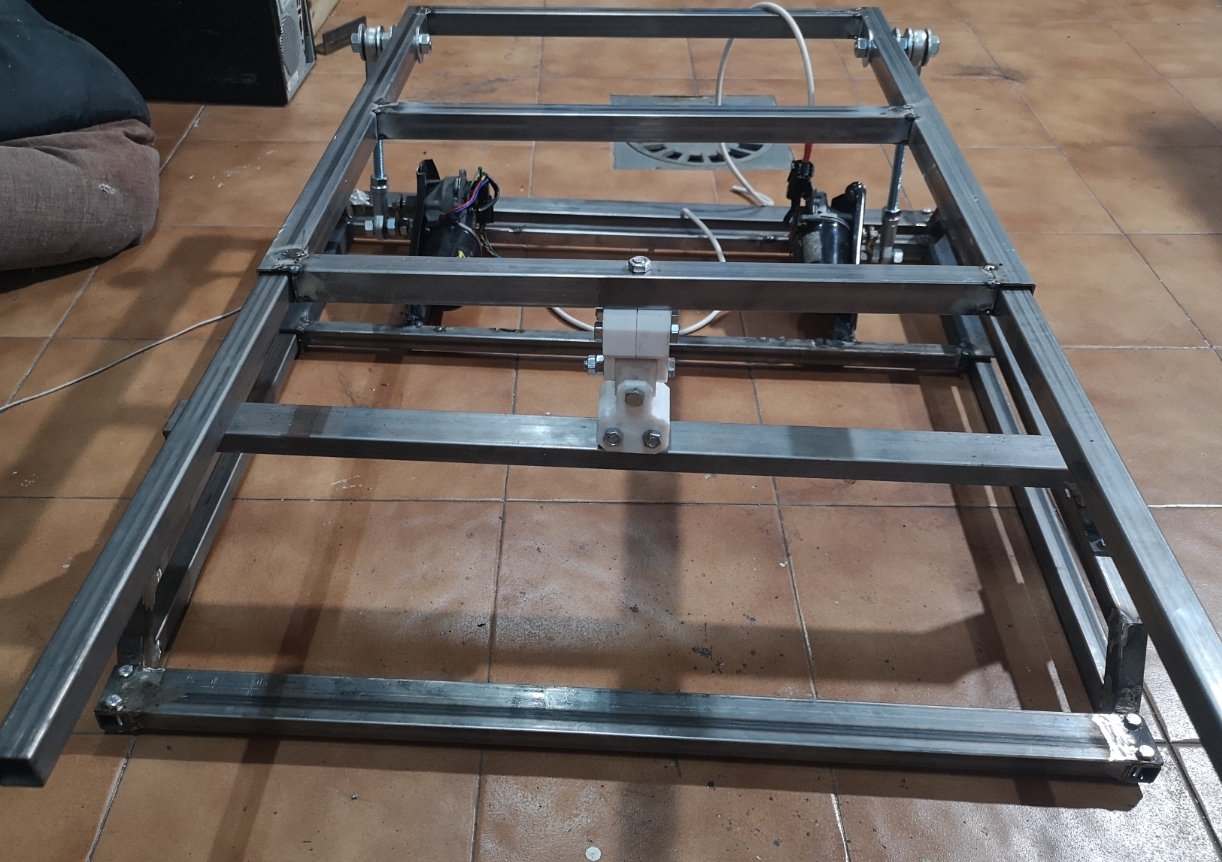

    Due to the pandemic the project had to be postponed, it was a risk to work with tools and that a mishap could occur that would require going to a hospital.
    In these last weeks I have returned to the project.
