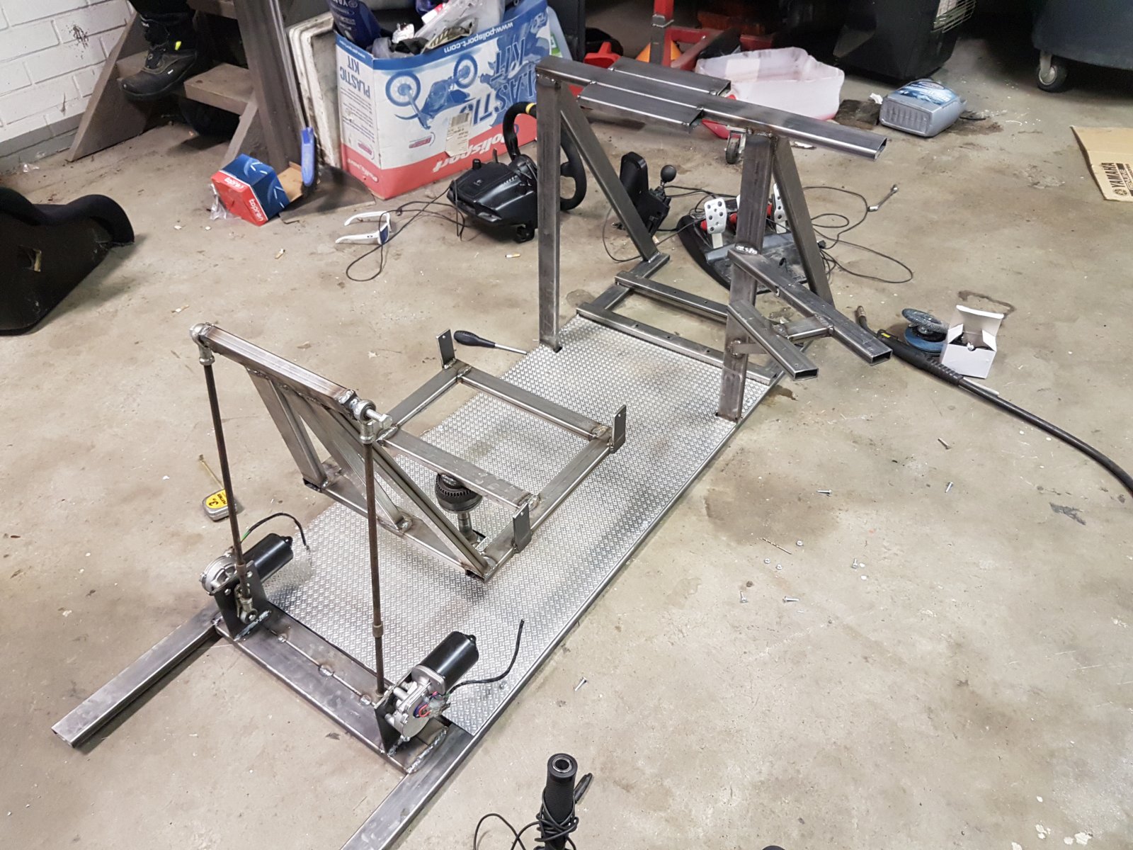

    any help this problem i have.. using windshield wipers and arduino/motomonster
    just got my rig "working" but the problem is when motors go just a little down at the midlepoint they get stuck. i have to manually move the motors up and they stops at the midlepoint. up they work fine put down it stuck's
    im using racingmat code

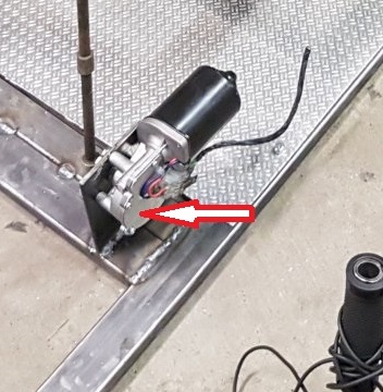

    wiper motors may have an internal stop position where that is related to the actual lowest point of the wipers on the car front shield ... make sure you eliminate those position contacts and have a continuous connection to the motors that makes them rotates endless ...

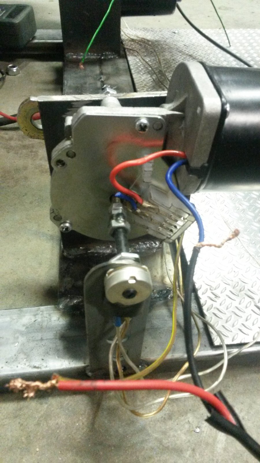

    please post some pictures of the motors :)
    and yes, it's mandatory to check (and remove) motor case grounding!

    yeah we did that..still wont work. it tilts forward and back to center but when we tilt it all the way back it stuck's there and it wont tilt back to center
    i dont have better pic now :(

    just remove that cover and you'll see what I mean ...
    BTW ... those motors could cause a short circuit to the metal chassis as you use +ve and -ve to their body when forward and reverse the direction ... use proper insulation from the chassis .

    done all that..this is how it's now. no short circuits..all wiring is ok.. when it tilts back it doesn't go all the way pot's max limit when it stuck's
