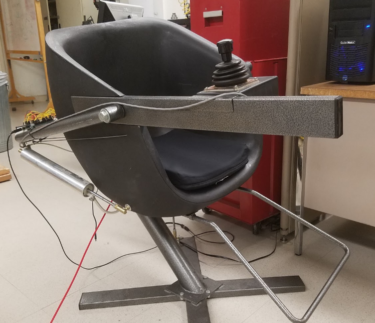

    My group of 3 mechanical engineering students are working on a DIY motion simulator using compressed air and pneumatic pistons for our senior design project. The chair includes 2 solenoid valves, 2 linear potentiometers, an arduino mega, and a serial to usb converter.
    The above picture has an old joystick that was originally programmed to work with X-Plane using an arduino header file called ArdSim.h. We however converted the code to work with simtools instead. The Joystick has since been removed and replaced with a HOTUS and a camera threaded pole for the oculus rift sensor.

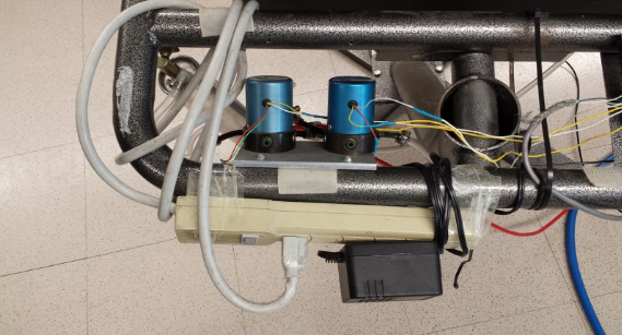

    The two solenoids used to control the two pneumatic pistons.

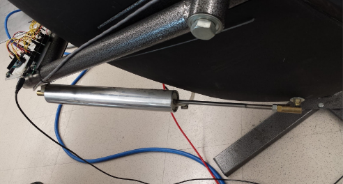

    The pneumatic piston used for pitch. The string above is attached to one of the linear potentiometers.
