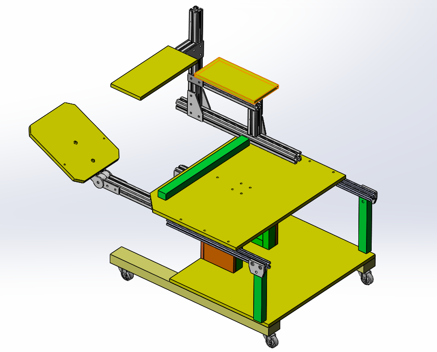

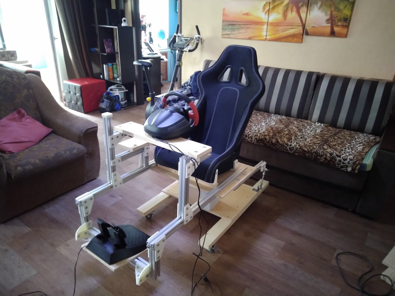

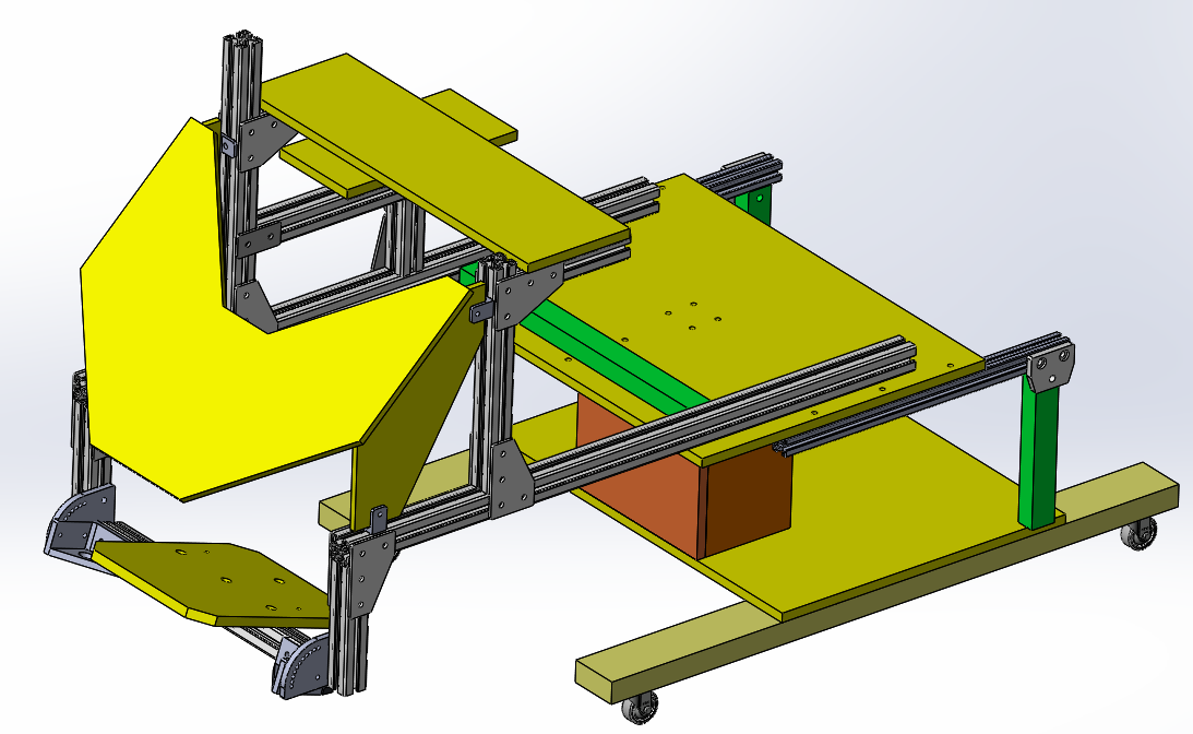

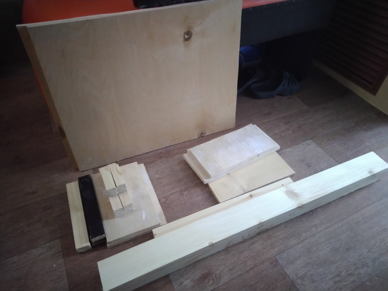

    Good afternoon! I am writing via google translate. I want to do 6DoF construction, but for now I decided to start small and do 2dof construction. And so less words, more pictures !!!

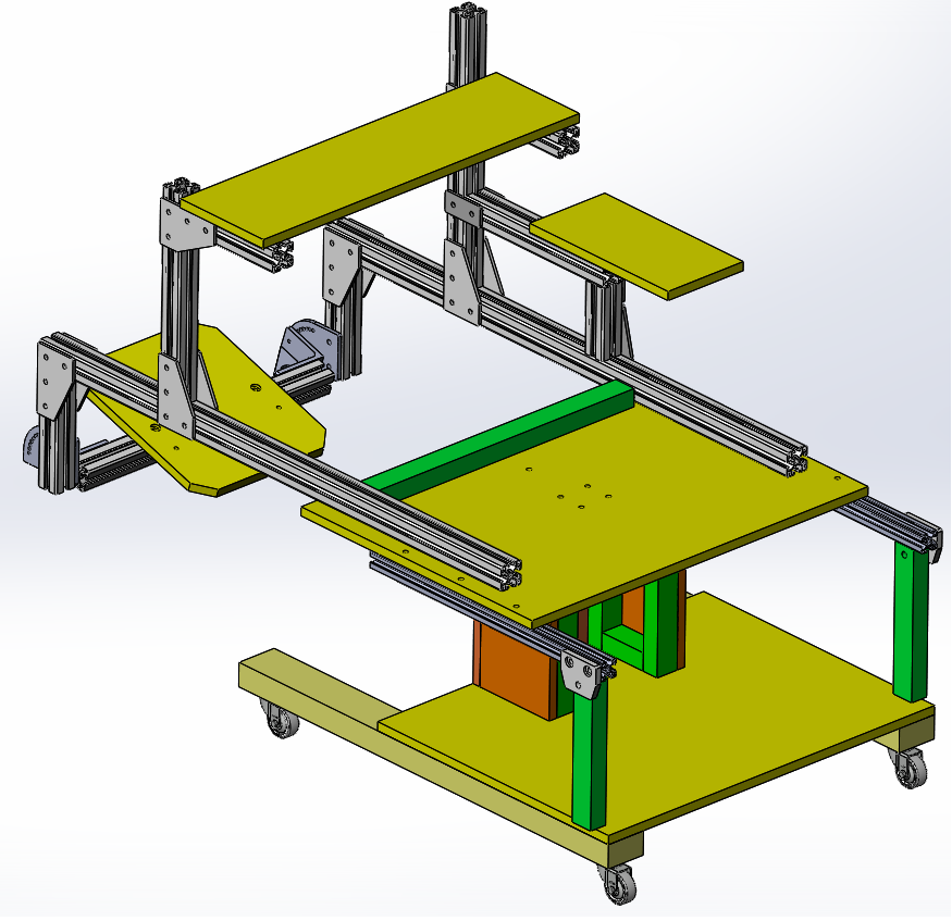

    1. Drew the model. No engines yet;)

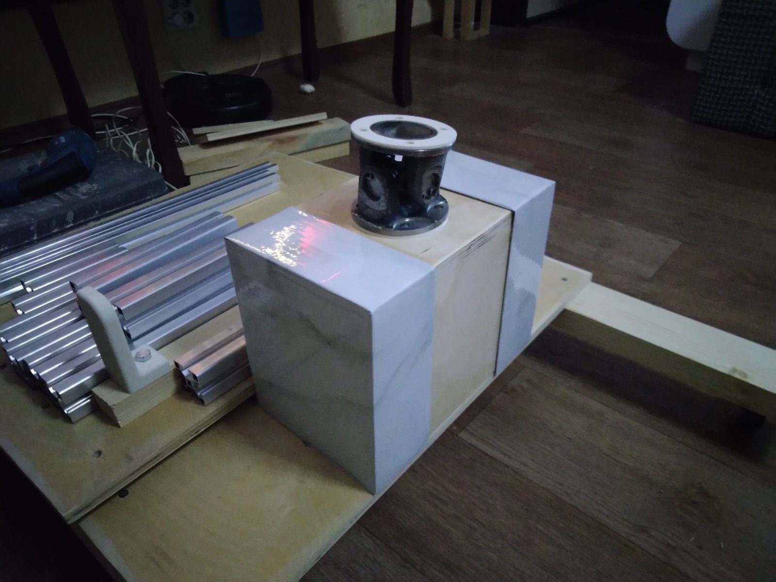

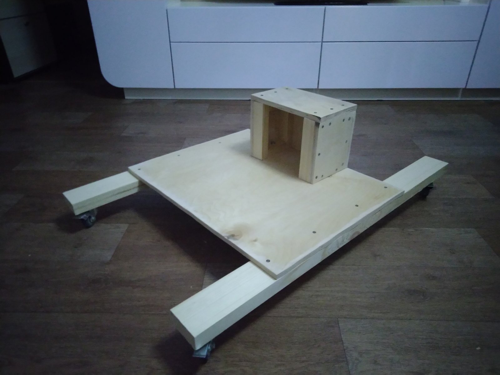

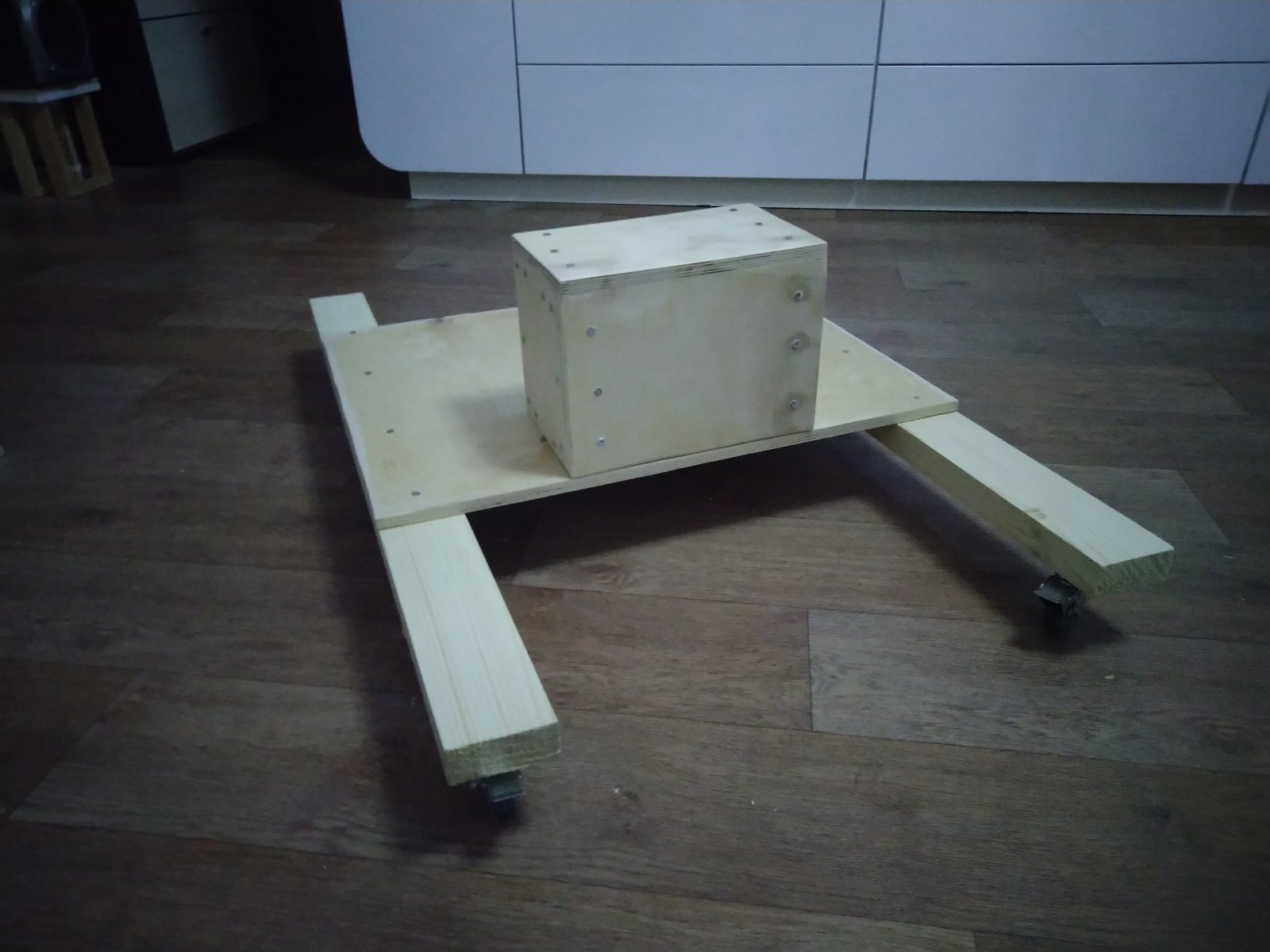

    1. Sawed plywood and wooden blocks

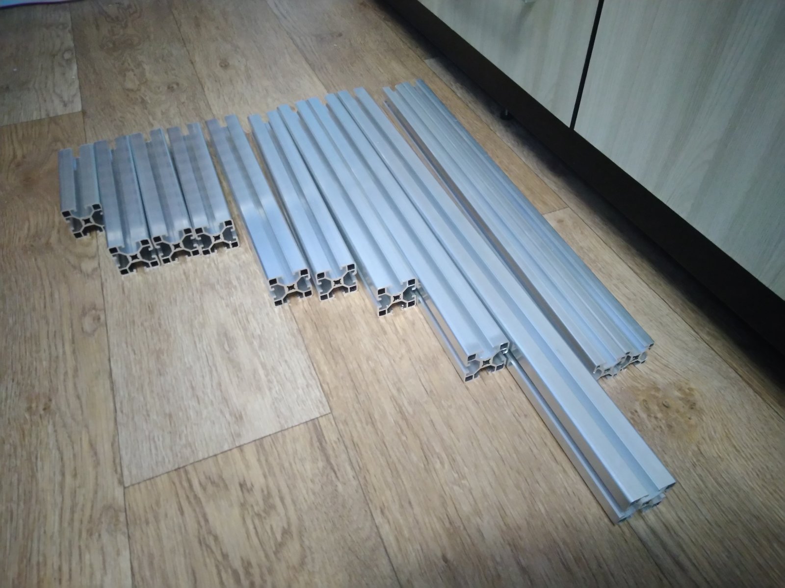

    3. Cutting aluminum profile

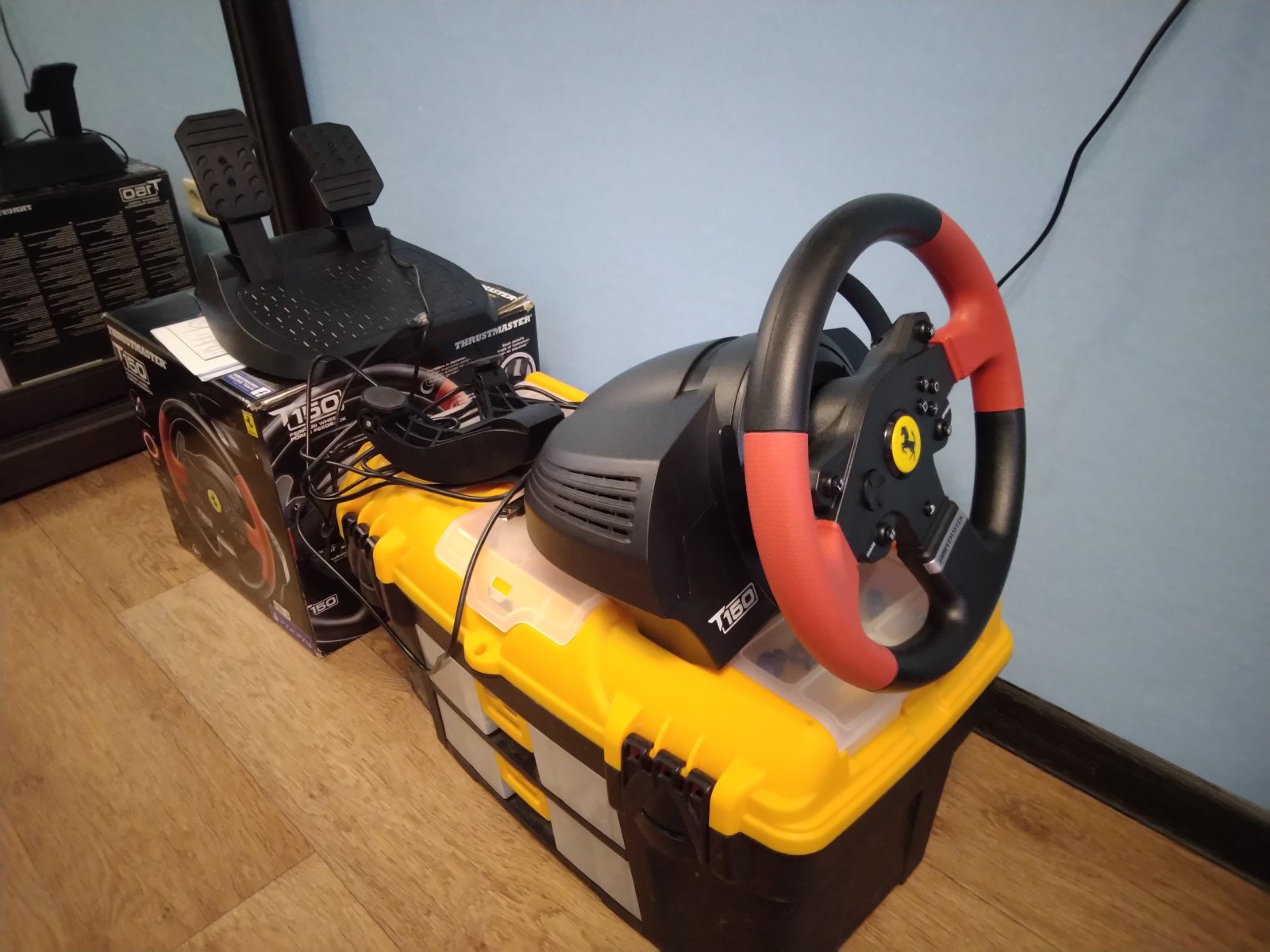

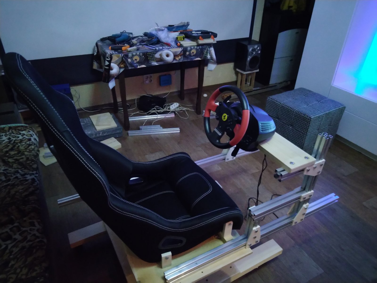

    4. Bought a thrustmaster T150 steering wheel

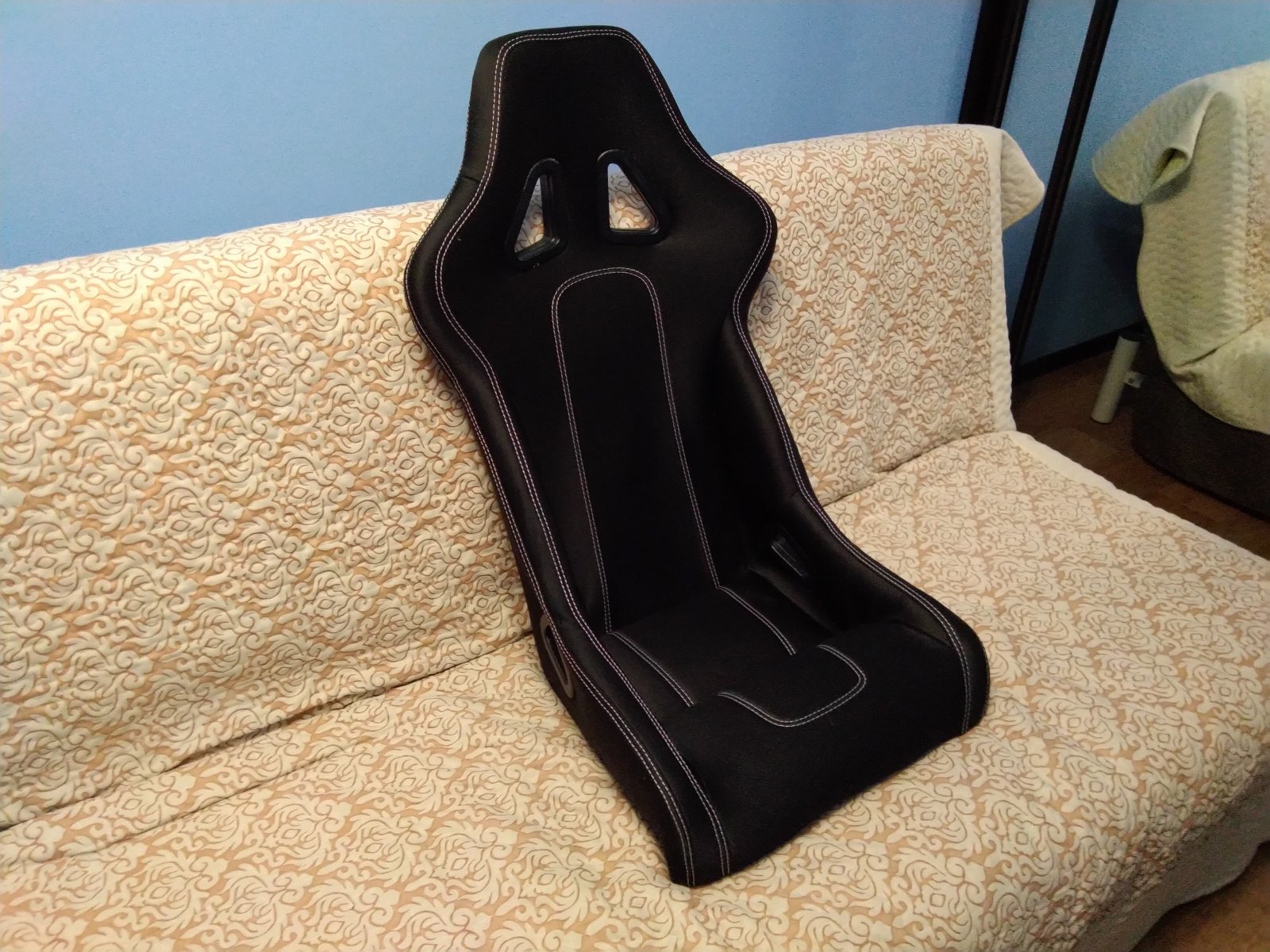

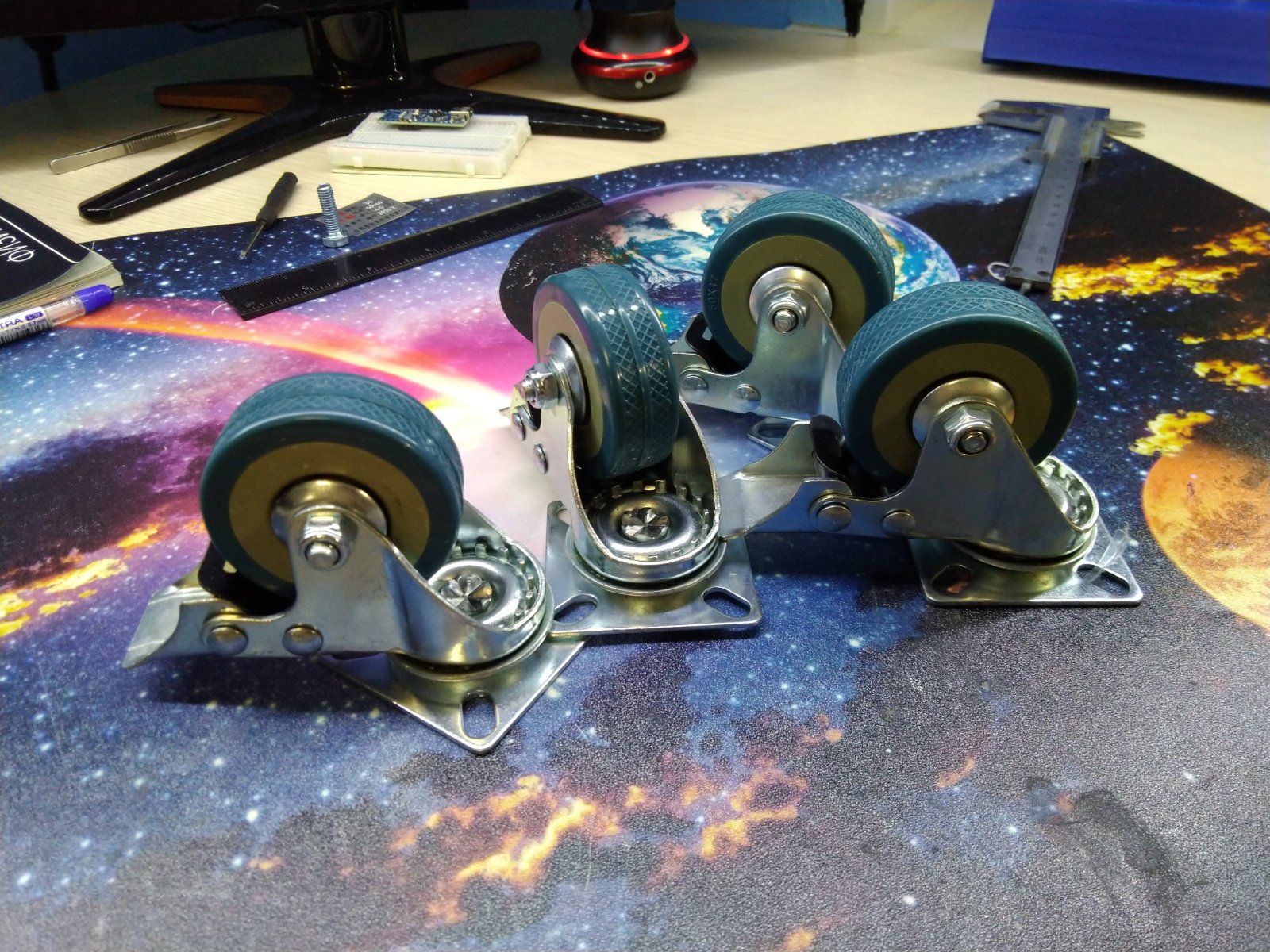

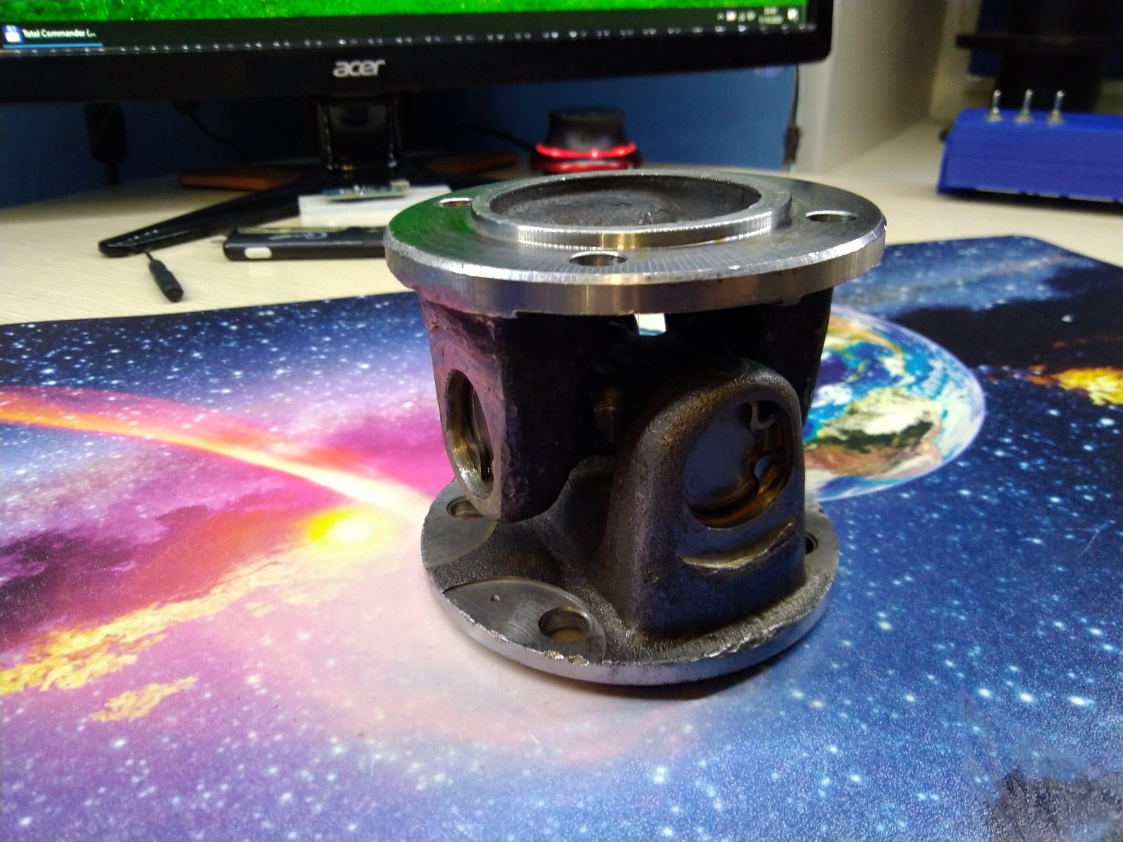

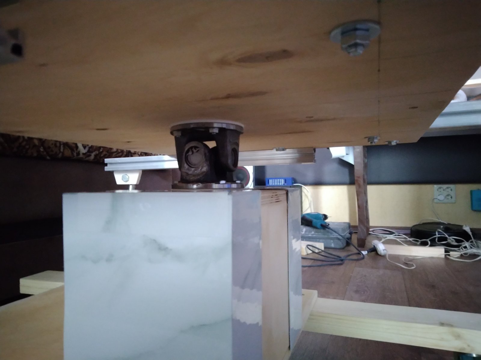

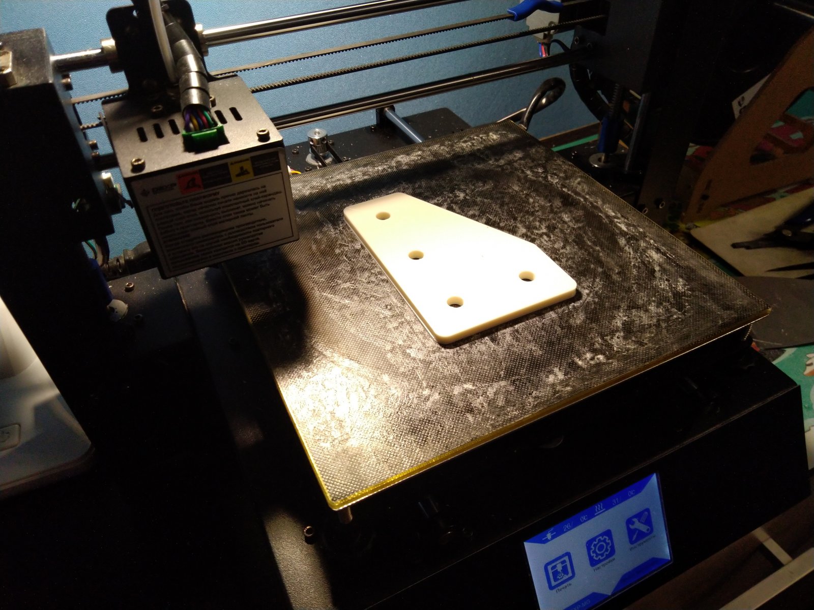

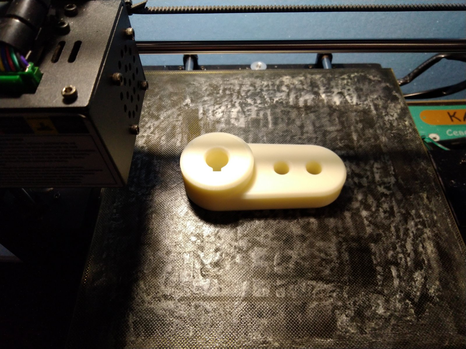

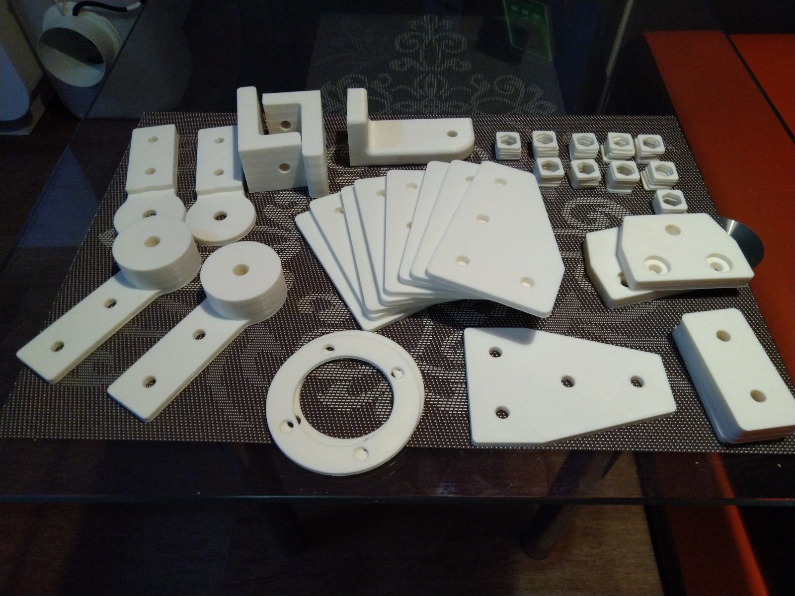

    8. I am 3D printing various parts IMG_20200930_225954.jpg IMG_20201024_221338.jpg

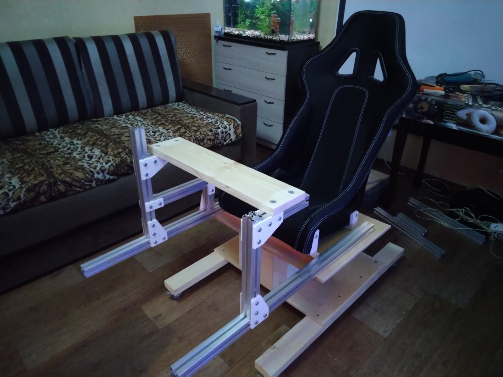

    Tomorrow I'll go buy bolts and nuts :)
    To be continued: show your teeth

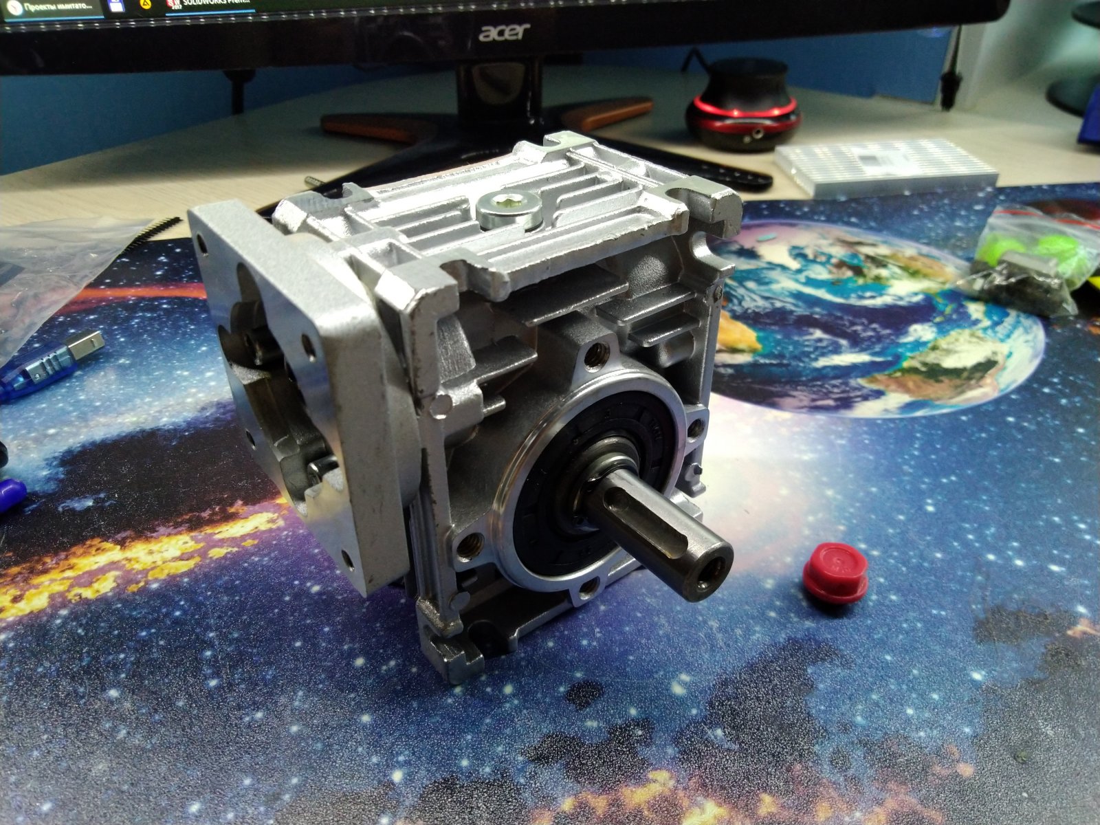

    I want to use 188W BLDC motors and RV030 worm gearboxes

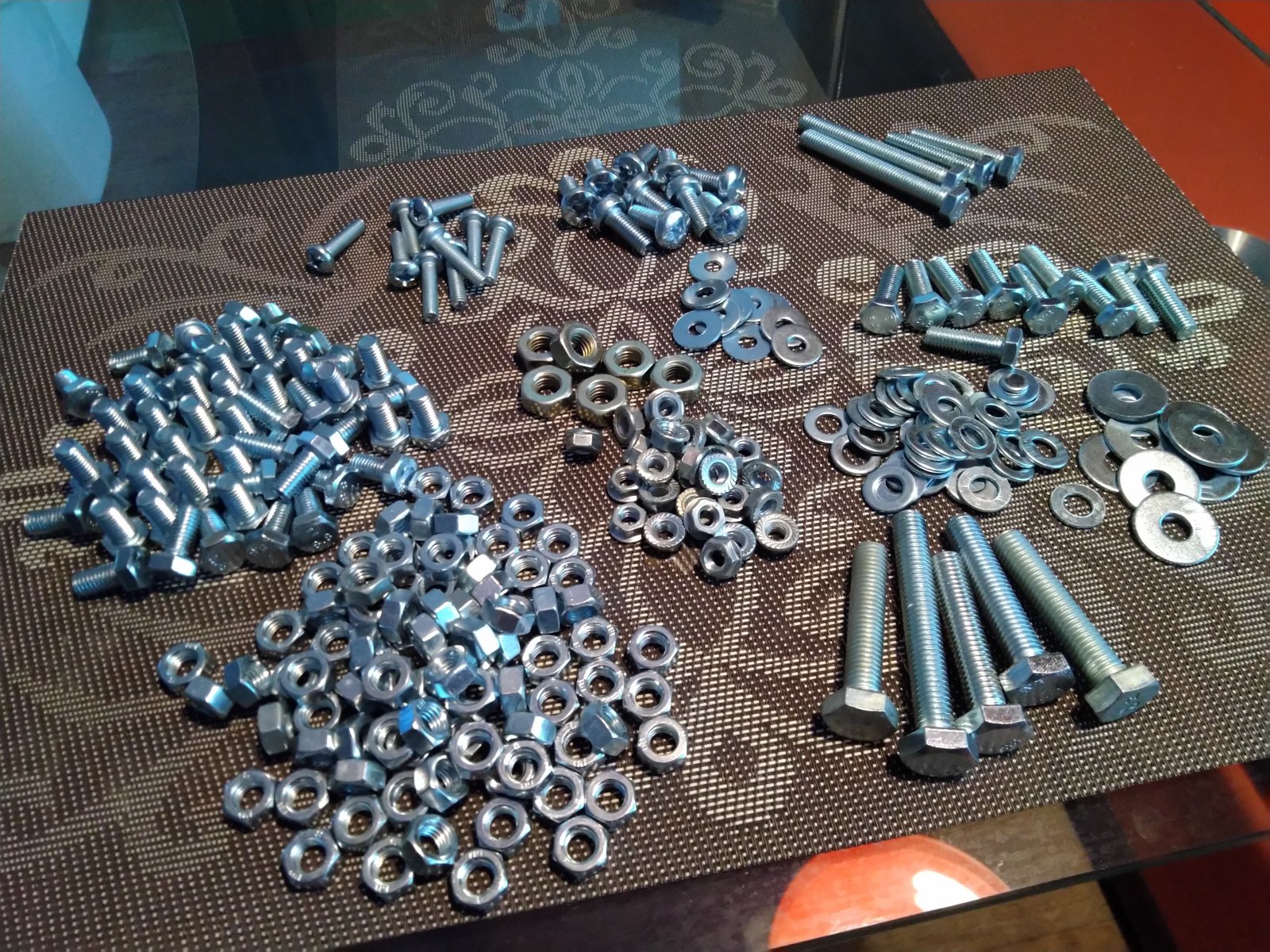

    Bought bolts and nuts

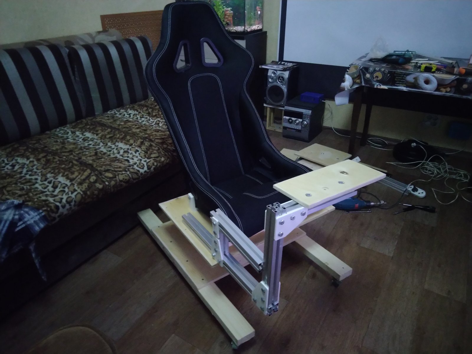

    Pre-assembled the structure. With active steering, the rigidity of the structure is not enough IMG_20201025_210530.jpg
    Drew a new reinforced model
  5. Michael_miass
    Michael_miass West
    Nov 16, 2019
    145
    Russia, Miass
    725Coins
    +175 / 0 / -0

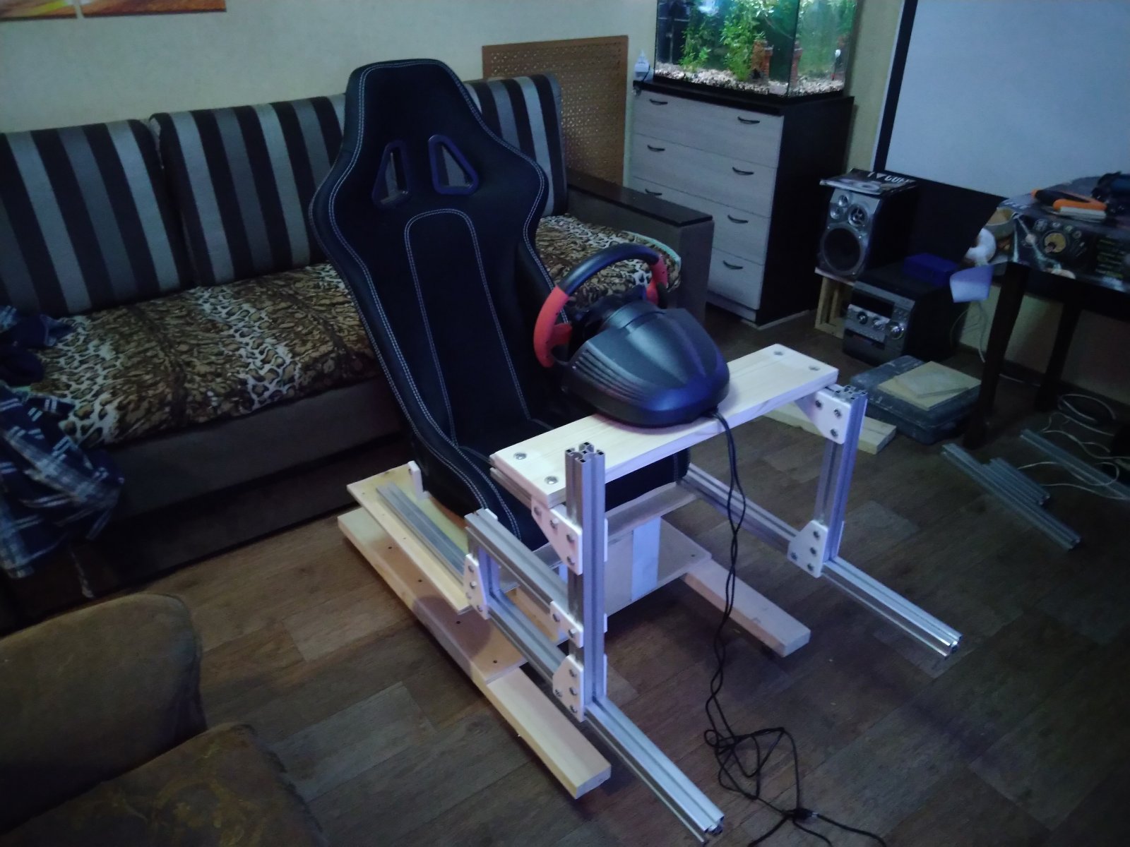

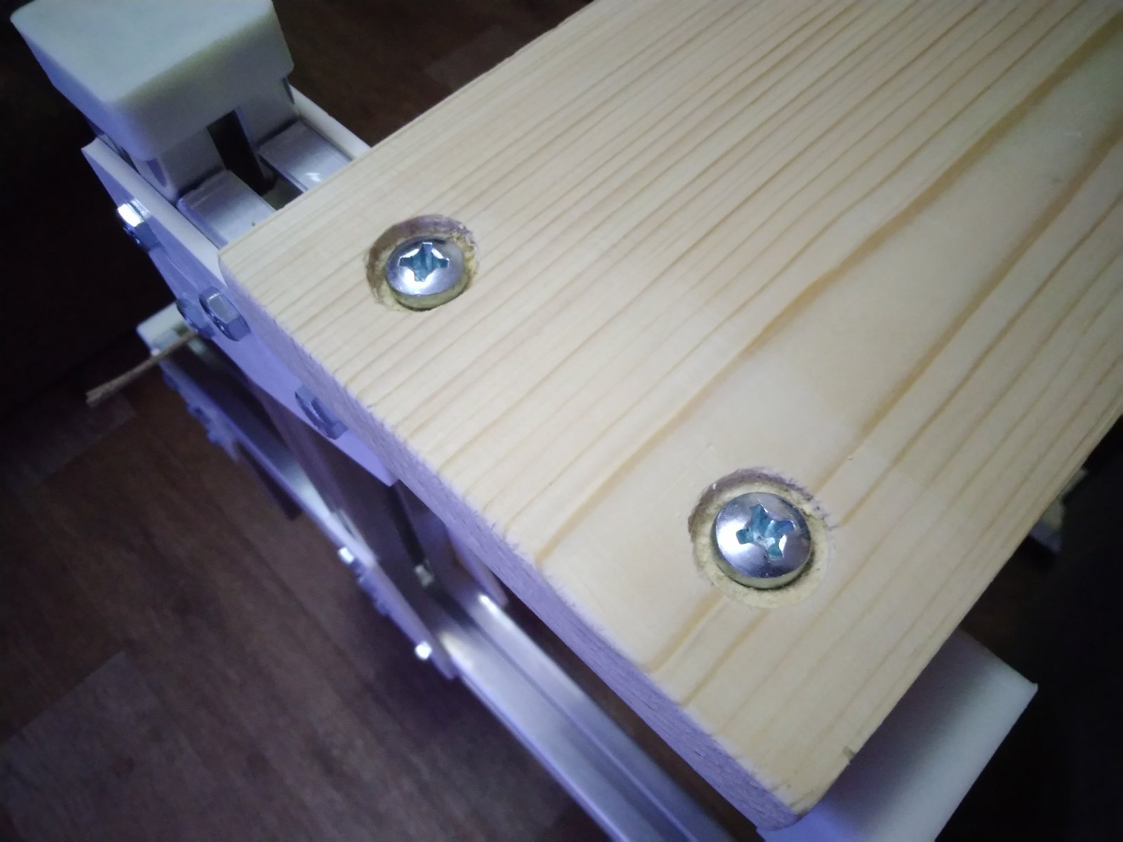

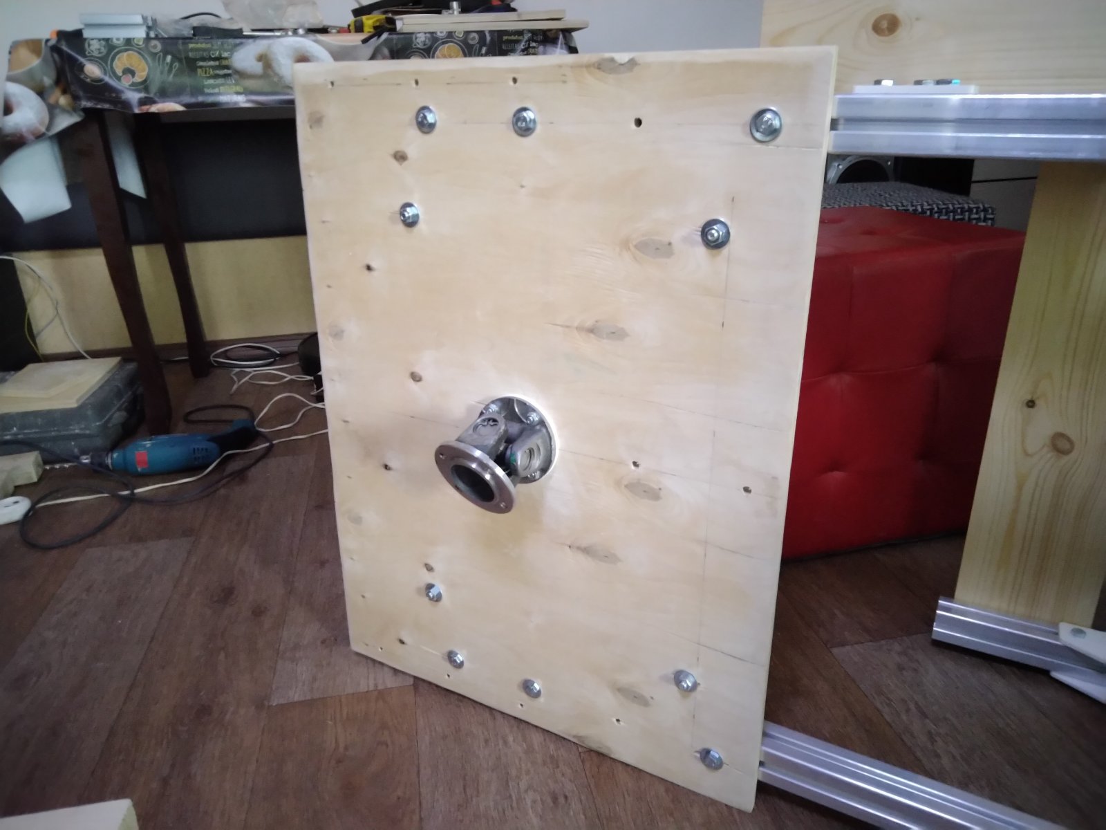

    I tried on the hinge on the base

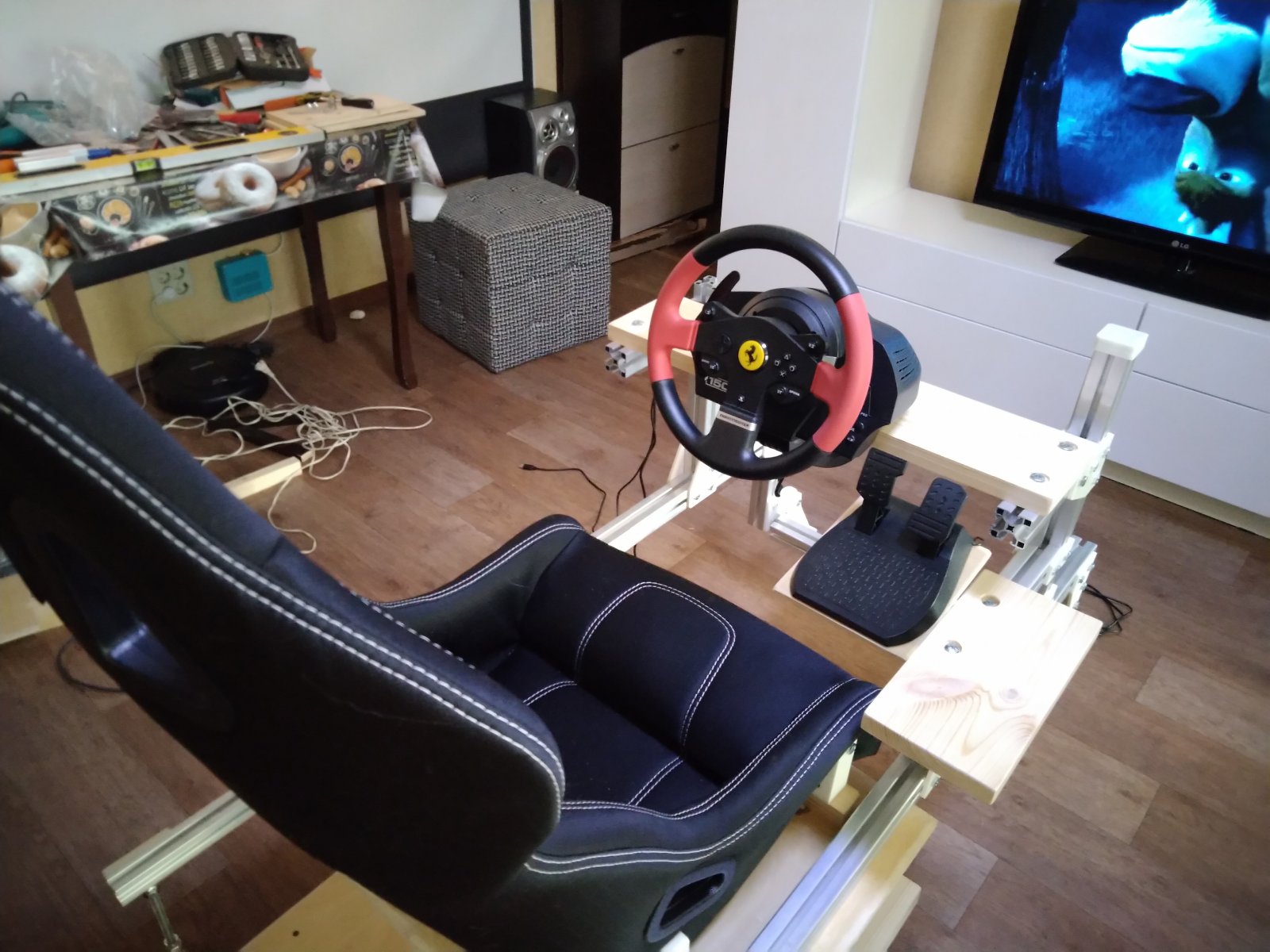

    Assembled a reinforced structure. The construction is rigid and reliable. I'm happy as an elephant :grin. Tomorrow I will assemble a block with pedals and look for the center of gravity.

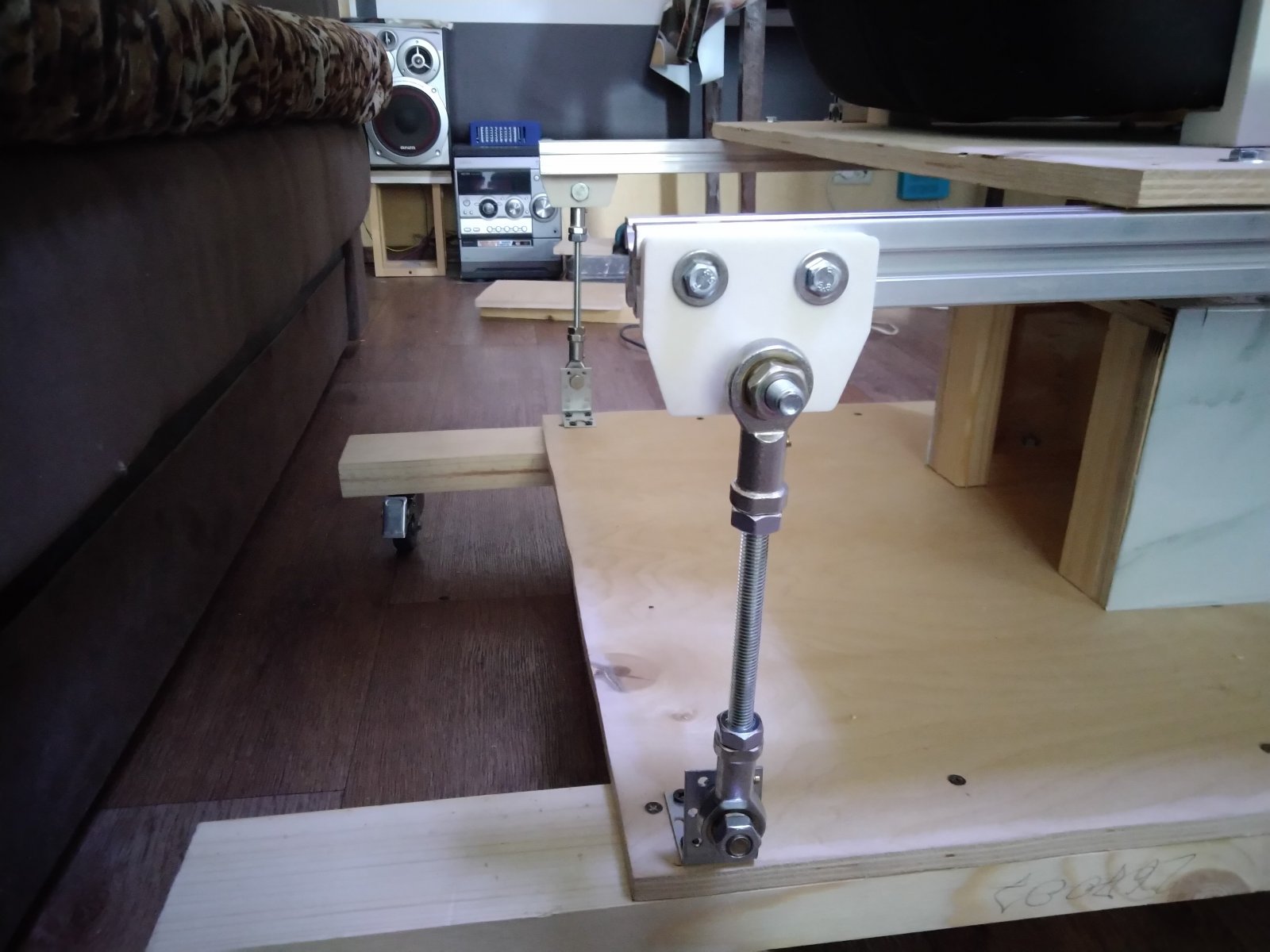

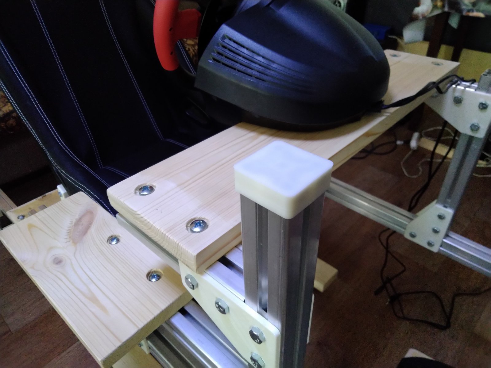

    Found the center of gravity using a pipe and installed a hinge there

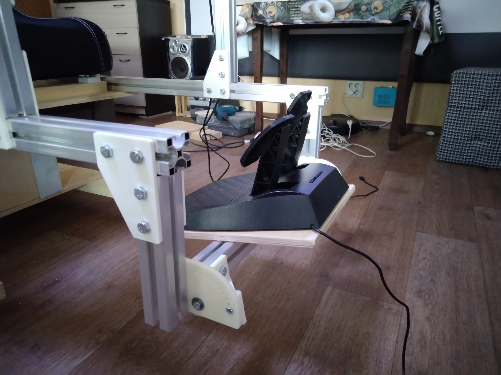

    Installed pedals
    Printed on a printer a cap for an aluminum profile
    Installed traction
    Here are some more photos
  7. SeatTime
    2,573
    What gearbox ratio are you going to use to drive this? The drive point you have chosen will require quite a bit of torque.

    I want to use a 40: 1 gearbox

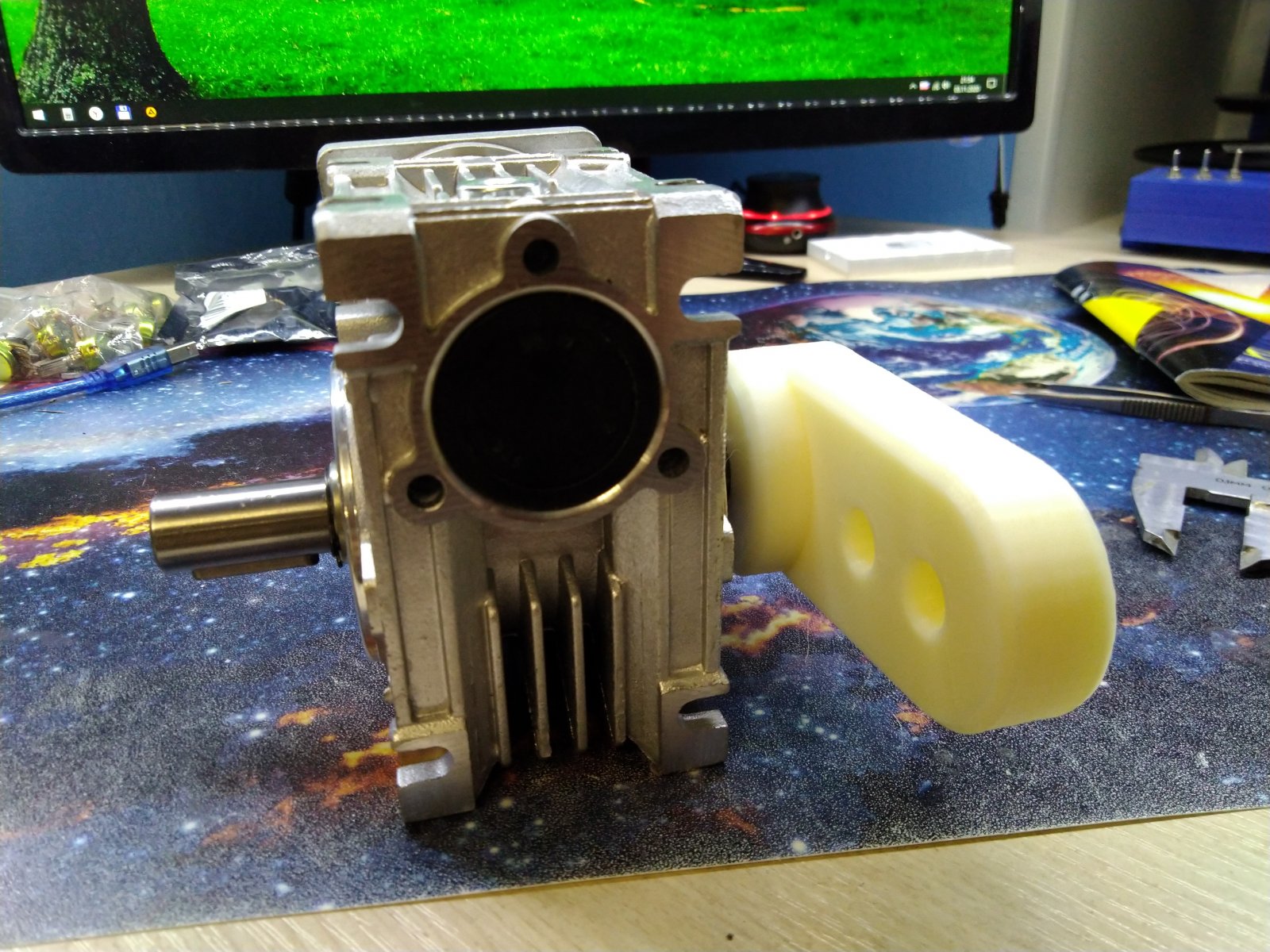

    Photo of the gearbox RV030 ratio 40 from aliexpress
    Have a question. Should the red plug be screwed in instead of the screw on top? There is a hole in the plug. What is this for? for the reducer to breathe

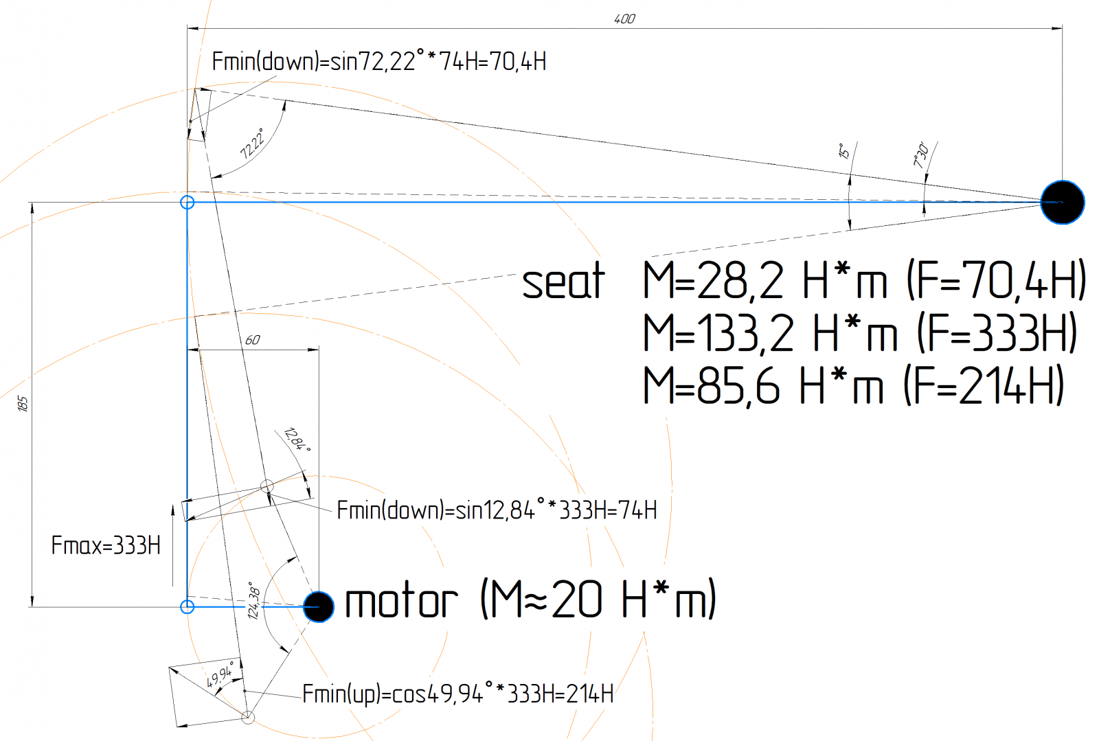

    I counted the efforts on the rods. With a torque on the gearbox of 20N * m, the maximum force on the crank is 60 centimeters - 333 N. At the bottom point when moving upwards - 214 N. At the top point, the worst situation is the effort just taking into account two angles 70.4N

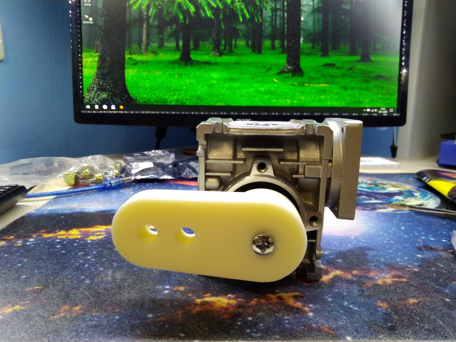

    Unsealed and installed the crank

    Printed with ABS plastic, 60% filling. I think this will be enough

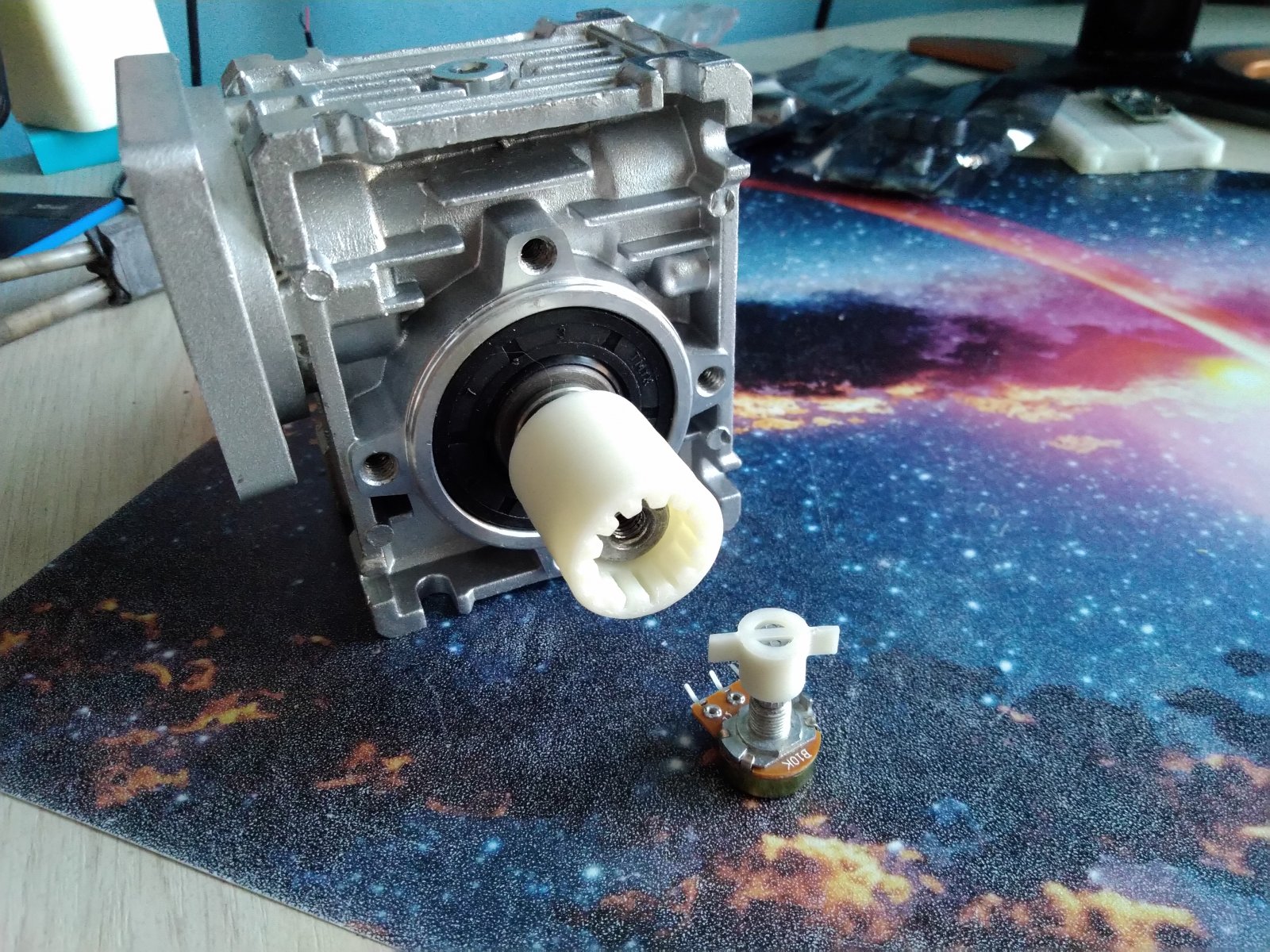

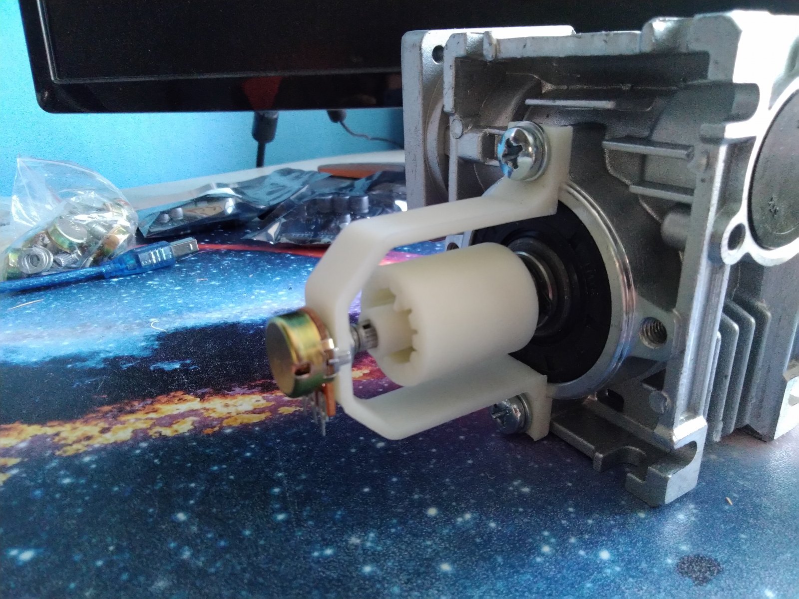

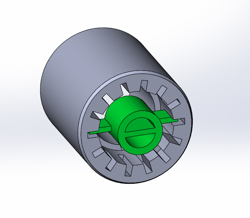

    Potentiometer coupling. The legs of the green part break faster than the potentiometer. Everything is attached to the gearbox.

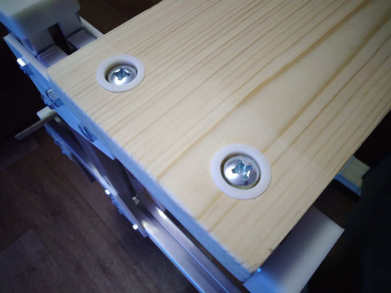

    While I'm waiting for the drivers motor, I printed more rings for screws
    It was
    became

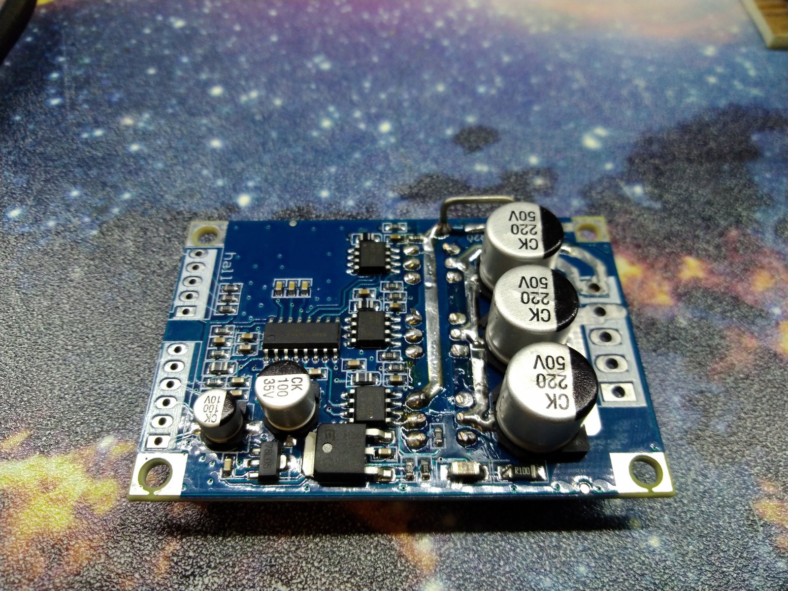

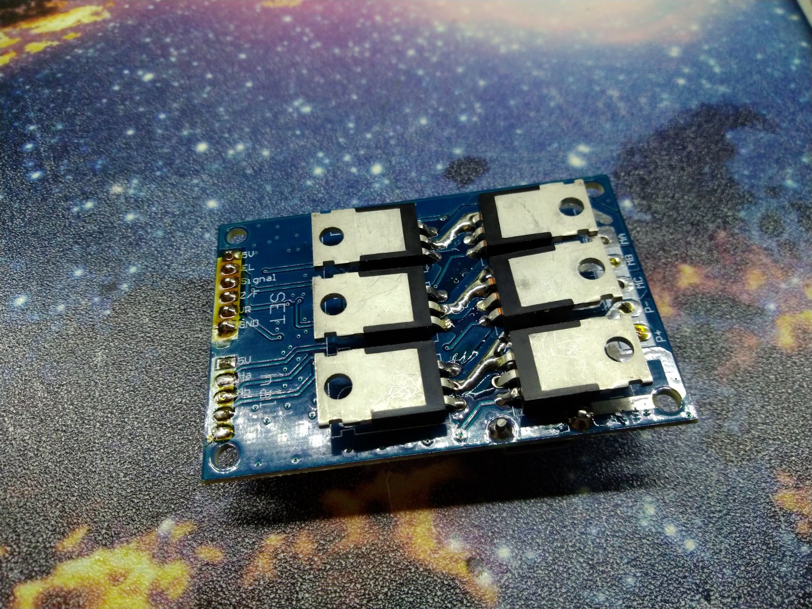

    Tested cheap drivers for 7 euros. They work very badly:mad:. Change directions for a long time (approximately 0.5-1 seconds). As a result, I burned it and I do not regret it much:)
