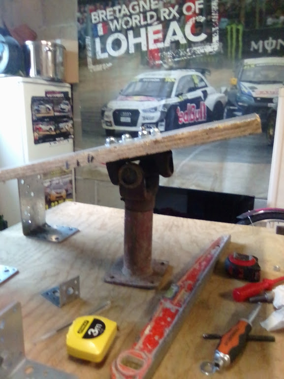

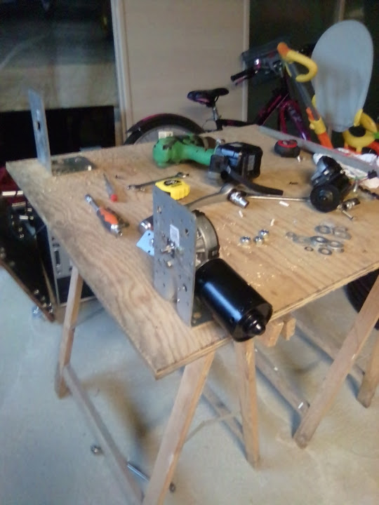

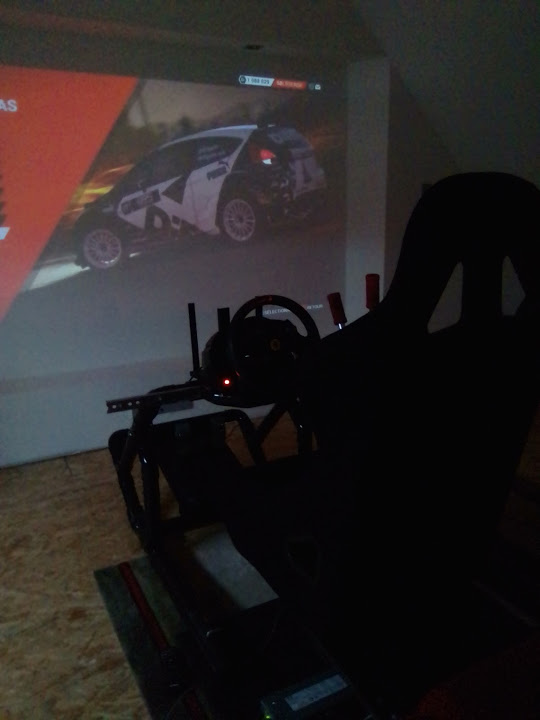

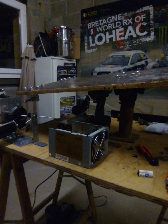

    hi.apres have read a long time on the forum I embarked on the construction of a simulator 2dof a wiper motor for my ps4 I already gathered the necessary equipment card motorcycle monster, arduino, cardan, seat bucket etc.
    I send you photos of my progress.

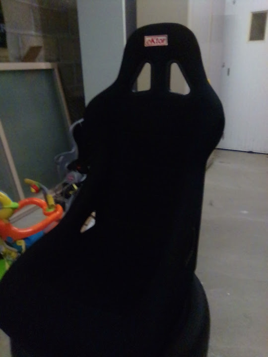

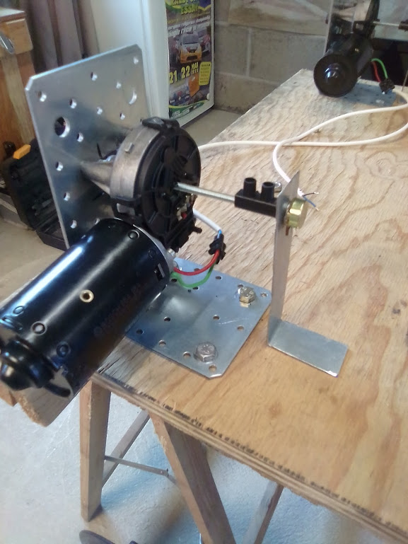

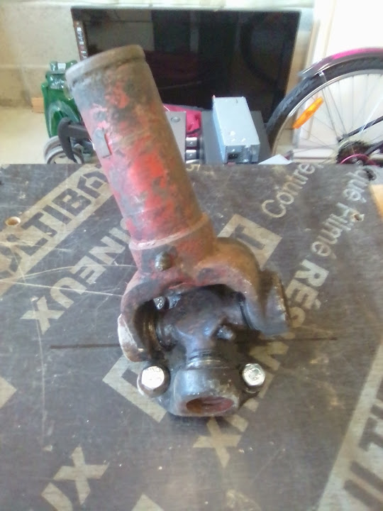

    my simu advance slowly think you must I put cogs for but potentiometers
    the bucket seat 40 euros used

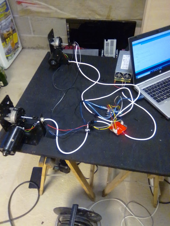

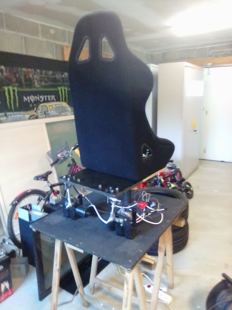

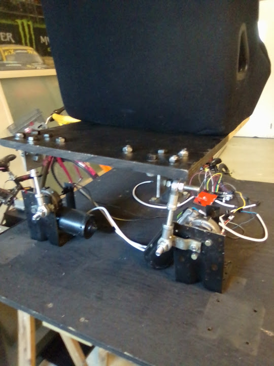

    good I received my arduino and moto monster first tests the engines answered but I think the one on the left has a bit of male I'll try to settle this
  7. ludo22420
    ludo22420 Member
    Aug 4, 2017
    43
    206Coins
    +7 / 0 / -0
    Je suis à la fin de ma construction cela m'a pris beaucoup de temps mais je suis finalement arrivé. Le simulateur se comporte bien avec les démo lfs et simtools. Plus pour moi cas pour recevoir la licence gratuite pour essayer assetto corsa en udp sur mon ps4.ces longtemps à attendre J'espère que j'aurais la licence. voici quelques photos désolées pour la qualité.

    d'autres photos

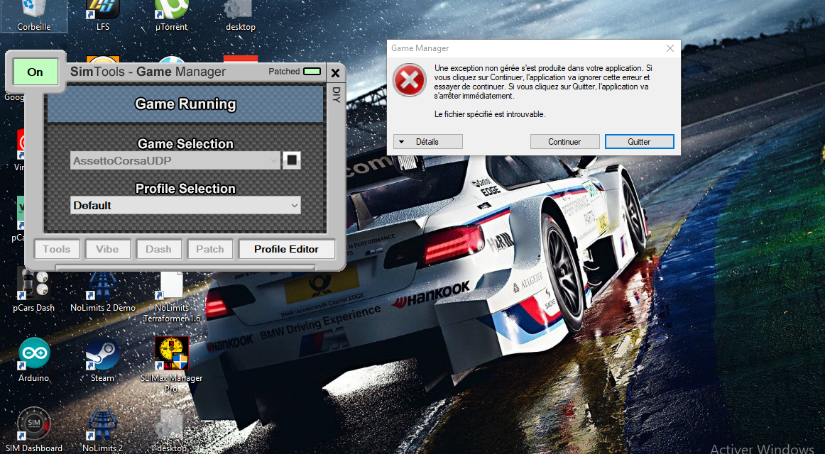

    hello after a moment in stand-by I resumed my project. I download the plugins assetto corsa udp but it does not work I do not understand if someone can help me. Here's the problem:
    Consultez la fin de ce message pour plus de détails sur l'appel du débogage

  15. yobuddy
    5,399
    50,577Coins
    +5,159 / 19 / -0
    There is no reason you should get less resolution from the PS4 version of games that support telemetry.
    It should work just fine buddy.
    Before you try connecting games thou, please setup Game Engine and make sure you can use output testing without issues.
    The error above looks like it is complaining of a file missing, but I can't tell what exactly is missing.
