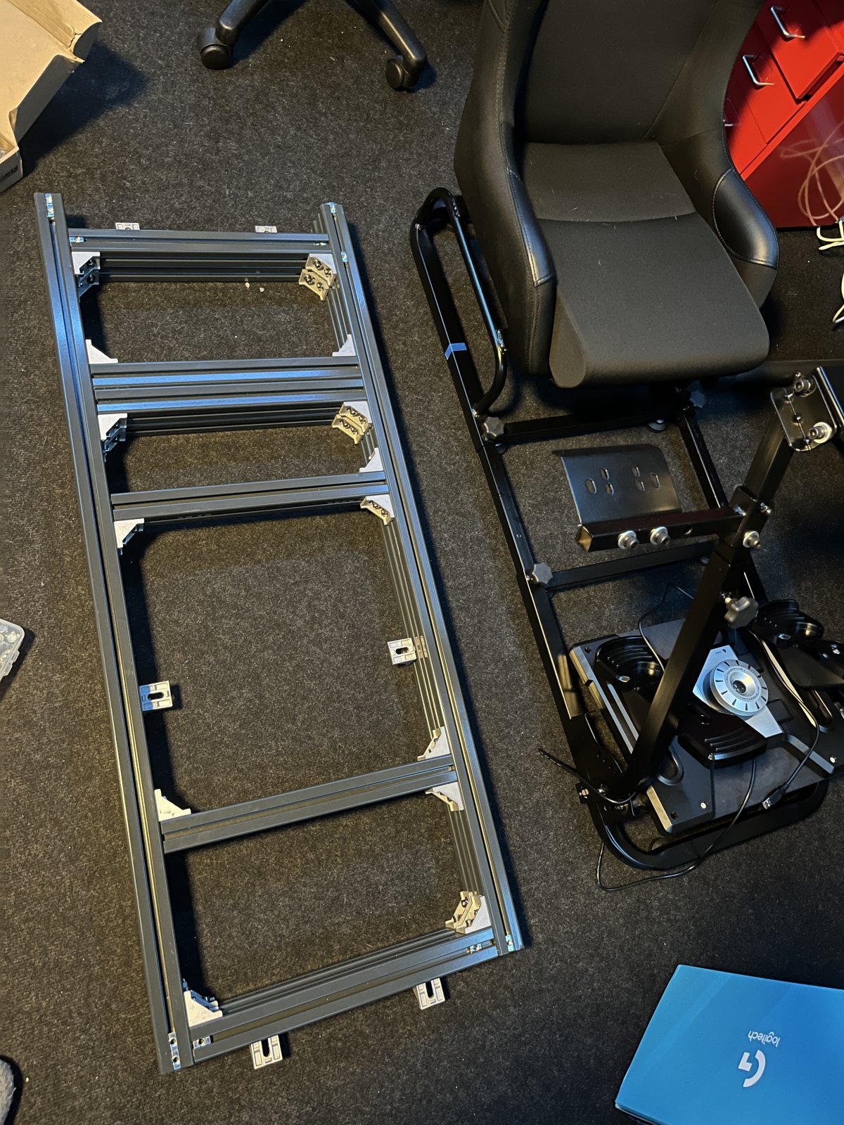

    Before going into the different sections I want to point out that I am using a finished product for the main static rig.
    I was actually planing to build the static rig from aluminium profiles as well, but looking for a seat to use i stumpled
    over this product and just couldn't resist using it as a starting point. It ended up being completely perfect for my use since
    the feet are being screwed in using M8 screws and this perfectly adapted to an aluminium profile frame. But more on that later.

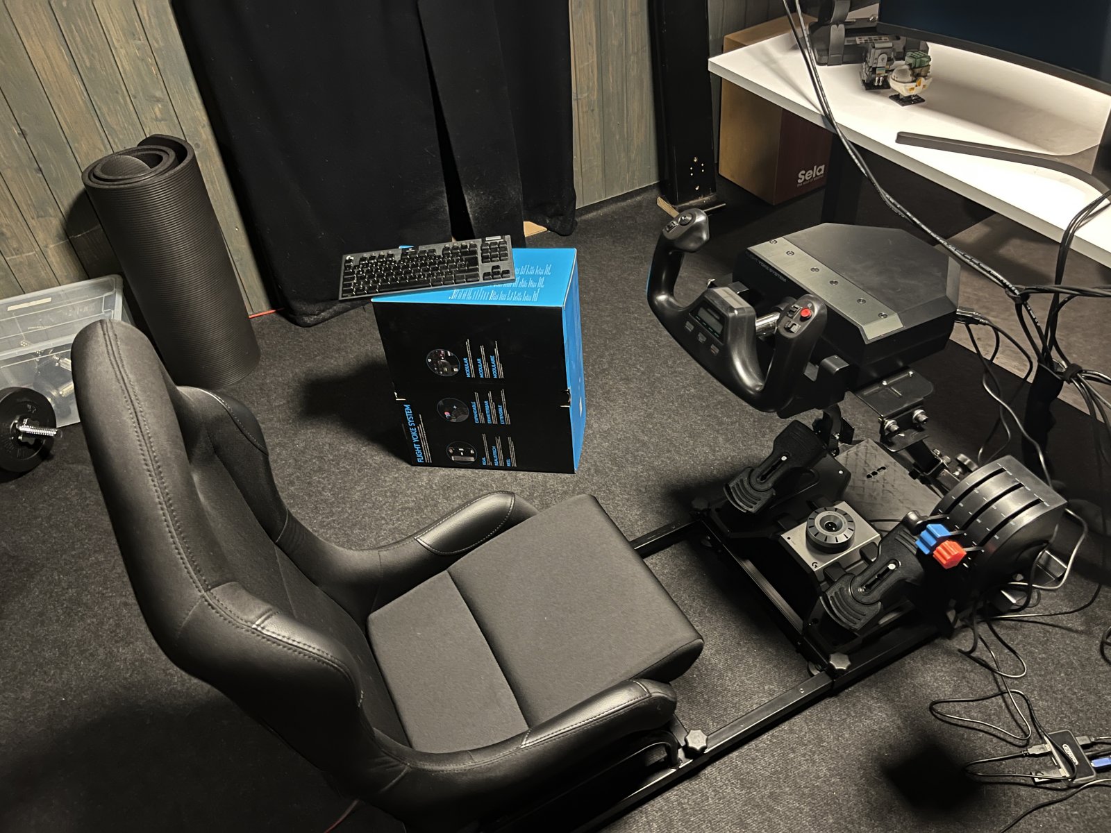

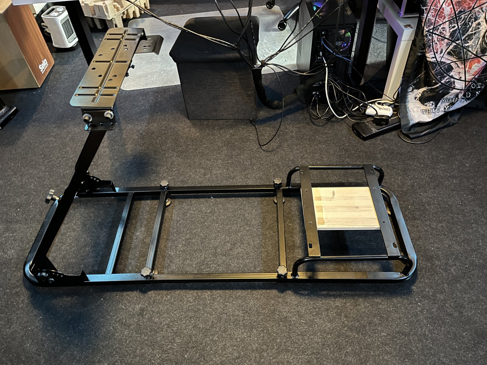

    Static Rig:
    ᴏ Sourcing - Done
    ᴏ Mechanical Build - Done
    ᴏ Attaching controllers and testing - Done

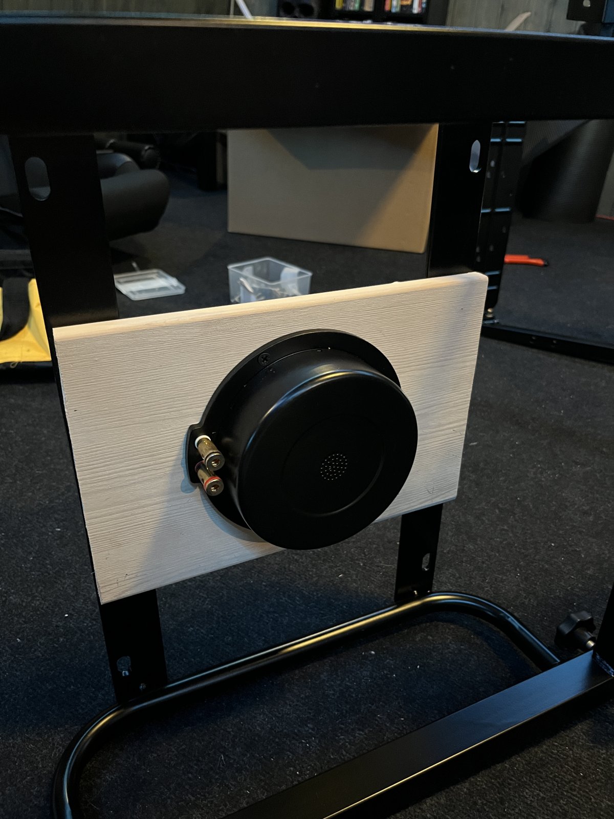

    Bass Shaker:
    ᴏ Attaching bass shaker to static rig using wooden plate - Done
    ᴏ Testing with Sim Shaker for Aviators and Sim Shaker Wheels - Done

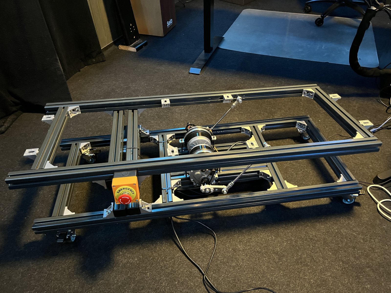

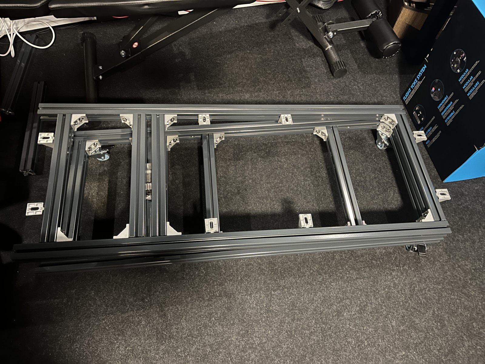

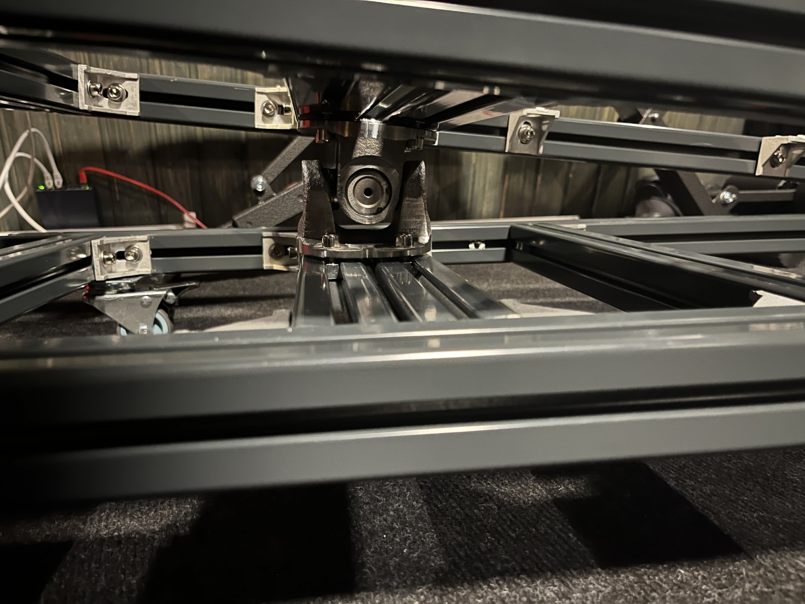

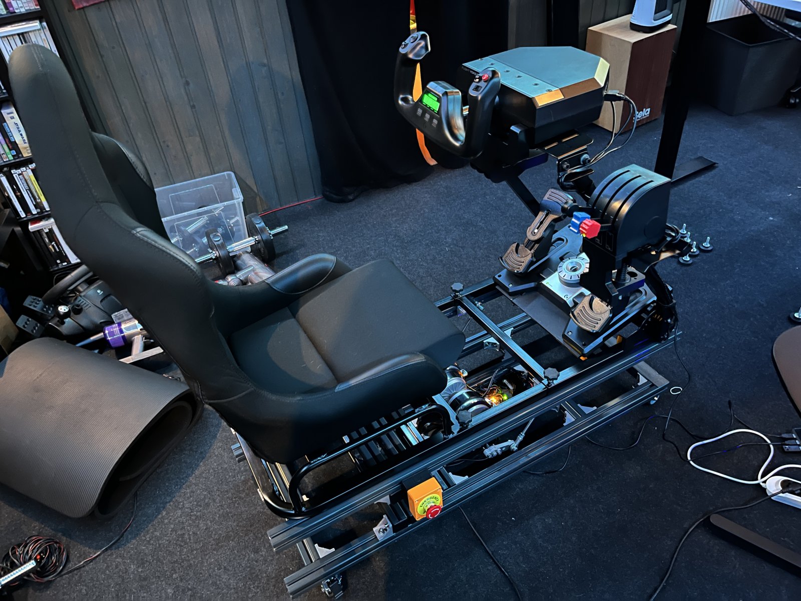

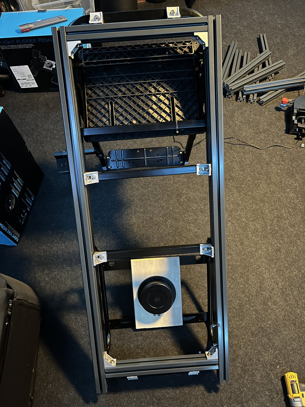

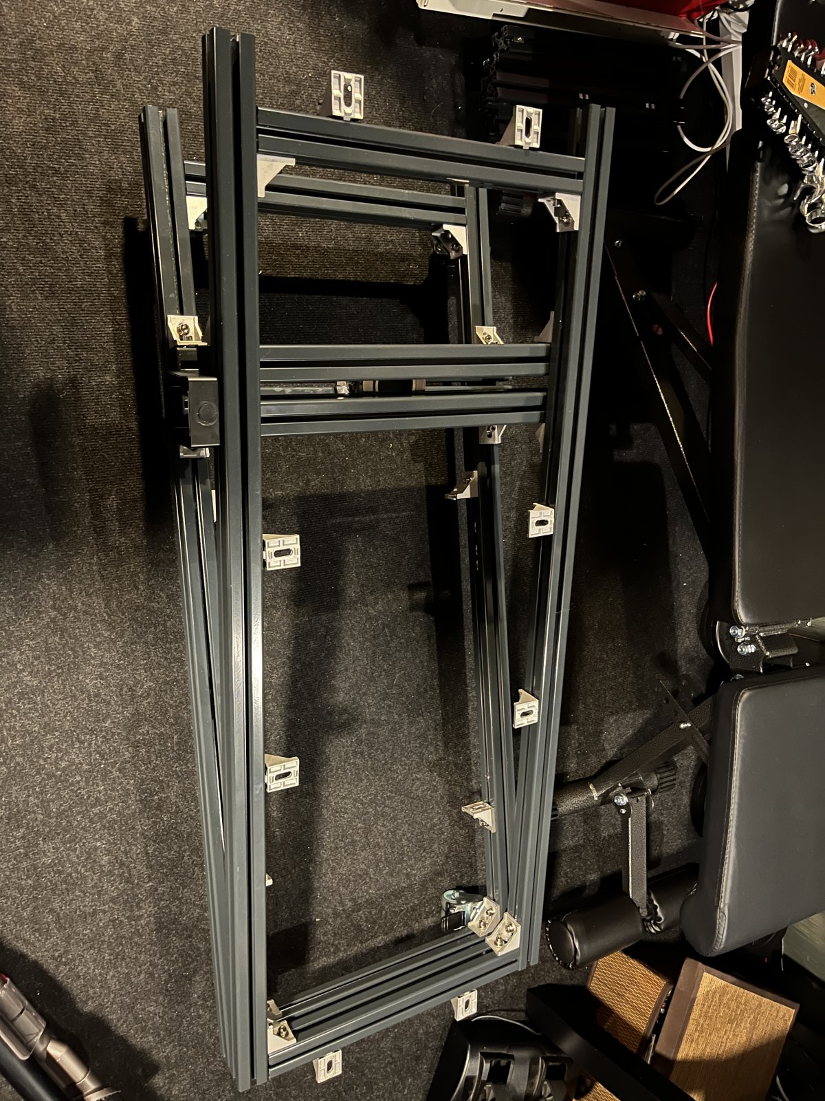

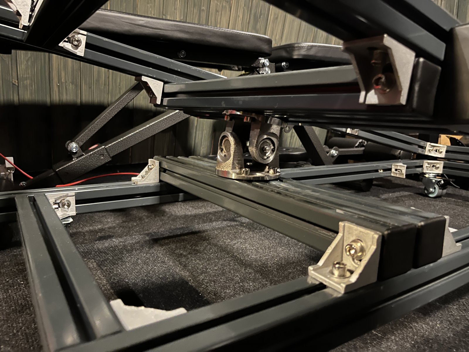

    Frame of motion rig:
    ᴏ Sourcing (aluminum profiles + angles + universal joint) - Done
    ᴏ Building two main frames with aluminium profiles - Done
    ᴏ Mount universal joint - Done
    ᴏ Mount wheels on lower frame - Done
    ᴏ Join the frames with universal joint - Done

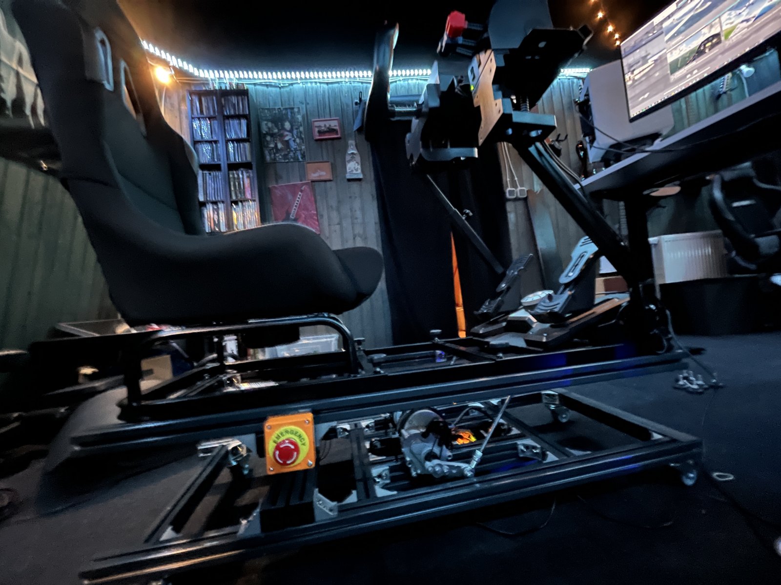

    ᴏ Install static rig on motion rig - Done

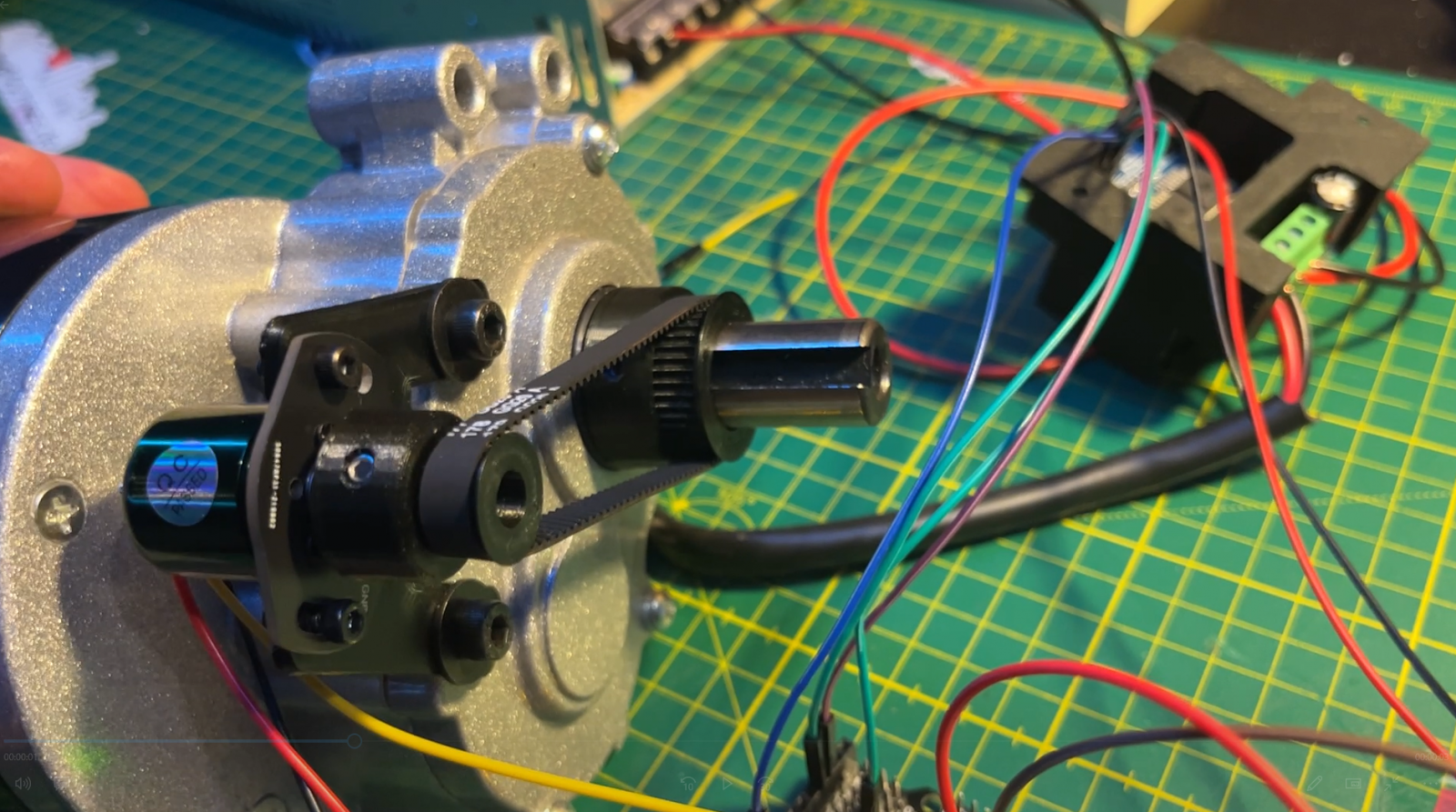

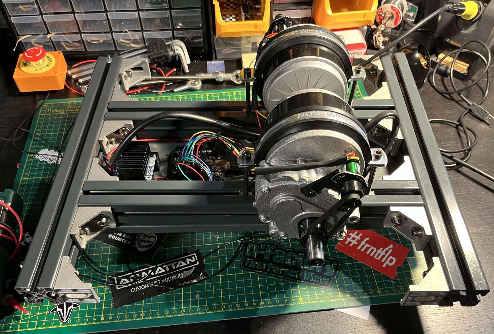

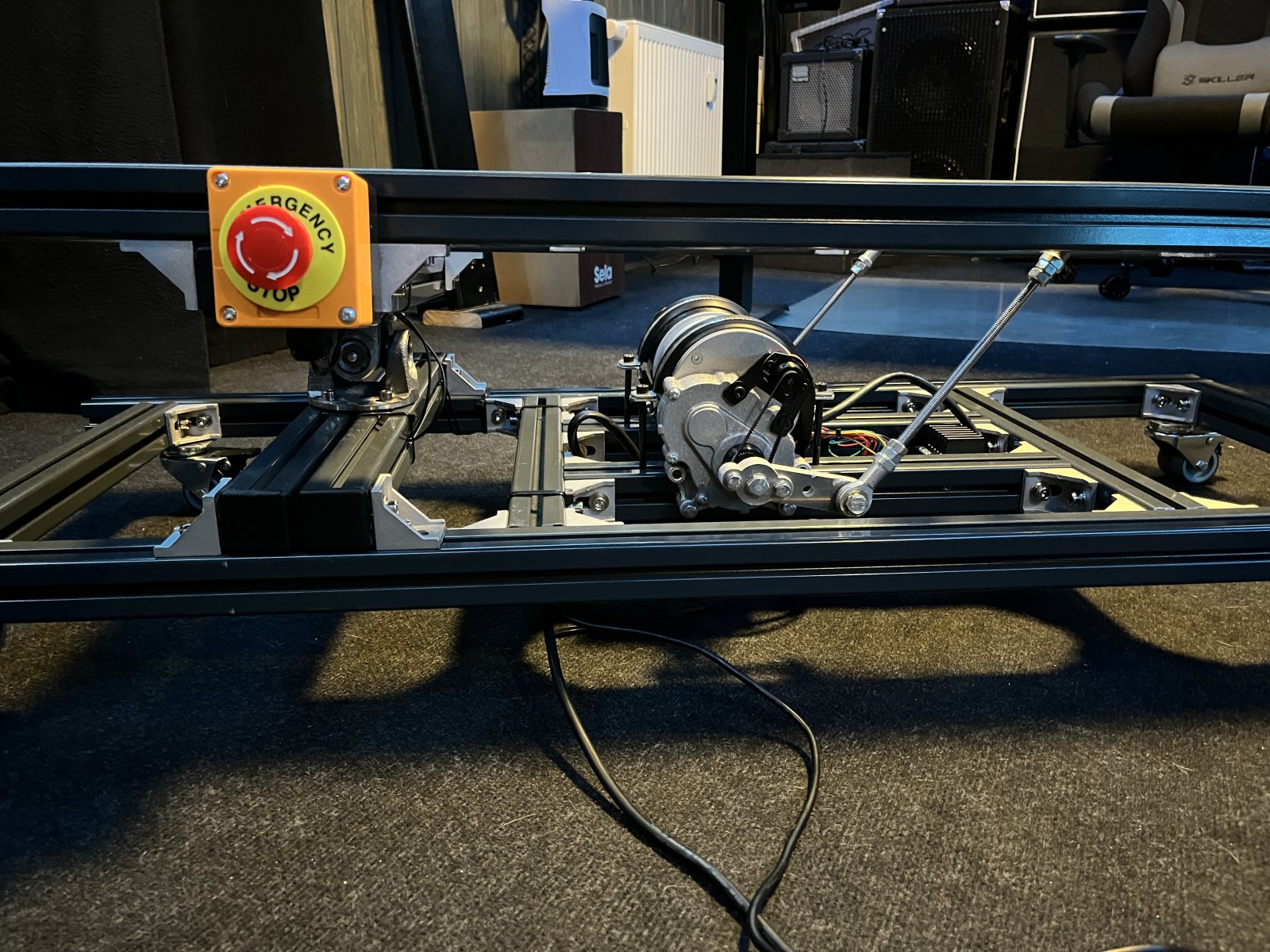

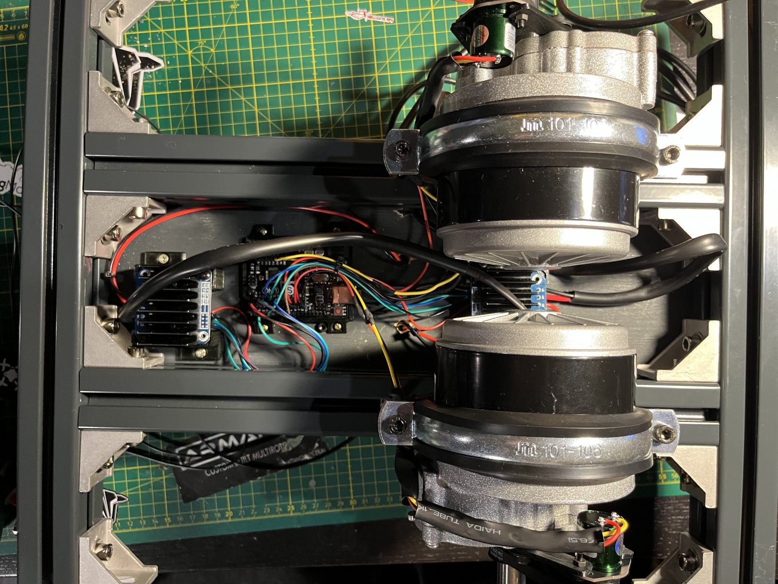

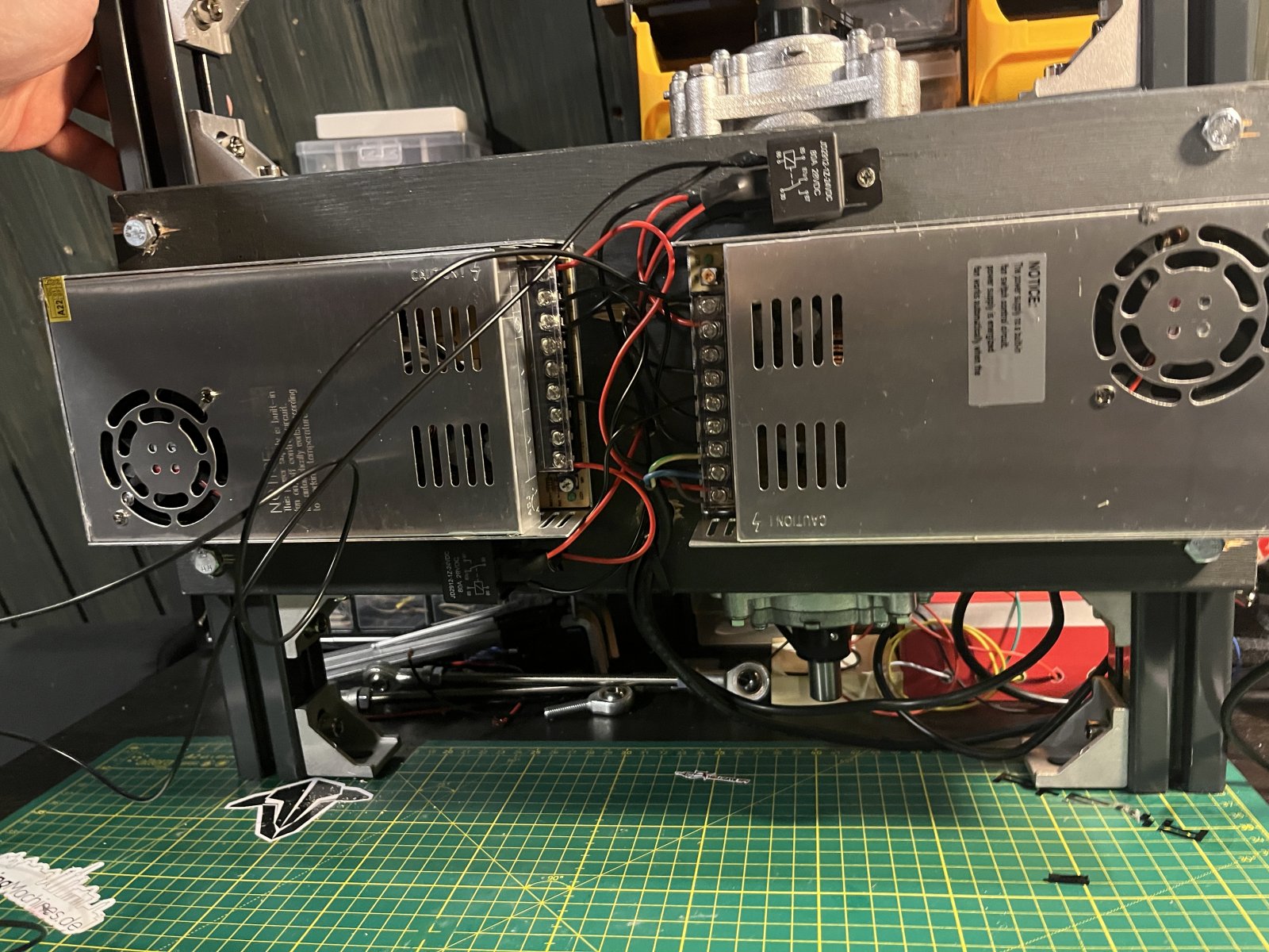

    Motors and electronics:
    ᴏ Sourcing - almost done, open: Arms for joining motor shaft to ball joint. Shipment date: November 21st
    ᴏ Installing hall sensor - done
    ᴏ Adapting hall sensor with pulley wheels (3D printed from parametric CAD file!) and timing belt - Done
    ᴏ Test wiring using Arduino Uno + 2x IBT_2 drivers - Done
    ᴏ Testing motors and hall sensors with SCM3Utils - Done
    ᴏ Setup emergency stop using two relays - Done
    ᴏ Mount motors and electronics on aluminium frames - Done
    ᴏ Mount motor arms and ball joints - Done
    ᴏ Test and tune motors using SCM3Utils - Done
    ᴏ Setup FlyPT Mover configuration and test communication with finished motor rig - Done
    Next steps:
    ᴏ Fine Tune filters in FlyPT Mover

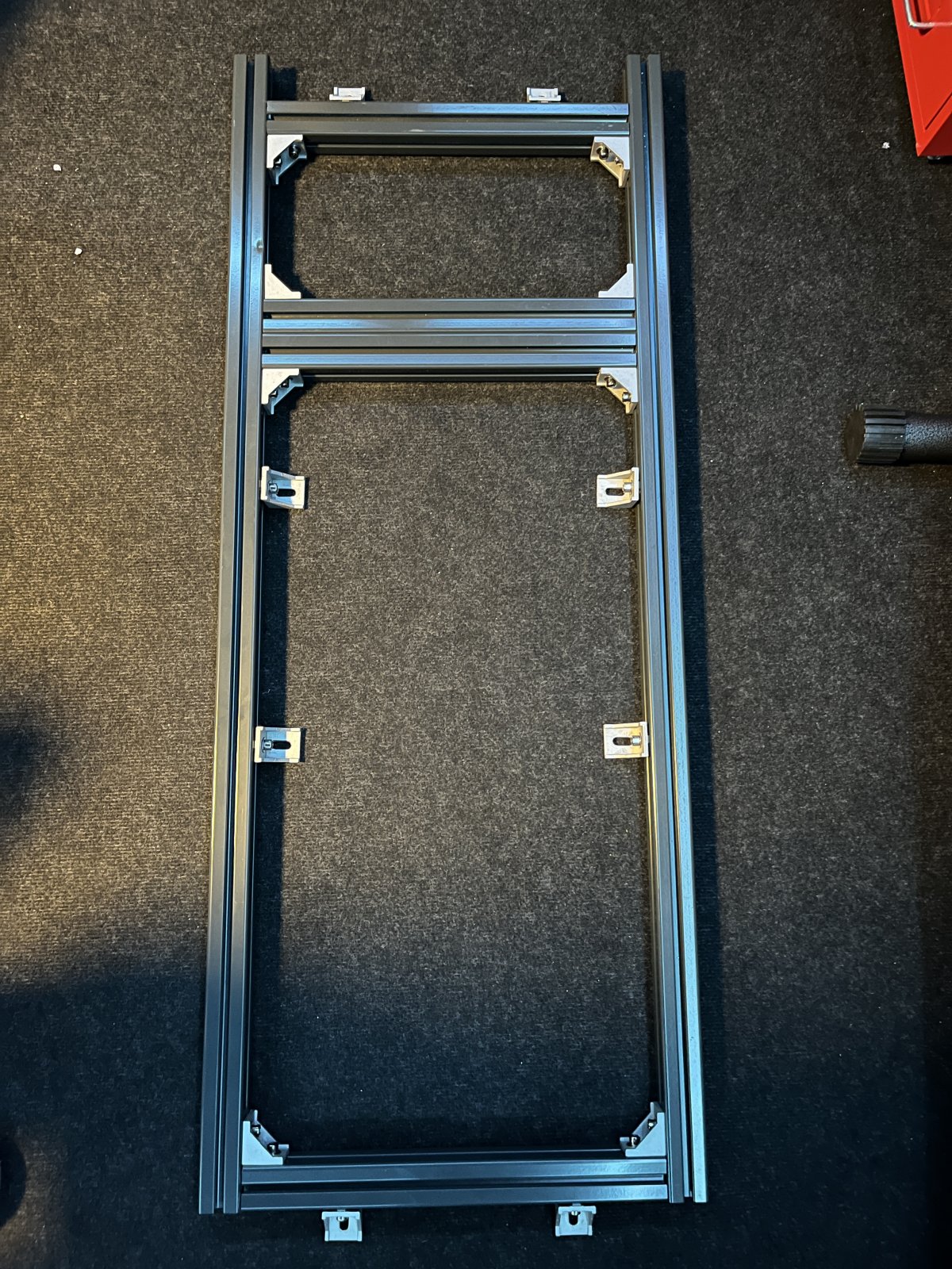

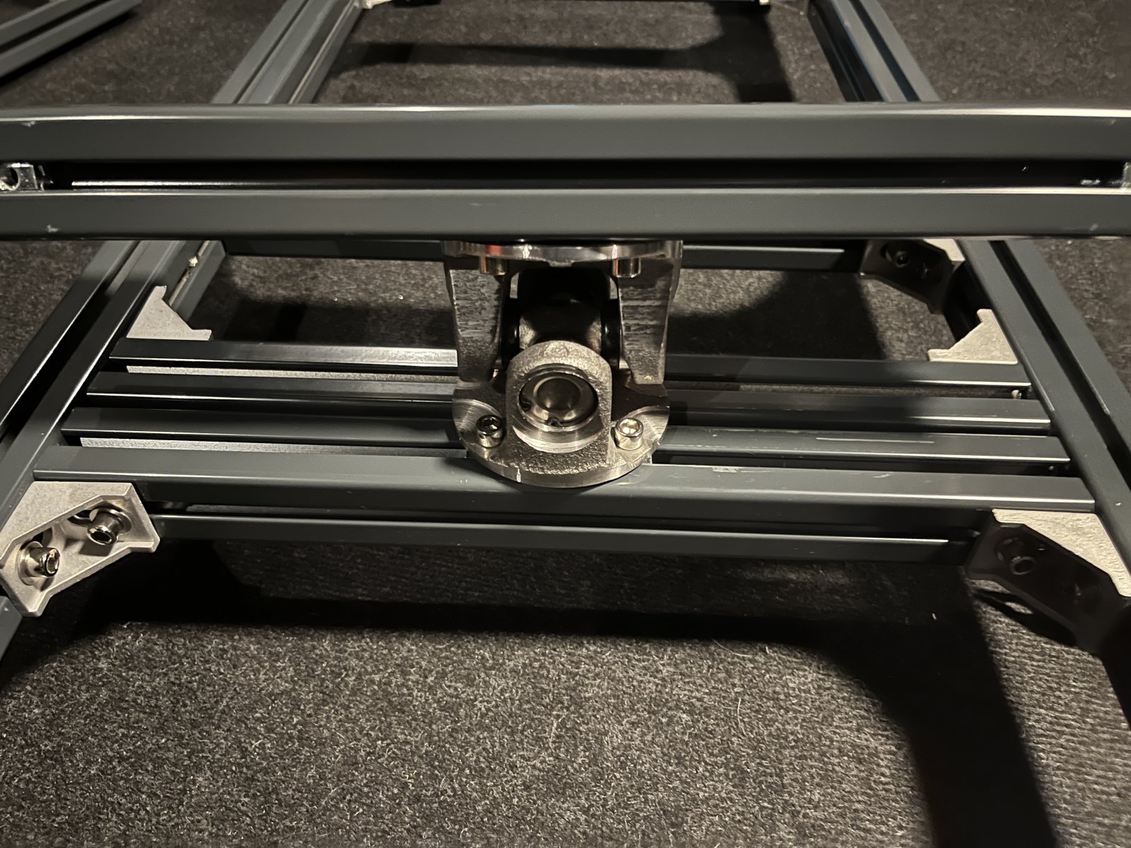

    So I finished assembling my universal joint and connected my frames with it but I'm not too happy with the results for two reasons:
    - Available angle for movement is very low
    - The weight is held from the side and only one side per one profile
    I thus decided to order four new, longer profiles to mount on top of the lower and below the upper frame. So I'm posting these pictures here since they are not part of the final result.

  8. Dontmocme
    Dontmocme New Member
    Dec 18, 2020
    10
    66Coins
    This looks great, in the middle of my build waiting for parts. What size aluminum profiles did you end up going with? Size and type. My prototype looks like your but still deciding on profile sizes for lower frame. I am estimating 300 lbs loaded with rider and gear.
  9. MoreSine
    MoreSine Member
    Oct 25, 2022
    30
    Hesse, Germany
    157Coins
    +14 / 0 / -0
    I am using 40x40 mm profiles from Amazon. I could get them ready cut in 100 mm steps for around 18 € / m which is crazy cheap.
    It’s from a German company so I don’t know if the link will help but you can see the type of profile used:
    SCHMIDT systemprofile 1200mm Aluminium Profil 40x40mm Nut 8 Strebenprofil Anthrazit 4040 Alu Konstruktionsprofil 1,2m https://amzn.eu/d/8PAYRFS

    Finally got my motor cranks and spent a lot of time mounting and fiddling with the positions of all components. But I can finally say that the basic setup is DONE!
    Just finished my first test flight in MSFS with FlyPT Mover which was really a bumpy ride even though I put huge filters on everything but I need to get the hang of how to translate the positions into my small windows of available movement angle.
    Anyways, I will keep on testing and update here - but my first impression is: WOW!
