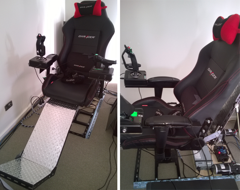

    I’ve recently “finished” my first rig, being a 2DOF setup intended for space sim use. Thank you to Value1 for the quick development of an ‘Elite Dangerous’ plugin for Simtools – it is truly fantastic to see my project come alive after tinkering with it for so long. Wearing the Oculus Rift while playing Elite on the motion chair is an amazingly immersive experience!
    While there is plenty of tidy up work to be done, I’m hoping the community can help me troubleshoot a specific issue with one of the motors being a bit ‘sloppy’ during movement.

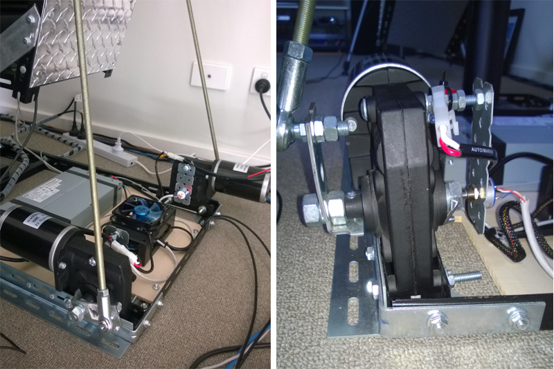

    • 2DOF chair, inc 2 x Motion Dynamics 200W worm drives
    • 2 x Pololu Jrk 12v12 controllers
    • 2 x HP DPS-600PB 47A server power supplies
    • Decent POTs (about $15 ea from memory?)

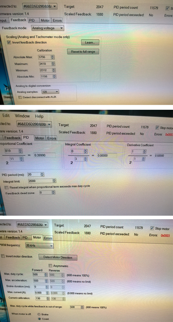

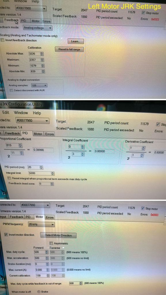

    Issue
    With the chair set to a ‘neutral’ position (using say the SimTools GameEngine - Output Testing tool), the left motor arm ‘sags’ when I sit in the chair. If I lean to the right side, the right motor arm barely moves and applies appropriate pressure to take up my weight.
    While still using Output Testing tool, the movements in the left motor are ‘sloppy’, and do not stop sharply. The right side motor moves much snappier and stops on a dime (see video).
    Some considerations:
    • The chair is as evenly balanced on the roll axis as I can get it
    • With the chair set to neutral (in say SimTools), I can easily move the left motor arm up and down about 10mm with my hand, while the right motor arm is much more rigid
    • The issue is present when testing with both the JRK config tool and SimTools
    • I’ve run the JRK config tool setup multiple times with no improvement in the left motor
    Is this something I can fix with say PID or deadzone settings in the JRK config tool (see below)? Or am I looking at a problem with the motor or POTs perhaps?
    Thanks in advance for any feedback you can offer.

    grab each lever without power on it and see if one turns easier than the other.
    If one does turn easier, turn up PID on the D to 0.8 or even 1.0
    What gearboxes are you using?
    25:1

    I would probably change the motor levers to something "beefier" - thicker, on the picture it looks like it started to bend already..
    And in the video your motors are moving the base of the floor, you could try putting anti-vibe rubber on the corners of the base, but then it shouldn't be on the carpet.. you can try though..
    Otherwise, very nice project for the first time :thumbs

    I've come back to this problem on and off but I haven't made much progress until now. After reading through this post, I reconfigured the problematic motor in the JRK utility again, in particular increasing feed back analogue samples to 1024, and dropping the P(roportional coefficient) value down to 0.14 (it was on 0.39). This has made the movement much snappier and minimises the sloppiness/overshooting I've experienced until now.
    I'm about to test in game - fingers crossed!

    Bugger - while the movement has improved greatly while the chair is unloaded, one side (left) still has excessive movement when I'm sitting in it. I'm starting to think the 25:1 gearboxes aren't up to the job - but it doesn't explain why the right side performs well (unless I'd somehow damaged the gearbox/motor on the left side early on in my testing.
    It seems my next step in troubleshooting this issue is to swap around parts (motors/gears/pots) to isolate exactly where the issue is - aahhhg.

    It is easy to swap the motors over as a quick test, there is just 2 bolts holding them on the gearbox. Just be careful not to damage the rubber shock pads inside the two part coupler that joins the motor to the gearbox, they can be a bit fragile.
    As @prodigy mentioned earlier in the thread the motor arms and also mounts look flimsy, are you sure they are not moving, same with the pot mounts?

    When I first got my motors (I have 25:1 boxes as well) I found one motor was very smooth to run and the other seemed to run a bit rough.
    I took the gearbox off the rough one and found the shock coupler (the rubber part @noorbeast mentions) was actually not seated correctly.
    I used a tiny amount of super glue on each rubber part (4 of them) to keep it in place and put the gearbox back on.
    I then ran the motor direct with 12v to "run it in" and it's much better now.
    I think sometimes the "gunk" inside the gearbox can get a bit sticky and giving them a run worked well for me....
    Might be worth a try....

    Im gonna call pot mounts flexing or doing something they shouldn't be doing. And after looking at the pics in the first post, Im concerned about those motor's flexing the frame Big time also the fact the lever is already bent, Imo you need to do some re enforcing before going forward. Thing's flexing and bending isn't helping your issues.

    I can 100% gaurantee that when you are on there with no upper support on that motor gear box you are getting no less then 1/2 inch movement in either direction. Could be more. That L Steel with holes in it will flex on its own. You would do well to provide a support bar between the two motors running horizontal.
    Here is a look at my rear:
