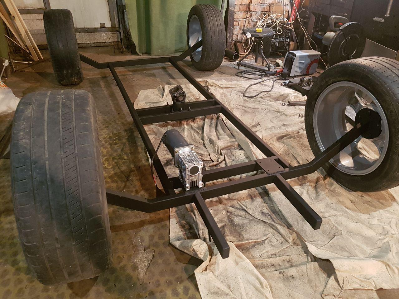

    Hi everybody!
    My idea was to built 2dof simulator, which would be very close to real race car in it`s exterior.
    It will have real 19" wheels, plastic panels and all what real race car have (as close as I can).
    Now it is half ready, some photos and specs:
    Arduino + 4 Moto Monster for more power
    2 x 250w 12V motors with 1:30 gearboxes
    1 x 60A server PSU
    a lot of metal
    Will post new photos!

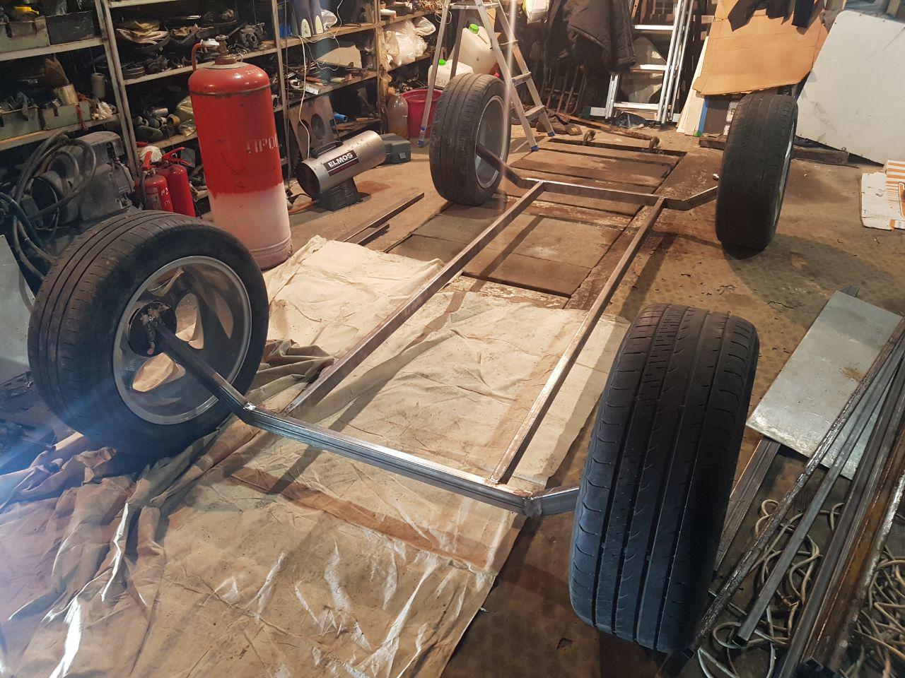

    Building side steelworks

    That is a whole other level with respect to external asthetics, you obviously must have s ton of space for your rolling rig!

    If the rig will have to occupy space, then let it be aesthetic, I think :)

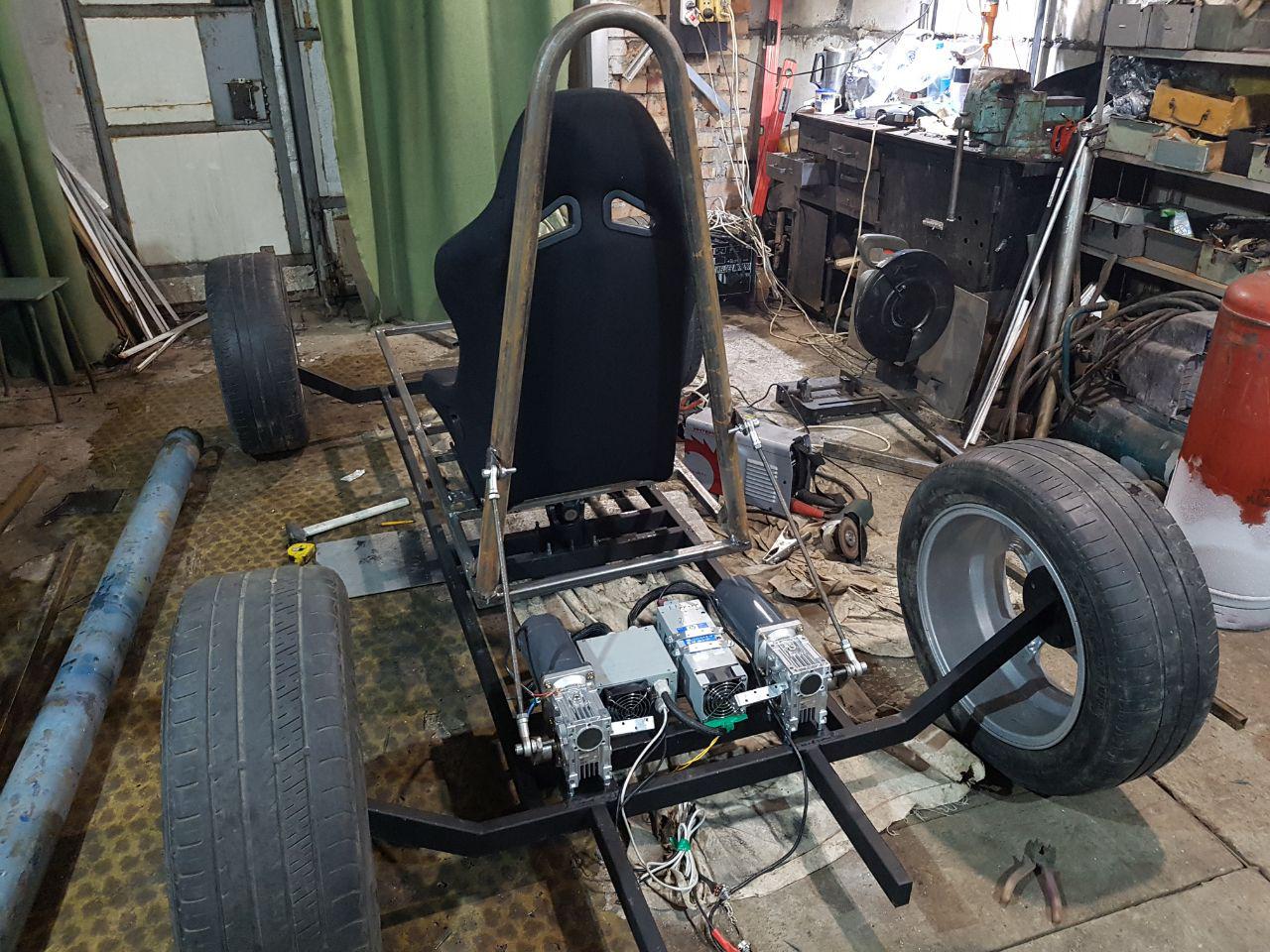

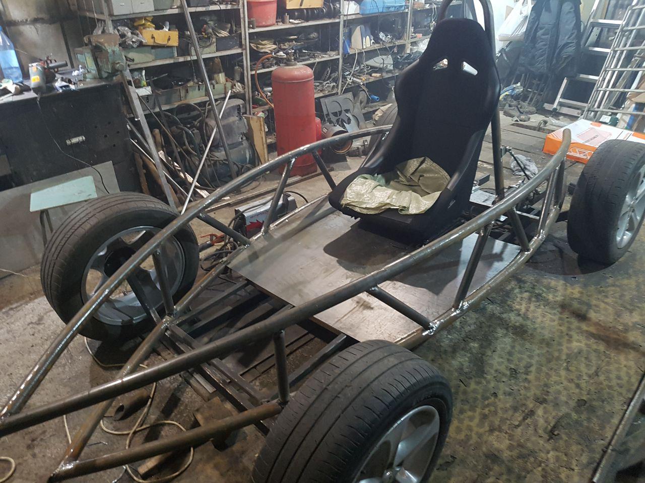

  6. Zed
    Apr 4, 2017
    1,040
    USA
    5,842Coins
    +1,043 / 4 / -0
    @ruba - That looks cool as hell but it looks like the frame around the cockpit is attached to the moving top platform of your rig. If I am seeing that properly that's going to be a lot of mass for your motors to move around and will cut the response of your rig. But maybe I'm seeing that wrong. Just thought I'd mention.
  7. ruba
    ruba Member
    Sep 7, 2017
    41
    Engineer
    Krasnoyarsk
    5Coins
    +14 / 0 / -0
    2DOF, 3DOF, Arduino
    @Zed Yes, the frame around the cockpit is attached to the moving platform. I plan to use some counterweights to achieve a balance. Most likely this will increase the inertia but I plan to use shock absorbers. Will see on test results

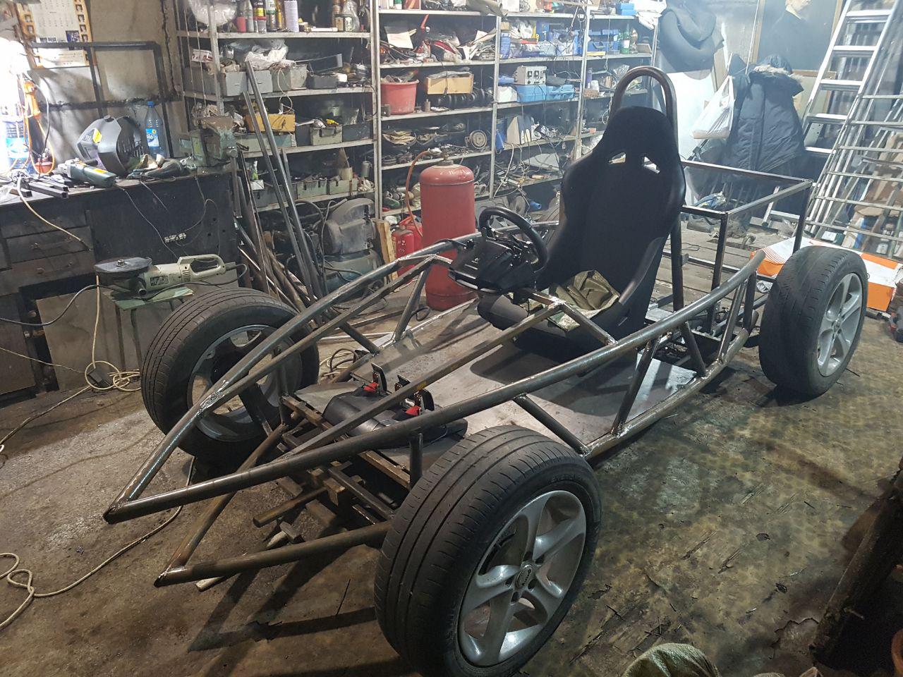

    Added "engine compartment" and steering wheel with pedals
