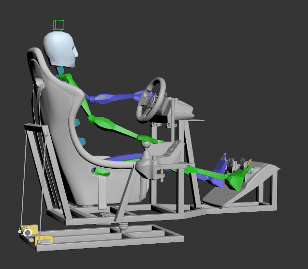

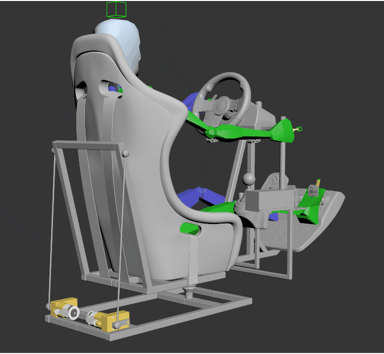

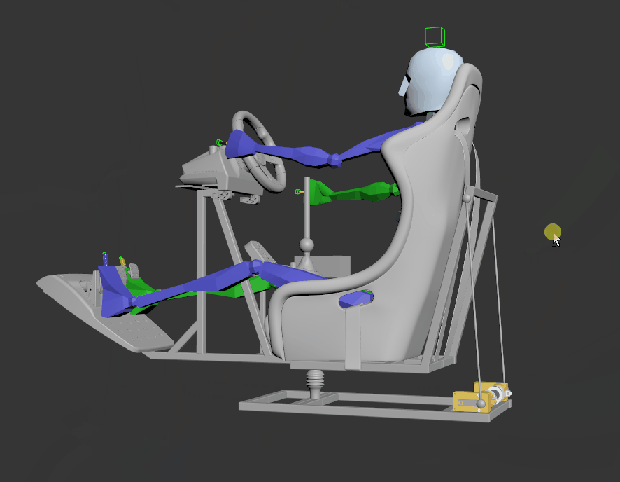

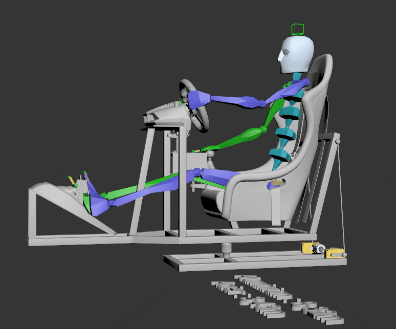

    1. I started by doing a few concept in 3D to get a general idea of what I wanted! Main objective was to:
    - Get a seated position feeling like a sport car
    - Have a G27 well fitted to it
    - Include a Hydro Handbrake
    Concept 1:
    Concept 2:
    2. And after a few concept, it was time to weld this all together! I have used a seat from my 2002 Subaru WRX that decided to die last summer! For now, my friend and I only had time to build the upper part, so I can already enjoy it with the VR headset, but no motion at all for now!

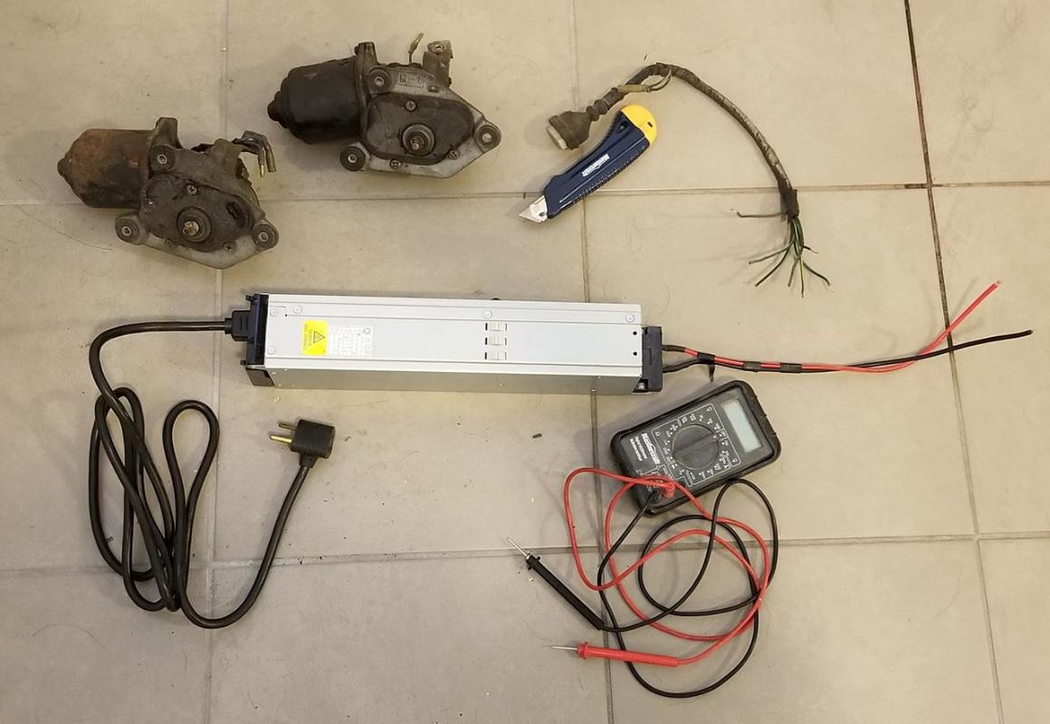

    So, this is where I am on my sim! I started yesterday night to assemble the electronic part! I found two wiper motor in a box of parts for my Datsun, so I will try these early 80's wiper motor since it's free! :p I don't expect too much from them, but who knows, maybe they are going run strong and work well! For now I sorted out the wiring for them!
    It is the first time I am working with an Arduino and stuff like that so I also started to figure out how to connect everything! But thanks to my friend who give me a few links, I have this good tuto to follow:
    https://www.xsimulator.net/communit...xPfmhouS0babXmgllYAaEWZmfbrPkBqm0sHXj0kA-aXy0
    Here is a quick picture of my wiring! I'm planning on just testing the reaction of the wiper motor without any load on them!

    Hey! Who are you? What are you doing with my videos?
    Ah, ah! Hello Antho. Nice to see that you finally post on the forum.
    You have a nice PSU there. ;) Let's hope it will be strong enough.

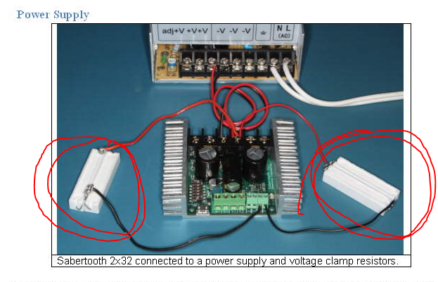

    Don't forget that your Sabertooth 2X32 needs some sort of voltage clamp resistors. Never used them since I use batteries, so I cannot help you with that.
    Take care an see you around!

    Following the tuto I posted above, I've started to look for the resistors I need for this part of the tuto:

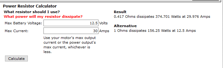

    While I understand why we need them, I am not sure what size I must use for my setup. I have two wiper motors that usually run on a 15amp fuse. So considering I have a 12V (more like 12.5 in fact) input from the power supply I am using ( DELL DPS-500CB ) and a load of maximum 30A, the calculator give me this result:
    So am I suppose to get resistors similar to the picture (10W1Ω i'm guessing)? or am I suppose to get big heavy duty resistors like a 100W1Ω?

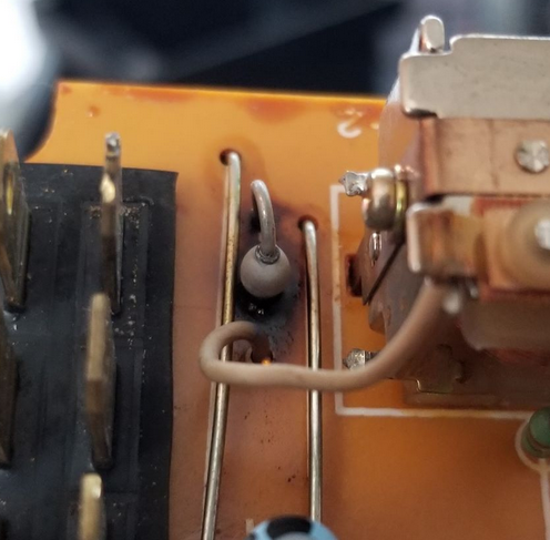

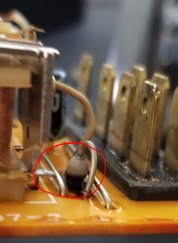

    Bonus Question (off-topic):

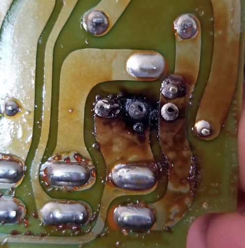

    Anyone knows if there is a chance to save this electronic board if I change the burnt element with something similar?
    Thank you all and have a nice day! :D

    in the picture...
    they are Schottky diodes. this seems to be put to protect the EMF of the relay, if it has burnt out and it is probable that polarity inversion are rather robust usually.

    As long as you have the metal circuit path, you should not have any problem to replace the part. It's worth the try.

    Hey! Thank you for your answer for my Datsun problem hahaha! Well a past owner of the car decided to change the wiper switch for a newer model that uses a different type of connector. While the wires shared a similar color pattern, they were not wired the same way and gave a wiper switch completly messed up! :D
    Now I have the switch all sorted and I perfectly match the wire diagram for the switch! I didn't know the name of this part, so a huge thank you for that! I'm gonna look for this and try to fix it! :D
    Also, for the power supply of my sim, I will probably buy 2x 100W1Ω resistor ( https://www.amazon.ca/-/fr/Boîtier-...ords=resistor+100w+1ohm&qid=1588120691&sr=8-8 ). After thinking about this, the purpose of the resistor is to get rid of regenerative energy and it should not be anywhere close to the load my wiper motor will put on the circuit. I even think that it might be overkill to put 100W1Ω resistors... But I am really not an expert for this and since they are cheap, I will take a guess and try it! :p
