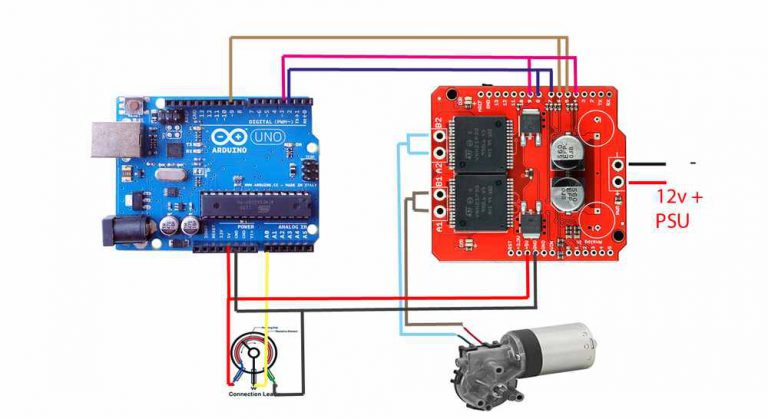

    i have a 2dof im building with arduino and 2 MM. In smc3 motor one works correctly on motion but motor 2 only seems to go one way, no reverse. Is there anything i can try or is it likely a bad MM? Potentiometer seems to read correctly if i turn it manually(not connected to motor).

    wired like this currently

    Correct, it seems Sparkfun have discontinued MMs, so those found online are clones.
    Those motors do not need ground isolation.

    I just got lucky, was painting my basement and found an extra MM laying around. Changed it out and it works in SMC3. Now onto simtools.

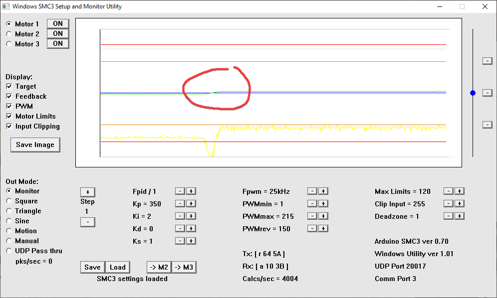

    actually before i move onto simtools. Im using a clarostat 73ja 10k pot, is there anyway to get the movement to be more pronounced in smc3? if i move to the full back or forward of my rig, the potentiometer barely moves off the center.
    20,533
    145,022Coins
    +10,775 / 52 / -2
    A wild guess but perhaps that is a 10 turn pot?
    How is the pot connected to the motor, directly or is it geared?

  12. noorbeast
    20,533
    145,022Coins
    +10,775 / 52 / -2
    How many turn of the pot does it take to go from one end of its range to the other?

    Then I am guessing you would need to gear it.
