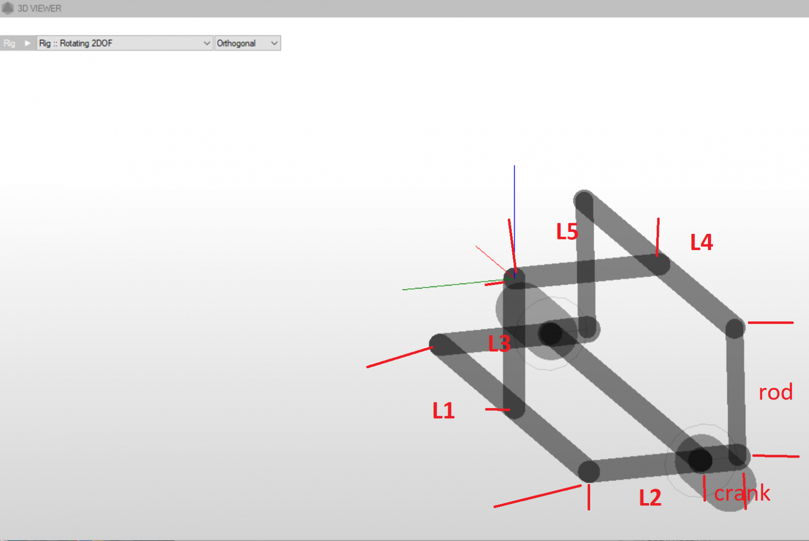

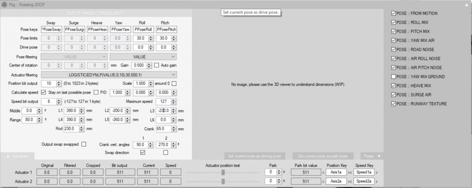

    I would like to show my 2DOF under DCS, this is a working prototype as I have not yet decided on the final form.
    I used :
    2x DC 250W 24V motor
    2x 24V 25A power supply
    100A power bridge
    Dimensions 2DOF
