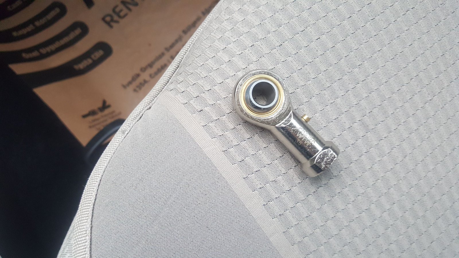

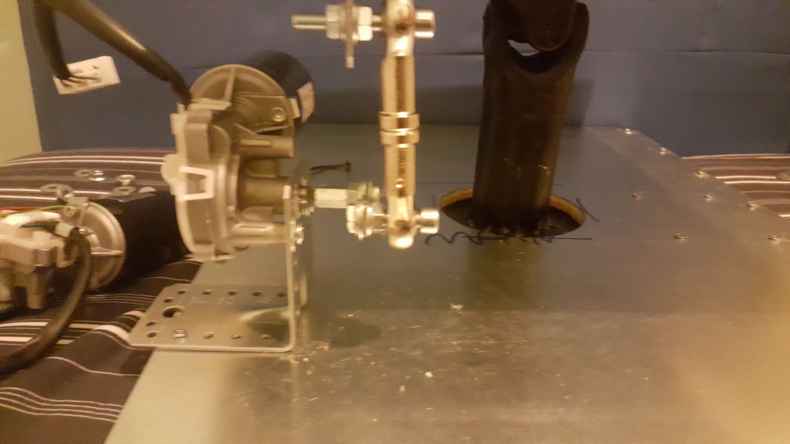

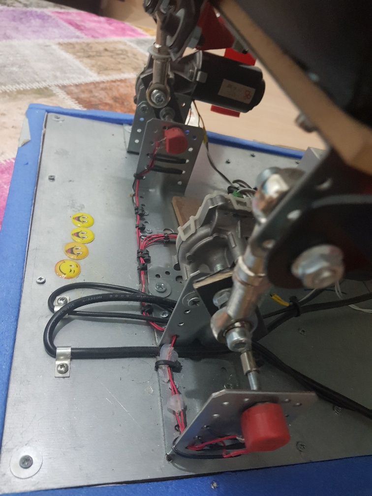

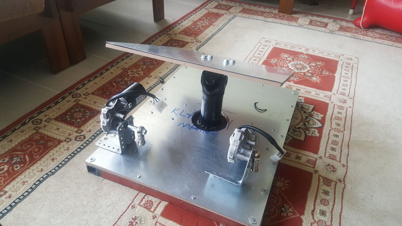

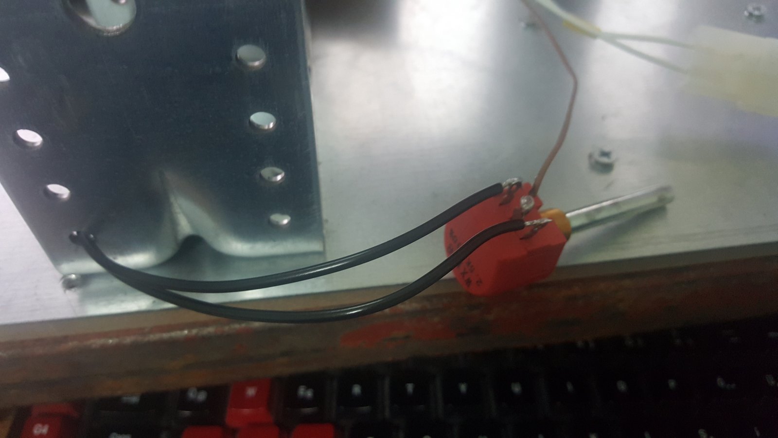

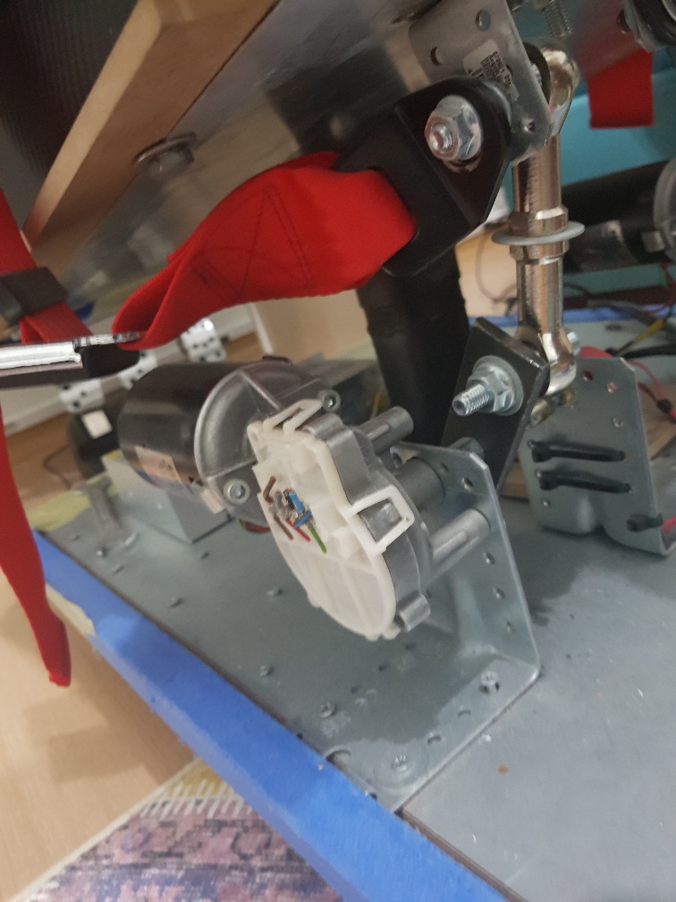

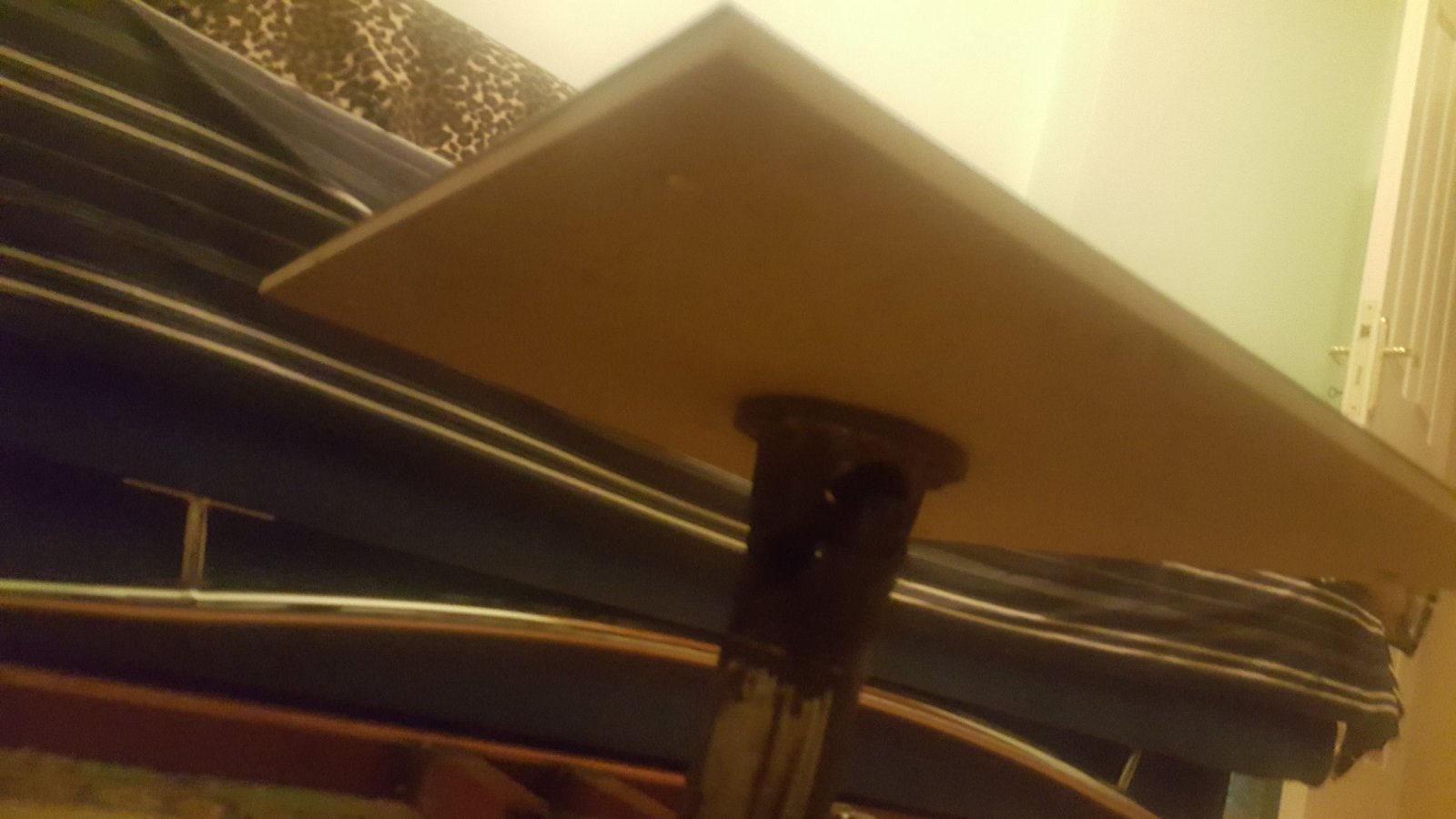

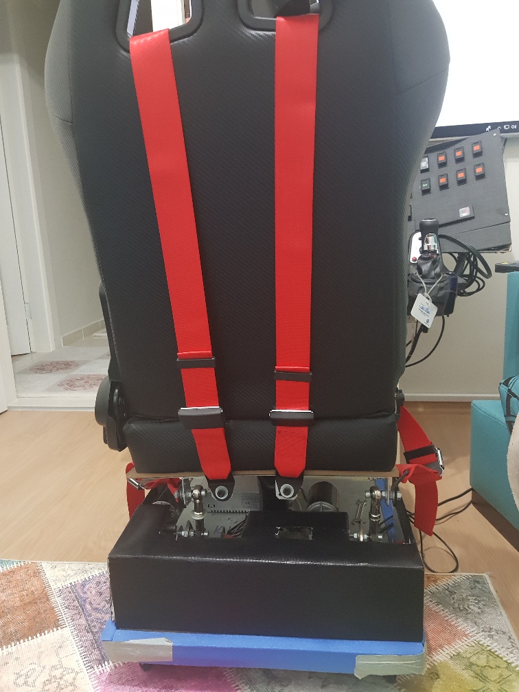

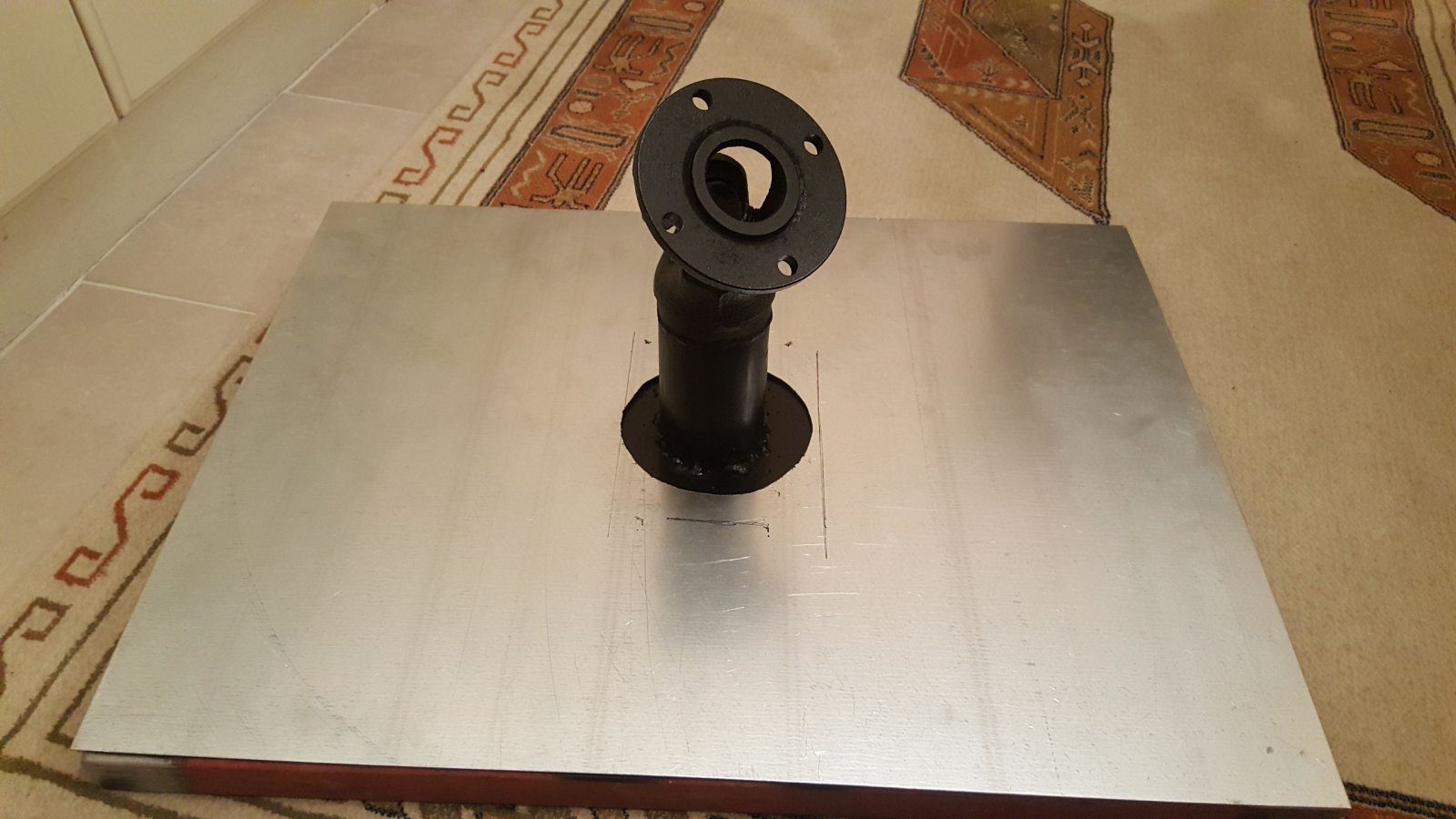

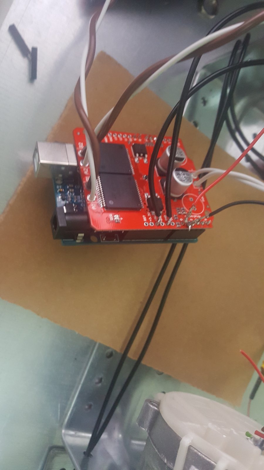

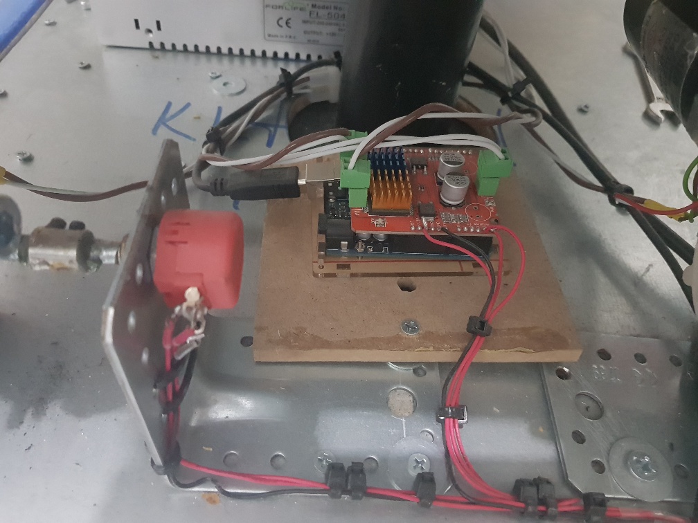

    Hello Guys,
    I've been tracking you for a couple of months, and I wanted to share with you my 2DOF motion simulator, which I tried to do myself.
    I am totally amateurish, I tried to come from somewhere else by collecting, collecting and getting support from our other friends in the forum.

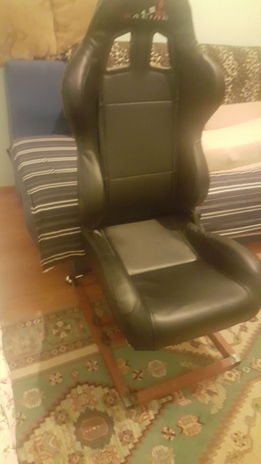

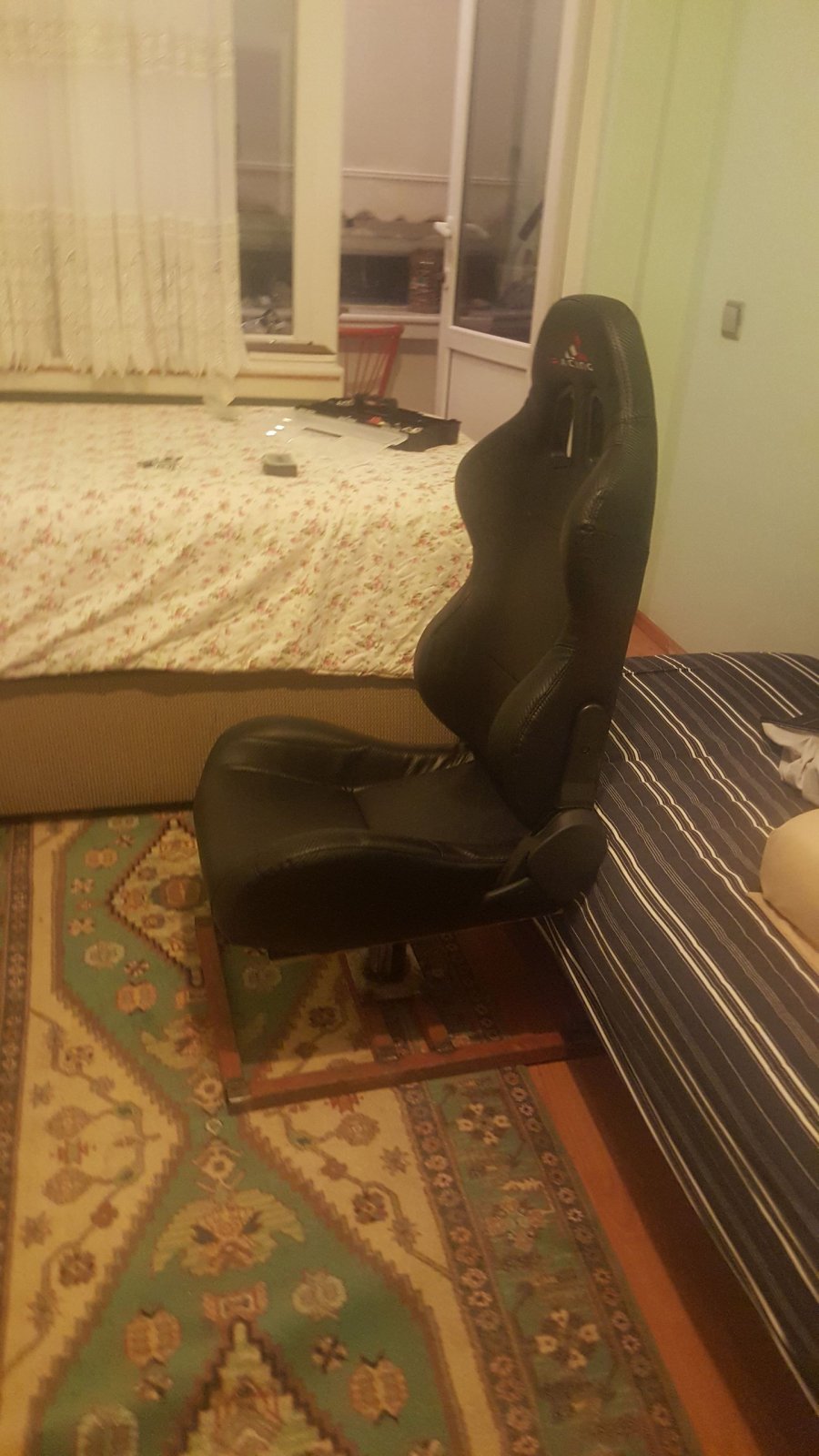

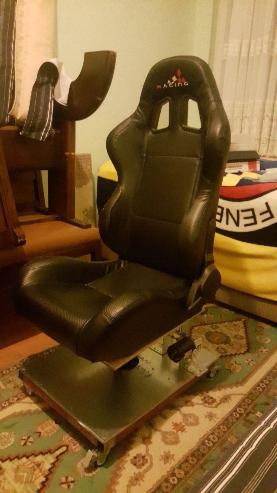

    I tried to make a similator in the bottom of the seat and mechanism that does not occupy space because there is not a big place in the house.

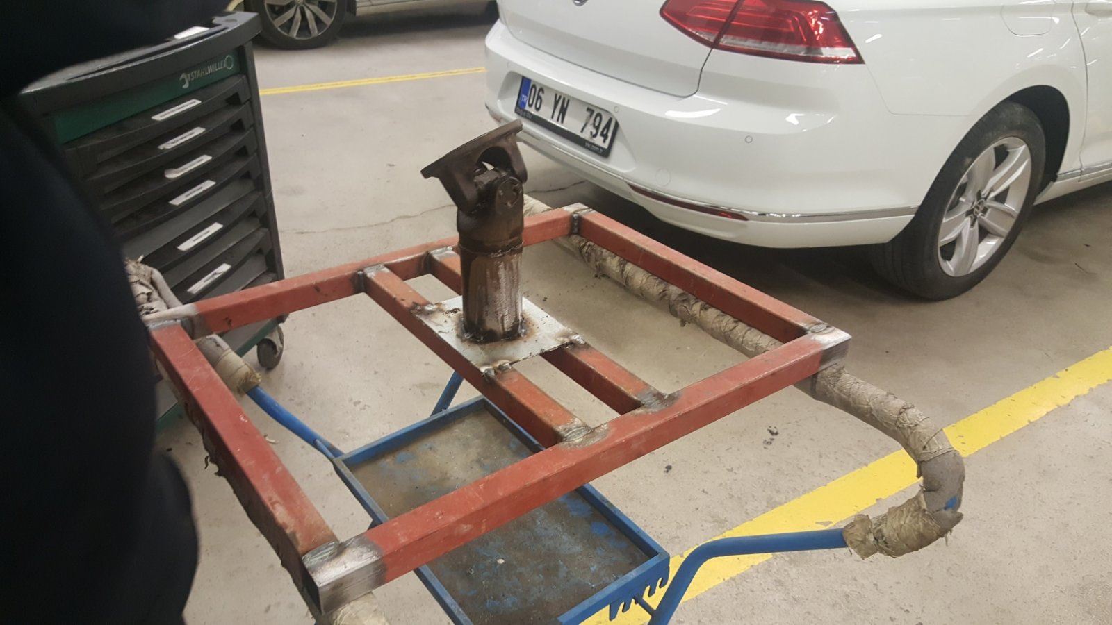

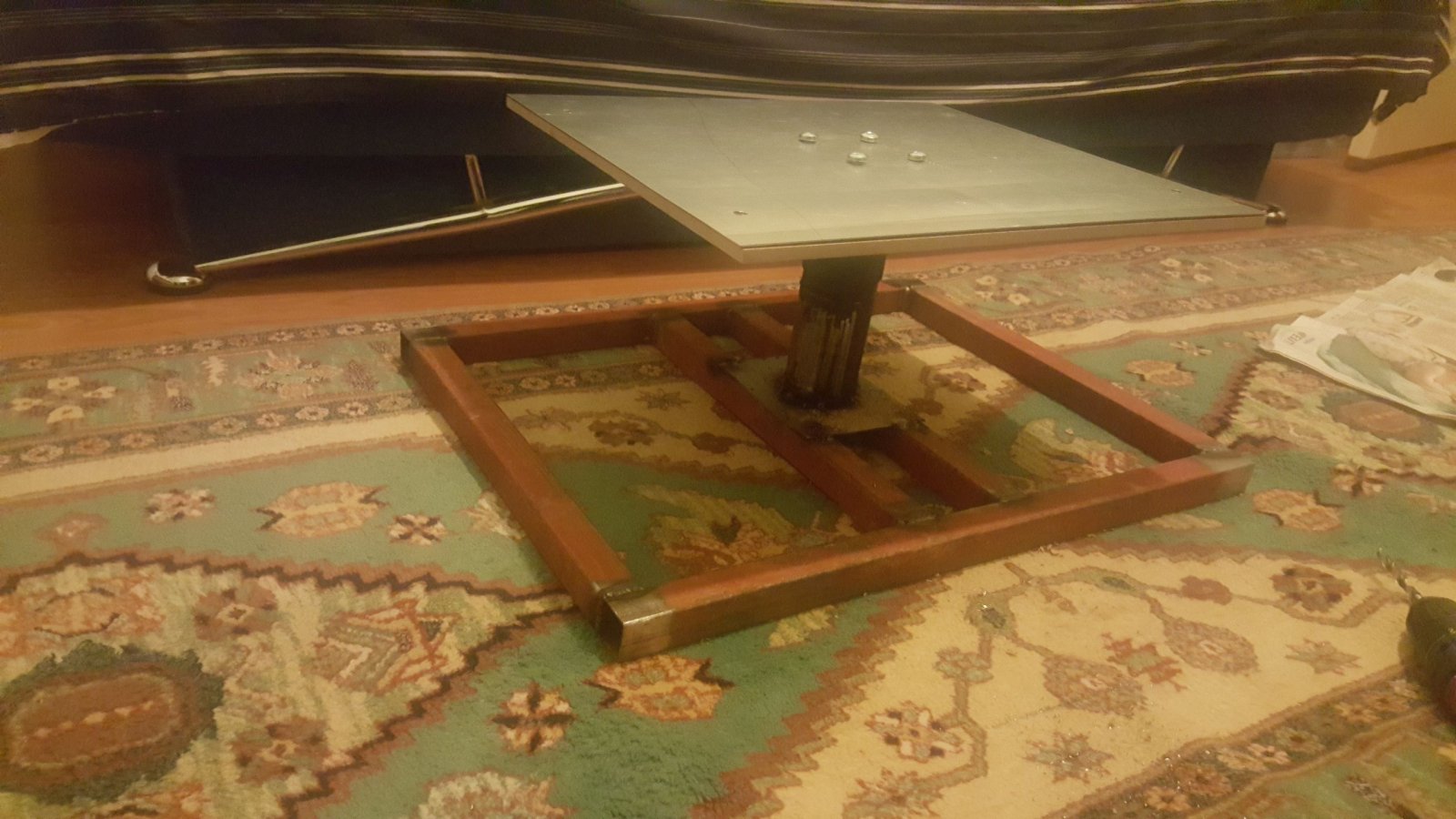

    When using My Simulator, I used 60cm and 40cm iron quadrilateral pipes.To make the base.

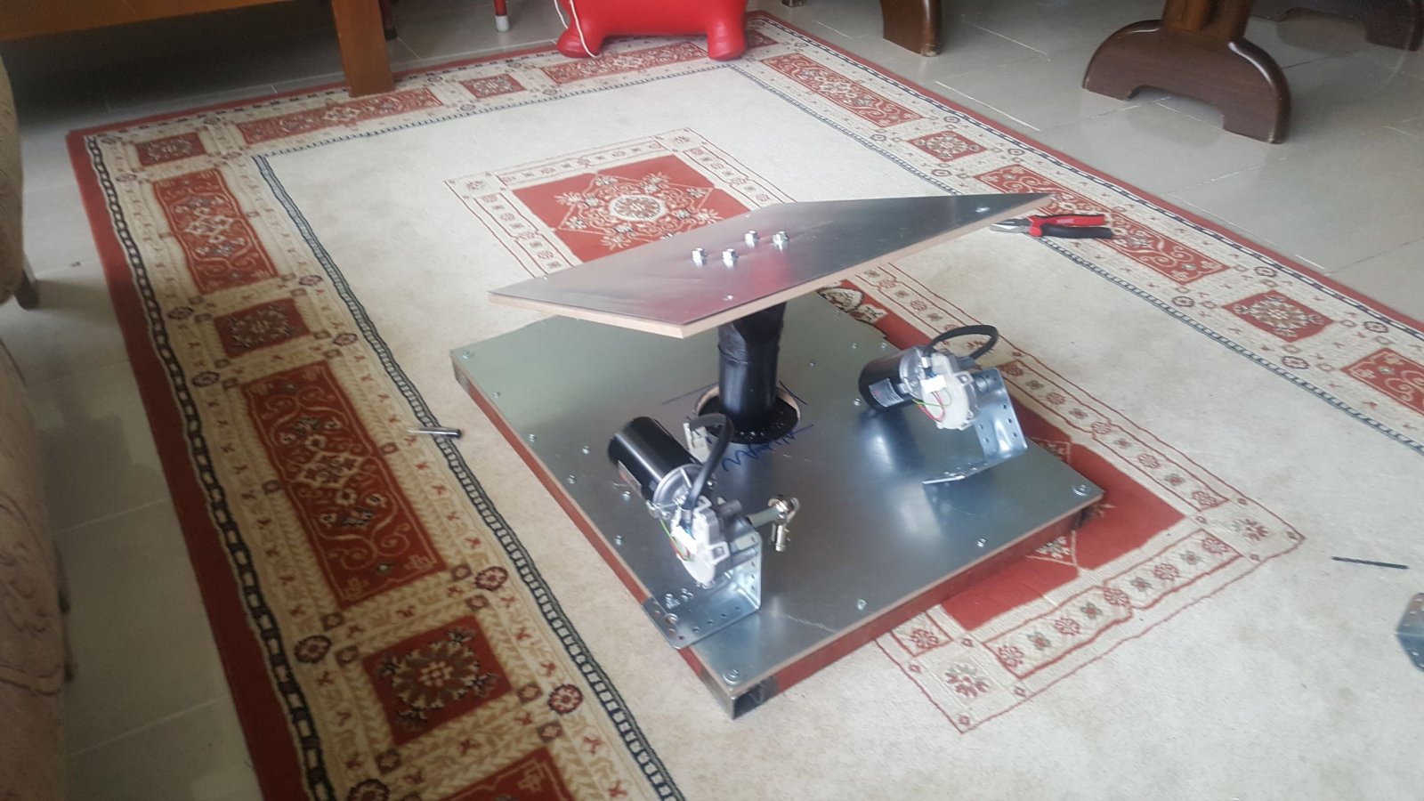

    I then used the middle part of the block to carry the weight, the tip of the shaft of a passenger vehicle

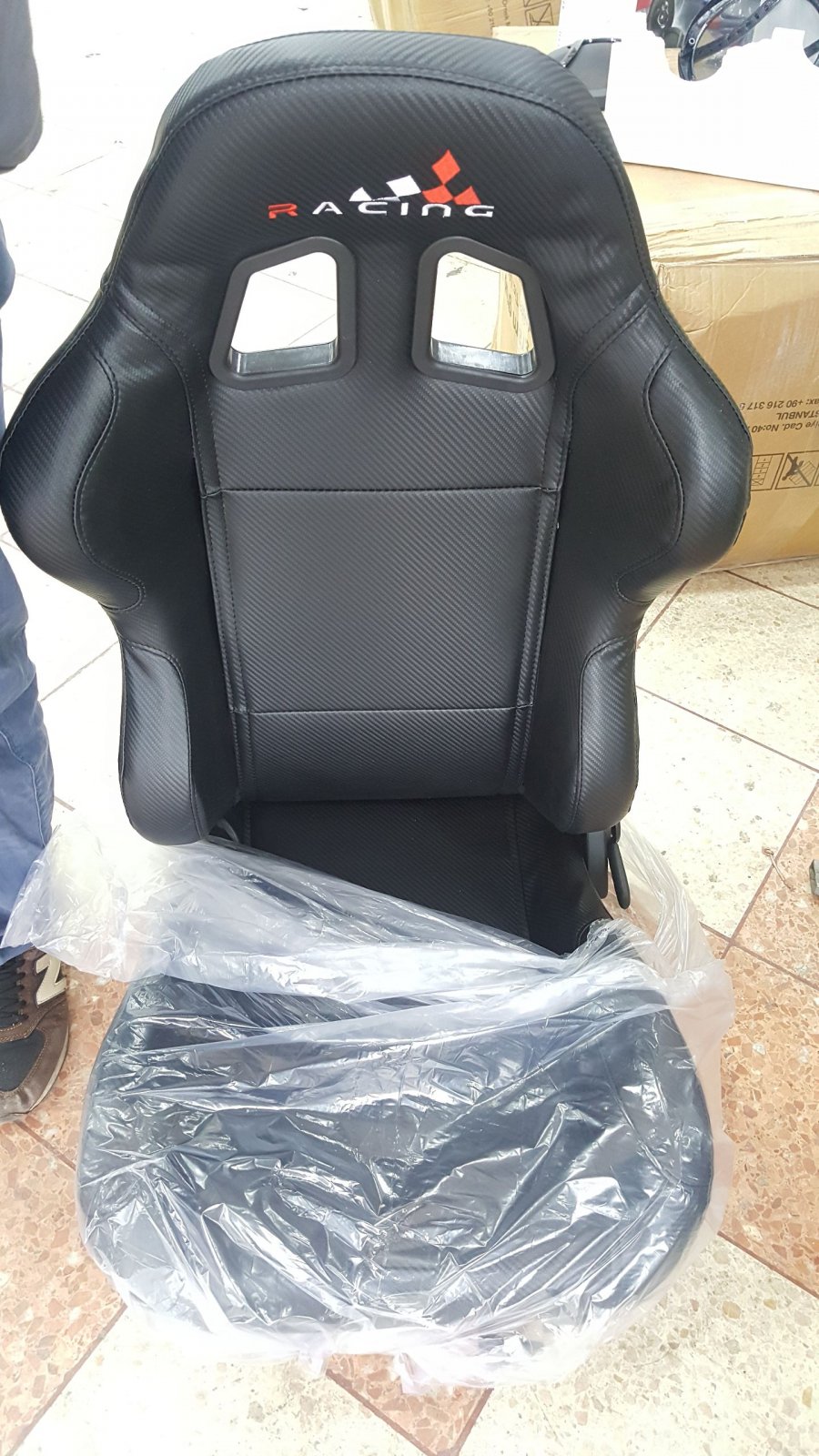

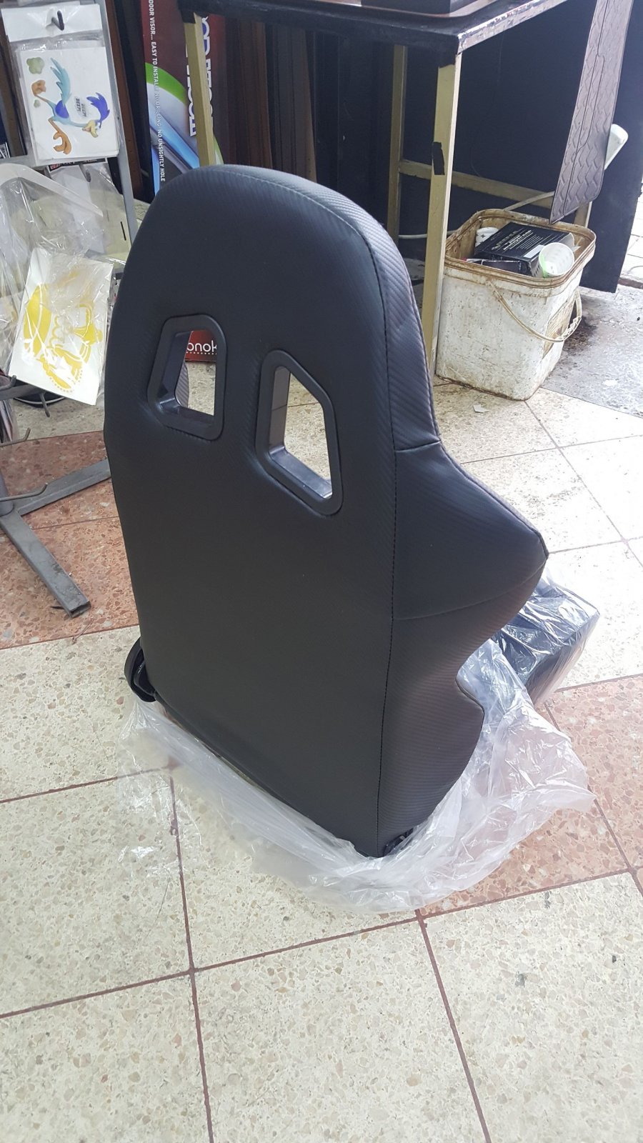

    . I made the lower part of the seat using mdf and metal thin sheet on top
    _20170418_205824.jpg _20170423_200924.jpg _20170413_182213.jpg _20170408_153149.jpg _20170408_153155.jpg _20170418_210103.jpg _20170418_210122.jpg _20170517_223307.jpg _20170408_133517.jpg _20170408_133517.jpg

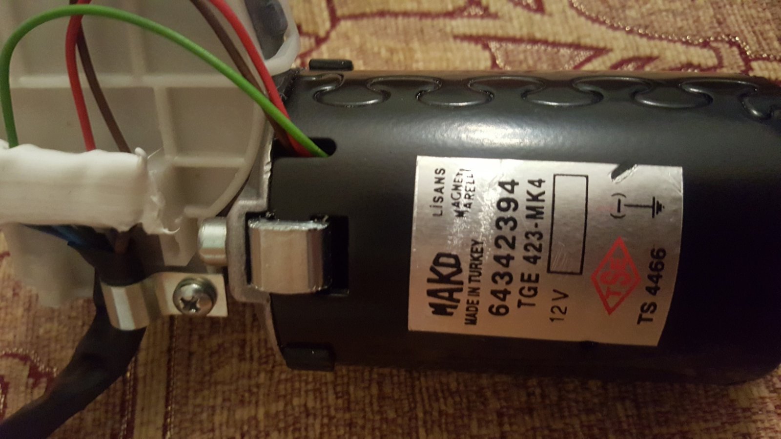

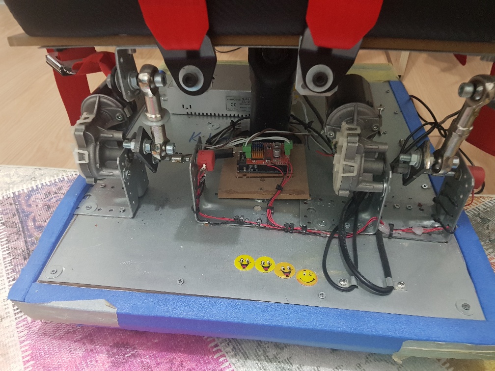

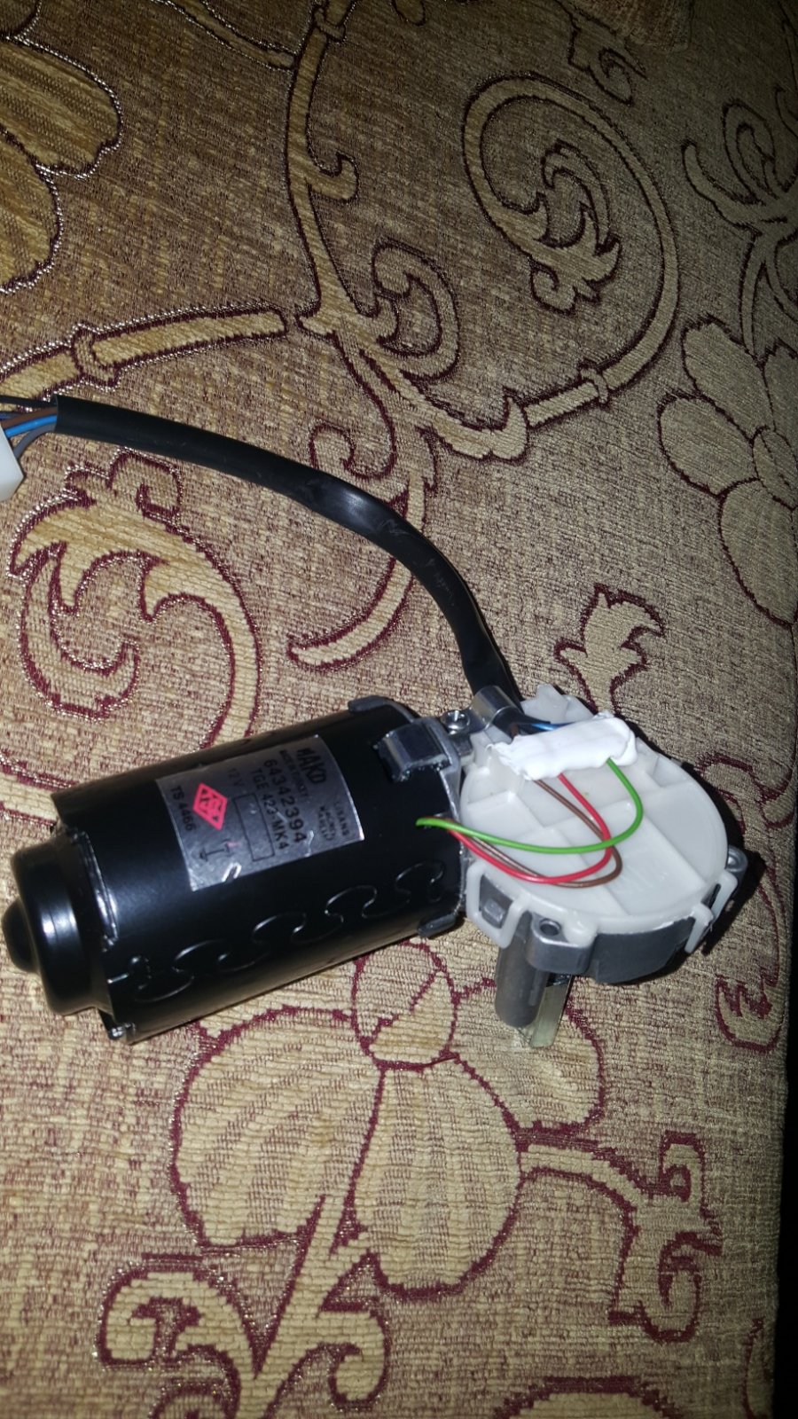

    these steps we will use 12v motors and parts to carry motor movements
    IMG-20170420-WA0031_resized.jpeg IMG-20170420-WA0036_resized.jpeg 20170529_204728_resized.jpg 20170529_204733_resized.jpg 20170529_204755_resized.jpg 20181025_003027_resized.jpg 20181025_003050_resized.jpg 20181025_003103_resized.jpg 20181025_003124_resized.jpg 20181025_003108_resized.jpg 20181025_003116_resized.jpg

    You connected the seatbelt on the sides directly to motor levers, does that act like belt tensioner?
    EDIT: ahh, nevermind, I got the wrong idea in my head.. it doesn't work like a belt tensioner since everthing is connected and moving together with seat
