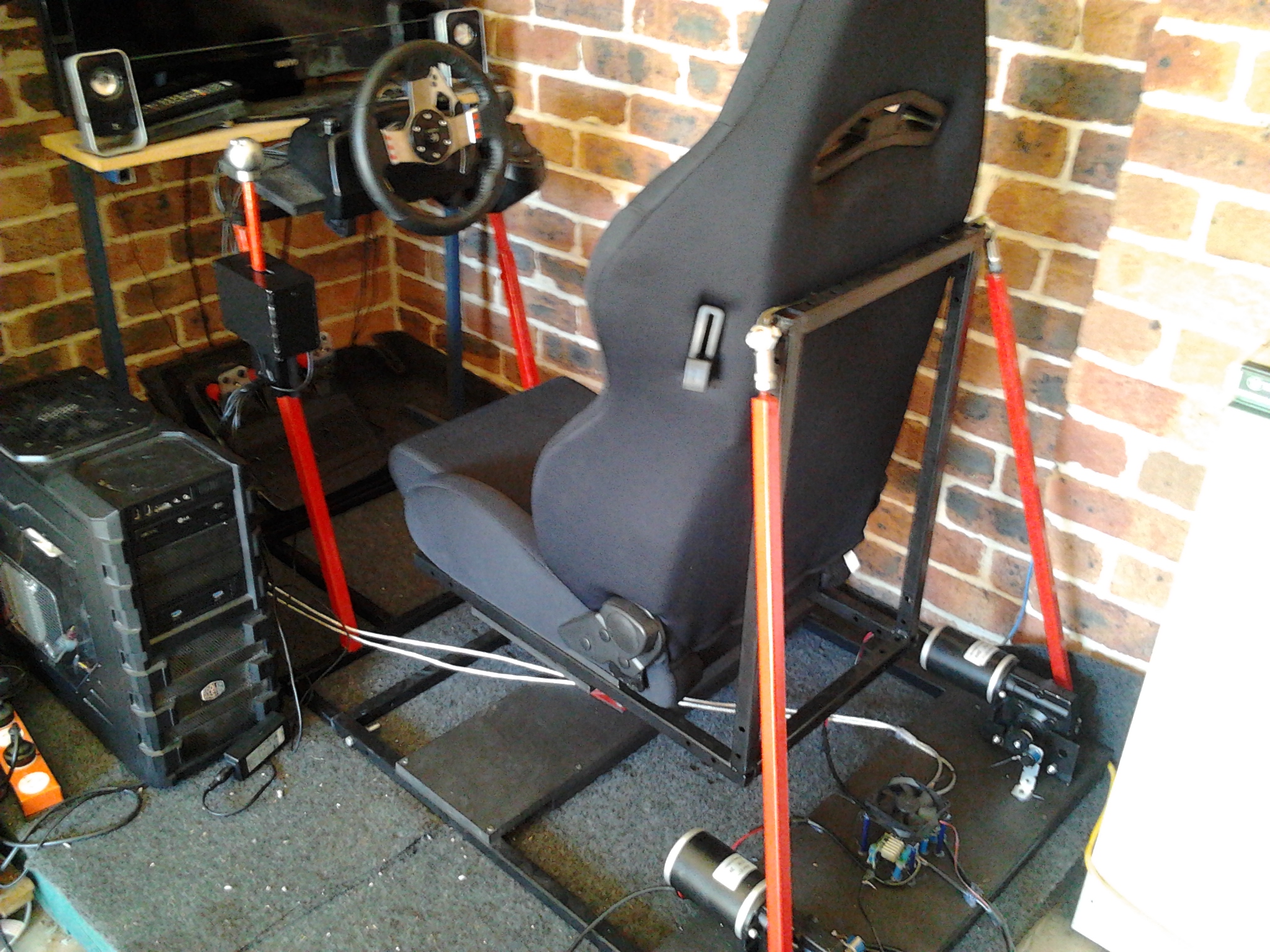

    reserved till later , when I get time to add details 2013-08-13 13.02.57.jpg
  2. bsft
    Sorry, been busy, here you go
    Ok, I am not going to attach a file as I found that once it is copied, I then have to spend 30 mins or more setting the correct direction of my motors/actuators to suit my sim.
    So I Suggest this, with each game, set your forces to a % , then set the motors/actuators to go in the right direction you need, go to tuning centre while in a game, capture max min , and manually change the numbers to suit.

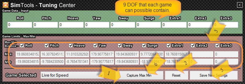

    So when in Iracing i open tuning center fill in the above row the % and in the lowest two rows the numbers? Does the percentage has to be the same as the axis configuration? Thank you

    Ok thank you, but the only think i dont understand is:
    Example, if its surge, untick the box above it and use 2 numbers, smaller number for kick in gears, larger
    number for braking.
    You will have it tune it a bit till you find a number(s) you like.
    • Dumb Dumb x 1
  15. bsft
    theres a tick box next to the word "surge" if its unticked, you can put 2 different numbers in. If its ticked, you can only put one number in and its copied in max and min.
    With the forces, usually surge, with a smaller number in max, gives you that "throw back in your seat" jolt when you step on it and also may give a gear change jolt going up the gears. When you hit the brakes, the idea is not to get jolted forward, but to have a feeling that you are under brakes. Hence a large number min.
    Does that help?
  16. Roel
    Roel New Member
    Oct 10, 2014
    15
    454Coins
    +0 / 1 / -1
    2DOF, JRK
    Thank you for you help. Now i start IRacing and and click op MINMAX START the numbers are like 5.12312421412 and so on. Then i press STOP MINMAX I can change them but like Heave i cannot put in 0.5 or 0.05... Only 1 and above. Then I press SAVE SETTINGS. is this the correct? And then i have to restart the game?
  17. bsft
    thats weird, I dont have iracing, but as far as I know, you should be able to set the heave number below 1. I only have race 07 , grids, dirts, and I can set the heave to 0.05 on max and min.
    Are you setting the profile in a single player or some area that the green numbers are still or off when you pause the game?
    I know if I try to set profiles, in race 07 in multiplayer, the fact the numbers are constantly changing stops me from adjusting. Hence I go to a single player run first.

    Hi, The issue is that iRacing add gravity (1G) to the heave output so the idle position is always 1 and then goes up and down from here. It actually makes heave less useful with iRacing because as soon as you scale it in simtools to get good movement the offset is so great your sim doesn't sit in the center of travel which effects all the other DOFs as well.
