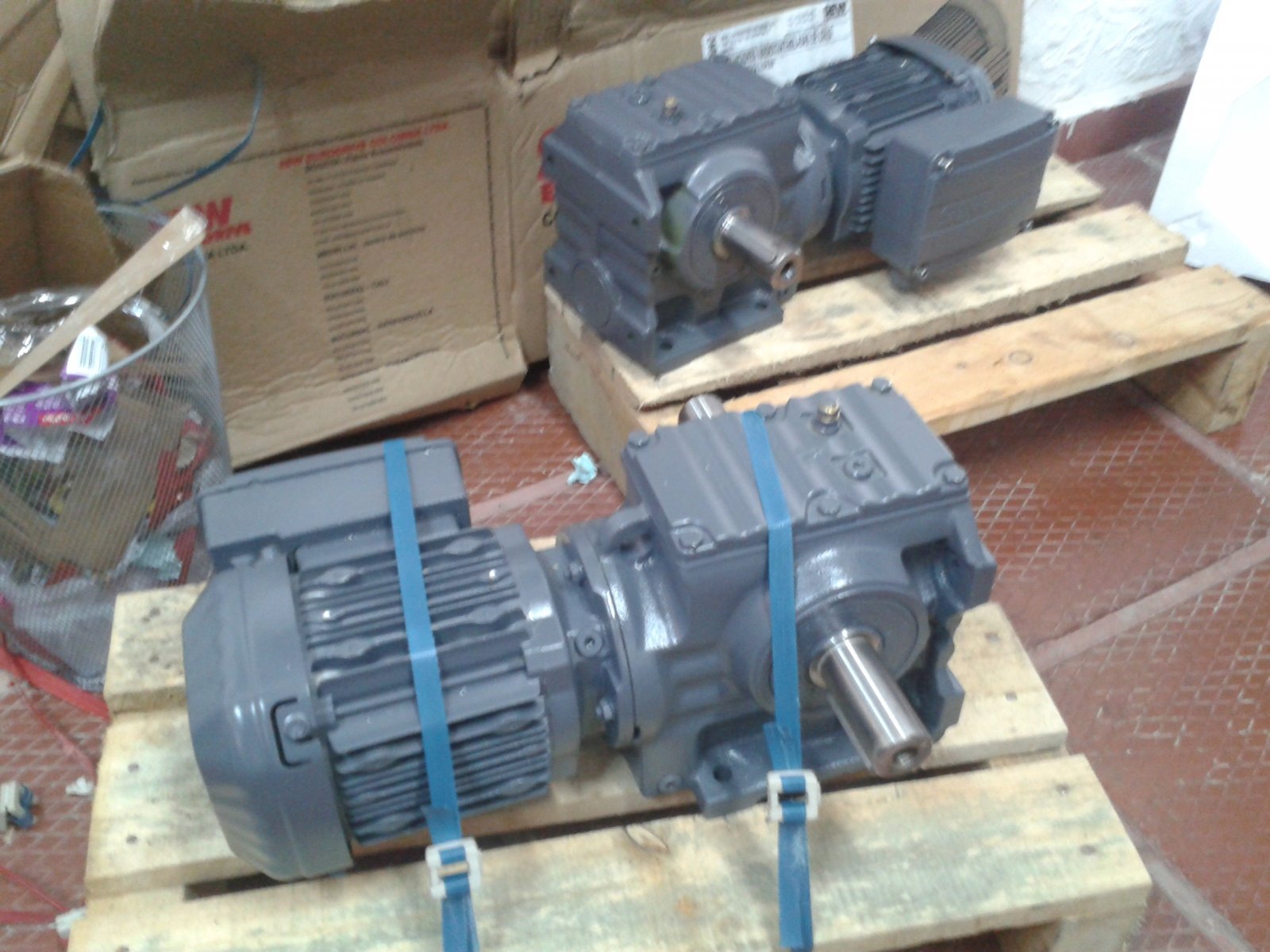

    There are many cheap 0.37kw gearbox motors on Alibaba that you can get for 300Usd the pair. Is better that the wiper motors jejeje

    Im starting my 2dof sim like yours, and I bought SEW motors for a lot of money :(, but any brand of motor with 0.37kw, helical-worm gearbox with 30rpms output and a good VFD will do the job.

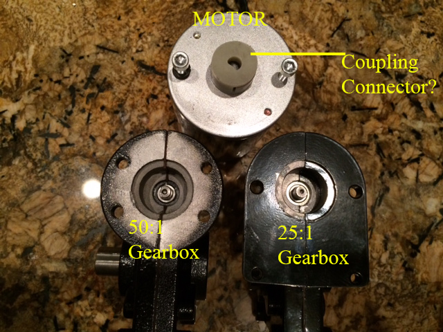

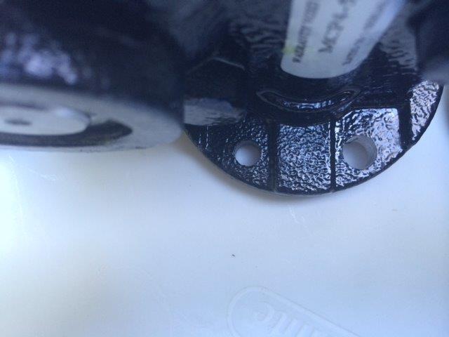

    I've already hit my first snag of sorts. My motors and 50:1 gearboxes arrived from Motion Dynamics. The new gearbox seems to fit well enough even though the motor has 2 screws but the new gearbox has 4 holes. I assume using just the 2 screws is fine but my question is regarding the plastic "coupling connector" that sits between the gearbox and the motor. Is the plastic connector a problem or should I attempt to swap it out for metal?
    Thanks for anyone's input!

    That plastic Flex connector or what ever you want to call it is fine, Only if your doing thing's WRONG will those break. (so ive been told)

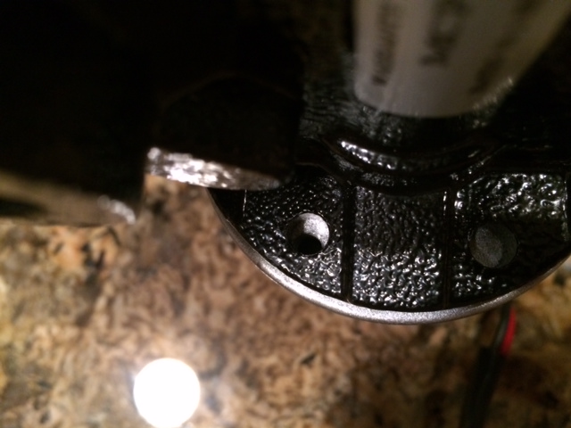

    Ha - well there is only a 50% of me doing this wrong :) But I may not get that far with this motor\gearbox:
    The holes don't actually line up enough to seat the gearbox by at least 2mm (it looks worse in the picture). Ideas? Widening the hole on the gearbox seems too risky.
    Another problem is how do I attach a rod end to the solid bolt? Drilling and tapping the opposite side for the pot seems easy but I cant tap this 20mm bolt for 10mm threaded rod.

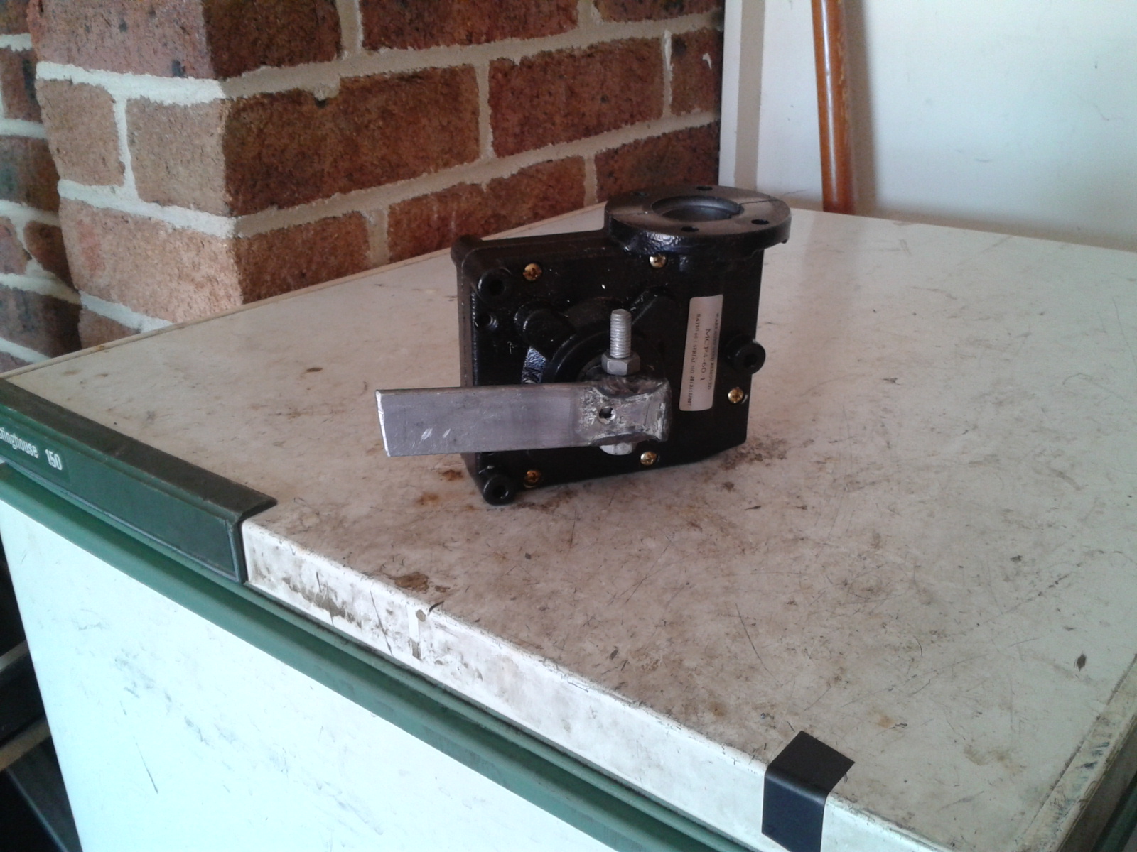

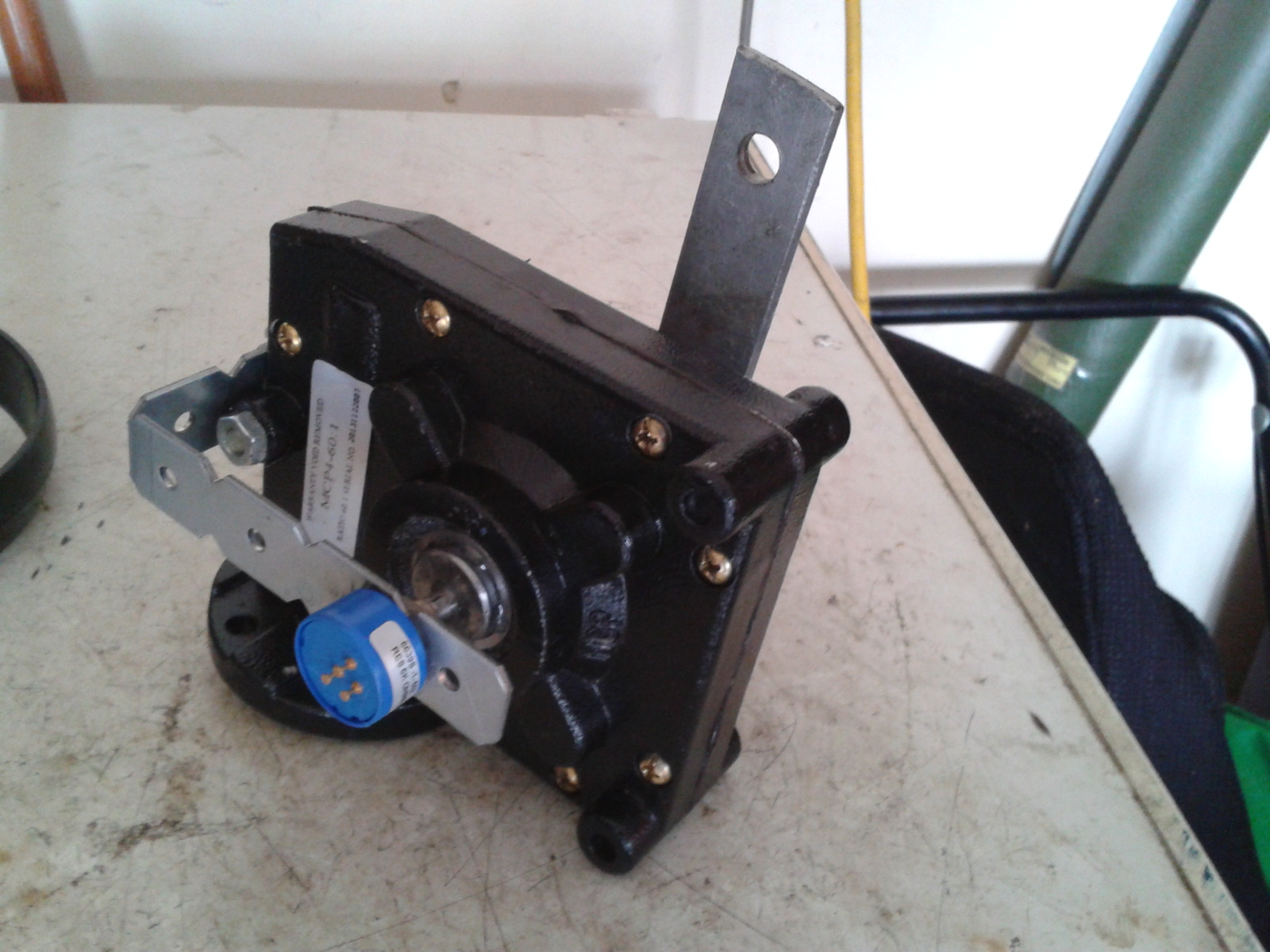

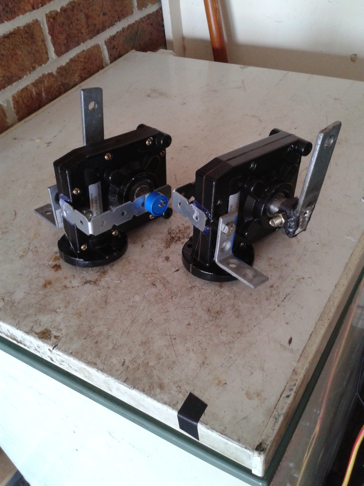

  16. bsft
    not the easier to do.
    I made a lever and ran a bolt through it, on and I drilled the holes out a bit more so they lined up.
    With the plastic couplers, worry if they break. Then look for metal
    The pot I just glued into the back in a drilled out hole, but in hindsight, I should have tapped a thread into it and then attached the pot on that

  19. SeatTime
    2,573
    28,320Coins
    I just welded a coupling for my pot onto the 60:1 gearbox (it is a steel gearbox unlike the standard motor 25:1 ). Drive shaft on the other side is connect via a fitted pipe with a key-way welded in and a threaded hole for a bolt.

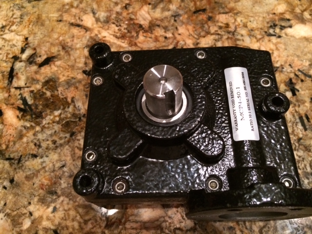

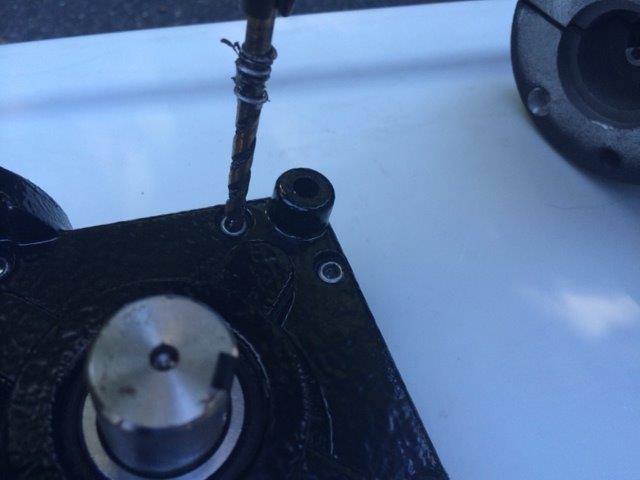

    Thanks guys! I'll definitely use one of these methods depending on what I can find.
    Just welded today for the first time. It's an art to be sure. I'm not having a problem getting a solid weld (I hope!) but pretty is another story! I can draw a straight line but getting solder in a straight line is harder than expected.

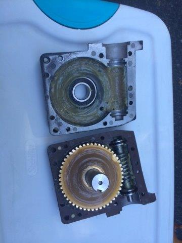

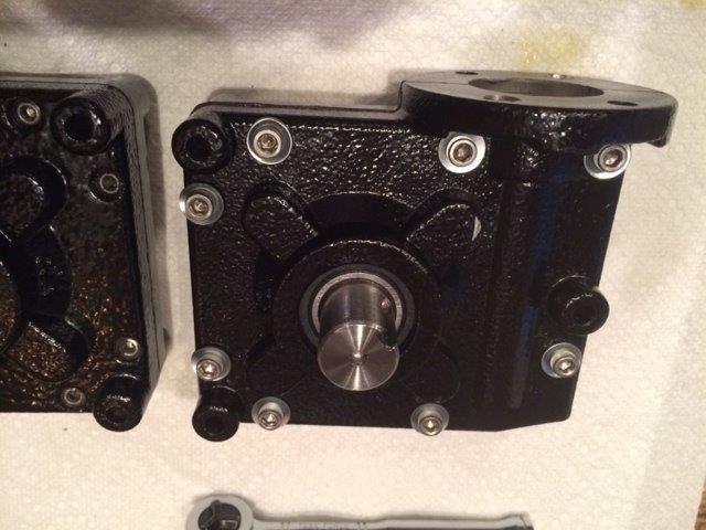

    This week I've managed to take the 50:1 gearbox apart, swap the bolt, and mount to the motors. For anyone using the same motors and gearboxes:
    - Tapping out the rivets was proving difficult so I drilled them out with 3/16" drill bit (5mm will work). Fast and easy. Use some can air to remove the shavings before taking the drive apart.
    - Once apart, the bolt slid right out and I reversed the direction to make it a left angle drive. This was 10x easier than I thought it would be.
    - I purchased extra rivets from motiondynamics but I didn't even try using them in case I need to get back in the gearbox. I used #10 x 1.5" screws. 5mm x 35 or 40mm screws will work.
    - A 5/16" drill bit (8mm will work) was used on two of the gear box mounting holes and now it fits perfectly on the motor.
