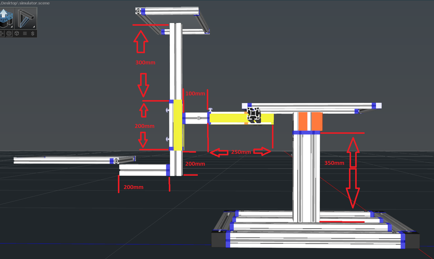

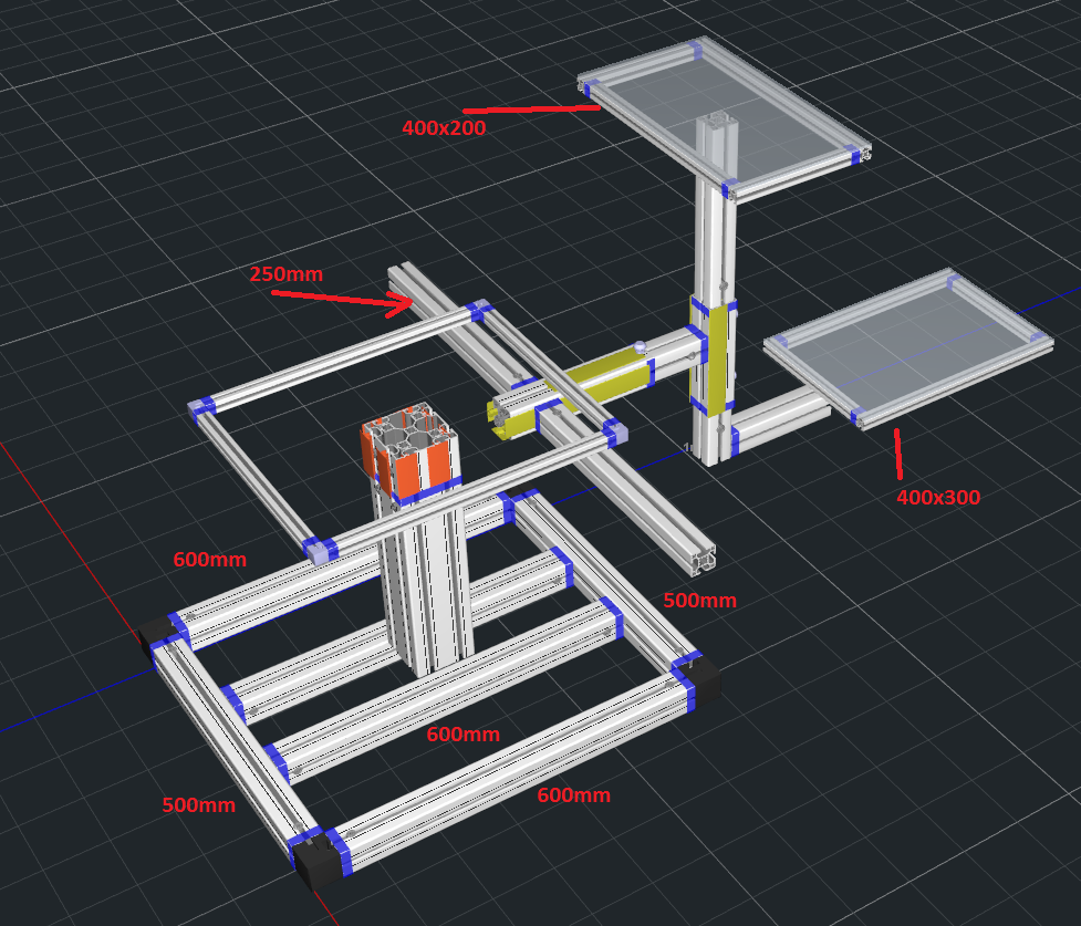

    3D model
    I've attached two images showing my 3d model.

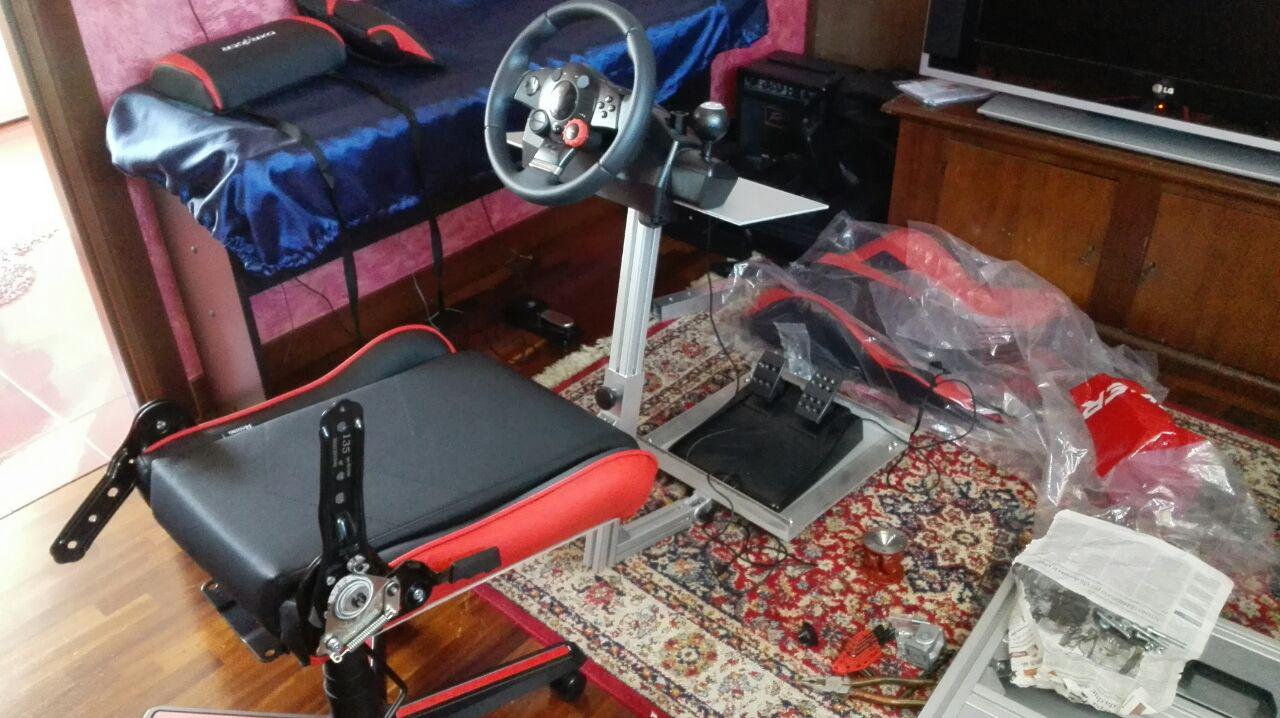

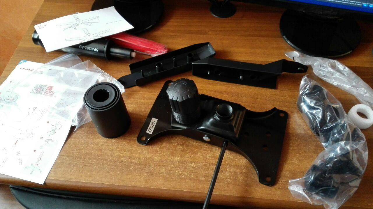

    Today arrived my new seat... very well made. I've attached some photos at this post.
    Regarding electronics, i'm 90% convinced to use 2 JRK+ classic HP PSU...but I want to take more time to make final decision :)
    Now I'm thinking about structure.

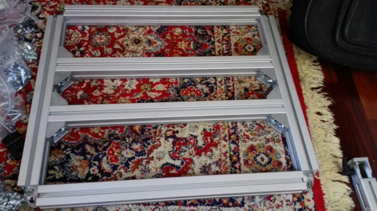

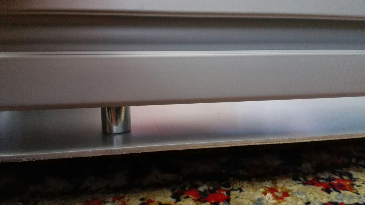

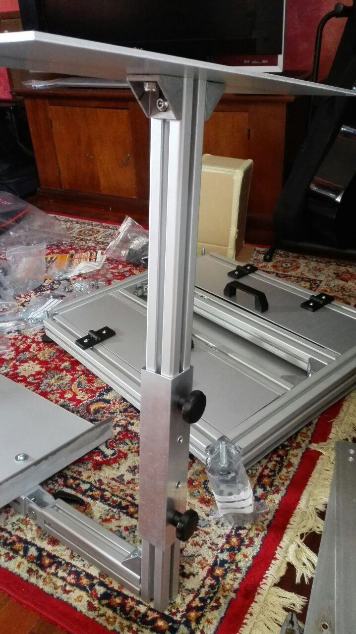

    Hi to all,

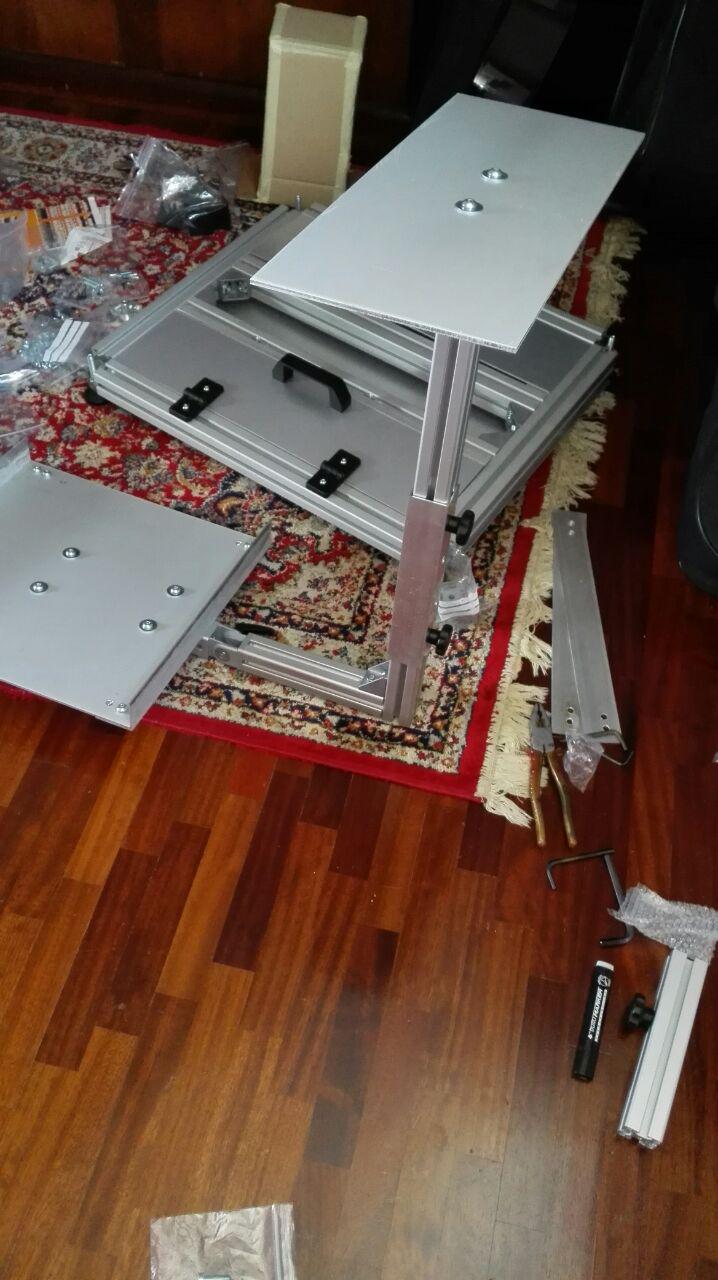

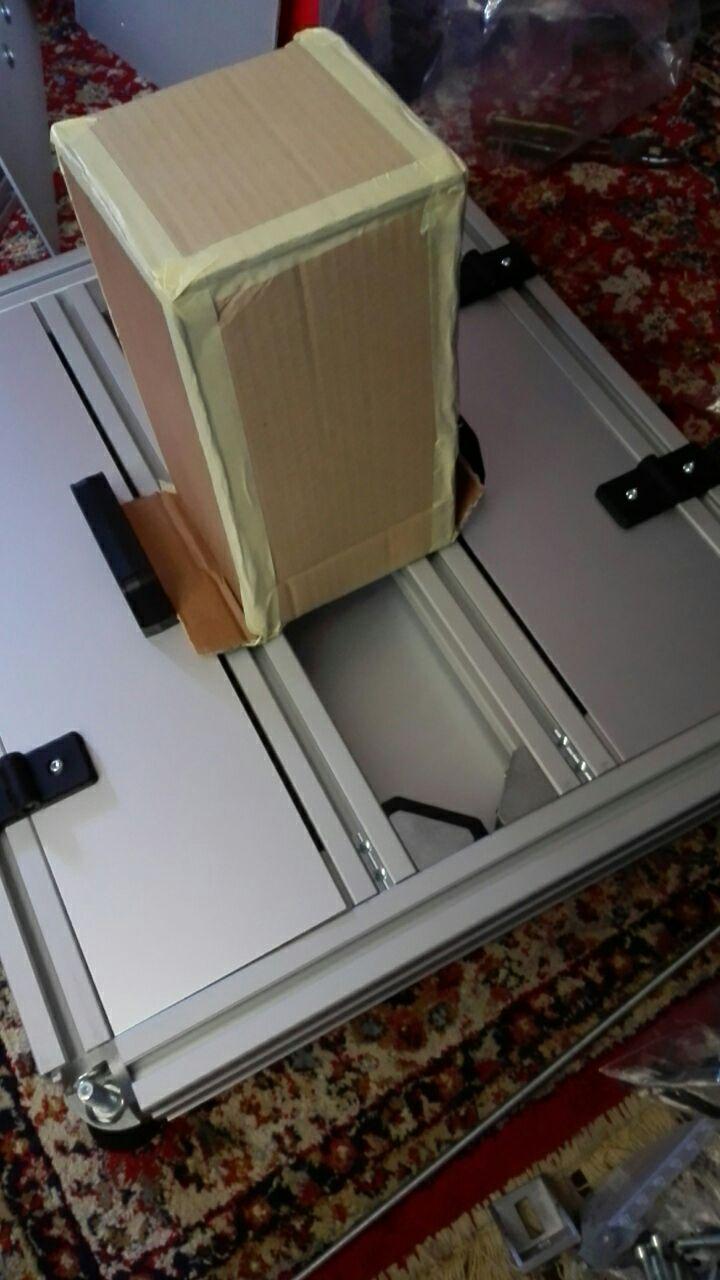

    It's been passed time since the last time I wrote, but I've worked hard on my simulator. First of all, finally I've decided to use JRK.

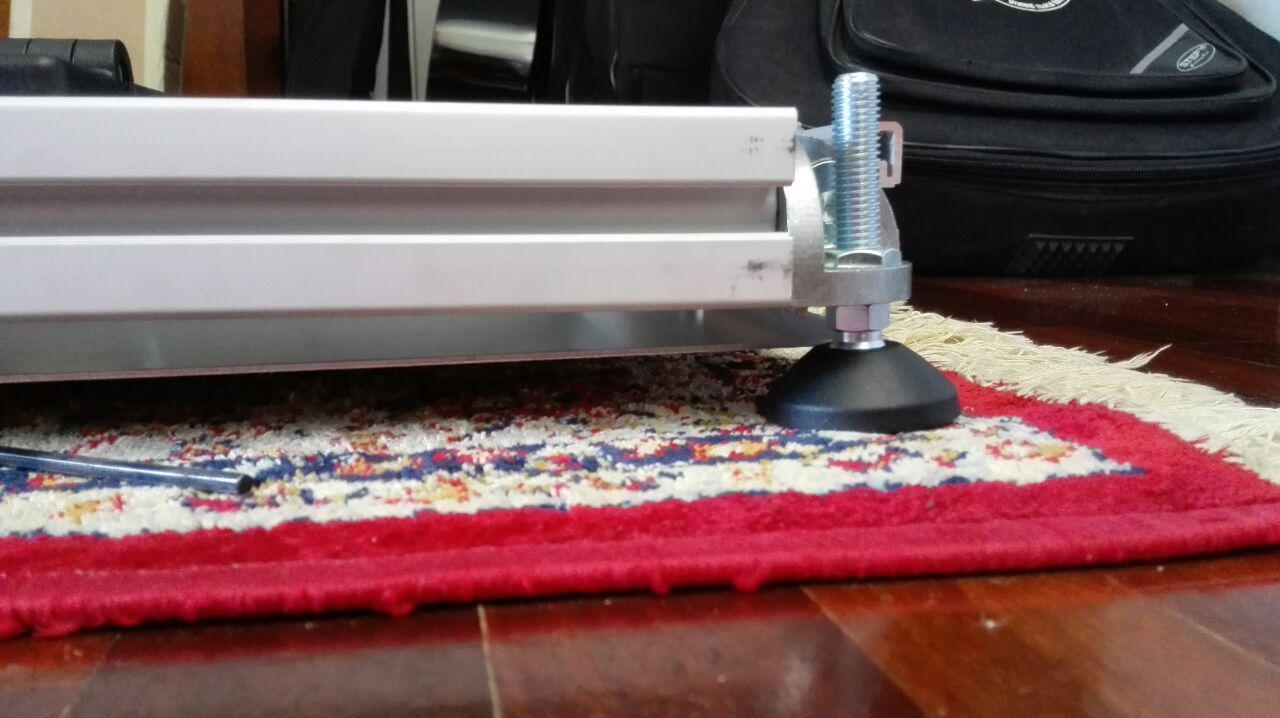

    For now, I've built the base using 45x45 profile. I've used spacers to create a suspended base where electric wires will pass and i've bought anti-vibration feet wich can support up to 500KG .(photo: 1,2,3,4,5,6,7).
    After that, i've prepared the base under the seat with 4mm aluminium plate. I've used the original holes of seat (photo: 8).
    Finally, i've build the structure for steering wheel and pedal (It's easy to see that i've inspired my work to @noorbeast 's simulator) with 40x40S aluminium profile. The plate for steering wheel and pedal is 4mm. (photo: 9,10).
    So in the final photo of this post (photo: 11) you can see the structure as it should be. I like my solution, but maybe i've made a fatal error; structure of steering wheel and pedal (photo 9) is too heavy. Its weight 6Kg and in the future I want to use Fanatec steering wheel and pedal (wich weighs 7 KG). In fact, I've tried to place plate under the seat (to make a try, without fix any bolts) and i've inserted this structure...now the center of the base under the seat it's inclined:(

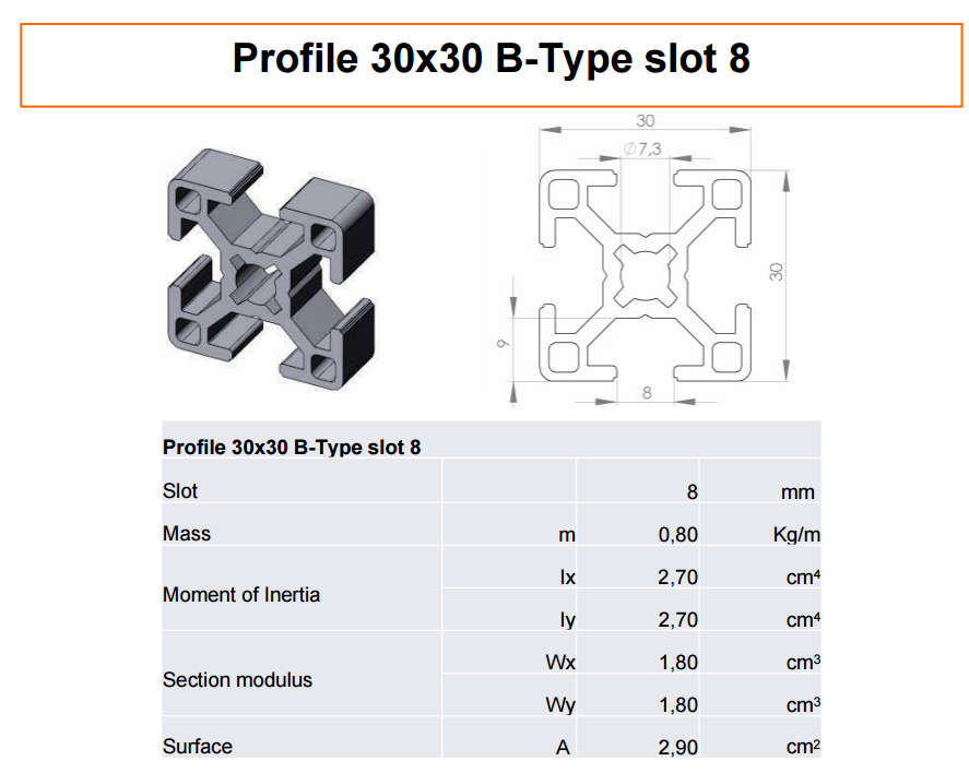

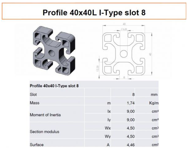

    My decision to use 40x40 profile comes from the table attached here (photo 12), wich says that Inertia of this profile is 9cm^4 so i've thinked its very resistant...but weighs 2,70Kg/m...so maybe this is a overkill. I'm thinking to make all of structure in photo 9 more lighter.
    What do you think if I use the profile in photo 13 ? Is 30x30 and has Inertia 2,70cm^4 and weighs 0,80 Kg/m. I do not know if it can be strong enough, maybe it's to light? . I haven't any problems to reoder this kind of profile..it's important to make a good job.
    I think that another thing to do to avoid unwanted blending is to make structure in photo 8 with more points of grip..but i'm not sure
    Any other suggestion is appreciated hug:

    +77 / 2 / -0
    First of all, I must repair this big problem :D Any suggestion? It's very appreciated ;)
    20,551
    145,124Coins
    +10,779 / 52 / -2
    It is not just the weight of things like the Fanatec wheel and pedals, that mass also has a considerable leverage length compared to that the motors have on a compact design.
    The multi options you have is to maximise the leverage length for the motors within your design parameters, maximise the torque in the motor/gear ratio chosen and lever CTC length, plus keep the wheel/pedal frame as light as it can be without flexing, which is not just the profile chosen but also how it is braced.
  12. mirkobastianini
    mirkobastianini Active Member
    Jan 23, 2017
    193
    informatic
    italy
    1,300Coins
    +77 / 2 / -0
    Ok, it's clear... so, in my mind I'm thinking to doing 4 things:
    1) Do the universal joint's base about 35cm height. This means that 35cm+7cm of Universal joint=42cm of height...like a normal chair, so in this way I think i've maximized the leverage length for motors.
    2) Use the 30x30 profile, as I said in the post before. My fear is about the inertia and the real strength of that profile. In fact, if I use this kind of profile, my structure become around 3/4KG, wich is more light. But maybe, this can cause unwanted destruction, because the inertia of this profile is much less. So, I should need suggestion from persons on this forum, wich are more expert than me, if is the case to do this change. It's a good choice to use this kind of profile or It's better to stay with my original 40x40?
    3) Brace the structure to seat. in your opinion, what should you do to fix how the structure is braced to seat?How I can reinforce it?
    4) Change the thickness of pedal's plate. In fact, i've used plate with 4mm of thickness...maybe it's too much. Wich is better? 2mm? or 3?
    Thanks :)
  13. noorbeast
    20,551
    145,124Coins
    +10,779 / 52 / -2
    1) I don't mean the height, I mean the length from the pivot to where the rods connect.
    2) Possible, which relates to point 3.
    3) I used light wall tubing with substantial reinforcing plates between the horizontal and vertical tube mounts, to prevent unwanted flex.
    4) Yes do keep it light. I used angle for the pedal frame for rigidity and pretty thin checker plate for the infill. On mine it is actually the frame that supports the pedals, not the infill plate.
  14. mirkobastianini
    Jan 23, 2017
    193
    informatic
    italy
    1,300Coins
    +77 / 2 / -0
    Perfect.
    Ok, so if You have used light wall tubing with reinforcing plates I think that your structure is very light..maybe around 3KG (without steering wheel and pedals). Mine it's very heavy, it's 6KG without nothing attached...Just to give you an idea, I struggle to hold it suspended with one hand. I'm seriously thinking to buy another 30x30 profile and do structure another time from scratch.
    What thickness do you suggest to use for pedal's plate? Here in Italy I can choose between 1,5mm, 2mm, 3mm and 4 mm(wich is too much). And for steering wheel? It's better to stay with my 4mm or buy something lighter?
  15. noorbeast
    20,551
    145,124Coins
    +10,779 / 52 / -2
    As I said it is the angle frame of my foot mount that takes the real load of the pedals, so if done like that 1.5mm infill would be fine, as it is just infill.
  16. mirkobastianini
    Jan 23, 2017
    193
    informatic
    italy
    1,300Coins
    +77 / 2 / -0
    Ok, if i remember well your thread, you have used 40x40 angle with 4mm of thickness...right?
    Thanks noorbeast :)
  17. noorbeast
    20,551
    145,124Coins
    +10,779 / 52 / -2
    Yes, but likely you could go a little thinner if weight is critical, though 4mm is not all that heavy.
  18. mirkobastianini
    Jan 23, 2017
    193
    informatic
    italy
    1,300Coins
    +77 / 2 / -0
    Thank you noor!
    And another question to all.. It's strictly necessary to give an angle to pedal plate? I ask this because i've see that your simulator (noorbeast) has a little angle that go to pedal frame.
    I ask this because, as you can see from photo attached, I have 90° angle that goes directly to plate, and I don't know if I should give another angle to pedal plate... In my original idea, I've thinked to use lock/swivel , but i've seen that it's not enough strong, so I've abandoned the idea..
    Now I do not know if it's better to not create angles (and directly take advantage of the pedal angle itself) or to think an alternative solution to attach something to the aluminum profiles and create the desired angle... Any suggestion?
    I've seen this from motedis.com,
    http://www.motedis.it/shop/Accessor...o-45G-30-scanalatura-8-tipo-B::999991025.html
