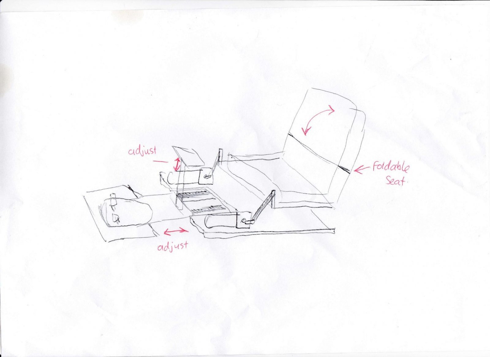

    Hi there again, I believe I am to post builds here, so this is what I have got so far
    After extensive reading and some ideas, this is what I have. Final measurements are not yet worked out, but its a start.
    I am needing a compact simulator, so I have come up with this idea.
    It will compact up when not needed, so I am looking at building my own folding seat. I have seen plywood used with home made covering.
    The wheel mount post will be adjustable up and down and the pedal mount slide-able back and forth. Still working out where to hang the shifter, off the side somewhere I guess.
    Oh, I have a G27 set up currently.
    And the seat folds down so its all flat, sort of.
    Not sure how yet to make this up. I can weld and have done projects with robotics a bit for the local youth centre, so I have a few ideas on how to go about it.
    I happen to have a tailshaft here from a wrecked car, so thats the uni joint pivot thing covered. (From what I read)

  2. rattler
    rattler

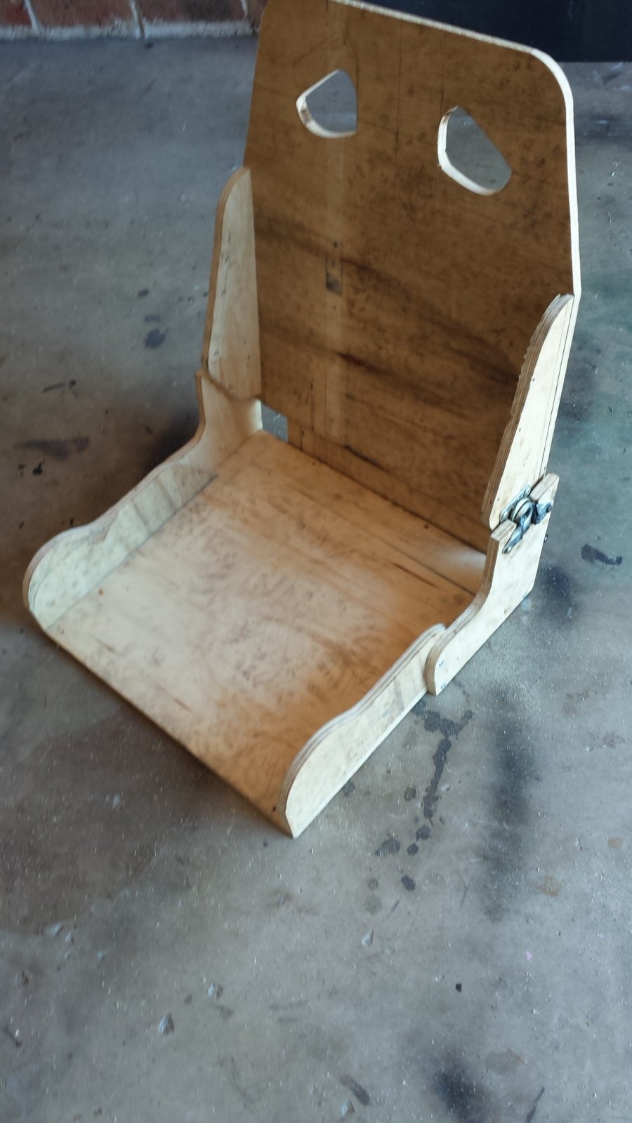

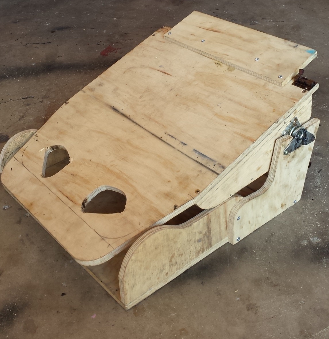

    Heres what im thinking. A home made seat that folds like this.
    I have plywood , jigsaw , I could modify a few castors to act as side hinges.....
  3. rattler
    rattler
    Damn internet. Heres the pic

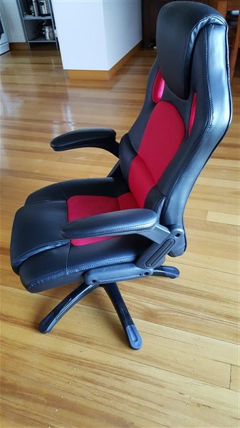

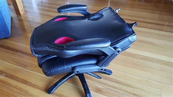

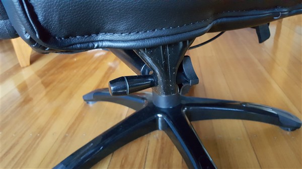

    I know you plan to build your seat but thought you may find these and interesting comparison, where the race style office chair has the back fold down, I just added a simple quick release screw so it folds.

  10. rattler
    rattler

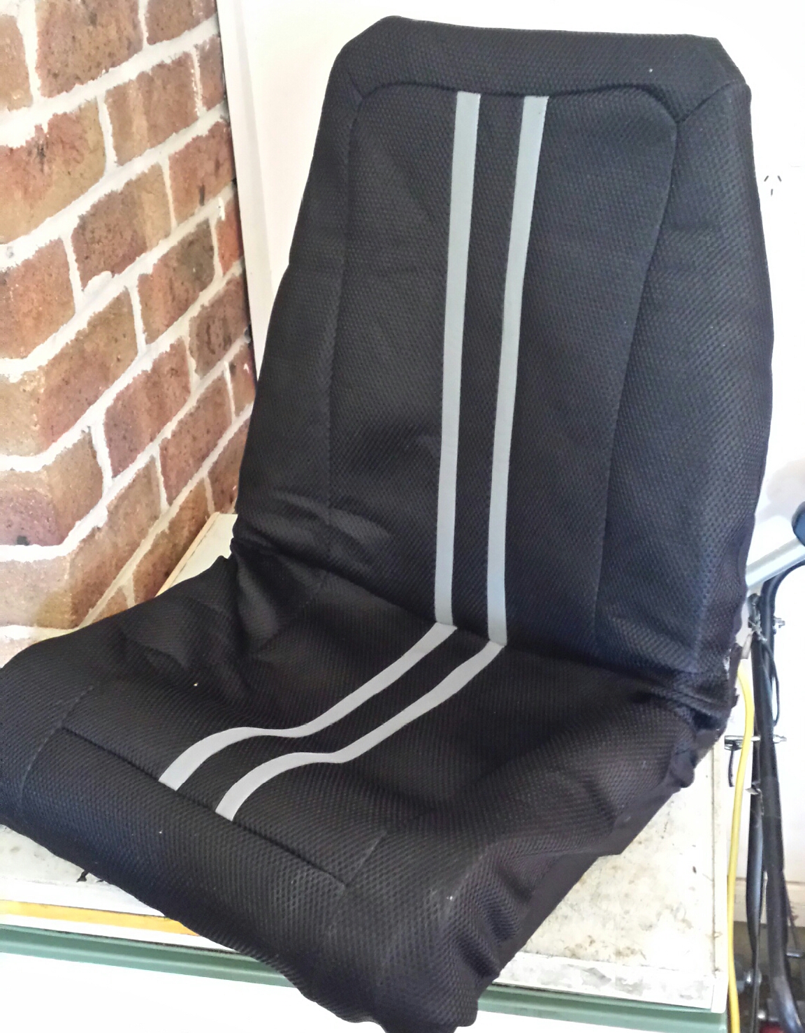

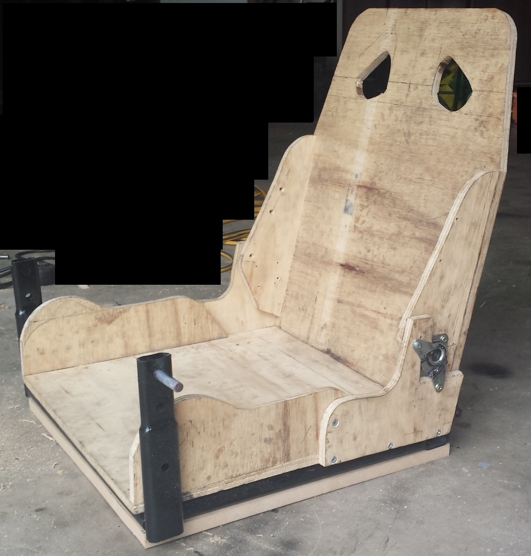

    20151120_120620.jpg well its been a busy morning. I cut out a 12mm thick plywood seat. Ive used modified castors to act as side hinges. Ive yet to pad and cover it.
    Just getting started before I go back to work next week.
  11. rattler
    rattler
    Ergh. I detest mobile internet.

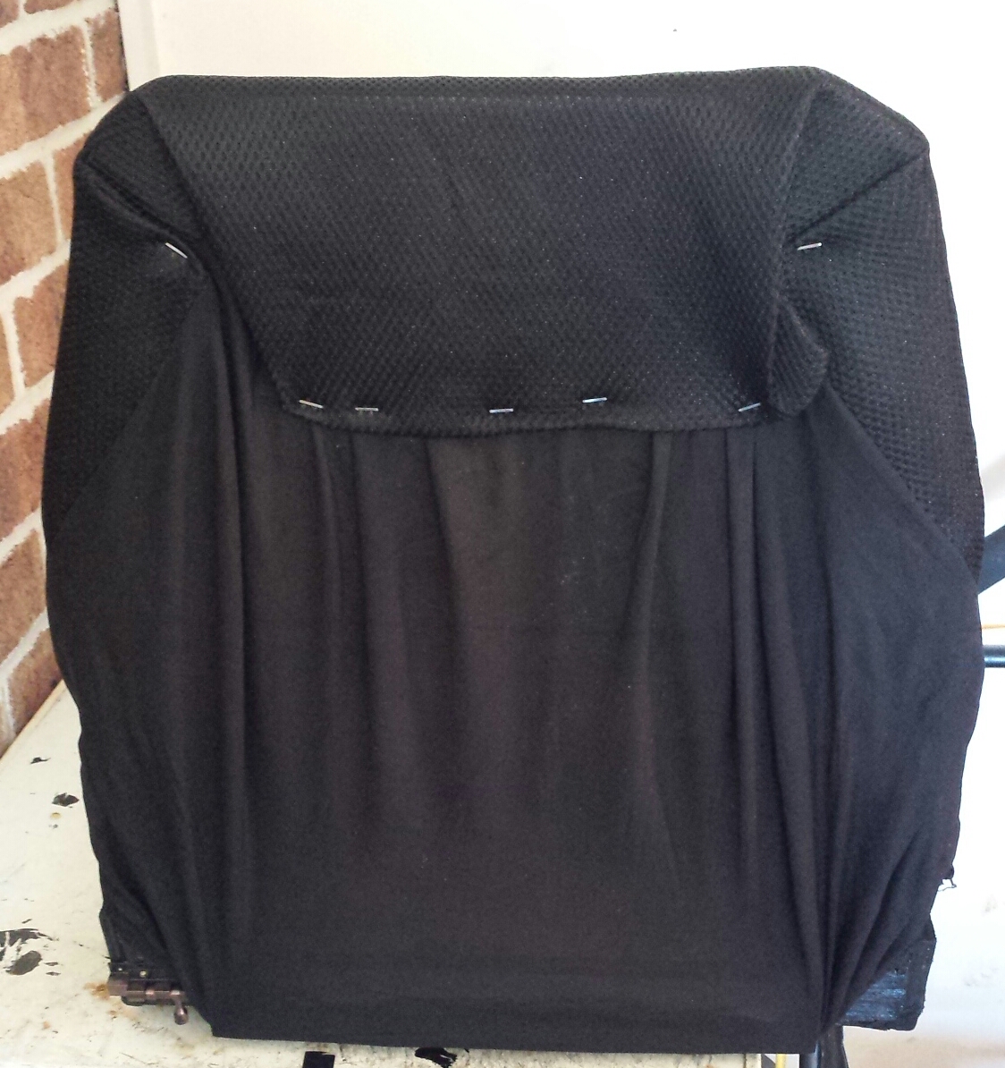

    Heres it folded
  12. rattler

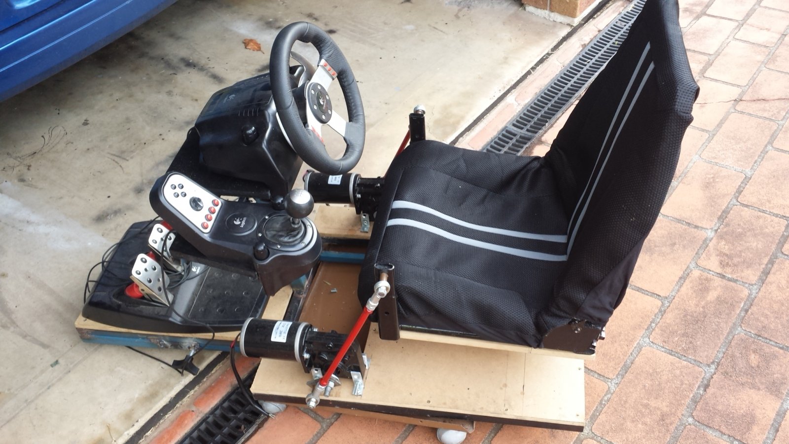

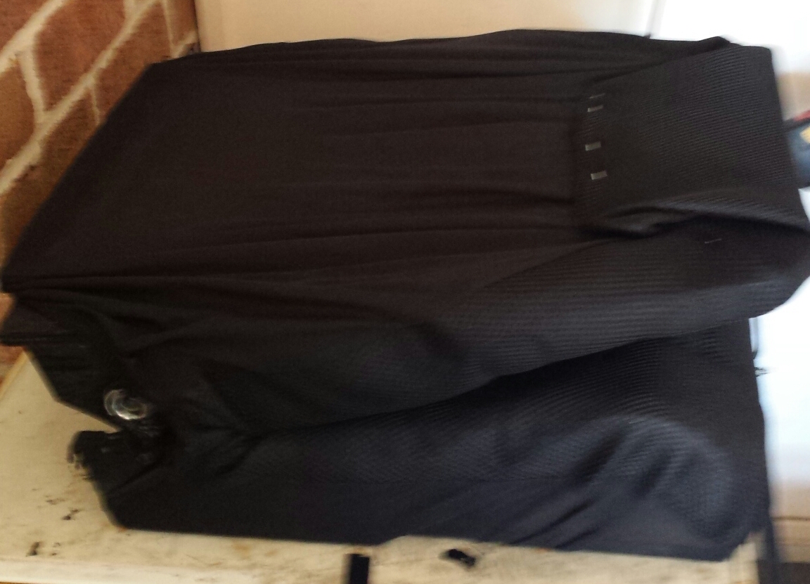

    rattler

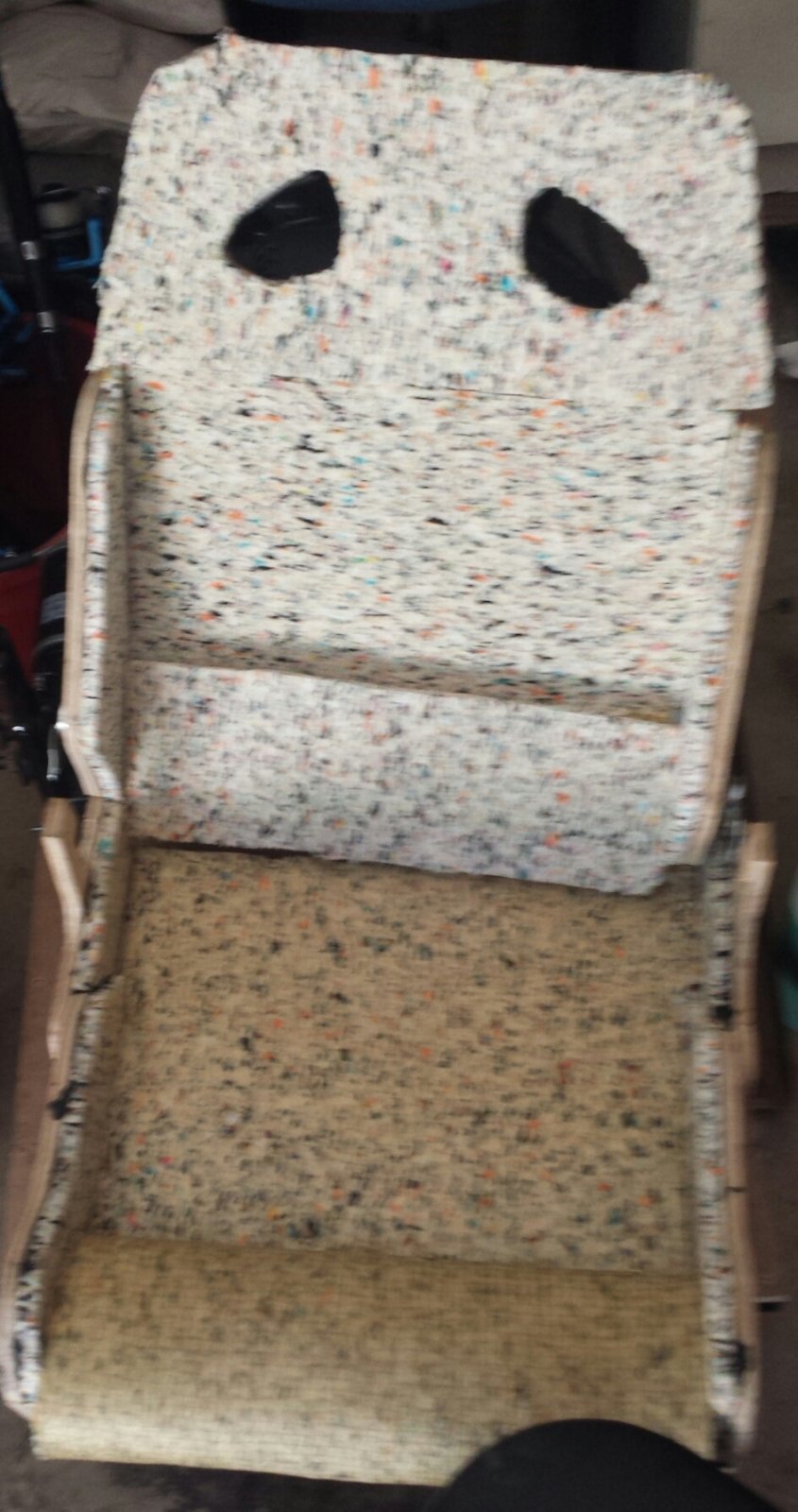

    Righto, final work for the day, I welded up a frame like @bsft desk racer, so motors will be out the front and not underneath as I need to keep this thing sitting low
    Also I padded the seat frame with carpet underlay, its quite firm and I put a seat cover over it and stapled it into place. Simple but effective, pointless cutting harness holes, but hey, its covered
    20160225_123336-1.jpg 20160303_120853-1.jpg 20160303_120911-1.jpg 20160303_120929-1.jpg
    Thats it for at least a week or so, until I get time to get back into it.

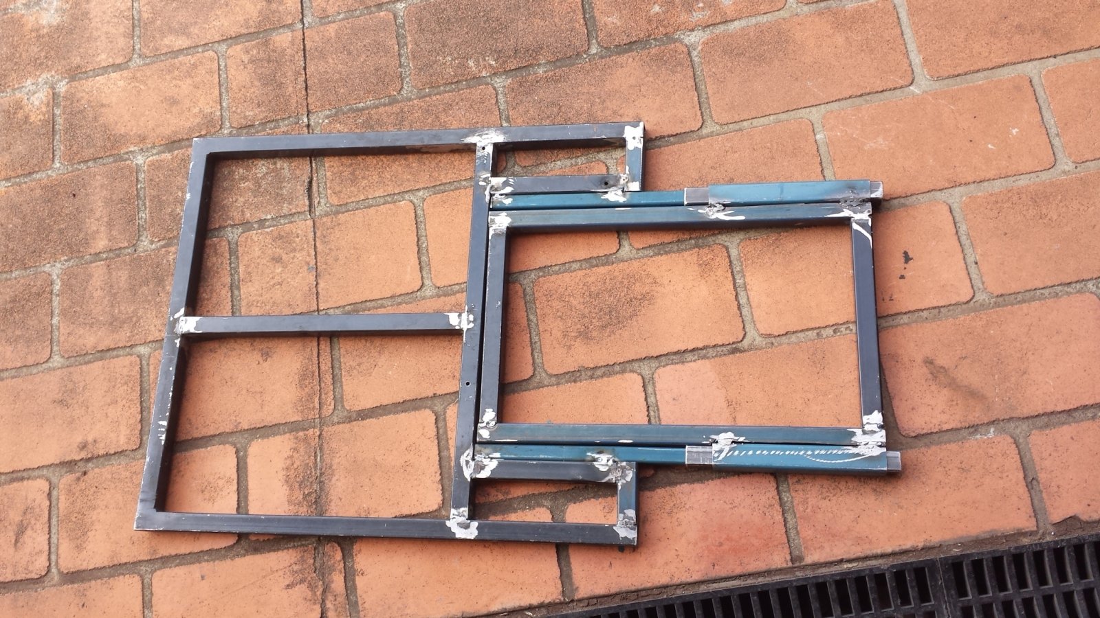

  15. rattler
    rattler

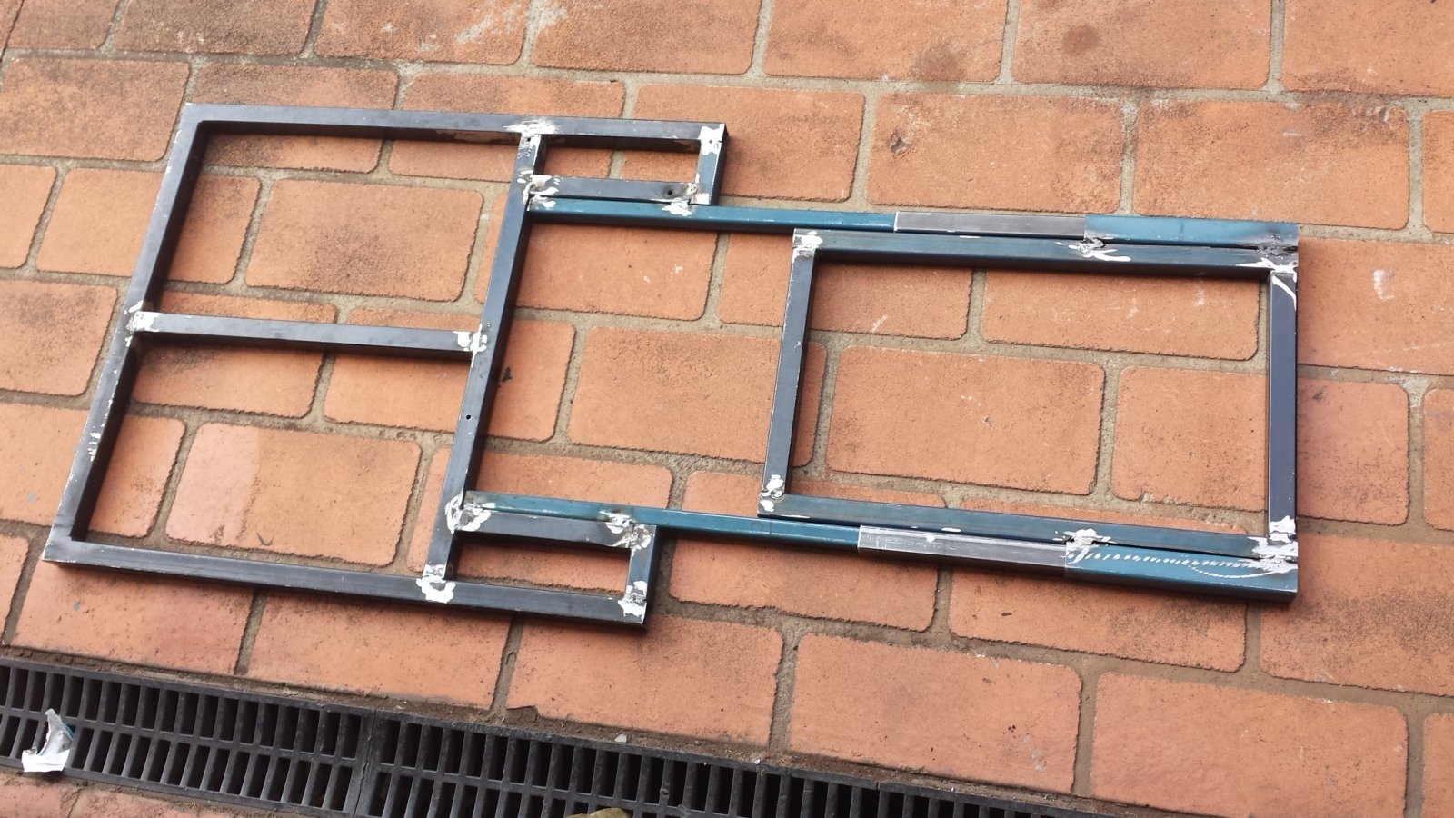

    well I got the frame welded up today, a few mods to do to it yet, the wheel base extends out and in to keep compact.
    I took it to @bsft for him to check, got 5 thumbs up

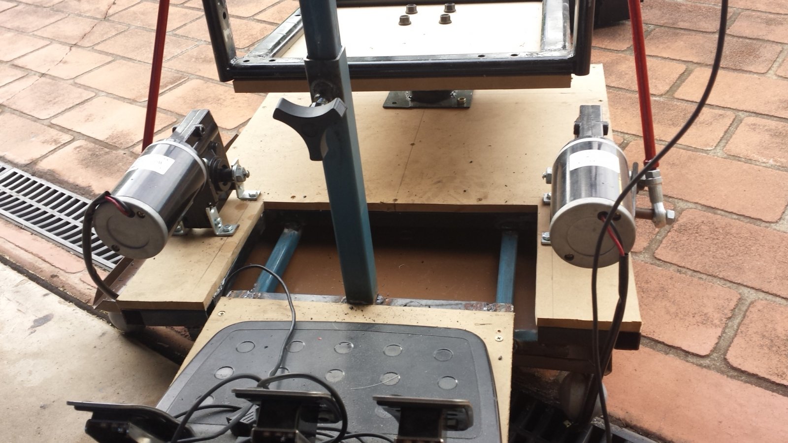

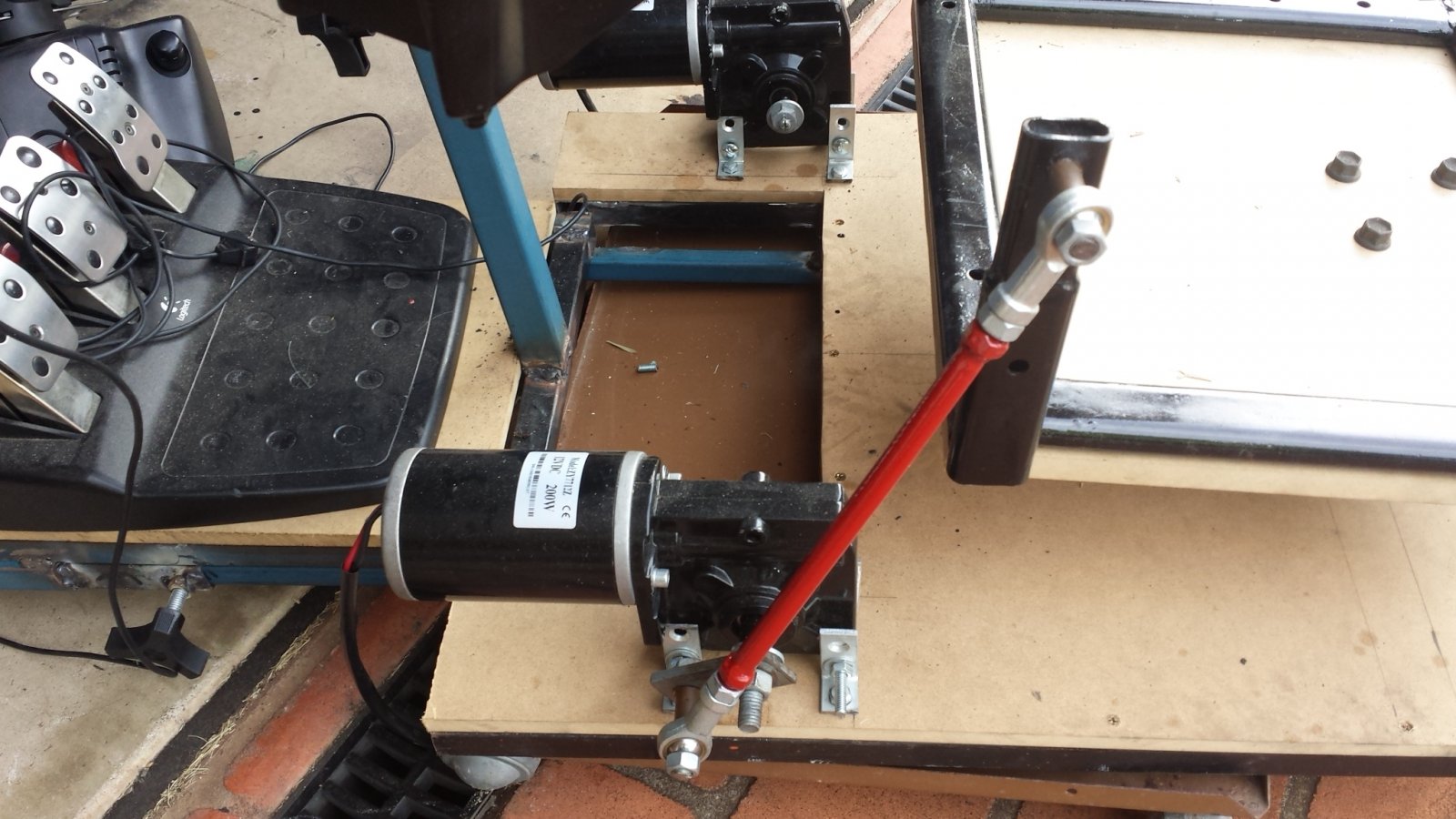

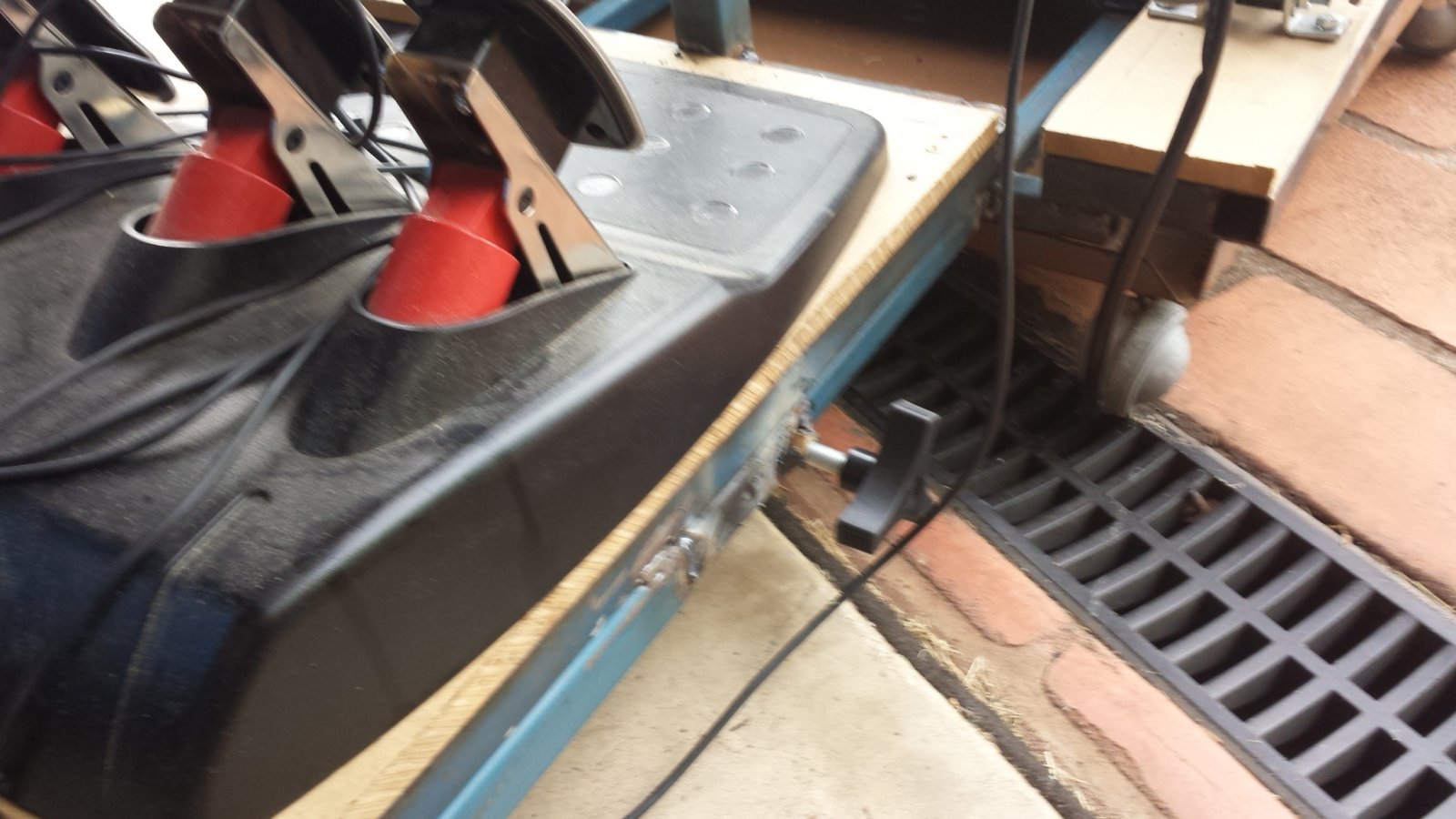

  16. rattler
    rattler
    Phew! What a day! Nothing like 7 hours to get things done.
    Thanks again to @bsft for allowing me to use his tools and garage.
    Got a lot done today.

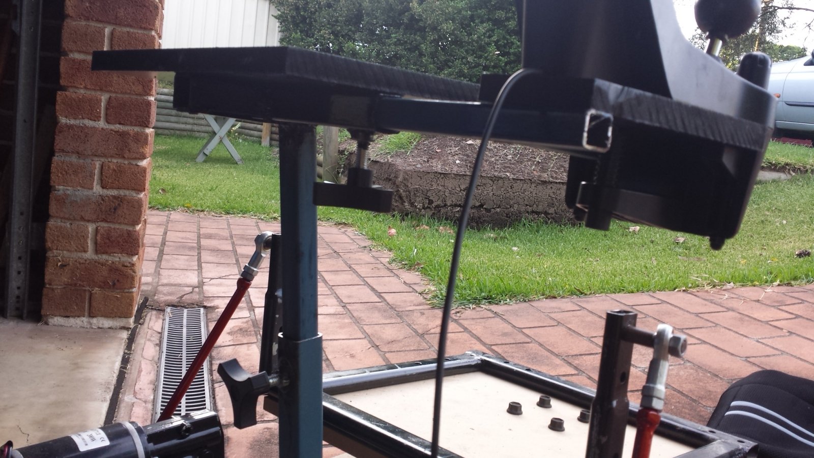

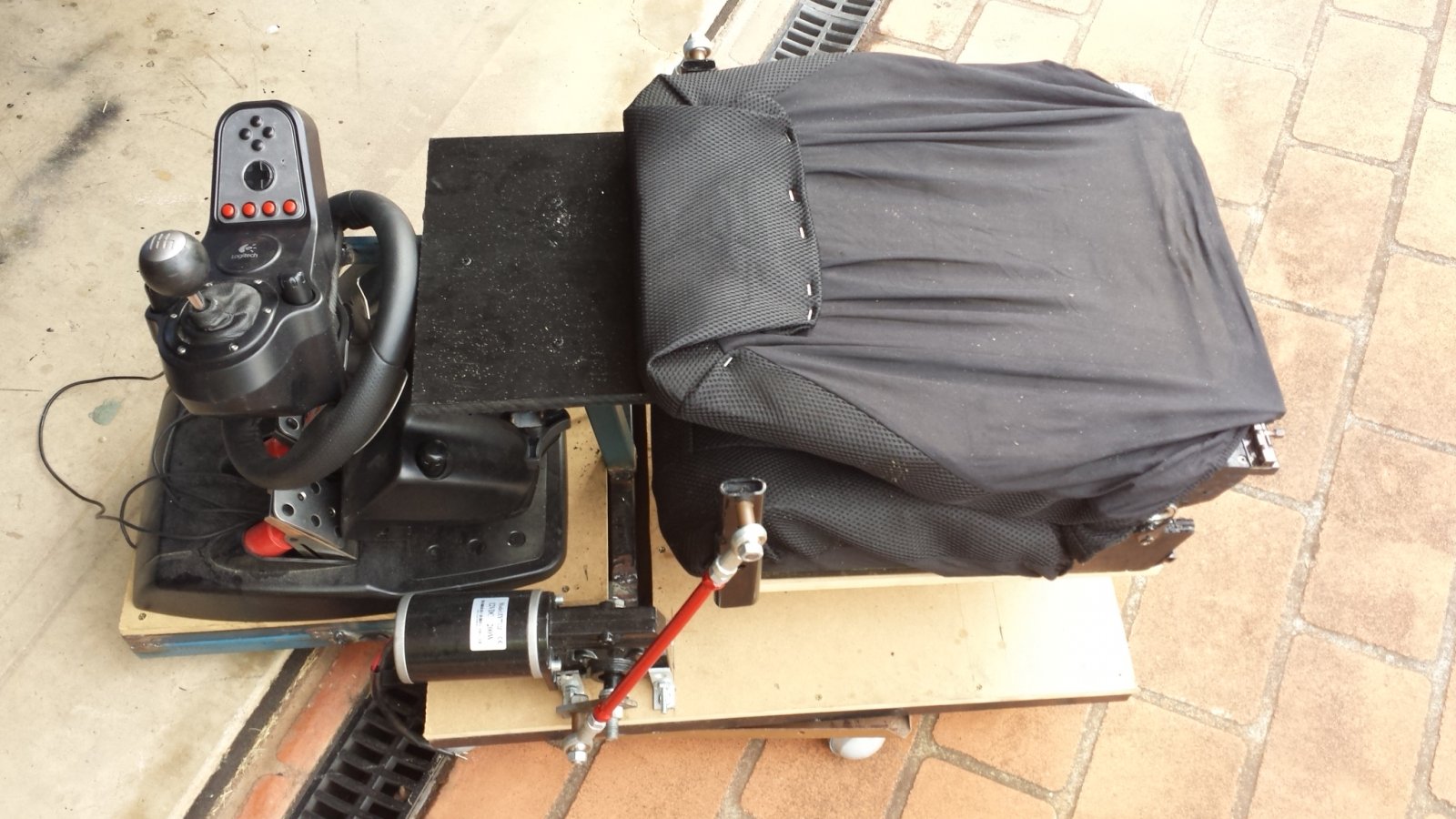

    I picked up the motion dynamics motors during the week as well as wood , rod ends , brackets.
    Got carried away and almost forgot to take photos.
    Made the rest of the frame including wheel stand which adjusts up and down and held with a adjust. Also added a removable shifter mount , welded adjusters on extendable pedal mount. Cut and welded a tailshaft pivot. Made 40mm CTC levers and rod arms. Cut and screwed on mdf sheet. Started painting and nearly forgot to take photos....hahahaaa
    Thats majority of work done. Ran outa money to buy JRKS and power supplies.
    Car rego is due....dammit....
    Hopefully will do more next week or so.
    Cheers , Andrew.
    20160318_181859.jpg 20160318_181851.jpg 20160318_181841.jpg 20160318_181822.jpg 20160318_181641.jpg 20160318_181725.jpg
