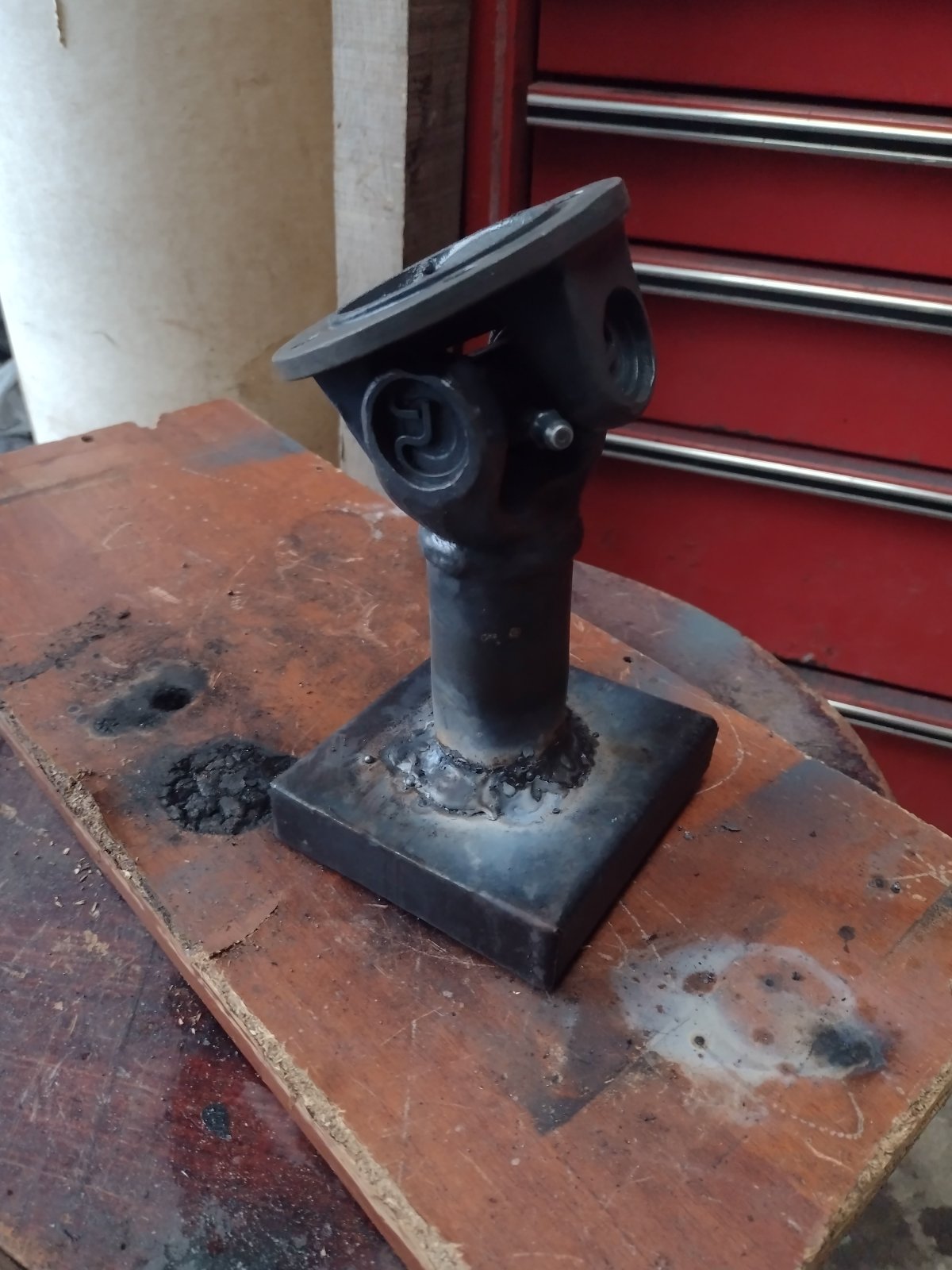

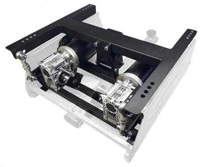

    This is a project I decided to do quite some time but I started just a month ago
    My plan was to make a seat mover similar to the Dof Reality M2 and attach it to rig

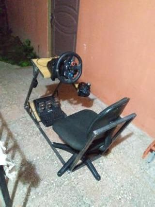

    I had a previous Rig with an office chair attach to it, but was unconfortable after 30 min of use and it was a little bit longer than what I needed Old Rig 2020.jpg
    So my new rig must be shorter, more confortable (if I can) and I decided to build my own seat mover

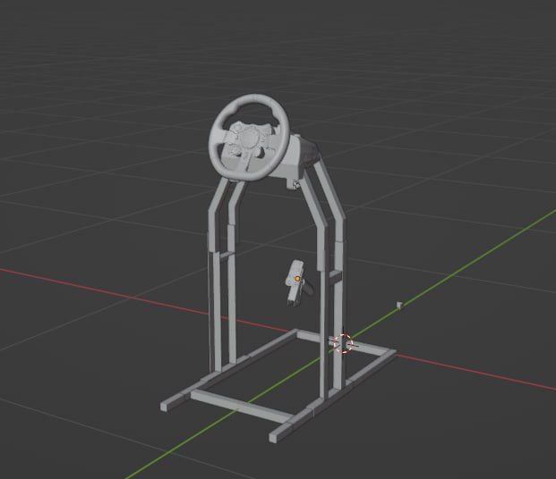

    I made a 3D reference model to take some measures and visualize how will it look 3D Reference model.jpg

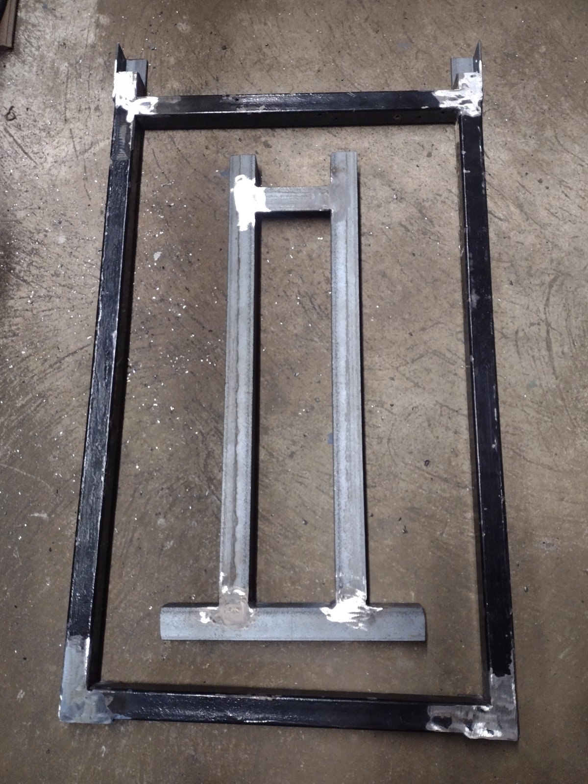

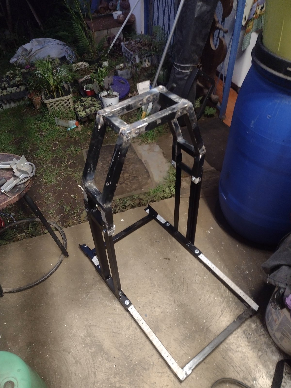

    And I started making the M2-like seat mover with some square tubing, metal angular bar, lots of welding and a universal joint
    IMG_20231110_182516630_HDR.jpg IMG_20231110_184454048.jpg IMG_20231118_193722488.jpg IMG_20231119_152712999.jpg IMG_20231119_155616716.jpg

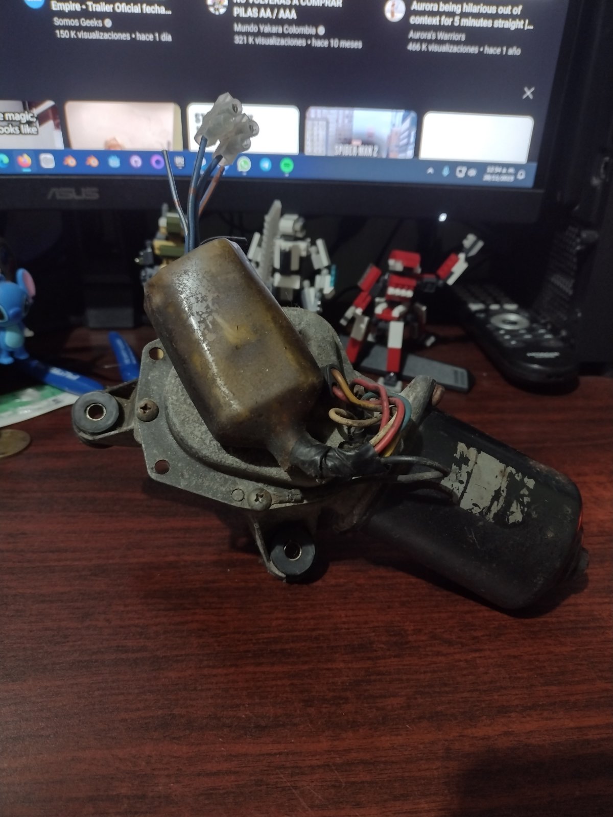

    For the motors I will use some wiper motors as apparently they can do the job, if not I will do some modifications for now and maybe later I can buy more strong motors
    I remove all unnecesary parts to make them look clear
    And i paint them in black just because
    I didn't install them yet because I must to some kind of attachable supports but I'm currently working on it

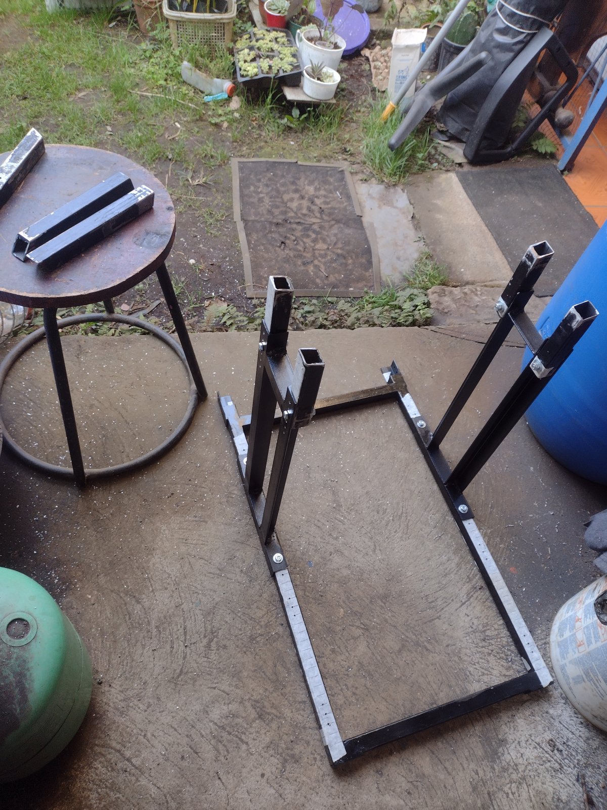

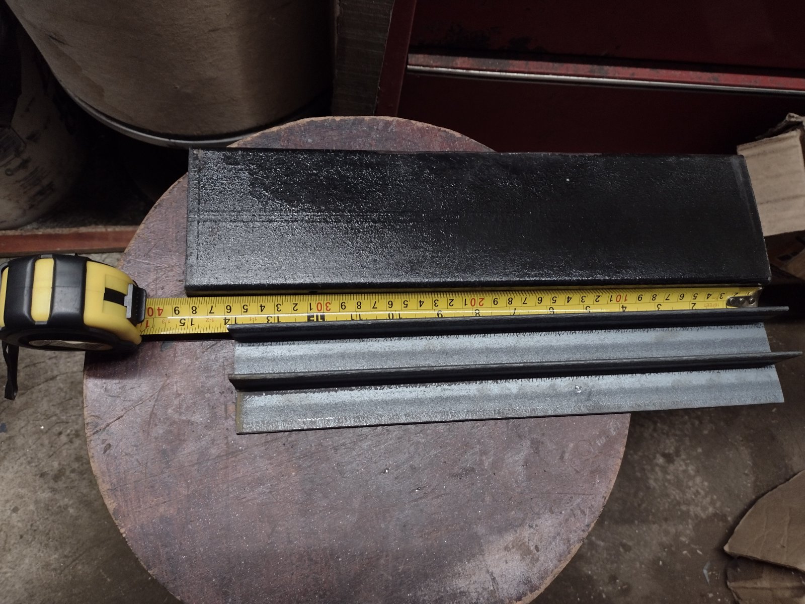

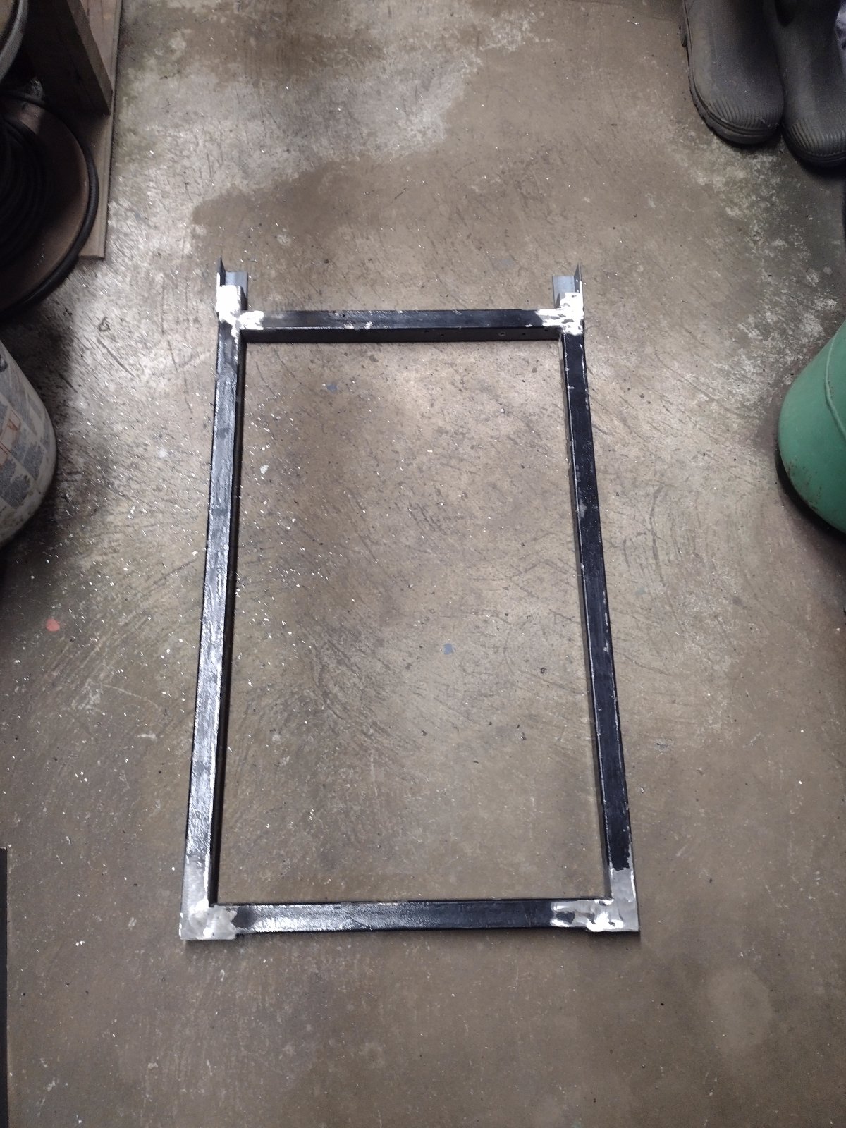

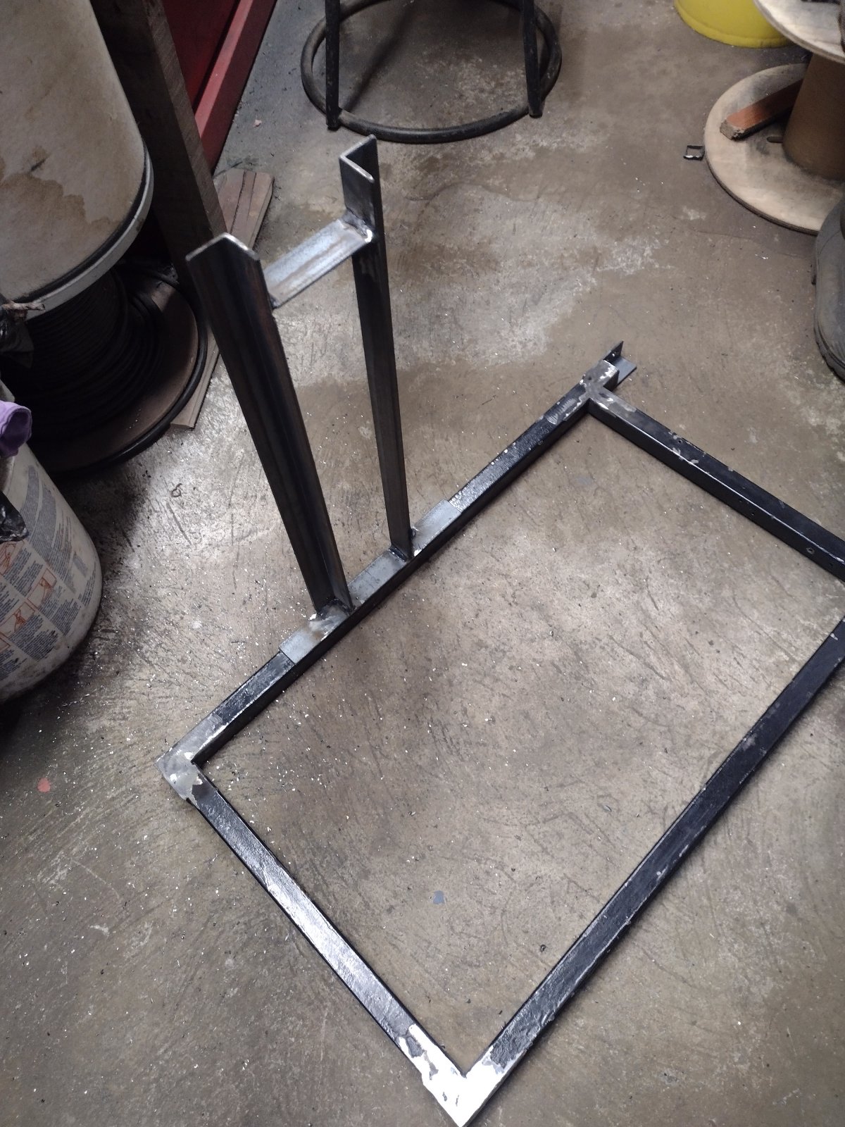

    For the rest of the rig I did it modular because if I need to add parts or modify something it's easier to just screw/unscrew the part i need

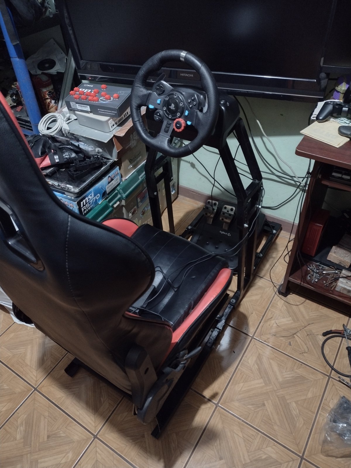

    First I made the frame based on my 3D model measures
    This frame (now) holes for ajusting the pedals/steering wheel distance from the seat
    For the steering wheel i made 2 columns (I don't know how to call them) to ajust the distance and height
    IMG_20231129_182853091.jpg IMG_20231129_182933836.jpg IMG_20231201_160018788.jpg

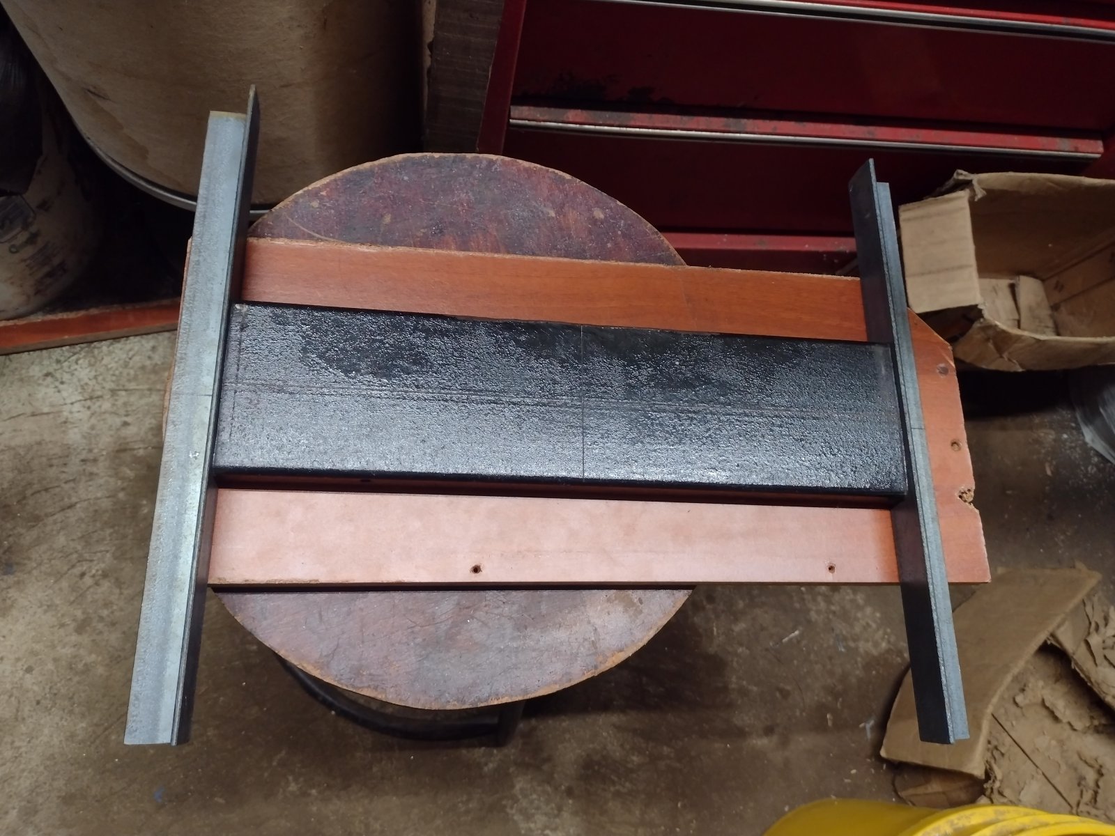

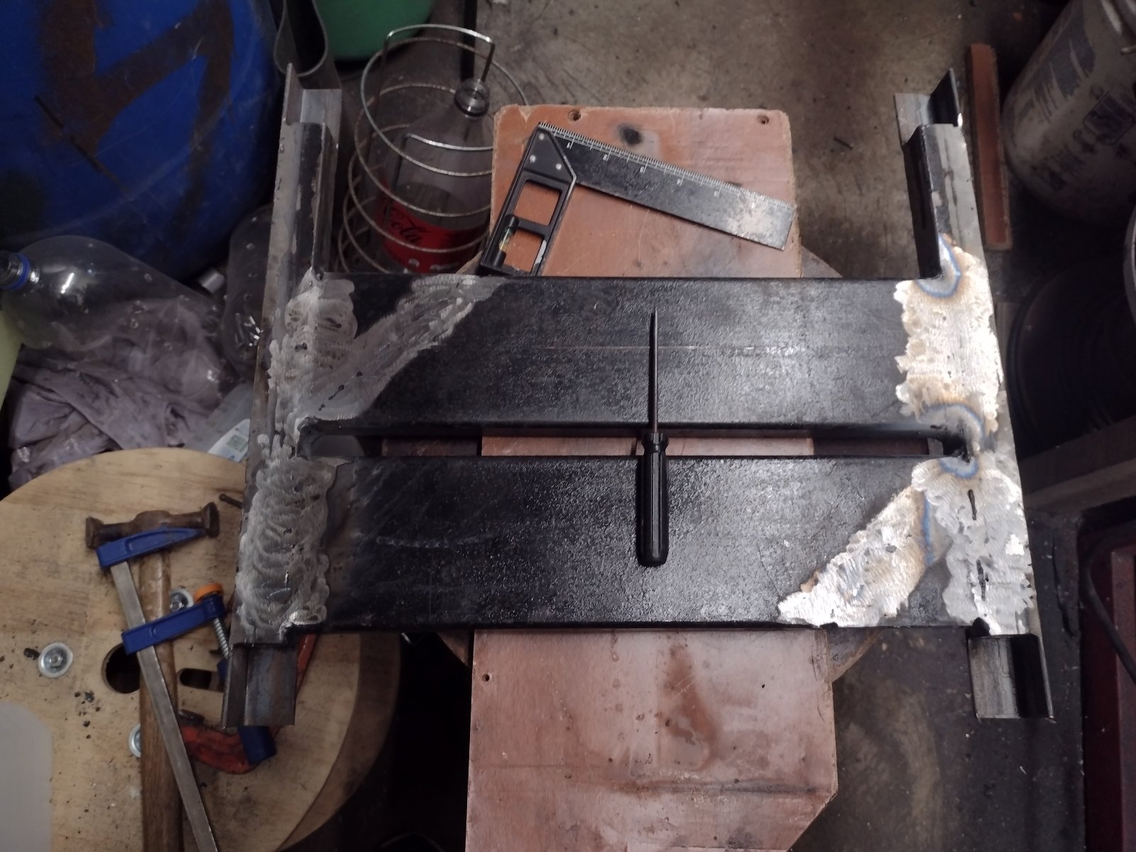

    And to attach the steering wheel a little bit stylish structure that was harder than I though

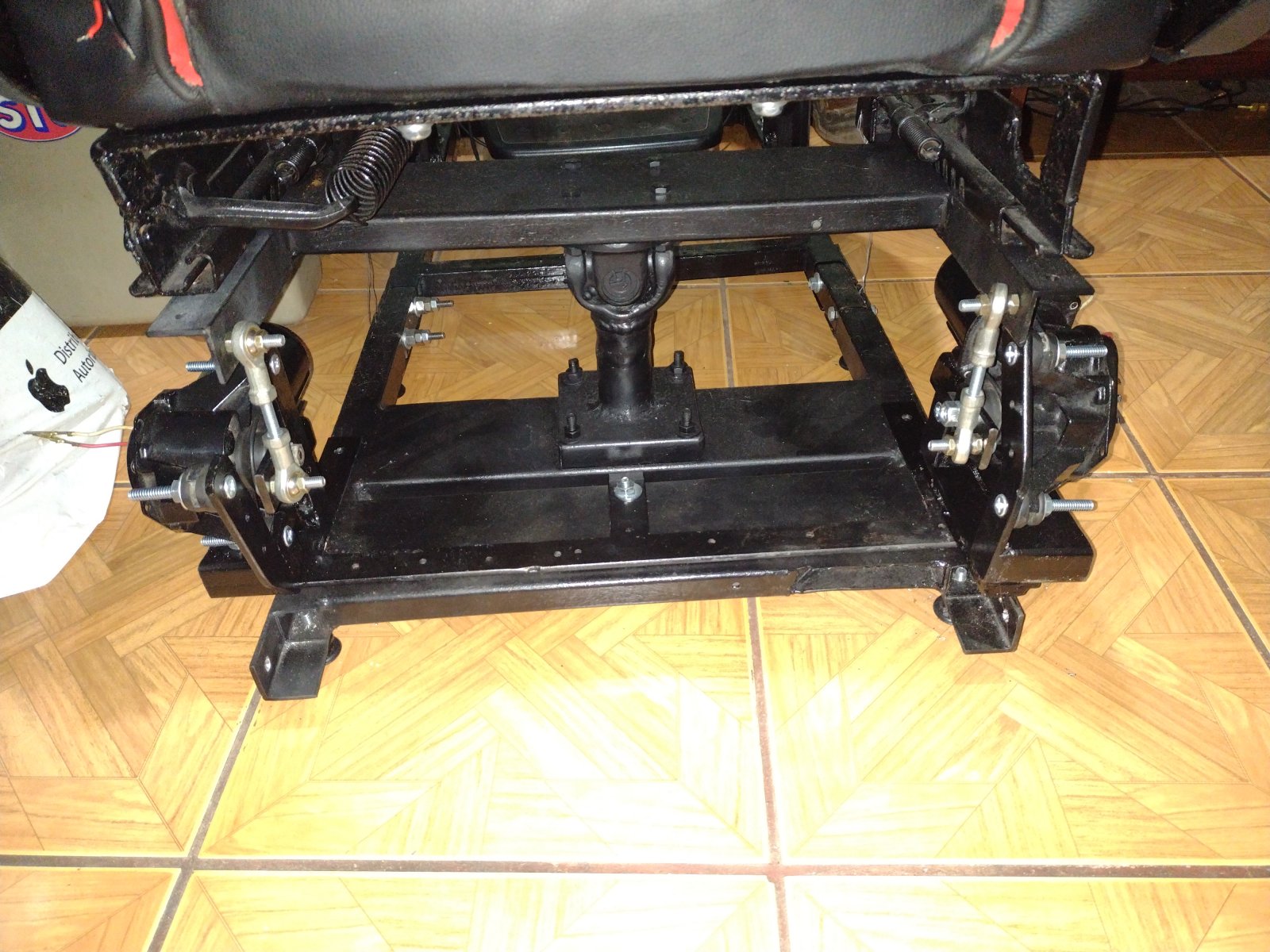

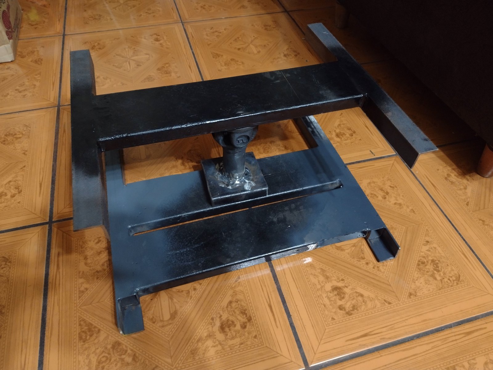

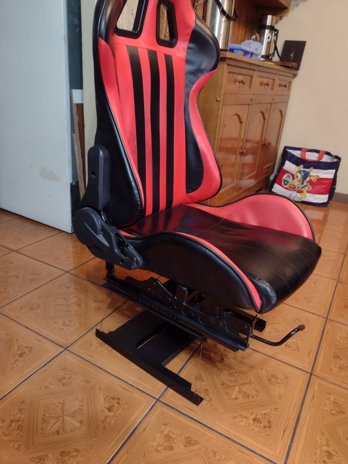

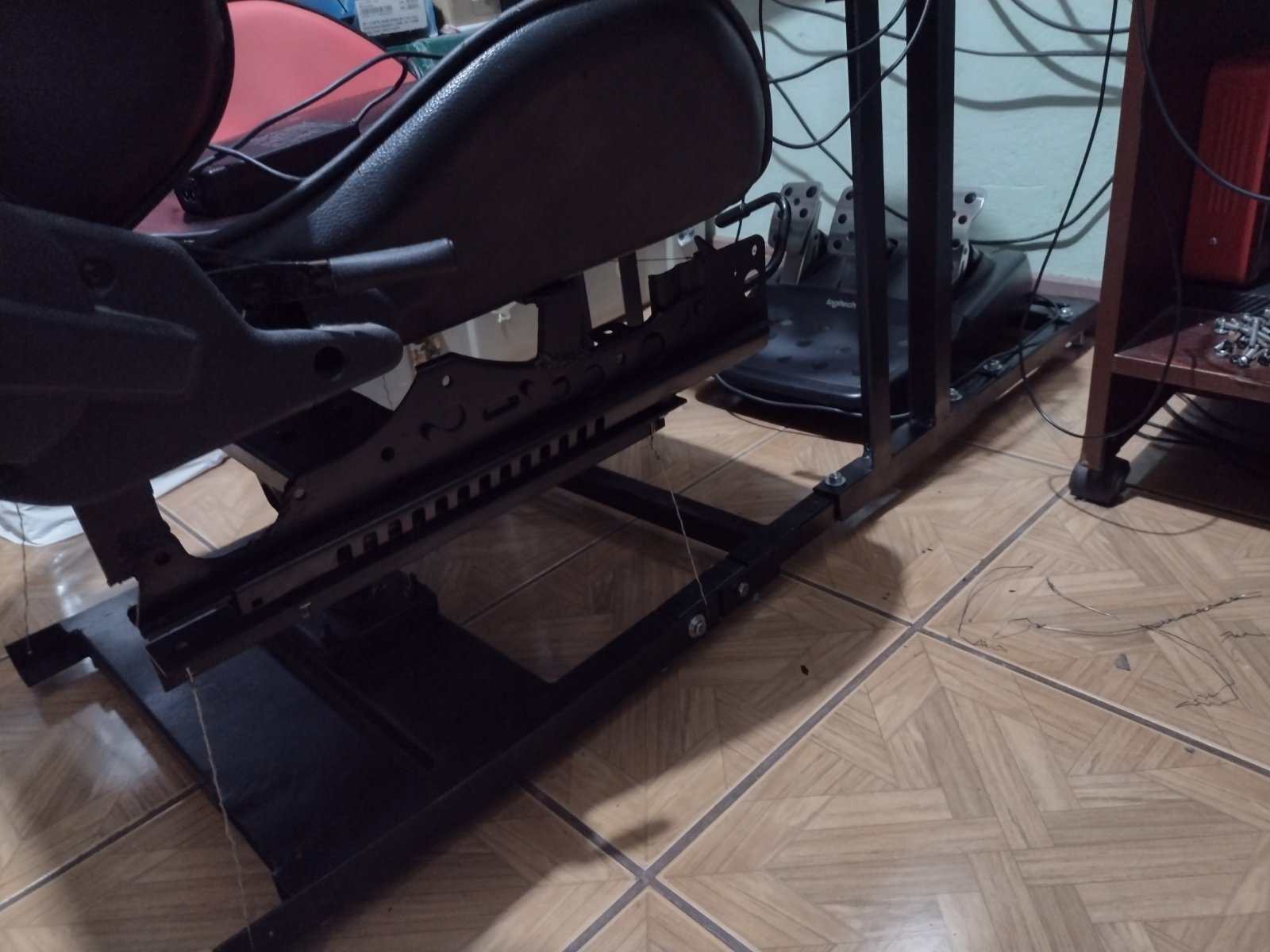

    For the seat mover part I attach my gaming chair using the ajustable rails of a car seat and the car seat is my new pc chair, this is because the gaming chair is lighter
    and for now it looks like this
    I use some metal wires to secure the chair while I work in the motors support

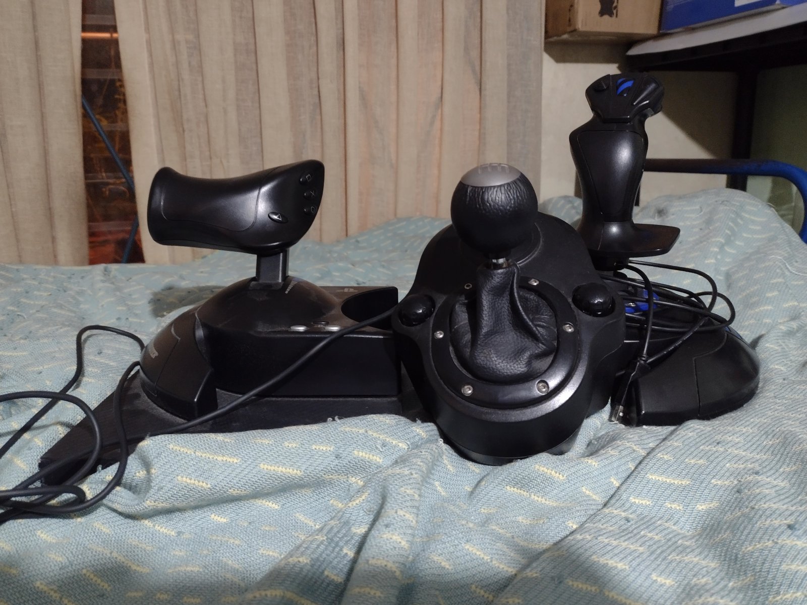

    And one more thing, I must see how I can attach this H-shifter and HOTAS to my rig because I want to make something versatile, a unique simulator that I can use to cars and spaceships, I play usually assetto corsa/competizione, project cars and Elite Dangerous

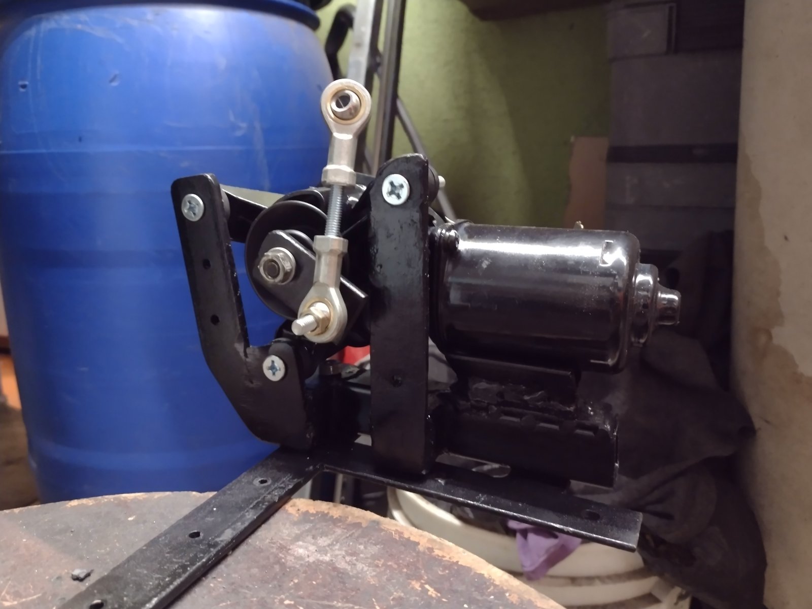

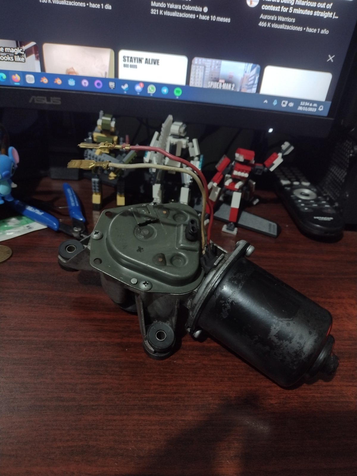

    This is what Iwas working these days
    A structure to attach my wiper motors toy rig
    Theorically both are the same
    But in practice one have more torque than the other at least when they are shutdown
    This is how it looks like
    I have to test them first to really know how they perfom

    The seat was balanced with me on it, so theorically i should be able to add some kind of springs/bungee cord/whatever I find to aid the motors
    Anyway XD I though I had a monster motoshield... but no... So i have to order it, I don't know how many amps this wiper motors use and I have a 5-36v 2A motor controller but I'm pretty sure is not enough, my motors are apparently 12v and that's all the information I have

    Ok XD I test the apparently "weaker" motor with my brother (which weights less arround 10kg less than me) and the motor can push him up without any problem so.. maybe my this will work better than expected (I need to secure my motors supports correctly first to test them better because they are held together with just a single screw right now)
  9. poumpouny
    poumpouny Member
    Jun 27, 2023
    58
    92Coins
    +26 / 0 / -0
