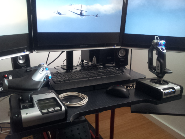

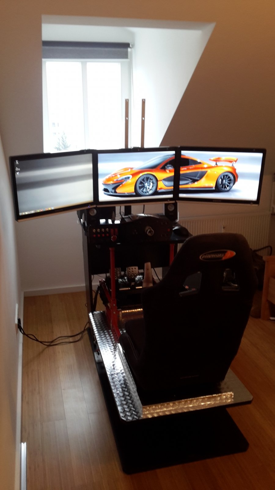

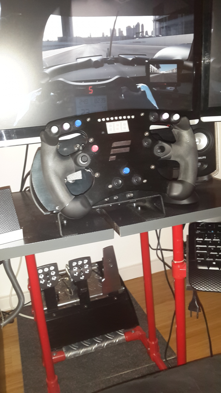

    After 2 years of improving my racing rig from very simple to more and more functionality, i decided some weeks ago to make a dynamic one.
    I had the chance to get in touch with Erwan960 on the PCars Forum who provide me some parts and give me some advice. So most of the hardware components, the motors, the reducers, the Pololu Jrks, the potentiometers and the joint are coming from him.
    I had just to do the mechanical parts,

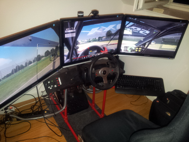

    First I put some pictures from the history to show the evolution :
    in 2014, I installed a triple display and I was using a G25.
    I could also use i for flight simulator
    then I update in November with a Fanatec wheel and a new seat.
    and I added a fourth screen for the Motec

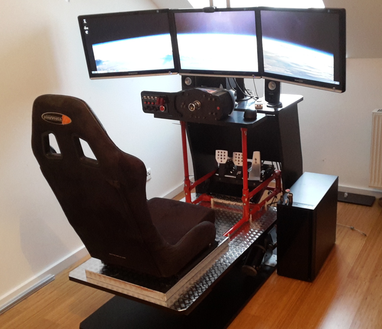

    I have reworked the structure, made a fixed part to support the monitors and the sound system, moved the pedals, wheel and seat on the mobile platform. I tried to keep a high level of finition with the surface or hiding the cables and electronic stuffs.
    I have also add a bass-shaker under the moving platform
    All support are made of wood (covered with decal)
    I share the actual result even if some details are still on tuning : keyboard support, additional support for the joystick for flight simulator, some screws missing, etc...
    First tests are impressive even if some tuning is still needed with the help of Erwan960.
    More pictures to come

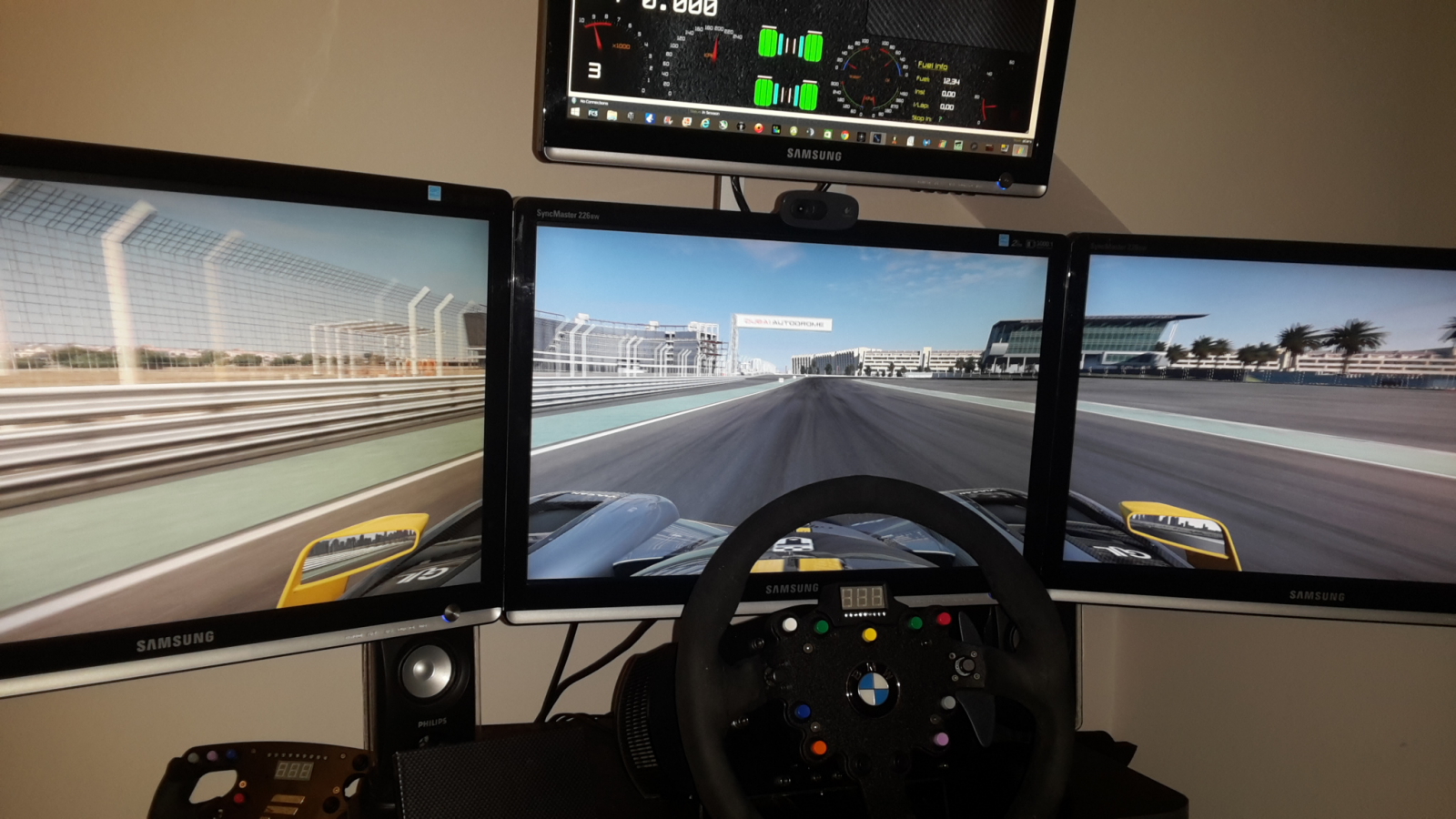

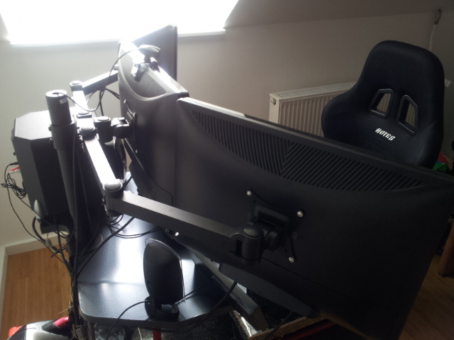

    I used the 4 possible displays on the graphic cards : The triple screens are using the 2x Duallink DVI and the Display port. The fourth screen is on the HDMI
