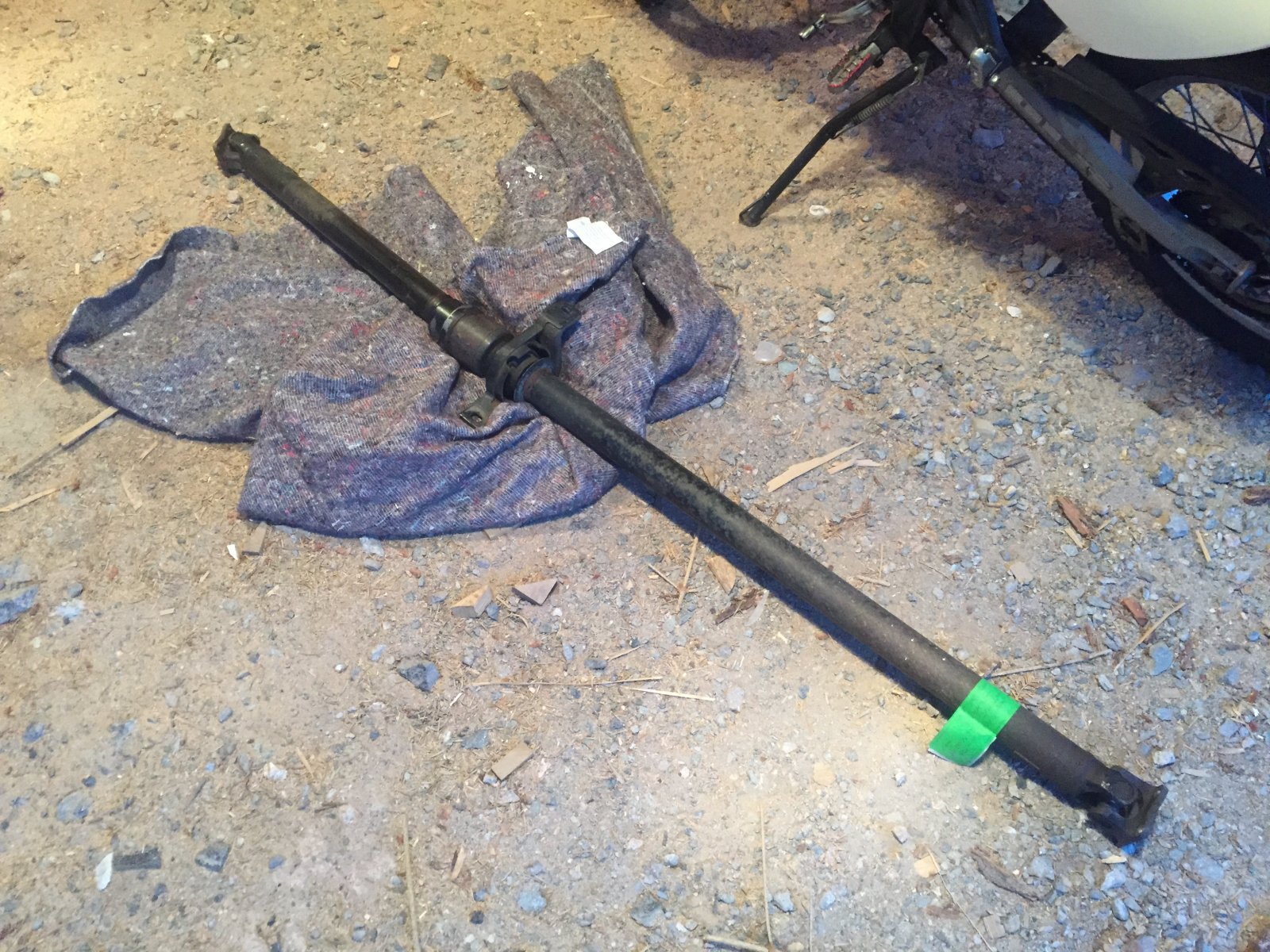

  11. Intruder
    Intruder Member
    Dec 16, 2015
    74
    435Coins
    +24 / 0 / -0
    Hi
    Thanks for your answer!
    I have had no patience yesterday so i ordered them.
    I plan to use 24v 20A power supply, if it's not enough for both motors i will use one for each.
    Found a data sheet of the motor and the gear, it seems to have a full metal planetary gear, that's not bad;)
    And I was on foray at a bike and a car garage (both friends of mine) and it was successful: IMG_5082.JPG IMG_5084.JPG
    Maybe I will build a bike chain gear... let's see

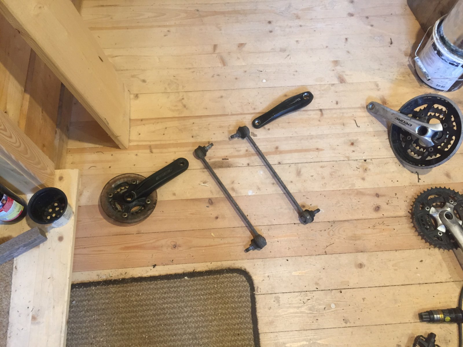

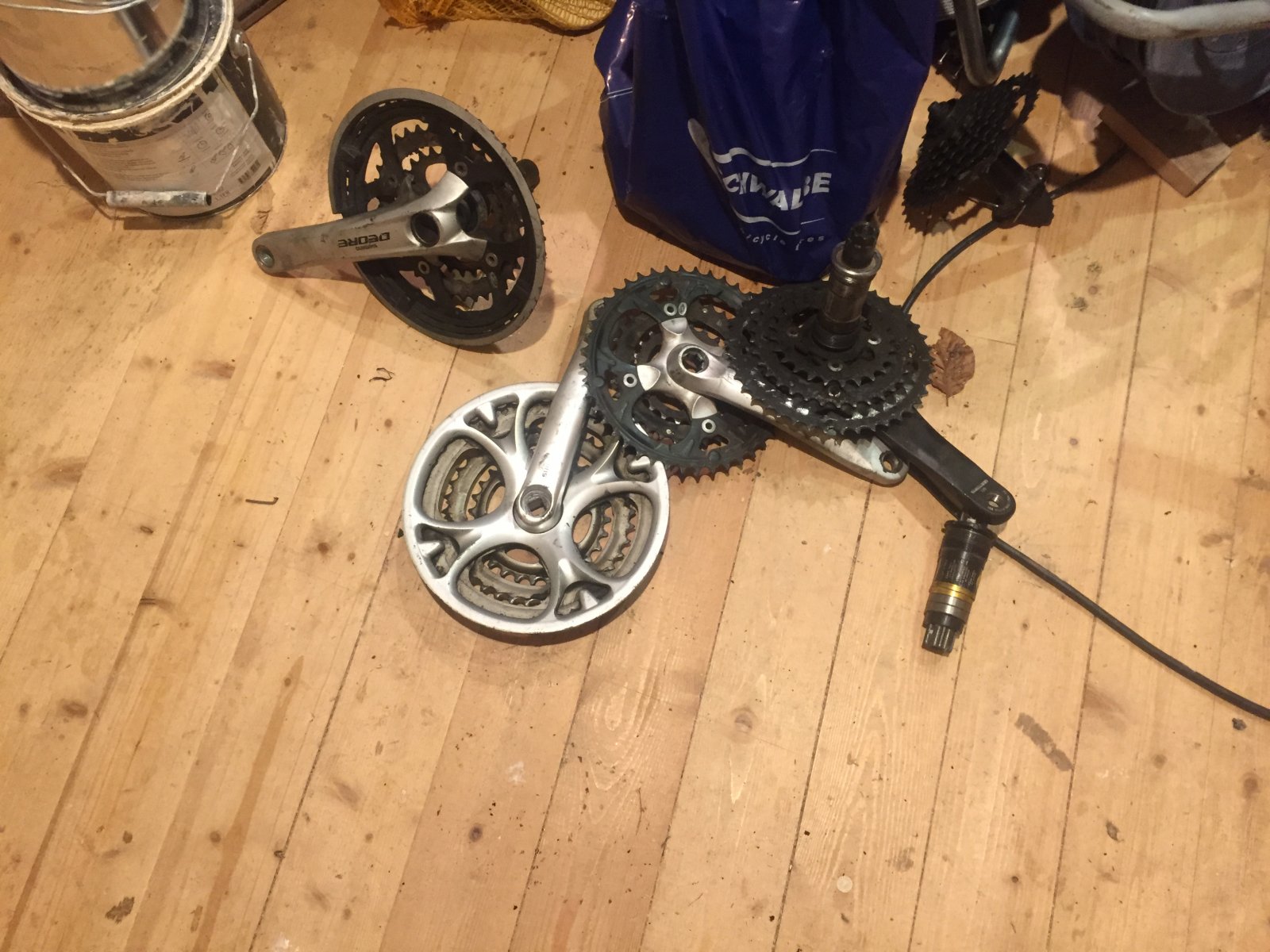

  12. Intruder
    Intruder Member
    Dec 16, 2015
    74
    435Coins
    +24 / 0 / -0
    New day, new parts: this time 2 stabilizer from a car, and another set of bike pedalarms wit (theoretical) the same diameter as the motor axis
    Price until now: 0€
    next step, 18mm Multilex wood 1x1 meter for the ground plate and platform base

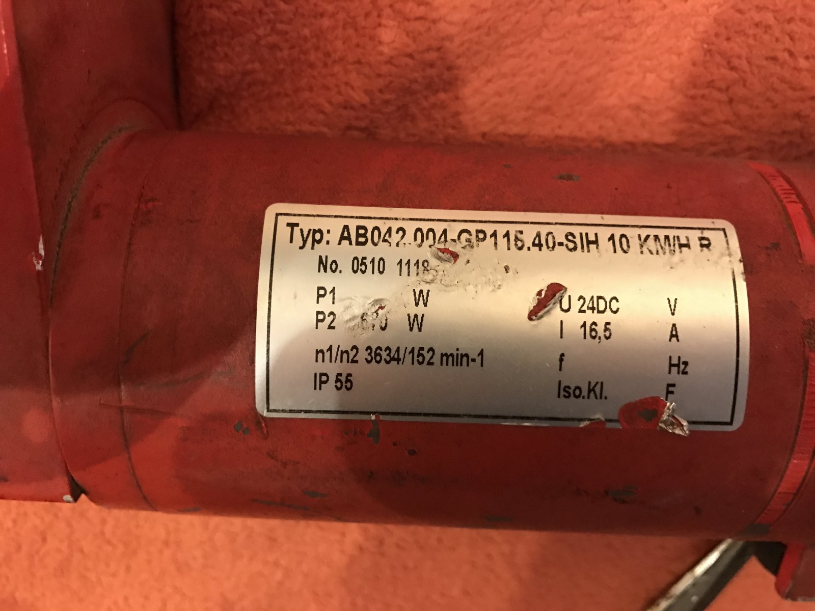

  20. Intruder
    Intruder Member
    Dec 16, 2015
    74
    435Coins
    +24 / 0 / -0
    Yes it can be cheap, and 24v is not bad! Today I received my Motors! Yay! 670w and 160€
