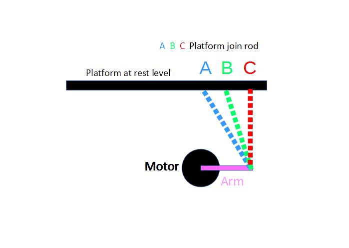

  7. OlympusSim
    OlympusSim New Member
    Oct 5, 2015
    16
    Buenos Aires - Argentina
    608Coins
    Sorry if
    I made a sketch to see if you understand better
    Where should connect mounting point on the platform when is a rest level, assuming the travel arm is halfway
    Should be Point A, B or C
  8. OlympusSim
    Oct 5, 2015
    16
    608Coins
    Sorry but i need more information
    I make a sketch
    Where should be the point where the platform is connected with the rod
    In the Point A,B or C
  9. SixCyl
    SixCyl Member
    Oct 30, 2015
    43
    444Coins
    +13 / 0 / -0
    Hi OlympusSim
    For me, i think C is the Good Choice but I could be wrong.
    I ask to confirmation.
  10. Pit
    3,013
    30,416Coins
    +3,088 / 31 / -0
    angel between rod and lever should be 90 degree, short said C.
  11. SixCyl
    SixCyl Member
    Oct 30, 2015
    43
    444Coins
    +13 / 0 / -0
    Thanks to confirm !

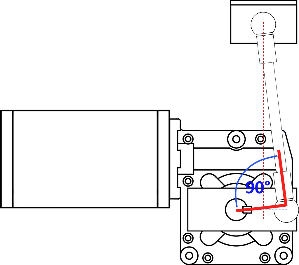

  13. Erwan960
    Erwan960 Active Member Gold Contributor
    Nov 4, 2013
    137
    3,832Coins
    +255 / 0 / -0
    It should be B.
    To ensure a symmetrical movement, it is necessary that the center of the handle, when it is in a horizontal plan, should be on the same axis as the upper ball.
  14. Pit
    3,013
    30,416Coins
    +3,088 / 31 / -0
    Sorry mate I honestly disagree ;) You cannot simulate a symmetrical movement over the full range of the movements using this system. I agree this happens on a very small radius but when you leave the latter as you want to describe the movements it will continue asymmetrically. Furthermore you should think about the nm relationship, as smaller than 90° as worse the efficiency.
    I could be wrong but interesting in any case :)
  15. zigzag49
    zigzag49 Active Member
    May 27, 2014
    251
    706Coins
    +220 / 3 / -0
    I also say B for the same due to the symmetry of movements knowing that the connecting rod should be about 3 times the length of the cam center distance.
  16. insanegr
    insanegr !N$@n€
    Jan 14, 2014
    505
    Athens
    16,715Coins
    +499 / 1 / -0
    i say B too but only if the lower and higher point of movements will be when the rod comes vertical at the red line
  17. Pit
    3,013
    30,416Coins
    +3,088 / 31 / -0
    This is the version which I would prefer:
  18. OlympusSim
    Oct 5, 2015
    16
    608Coins
    Thanks folks
    Erwan960 your sketch is perfect!!!
    I make some test connecting in "B" point
