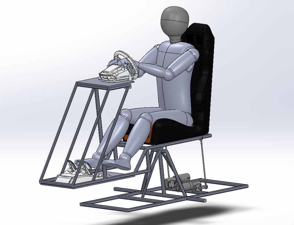

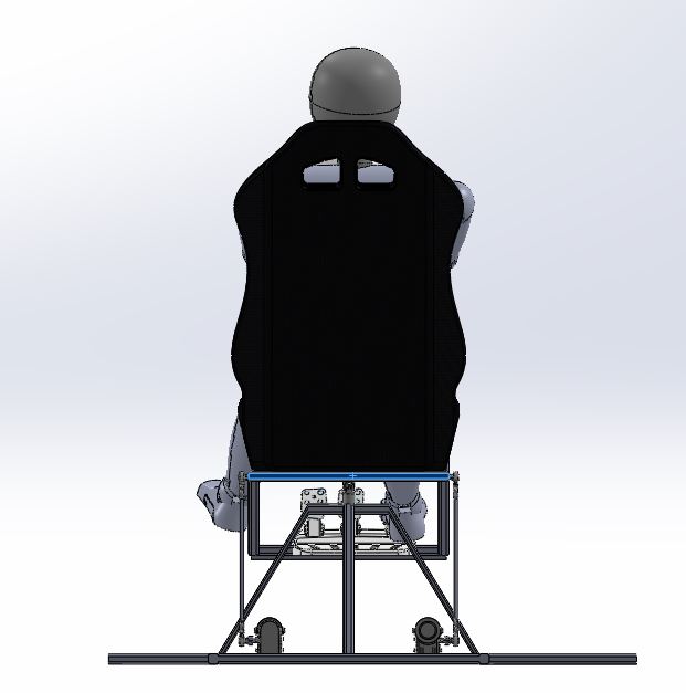

    Hey everyone,
    I'm starting my build thread as recommended. My plan is to build a standard 2DOF platform mover sim using gearmotors for racing/flight sims. My main priorities as far as the build goes are:
    1) Have the rig be fast/responsive (more optimized for simracing than flight, but able to do both).
    2) Keep cost moderate to low (I'm a student and my budget is fairly tight).
    3) Keep the footprint of the rig small.
    4) Make the rig at least a little bit aesthetically pleasing.
    5) Leave the option open to add a Yaw axis to the rig later on.
    Keeping all of this in mind, here are my plans as they stand now:

    Just some things to consider.
    If you are optimizing speed for racing simulation then a shoulder of foot mount design would work better, because you increase the leverage and could take full advantage of the speed of the 25:1 equipped motors. A compact design can work, I have one, but definitely go with the 50:1 motors and you will need to trade some speed for torque.
    The frame tube size may depend on how you intend bracing it but consider 30mm.
    For rod ends you can go for either heim (rose) joints or tie rod ends, but in terms of value for money it is hard to go past @Nick Moxley's repeated recommendation of these, which are for 4 quality tie rod ends: http://www.aliexpress.com/item/4pcs...ight-hand-tie-rod-end-bearing/1559309095.html
    Our sims have some significant power spike needs, you may want to consider an additional power supply for future upgrade.
    Direct mount flexible couplings and Hall sensors are a great mix of simplicity and high precision control.

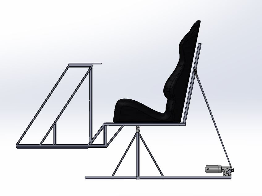

    I've considered doing a seat mover, but since I will be playing some flight games (Elite Dangeroud, EVE Valkyrie when they come out), and trying to integrate a VR headset into the design when they come out, I think a full platform might be better for me. Honestly though I'm not even 100% sure about that either. Worst comes to worst I figure it's probably easier to take an angle grinder to a full platform and cut it down/make some modifications and turn it into a seat mover than to do the opposite.
    As far as shoulder mounting goes, I know it will give my much better lever angle, but won't that make the torque loads on the motors uneven in the pitch/roll directions? I was under the impression that this was important.

    Shoulder mount at rear on a full frame can give you appropriate angle. I did a full frame shoulder mount for a mate a while ago, 60:1 boxes 80mm CTC levers, he gets about 18 deg total angle .

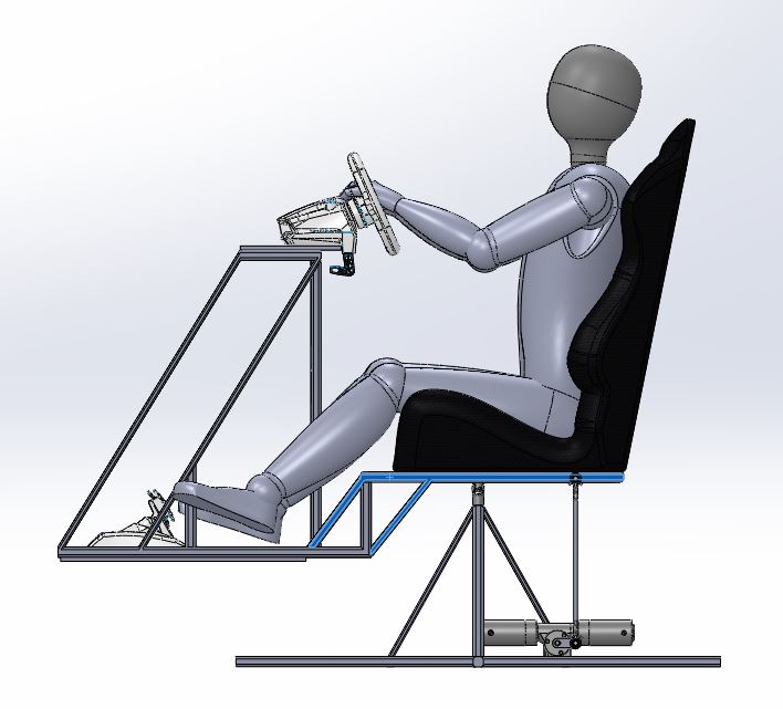

    Right, I'm not too worried about total throw angle. More so the fact that if I mount the arms farther rearward from the pivot than they how wide they are mounted, wouldn't that mean that the rig would move faster in the pitch direction, and slower in the roll direction, given that the lever angle for the pitch is now greater than that of the roll?

  16. bsft
    The speed difference between a bigger roll and smaller pitch , for example , is negligable. My Desk Racer of which noorbeasts DX racer is based off has 7 deg roll but 17 deg pitch. And as said, a good profile sort and it all feels even. The actual speed time difference would be in the fraction of a second. If you can notice that then you are doing better than me. :)
  17. Tim McGuire
    Jul 26, 2015
    261
    Canada
    2,217Coins
    +317 / 2 / -0
    3DOF, DC motor
    So something like this would be more recommended?

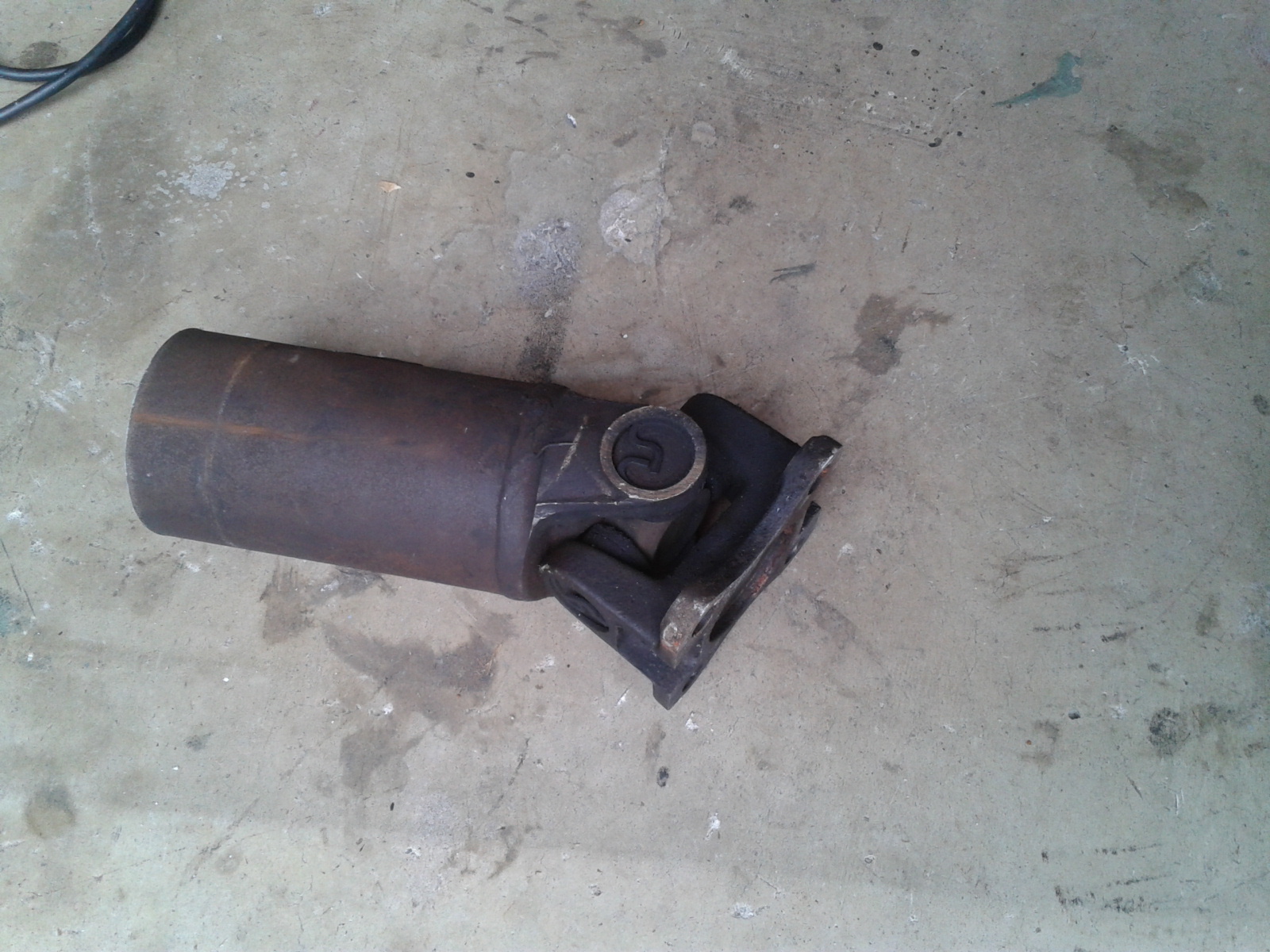

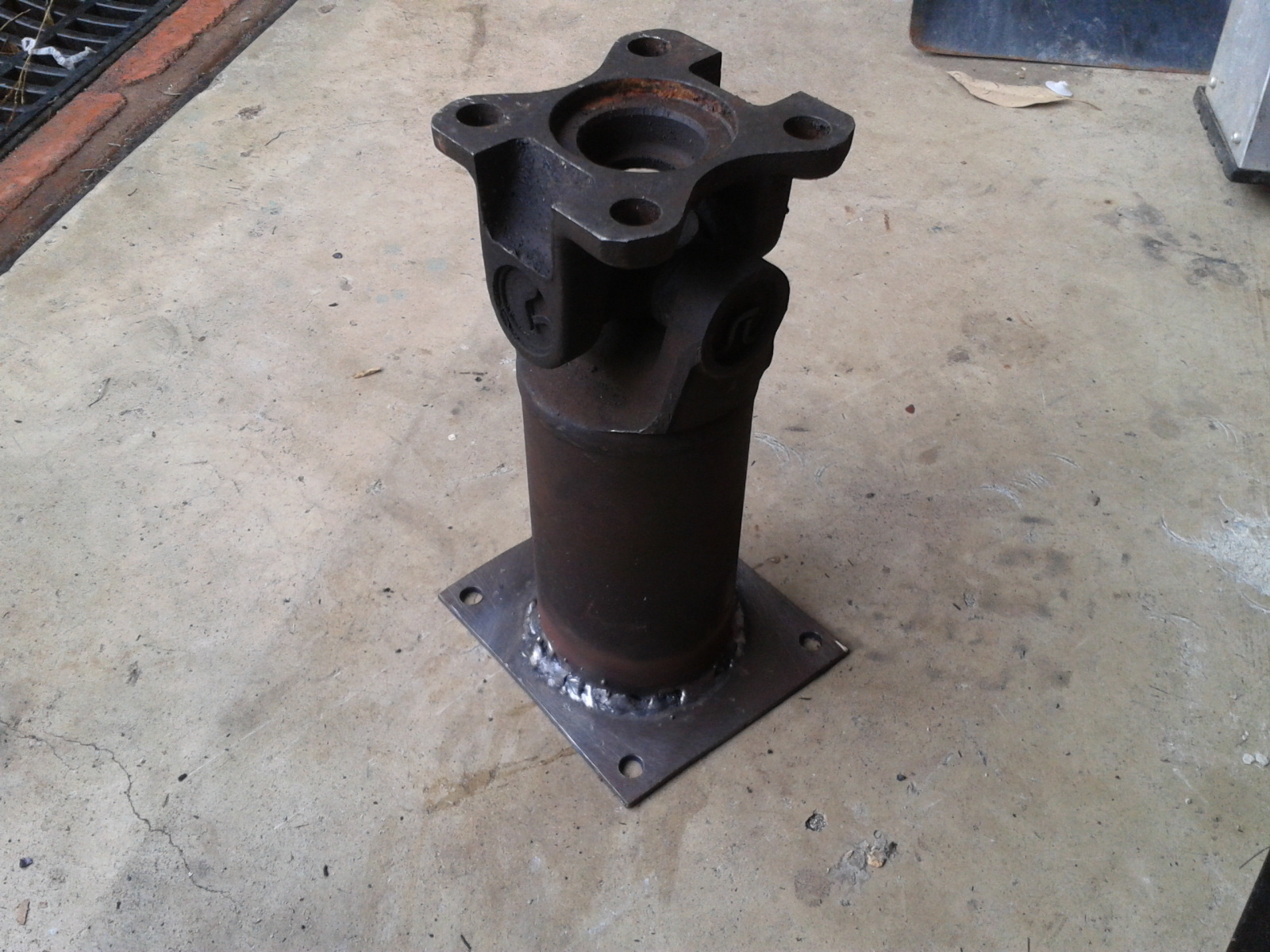

    An old tailshaft from the local car wreckers is just fine as long as the universal joints are in reasonable condition.
    I used solid aluminum rod and drilled a tapped it to make the front rods for my sim, but found it cheaper to buy an ATV rod with ball joints when I added heave.
    It is more common to use steel shafts or steel square tube and weld nuts each end to make the rods.
  19. bsft
    I go to a car wrecking yard and ask for a cheap rear wheel drive car tailshaft.
    Usually costs me $20-$30 so shop around as some places want too much money
    I cut it to length and weld a plate on the end for bolting it up
