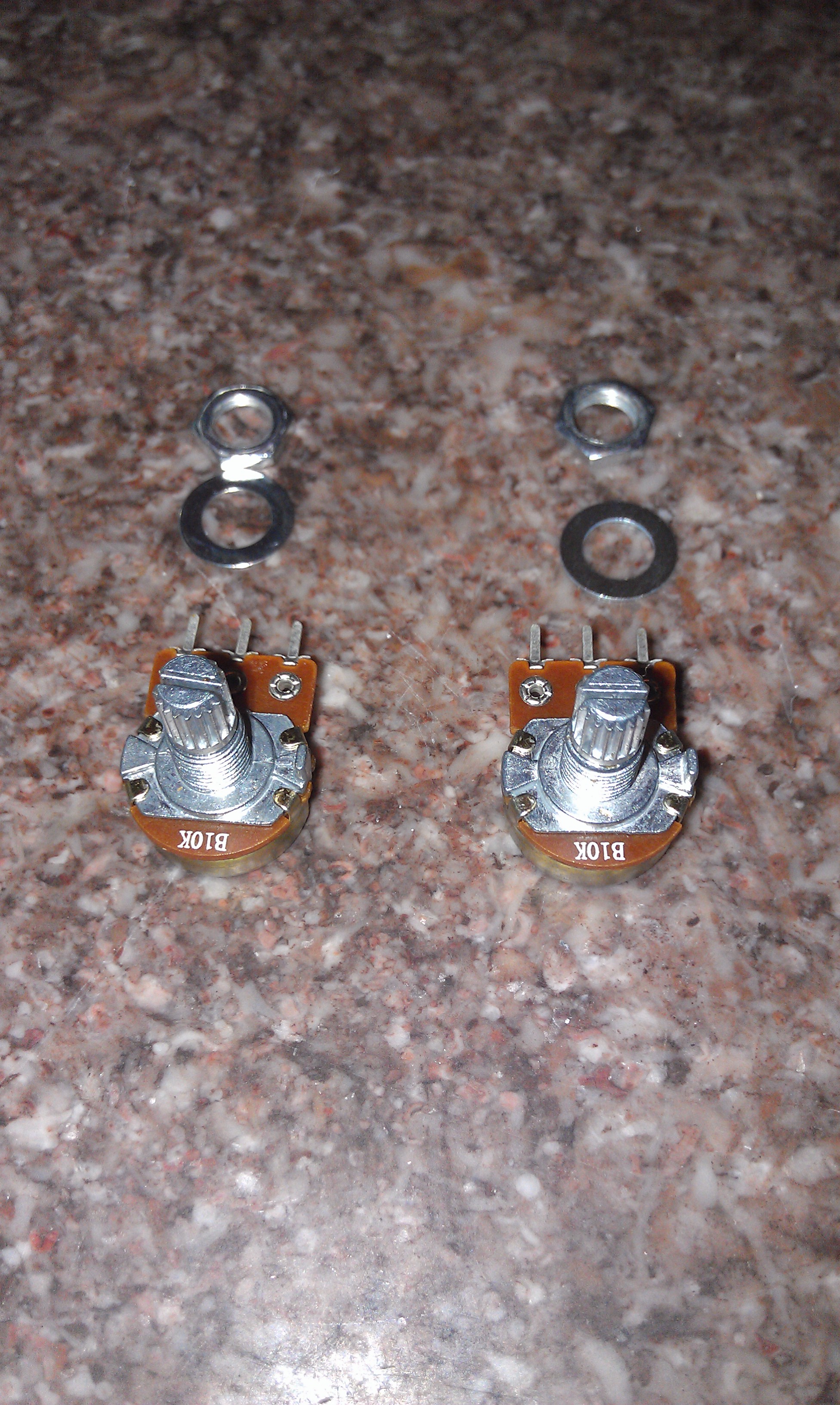

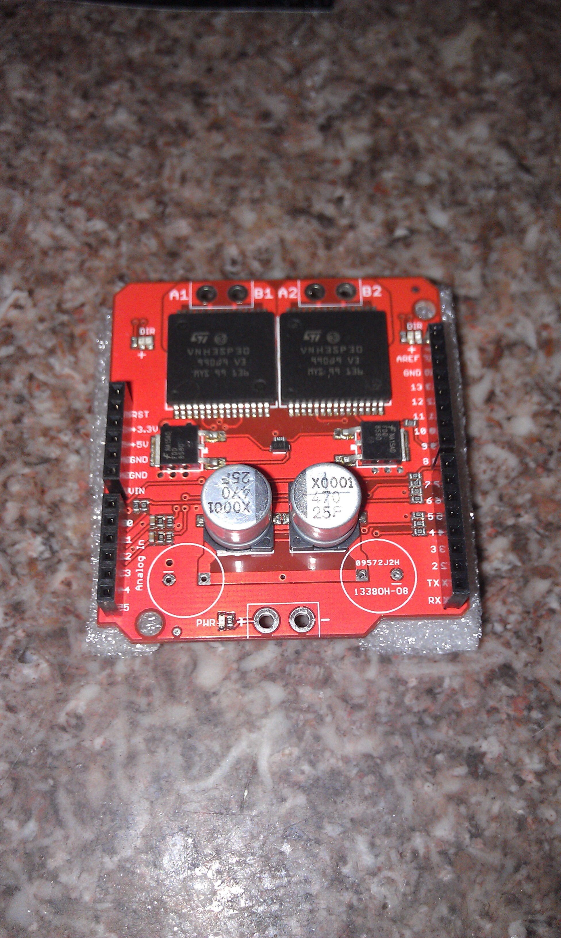

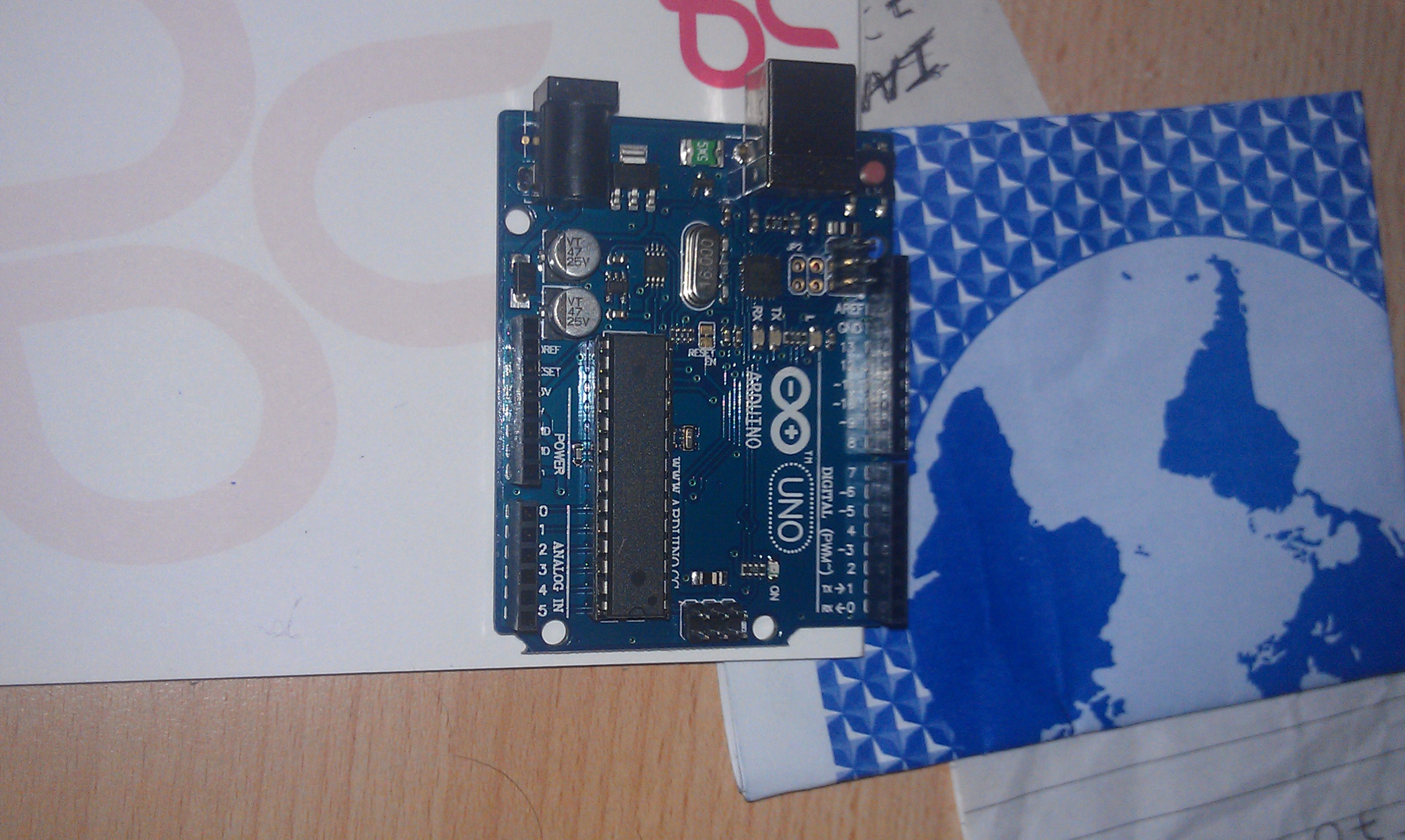

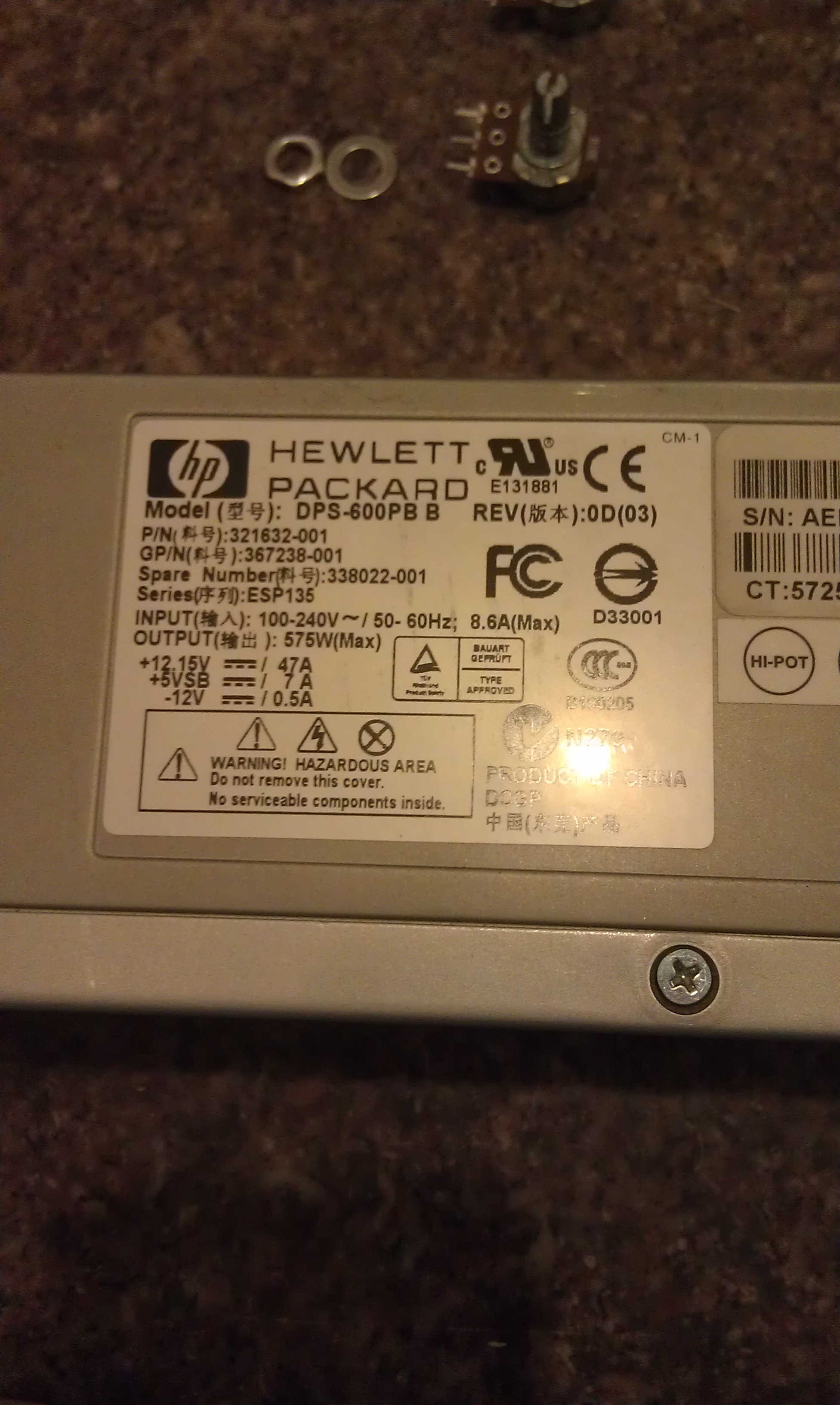

  2. Luimp
    Luimp New Member
    Oct 23, 2013
    21
    Dungannon, Northern Ireland
    319Coins
    Hi, so here is the pictures of the stuff I get and from the rc chassi

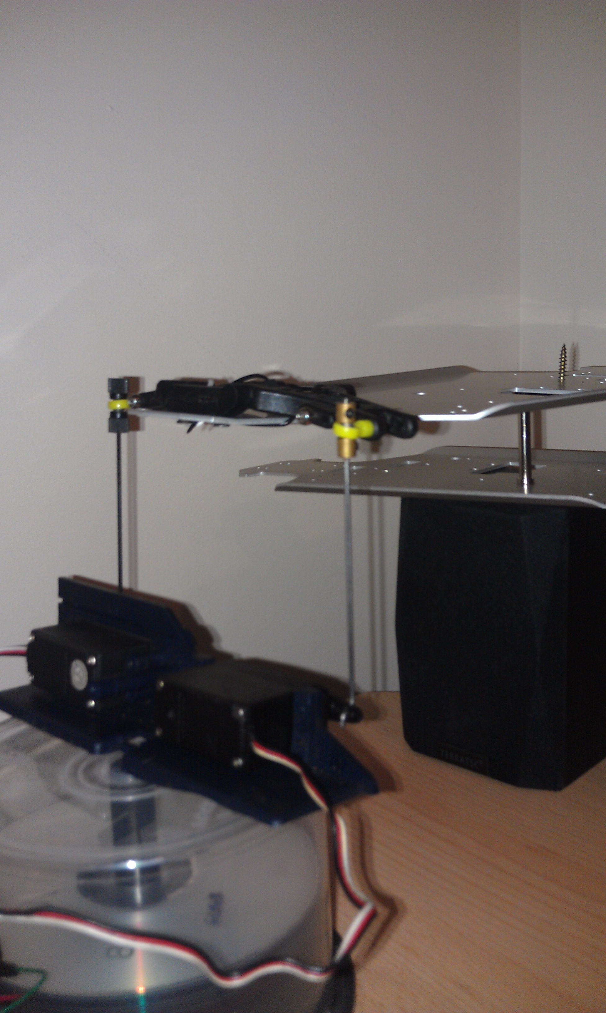

  4. Luimp
    Luimp New Member
    Oct 23, 2013
    21
    319Coins
    hi, I try connect just the 2 servos and ard using ur fig. and sketch but nothing moves and as i only have the other program is very complicated
  5. eaorobbie
    20,491Coins
    +1,687 / 23 / -2
    Yes it is very complicated and buggy, well the new software coming here soon, is worth the wait, sorry about that. Please subscribe on the Home page http://www.xsimulator.net/ so you may be alerted as soon as it become available publicly. There is a counter showing how long it us away.
    Now can you drive the servos in Arduino IDE, open the serial monitor and send Rxxx~Lxxx~ where xxx is 0 - 255 being 127 as its centre position, this will confirm everything is wire correctly and ready to go. Plus the board rate in the bottom right corner needs to be set to 9600. Communication for this is 9600,none, 1 stop bit.
  6. Luimp
    Luimp New Member
    Oct 23, 2013
    21
    319Coins
    I can make the servos move but just one time for one side or the other not ingame, I use ur arduino sketch I write ~L0-255~~R0-255~ the ard rx led flash but there's no response from game
  7. eaorobbie
    20,491Coins
    +1,687 / 23 / -2
    Hang in there mate not long now.
    In the Arduino IDE - Serial Monitor send R0~L0~ they will go to one extreme and send R255~L255~ for the other any other value in between they will also move as long as the value is between 0 to 255.
