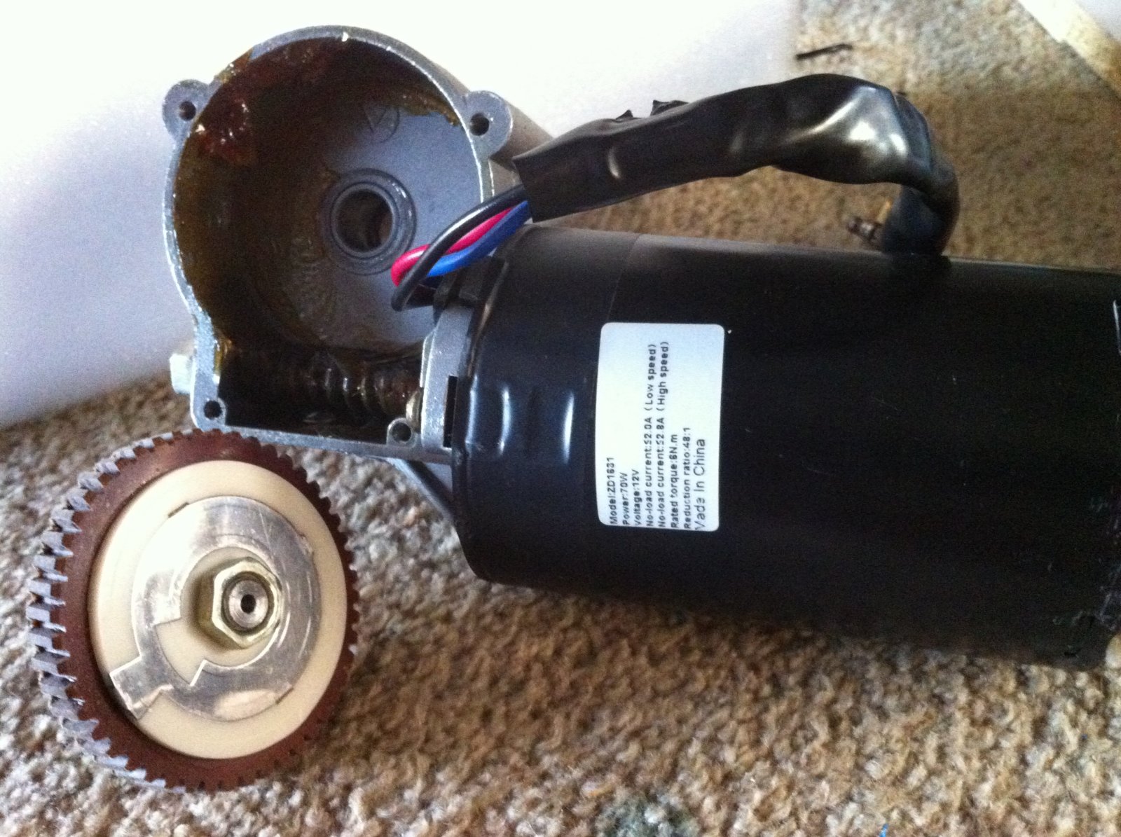

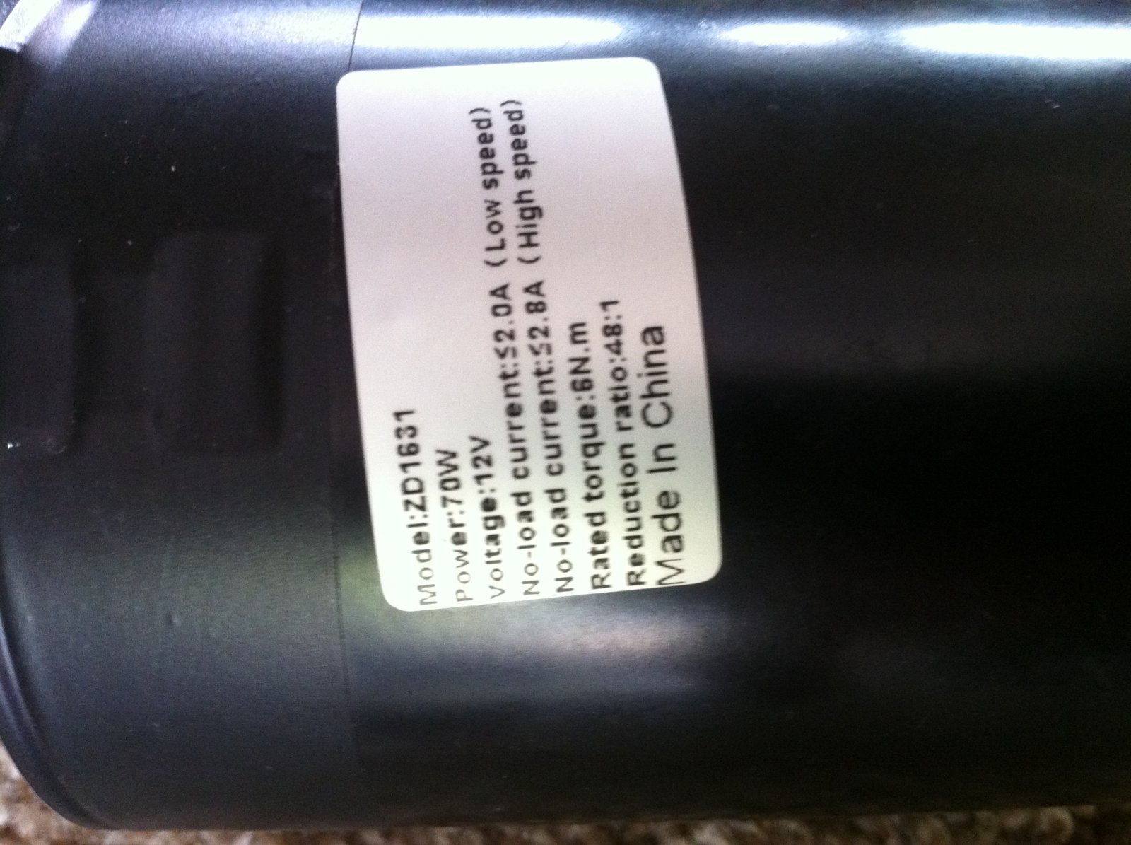

    So I took my time and read other peoples threads and slowly bought the pieces I would need. Tailshaft uni, rose joints, etc. I decided on new 70W worm gear motors (wiper motors), as they were reasonably priced.
    I pulled them apart to check the wiring and remove the unnecessary wires.

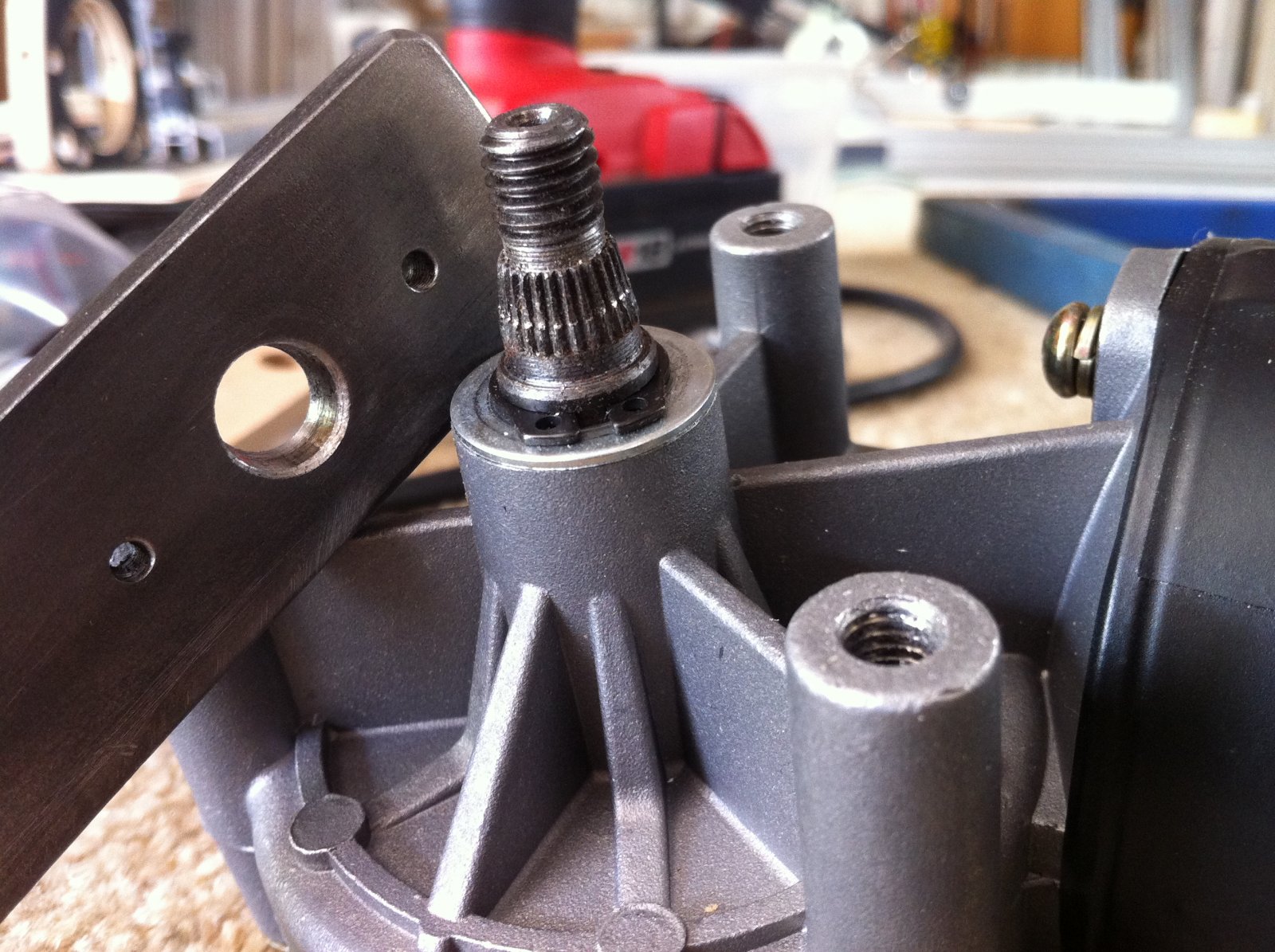

    The biggest issue was the tapered spline on the shaft. I had to grind a drill bit to the correct taper and re-sharpen it to drill the arms.

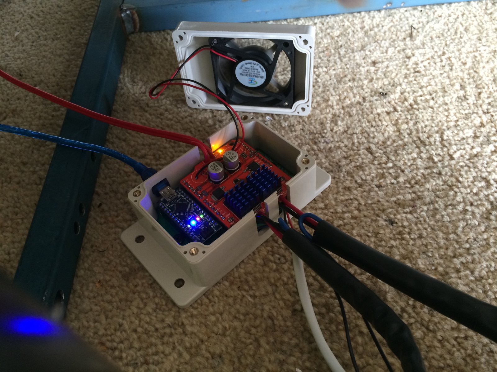

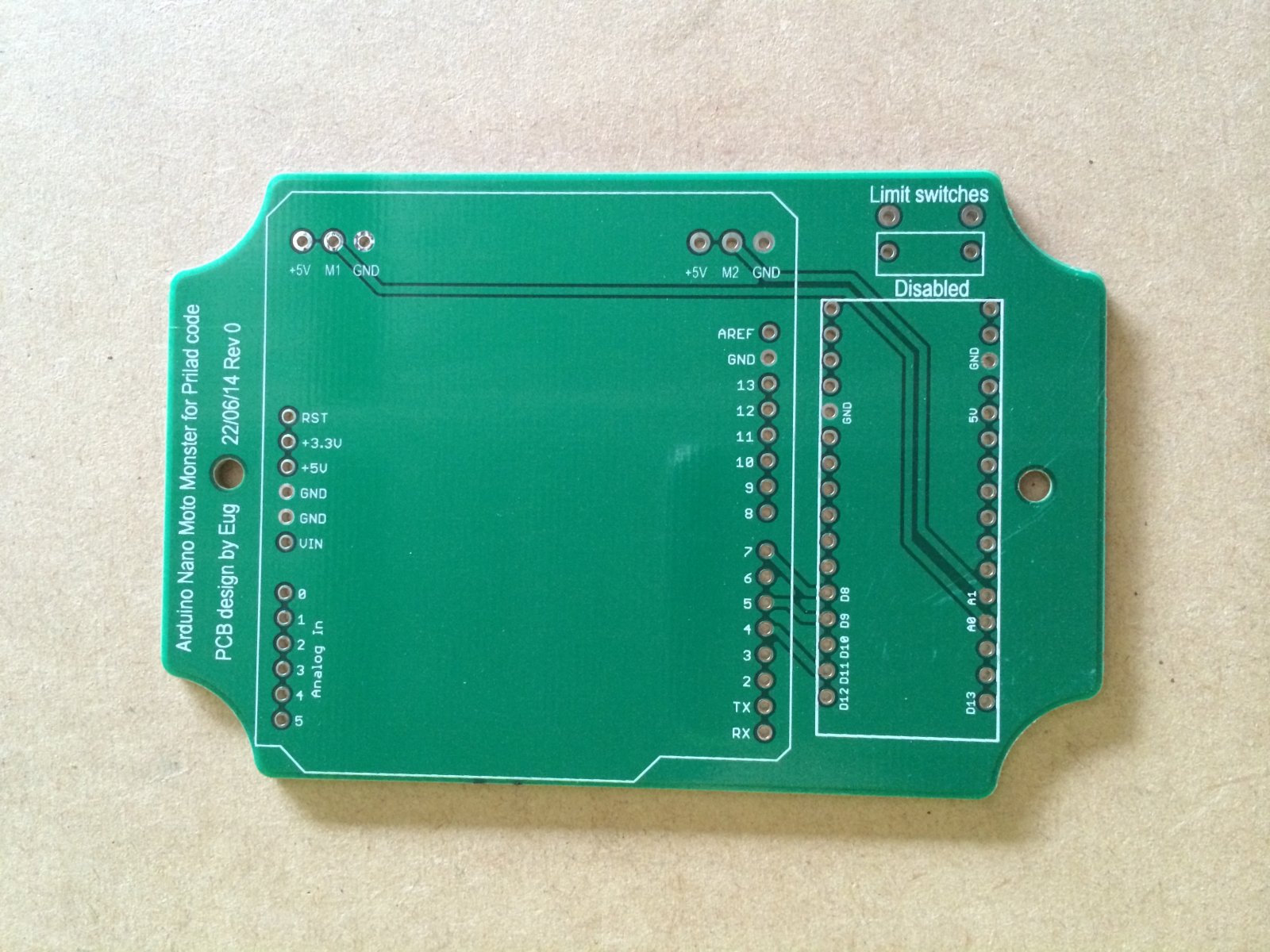

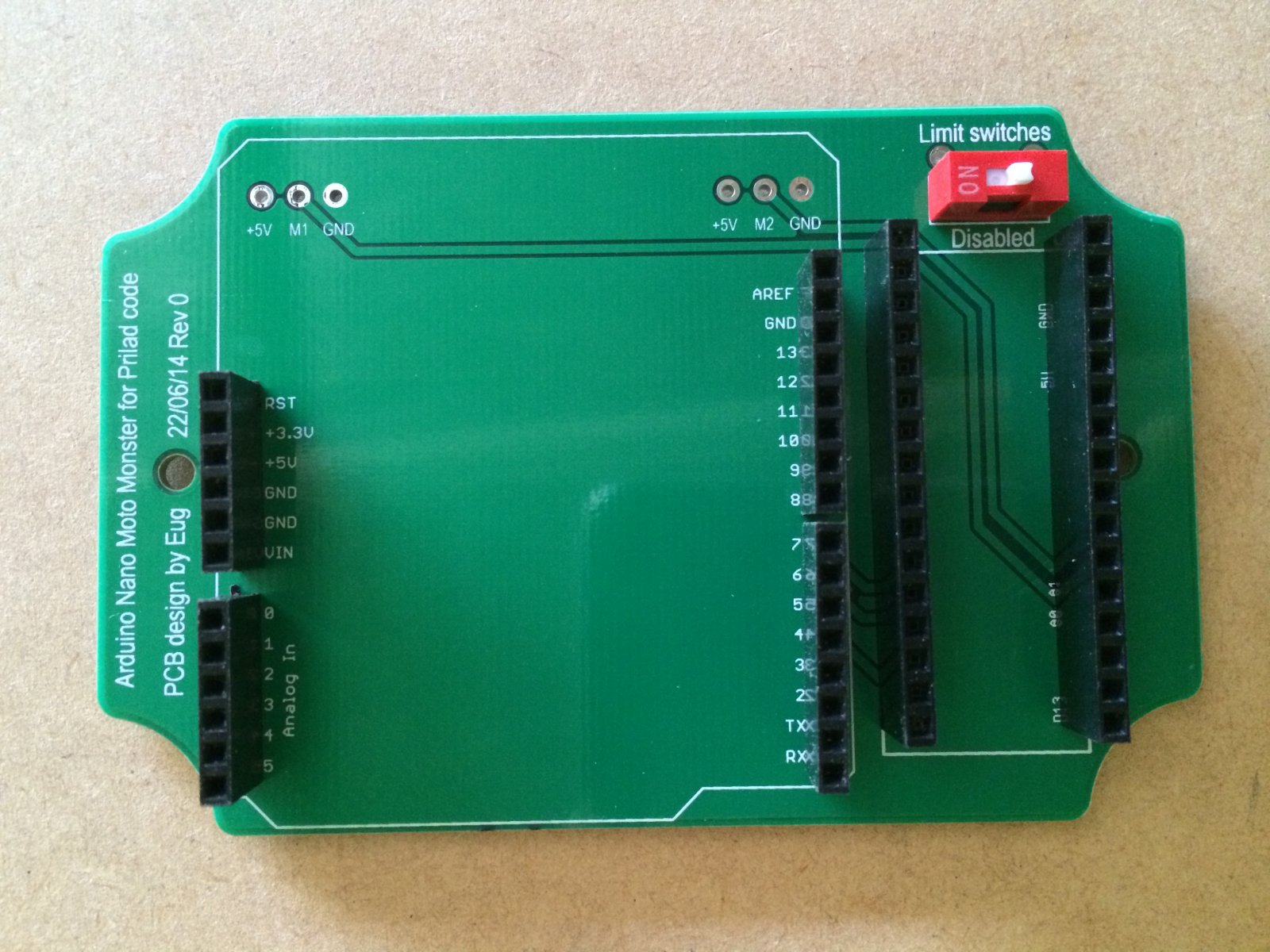

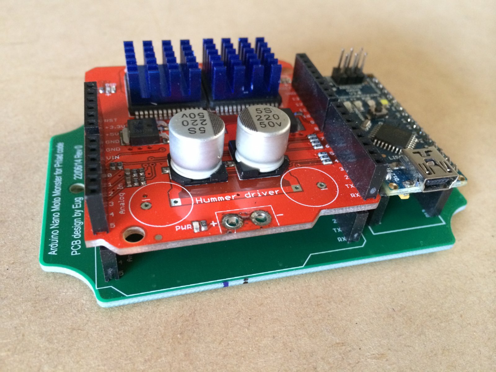

    But I really wasn't happy with the birds nest of wiring. I would have preferred to stack the moto monster onto the Arduino, but the code wouldn't work in that configuration. So it meant a bunch of wires all over the place - too much chance of mistakes and things not working, or blowing up. Didn't like that idea too much, so I spent some time and designed some PCB's made to fit into a small plastic box I had from another project.
    Bare PCB
    Headers installed. I decided to add a switch into the circuit that would allow me to add limit switches to the motor arms - just in case. Better to cut the power than burn a motor out or damage something, especially when first testing!
    Moto Monster and Arduino installed. I used small ram heatsinks on top of the driver chips.

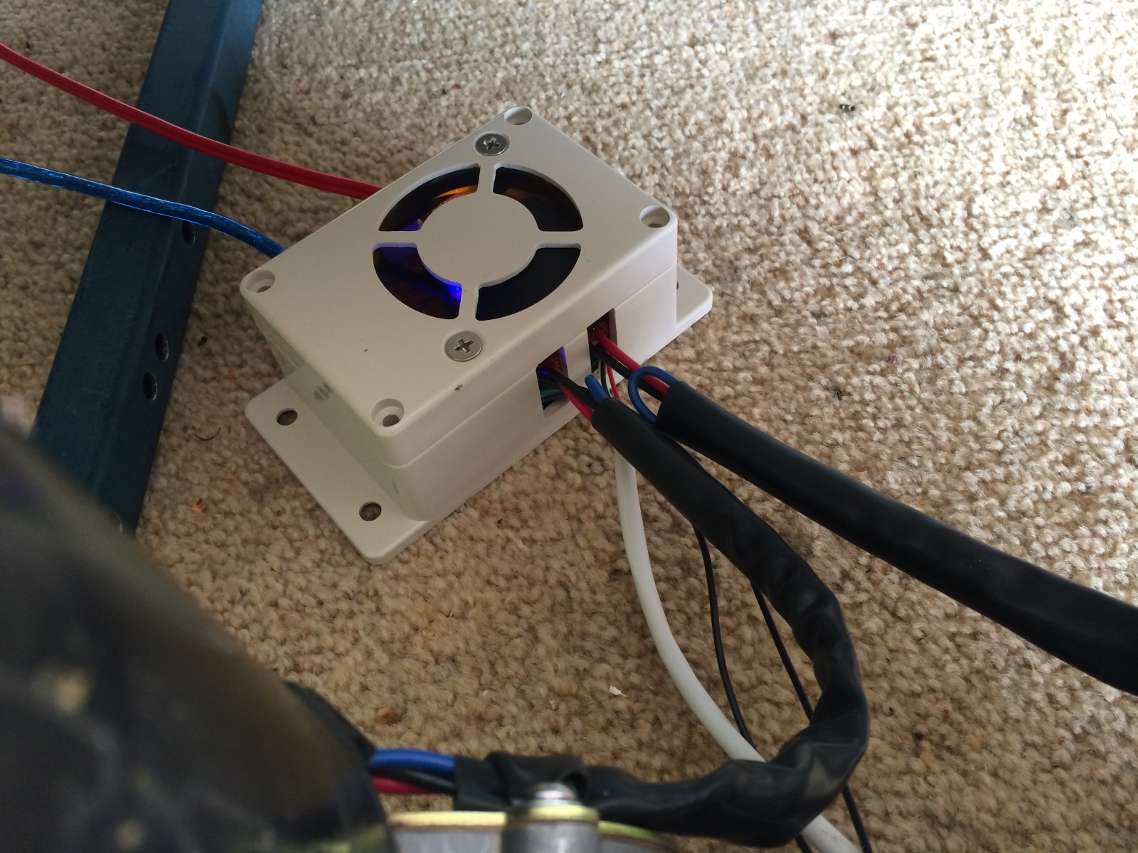

    PCB mounted in the box, power supply, motors, pots and limit switch wiring in place. Fan screwed to lid and wired to moto monster for power.
    That's it, ready to roll.

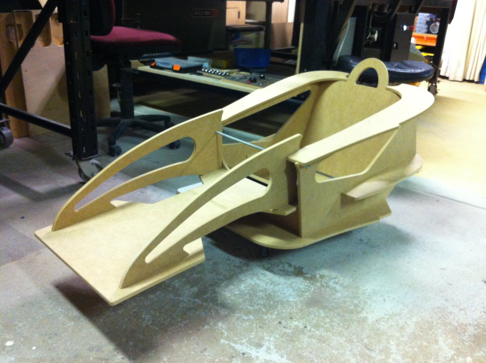

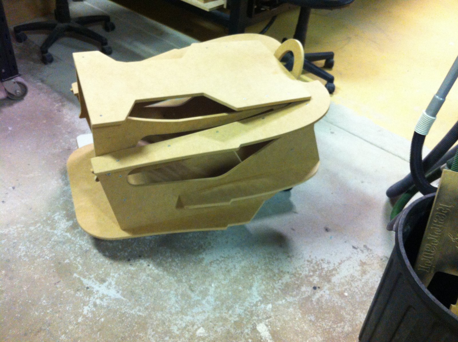

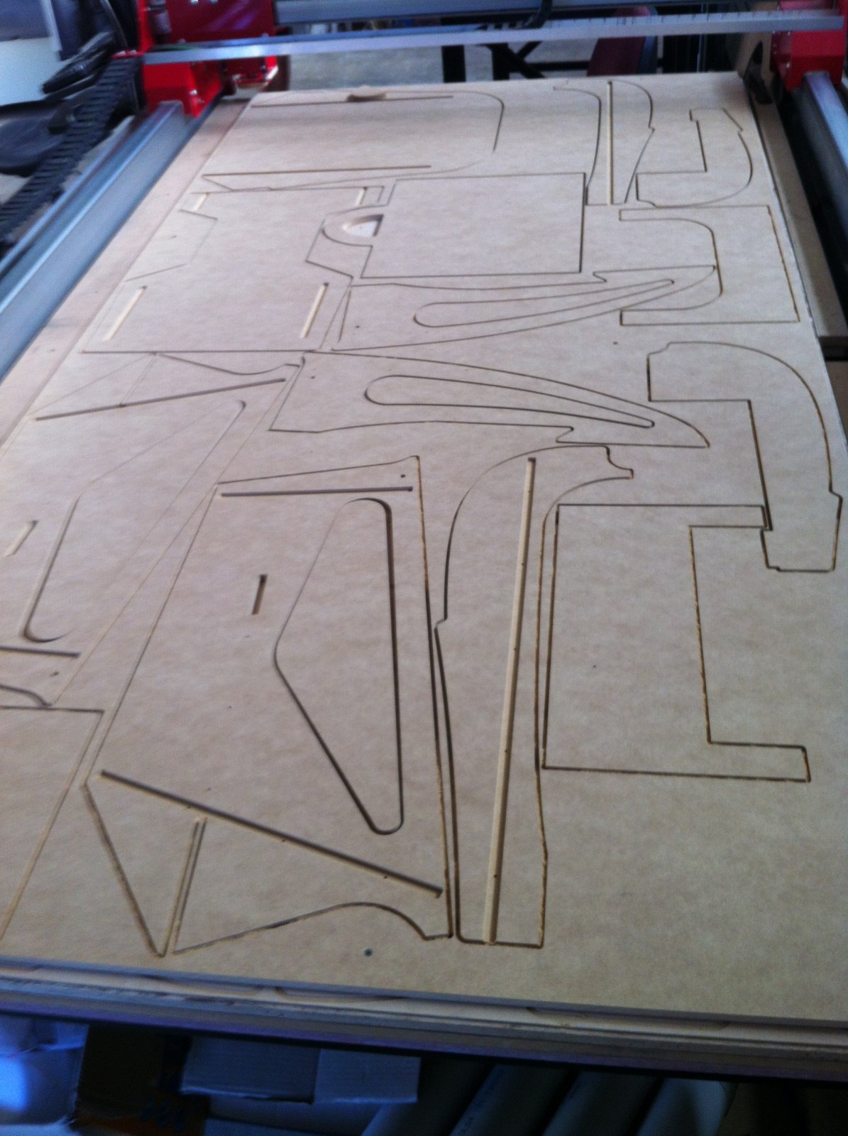

    Next step was designing the sim. I wanted something different from just a seat, something with some "fun" factor to it. I did some searching and got some ideas.........

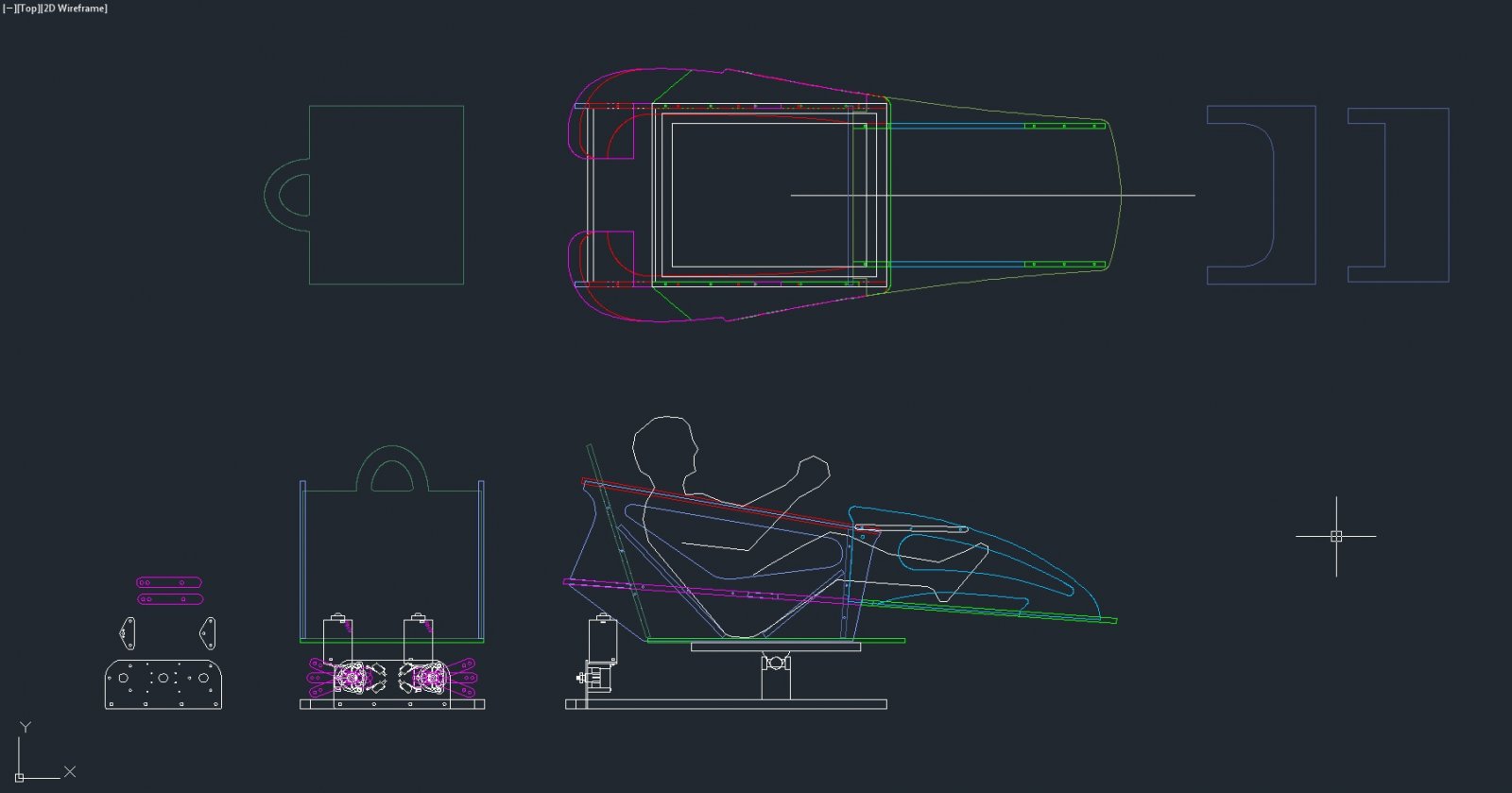

    Spent some time on CAD and had a design ready.....
    It makes things easy when you have a CNC router at home.....
    A short time later and it's assembled.
    And it folds up when not in use.

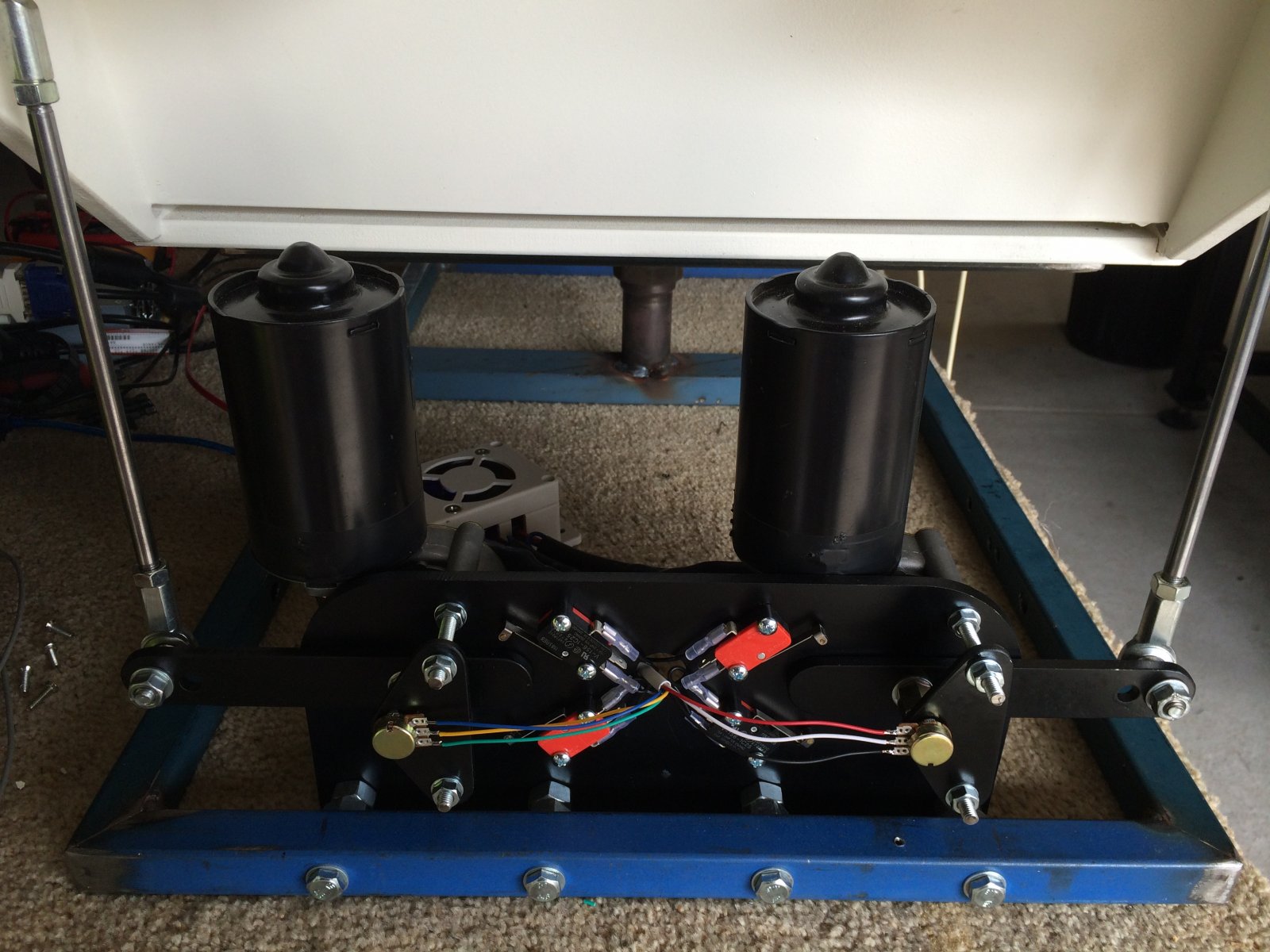

    Next came mounting the motors. I built 2 rectangle frames from some 30mm tubing I had laying around. I decide to put the motors at the rear, as far away from the pivot point as possible. I also decided to make longer rods, to attach the arms near the centre of gravity.

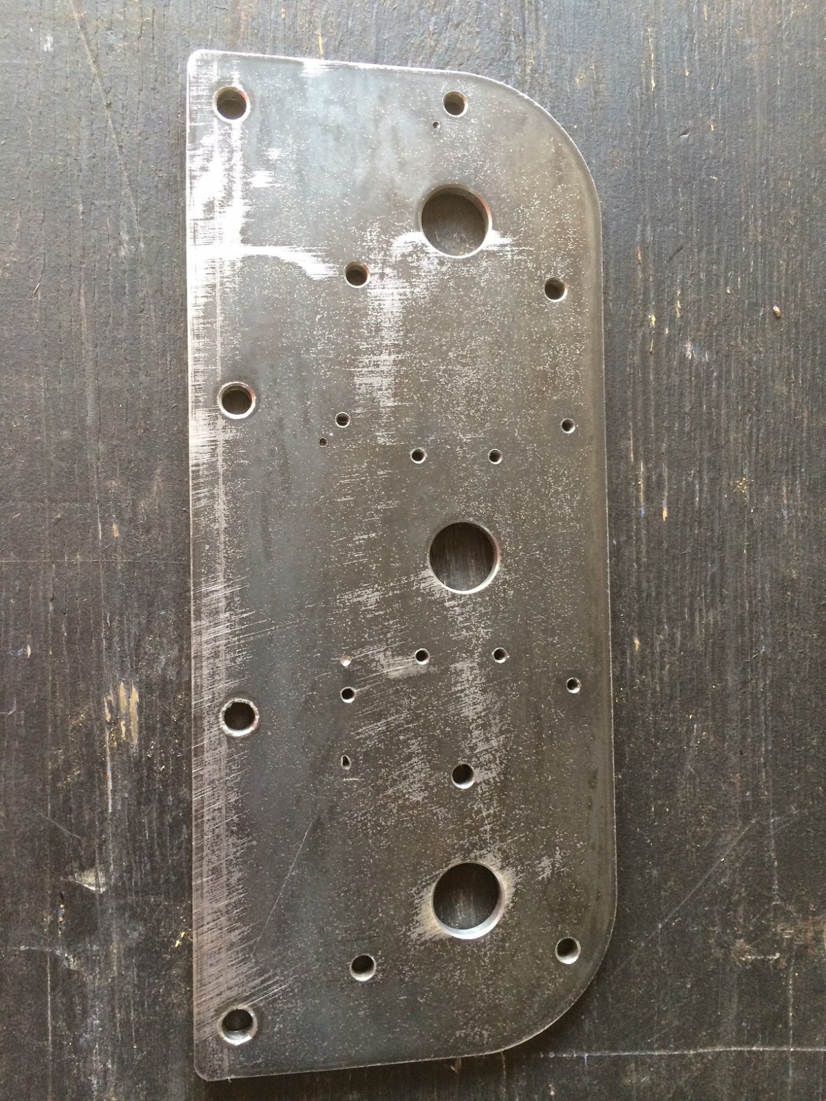

    One mount to hold the 2 motors, limit switches and pots. Helps if you have a CNC plasma cutter at home.....
    And here it is in place, everything mounted being tested. The kids have sat in it and the motors have no trouble moving them. Next post I'll upload a vid or 2.

    The PCB is multi-layer Robbie, so it's unlikely the gerber files are of any use to any members as it's not something one can make at home. Plus it's designed to fit a specific case, which needs to be machined on the CNC router to make it all fit neatly - not something many members can do.
    However I did have to get a qty of boards made, so if there's interest from others, and if it's OK with Rene, I might offer them in the Marketplace forum.
    As for the wood plans, it's a tough one. The design is based on others I found pictures of on the web, so strictly speaking it may or may not be mine to release. Either way, they are a DXF file format, which can only be cut on a CNC router. They have tabs and rebates to lock it all together, and would be far too time consuming to make by hand. I would imagine there's only one or 2 people on this site that have access to a CNC machine, so I can't see how the plans would be any real benefit to the members here???
