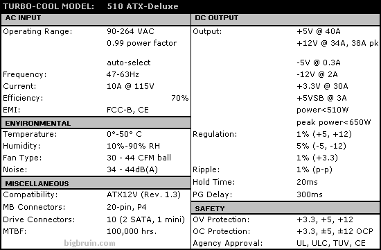

    P.S. I have one question for those who know about current consumtion of 2 wiper motors with load.
    I'm going to use my old ATX pc power supply which is 510W with 12V-34A (38A peak-single rail) as a PSU for 2 wiper motors.
    The image of my PSU specs is attached.
    Can one ATX power supply handle 2 wiper motors with load?

    should be ok mate but ya could use one per motor.
    Well done on mini. Time to build the real thing because i dont think it would last if ya sat on it, lol, sorry could help myself.
    Well Done, Ask away.

    Also power supply, yes one each per motor would be sufficient. Otherwise run one power supply in parallel with a car battery for both motors. Several of us use that set up. Good to handle big spikes in current draw.

    Normally, a car wiper motor(DC12V-30W) consumes 10A on its specification.
    but I learned before that P = VI,
    then 30W = 12V * y A.
    Therefore
    y = 2.5 A.
    is that right?
    if it's right, one PSU can easily handle 2 wiper motors
    So, I thought one PSU can handle 2 wiper motors w a payload of nearly 130kg.
    if I'm wrong,
    I should buy a car battery or another PSU. :(
    plz correct me if I'm wrong.
    Thanks in advance

    Hello dude, in regards to power supplies and wiper motors.
    When a wiper motor is doing what it usually does, that being turn one way to swing a wiper arm, it draws a quick bit of high current to start it then uses a little bit after that.
    Example being an air-conditioning compressor. Mine is 9kw cooling, so when I start it up, it draws 72amps for about 1/2 second and then 10-12amps running after that.
    A wiper motor constantly having its direction and speed changed draws a LOT more current than what it lists as actually using. A safe bet would be to use either one psu per motor, or use one psu wired in parallel with a decent size car battery. I use a cheap 500w pc psu, which really runs more like 330w (it runs about 18amps on 12v) and a second hand car battery rated at 330cca. The two of them together handle the spikes of 22amps through my JRK controllers very well. I run two motors.

    Thank you bsft for your kind answer.
    Now I can see in power consumption of motors more then before.
    Anyway does the spikes you wrote mean peak current?
    In your case the power consumption of 2 wiper motors is 264W(=12V * 22A) at maximum.
    Am I wrong? 22 amps in each?
    If the spikes of 22A is for 2 wiper motors, There is one thing I can't understand is that My PSU which can handle 12V-34A(510W) on the average, 12V-38A(650W) at peak is not enough to turn 2 wiper motors on in severe situation you said.
    I think the spikes of 22A is quite lower than the capacity of my PSU, 34A.
    sorry for bothering you to explain.
    Thanks in advance.

    Hello Jason, sorry, I'd better explain myself better. Yes I mean peak current, in this case my boards are set at 22.5 amps peak, each. I can go up to 30amps, but they would stress the boards.
    Yes I mean 22amps per motor. So perhaps allow up to 50 amps total. My suggestion would be to use your power supply with a car battery in parallel. This will cover peak current bursts and perhaps save a few dollars in getting another power supply.
    With the motion, if you harden up the motion or add more forces, you add more power needed, hence the higher current needed.
    It took me ages to figure out power requirements and cost to do it. Eaorobbie, suggested a car battery in parallel with my current power supply. It works a dream. I got a good second hand battery for $30, and modified a pc psu $40, cheap overall and very effective.
