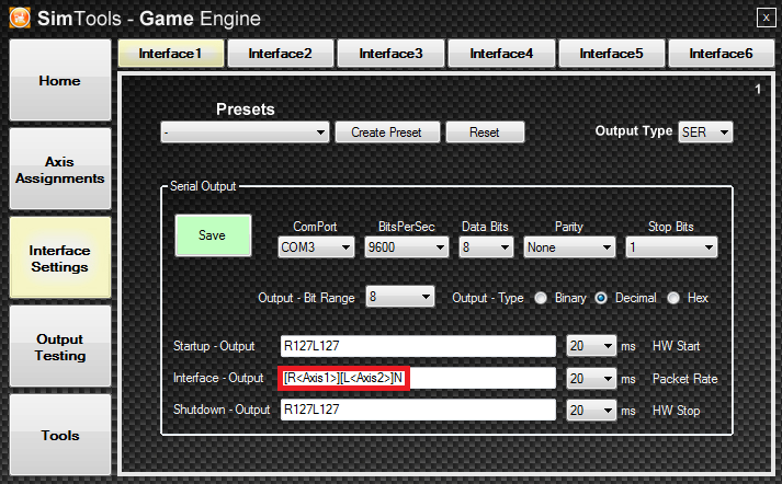

    Ok for an example of SimTools talking to an Ard I will show you how I did it with the model, actually another member @aarondc made it way better.
    That controls 2 servos but can be written in a different way to control what ever.

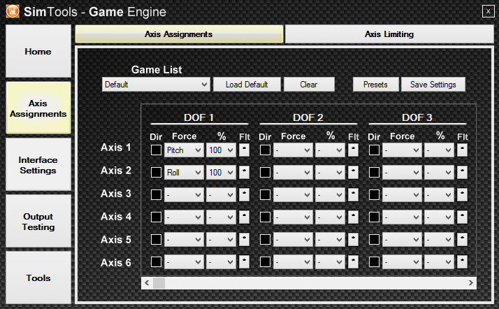

    So you would setup 2 axis like this in the axis assignments:
    Axis 1 is the Pitch servo and Axis 2 is the Roll Servo and but use 100% of the servos movements.

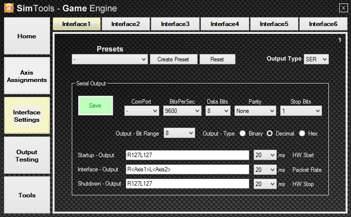

    Then to talk to the above code I use this in the interface setting except set the comport to what you need.
    Ok here you can see Im sending the info to the ard at 9600 and 8,N,1 and in a decimal format at 8 output range ie (0-256).
    Startup tells it to centre the servos, so does the End. Make sure you save before move of any of the sim tools pages too.

    Ok if you had used the above settings for the axis assignments then they are wrong to the way that you now have built the model too. You are using combined axis and the above axis setting are for separated axis as in one axis(servo) controls roll and the other controls pitch.
    The correct Axis Assignments to make you model move correctly is as follows.

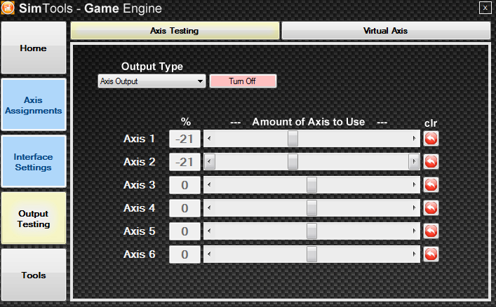

    Hi, I have problem with simtools. If I am simulating with Axis testing i get both servos up. And problem come if I get slowly down to -21 servo gets to -21° but if i continue to -22 or bellow servo get up to 180°. simtools problem.png
  11. eaorobbie
    20,465Coins
    +1,686 / 23 / -2
    You using the updated version of SimTools, has a correction in it for the Output Testing. As previous it was a little touchy to use, I normally just test the DOF. But this axis test should work too, Check in the Tuning centre as you move the axis to be sure its an issue with the code or not.
    I need to plug my model in and test this again my self.

    Ok this is the revised code , tested. One is in Debug mode allowing you to use the Serial monitor in Ard IDE enviroment, handy for pre testing.
    Command to test with is Rxxx~Lxxx~ with xxx being a number between 1 - 255.
    Then the other is in SimTools mode ready to run in sim tools with this preset.
    or set it to 8 , N , 1 and decimal with 8bit output.
    Command is R<Axis1>~L<Axis2>~ at 10ms.
    I have tested both with my model, you might have to change the pin out for the servos or the mapping as one servo is mapped the opposite to the other.
    I need to update my original post to these codes , sorry a project that I did over 6 months ago , the post didnt get cleaned up. Sorry man.
    The following zip file contains both codes debug and SimTools ready plus an Interface Settings file which can be imported into SimTools via the Tools - Preset Validator.

    Hello. Today I edited your old code, and now everything works as it should. I added to it one more Funck, adjusts the congestion. Thank very much for any help. I think with this i can graduated in matricular exam. Tomorow i share arduino code and some photos.

    I added the N and now I know where is the end. In code I add the condition, if is gforce1 bigger than 9 (it is because if i get from simtools L=76-48=28 or N=78-48=30). if a condition is true gforce1=0 and gforce10 is ok and gforce100=gforce100*10. You can add next condition, if gforce10 is bigger than 9. It is for the case where the number of simtools is not a three-digit.
