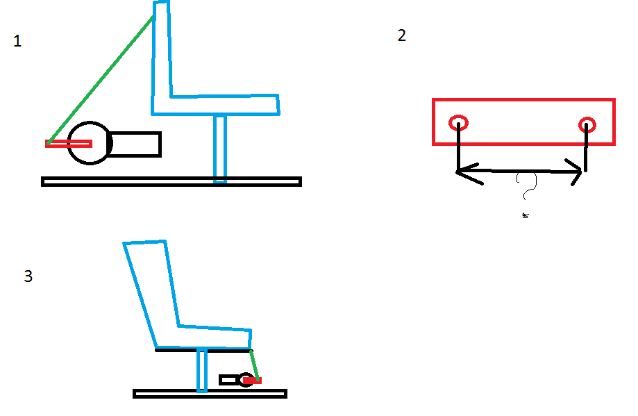

    Thx RacingMat. So today I made a sketch:
    http://postimg.org/image/hxm9oonnb/
    I need to reduce the lever, but do You mean the lever painted in red on my picture or some other? I don't want to move the seat too much. Only a little, so I imagine this element can be short (does anyone know optimal dimension to start with this part?).
    What is more important to have a good feel wit motion rig - speed or power (I know - both, but if You have to choose)? '
    First motor is weaker but faster and You say I can reduce the lever to neutralize it. Second motor is slower (but with more power) and maybe this is a problem too? How we can fight with this?
    I dont know is it important or no, but my weight is around 75-80 kg.
    My picture with number 3 shows what I want to achive. Only place I have to build is under the seat. Sadly I can't use more space around ;(

  9. RacingMat
    2,237
    21,020Coins
    @gorzasty
    first posting image: this forum is wonderfully marvellous love3.gif to post image, simply drag and drop it onto the message you're writing
    and them choose Thumbnail or Full Image
    tadaaa !
    second: the lever
    yes, it's the red one
    for example (depending on other parameters) 3cm is short 6 cm is long
    third: speed or power
    In my opinion, I don't enjoy too much being shaken too much but I prefer precision (no lag with game on PC): I would advice you speed! ;)
