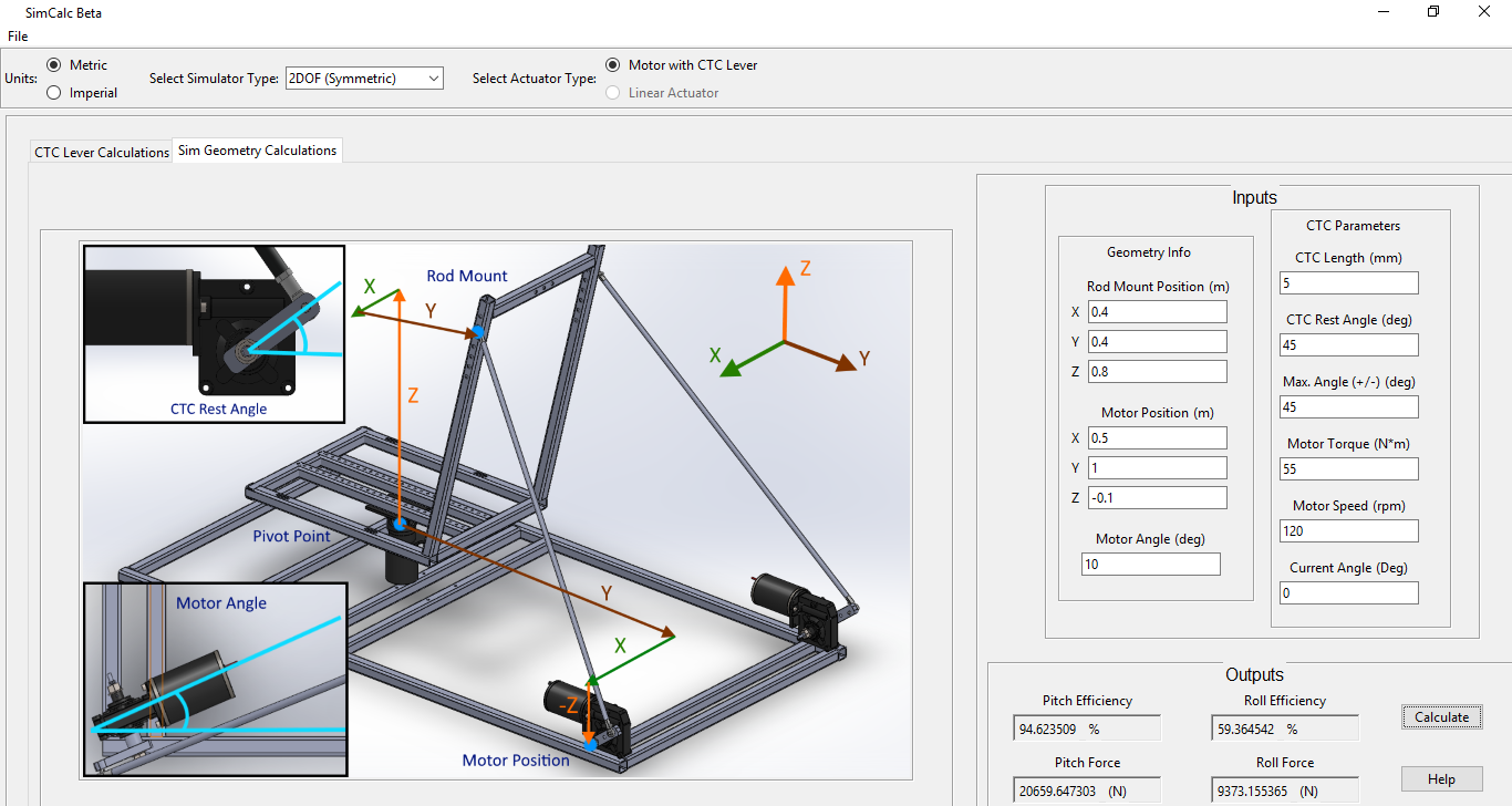

    so I tried out this wonderful calculator, but I'm having problems understand the values.
    I switched to metric system. I provided a couple of values that I think will approximetly meet my later setup.
    My questions:
    CTC Lever Calculations
    • Max. Angle (Deg) of CTC lever
      • Does 45° meet the regular setting? Or what is a optimized value here?
    • Current Angle (Deg)
      • I do not understand this one. What means current position? What is the zero position meant to be? What I'm trying to say, that this is all depending on however my setup is going to be, right? Current position may be any position, or am I misunderstanding something?
    • Rest position
      • What is the rest position?
    • The output values:
      • Linear Speed - Is there a specific value that has to be met?
      • Output Force - What does this one say?
    Sim Geometry Calculations
    • Motor Position Z
      • This value is relative, right? It depends on what position the CTC lever is set to, right? Is that the Current Angle value from the previous page?
    • Motor Angle
      • That's the angle from the left or right outer line towards the Rod Mount? Correct?
    • Pitch and Roll Force
      • I'm not sure what to do with these values. Do these values tell me anything on the possible weight of the seat construction?
    Sorry for so many questions, but as I said I'm not familiar with the mechanical stuff.
    I hope anybody is willing to help me a bit further.
    Kind regards
      • How far the lever is allowed to move, keep in mind that over 38-40 degrees in either direction, 76-80 degrees total, the effective use of torque falls off dramatically. Think of it like pushing a door, if you are applying the force at 90 degrees to the door then you can move it with one finger, but if you apply the same fore to the door jam it would be hard to close as it is an inefficient angle.
      • As per the insert picture when the seat is level the rods should meet the lever at around 90 degrees. So the angle of the lever at rest is 45 degrees for the pictured design but will vary depending on sim design. So on a compact frame design it could be just over 0.
    • Rest position
      • The rest position is when the seat is level and the rods meet the lever at 90 degrees.
      • Linear Speed - the general consensus is that at least 150mm/s is needed for good motion, I would suggest 250mm/s or over for VR.
      • Output Force - The theoretical force in Newtons.
    • Motor Position Z
      • This value is the height from the pivot point (at or near the seat base) to the where the rods mount, in the case of the shoulder mount design pictured to the seat back when at rest.
    • Motor Angle
      • As per the photo insert, it allows for the motors to be angle mounted to the frame, which can effect the geometry.
      • The design angles determine the efficiency an hence what force applies in the pitch and roll axis.

    I think I understand so far. But the one thing I'm not getting is how much the seat construction inclusive myself may weigh?
    20,535
    145,034Coins
    +10,776 / 52 / -2
    You would have to figure out the mass for yourself by including your weight, the seat, seat frame, plus any peripherals mounted to it.

    Yeah that is no problem to me, but how do I know if my setup/motors is/are strong enough for that weight?
    20,535
    145,034Coins
    +10,776 / 52 / -2
    Disregarding mechanical loss, to know what Newtons it will take to move something it will be Mass (kg) x Acceleration (m/s) = F (N). So to move 100kg at 0.7 m/s needs 70 N. It takes 9.8N per kg to counteract gravity. Keep in mind there is significant mechanical loss in things like a wormdrive gearbox, depending on the ratio you may want to allow between 10% to 50% loss for worm gears and the greater the gear ratio the higher the % loss is: http://www.meadinfo.org/2008/11/gear-efficiency-spur-helical-bevel-worm.html
