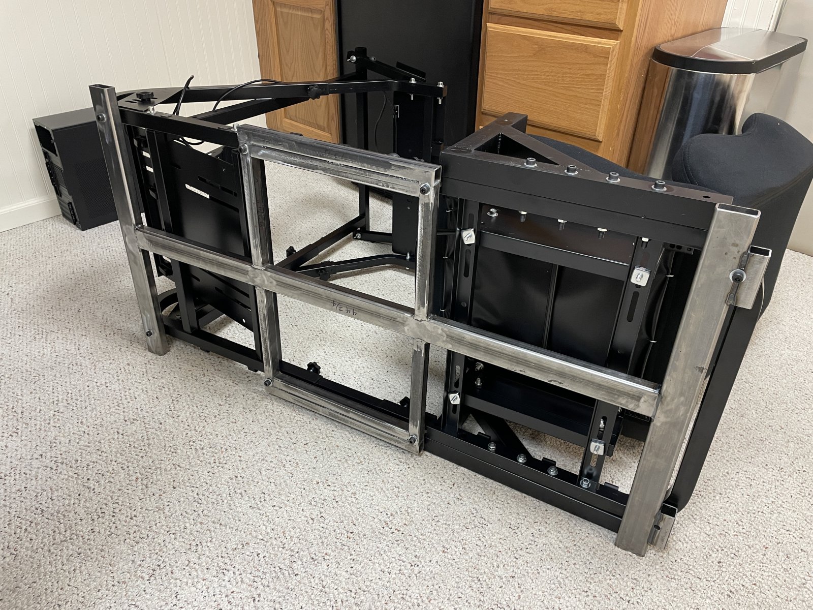

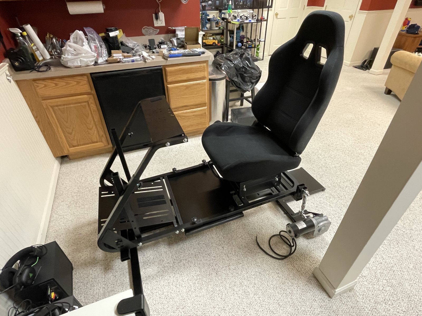

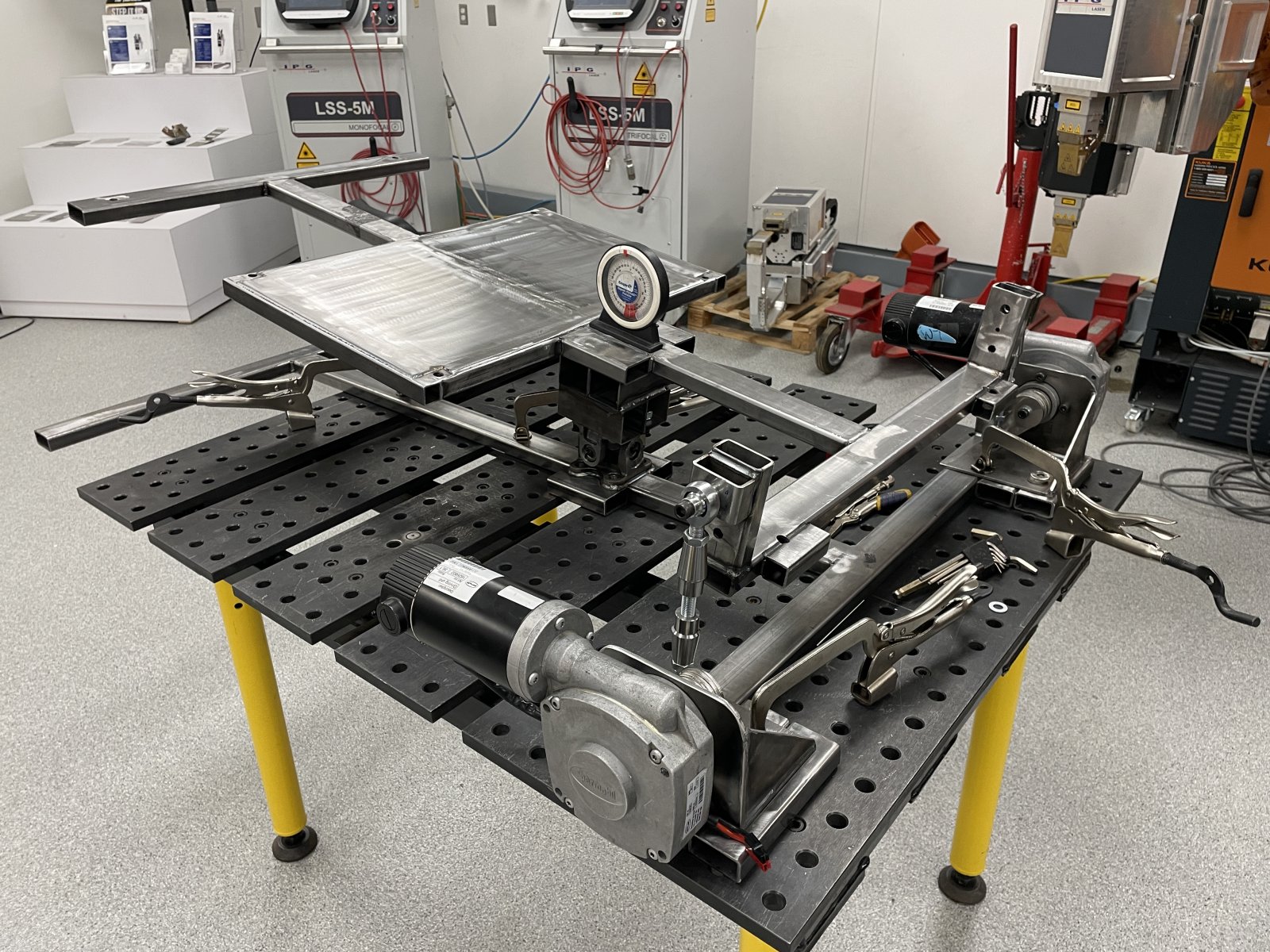

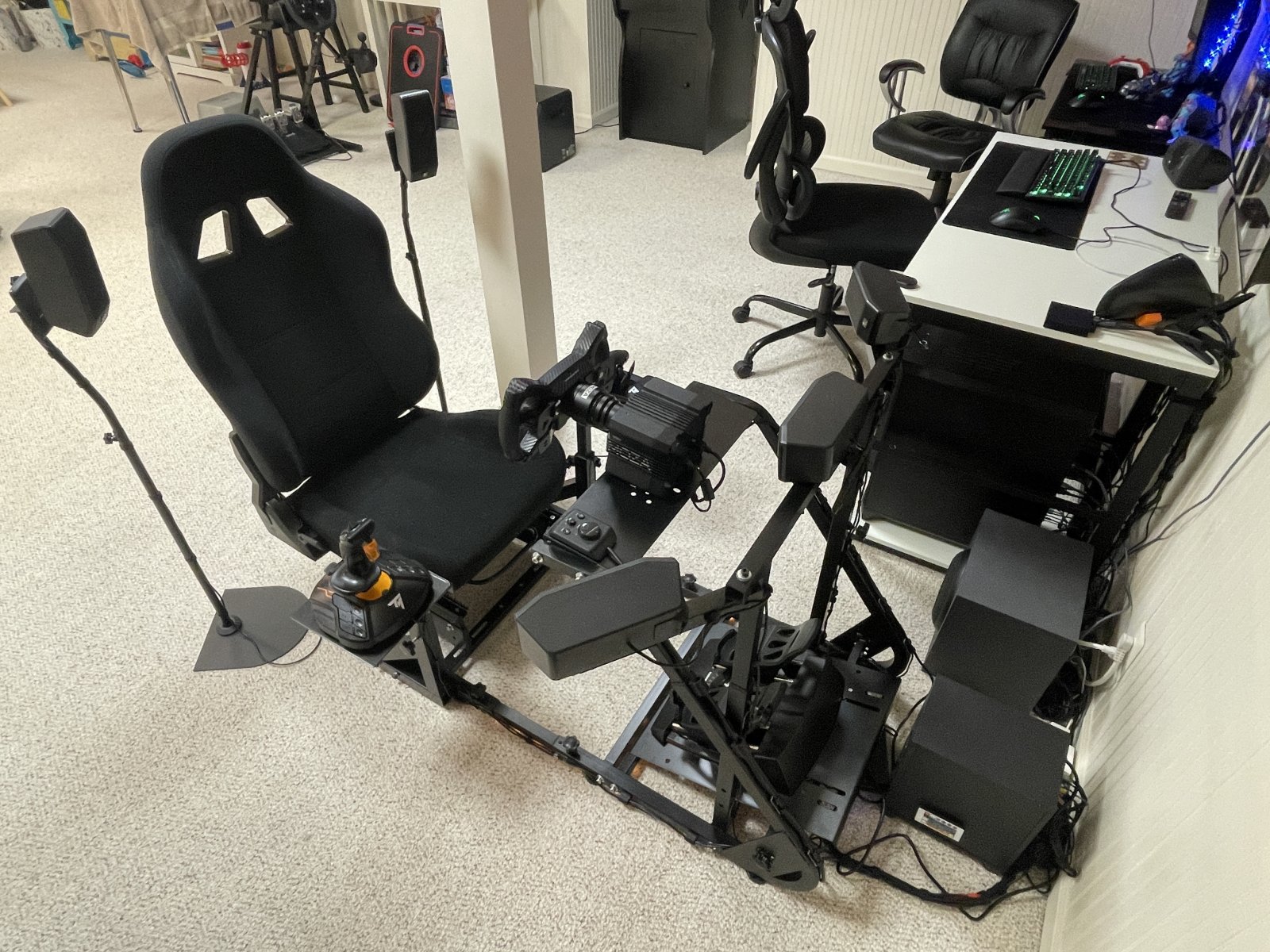

    Like many, have played driving and flying games in the past but nothing beats a sim rig for stability and comfort.
    Bought a cheap Dardoo sim rig from Amazon. Made the front speaker support where the monitor normally goes for surround sound.
    Picked up a PS VR2 a couple months ago and have enjoyed the experience.
    Went to an indoor go-cart track a few weeks ago and they had professional grade 2DoF driving sims. Got looking at the construction, a quick Google and found this lovely site.
    Happen to see @Captain Jack's build using the same sim frame. So, all credit to you Captain Jack for the concept. And the motivation credit goes to @Halloween2go after watching your videos.
    The tubing and universal joint were purchased from Amazon. Wheelchair motors should arrive any day from Ebay.

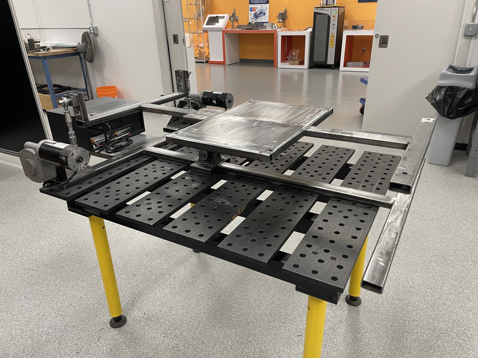

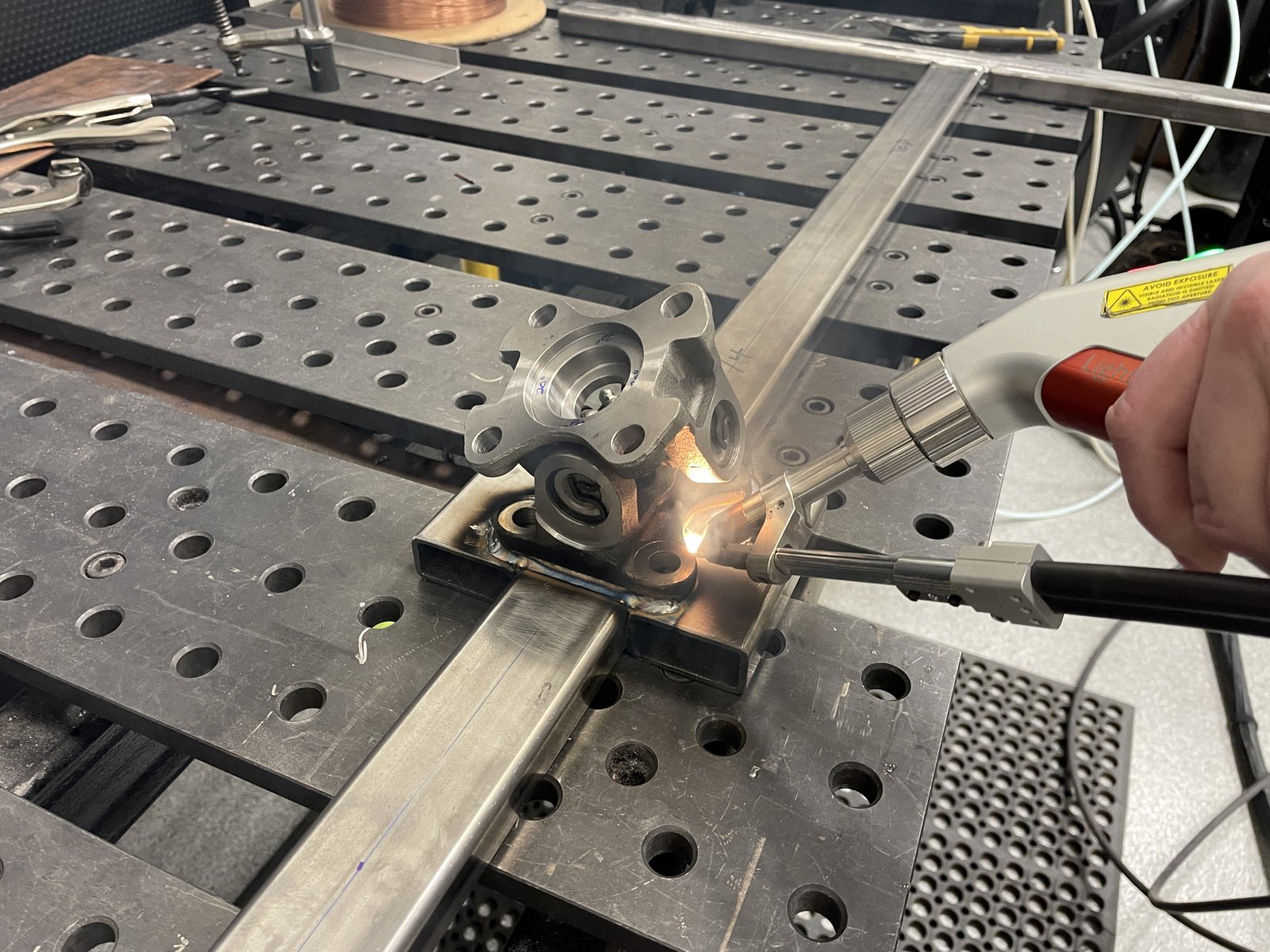

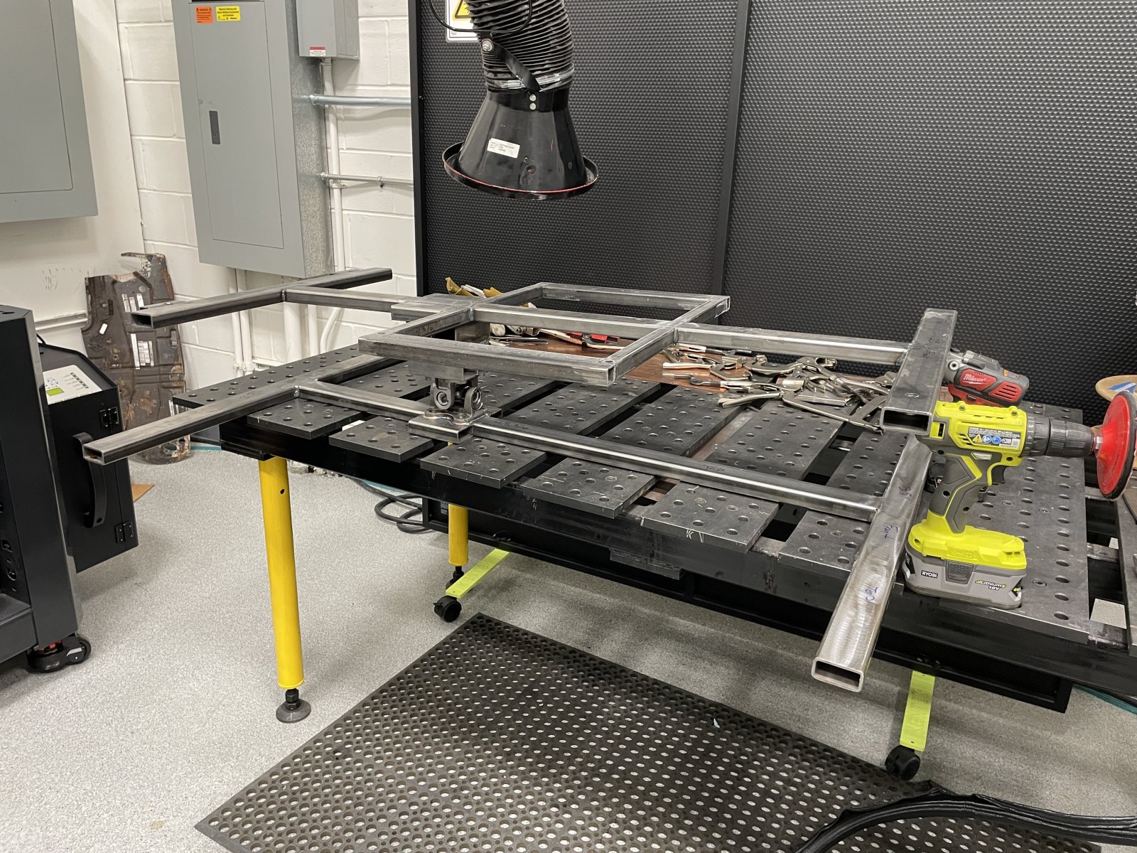

    Welding of the frame is almost complete, just need to make the motor brackets and hall effect brackets. I work for a laser company and a handheld welding system with wire feed.

  3. Garrett
    Garrett Member
    Mar 14, 2026
    56
    327Coins
    +31 / 0 / -0
    A few pics.

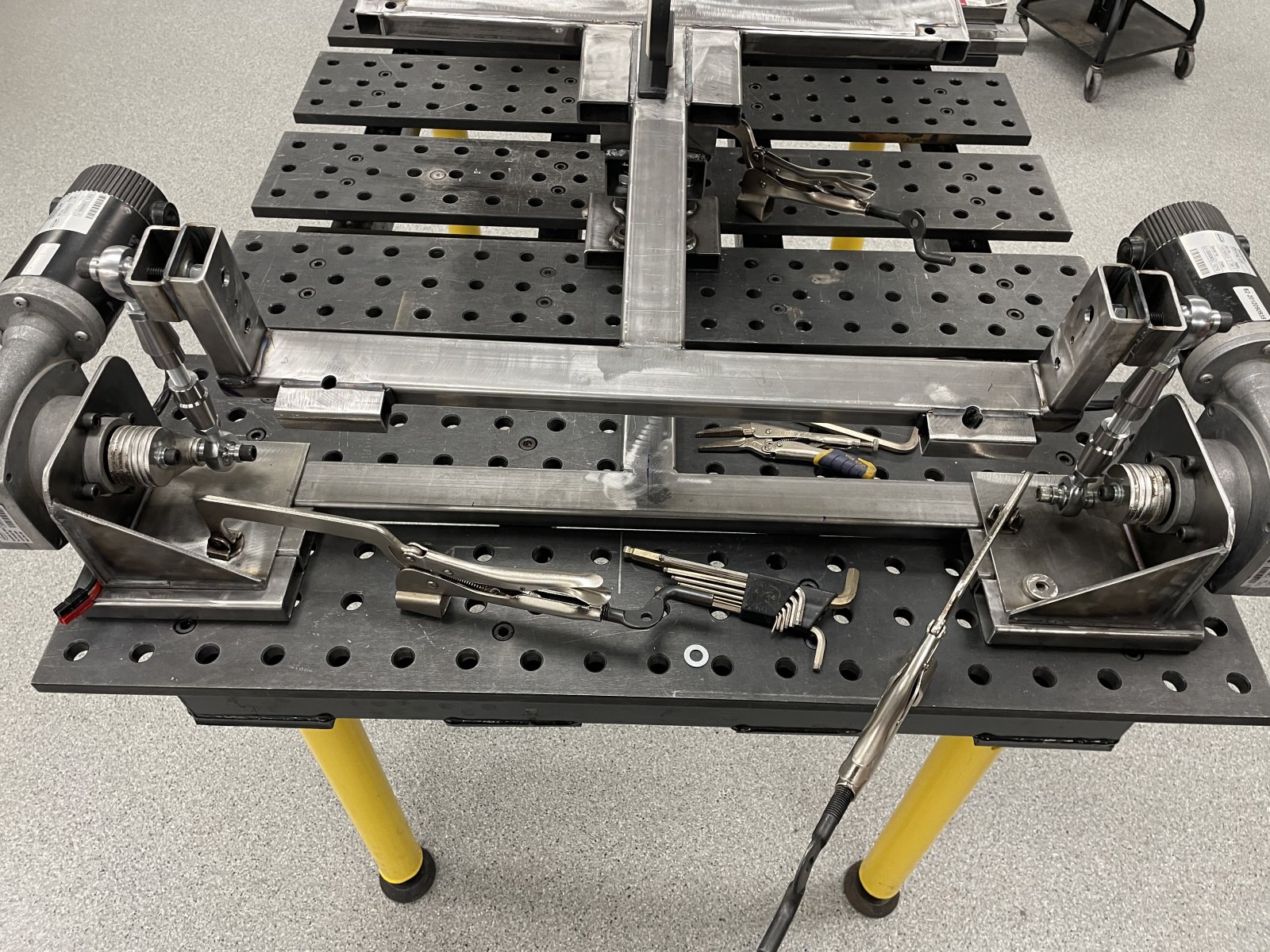

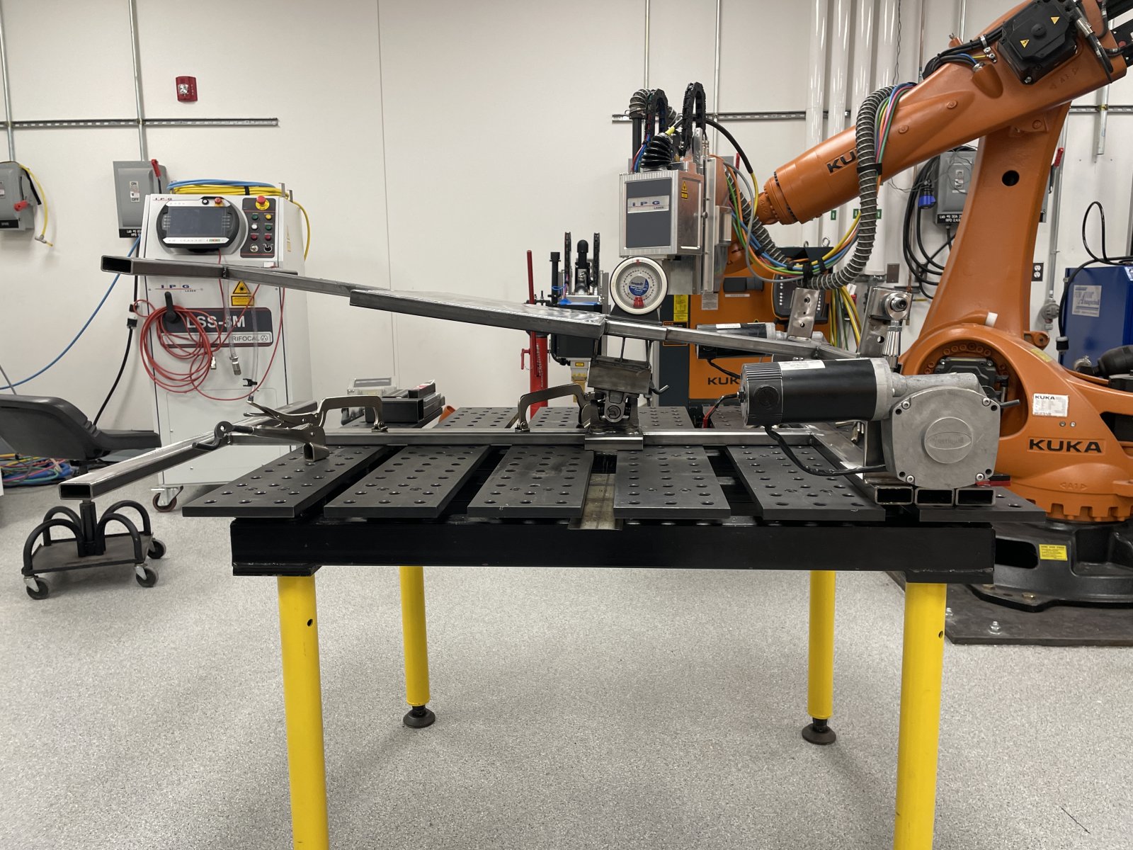

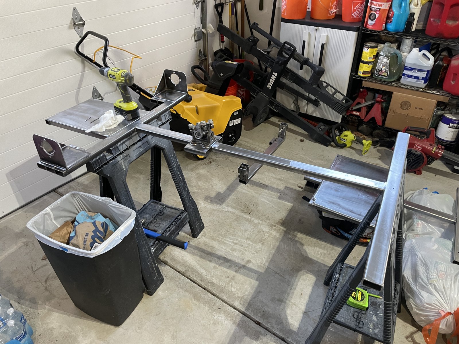

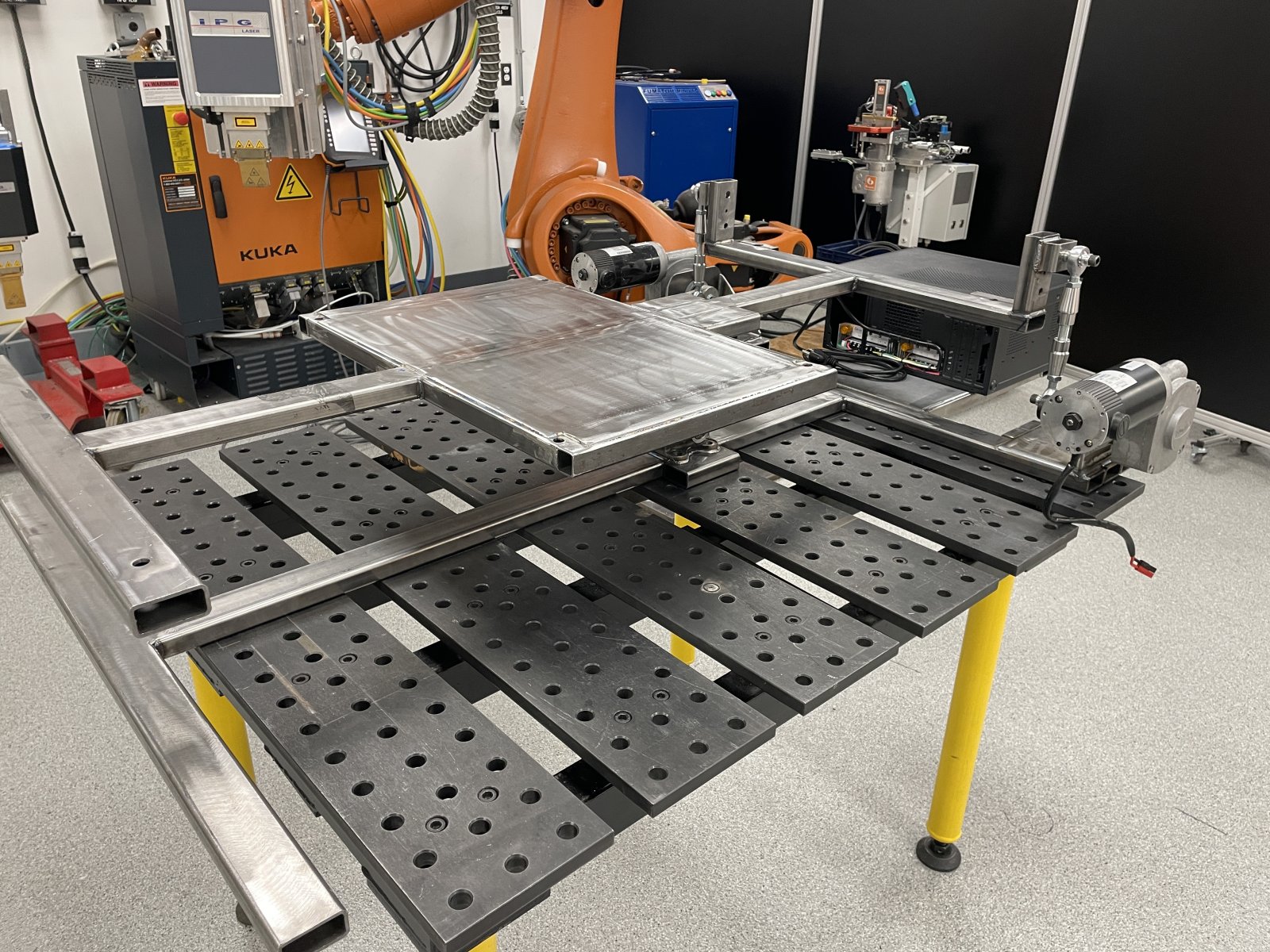

    I'm a welder for a major industrial laser company so we have some cool toys to play with.
    For this project using the handheld welding laser with wire feed and a cutting laser set up.
  6. Garrett
    Garrett Member
    Mar 14, 2026
    56
    327Coins
    +31 / 0 / -0

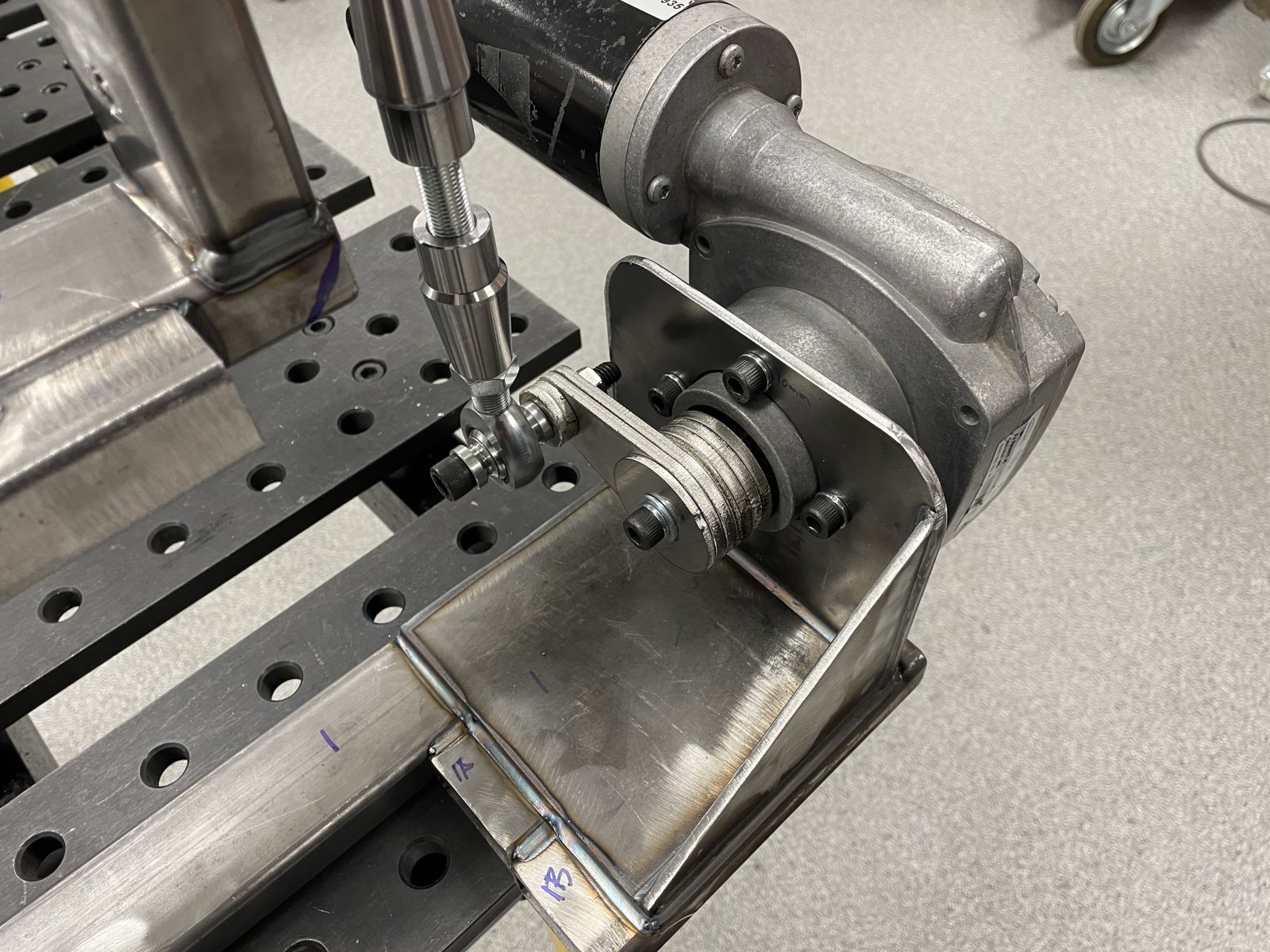

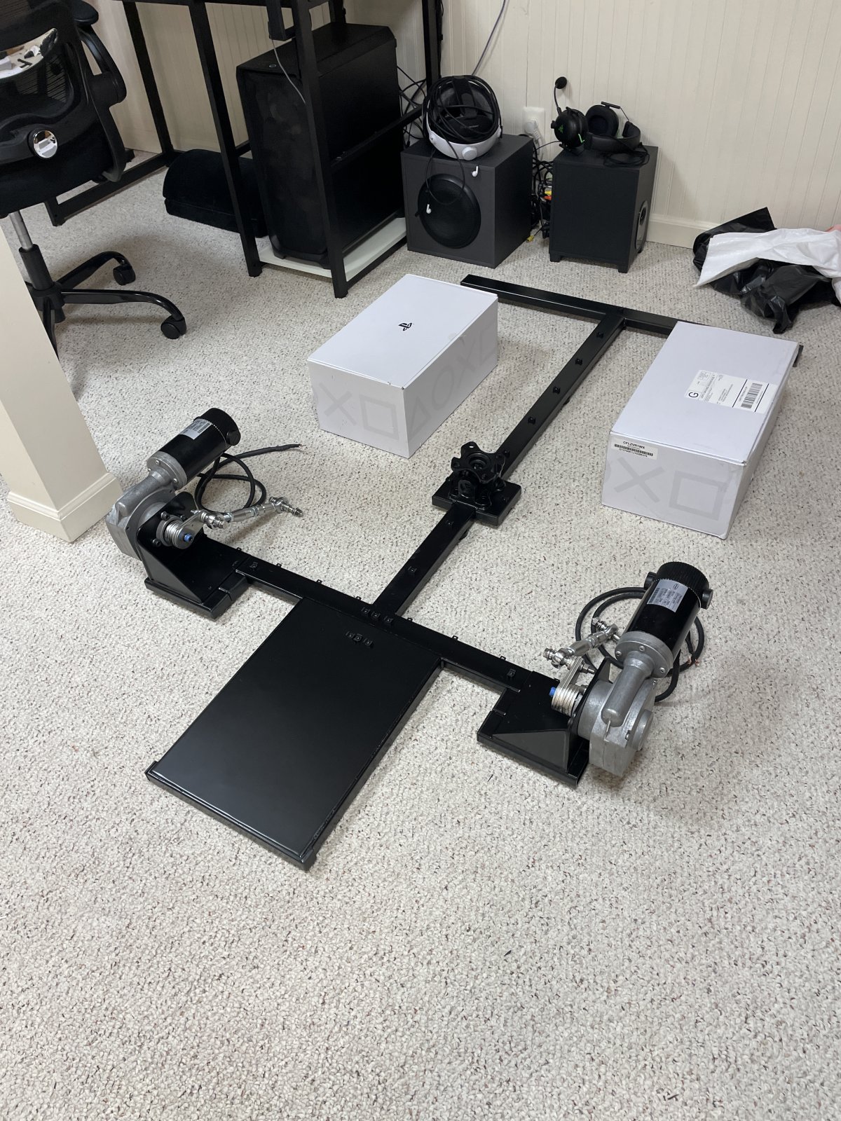

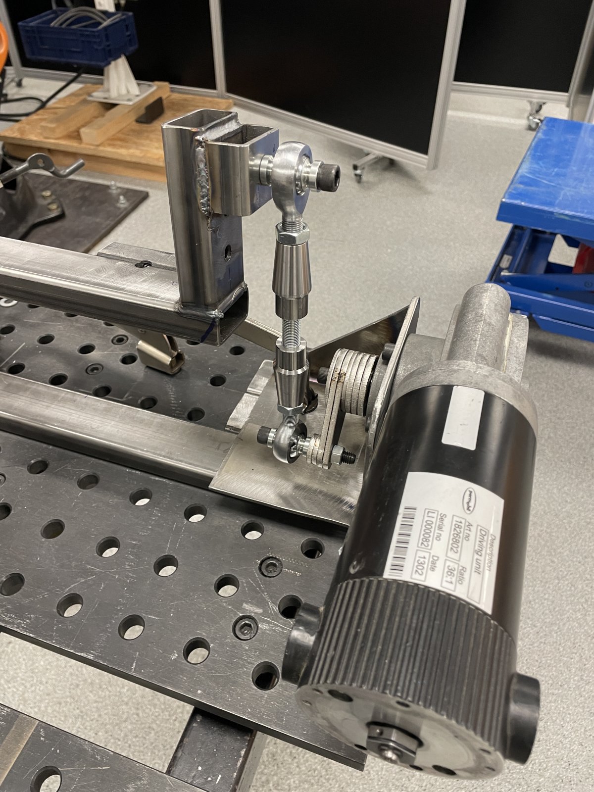

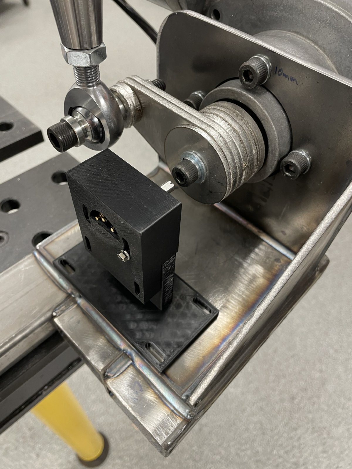

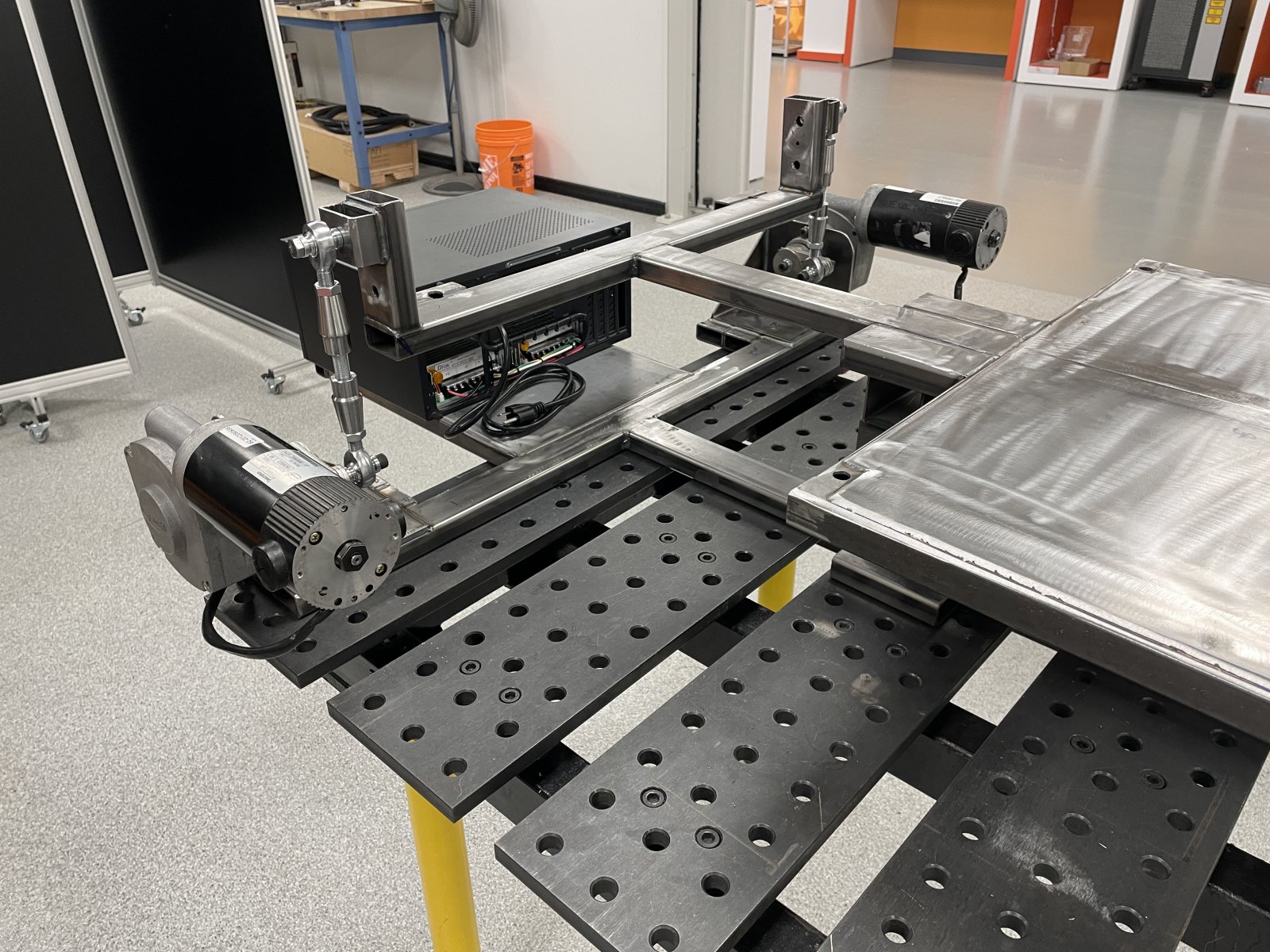

    Brakes on the motors were removed, they were weak and would fail to fully lock to prevent motion.

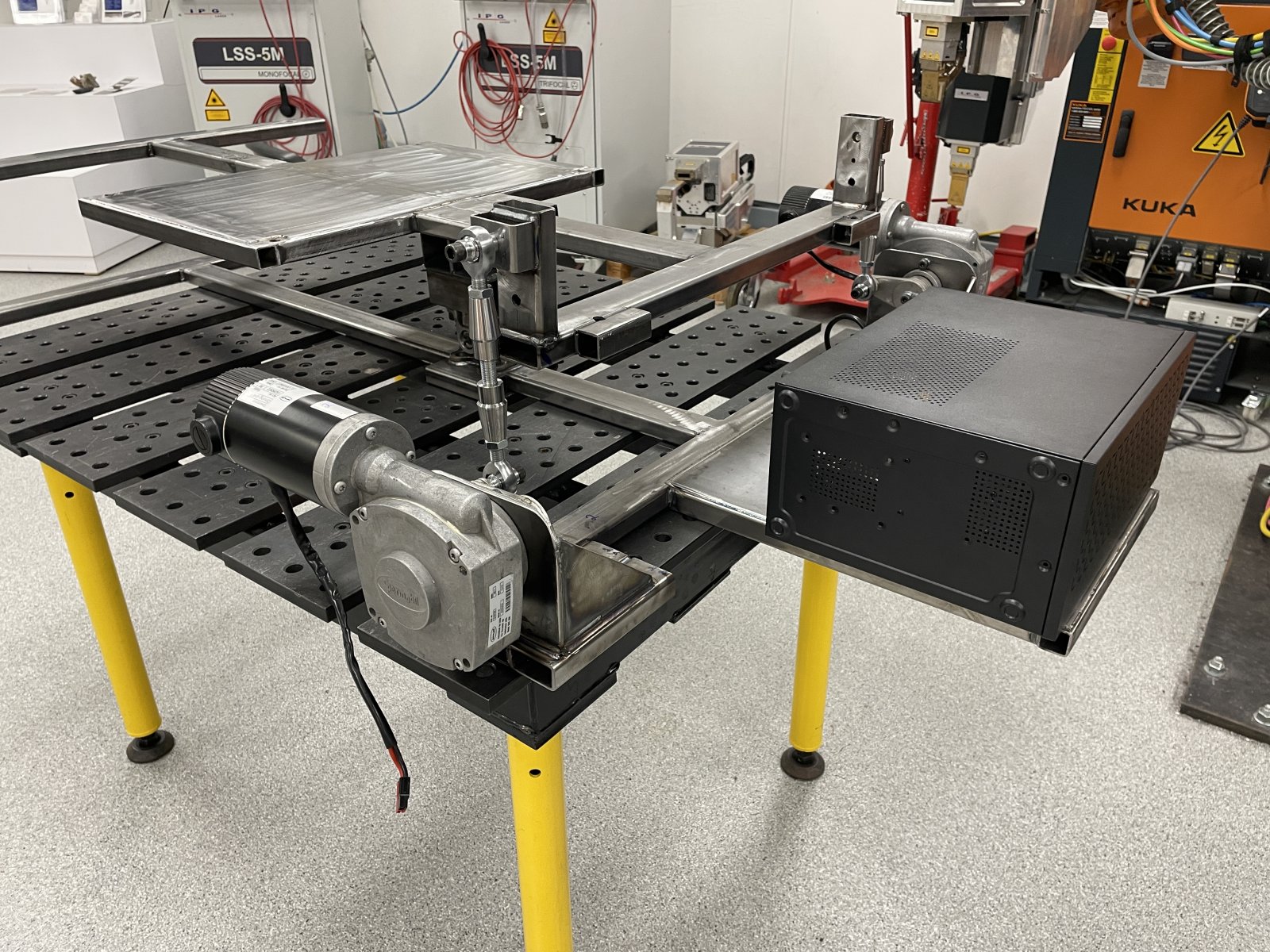

    Motor mounting brackets completed.
    Still looking at options for a lever arm from the motor to the heim joints. Once that is finalized can set the position of the motor mounts for welding. Heim joints should be delivered later today.
  7. Garrett
    Garrett Member
    Mar 14, 2026
    56
    327Coins
    +31 / 0 / -0
    Will be mounting the motors this week. Had to make custom lever arms and spacers for the wheelchair motor shafts.
    Once the motors are mounted will make brackets for the Hall sensors. They are 360 degree, didn't see any 180's on Amazon when ordering. Will keep an eye out for 180 degree as I understand they have better resolution.

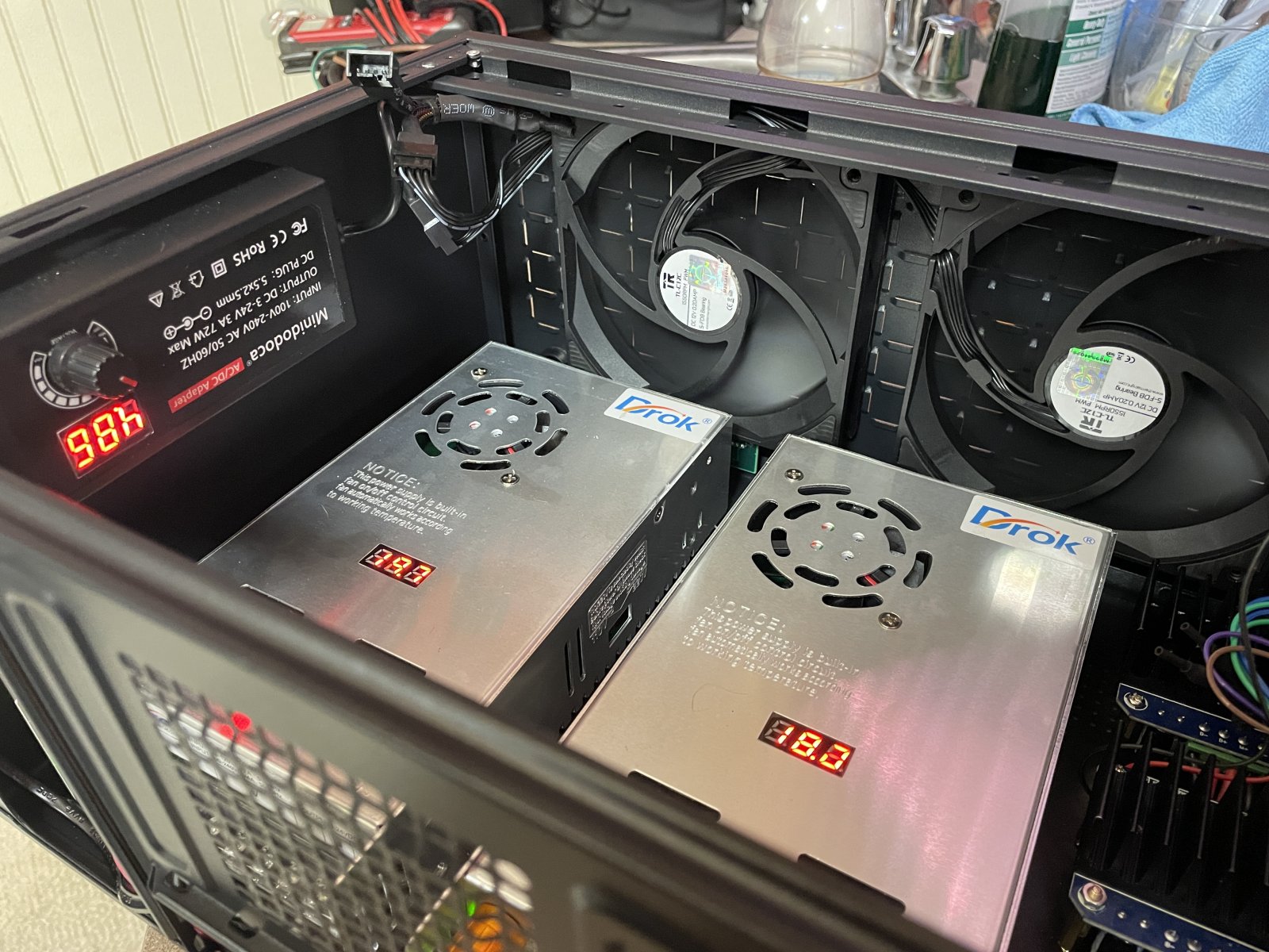

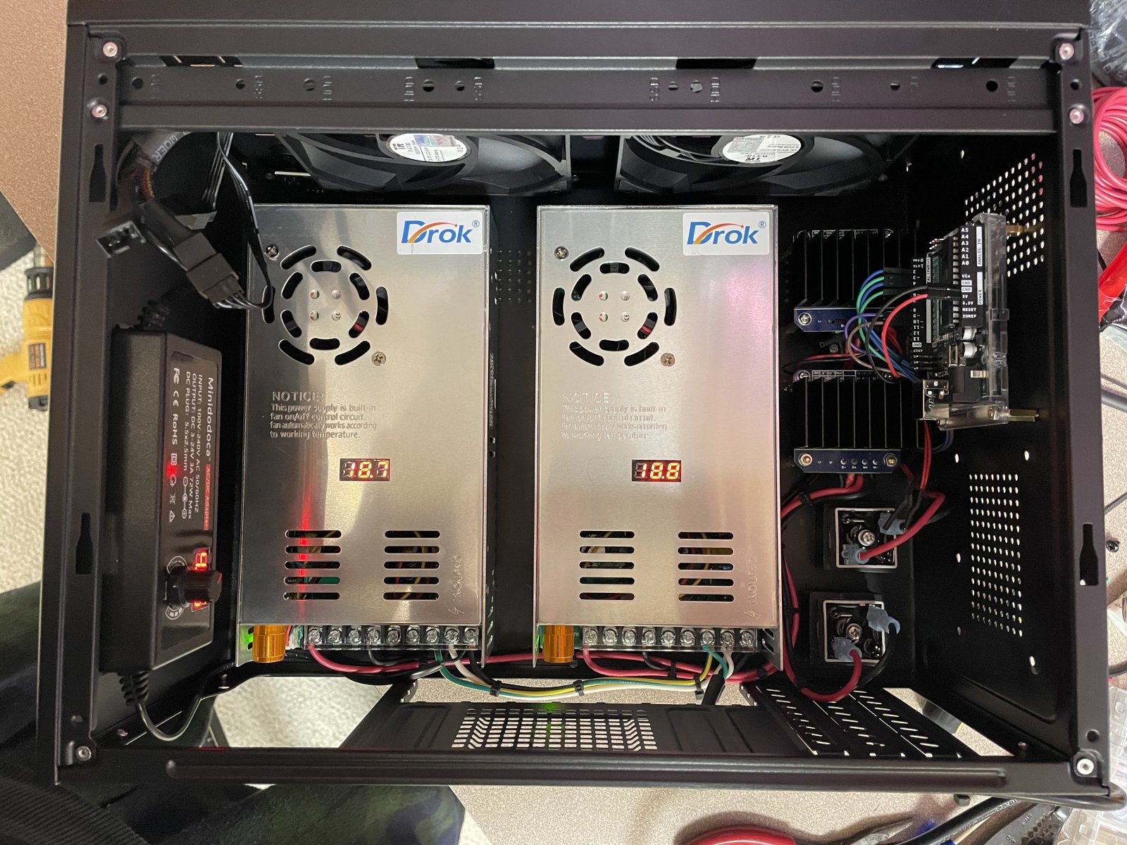

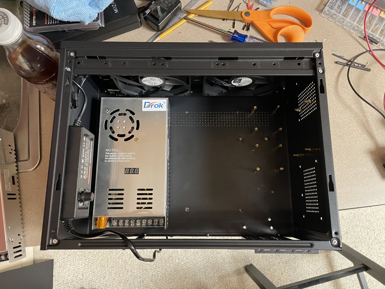

    Control box is just about complete, used a mini-pc case and added a couple fans to keep things cool. That's what the small power supply mounted on the side is for.

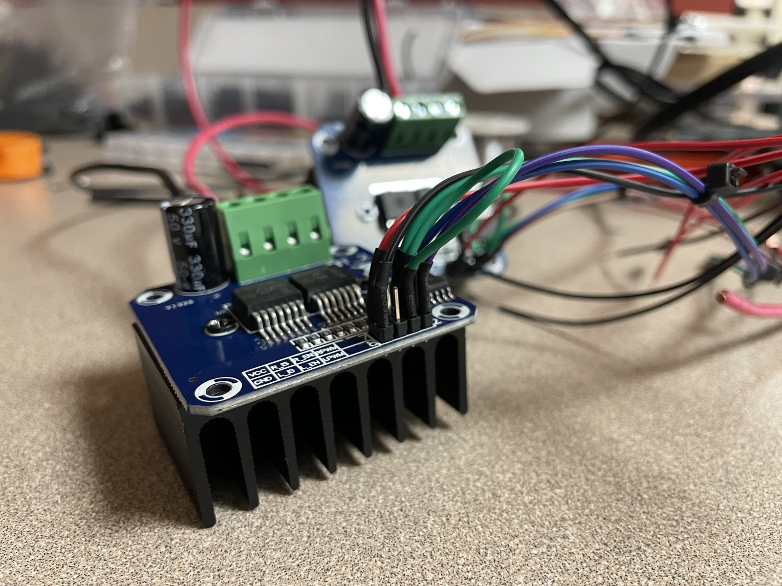

    The usual with an Arduino3, IBT-2's, 500 watts 20 amp adjustable power supplies and bridge rectifiers. Thermal paste used on all heat sinks.
    This Arduino wasn't marked like the examples on the FAQ thread. The feedback from the position switches are labeled differently but assume the pin location should be the same on the Arduino3?

    Finalizing the motor position and Heim joint connections then will weld the motor brackets in place.
    After that, will make the Hall effect switch brackets.
    Current lever arms are on the short side due to lack of CAD skills and being the first build, learning curve. Current range of motion is 10 degrees in pitch and roll. Will see how it reacts with current lever arms but may make another set about an inch longer if needed.
    If you see any glaring issues in the build please feel free to comment.

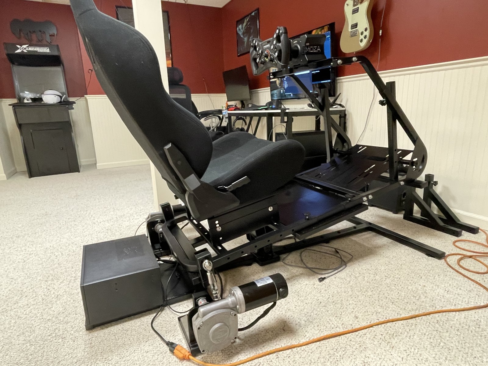

  10. Garrett
    Garrett Member
    Mar 14, 2026
    56
    327Coins
    +31 / 0 / -0

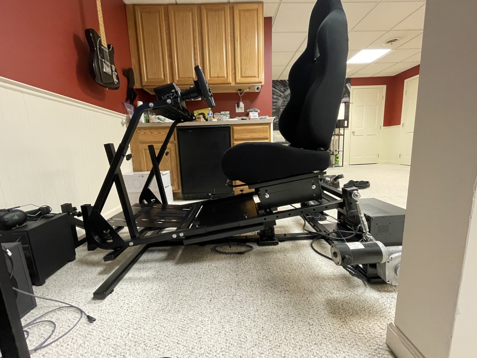

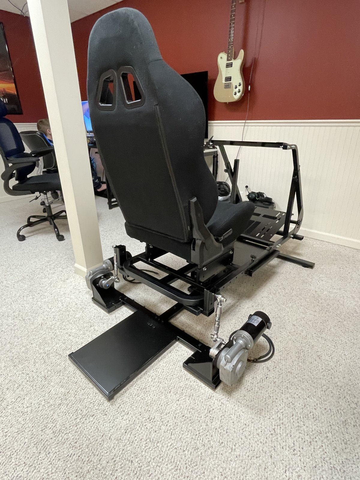

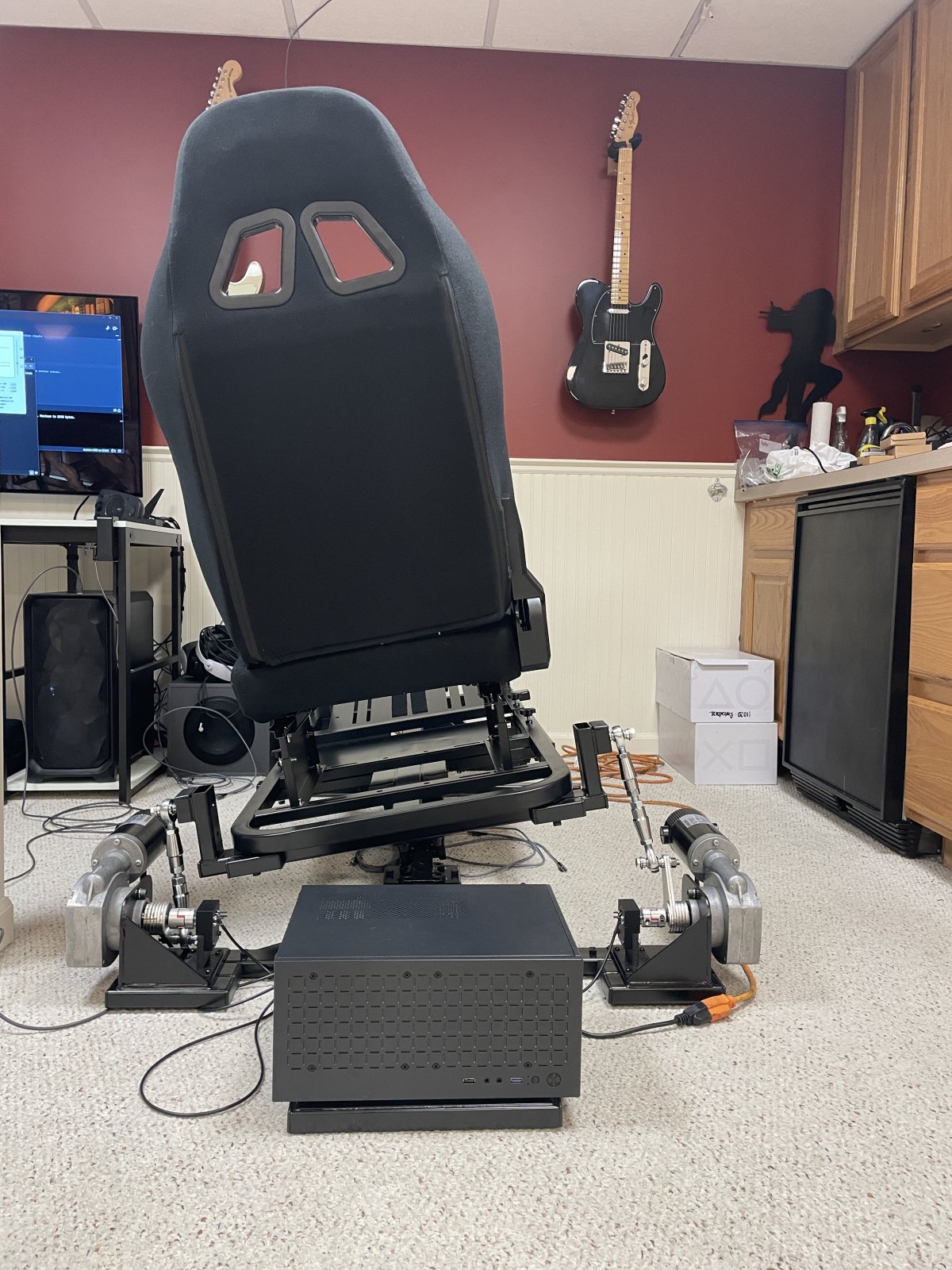

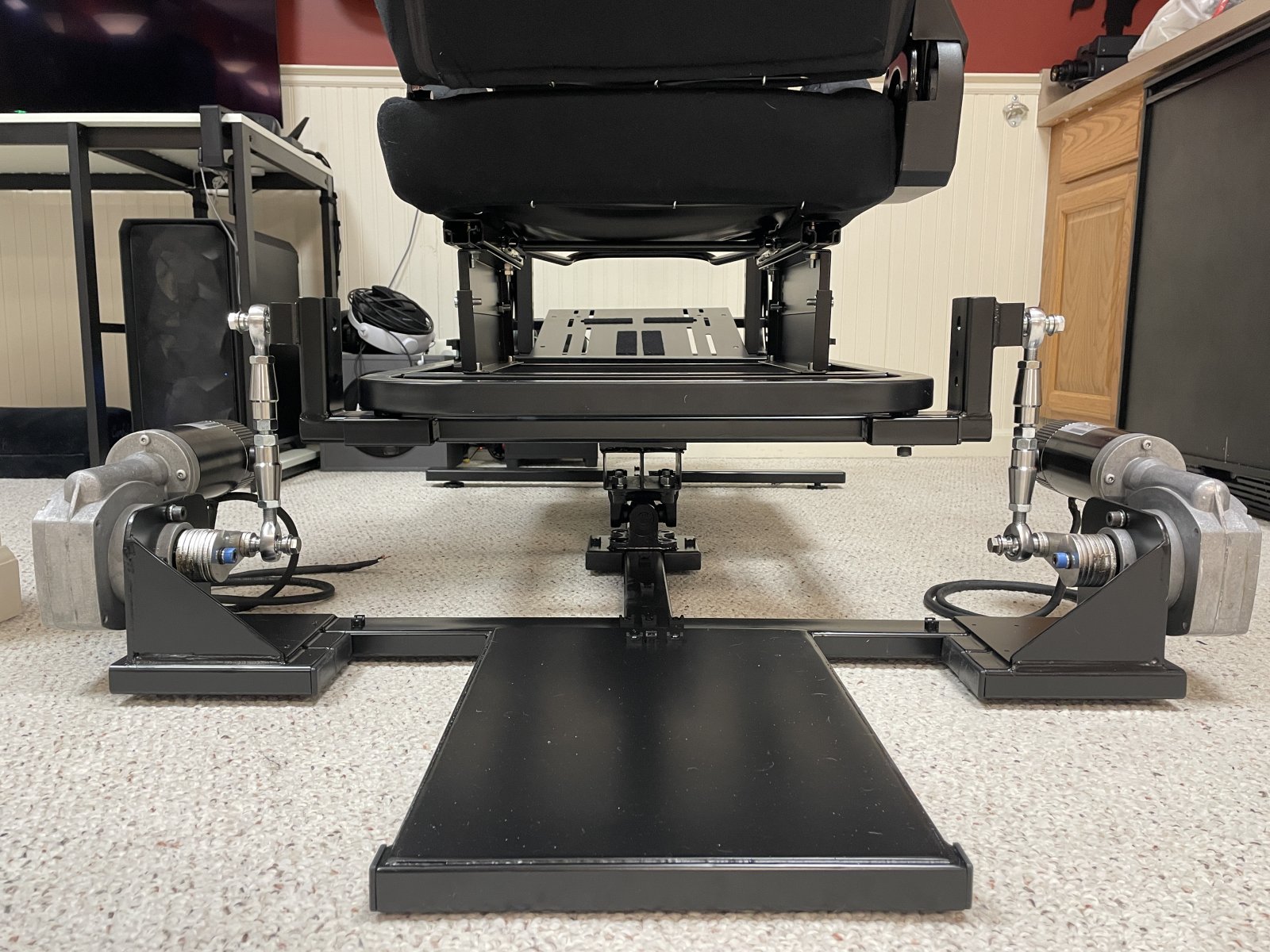

    Has 10 degrees of travel in pitch and roll.
    Next up are the Hall sensor brackets and installation. Then time to power on and tune it.
    The spacers and lever arm are cut from stainless and have a key slot.
    The plate on top is for getting in and out of the rig, don't want to lose any toes.
    The control box sits on the back of the rig.
    Bolts on the Heim connectors will be changed to stainless steel, didn't have any on hand today.
    Still have a lot of little holes to drill for cable management zip tie points before paint.

    This sim is for both flying and driving and also has surround sound speakers mounted at the front.

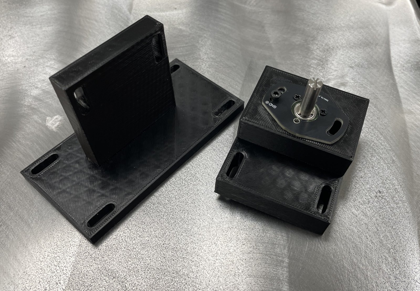

    3D printed mounts for the Hall effects. Couplers arrive Thursday evening.

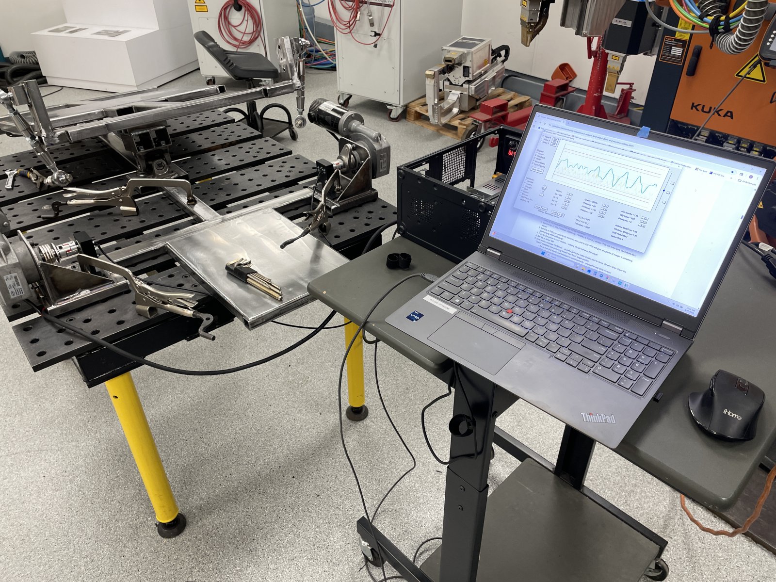

    Initial power up and motors tuned with the SMC2 utility.
    Will have to tune the motors again once everything is assembled and weight is applied.

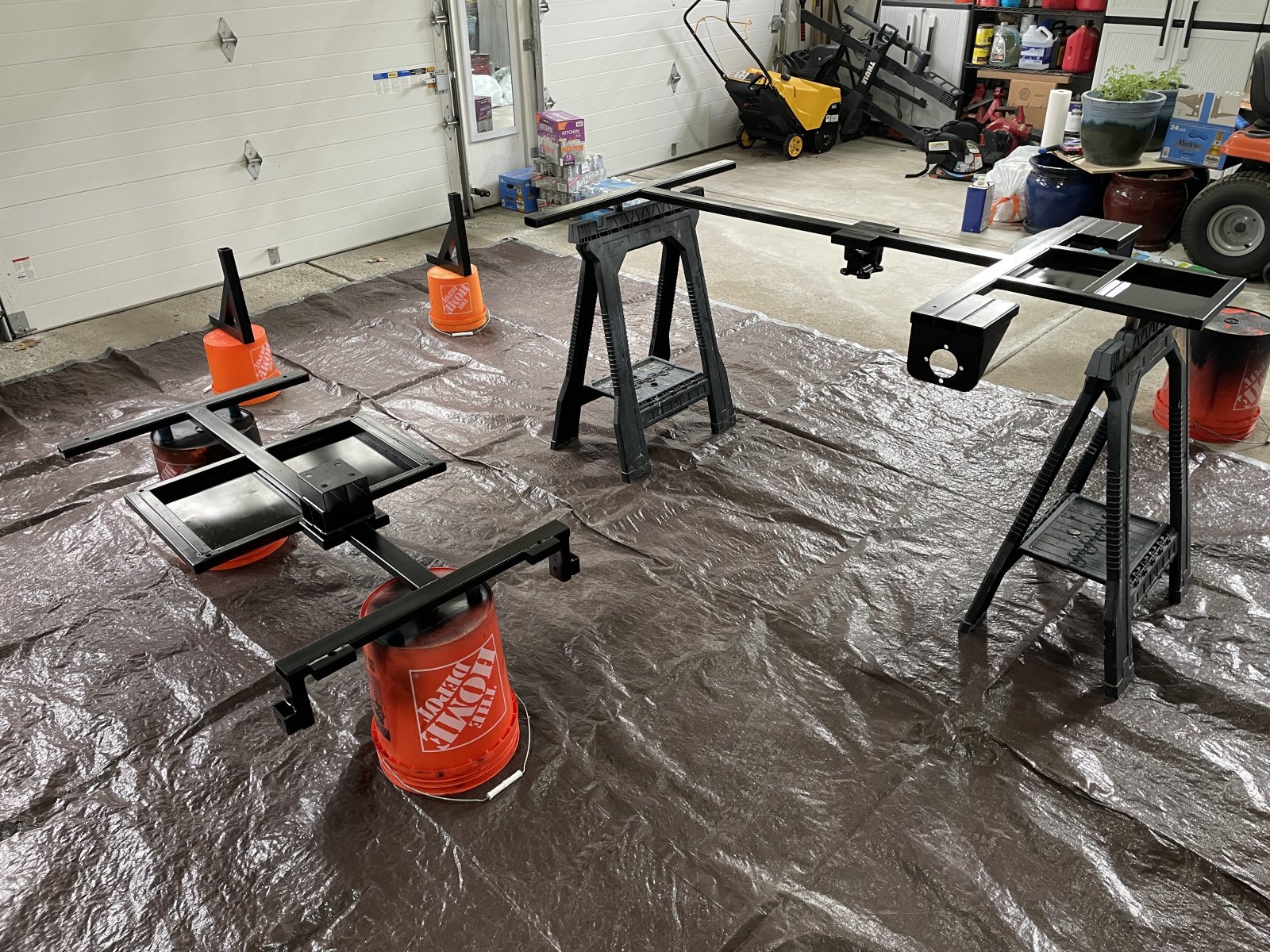

    Tore it down to drill and tap holes for the cable management and a coat of paint.

    Just one of the many minor mistakes I've made on the first build and not doing enough research prior to jumping in. You know, like so many others....
    But even so it's up and running with all the gear on the rig and me in the seat, SCM utility test had no issue moving the rig with me in the seat! With the power supplies set to 18 volts the motors did not struggle at all. If anything I need to tune it for a little softer of a ride, can be a tad jarring as experienced in the Square Wave test.
    Have to finish the cable routing and then on to SimTools.
    Still pinching myself...not sure what the hell I've gone and done but really looking forward to taking this thing for a ride!

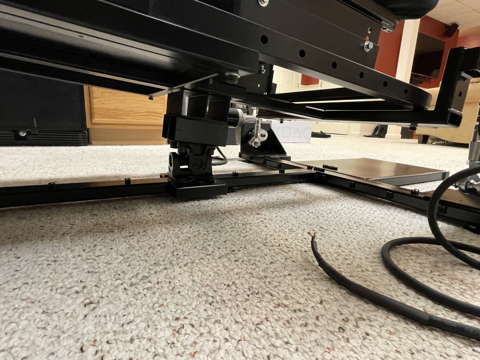

    Moving on to securing the cabling.
    In the end, solid 10 degrees in pitch and roll directions.
