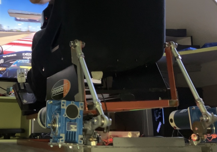

    Hi, 2dof with 2 motors 120w, a bridge VNH2SP30 with fan, an arduino, simtools v3, a dash screen, simhub.
    A big steel ball, potentiometers multiplied with gear wheel.

    Working well with f1 23 on ps5, and EA WRC on pc!

    Nice work :thumbs
    Where did you get the motors from, as members are always looking for potential sources?

    AliExpress... 120€ plus 60€ shipping for one...
    Only a little mistake, there is a little gap ( between terminal teeth) when the seat goes suddenly in other side right left or left right, but it's really acceptable.

    Do you mean the rig can laterally rotate? If so that could be controlled with a panhard rod between the bottom and top frame.

    No, there is a little gap in the axle of the motor when the axle change direction of rotation, due to the gap of the final teeths inside the reductor.

    Yes! It's true, I'll put my seat on ajustable slide, and tried to put the weight more to the front. ( excuse me for mistakes in my English !)

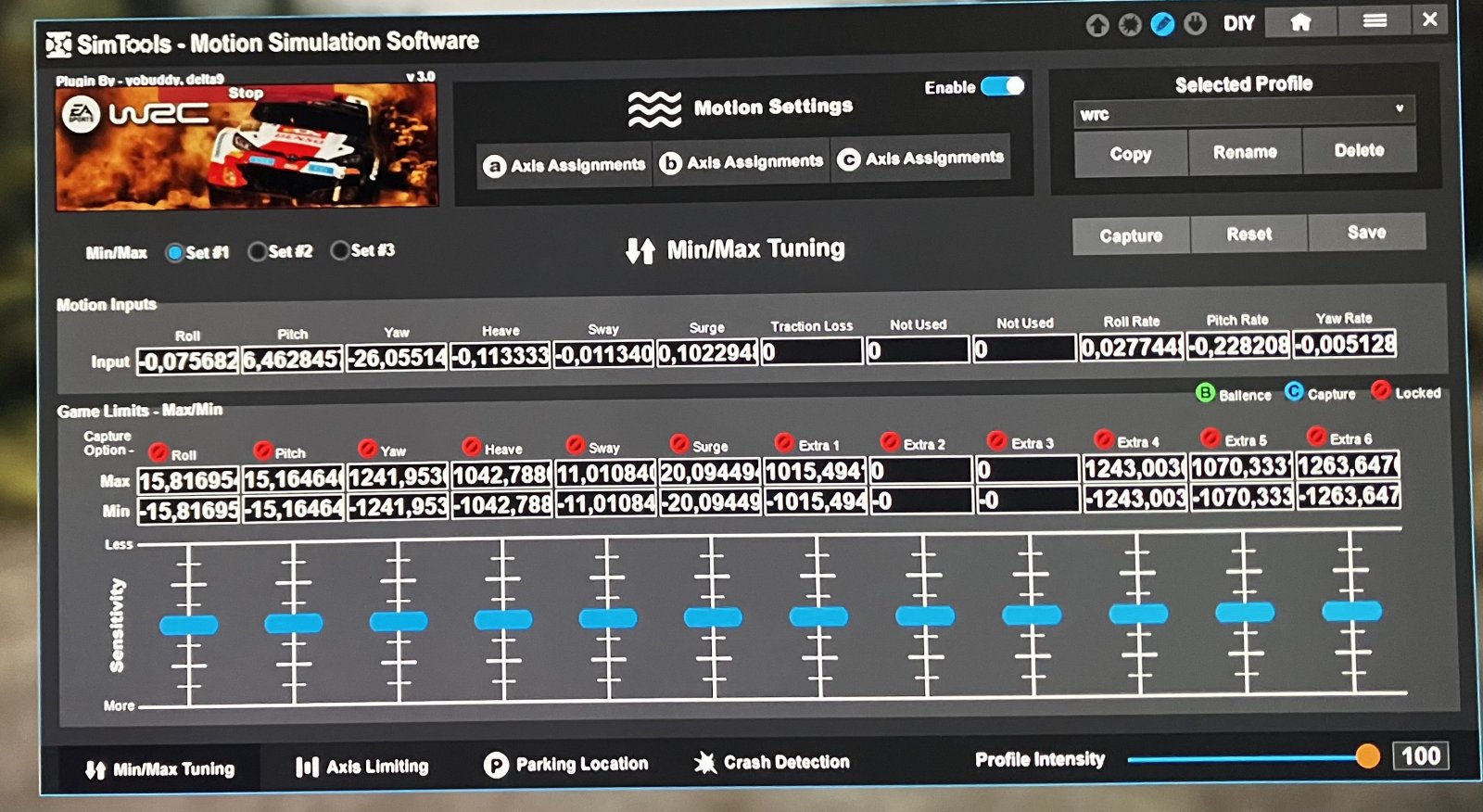

    good evening, I am very interested in your project, can you give me the minimum and maximum values of your settings for F1 23 on PS5 (in the tuning center)
    and also the % values in axis assignment?
    I tried to capture the values in play on F1 23 and I have the impression that the amplitude of movements are not very significant...

    First thing, be carrefull you are in different Set ( 1&2) in your setup, put the same.
    I modified the min max tunning .
    For me you have to more axis level, stay in green, and adjust with profile intensity.

    But all depends of speed of yours actuators, angle of your movement..

    Sorry, I posted EAwrc for tunning, for f1, It's an old pic, I take a new this afternoon, don't remember if it's the last.

    thank you for responding to my message, in fact the "set" does not correspond to the right profile (I did not send the right photo...)
    on the other hand what is strange, I did some tests with LFS and I really have the right movements which are perfectly reproduced.
    I really don't have the same feeling with F1 23 on PS5 (no real movement on acceleration or braking, the connecting rods move a few millimeters!
    I'm waiting for your parameters so I can compare.
