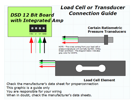

    Do you have a wiring diagram for your load cell setup? You may want to put a capacitor on the input power rails to the load cell amplifier.
    If the load cell amp already has this it may be signs of a failing power supply. DC should not have any noise whatsoever.

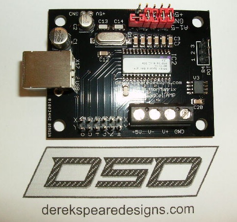

    Very weird: when I disconnect the PUs from the 24V wire (the PSUs are close to the rig) and if I power on the PSUs only, the signal of the cell is jerking. If I power off the PSUs, the signal fails down until zero for one second then comes back to standard. If you want I make a video for better understanding.
    The controller:
    The wiring of the load cell:
    The load cell:

    Looks like the controller already has the required capacitors. So the 24v supply is in no way connected to the pedals? Is the controller powered by the USB? You could try a ferrite core on both ends of the USB cable but without knowing the frequency of the noise they may do nothing at all. Could possibly be voltage dropout across the USB cable. Problem sounds really weird. Either way there should be a path for the noise to couple with the pedal. is any part of the 24v system near the pedals?
