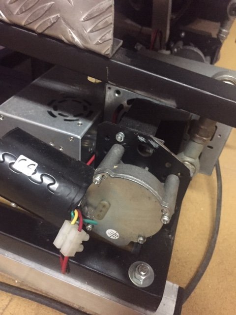

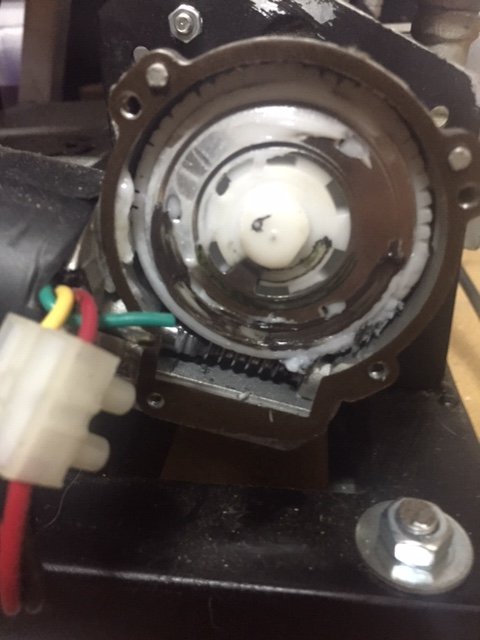

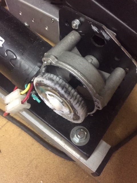

    I have the simulator working properly, but my wiper motors have worn out fiber gears.
    What new engines do you recommend? ?

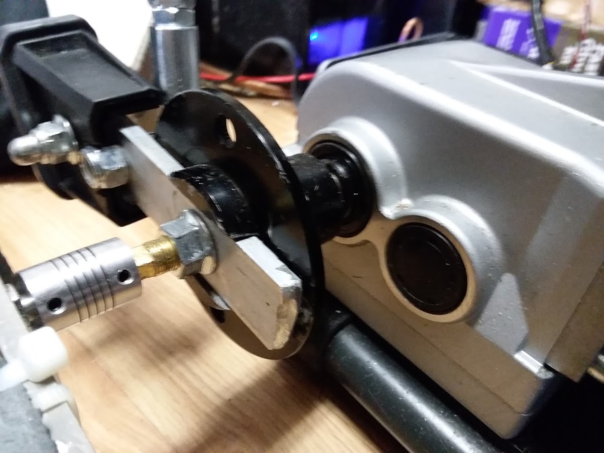

  14. T R Para
    T R Para i make stuff up
    Oct 18, 2018
    385
    Cincinnati, Oh
    2,439Coins
    +357 / 2 / -0
    AC motor, 6DOF
    If he has the keyed wheel hubs that fit on the output shafts get them also. I used the hubs to attach my output levers..

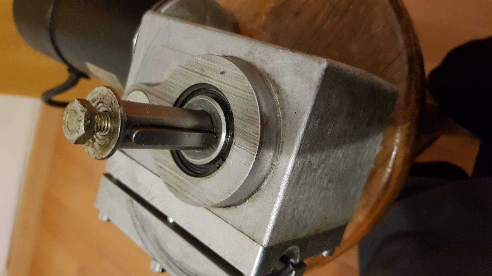

  16. grec pastor
    grec pastor Member
    Nov 14, 2018
    38
    Spain
    453Coins
    +25 / 0 / -0

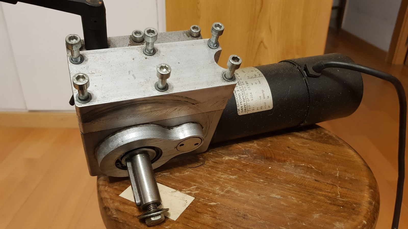

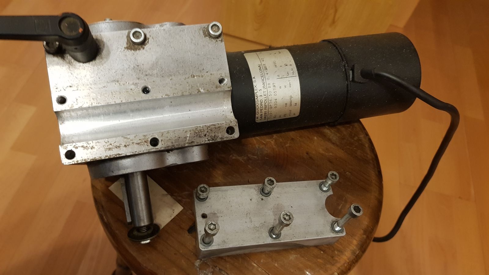

    Good morning, guys.
    They have sent me pictures of the engines.
    The anchor is like that, how have you put the pulleys? Do you have any pictures?
    Thank you.

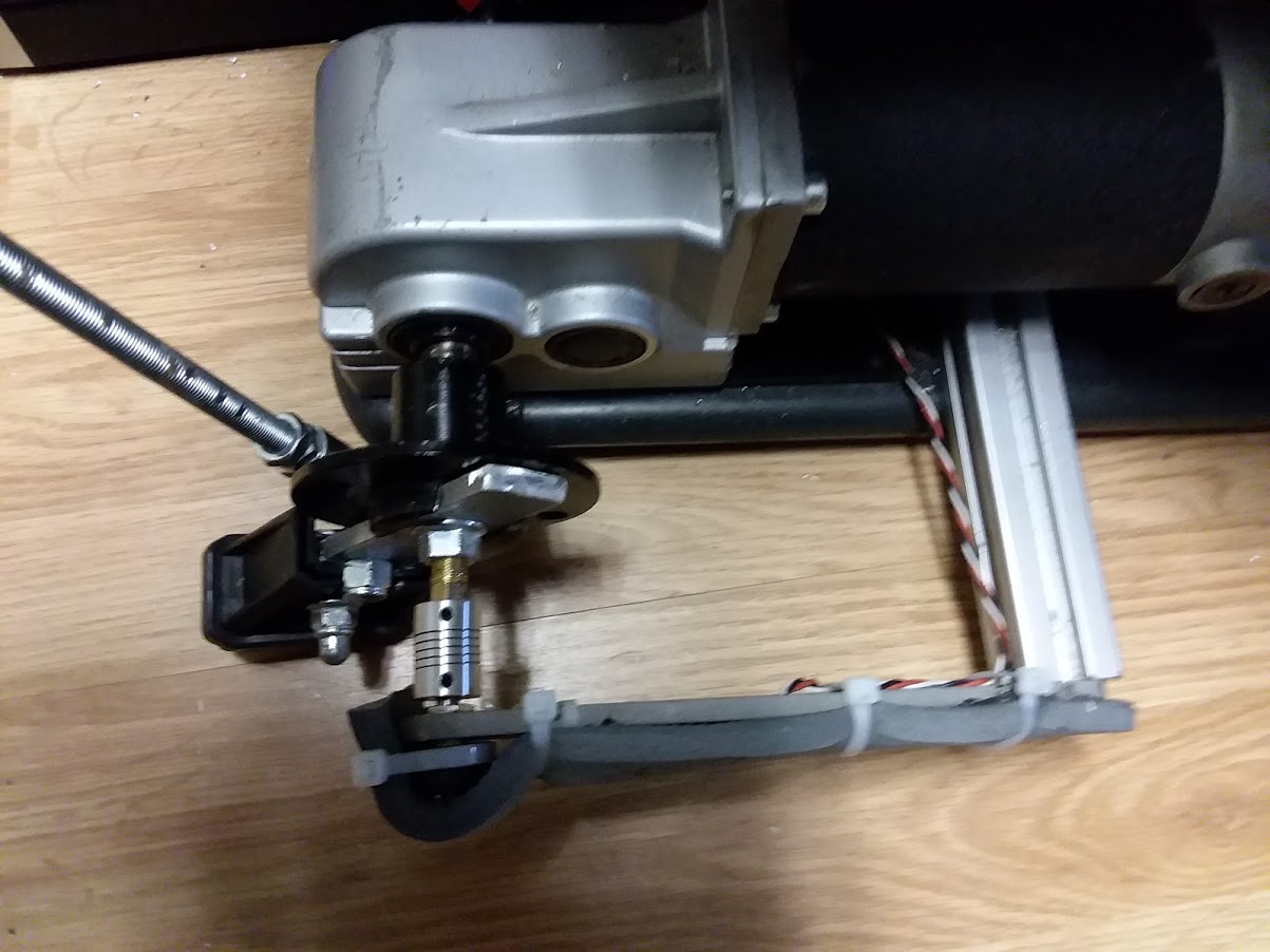

  17. T R Para
    Oct 18, 2018
    385
    Cincinnati, Oh
    2,439Coins
    +357 / 2 / -0
    AC motor, 6DOF

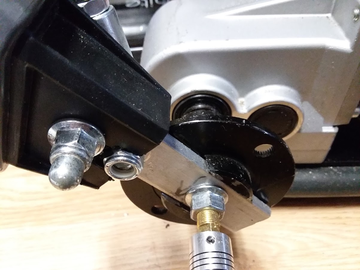

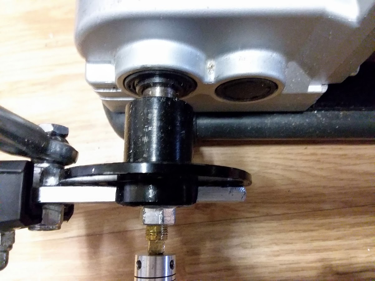

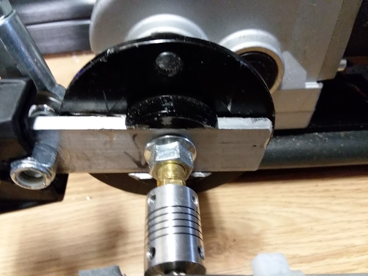

    Here are some pictures. The black hub has a large slot cut into it to allow the aluminum lever to fit in to it. The flexible coupler attaches the HAL Effect pot to the output shaft. An aluminum bar supports the pot and attaches to the T-Slot extruded aluminum which is then mounted to the chairs base. The aluminum bar is covered with a high density foam protective cover. There is a large rubber foot that attaches to the end of the output lever. It acts as a stop and helps prevent over rotation. 20181204_111642.jpg 20181204_111926.jpg 20181204_111935.jpg 20181204_112000.jpg 20181204_112023.jpg
  18. grec pastor
    grec pastor Member
    Nov 14, 2018
    38
    Spain
    453Coins
    +25 / 0 / -0
    thank you, I already have the engines at home, I bought some pieces of steel to make the anchors and adapt my potentiometers hall, I will put pictures of the process, both here and in my construction thread of the simulator.
    My new engines have 4 connections, +, - and two neutral, which I think are good for braking, but I have to finish looking at it well.
