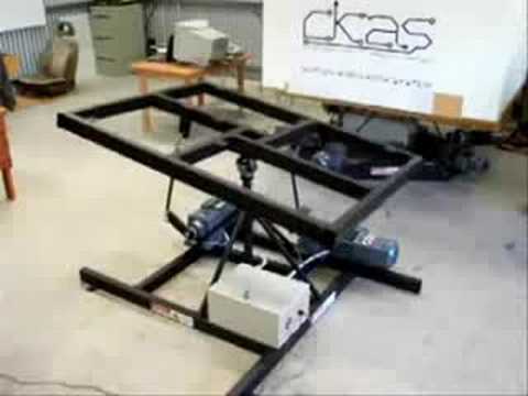

    Hello I have a question about these 2 motors.
    They are from an electric wheelchair.
    It says on the label that it will draw 9 amps, but what would be the estimated current when reversed.
    and would these be good enough for a 2dof platform.
    thanks in advance.

    no the question was meant to determine the estimated amps these motors will draw in a 2dof simulator.
    the reason is that my power supply is 24v 25a.
    about being used for a 2dof well a joyrider simulator will be easy because of the fact these motors are a lot stronger than wiper motors.
    frex style is not really my interest.
    or platform
    which i think are a bit to much for these motors, that's why I am asking.

    The easiest way to figure out the stall current is to measure the resistance between the (+) and (-) wires of the motor.
    You should measure a low resistance. Ohms law: Current = Voltage / Resistance.
    If you measure 10 ohms and you use 24V, your current will be 2.4A for each motor.
    A rough estimate from the specs 24V/120W, the current is 120/24 = 5A, but who knows how they determined the 120W power.
    Don't forget, this is only for STALL current. If the motor is rotating one way, then suddenly reversed, the current spike could be much higher than the stall current depending on the speed and load on the motor. A properly designed DC motor driver can eliminate reverse current spikes by braking the motor before reversing it.
