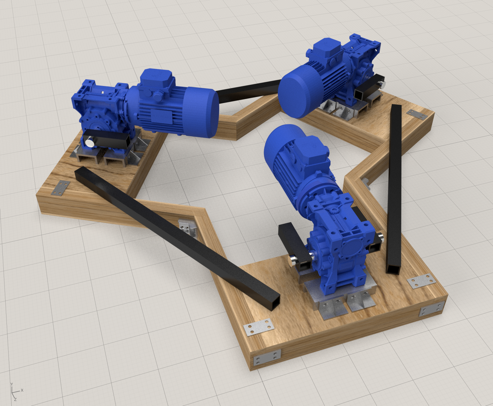

    I'm building a 3DOF (Pitch, Roll, Heave) motion simulator, built to be used as a Flight Simulator (only) with Prepar3D flying commercial airplanes - which is a notably different use that combat flight sims like DCS.
    The motors that I'm thinking about using are 3-phase AC motors, 1HP 1500RPM, 230V and 50Hz:
    These ones in particular
    I will be using 3 motors in a 120 degrees triangle layout, very similar to this project.
    Here's the gearboxes I had in mind (30:1 ratio).
    Here's a render of my first draft of the base:
    Note: This render will be updated tomorrow or later this week with more precision and more elements added.

    I've been reading through multiple threats here on the forum for literally dozens of hours and I think I kind of figured out the different elements that needed to be bought and installed, but not to a point that I feel confident enough to move on- at all ;) Also as I'm going the AC route, I can't follow the same wiring system as @momoclic 's guide I referred to earlier who is using DC motors.
    What I need for the moment is guidance on wiring everything up.
    I have found wiring diagrams across the forum but they were all including elements that most of you guys assumed everyone knew, that left me perplex. Is there
    I'm assuming what I have to buy is:
    1x VFD
    2x Arduino Uno
    1x Emergency stop button
    1) Is that it for electrical/control hardware? Any specific recommendations?
    2) Do you think the motors I chose are a good choice in terms of heat produced/inverter duty?
    3) Anything else that you think I didn't think about?
    I have more questions to come but I'll start with that!

  7. Gadget999
    1,886
    11,543Coins
    +453 / 9 / -0
    some of the 6dof using vfd have had very poor response and are slow to respond
    make sure you do your research and use the right type of motor / vfd
  8. Blekkulf
    Blekkulf Member
    May 18, 2018
    69
    Molde
    354Coins
    +13 / 0 / -0
    2DOF, AC motor, Arduino, Joyrider, 6DOF
