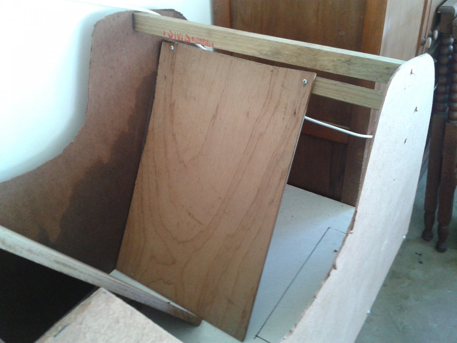

    Unfortunately, I had already designed and built a frame before I found this forum. I plan to build a racing simulator, which moves the entire frame. However, I cannot decide whether to make it 2 DOF or 3 DOF. If I build a 2 DOF simulator, I shall probably try to make it 3 DOF in the future. I am a complete beginner and know almost nothing about motion simulators, so I would like a fairly simple first project. I do however, know some people who can help me out. My main concern about adding 3 DOF later is that it will be much more difficult to achieve than if I did it at the beginning. I am using 12V wiper motors to move the simulator. The 3 DOF's would be pitch, roll and yaw with yaw being removed if it was two DOF. Any design advice would be much appreciated as this is a learning experience for me.

    Can you please post some pictures of your existing frame, just so we all know what you have so far.

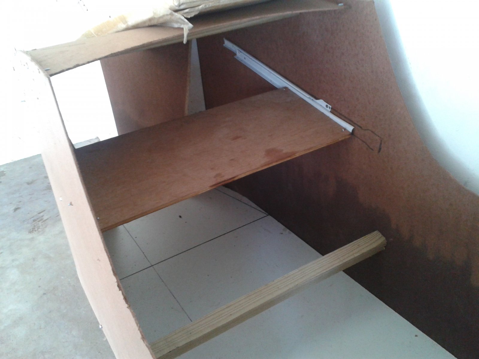

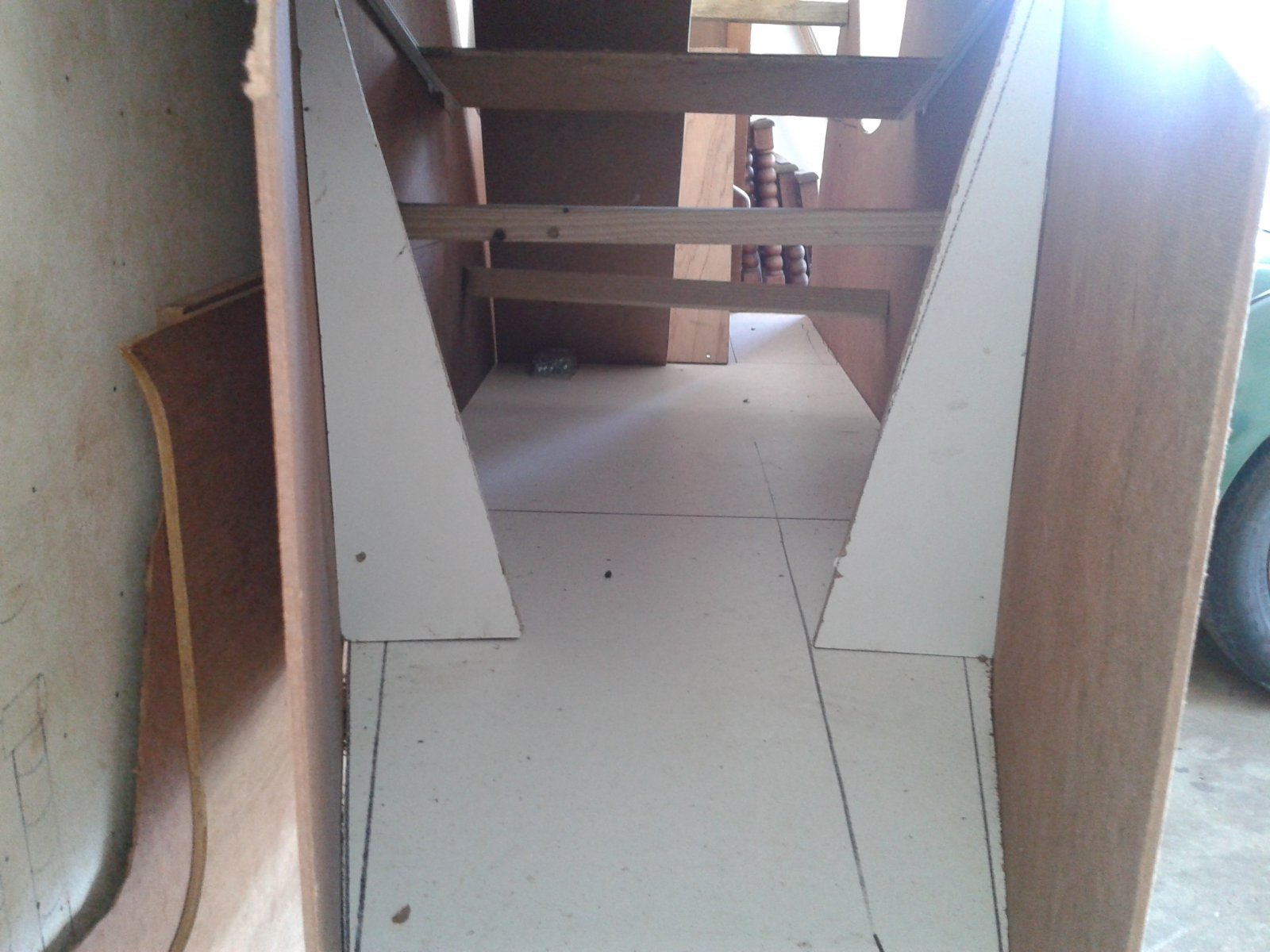

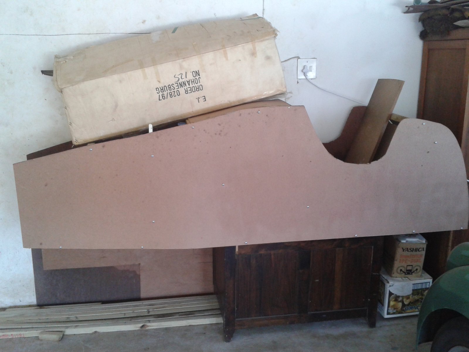

    Here are some pics of the frame. I know it's not perfect(hence, "Unfortunately" in my original post) but I have put many hours of work into it. It is almost entirely made of wood and so only weighs about the same as a 'light' metal frame. I am confident that with a u-joint or something similar in the correct place, that it will work. 20140905_144903.jpg 20140905_144919.jpg 20140905_144929.jpg 20140905_144853.jpg

    Hi monicamary, where there's a will there's a way as the folk saying goes. But - to be honest - your frame is potentially dangerous. Sharp edges, very thin wooden parts to withstand forces. I can see "outstanding" nails which can cause injury. This frame is not a result of a hard and detailed work, perhaps it is a result of your impatience? :)

    It may flex something fierce under motion though.

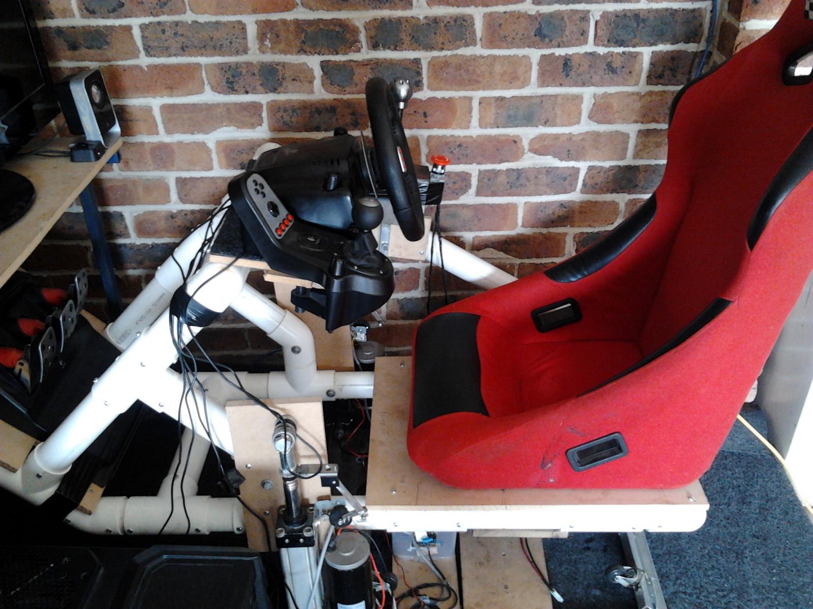

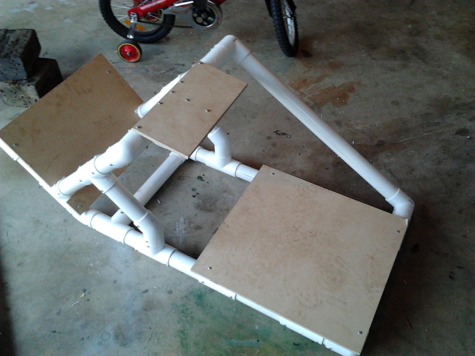

    If wood cutting is an issue, maybe a PVC frame would be better, with wooden sheets , thin to cover it. I used 16mm MDF for under seat, unit mounting, wheel and pedal holders. It weighed a heck of a lot less than the previous steel frame.
    that way you have strength and light weight frame.
    It may cost a bit more than steel, but its sturdy, easy to put together.

    Thank you for your thoughts and opinions. The frame is not yet completed as I have not had the time to work on it recently. As it is currently, it is fairly rigid. The base is solid and provides(along with the cross-braces) some strength. With the addition of a few extra panels to provide more rigidity, I am confident that there shall be little flex. Soon I will smooth over rough edges(literally and metaphorically) and do a bit more detail work. I shall keep in mind your advice when doing this. I am continuing with this frame because I have spent many hours working on it and do not want to start again. I am sure that I will be able to make it work safely. Thanks again for your input. It was very helpful.
