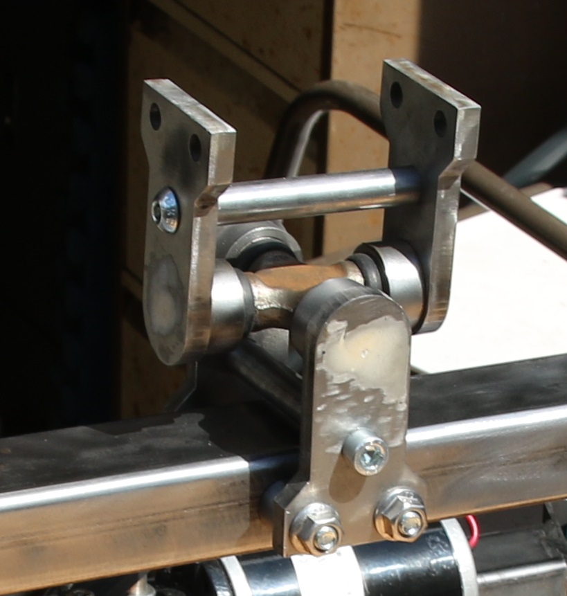

    i am getting there with my design. 2 motor as in title. i have a question about the centre universal joint. i was going to use a car or truck one but from reading others designs it seems that they only have about 18 degrees of movement. this would be fine for cars but to be realistic wih aircraft you need at least 30 degrees for a airliner or GA aircraft. even more for military fighters and helicoptors. how have people got around this apart from going for 6 dof. there are industrial joints that would work but they are very expensive.

    Hi Bob
    I designed a UJ Joint, and had some brackets manufactured by a company called Lasermaster in Redruth, the assembly uses a Land rover UJ Joint.
    This alows me to have 45. deg of movement on my sim in both pitch & roll.

    hi david, thanks lasermaster are just up the road from me. i used them to make a couple of rotors for my windturbine. good people. do you have the drawings? if not i can get them to make some from your picture if they dont still have the files.

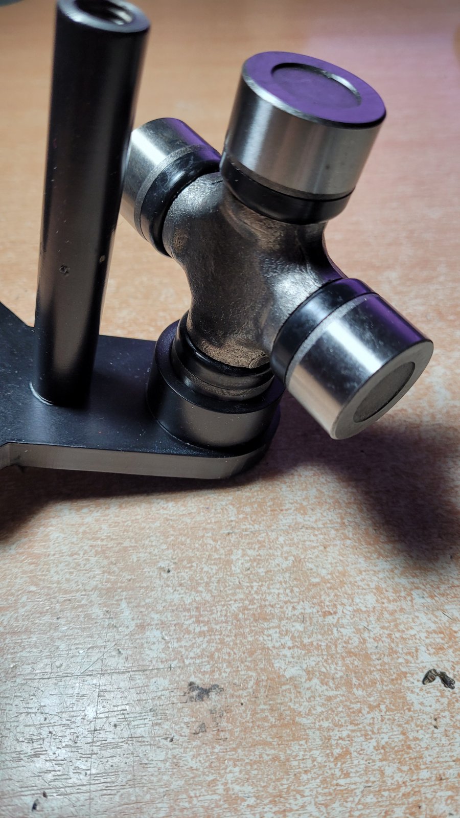

    hi david is the cross just clamped between the brackets or is it secured in some way. ? i have ordered a land rover defender 63mm one.

    The UJ is a Propshaft UJ Universal Joint 82mm x2 for Land Rover Series 2 3 - RTC3346.
    I am currently on base as I work at RAF Benson, I will give you more information when I get home tonight.
    David

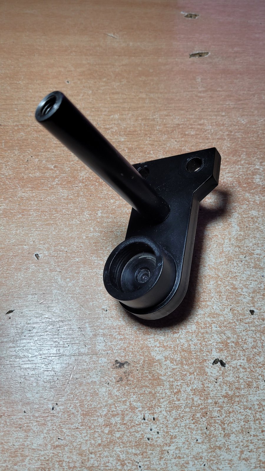

    I can give you the information for the UJ,
    The width of the bracket is 10.mm there is a bearing carrier for the Land Rover RTC3346 Universal Joint the dimensions are: eternal depth is 15.mm x 35.mm width, internal width 27.mm internal depth 11.mm / on the rear of the bearing carrier is a mounting lug the dimensions are 6.mm x 20.mm to go through the center of the UJ Bracket, and then welded together from the rear.
    There is a center spacer to join the two brackets together 90.mm x 15.mm with a 10.mm thread taped.
    My UJ was designed to fit on to a 50.mm x 25.mm steel beam with 4 spacers per side 22.mm x 14.5.mm with a 120.mm hex head bolt x 2.

    thanks david got all that. i have ordered a uj. i am still confused about how the bearing is secured to the bracket. it looks from the photo like it is just pushed up against the bracket. could you elaborate on the fixing please. normally it would go into the hole in the uj bracket so i am a puzzled about what stops it sliding about.

    Bob if you PM, i will give you s link to my Google server and I can upload all of the information you require
    what type of simulator are you going to build, with regards to my simularor I have based it on the DOF Reality design but with lots of modifications .
    David

    The bearing fits in to a bush that is welded to the bracket, and the two sides are held together by the center spacer.
    David
  16. bob golding
    bob golding Member Gold Contributor
    Feb 26, 2021
    45
    retired
    penzance
    410Coins
    thanks all clear now. i thought what i was seeing was the outside of the bearing.
