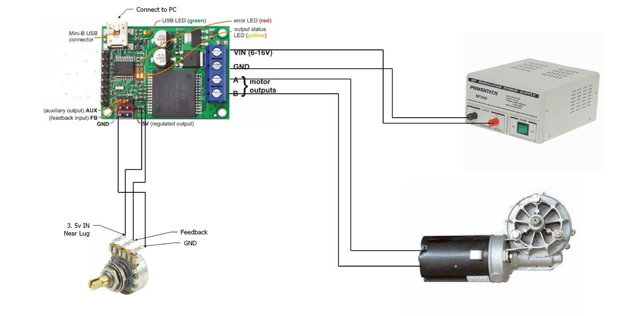

    I did find a thread or 2 with some wiring diagrams but want to be 100% before I bite the bullet.

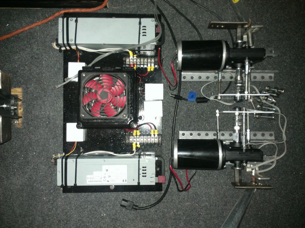

    My power supplies and jrk box

    I am just going through your thread now Jem, I have seen it before but this time absorbing as much info as I can!

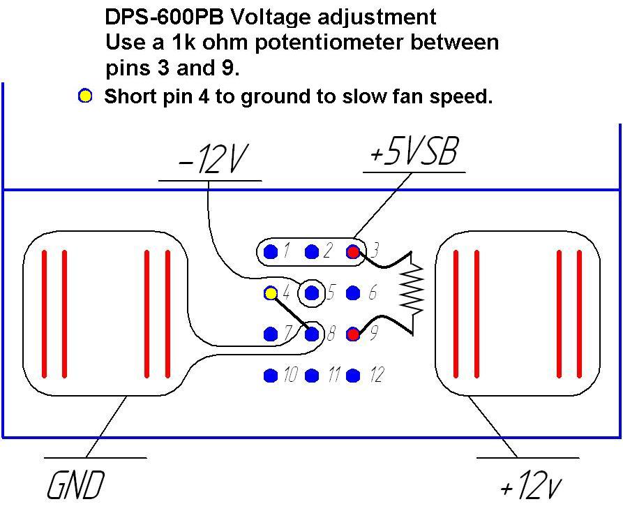

    Here is the ps pinout.
    You want to short pins 6, 8, 10
    Instead of shorting on the power supply, I ran the wires up to toggle switches by my wheel and make the short with the switches. Very convenient to turn on motor power from there.
    Nick has also used the same components on his. Check out his thread here. You can find all answers between the two threads.
    http://www.xsimulator.net/community/threads/2dof-diy-seat-mover.5271/
  13. bsft
    The JRK has a utility program with drivers that initially needs to be installed once you get the JRKS, but after that, its some simple PID numbers,motor power settings, set the feedback and you are off.
    No coding whatsoever , they just work and work well.
    @jem45472 has covered just about all here.
