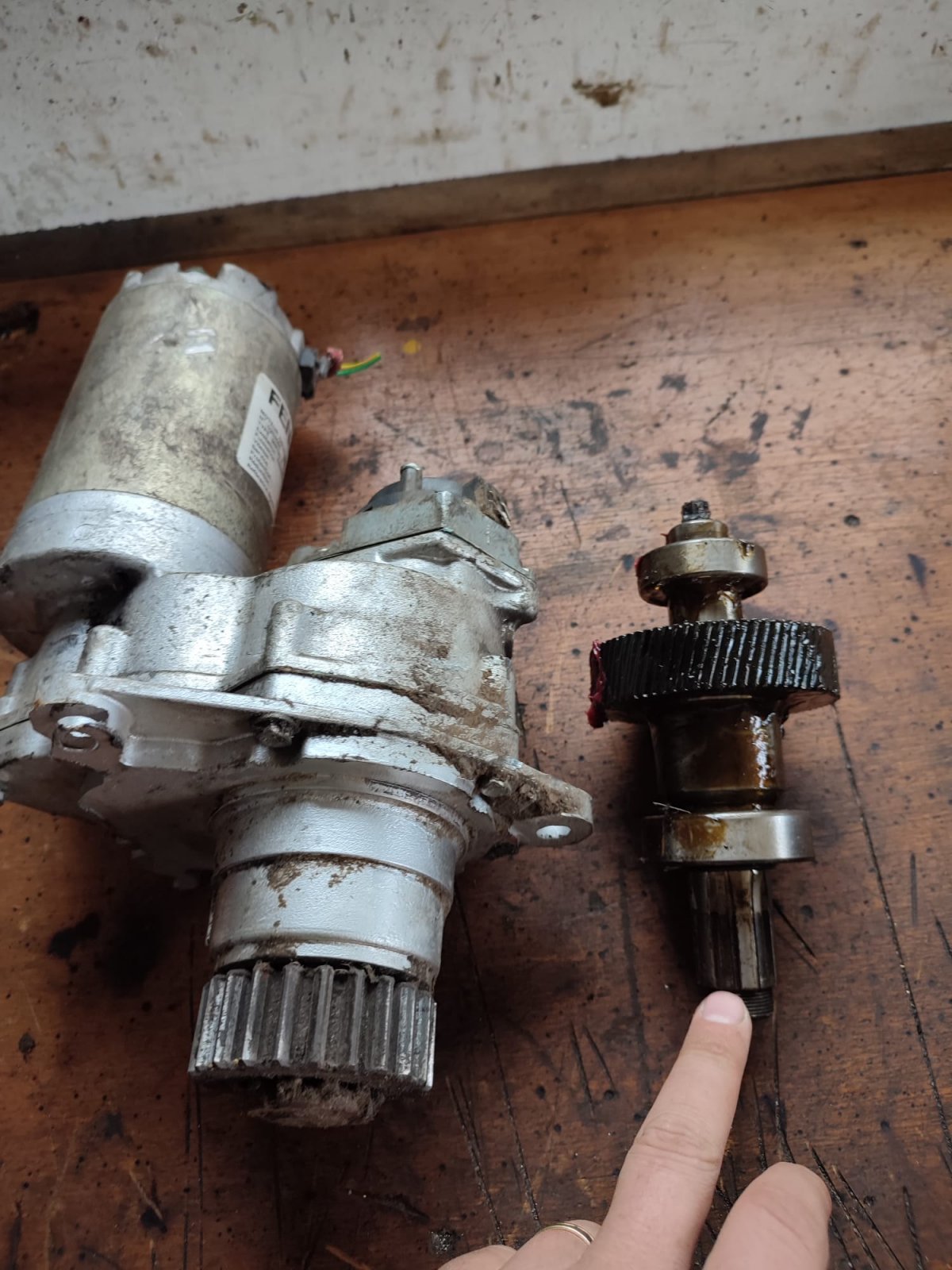

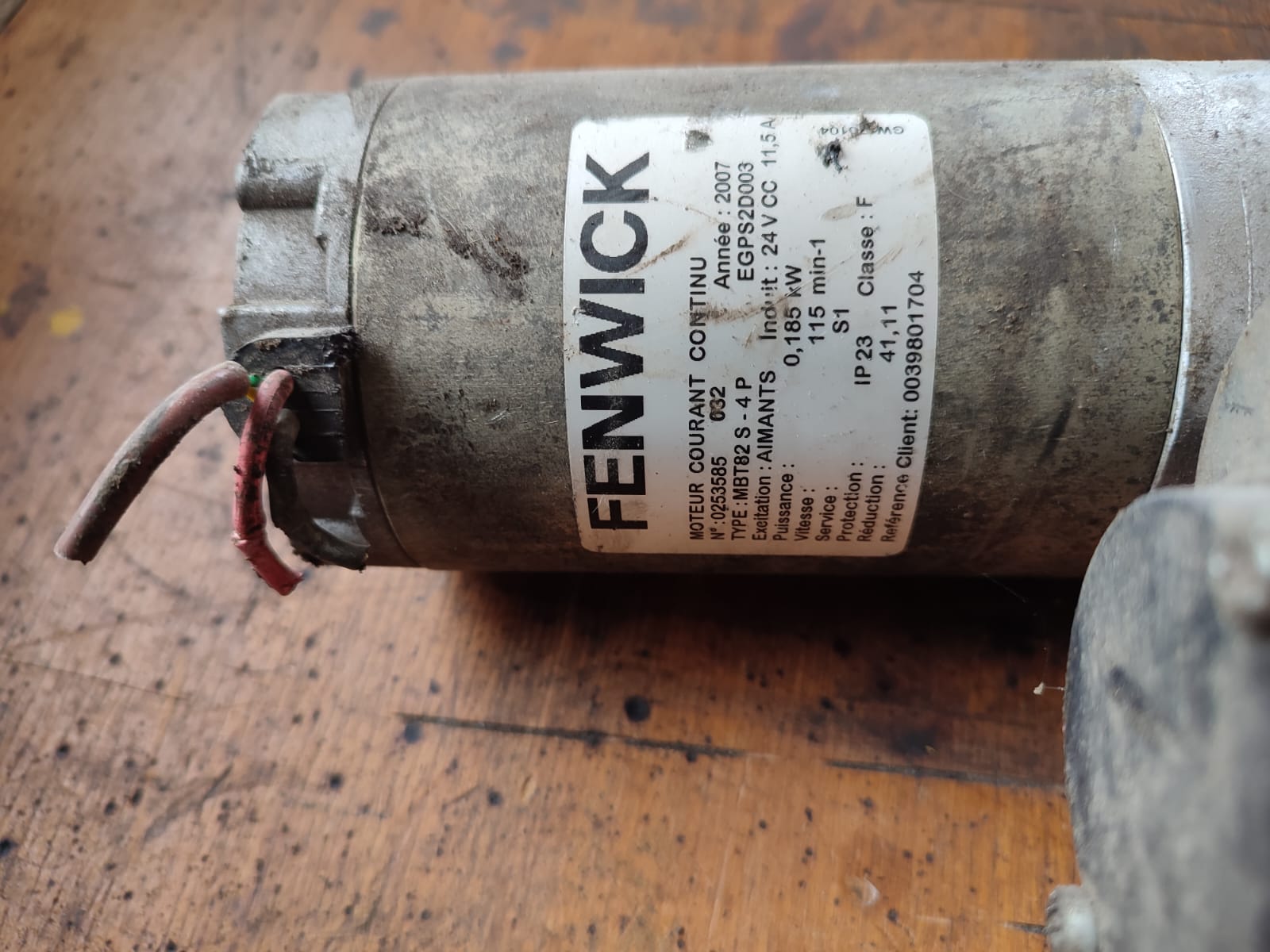

    I'm Alex from Romania, and starting from today I'm planning to build a 2 dof sim racing seat with traction loss. After watching some videos on youtube, I already have something in my mind, but I have to put my thoughts in a project helped by fusion 360 for all the measures and so. I was searching the internet for the parts I need, and I found locally at a decent price, 3 Second Hand fork lift motors for $120 all. Specs written on motors below. Also i have 5 VNH2sp30 drivers, but motors I plan to buy, are 24v at 11.5A, and VNH drivers can only 16V, 30A
    my question, can these motors help me build my motion simulator with 14v and 20A from PSU?
    motor specs: 3 x FENWICK - MBT82 S-4P / 24V DC / 11.5A
    PSU x3: 15A, 14V max OUTPUT
    attached pics

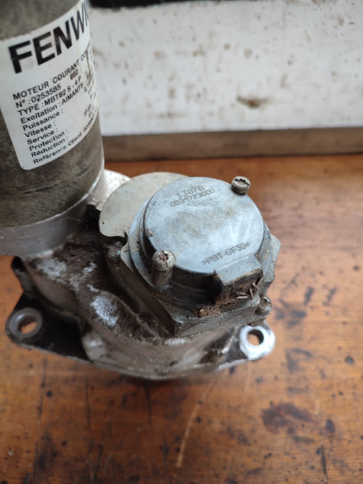

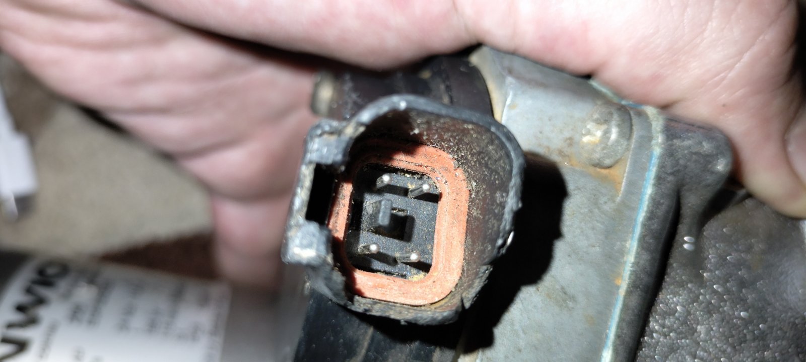

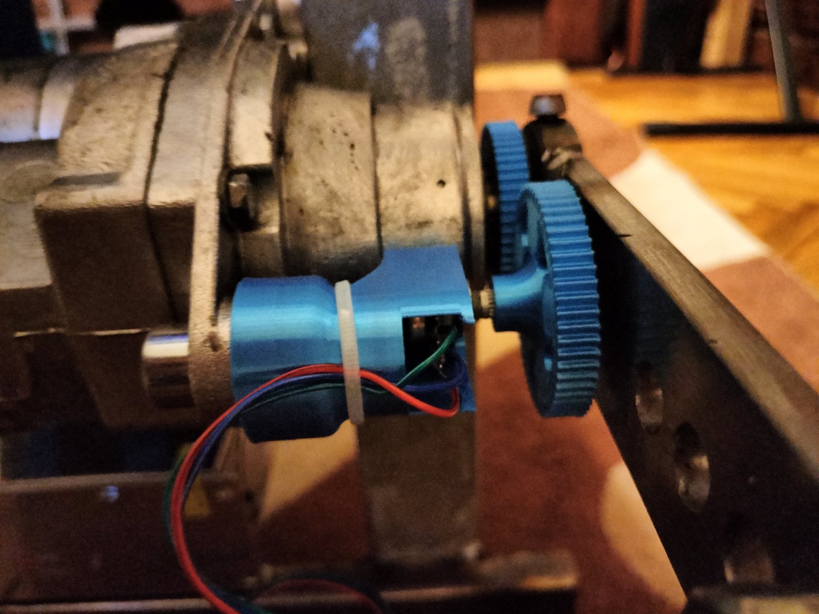

    hello. i bought 2 motors and are equipped with potentiometers. there are 4 pins in the plug on the potentiometer, but I can't find any info about wiring those things. Can someone give me a tip how I can read values from it?
    LE: potentiometer product code: Linde 0039723000

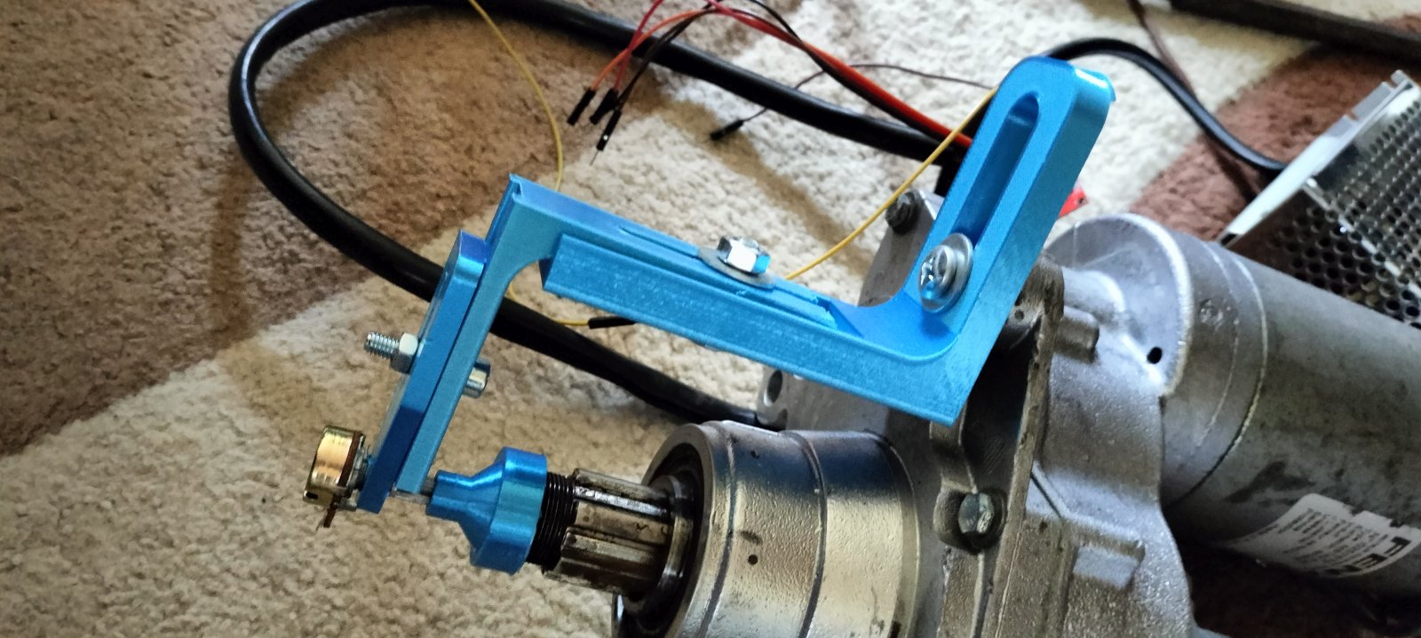

    Update:

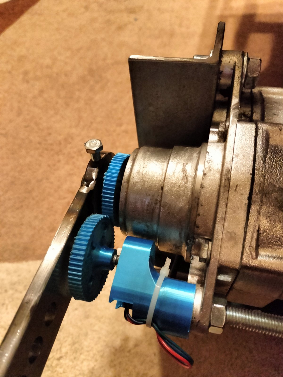

    without any info on the internet regarding the built-in potentiometer, I 3d printed supports for my cheap potentiometers used directly in the main shaft. I'm going to test if it works as it should.

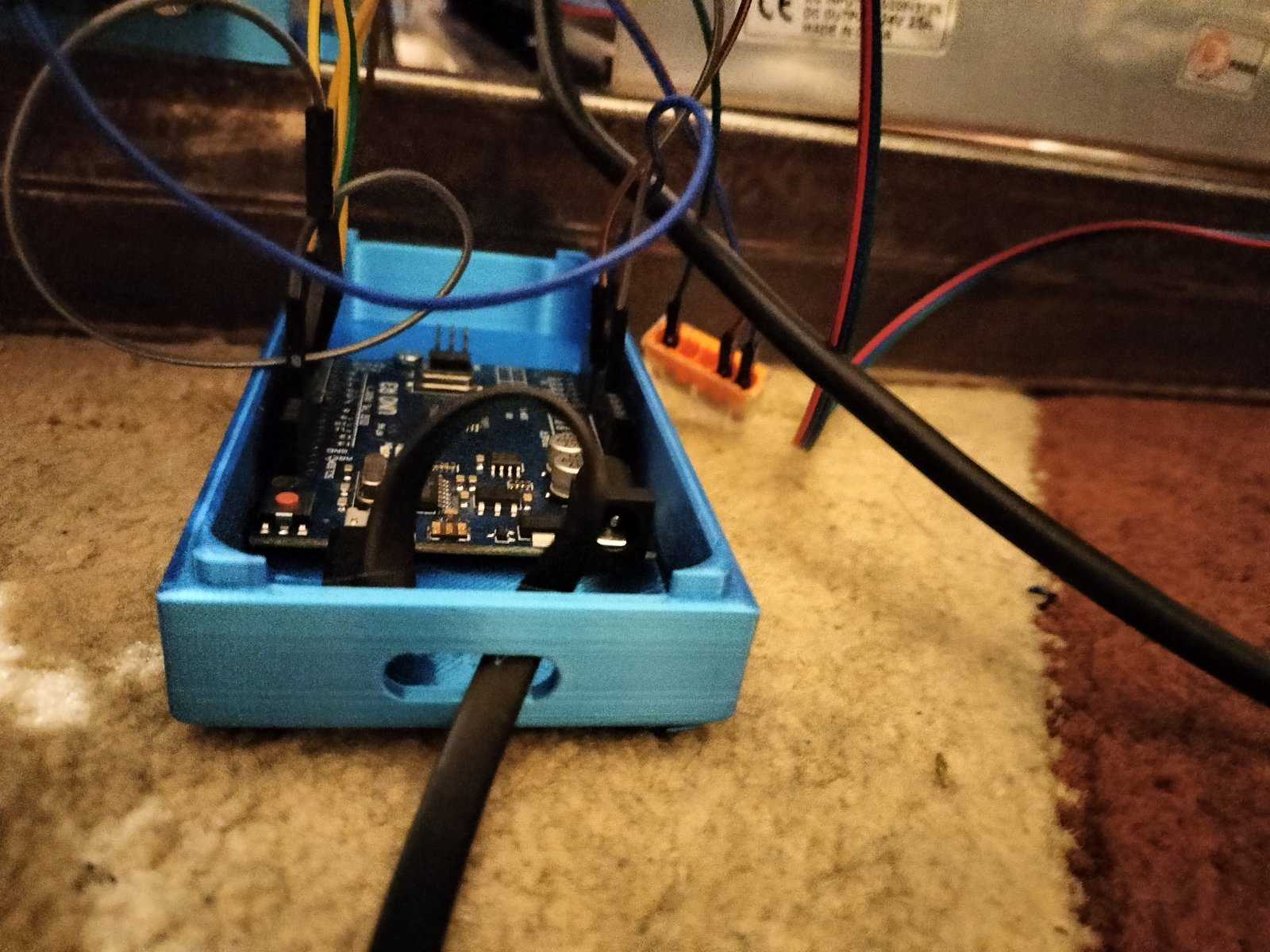

    DC motor, Arduino
    hello.

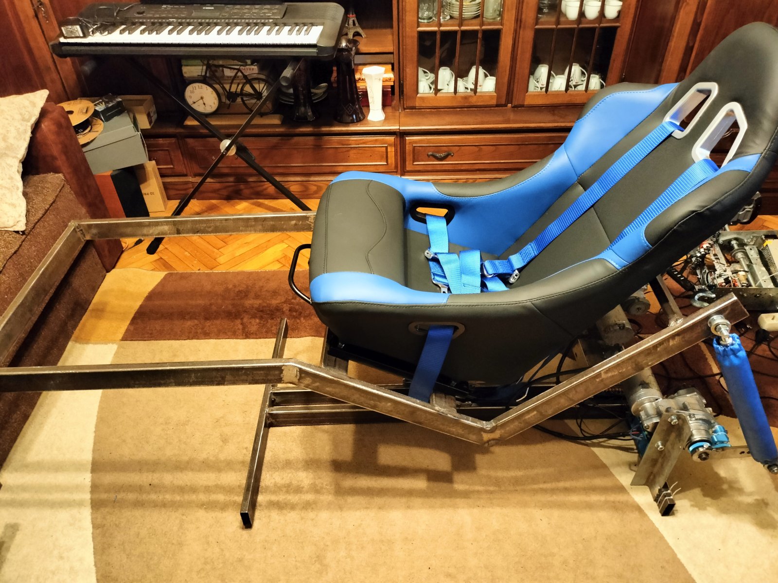

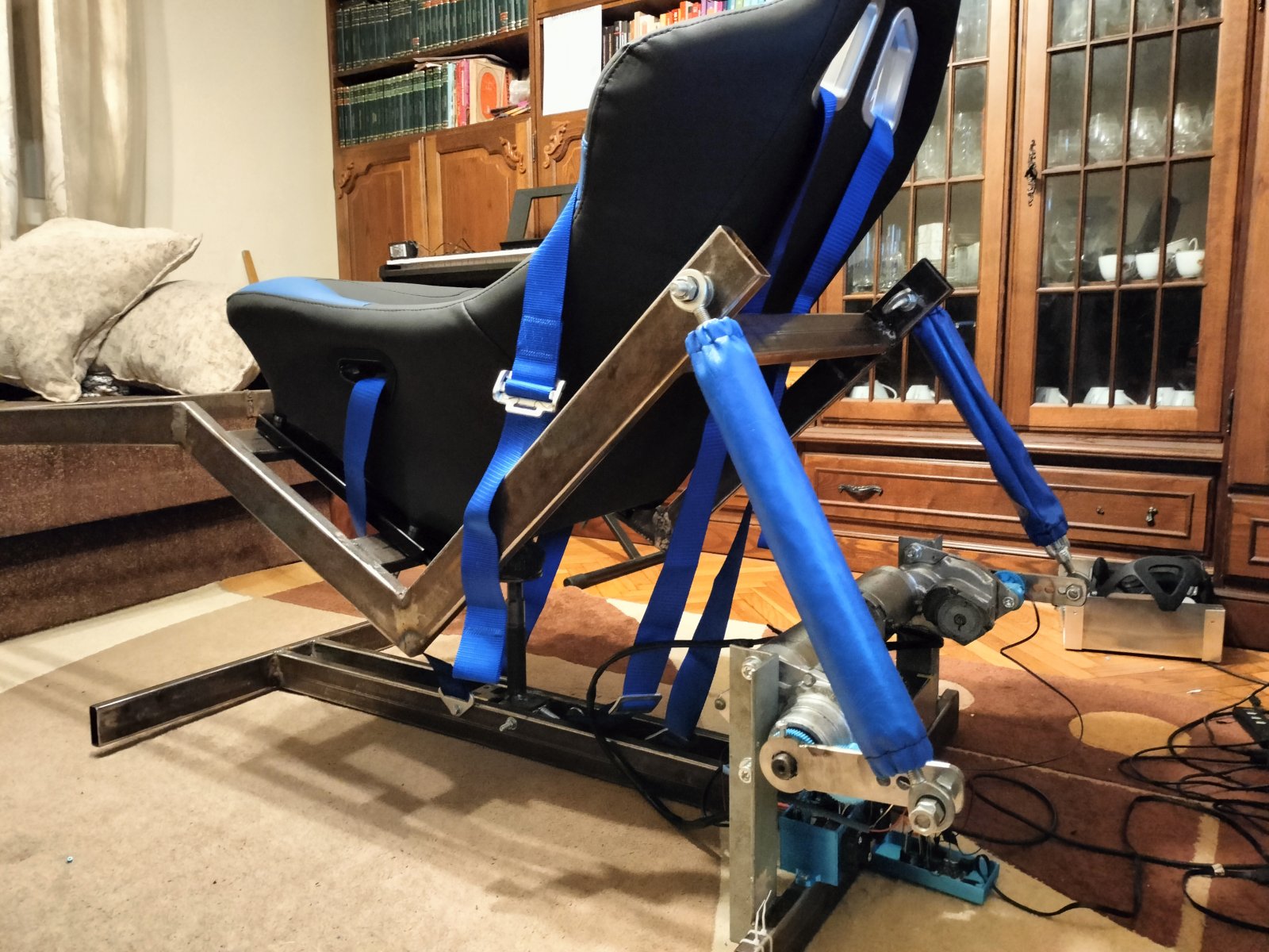

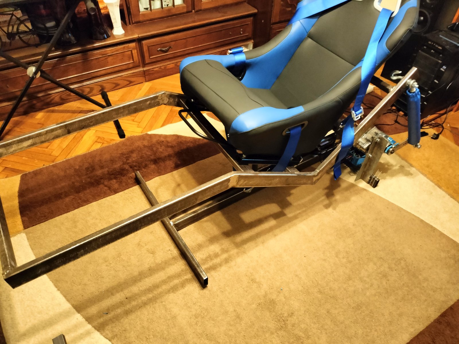

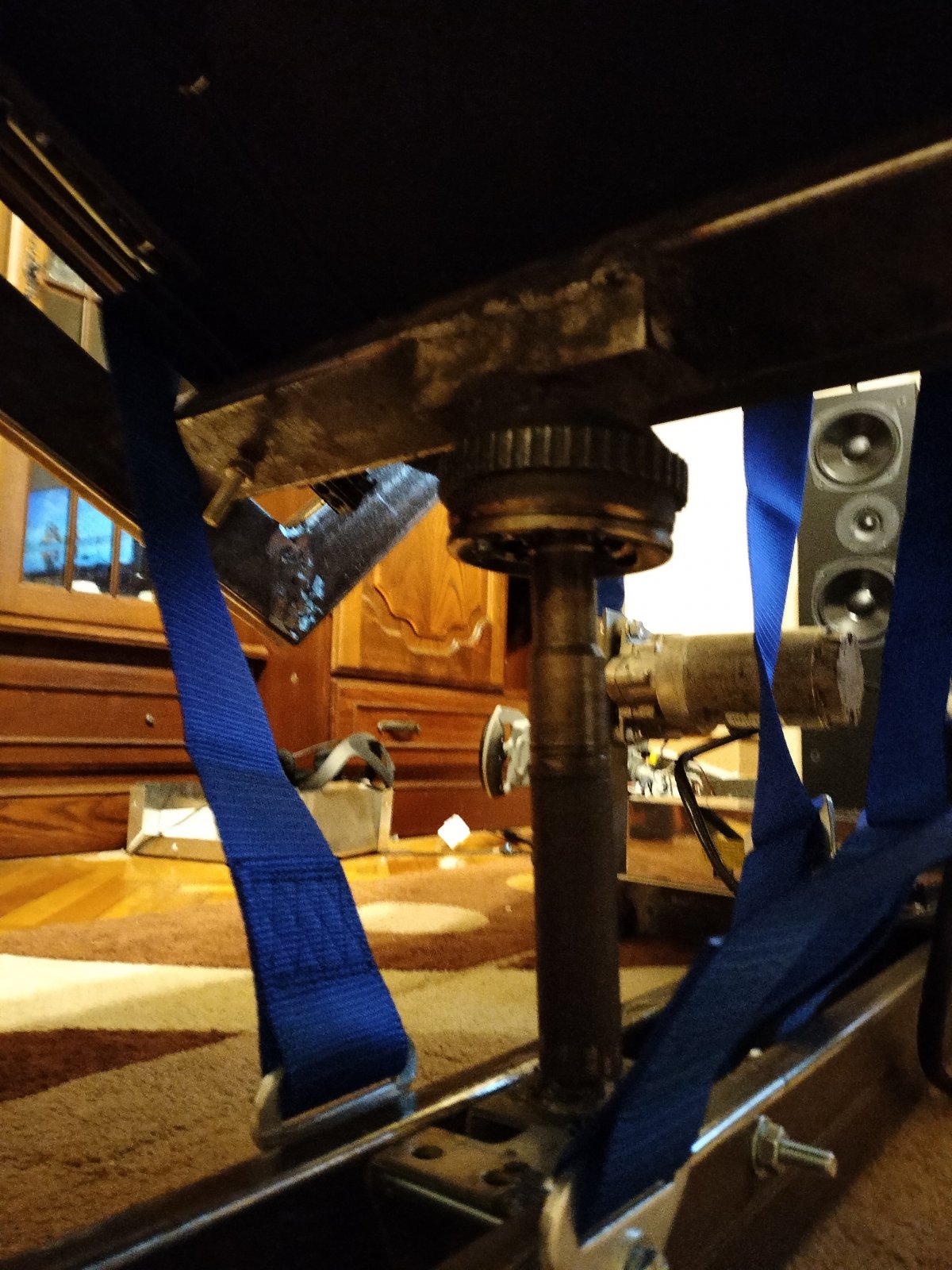

    I'm about to finish my 2dof. In the end, I used cheap potentiometers with a new 3d printed supports with gears to read position.
    The frame is made from a rectangular steel tube, 60x20x1,5 mm, about 10m used for everything. i was looking for something that matches the F1 driver position.

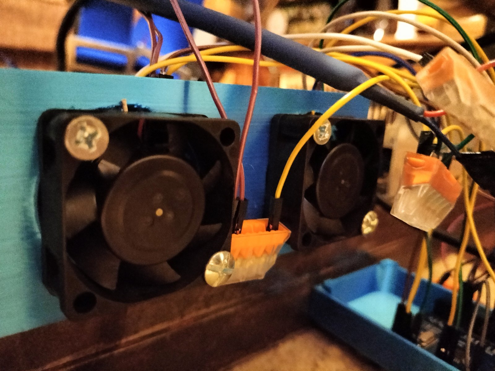

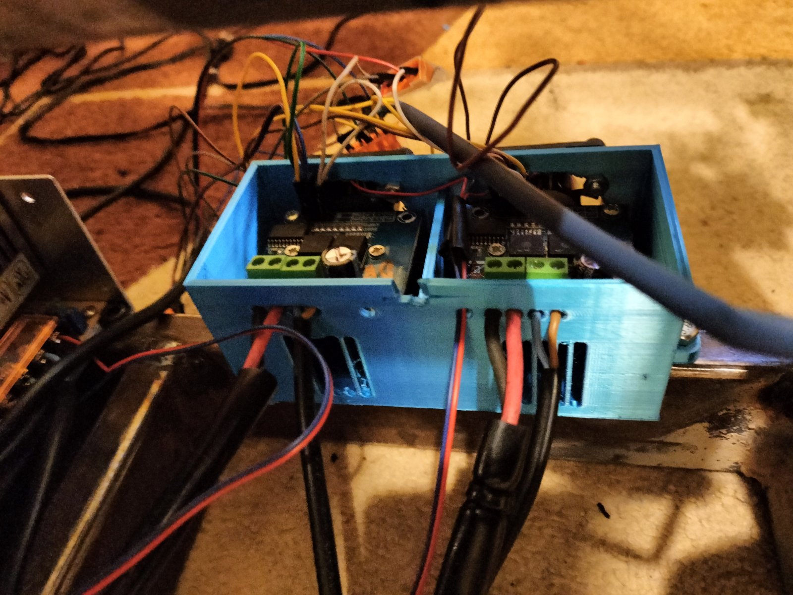

    i printed a case for motor drivers and arduino, but I have to print another lid because the actual one is a bit too small for this amount of wires.
    I've made some tests with Live For Speed, and it works!
    I made the whole thing in 6 days, so yeah, maybe I need 2 more days to finish the frame for the steering wheel and pedals, but my main goal was to see it moving! :) All I can say, is that those motos are really beasts since I can't use them at more than 40% of the capable power (values entered in SMC3Utils - 120 PWM max / REV PWM, and 40% in Simtools, in axis assignment tab)
    I will come back with updates when everything is mounted.

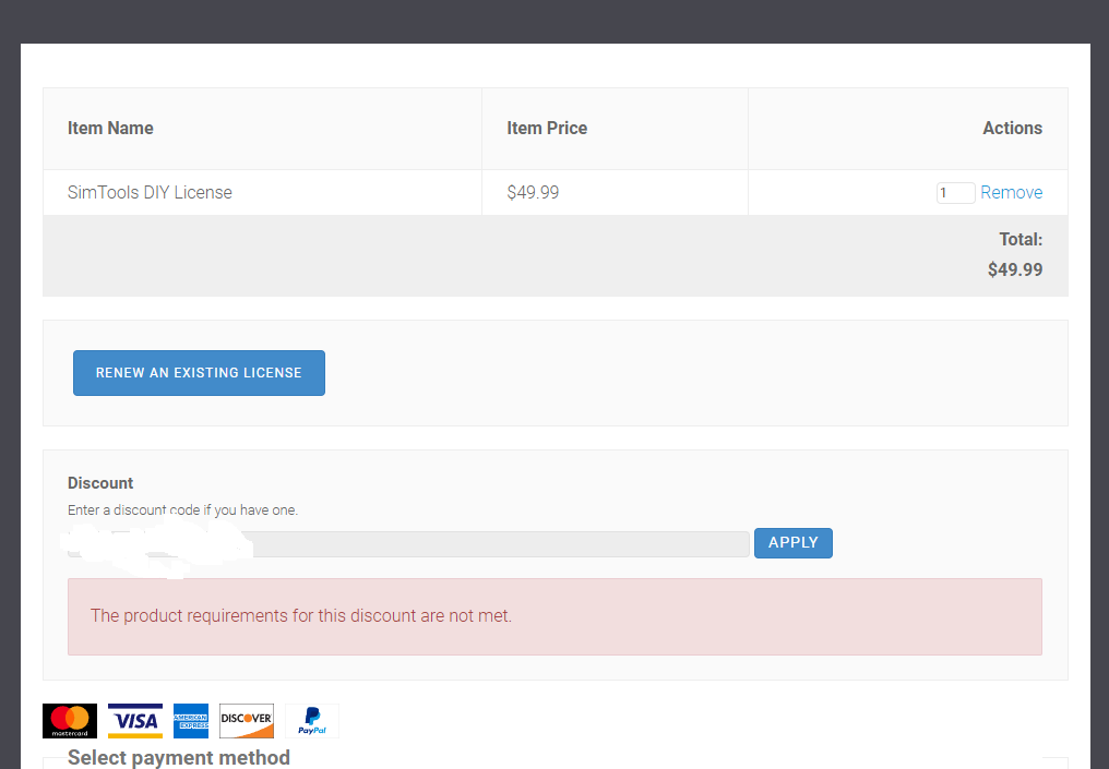

    Thanks to this community, I've got a free DIY license, but there's an error on the webpage. Can someone help me please? What I'm doing wrong?
