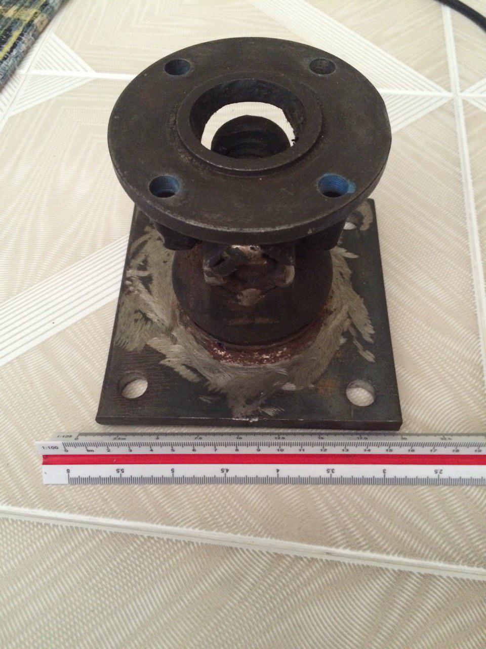

  12. insanegr
    insanegr !N$@n€
    Jan 14, 2014
    504
    Athens
    16,721Coins
    +499 / 1 / -0
    yes bigger is better as it wont twist. something like this 21faed0221bf5ca59703a72ebc79a0e01f4a18add31f2b22f0b1e199cc30de48_full.jpg

    And for the height ?
  14. insanegr
    insanegr !N$@n€
    Jan 14, 2014
    504
    Athens
    16,721Coins
    +499 / 1 / -0
    height does not matter but the thing you have to do is to put closer to the seat the lean point

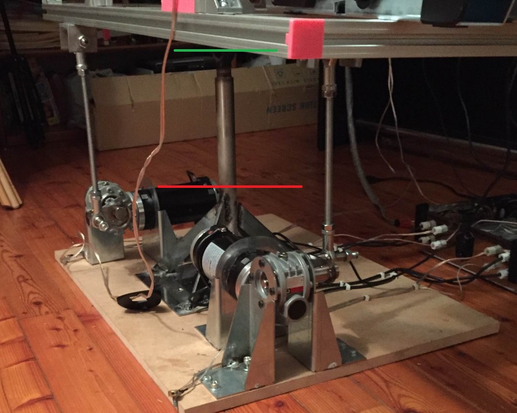

  16. insanegr
    insanegr !N$@n€
    Jan 14, 2014
    504
    Athens
    16,721Coins
    +499 / 1 / -0
    not the balance point (center of gravity aka COG).
    what i mean i will try to explain it in the photo. U joint should be closer to the upper frame (green line) and not closer to the lower frame (red line) if you use a long u joint.
  17. Guillemin
    Guillemin Member
    May 5, 2016
    33
    france
    302Coins
    I understand better now ! Thank for these explanations
    When I will have the U joint, I will send you a pics find the best configuration :)

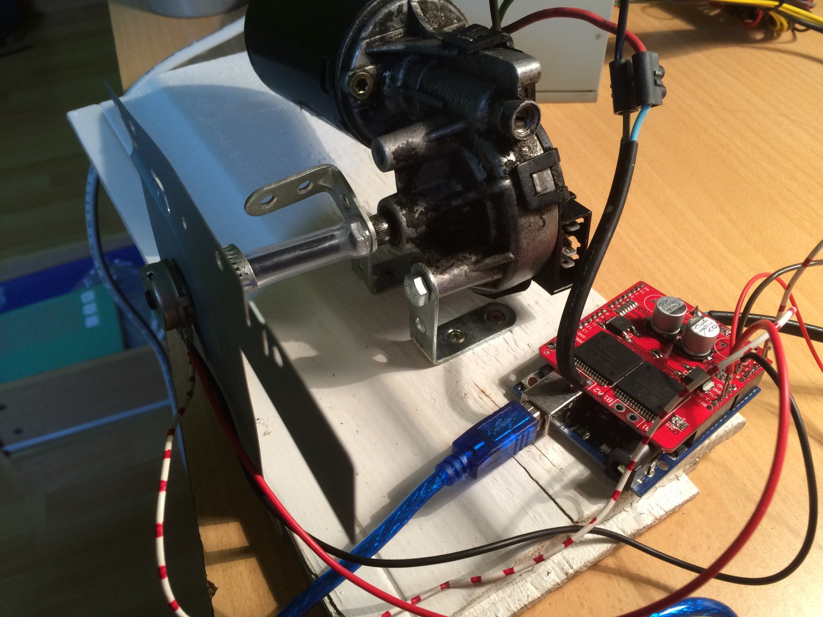

  18. Guillemin
    Guillemin Member
    May 5, 2016
    33
    france
    302Coins
    I have mounted my first motor with a potentiometer to test the arduino code with the motomonster shield.
    But I want try it with Project Cars to see if I had to make modification and see the amplitude of the motor during a race.
    Does someone can make a coins transfer for downloading the plugins ?
