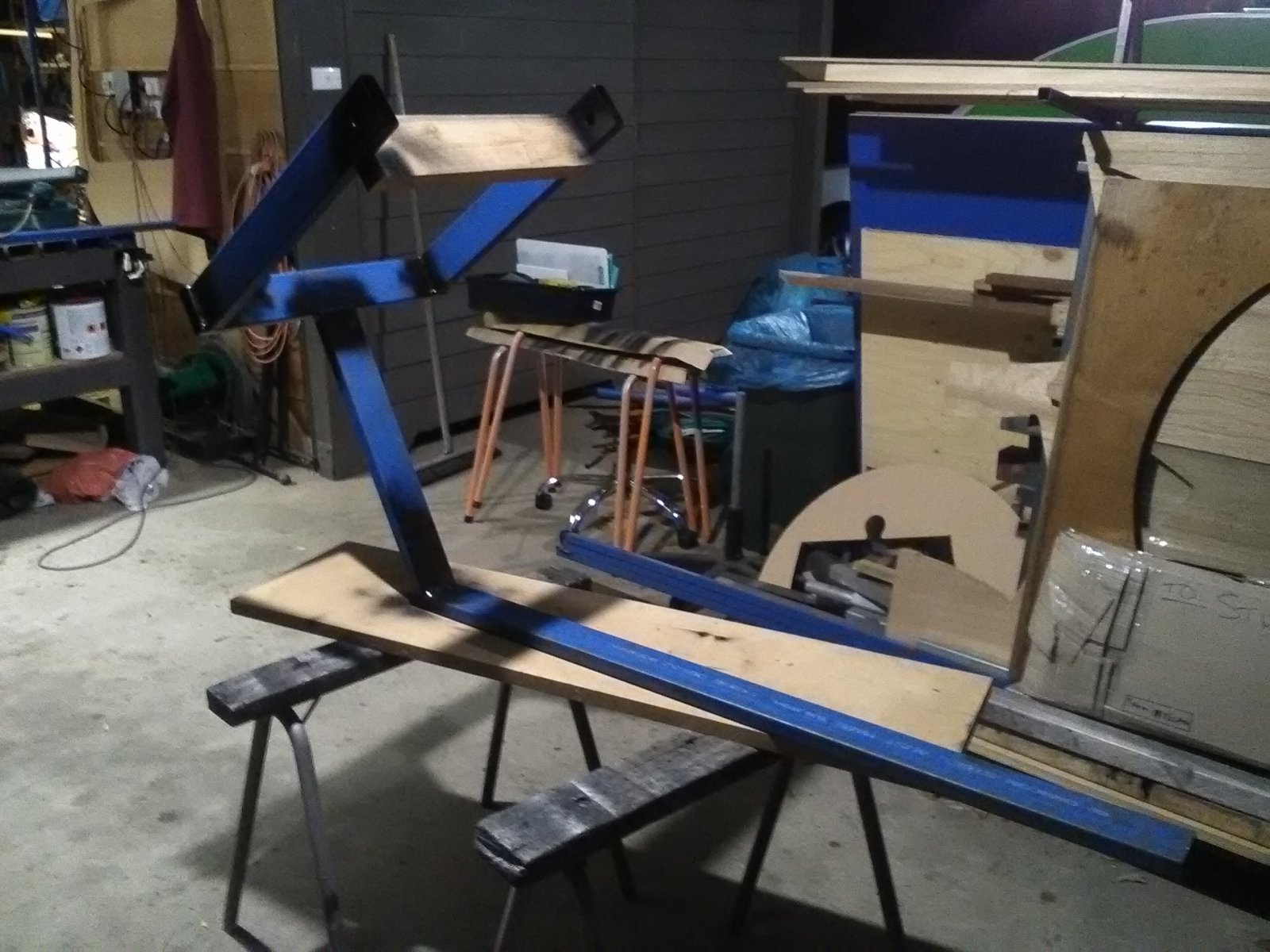

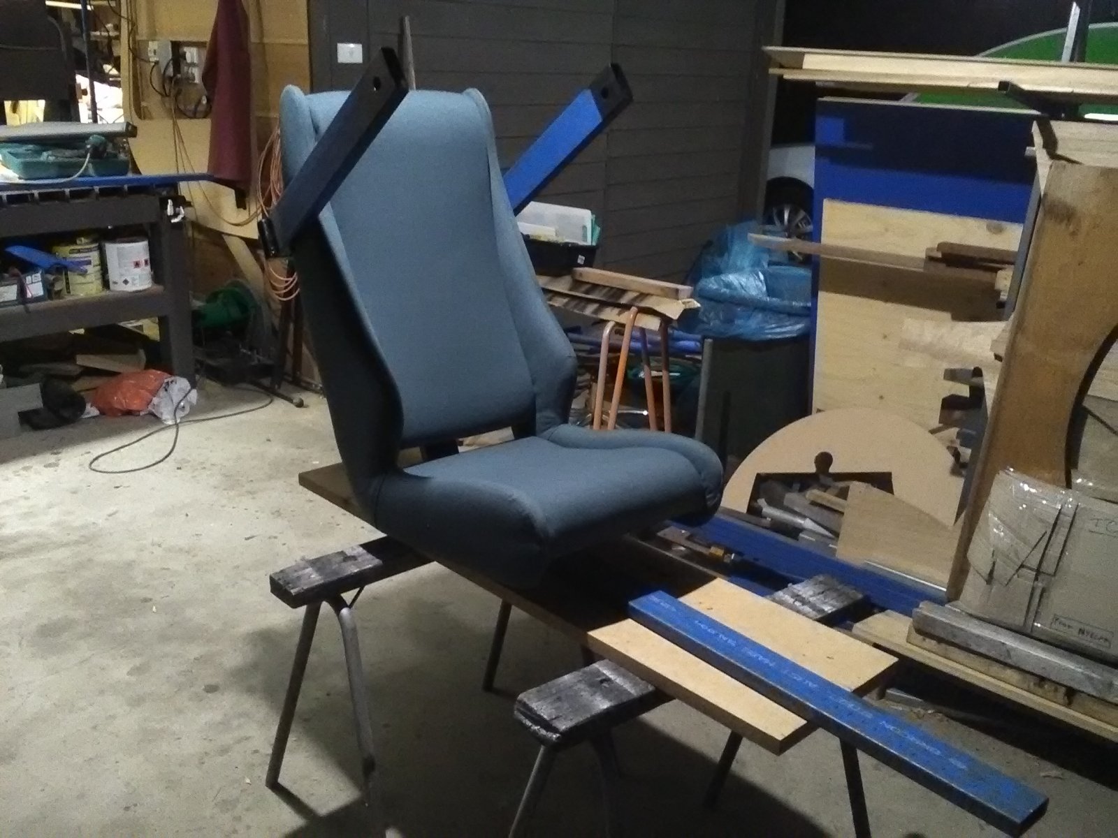

    l have started building my third motion Sim.

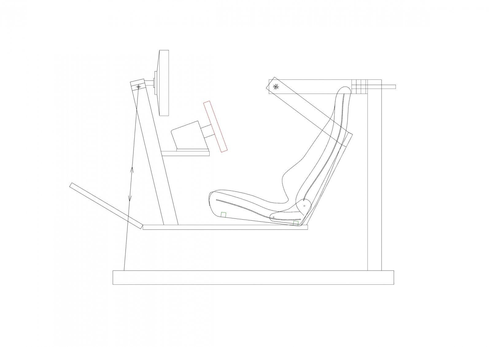

    This time around I am endevouring to place the centre of rotation at the VR headset position. (Just in front of my eyes)
    This means my head should stay revativly in one position which hopefully will negate the need for any movement compensation fudges.
    (I have discussed this idea in the VR forum also.)
    Anyway, I will post pics as the project develops.
    At this stage I have nutted out my drawings and built the seat and the seat mount with the above mentioned centre of rotation. I will be making my own linear actuators from linear bearings and DC work drives. Hopefully this will give me + - 15 deg on both axis . The actuators will be at the front of the rig and driving once again around the centre of rotation point.

    IMG_20190206_205348.jpg The seat mount.

    Interesting design, I haven't seen one like that before. I'm hoping to build my first motion rig in the near future and I like the idea of a high point of rotation because it would mean the initial acceleration you'd feel as the rig starts to move would be in the same direction as the acceleration you're trying to simulate by tilting the rig. Has that also motivated your choice for a high pivot point as well as trying to reduce head movement? The only other rig I've seen with a high pivot point is this one https://www.xsimulator.net/community/threads/new-lighter-2dof-simulator.11118/ which is pretty similar to what I hope to build with its use of rollers and rails except i'm thinking to have the pivot at eye or head level like you are.

    Yes, my original idea for having the pivot point at the head was as you described. After building 2 Sims I realised that the physics of the motion was not emulating the g forces that was supposed to be simulated. For example, with a pivot point lower than your head, under braking the movement of the seat pushes you in the back as the seat rotates forward. In a real car situation, your body is accelerated forward relative to the de-accelerating movement of the vehicle and you feel a force of the seat belt pushing you on your chest!. Having the pivot at the head will more closely simulate what happens I the real world.
    The happy coincidence is that it should also cancel out the forward/up movement fed back into a VR headset as the rig rotates under braking.
    I hope I make sense!
    I am really looking forward to testing this idea.

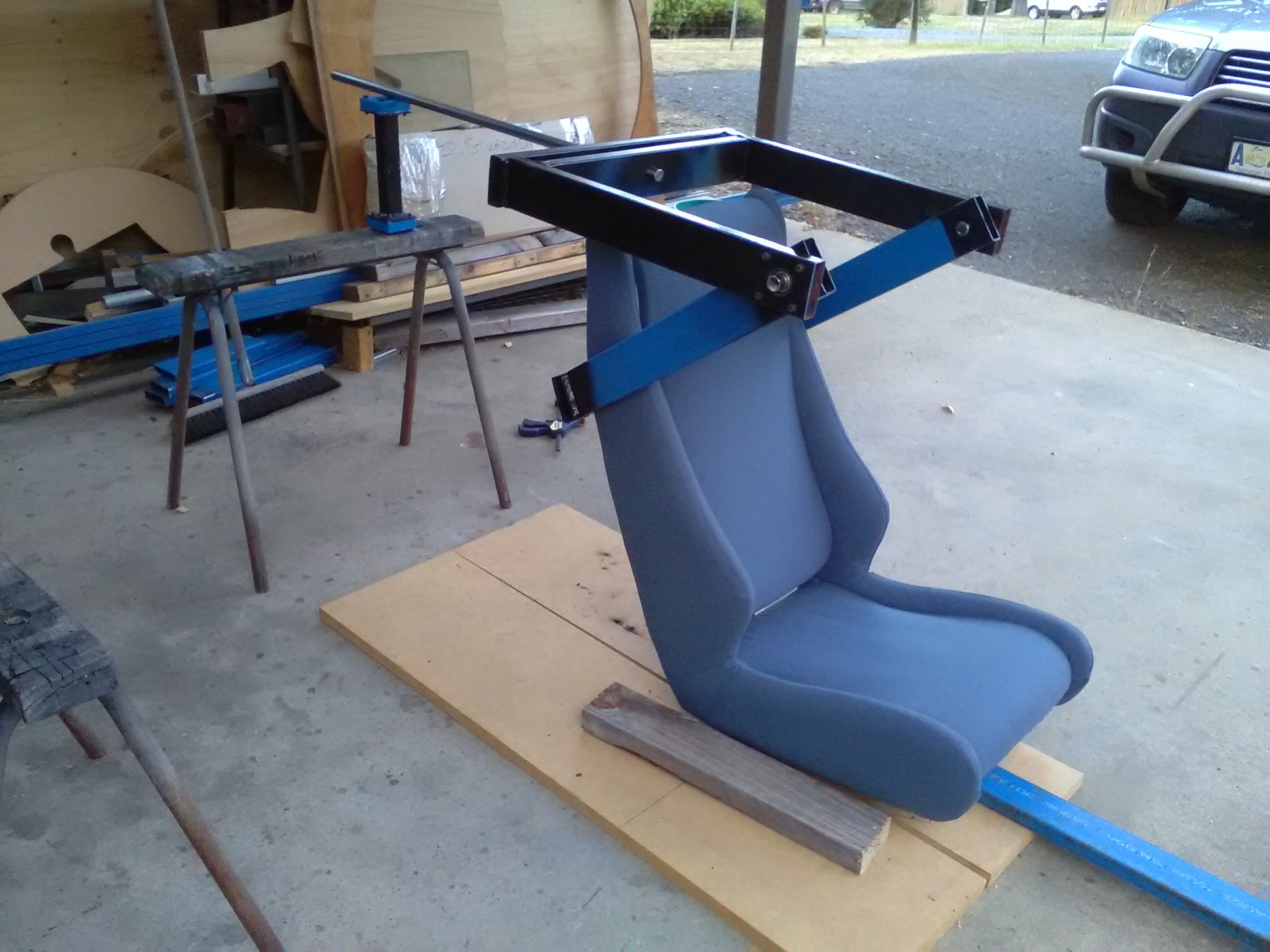

    This pic shows the yoke and bearing attachment to the seat frame. IMG_20190208_201554.jpg

    Have you done stress calcs for the round bar? I just did some guesstimate calcs assuming the bar is 25.4mm dia, the distance from the pitch pivot to the roll pivot is 500mm and the load the yoke will have to support is 150kg using the Cantilever Beam with Point Load Calculator at amesweb.info with these values:

    which indicates it might not be strong enough, depending on my guesses and what type of steel the round bar is.

    Wow,
    Thanks for taking an interest in my protect. As you point out, I am concerned withe the cantilever being the weak point. I have used 25 X 75mm section RHS where possible. I have just finished tacking the other parts of the rig together. After manualy moving the rig, I found that some parts need to be beefed up. I am working on it! I reckon I can make it work well. ------ work in progress
